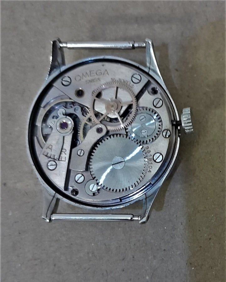

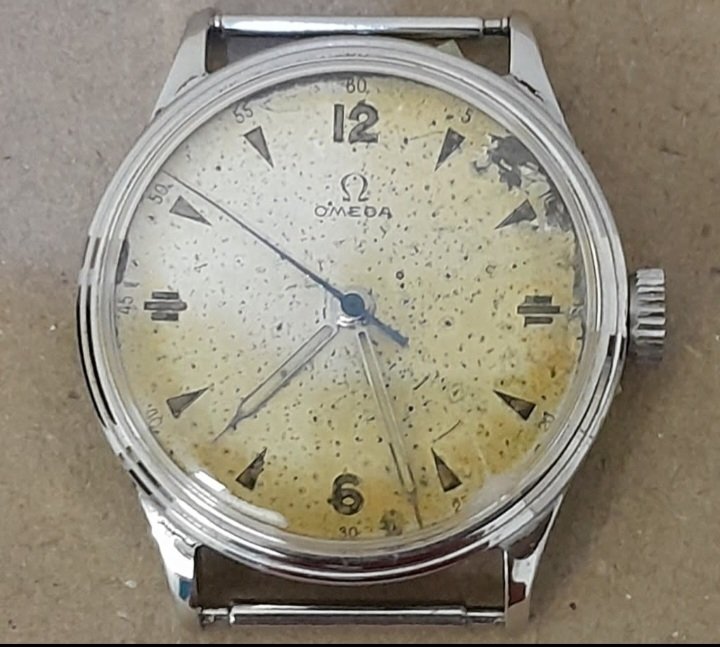

Hi guys I am looking at buying this Omega with 30t2 movement in. The ref no the case back isn't yielding any help. Can anyone help id the watch? Is the dial legit?
244
408
That's a serial number, and it says that the watch has been produced in 1944.

That was an interesting dial design, unfortunate about the condition.

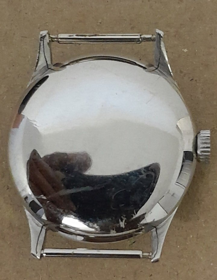

The watch you posted is 32 - 33mm? Missing case screws and has had the case polished.

I think this case design. Back holds the movement in place

Is the dial legit?
I'm voting no. The font for the 55 minute is different than all the other 5's. it has 80 over the 12 marker. Under the logo it says OMEOA. Plus the dial damage looks terrible.

Would need a clearer dial photo but it definitely seems like a redial, possibly with the original hour markers
That is because it is just a case number not a reference number. A lot of 1940’s and older Omegas were like this.
