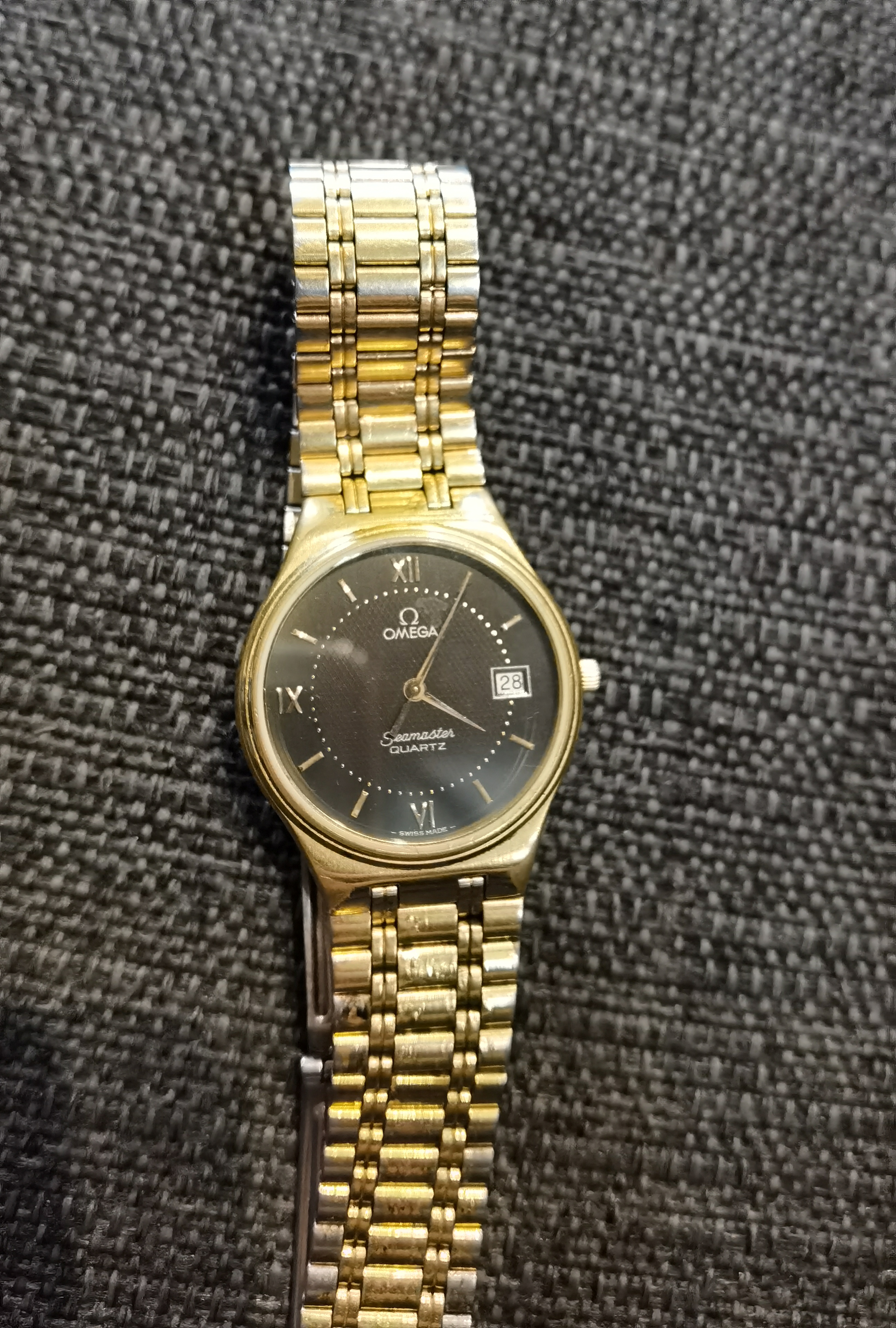

Hi folks. I was given this by my father and I would just like some info or specs on it maybe even it's age. Thanks in advance

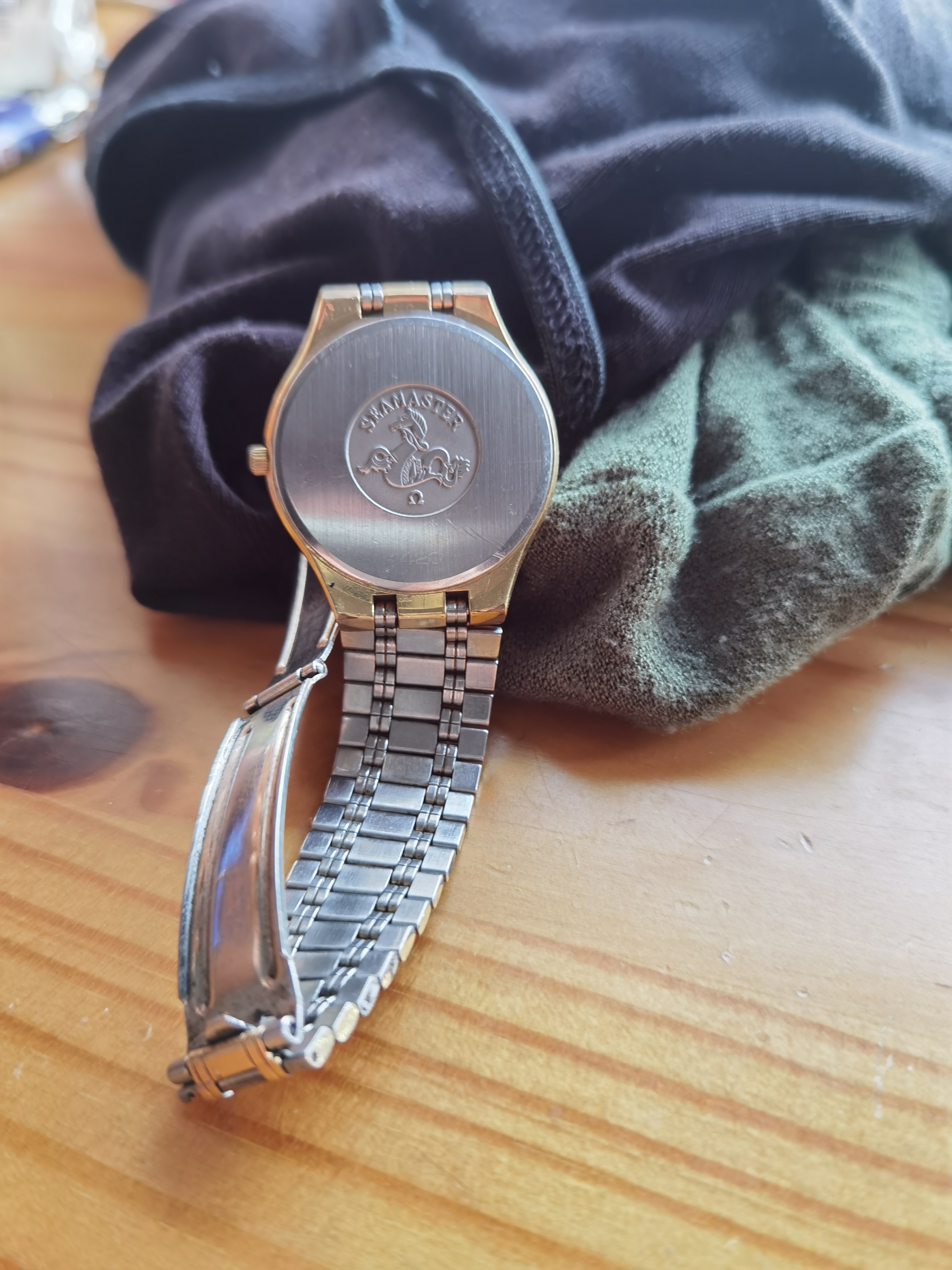

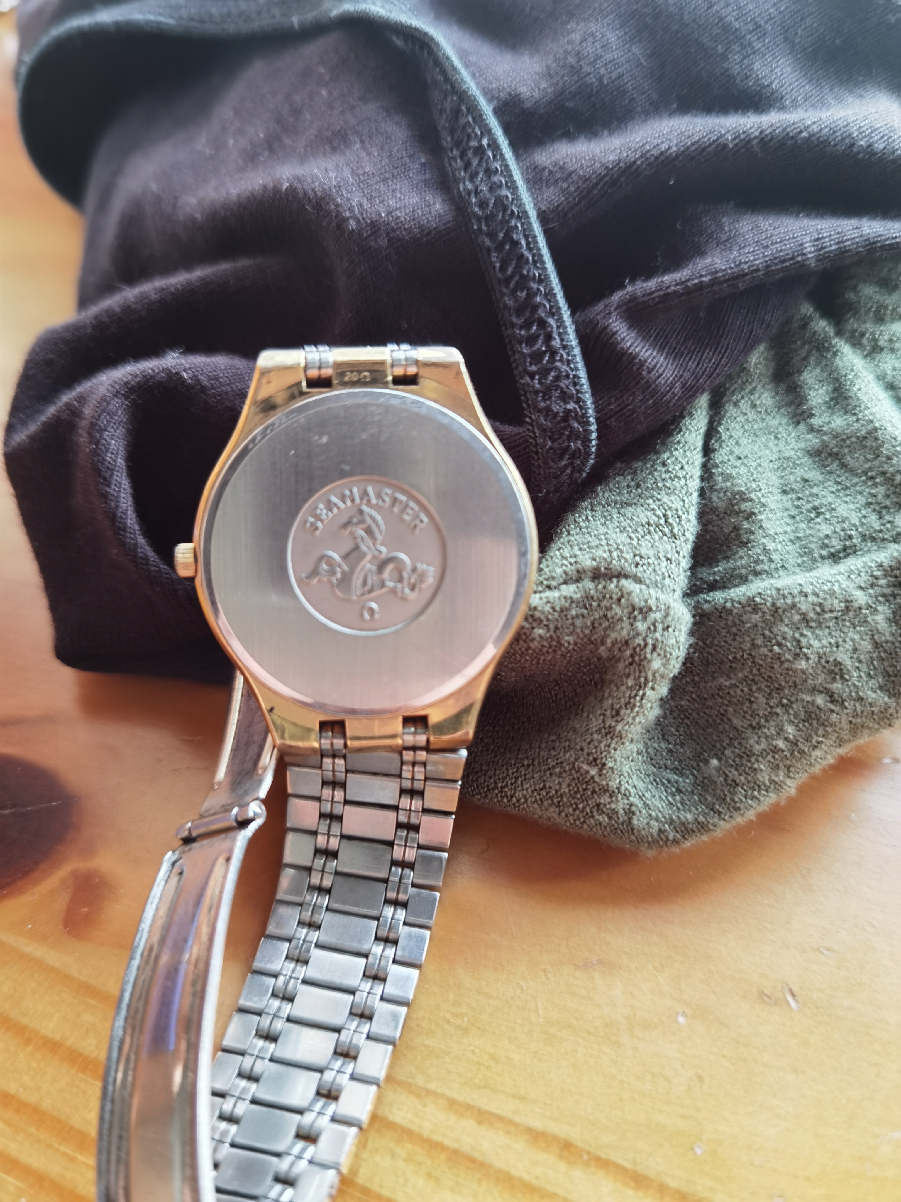

Pics enclosed pal. The only numbers on the back are 20ohms and 1420

Most places you see a Ω that means "Ohms". But on an Omega watch, Ω means Omega. In this case "20" means 20 microns gold plate. The interesting numbers are not on the outside of the case back as you have nicely shown us.
They are on the inside and you will need to open the back to find them. If you can't do so you'll need to bring it to a watchmaker. They can also replace the battery.

It is an Omega Seamaster and I think it is a ref 196.0235 based on some Google searches.
It is calibre 1420 movement. Gold plated and has that lovely textured dial.

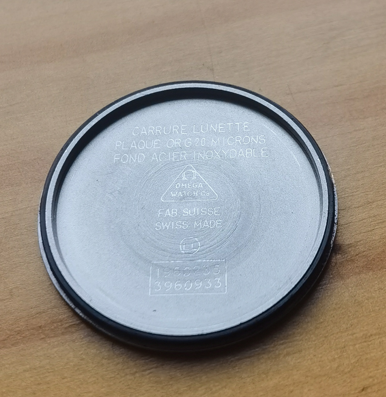

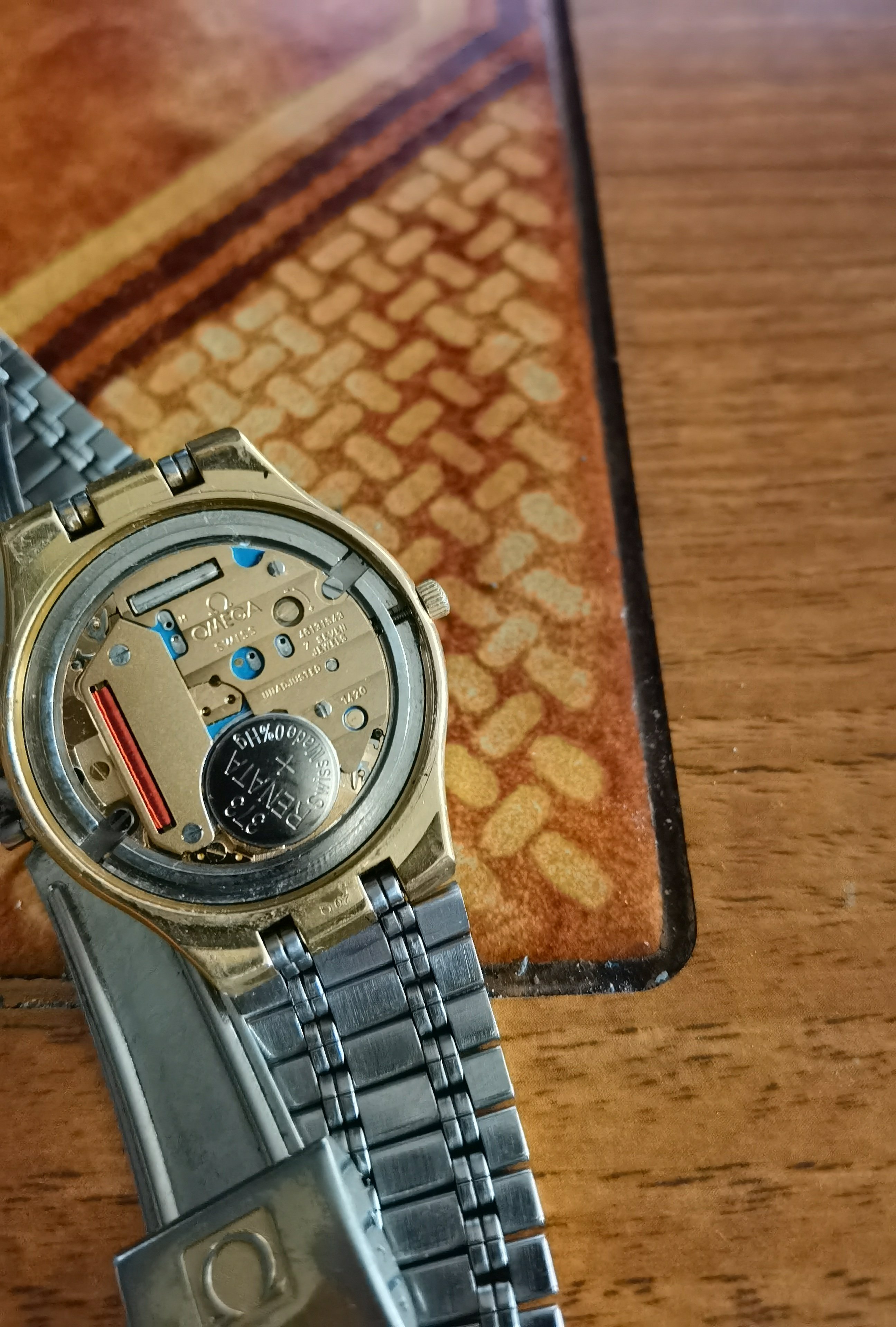

Apologies guys... I really appreciate your help didn't mean to question your advice... So here we go... I managed to prise off the plate pic enclosed

The serial number indicates ~1984, as @DMass suspected.
The battery looks like it's bulging, so if it's not running, get it out ASAP.
If that's just a trick of the light, and the watch is still running, it may be okay.

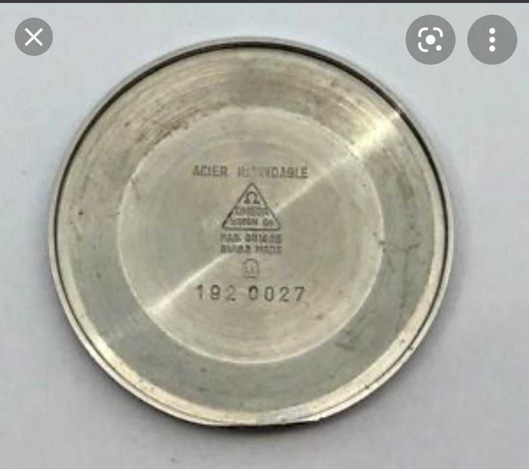

Awesome so on the inside of the case back you should see something like this :

If the watch isn't running, TAKE OUT THE BATTERY.

As timecube said make sure you take the battery out...
