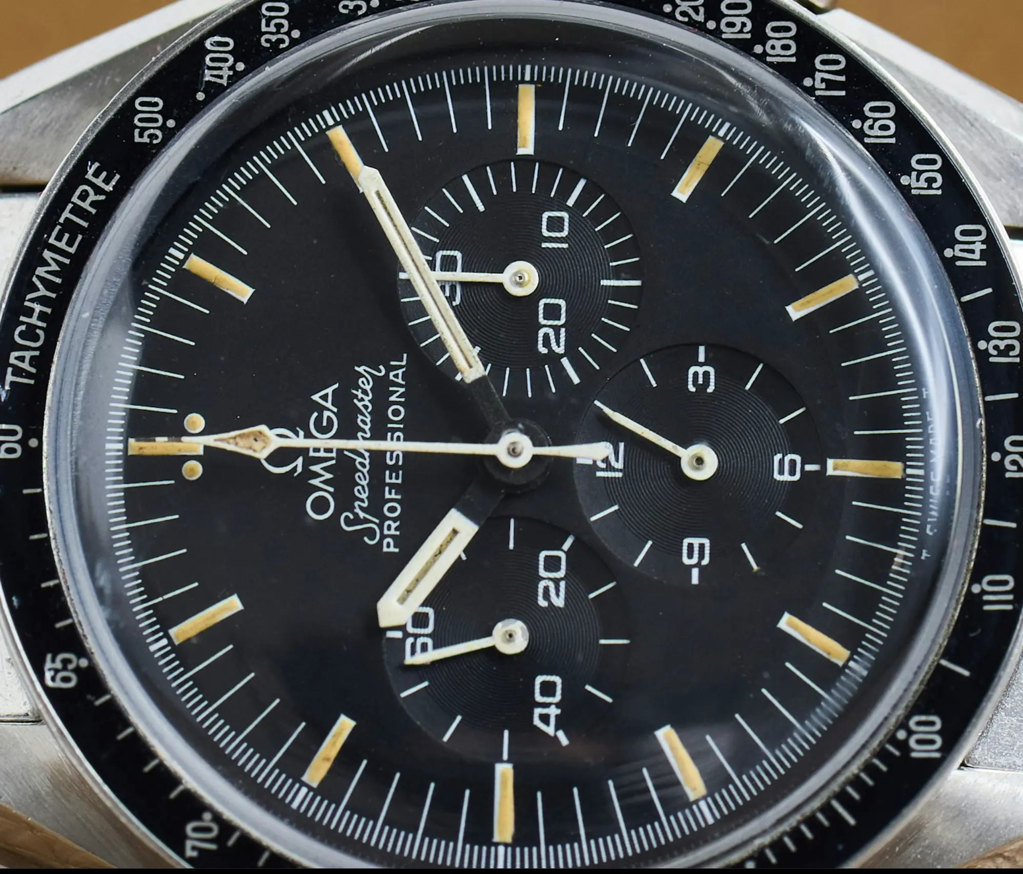

Hi,
I'd be grateful if anyone help identify this dial, it loks like a cross between a C4 and a C5, ignore the bezel. It looks stepped between 3-6pm but can't be sure. Thank you

Looks like -78 dial with long S extending down to the p level, with no visible step by my eye.
Bezel may ne correct for -78 as well but can't see the entirety
Hands are wrong look like MkII hands.
scroll down through this to the end for discussion of dial differences
https://speedmaster101.com/145-022_update/

Thank you, I invested in a copy of "Moonwatch only" but couldn't find it, very helpful and much appreciated
