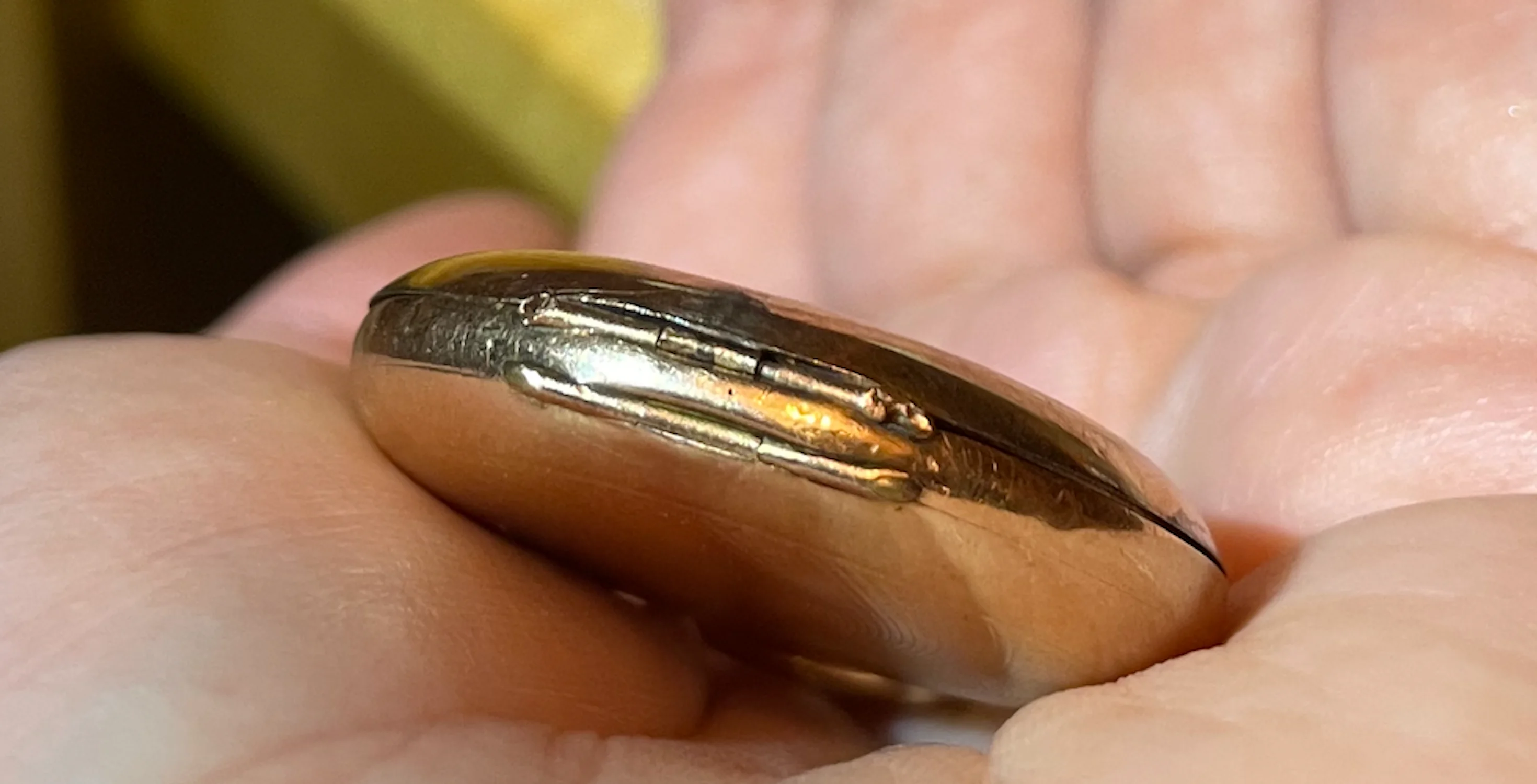

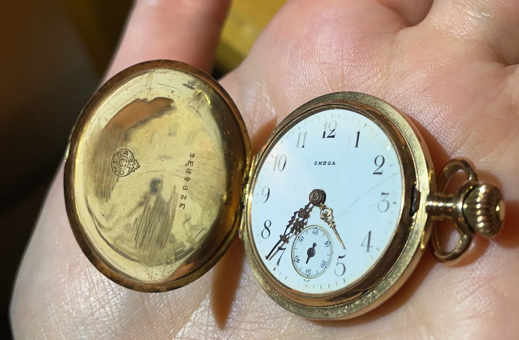

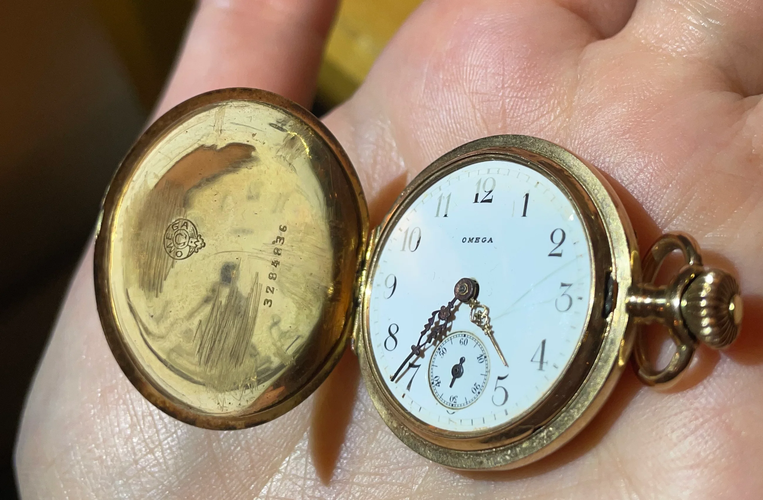

We found this very small (~1.25inch) Omega pocket watch in my great-grandmother's things. We will never want to sell this, as it is priceless to our family, but we have very little information about it (and her) and would love to know more.
What we know: owned by my grandmother (lived 1880s-1940s in Yugoslavia, though she may have gotten this elsewhere?). As far as I know, it has been in my family since it was made.

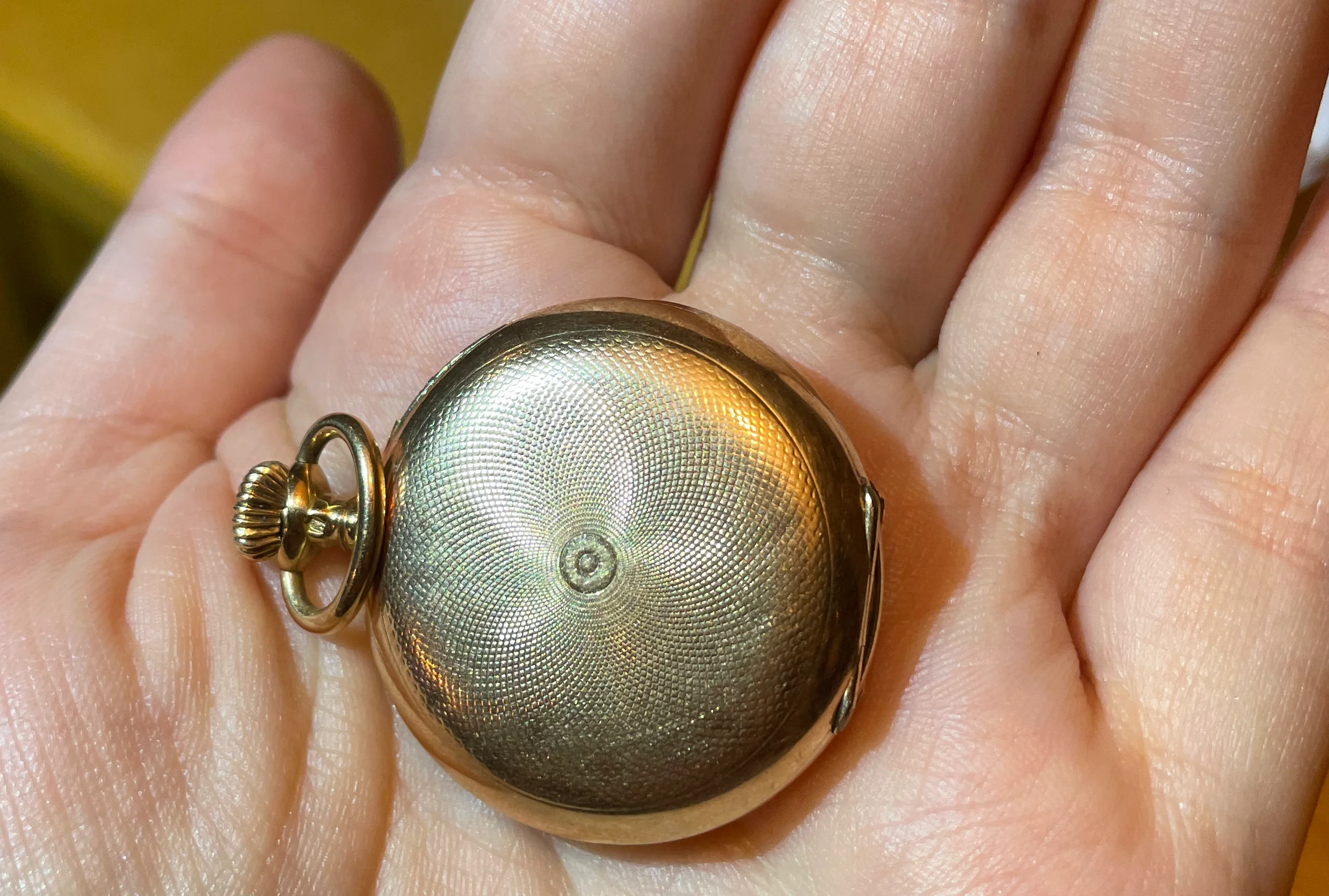

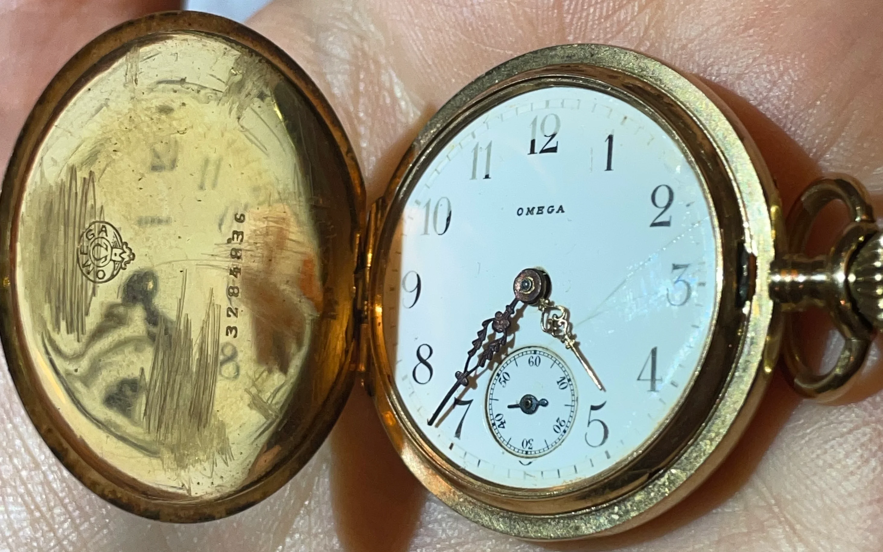

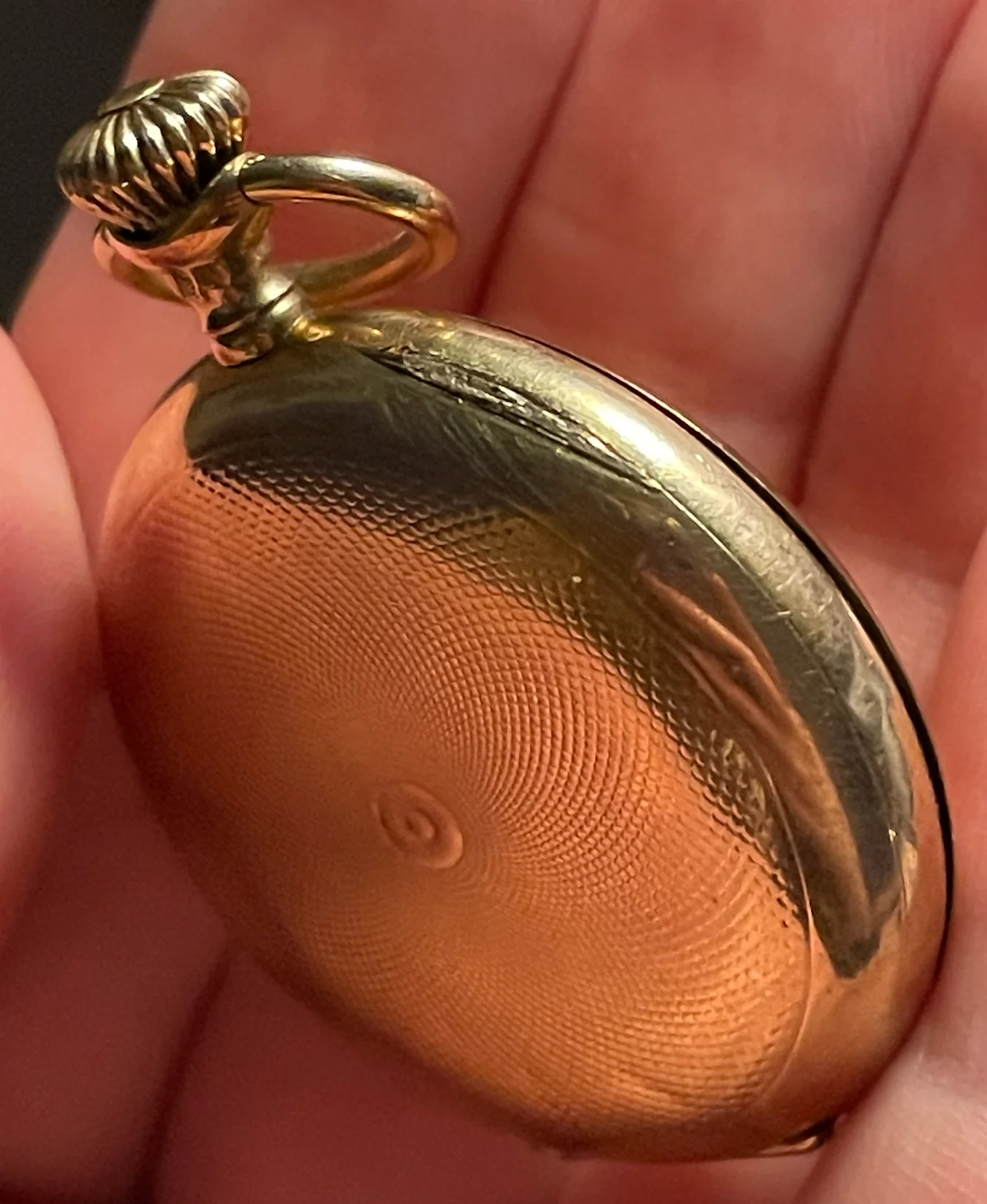

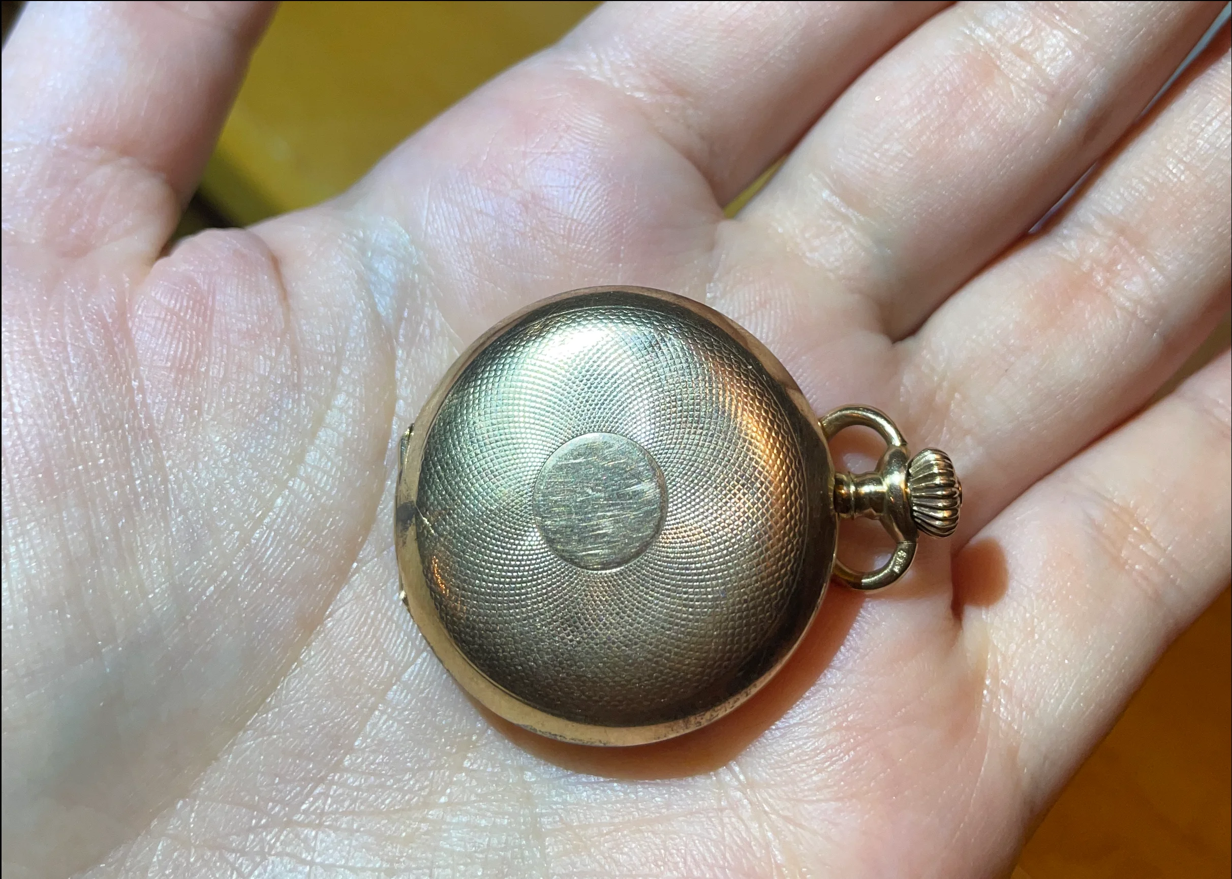

If I click the crown the front opens to reveal the watch face, which doesn't have a glass cover (anymore?). I believe it's enamel. The backside clearly must open (there's a second hinge!), and there's evidence someone tried to jimmy it open, but I barely see/feel the seam on some parts of the circumference. I unfortunately cannot get in to see the movement (I honestly don't trust anyone to open this--I realize that is going to limit the amount of help you may be able to give me, and am sorry for that). It's got some weird, agressive scratches inside the front cover in several places--not sure why. But the case number is clearly: #3284836.
We would be so grateful for: dating, identification, model #, material (gold?), or any other information that comes to mind when you see this.
Thank you so much in advance for your time, help, and expertise! Hope you have a lovely weekend.

It's a nice little ladies Omega pocket watch, possibly gold or rolled gold case, but no hallmarks are evident so it's just guessing.
The case serial dates it to about 1905, a movement serial would narrow the date down, but it may not be visible on the movement even when the caseback is opened. Due to the size, it may house a caliber 13''', but until the case is opened, again a guess.

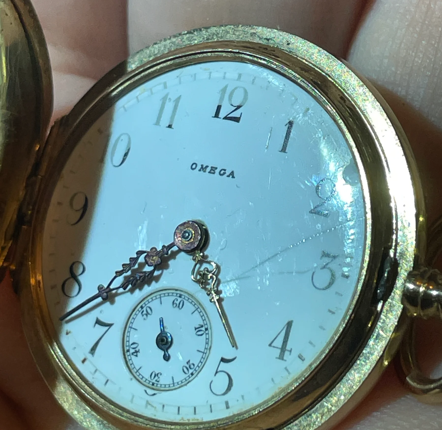

The vitreous enamel dial has "Paris" style Arabic numerals and the gilt hands are Louis XV style, although the sub-seconds hand is a later/incorrect replacement, the minute hand may also be a later replacement as it's not quite the same style.
Thank you so much for your reply!! I am genuinely very grateful.
I did think all three of the watch hands looked a bit different / the second-hand looked more modern. Is there a specific time period those other 2 later hands are typically associated with?
(Also good to know that even if I did get the back open, the movement number might not even be visible..!)
