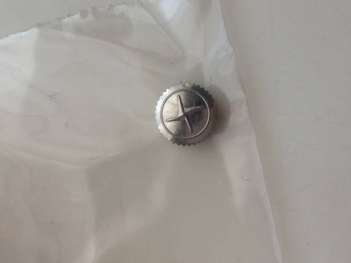

I am actually buying a Zenith El Primero A386 (#922D... I blurred the last 3 digits), and it looks really great, except, there is no "T Swiss Made T" or "- Swiss Made T" on the dial. Is it a problem? What do you think?
I share with you the pictures 😀

Stephane,
it looks like the dial is off center...too much reveal of the outer black up top, and not enough at bottom..see if you can get the seller to open the watch...

Avantnoire,
You may have right, so it's hiding the "T Swiss..." under the 50 at 6'.
The watch has been revised by an authorized Zenith reseller in last January. They revised the watch and changed the glass.

Maybe no feet under dial...
However uncorrect red second hand and crown

GIGI,
What do you mean by "no feed under dial". Less space, dial mounted incorrectly?
Yes, red second has been replaced, but for the crown, you said this because it's a smaller one?

correct crown got the circled logo more big, the ring is near "dents"

The second hand is clearly a bad point. For the crown, I don't care too much. The dial & hands are orgininal. The watch is for sale for 4500€. Do you think it's a fair price or I should wait?

I buy a beautiful chronograph without an original second hand & crown, but orginal case, dial...
I asked the seller to check the dial to center it. Wait it's response.
