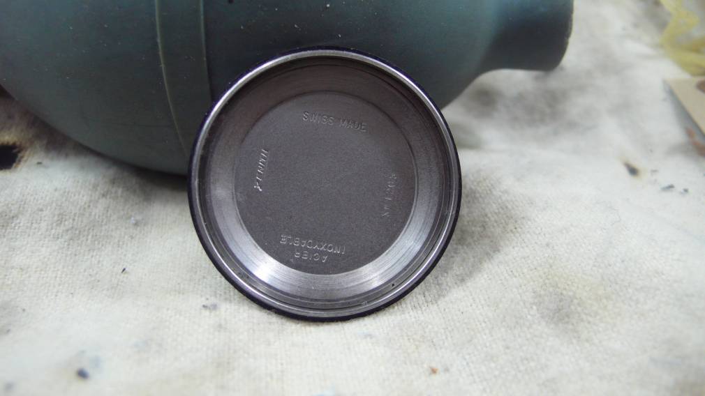

    The incorrect watches, which I believe to be forged as longinespassion has stated, have correct casebacks, but they are incorrect for the case numberIn addition, case numbers lie outside of known production series, typically in the mid 900Dxxx range (922 & 923D are authentic). Dials tend to be modern-style service dials as discussed elsewhere on this forum.
    for example, serial 936D460 - Type B caseback
    [​IMG] Click this bar to view the original image of 1024x768px.

    The second post: In followup to the recent post on smooth vs. starred casebacks , I thought I’d post the current caseback number data of the A 386 from the database, as close inspection has made it obvious to me that some of these are so irregular that they stand a good chance of being forgeries as has been alleged on the Italian forum. The good news is that they are not hard to spot as you will see. The “tells” extend well beyond the caseback, and the forger has even been so cavalier to give us a clear numerical indication.

    936D460
    Modern service dial
    [​IMG]
    That funny looking caseback again with the odd central area, and now with usually deep numbers
    [​IMG]
    Inside, a Type B pattern, whereas the 4th and 5th series bracketing this caseback number have Type C casebacks
    [​IMG]

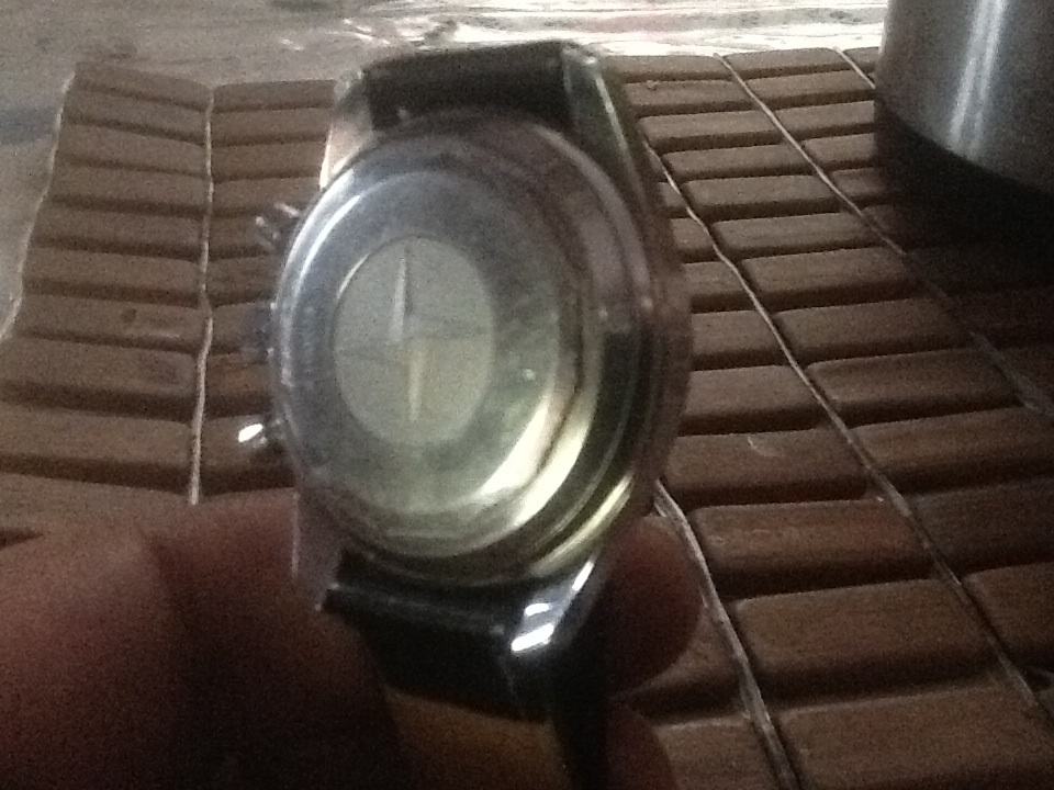

    Hi This is the case back markings of my 386 . back is the NATO star and serial no. 923Dxxx.

  17. sohail Mar 19, 2013
    445
    154
    It's an iPad pic , sorry but this is the one I got, a safe bet........
