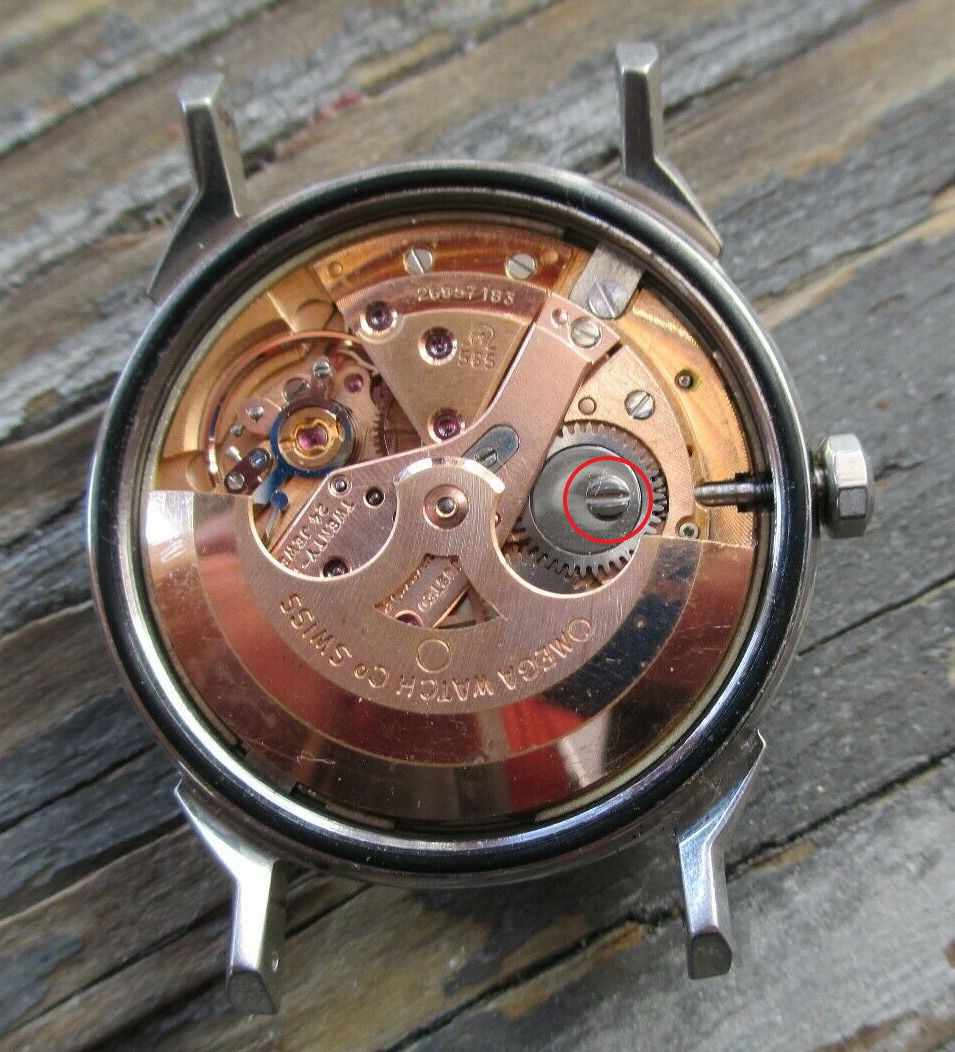

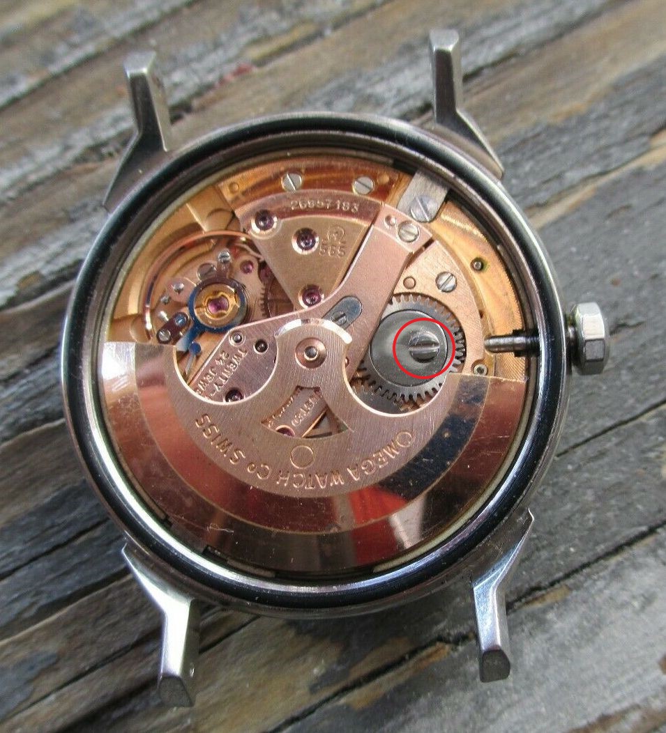

So far:
Wrong movement
Crown wheel screw looks wrong
Rotor bridge incorrect for movement, but is a chronometer bridge (i think it would say adjusted 5 positions under rotor)
Back of lugs look to have wrong facets
I would add, incorrect Lyre?
318
299
So far:
Wrong movement
Good job, but not one of the items above are mine. Keep trying you are getting close. What part do you call "Lyre"?
