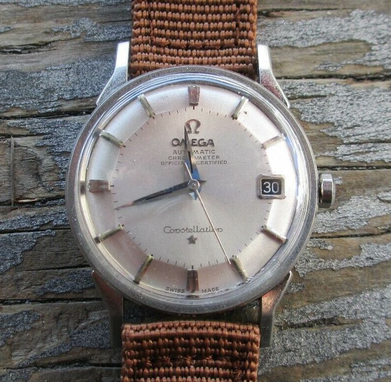

Name the things that are wrong with this Constellation spotted on eBay.
1,050
2,618
Hands are replacements. Wrong caliber, should be 564 for chronometer rated. Also never seen one with that date indicator disc color on a silver dial. Thinking it's also likely a redial based on the quality of the print below the Omega marker (edit: and the minute track on closer inspection).
Edit: regarding my thinking on the hands - the second and hour hand seem too long extending beyond the minute track. Also, with the black / onyx color, the dial markers should match if the hands are original.
Also - I can't tell if the markers contain lume. If so, we should be seeing T Swiss Made T on the dial, which would be another indicator of a redial and the hands being replacements.

I would add the case is overpolished as it misses edges on the lugs.

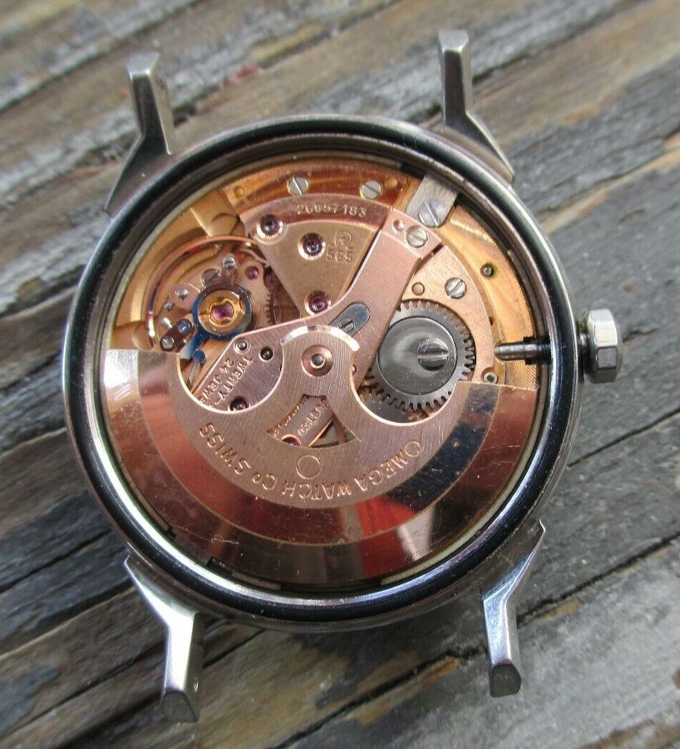

The screw used for the crown wheel seems odd to me...shouldn't it be flat?

The bezel?

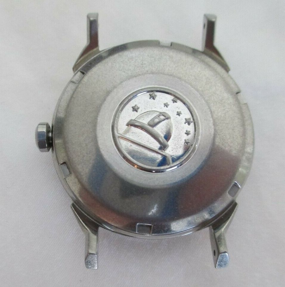

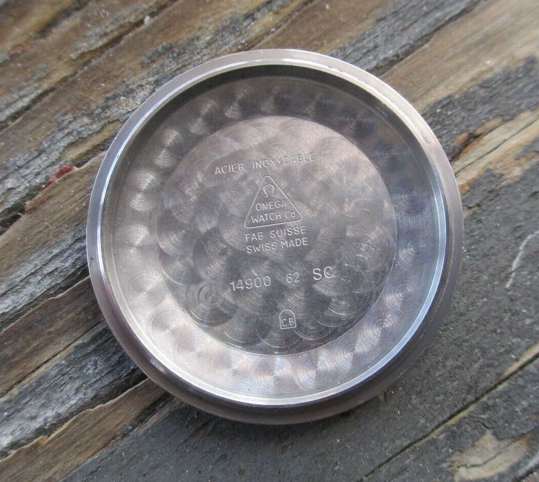

Also I think it has a wrong crown and since the case back doesn't belong to the case which case are looking at? 168.005? (I may be making some confusion as I don't known a lot about constellations - it made go study a bit 👍)

Colour of rotor and bridge is different from rest of movement...

Should've been either 14902 or 168.005, but seeing from the shape of the lug it should be 168.005,
Black date wheel, though I'll probably take that watch to take that black date wheel and put it into my black steel constellation pie pan watch then throw away the watch.
565 bridge was put replacing either 561/564 for the gear teain.
Crown wheel screw is fixed inside it, and its inner core is reworked to accommodate the fit of screw, I think.
Dial is Japanese redial, and relumed.
Mismatched hands.
Crown is an OEM one, though I won't blame them for that if it makes it a little water resistant.
Stem is too long, idk why the watchmaker didn't bother to fix it correctly.

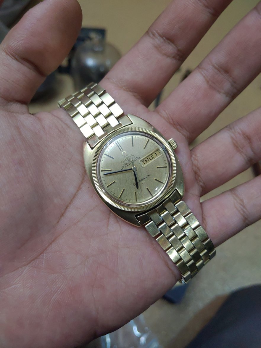

But what do you think about this one?
Movement correct, 751.
That circle thing is plastic covering the crystal.

As a noob, at first glance, all I could tell is the black date window and abnormally long second hand...

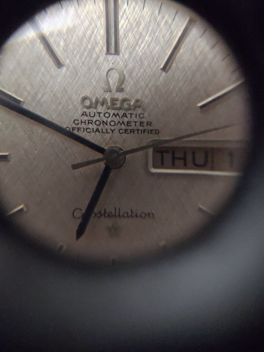

Ouch!!! my friend. Texts when you blow them up are kinda irregular -that is just one

Date wheel, second hand loner that what it should be, etc.

The caseback looks totally fake
The seconds hand is wrong, its too long
The date window has a black background
the hour markers dont look quite right, should there be bits of black?
And the word Automatic looks larger test than the words below.

Need more threads like this!! First thing that jumped our was the black date wheel, the hands and the dial font....

The 14900 should house a 551. The perlage on the caseback is too perfect, the circles not overlapping, possibly fake caseback. The hour markers don't have onyx, and finally, the chamfering/faceting on the lugs is not present.

Hands in bad position to perform "MOY" test, but don't need MOY test to identify it's a redial.
Some hour markers don't seem to match up with dial hash marks - 4 & 5 for example.
Not good with bezels but something looks off there.

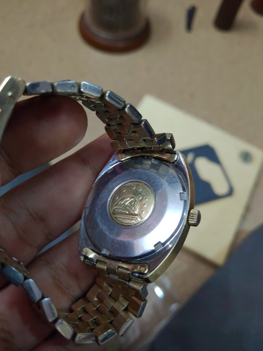

Is the rotor rubbing the copper ring below it at the 1 o'clock log or is that mark made by a clumsy watchmaker?

In addition to all of the above should there also be a lume plot/marker at 3 beside the date window?

- too long seconds hand
- wrong caliber, 565 was never in a Connie
- wrong date disc color
- soft pie pan facets indicating redial
I am in doubt about the bezel.
