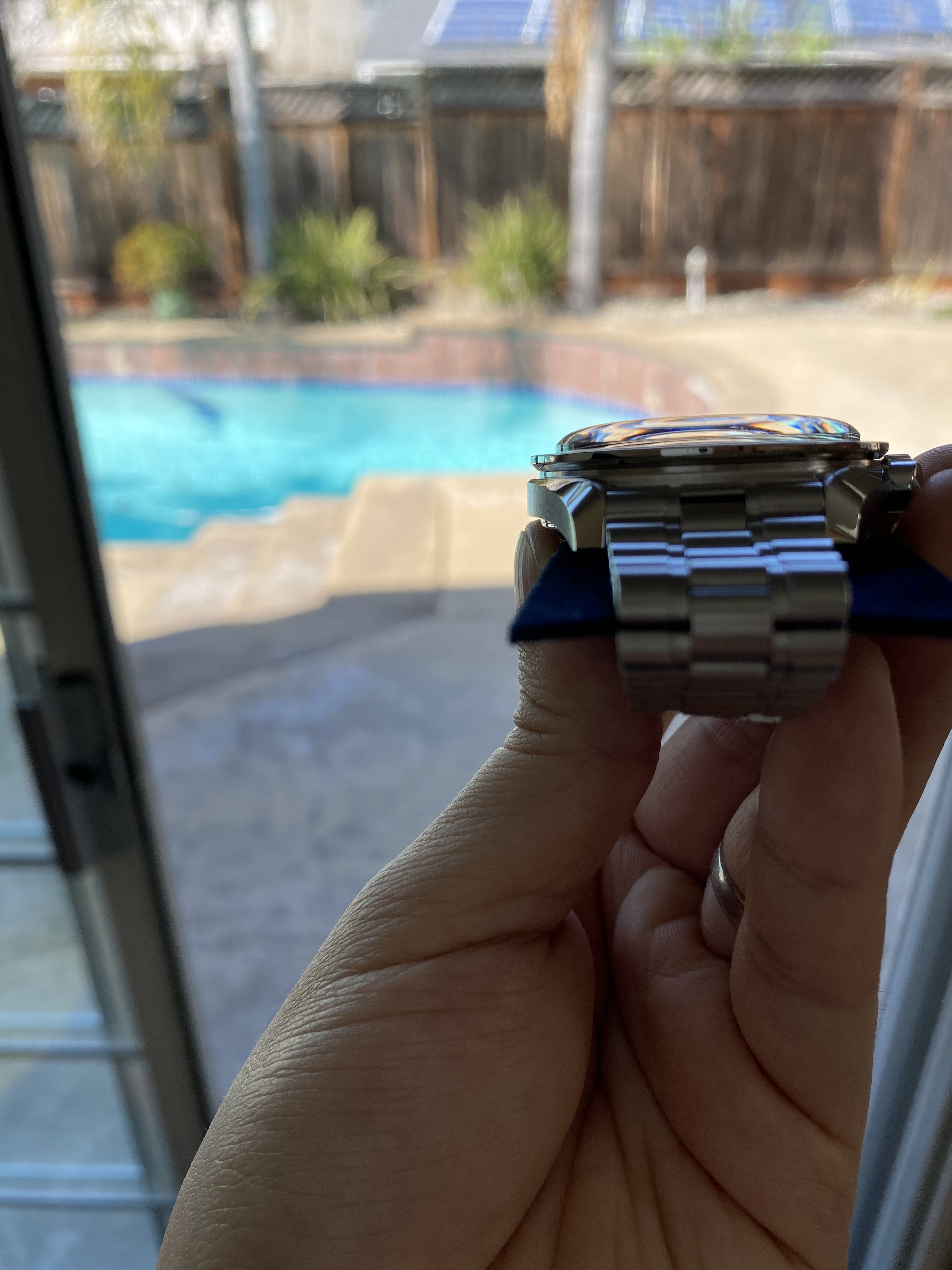

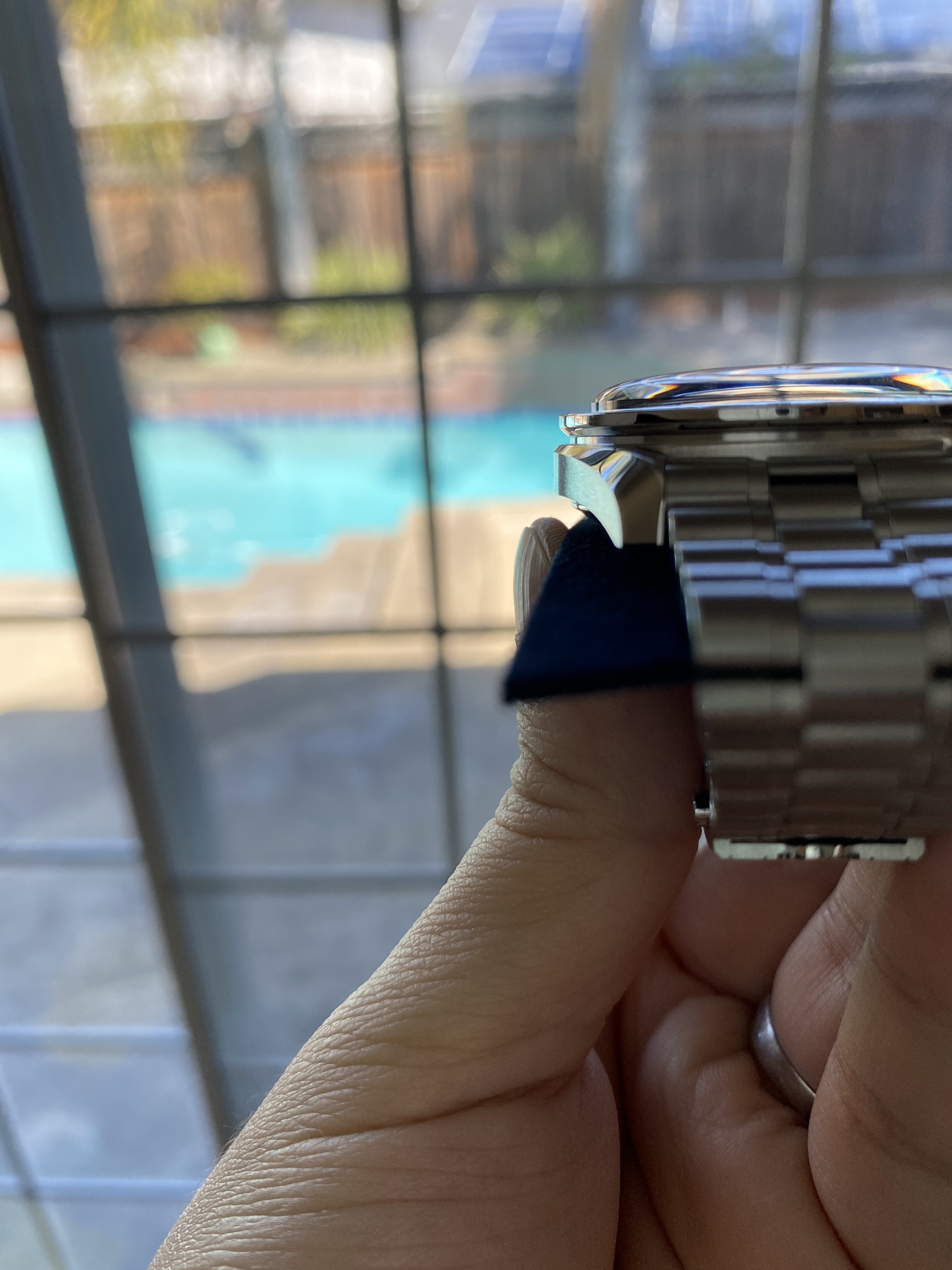

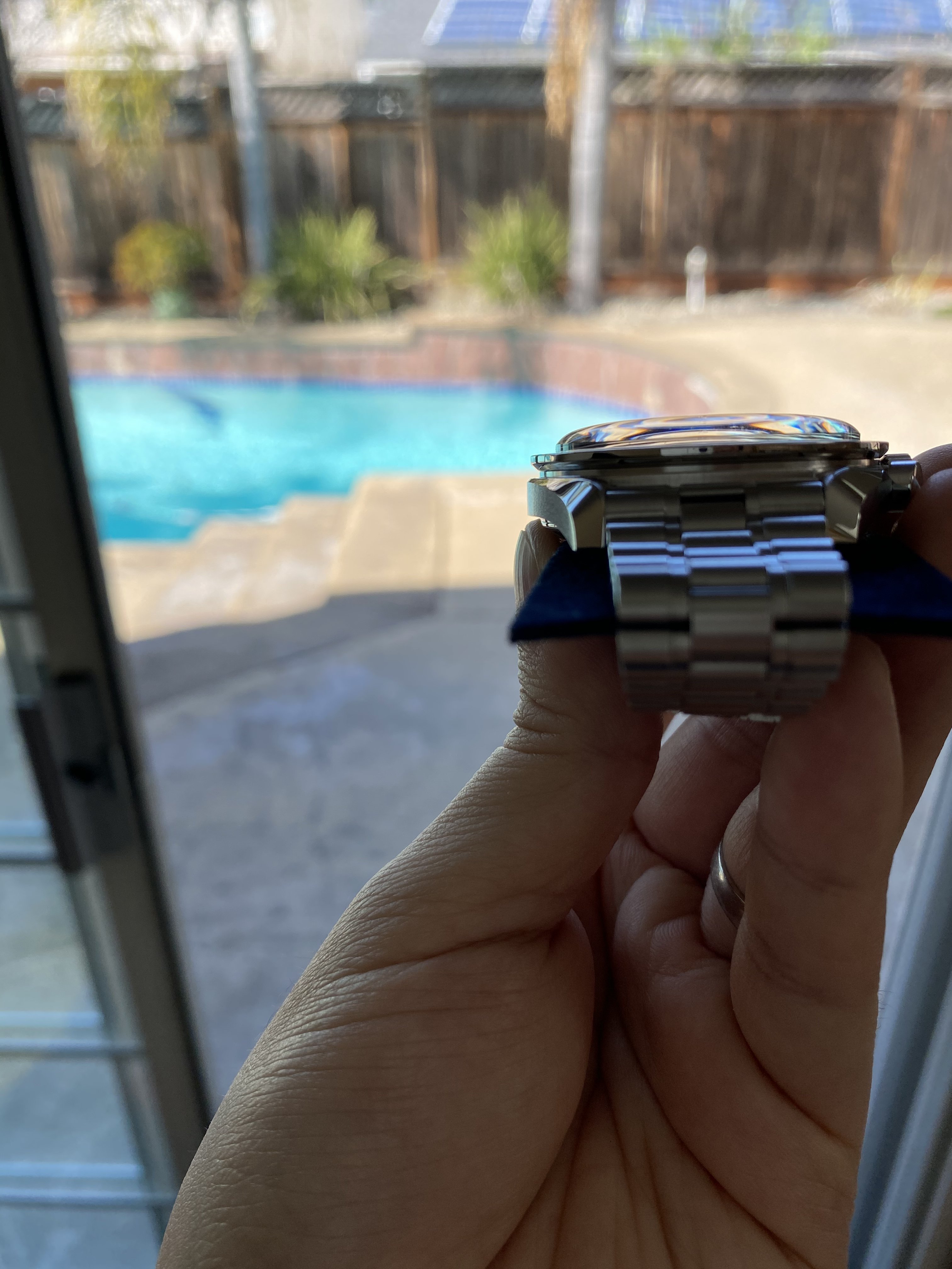

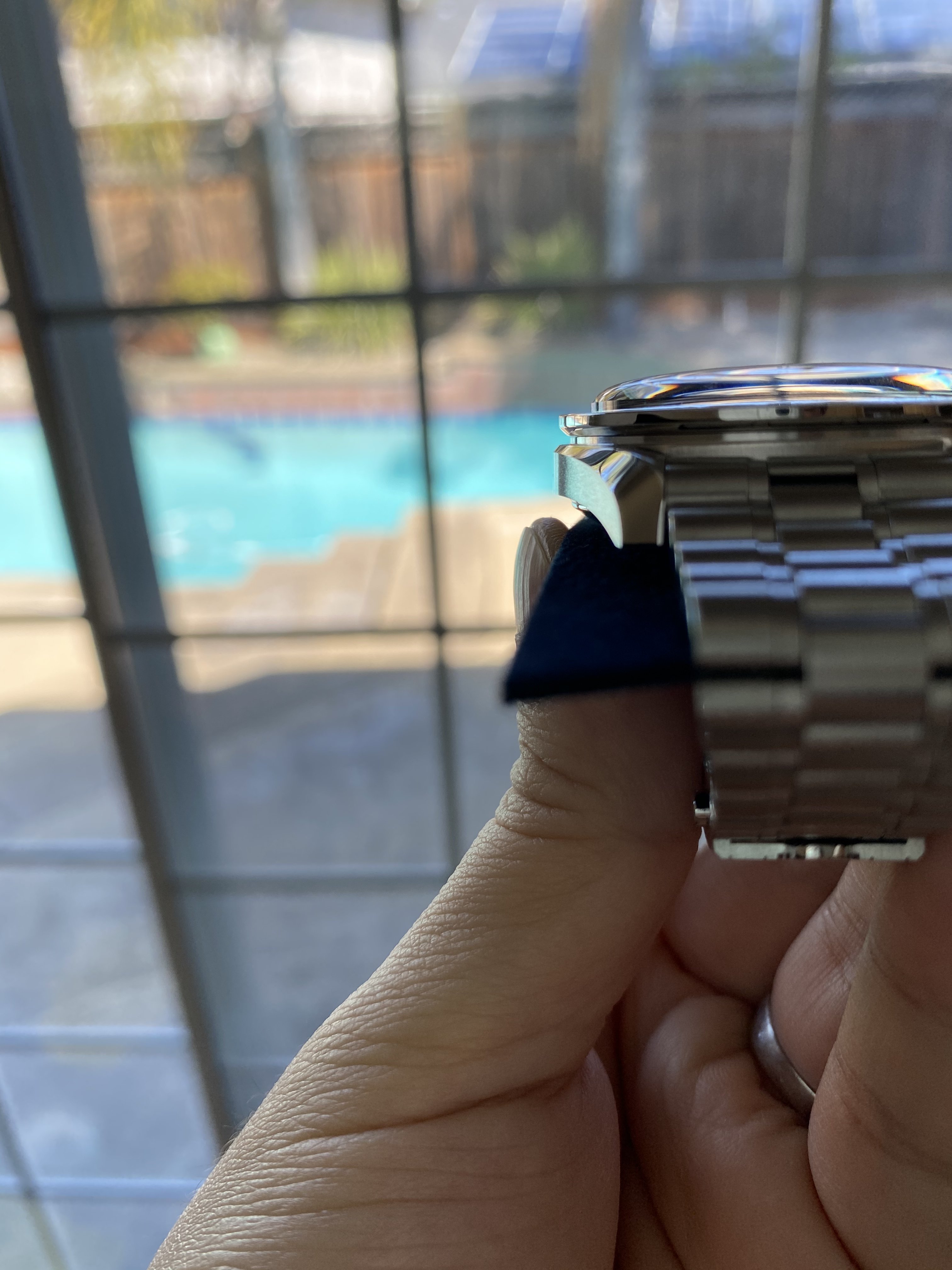

Well, as stated, when I got home with the new 3861 it’s already dark. Need to get similar lighting conditions otherwise there will be comments that says the light is different between day and night 😀 so just to share the comparison with 1863 temporarily.

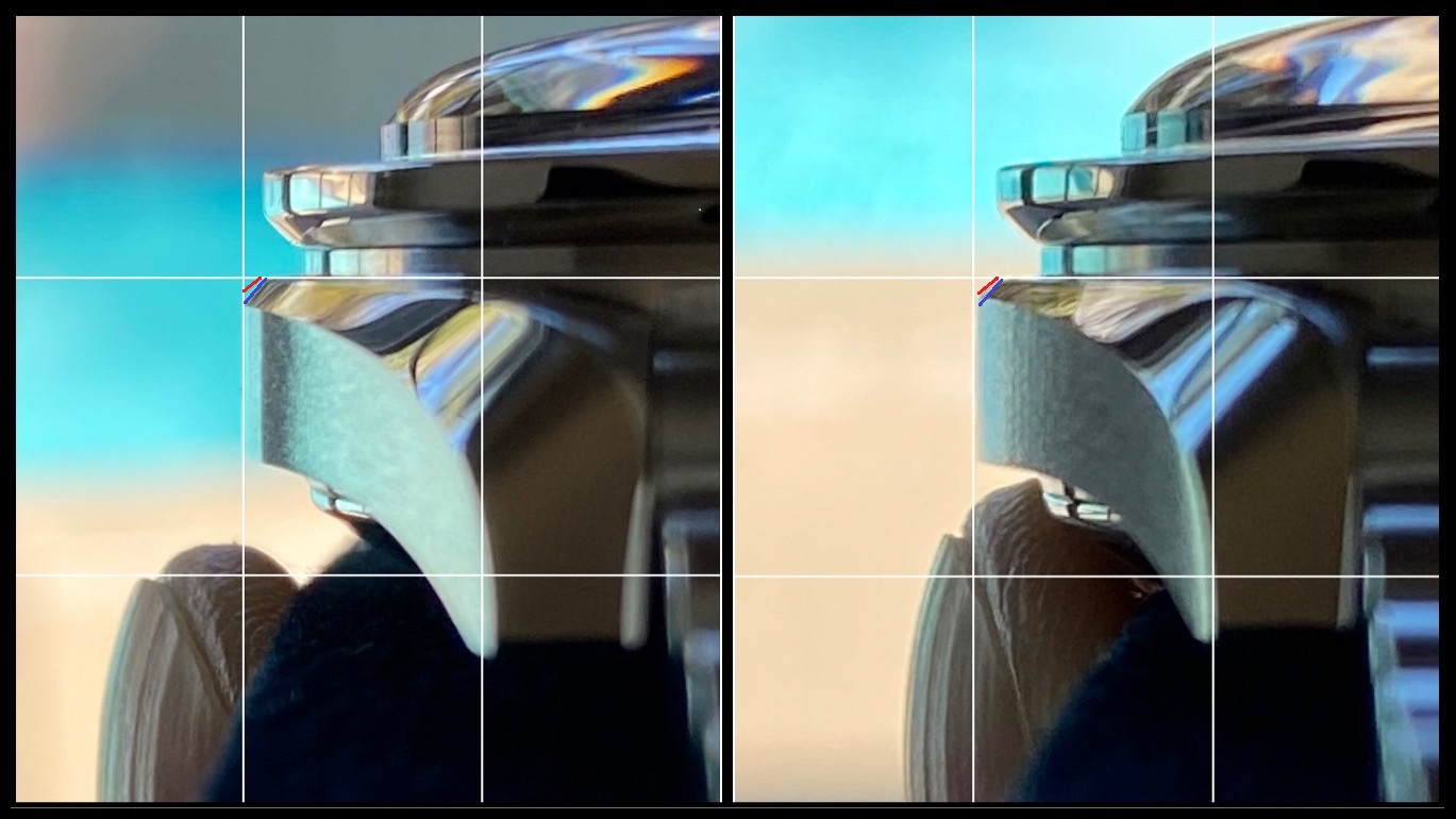

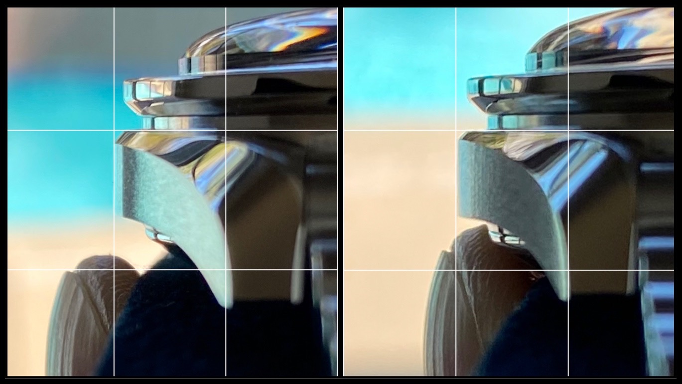

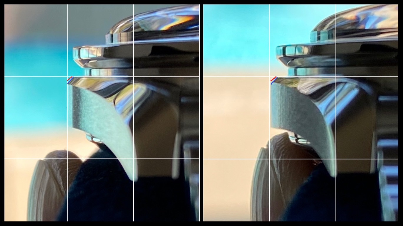

Here they are as requested, two original pictures of 3861N and 3861W (for anyone who has better tools to analyze the pictures), and my processed side by side. I don’t think I need to tell which one is which.

It looks like a difference of a factor 2, with the narrow width about 0.5mm, and the wide 1.0mm. On my Speedmaster co-axial (very different model) the corresponding measurement is about 1.3mm.
0.5mm difference on a 1mm detail is quite significant.

It feels to me, and I'm 90% confident about the difference is there, that the 3861N is sharper than the 3861W. But this is a more subtle difference than the bevel size IMO. Yes the "N" is sharper, but not cutting skins. How it's linked to quality is subjective.

A variance of 0.5mm on a 1mm detail. 3861N may be more roughly finished than the 3861W.

1. If it is prevalent that the "N" version exist, the market should accept this as manufacturing variance rather than the case being polished/refinished. And TBH manufacturing variance is very common in Speedy's history;
2. As I showed in the picture, the overall case size is 42, the 2 versions' sides have the same overall thickness, as they extend the same length out of the bezel edges. That is to say, before the beveling, the 2 cases should start as the same rectangular metal block. From there, the N case actually retains more metal than the W case, as the bevel is shallower. It's probably hard for the N case to be polished in the future because it needs to work on 2 surfaces. But if collector's negative reception associated with polishing is that there's less metal remaining, then this does not apply to the N case, it actually has more metal.

I drew the following to illustrate my point. Red line represent the N case cut of the bevel, blue line represent the W cut. If the W case goes thru a polish, the bevel will become narrower and look like the N case, but the case side thickness will decrease.
