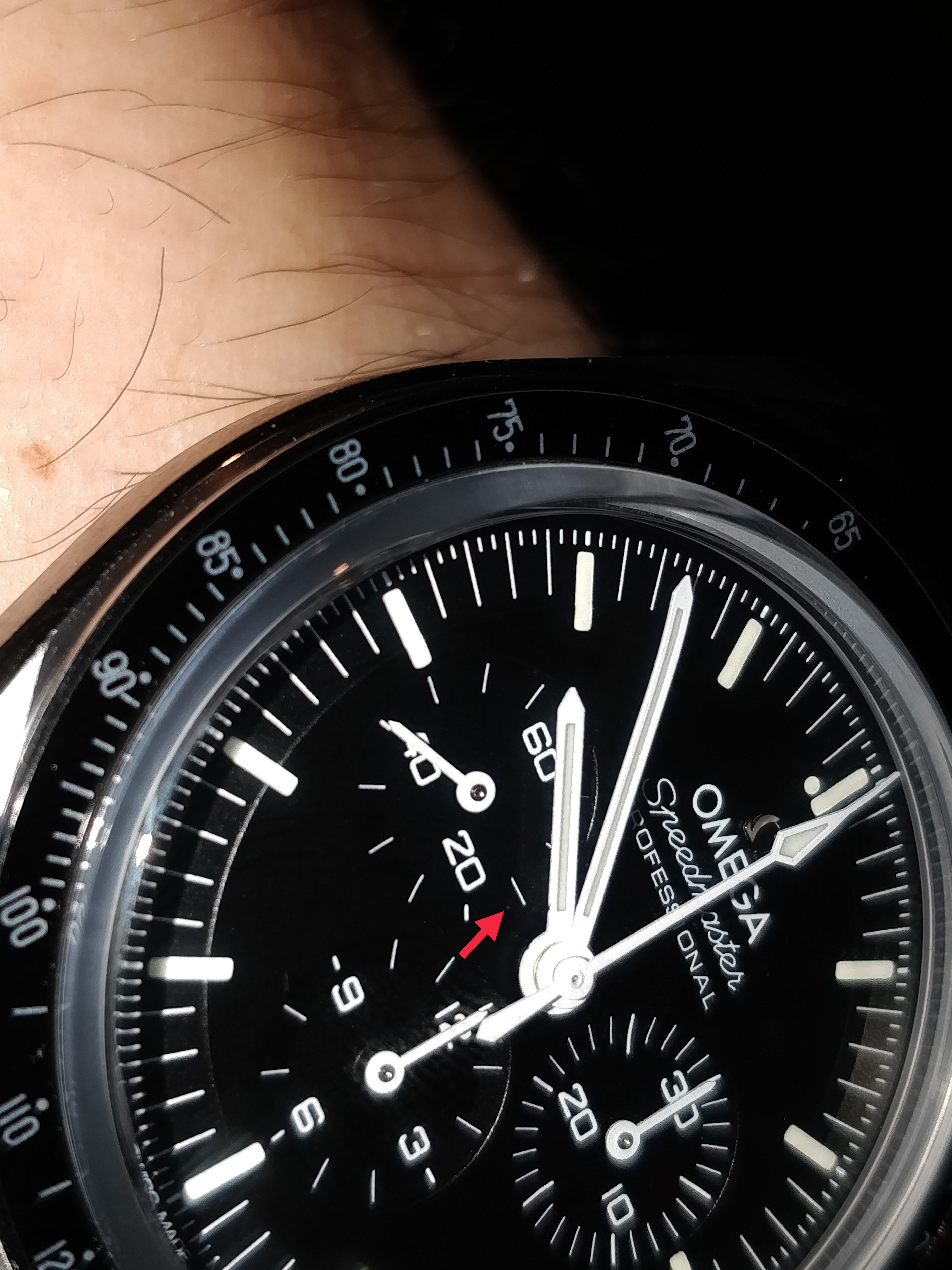

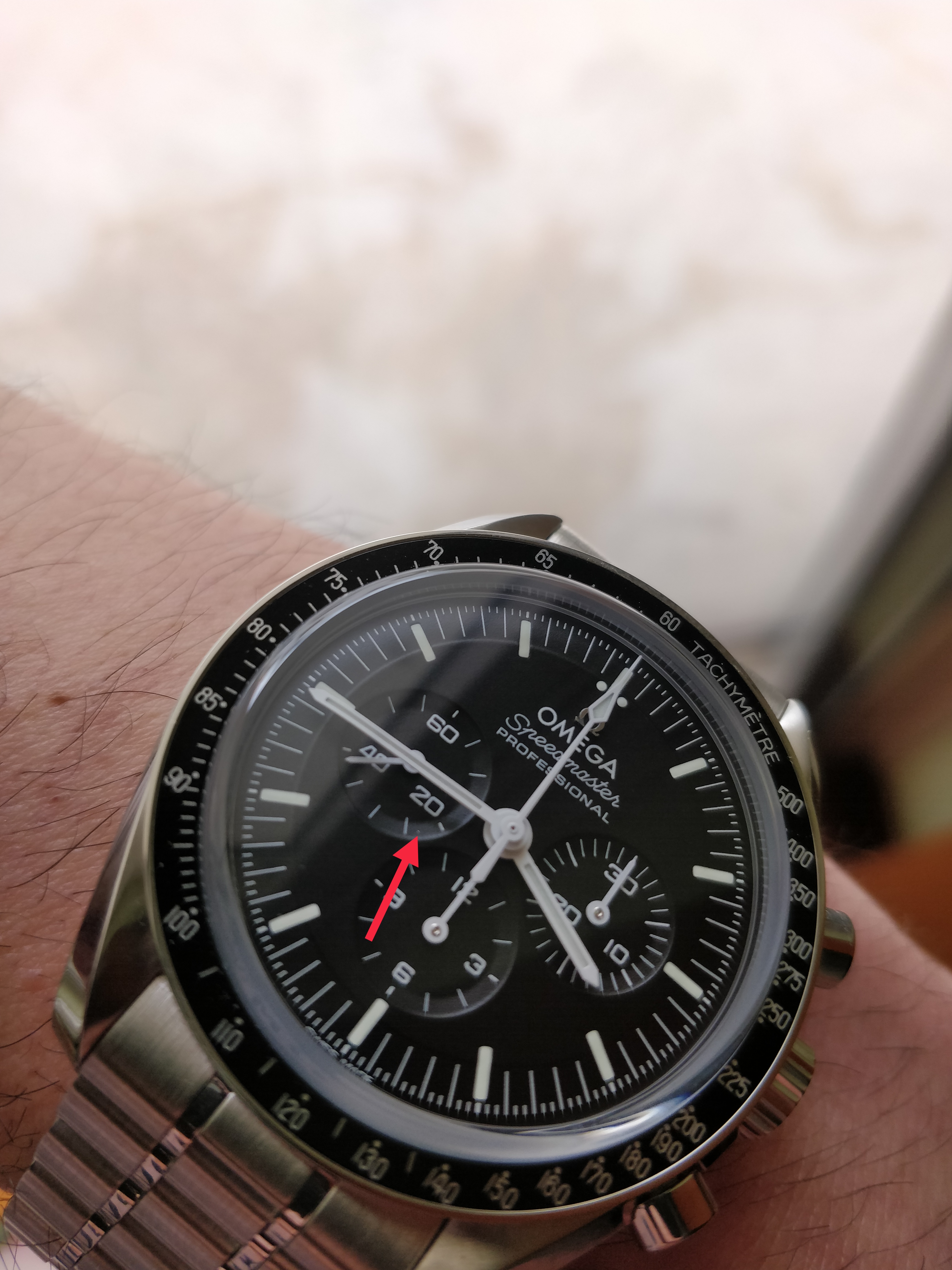

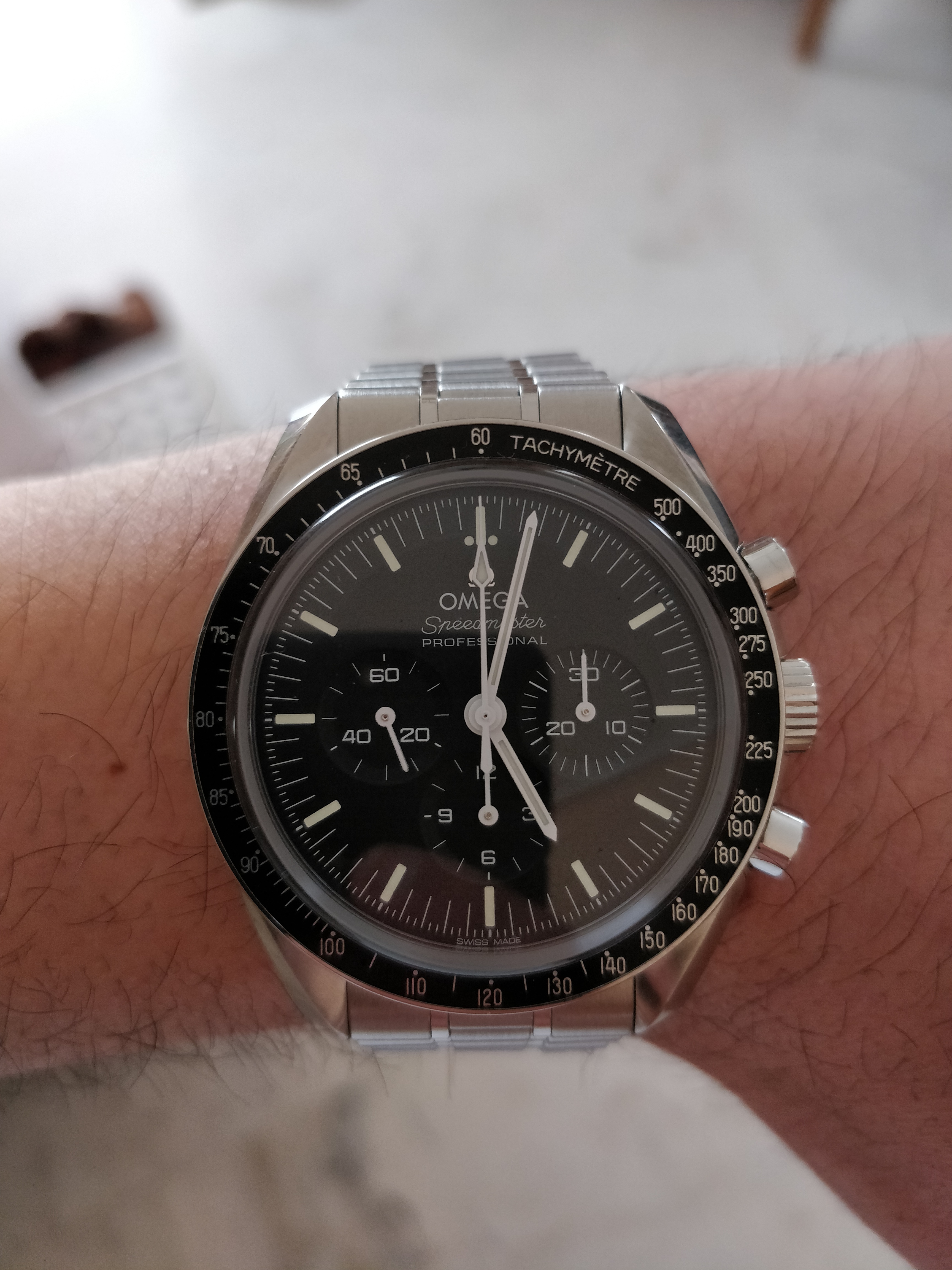

Hello all. Couple of days ago I bought a brand new SS 3861 from an Omega Boutique. Purchasing an Omega has been a long time milestone, really happy to get there and I love the watch. However, there are a few quality control issues which leave a bad taste. Listing them from the most severe to the least severe, in my opinion. These are all visible to the naked eye without lupe or any other magnification.

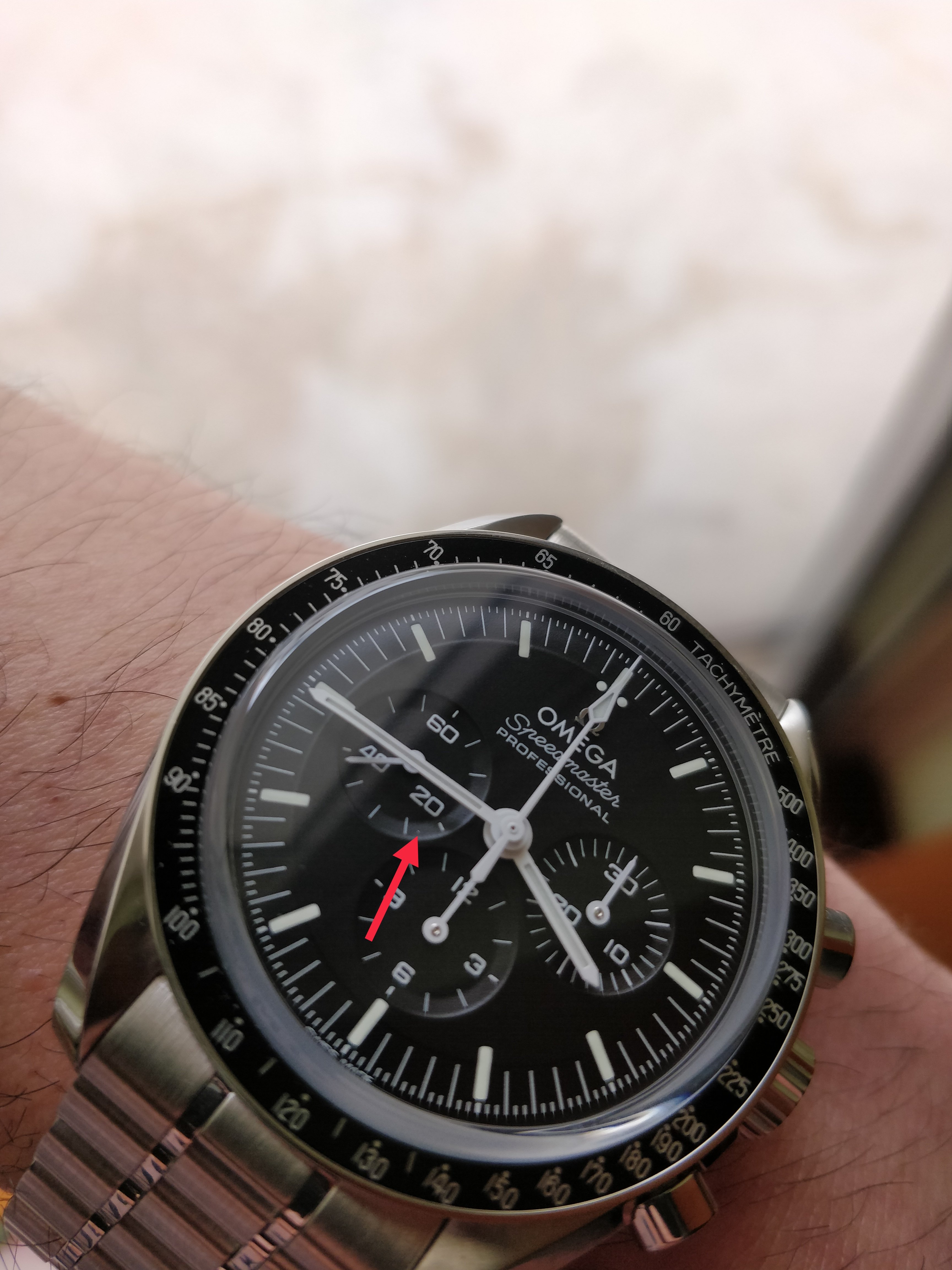

1. Spot of leftover material which shines when hit by light. Could be gold!

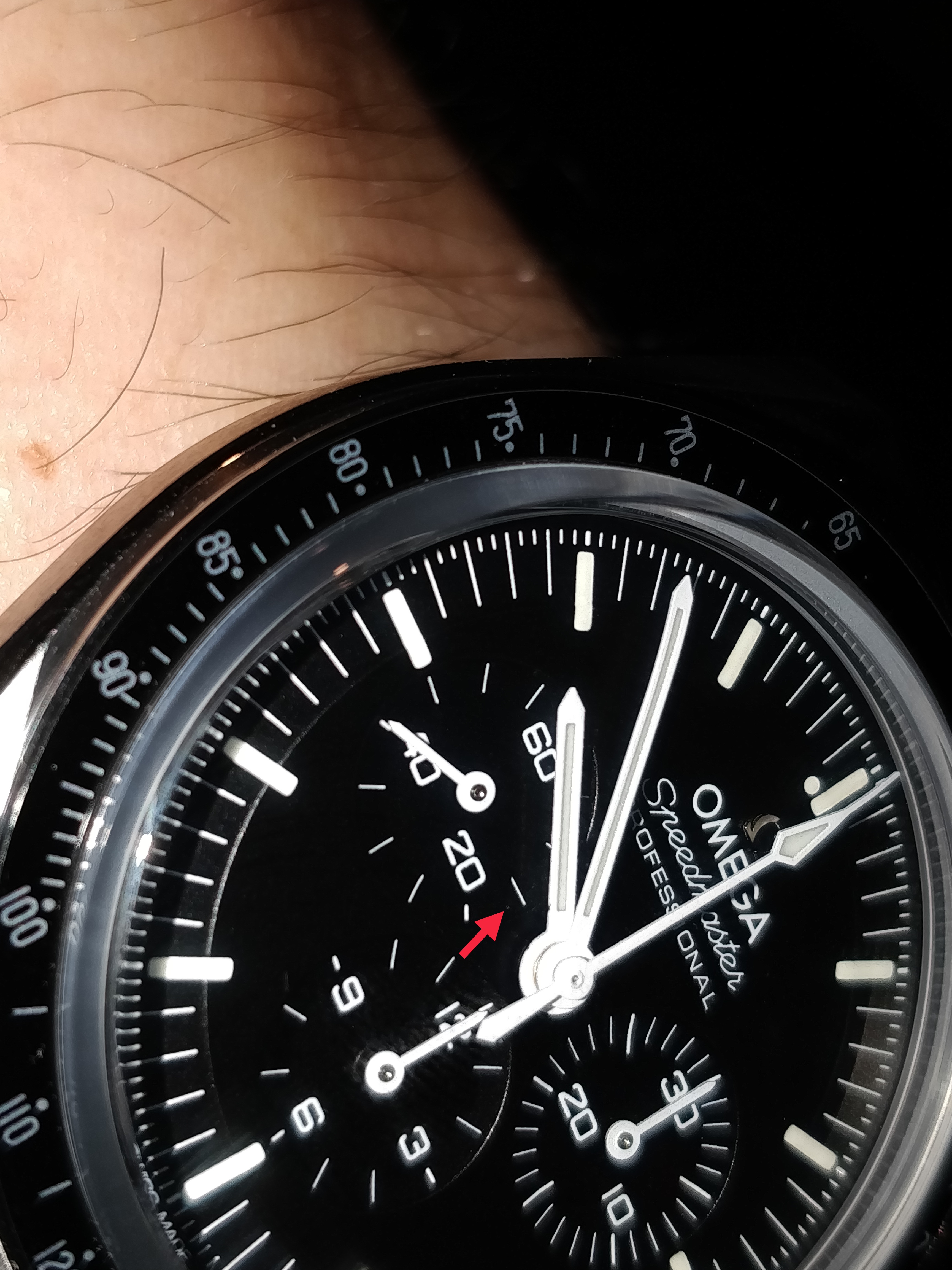

2. Spot of leftover material which doesn't shine under light.

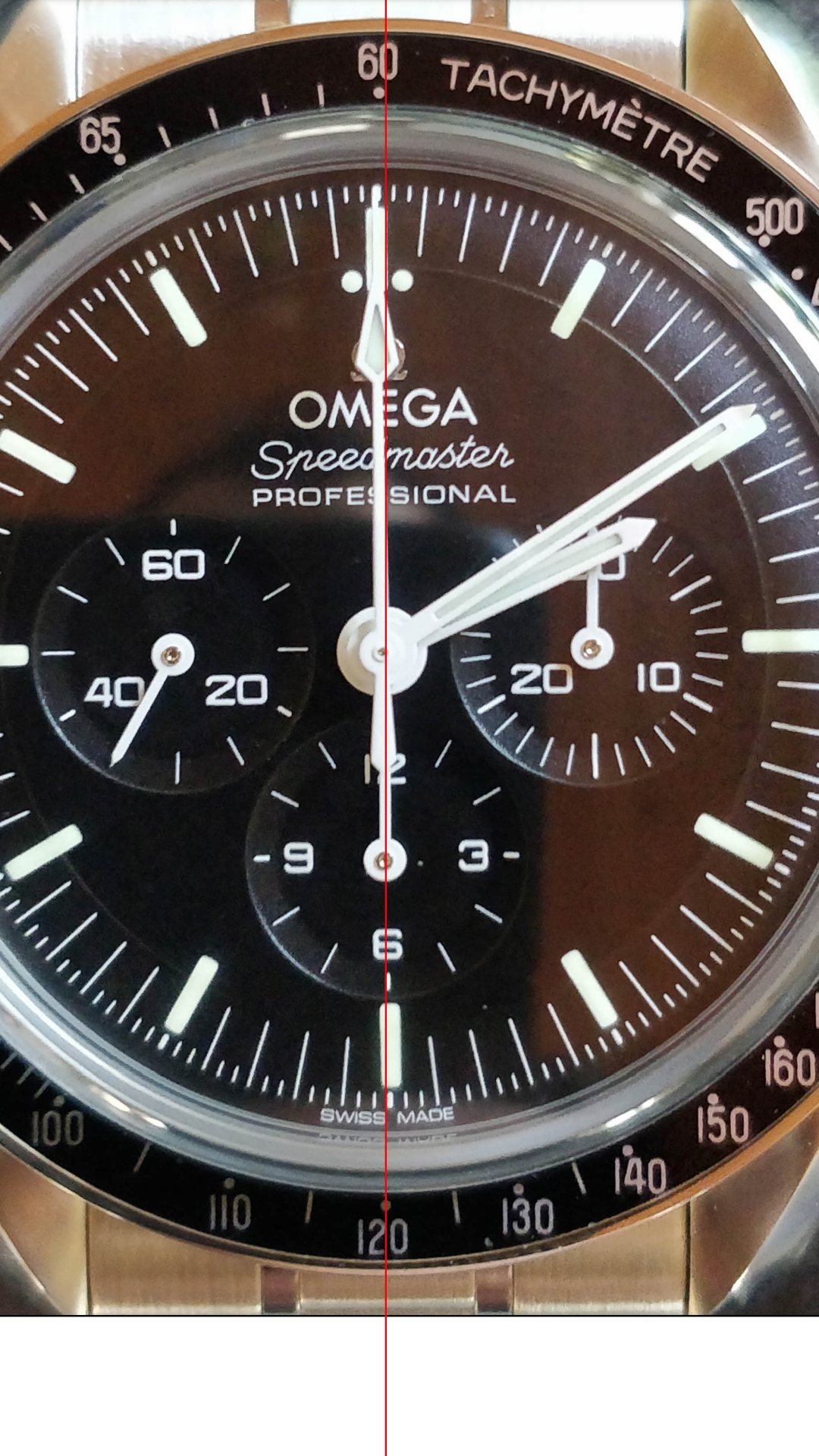

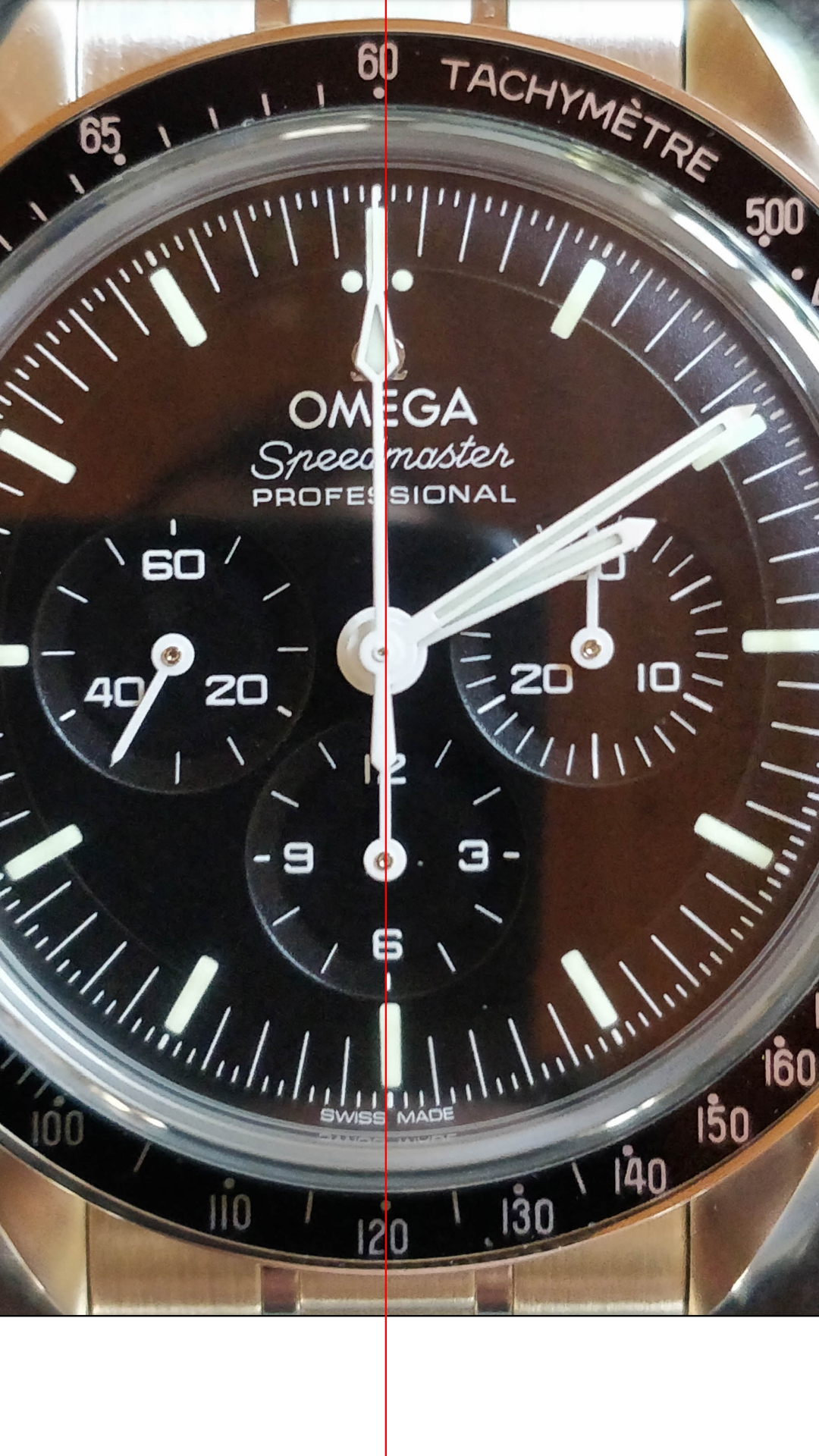

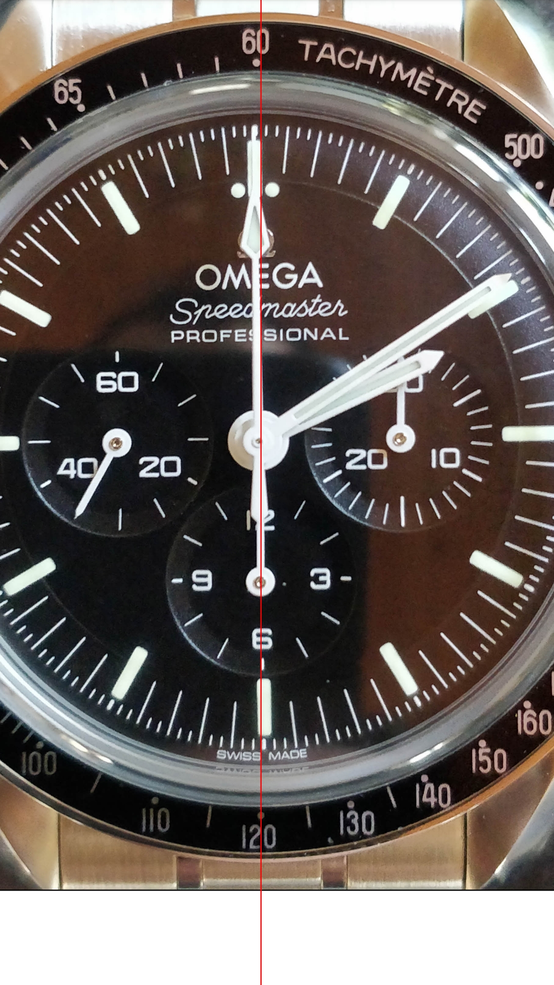

3. Dial isn't centered. Line drawn with CAD.

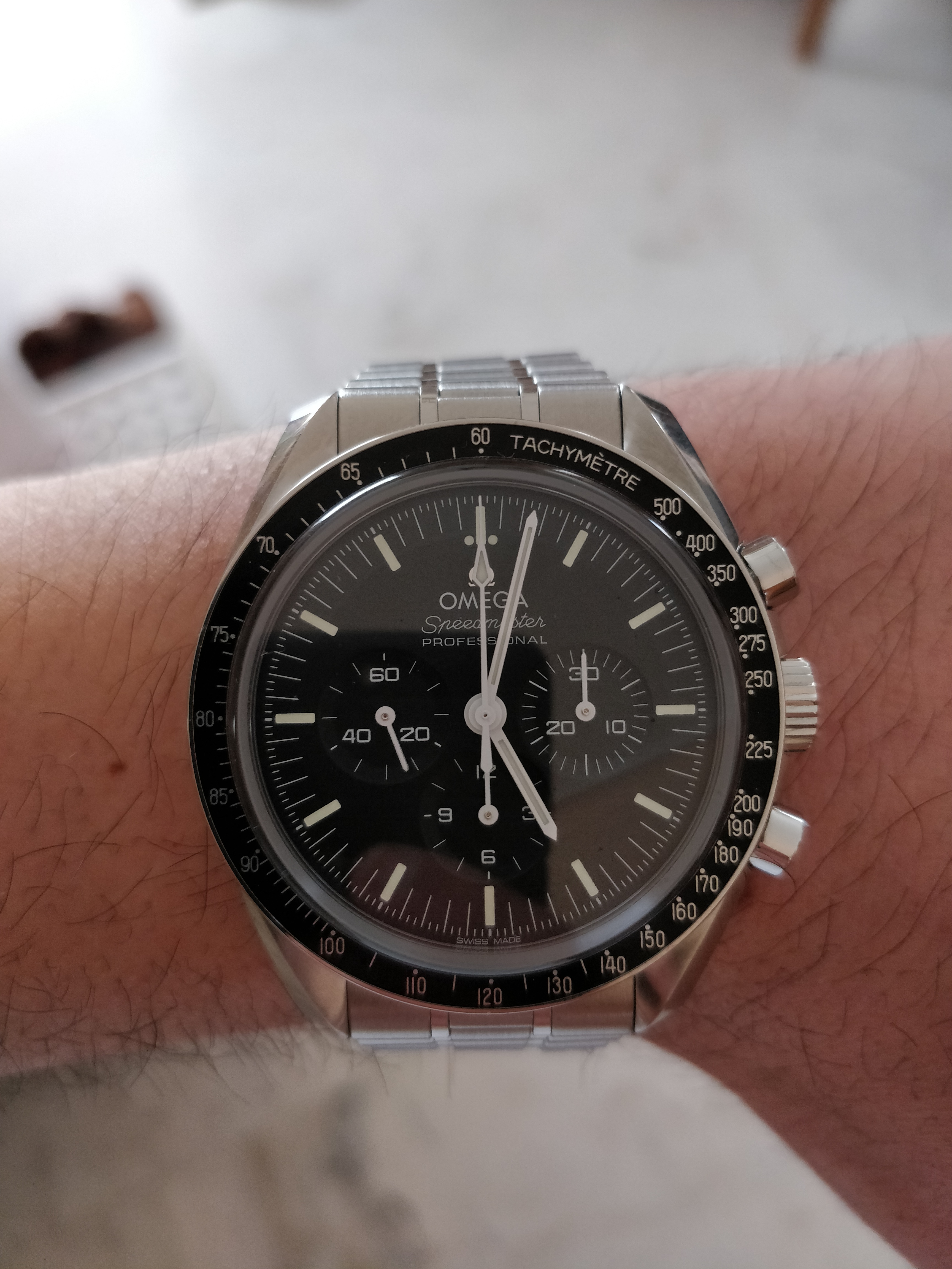

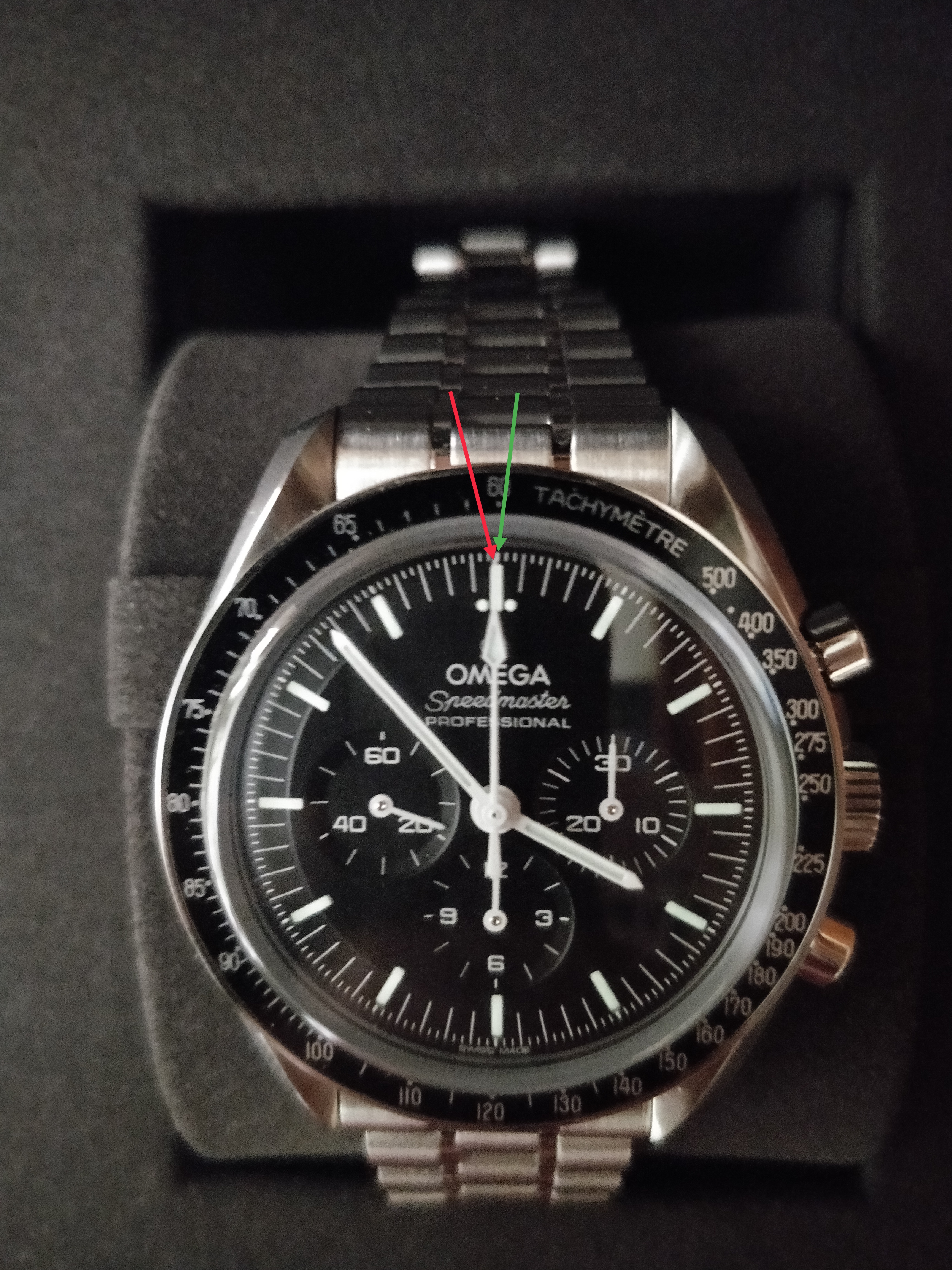

4. Chrono seconds hand isn't aligned with 12 o'clock.
Boutique said they are bringing a new one for me to check and swap if I am happy with it. They had 3 or 4 speedy's in store and all of them displayed misaligned chrono seconds hand.
My thoughts are: This watch is running at +2s/day. This is awesome and I'd be reluctant to swap it for another with worse tolerances, even if properly aligned. If the timekeeping is same or better than what I got, then no questions asked, straight swap assuming all the points above are not present on the new watch. Alternatively, I could bargain for a partial refund due to clear quality control errors, keep it and then sort it under warranty.
Bottom line is: This is not a £50 watch. It costs a small fortune and I'd expect the quality control to be equivalent to the money I'm paying. Pull your fingers out Omega!
Rant over.
Update: the boutique swapped it for a new one. It all aligns perfectly to my naked eye and as far as I can tell, I can't see any specks on the dial. Overall, I'm over the moon with it!! 🥰 Pun intended.
And because you win some and "lose" some, average precision is up to +2.6s/day (from +2s/day) and deviation in six positions is up to +7.2s/day (from +3.5s/day), but these don't bother me at all, it's all minor. Precision at low power reserve is improved, however.
All in all, very happy with the outcome!

As others have mentioned, attaining absolute perfection may be too much to expect. I like the way you have broken your findings into degree of severity. The shiny speck of whatever does seem a bit over the line, and should probably be removed. I purchased a 3861 which had a seconds chrono misalignment issue as well -- it was about one full watch beat off, which I judged as being excessive (I own 6 other chronographs, none of which have this degree of misalignment, though some are not perfectly aligned). So that watch is in for warranty service. From what I see in your photos, I don't think the chrono hand misalignment is excessive. And trying to line up those three points using cad on a photograph, there are just too many possibilities for the presence of optical artifacts and/or distortions to trust that particular finding.
I’m having a hard time accepting that photo as proof the dial is off center. The position and orientation of the watch isn’t perfectly square/level, both horizontally and vertically, to the sensor plane in the camera. There is a generous amount of distortion in your image.
One thing to remember is these are mass produced accessories/jewelry. As said above, expecting perfection will set you up for disappointment. Like other brands, Omega offers a warranty for a reason- things happen.

It's all visible to the naked eye. CAD was used for ease.

If the dial isn't centered it should also be visible when you draw a line immediately from 60 to 120 on the bezel, or if you draw a line immediately through the center seconds marker over 12:00 to the center seconds 6:00 on the dial itself
I think I see what you are talking about but I would want to see some different perspectives on this. Are the 60 and the 120 supposed to be immediately over 12/6, or are they normally some fraction of an inch off?
Here's what I don't get... if your CAD expertise is conclusive why is your line centered nearly perfectly over the 120 on tachymeter but off center on the post for the handset and then even more off centered to the right of the 60 on the tachymeter?
If your CAD is conclusive it would mean the tachymeter insert is perfectly circular yet the printing on it is off center and the dial -and- movement are off center... leading my decidedly non-CAD brain to conclude that either:
A) Your skills in concluding all this are flawed ~ ie: your photograph is angled (or the watch was during the shooting of the photograph) and thusly a perfectly straight line is a false positive.
or
B) The case itself is flawed ~ as the insert itself along with dial and movement are all in alignment but the case is crooked. And even more so, the case becomes crooked only once past the hand's centerpost (when looking from bottom to top). Again, not possible I would say.

The "dial isn't centered" claim and analysis is total BS. But in any case, all of these things are well within spec. "Quality control" doesn't mean perfection.

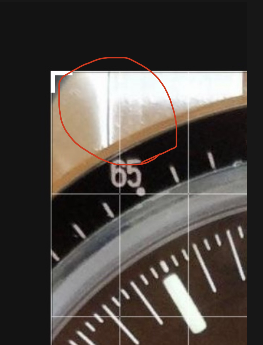

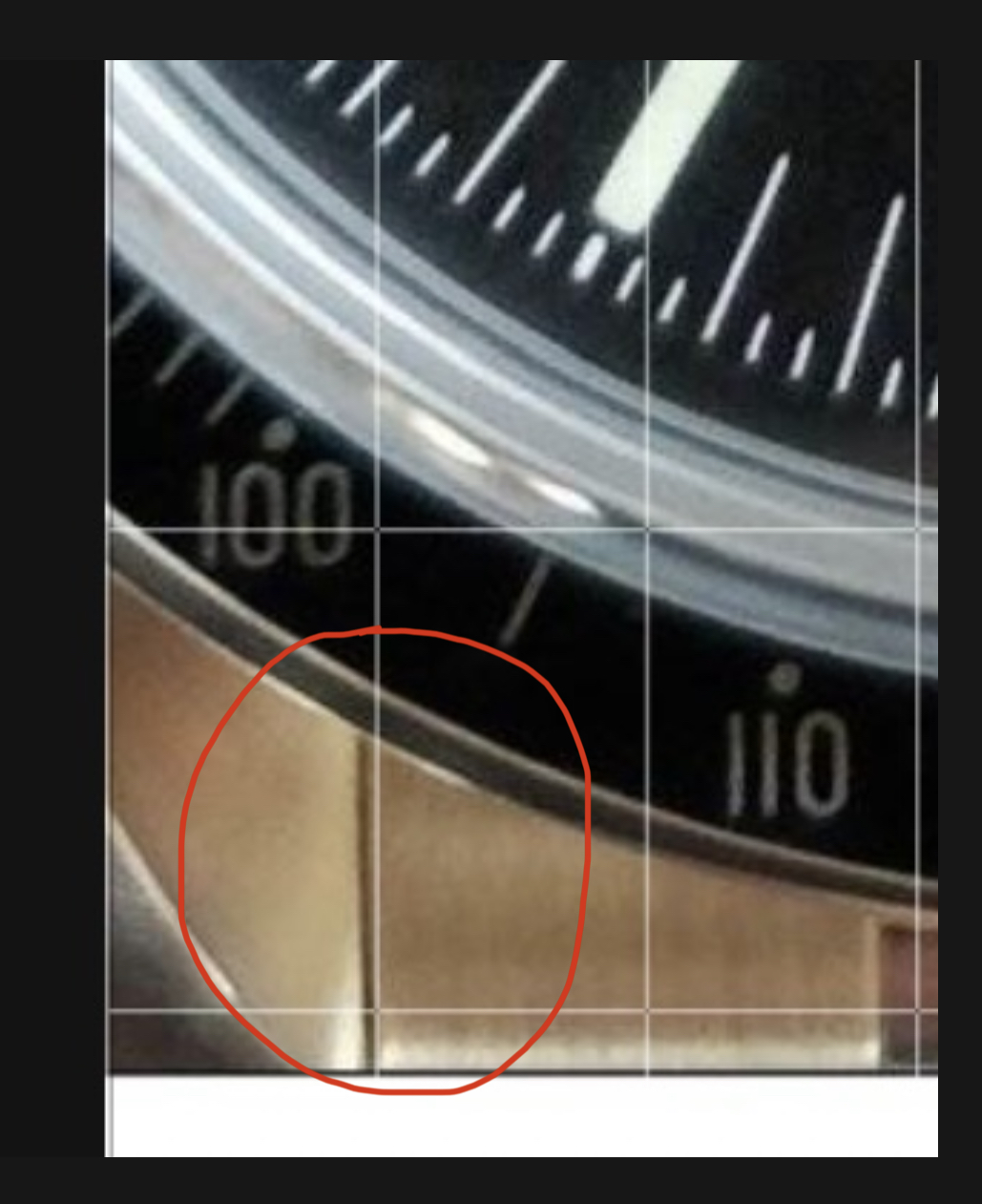

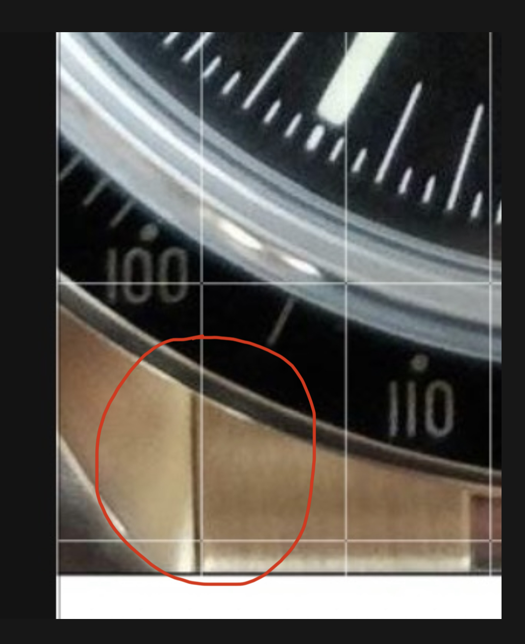

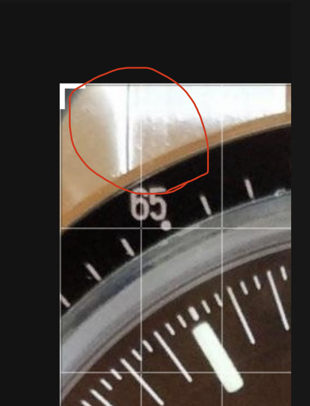

My point above is that your vertical line isn’t going to be an effective evaluation if the photo wasn’t taken properly to begin with. There are many variables as to why your example is flawed but this is the easiest to show you- Your watch isn’t perfectly vertical in your photo. Saving your photo and leaving it as is, I overlayed a grid onto it. Using the lugs as physically straight lines, you can see the lug/case line travels away from the grid line. IE your watch is rotated. The first image is the 12p’clock lug and the second image is the 6o’clock lug. Which follows why your line doesn’t dissect the 12 and 6 markers.

I would kindly disagree, it's not BS. It's visible to the naked eye. To reinforce this, when the time is set at 6 o'clock , the hour marker is slightly to the left of the 30min lume mark. Which further shows that the dial is slightly rotated counter-clockwise.
In any case, I'm more bothered by leftover material on the dial of a luxury watch, rather than the alignment issues.
