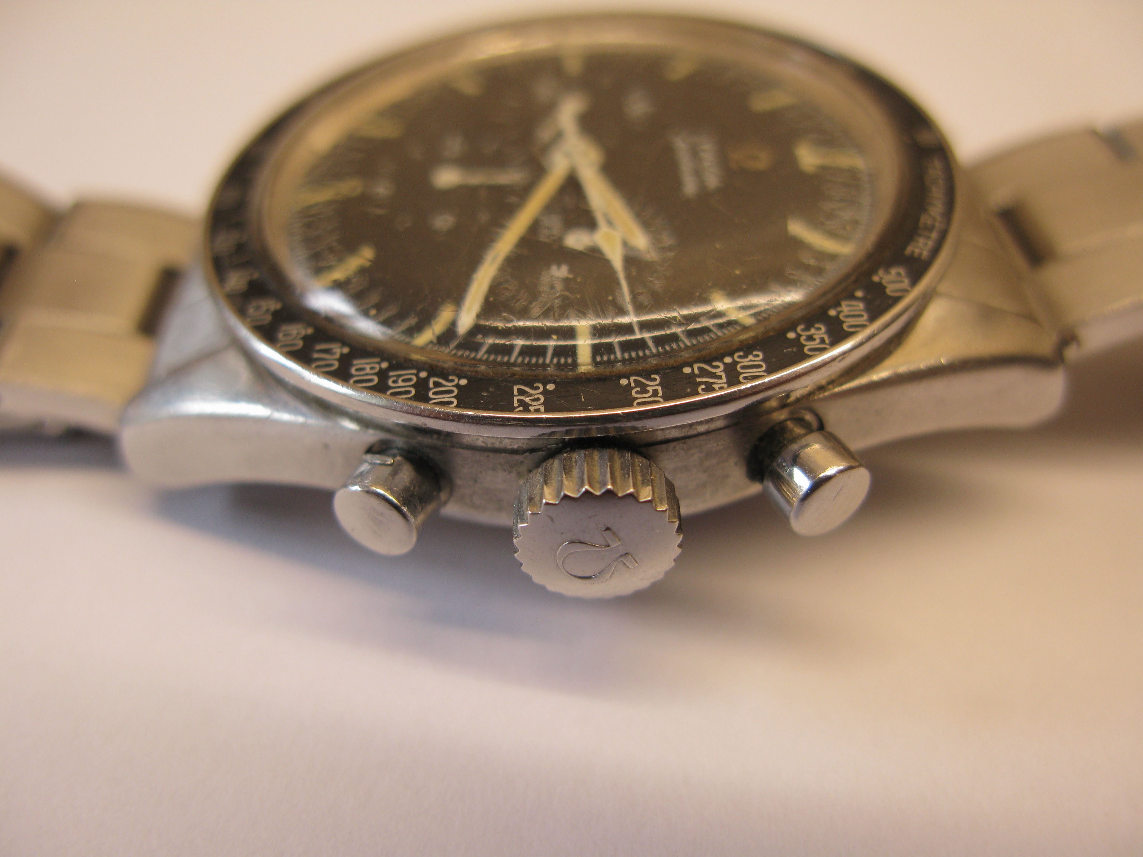

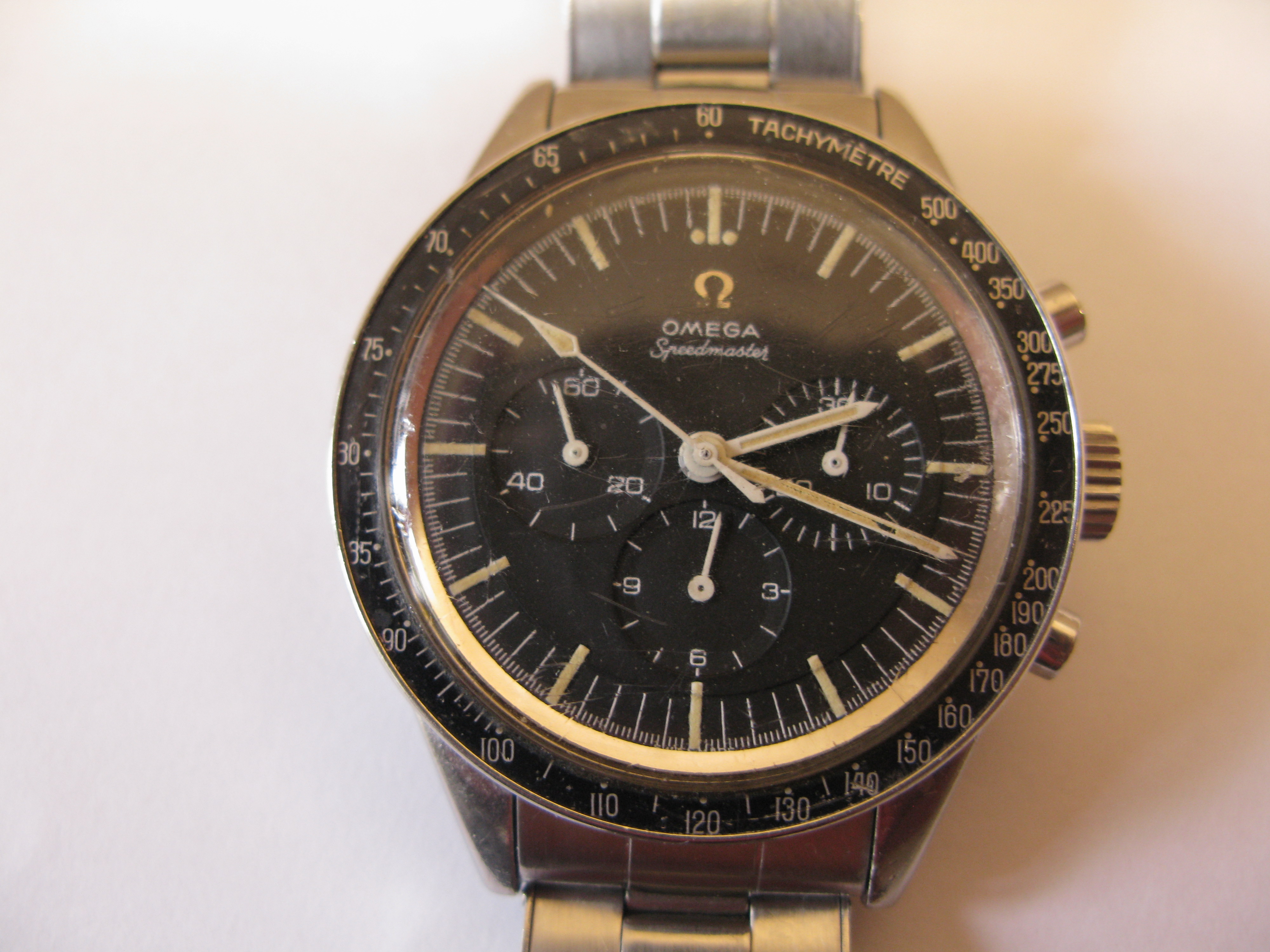

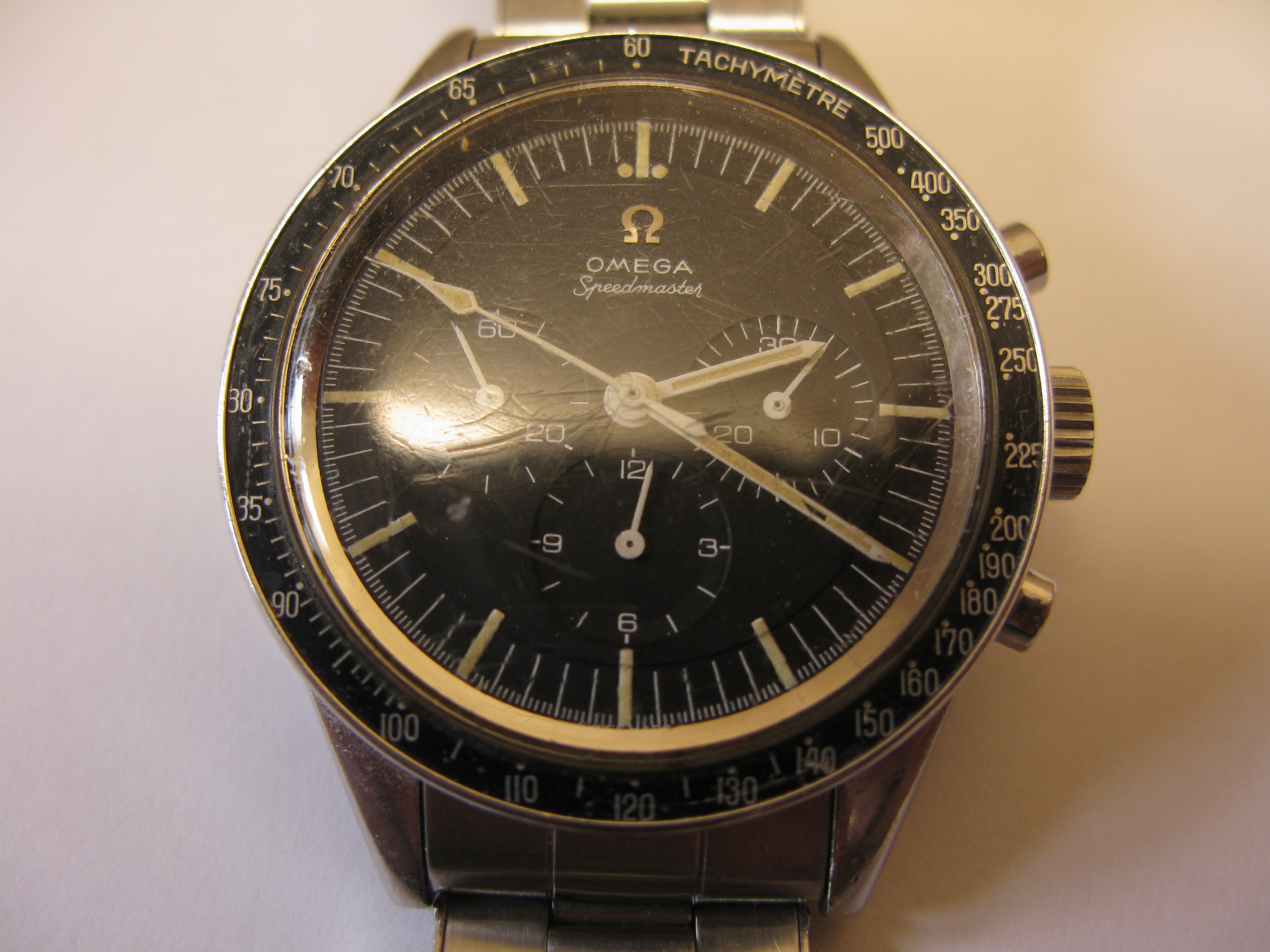

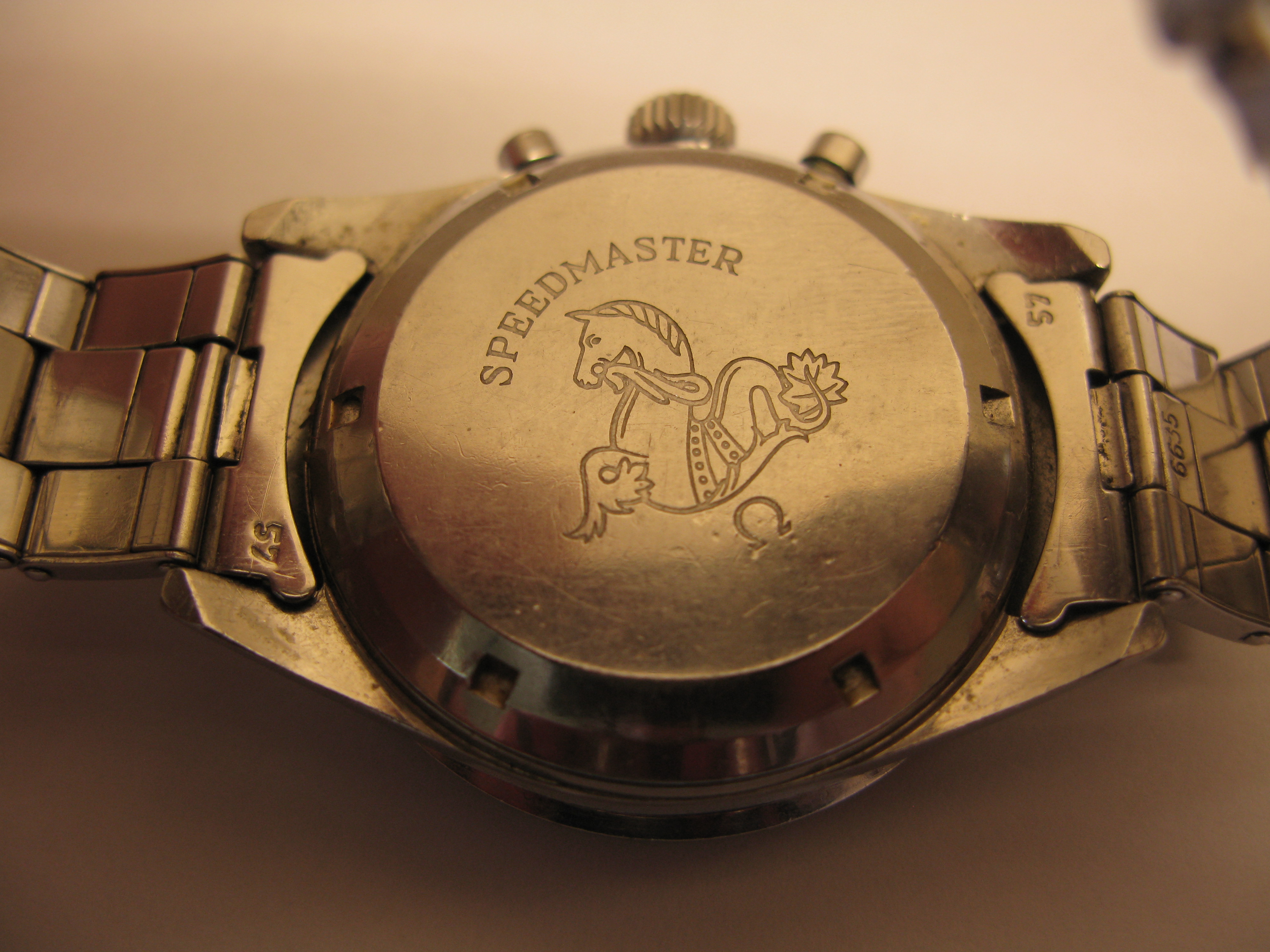

My father-in-law has come across what we think is a Omega Speedmaster watch, which has been in long term storage. He bought it over yesterday and I took a few photos which I hope will give a better idea. The watch was working fine, but has has scratches on the glass, and the bracelet is a ladies Rolex (it was worn by mother mother-in-law occasionally). Box / paperwork sadly long gone.

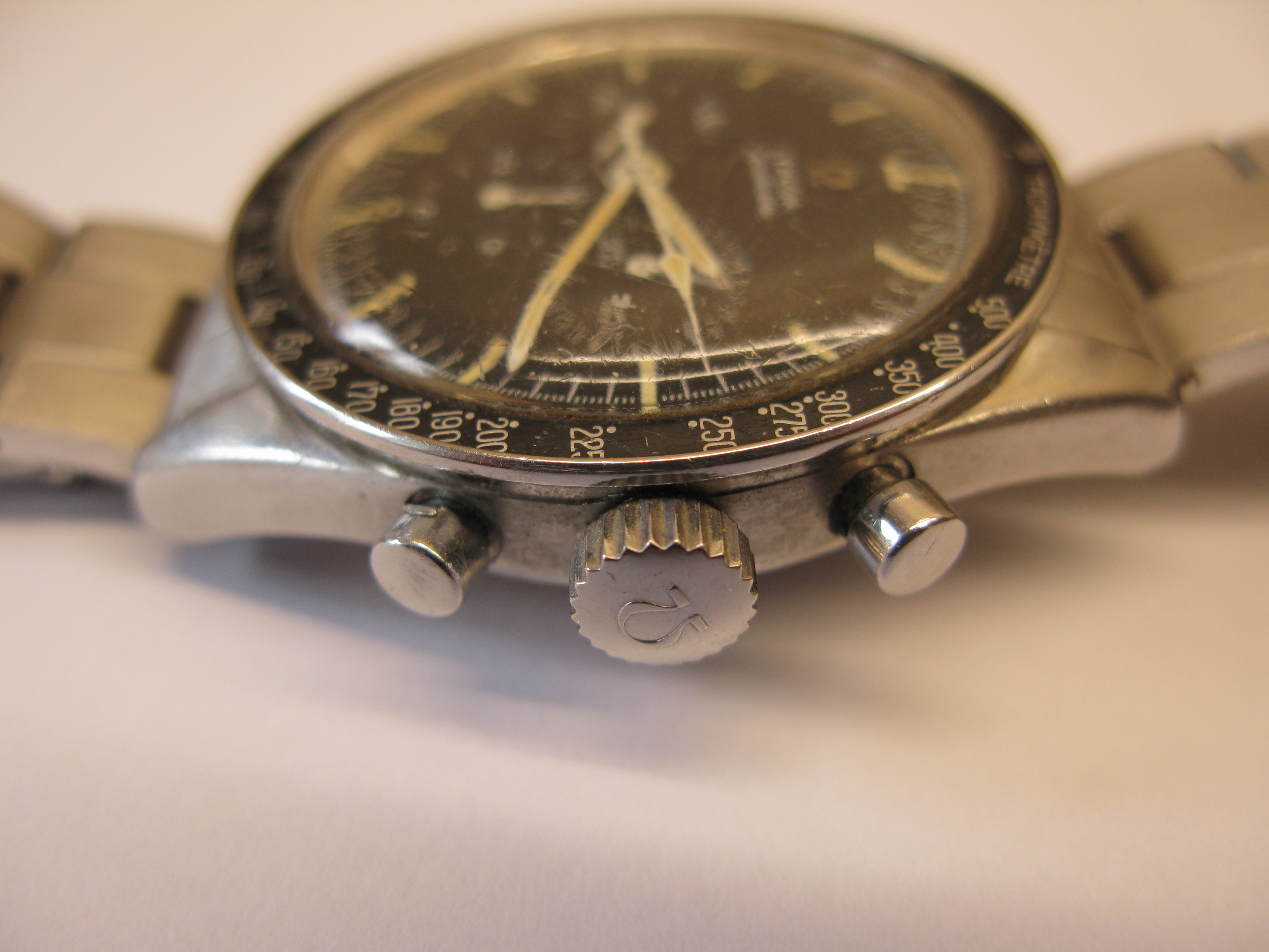

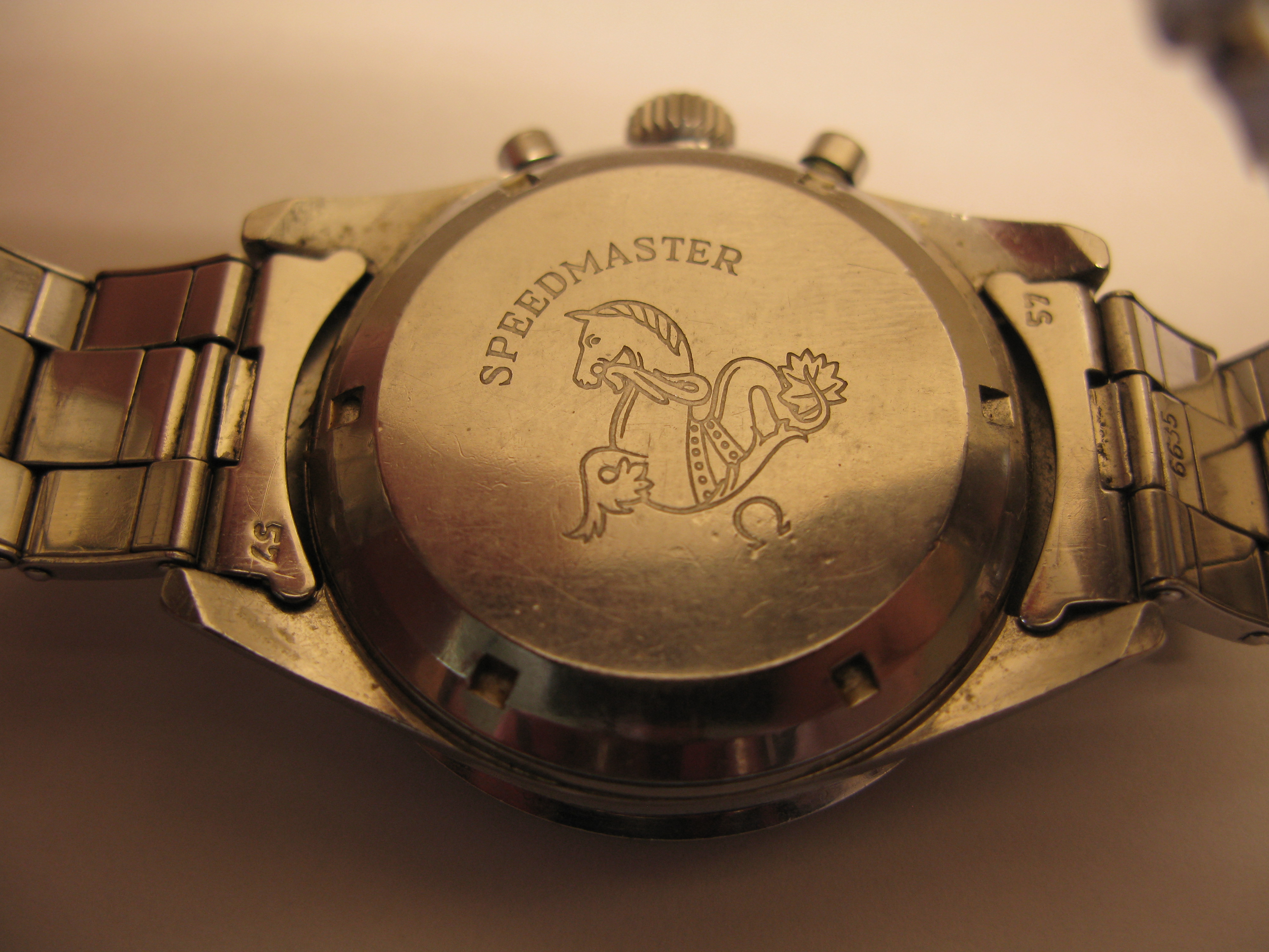

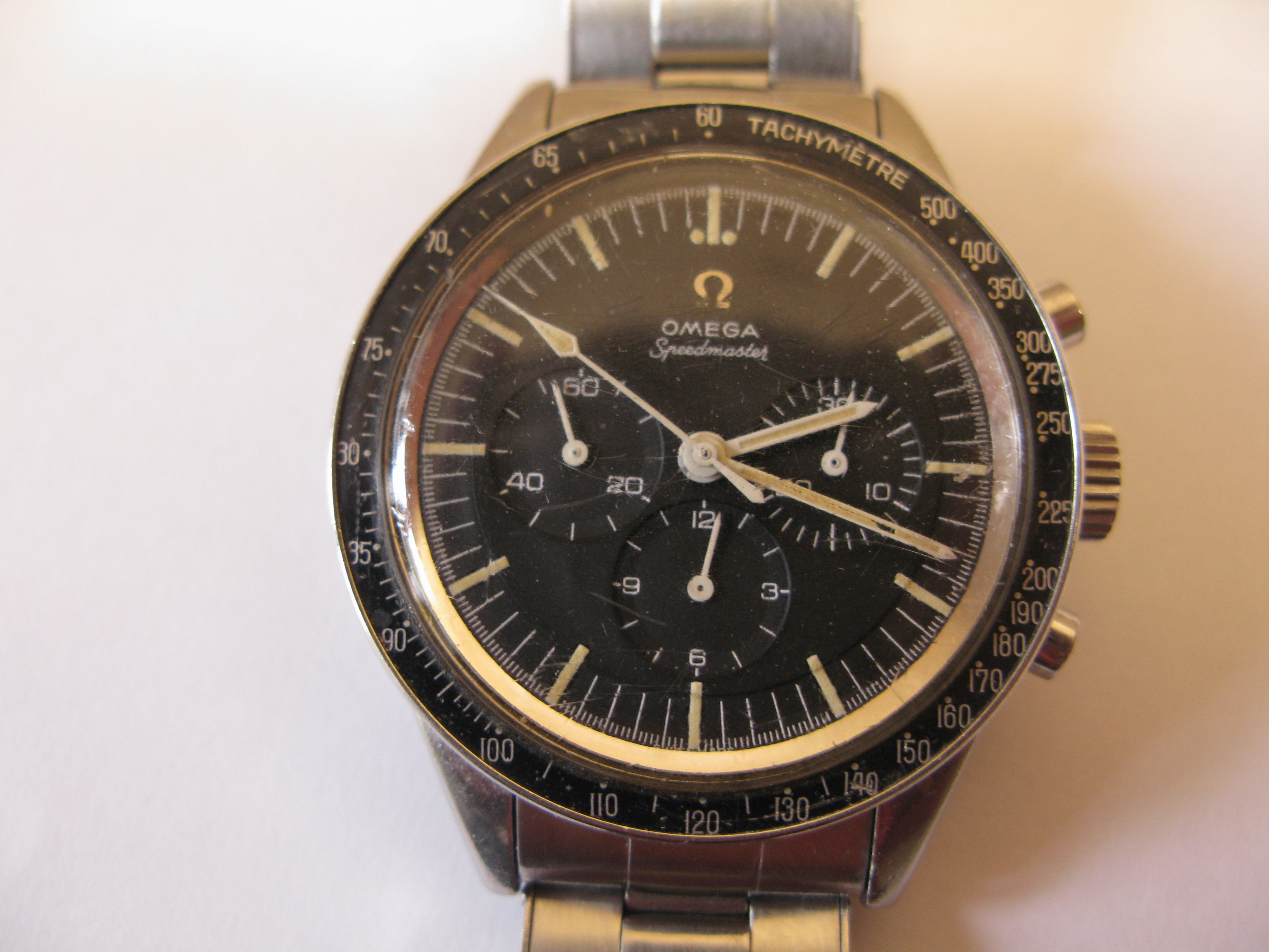

Looks like a late 2998 or more likely 105.002-62 with stick hands which may or may not have been changed at service. The 105 did come with those originally so that is my best guess at the model, the 2998 used polished hands so if it is earlier, it has had parts changed. On a Rolex bracelet I see, also valuable maybe but to a different crowd.
Looks like a very nice example with considerable value, think 5 figures GBP

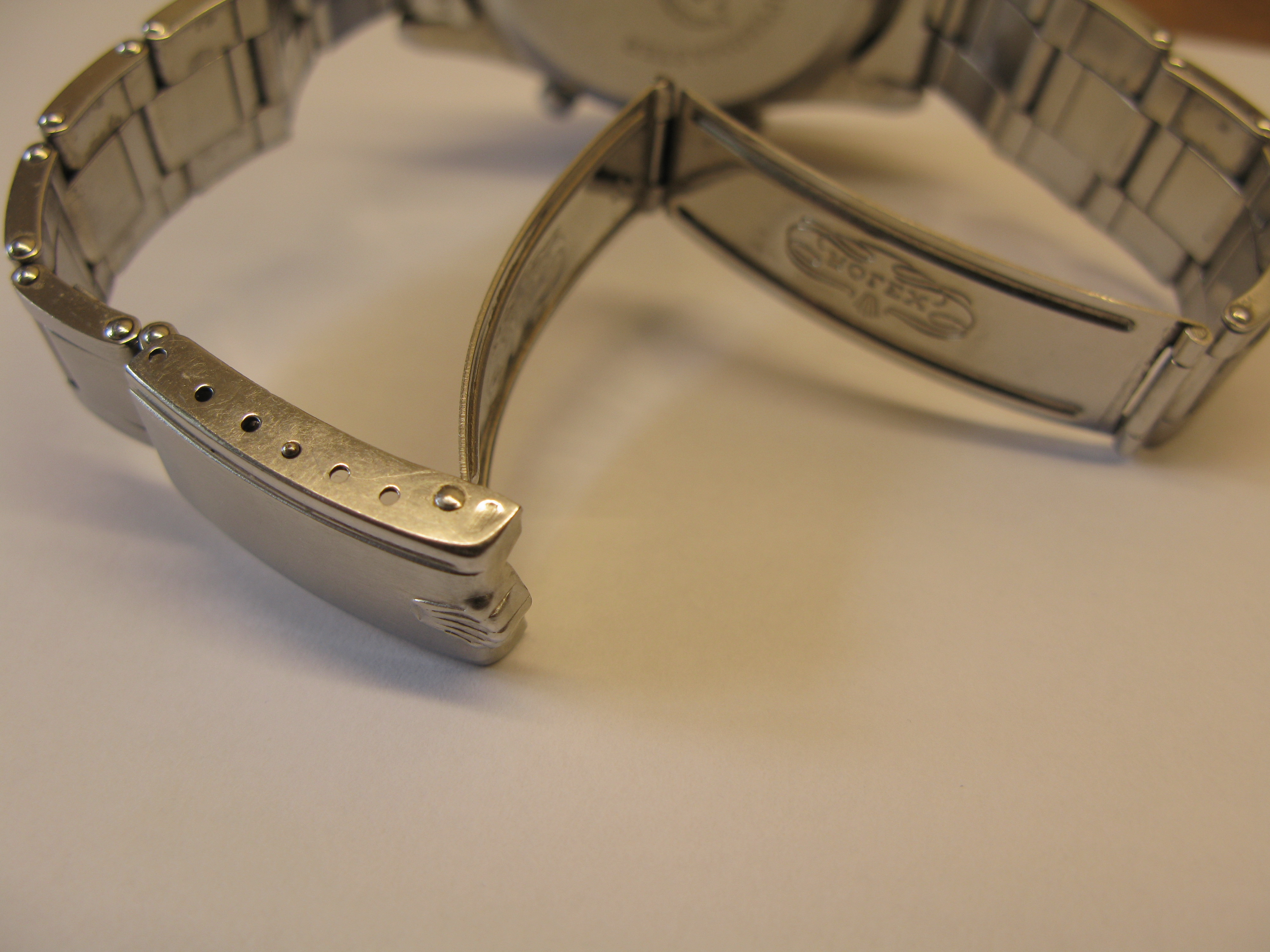

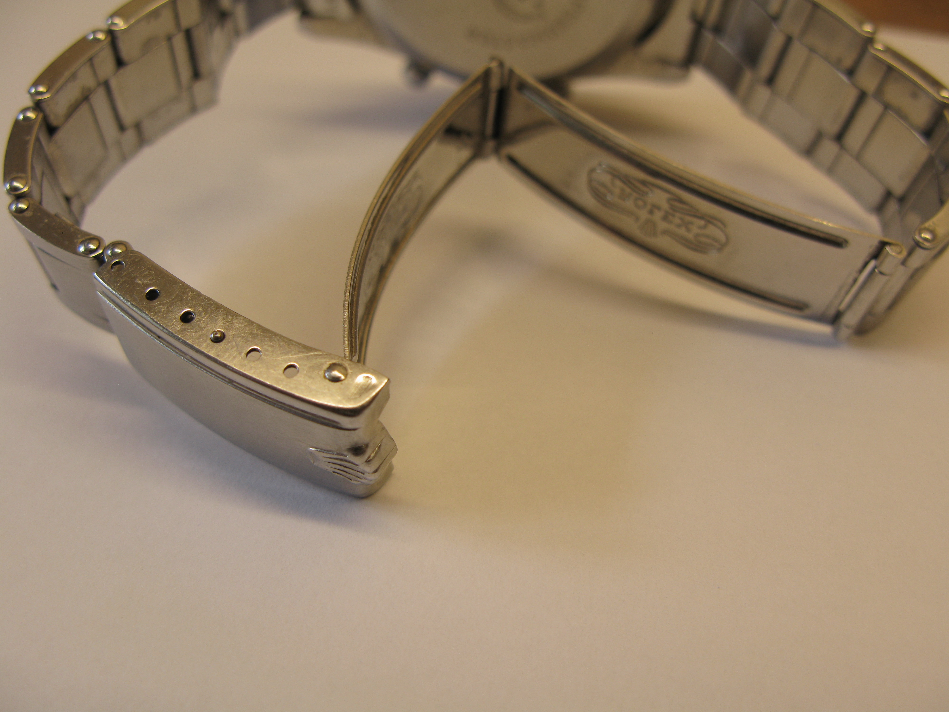

The 6635 expandable rivet bracelet is for a men’s Rolex with 19mm lug spacing. The clasps were just quite narrow on those bracelets. It has some value and would be best sold separately.
