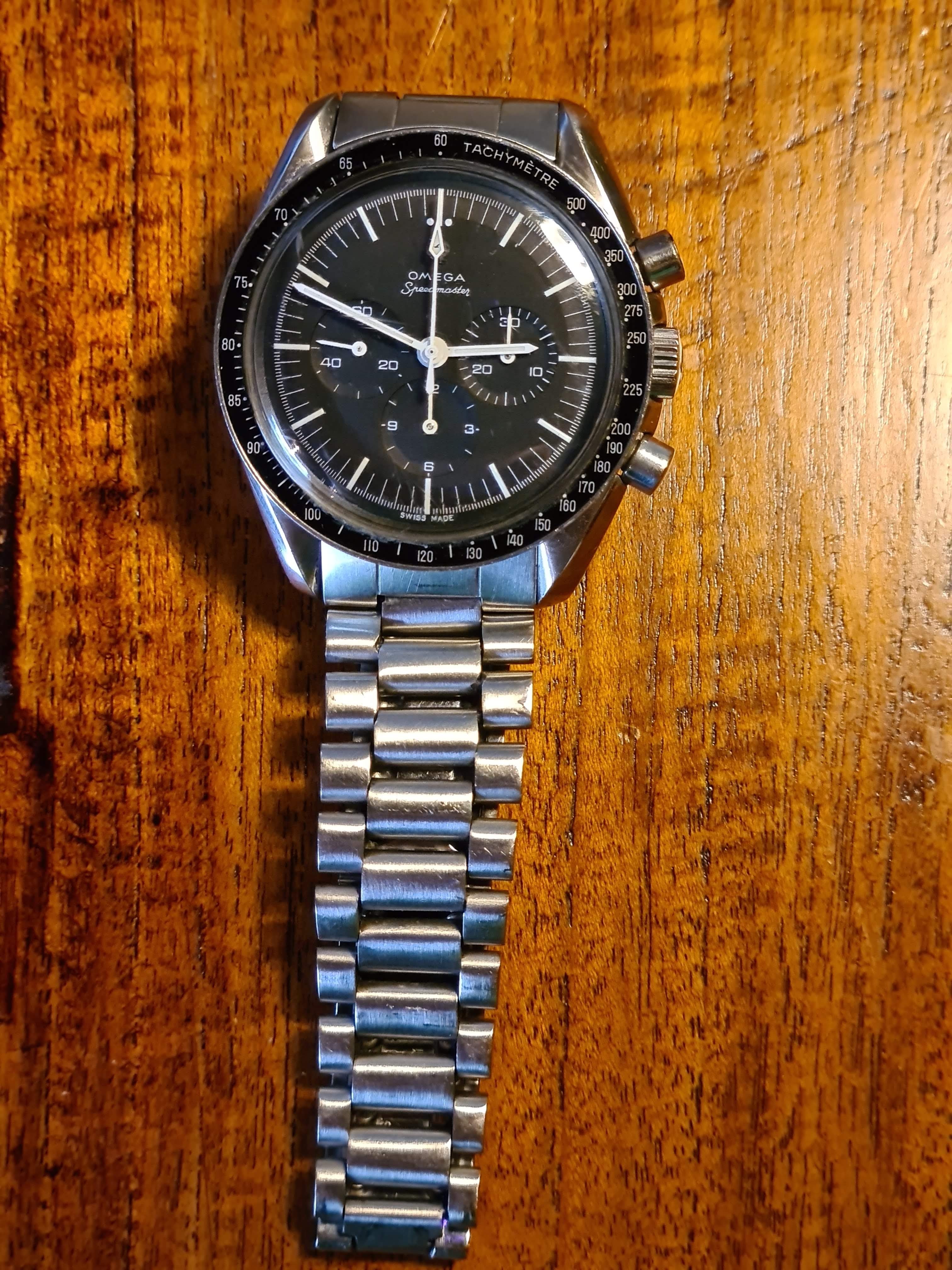

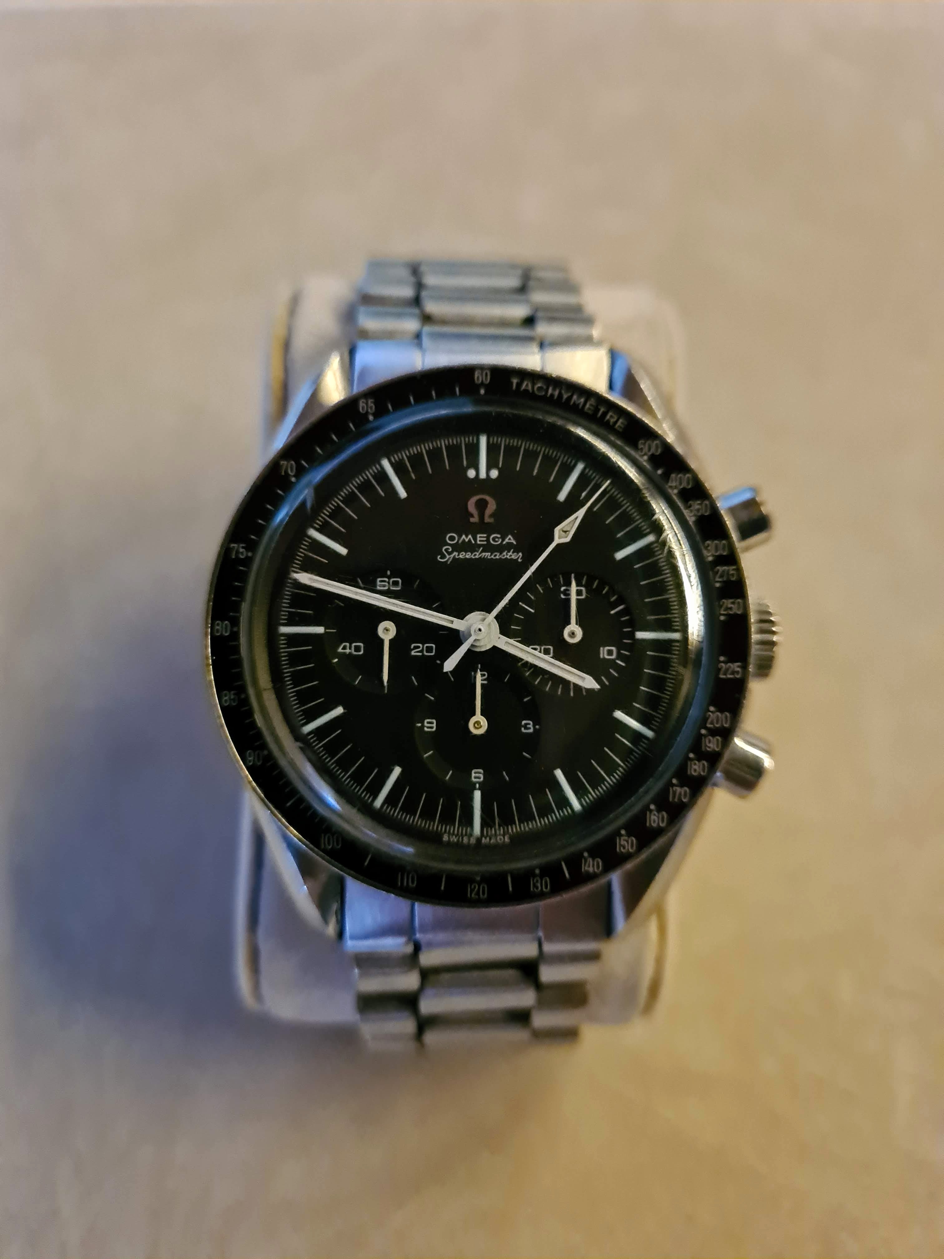

I bought an Omega Speedmaster Chronograph Moon Watch 145022 - Cal 861 of around 1978/1980 on Ebay about 7 years ago when I had a lot of interest in watches, but very little knowledge. I made a fairly good deal at the time, but doing my research in my "Moonwatches Only" book and online I noticed that there are several things off, which has been bothering me for a while. I noticed:
1. that the Bezel is probably from around 2010,
2. the dial is not a Speedmaster Professional dial/signature which doesn't fit with the dates of the watch (and the T's are missing in the bottom next to swiss made). The question now is whether it is a service dial or a pre-moon dial?
3. the hands are probably pre-moon.
Now I know these things (I think I know them at least), can I ask you guys and girls what you as the professionals would do? Should I try to find a 1980's dial and put it in this watch and have it fully serviced or is it probably best to sell as it is (with this info) and buy a good 1980's watch?
Any suggestions and ideas would be greatly appreciated! Are my findings correct by the way? Let me know if you need other pictures.
Thanks a lot!
Kind regards,
Robby

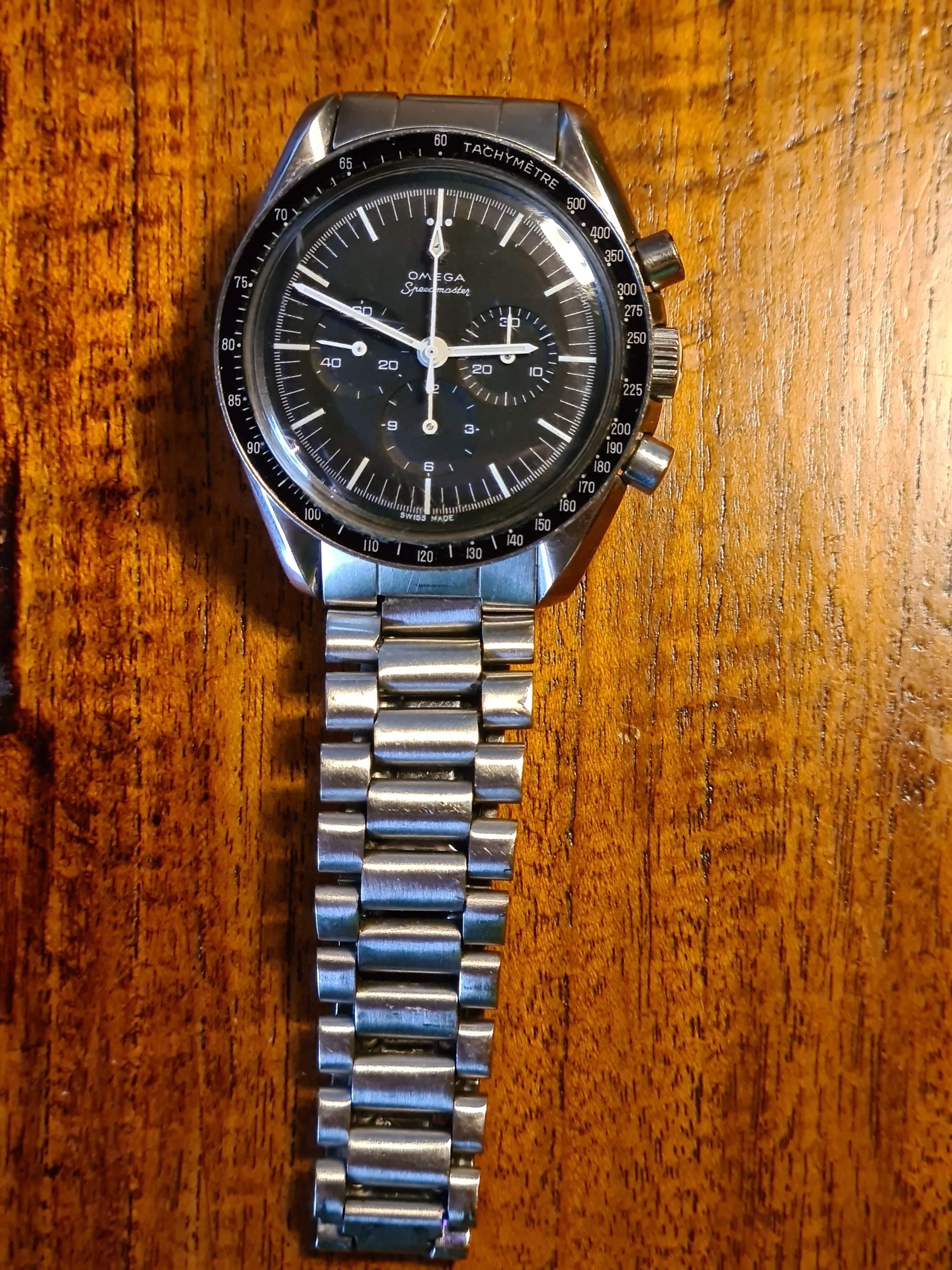

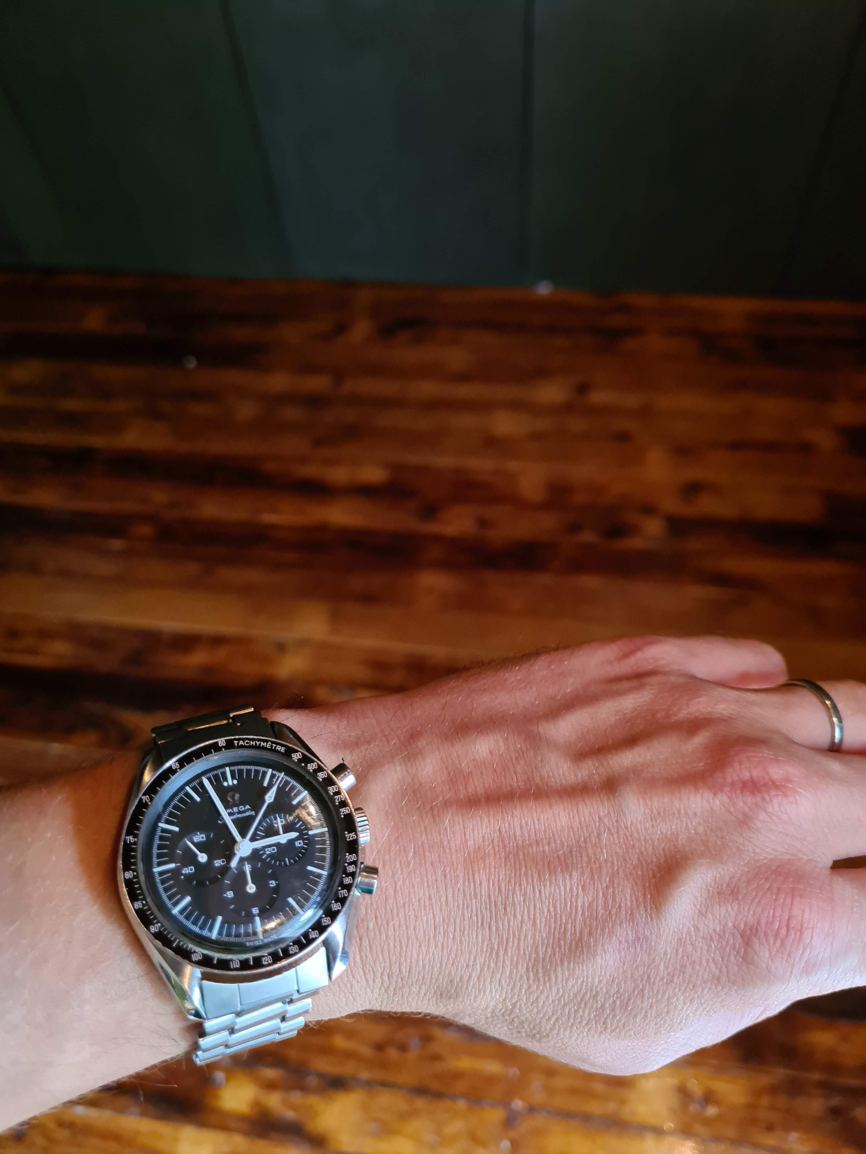

1171 braclet that looks a bit stretched but is original. Hard to tell but it looks like the endlinks might be a bit too small, is there a lot of gap? you should fit them to the case a bit better if you can!

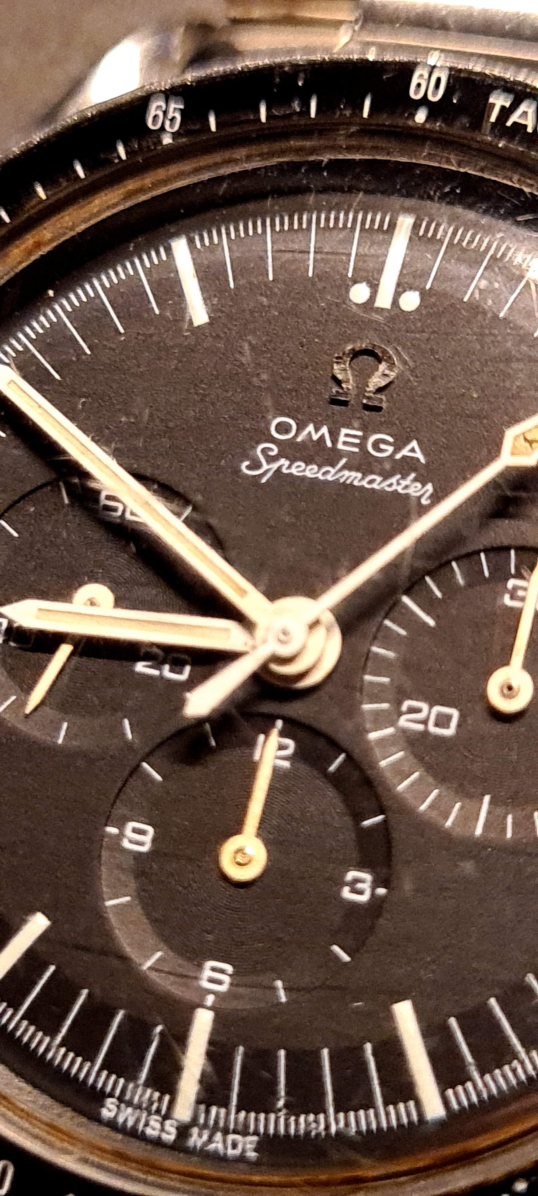

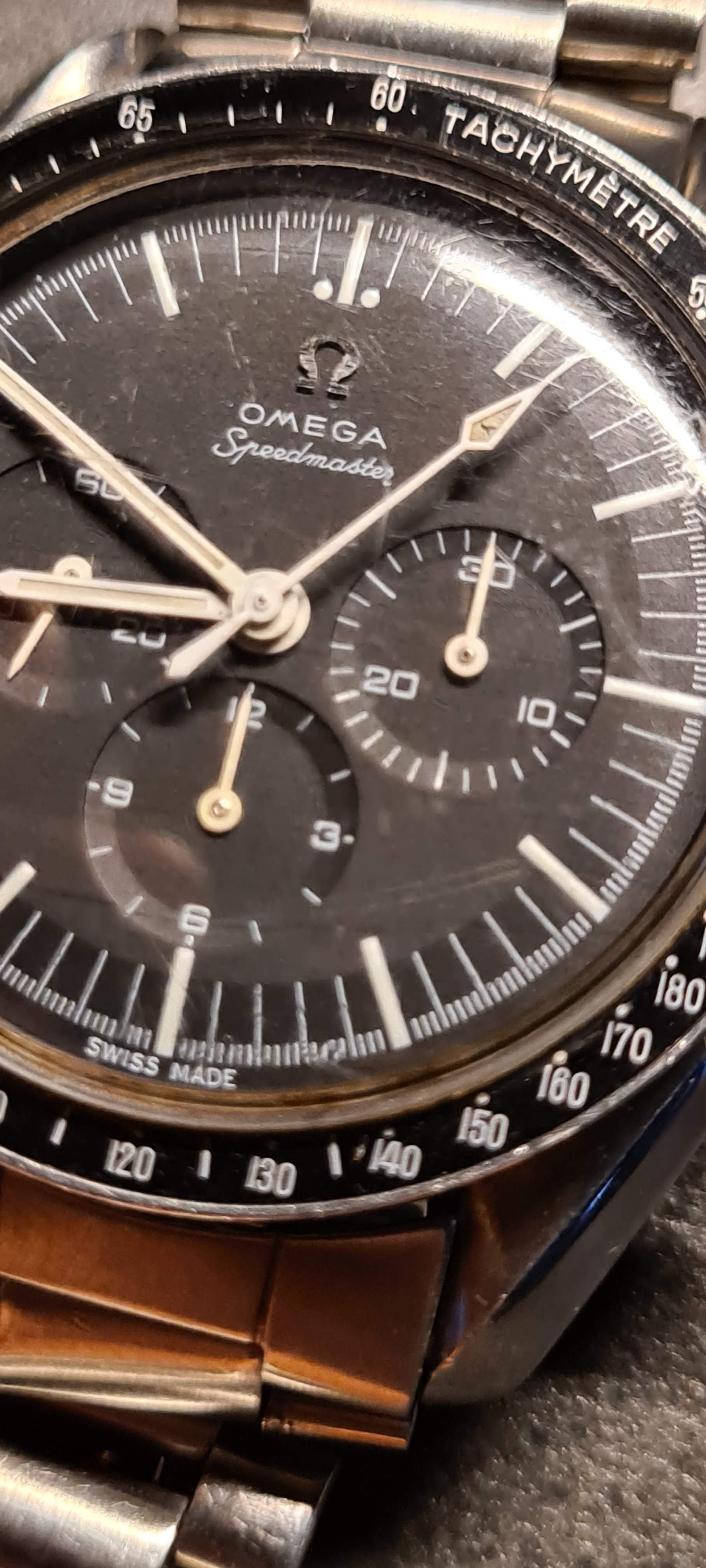

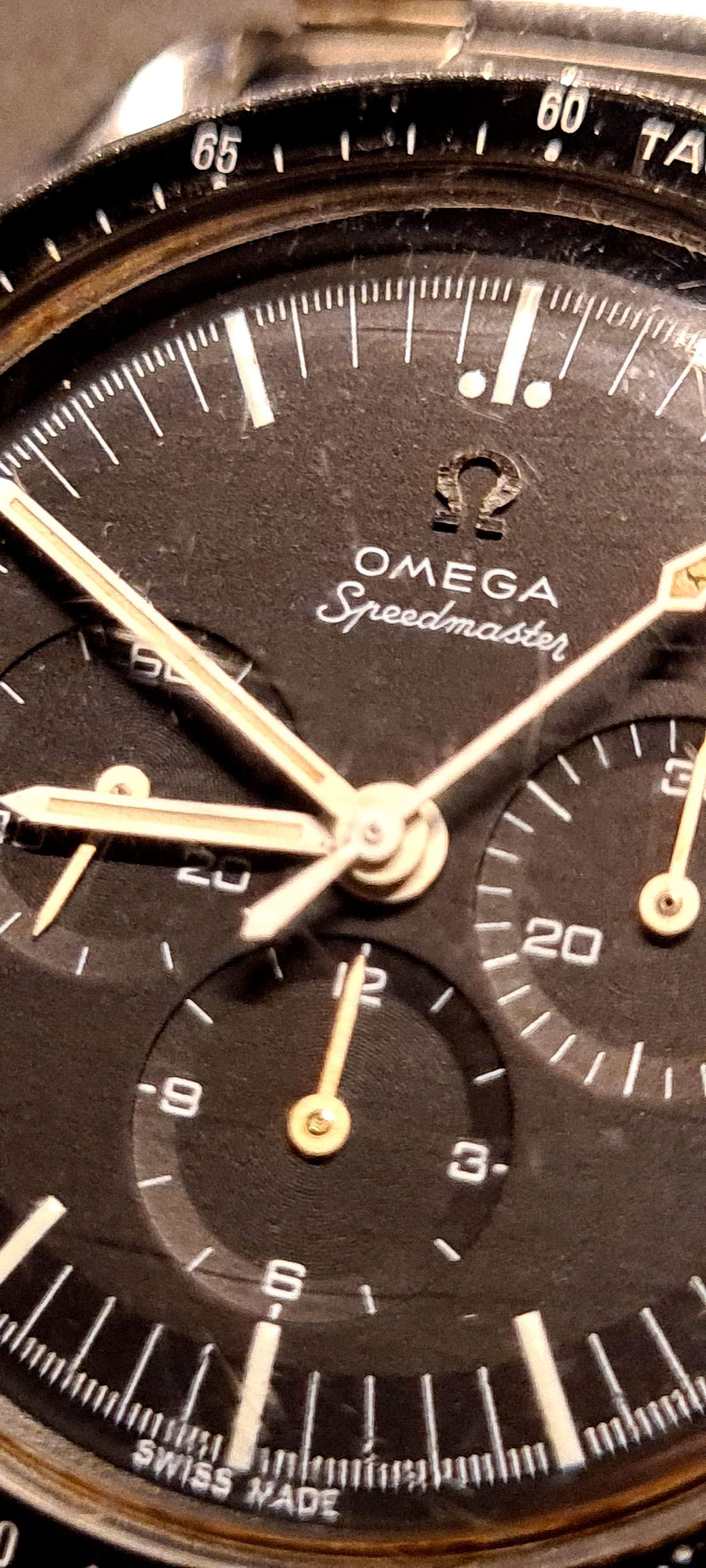

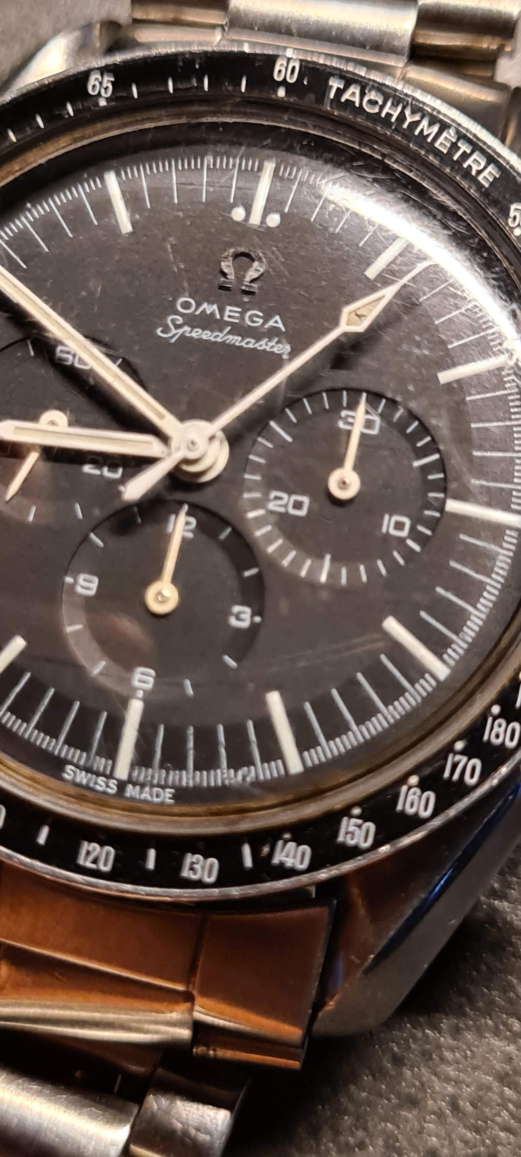

Thought it was a 2998 service dial but check link below for the likely dial (a 2998 dial would need feet modified). Also looks like superlume hands (hour/minute) with a tritium spear chrono hand (or maybe relumed?)

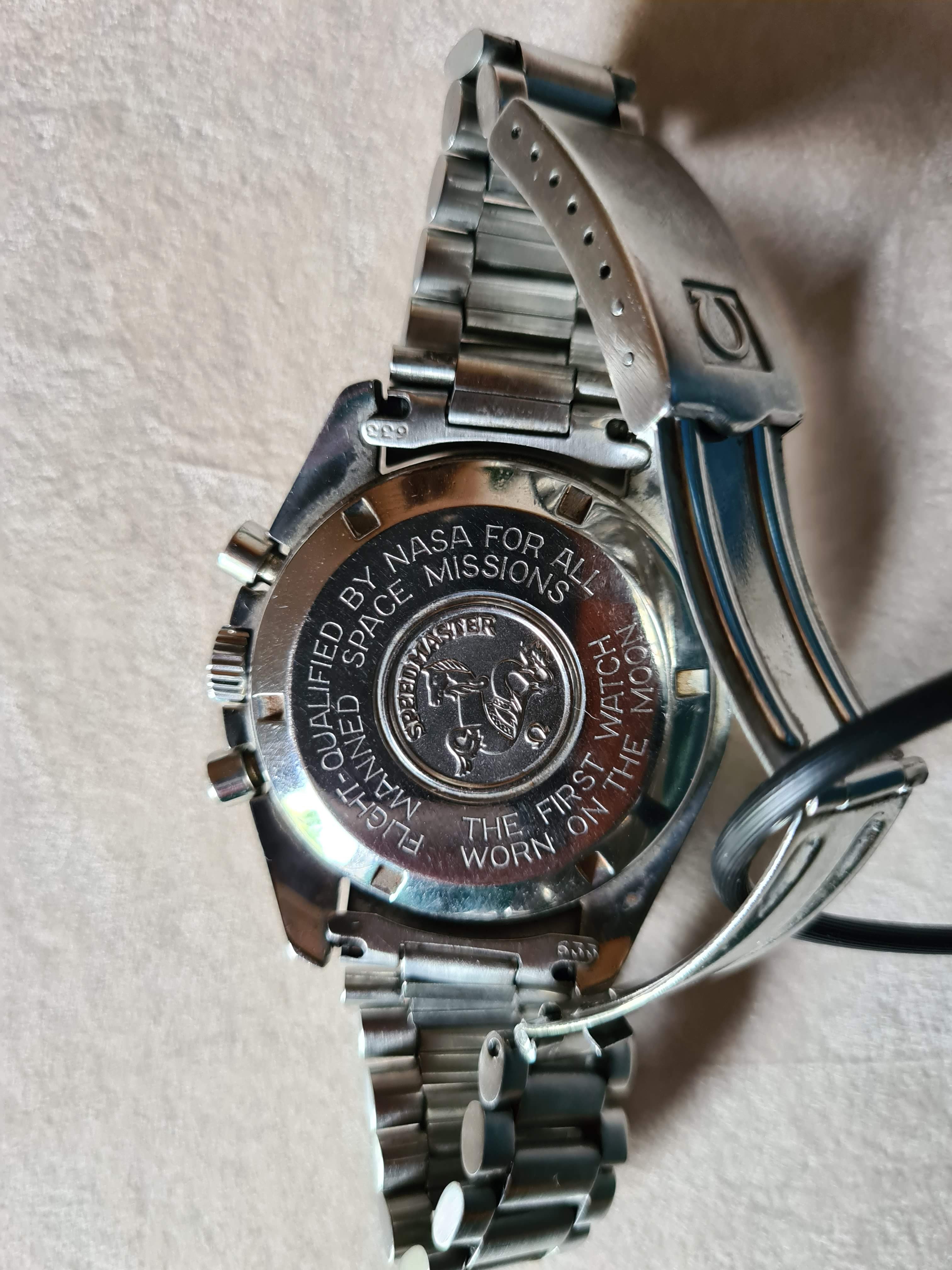

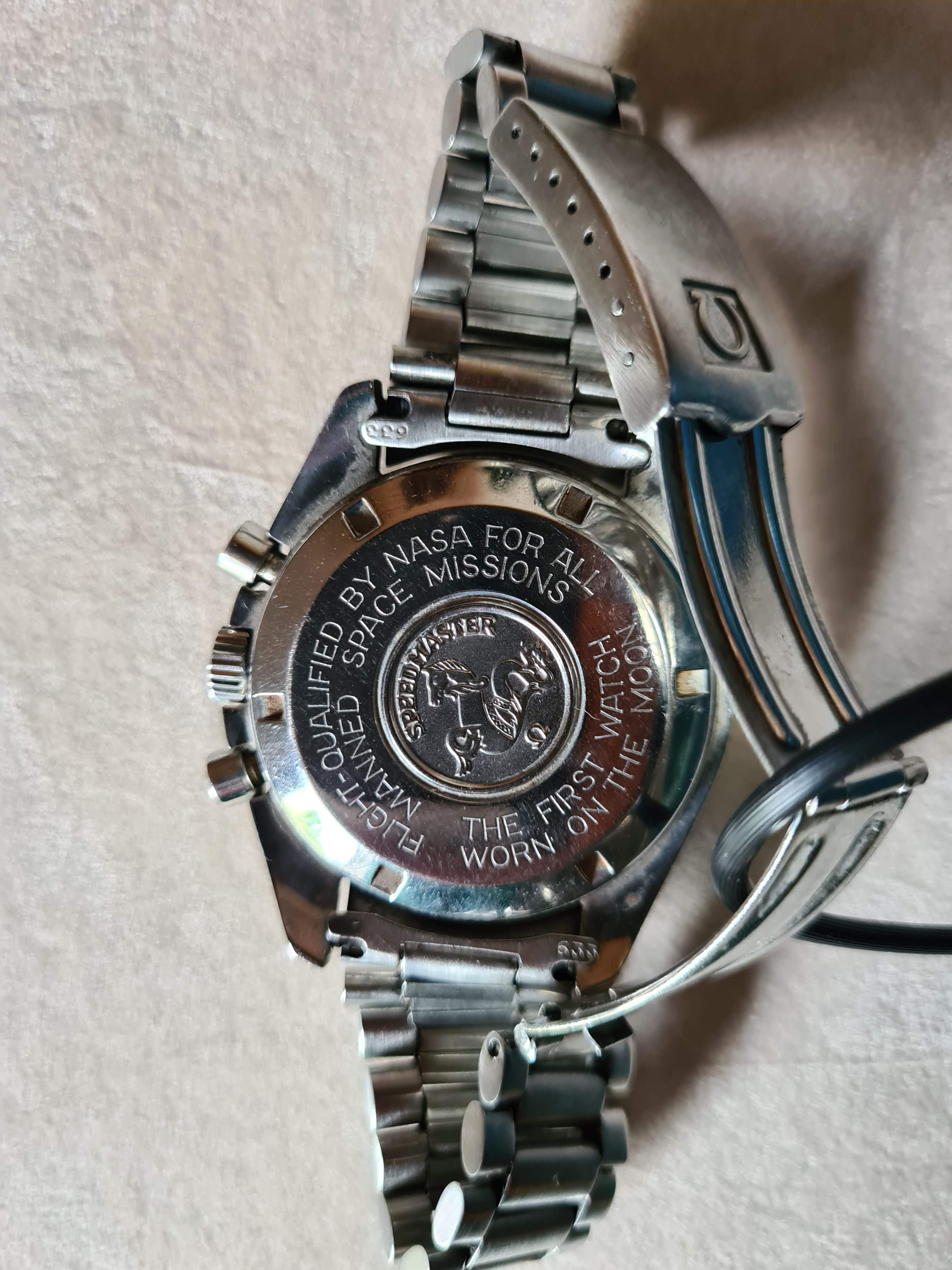

Bezel looks to be a modern service bezel. Have you had the back opened up or have movement shots?
Edit re dial: https://tambowatches.com/product/omega-speedmaster-professional-moon-watch-3594-50-dial-raised-logo/

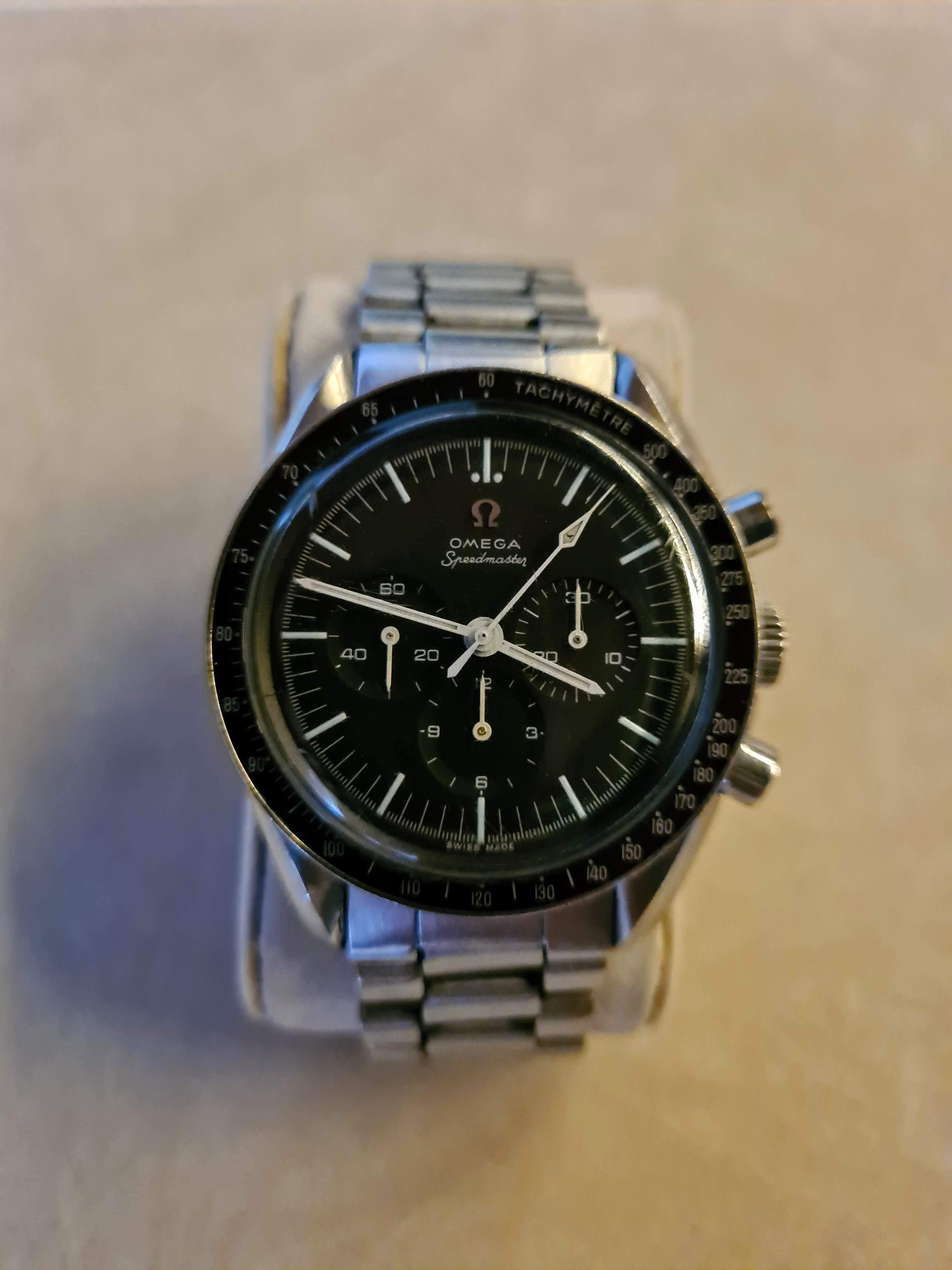

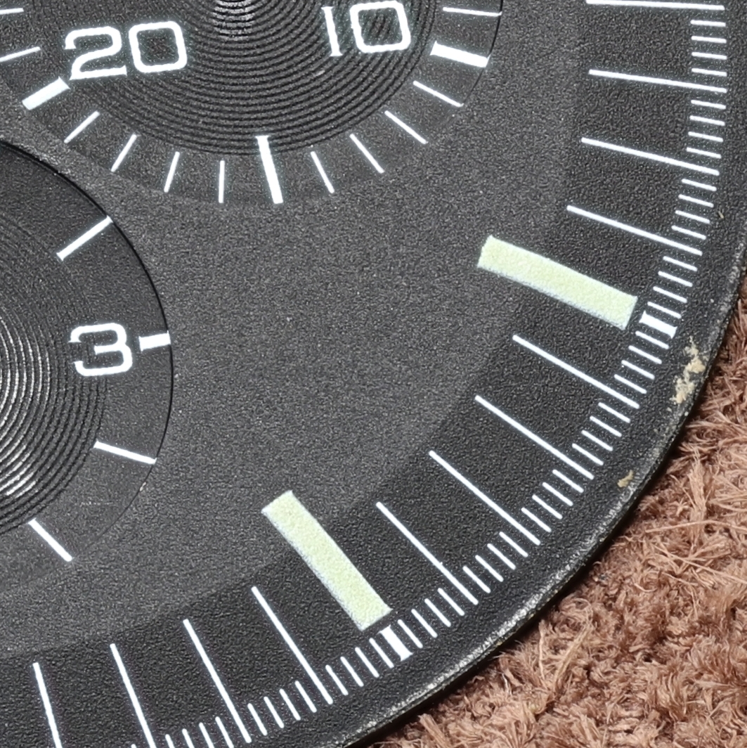

Does the dial have a step?
(like this)
Or is it like this?
Its not easy to see in your pics. I would hazard a guess its not got a step. I would further hazard a guess its a 'Replica' dial ... and seeing as my unprofessional opinion is hazarding so many guesses, I would hazard one last guess that the hands are also modern service hands, and that there is nothing pre moon on your watch.
What to do? That depends on what you have there. What is the serial number? Have you applied for an extract of the archive (to make sure the movement actually came from a Speedmaster)? I would only think about doing anything after that. Until then, enjoy it for what it is ... a nice and cheap-thrill Speedy that has been giving you pleasure for many years and did not cost an arm and a leg...
Thanks for that! Good idea for the bracelet. I wouldn't know how to do that, but that is probably the reasons why the bracelet is a bit loose. Also one of the reasons I am thinking of changing as it does not wear fantasticly as it is a bit loose.
Looking at the link it looks exactly like the 1, 2 and 4th picture. My untrained eye can't find a difference. I believe I have finally found the dial that was put in the watch I think, wow!!! Are these service dials? Very expensive for a service dial, better to search for a 1980's dial and put that in for 300 EUR extra, what do you think?
As to the hands: what do you mean with your remark? Is that good or bad? I am learning so much now, I need to go back studying I believe.
I want to open it up and combine it with the new potential parts I want to ask them to put in, or do you thinnk it is best that I ask to open it up now to gain more knowledge before I figure out what to do?
(like this)
Or is it like this?

Thanks for this!
It does not have a step but it is also not like the second picture, it is exactly as suggested by E2B in the link he mentions. It seems to be a 3594.50 Dial. Raised Logo.
Yes, the hands is a very big "if". Do the attached pictures help?
I made the mistake in not researching any further when I bought the watch and now 7 years later I am going into the details.... Not smart but at least I am trying now. It is a good idea to have it opened up and ask for the serial number. After that I can apply for an extract of the archive (great pan!).

TBH, if you want just to wear the thing, grab a service dial and a a set of hands you could just do that and have a older watch with a nice dial/bezel/hands that are not exactly correct, but visually nice. If you get it serviced properly (which you should if you want to wear it) all that comes off anyways. You can also swap the strap for a the uncleseiko one and enjoy it!
Here's a dial on here: https://omegaforums.net/threads/speedmaster-145-022-861-service-dial.118137/
By the time you looked at getting the right bezel, hands, and dial to set it all back to stock...that wouldn't be worth it.
Hard to tell what's going on with those hands, but someone will tell you. I'm sure you could sell those and the dial for a few bucks to do option A
