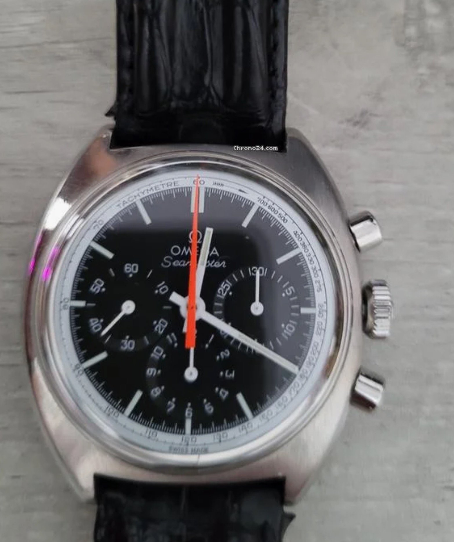

Please could I ask for any thoughts about this watch on Chrono24?
I have always liked them and am attracted to this version because of the pulsations bezel, I am a doctor. It seems overpriced compared to other similar watches, such as this one which I understand has a more collectable movement.
Forgive the very naïve questions, I have not bought a vintage watch before but have been wondering about these for a while, but have literally no knowledge about how to spot a good (or bad) one.

these are very attractive watches- there are cal 861 and cal 321 movement versions- the 821 are less expensive but still desirable- but as a first vintage watch this is the deep end so do some research. There is a nice one in the Private Sales forum here from an established OF member and collector which is fairly priced- have a look

Very nice reference. I know strictly nothing about these, but the case in your first link stands out quite a bit, and looks slightly too good compared to the dial and hand condition. Perhaps reassembled with a NOS case?

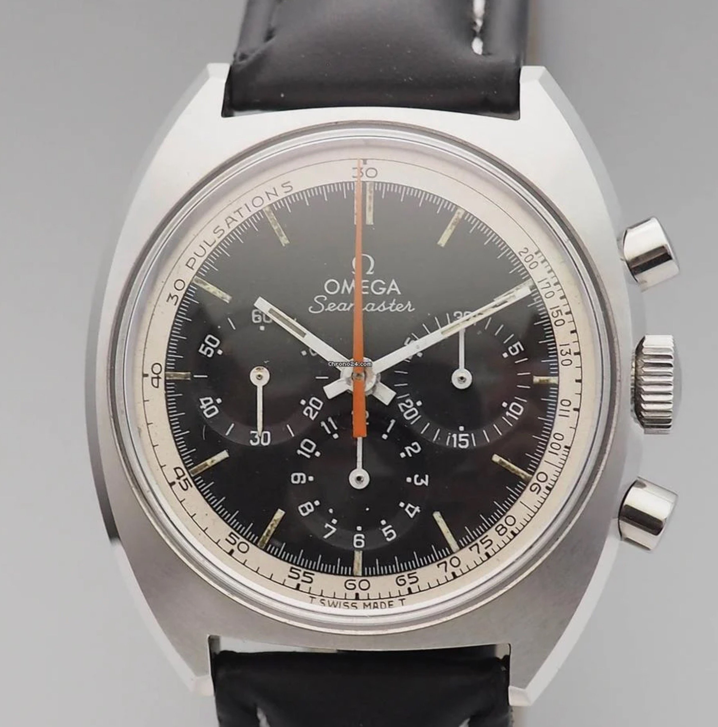

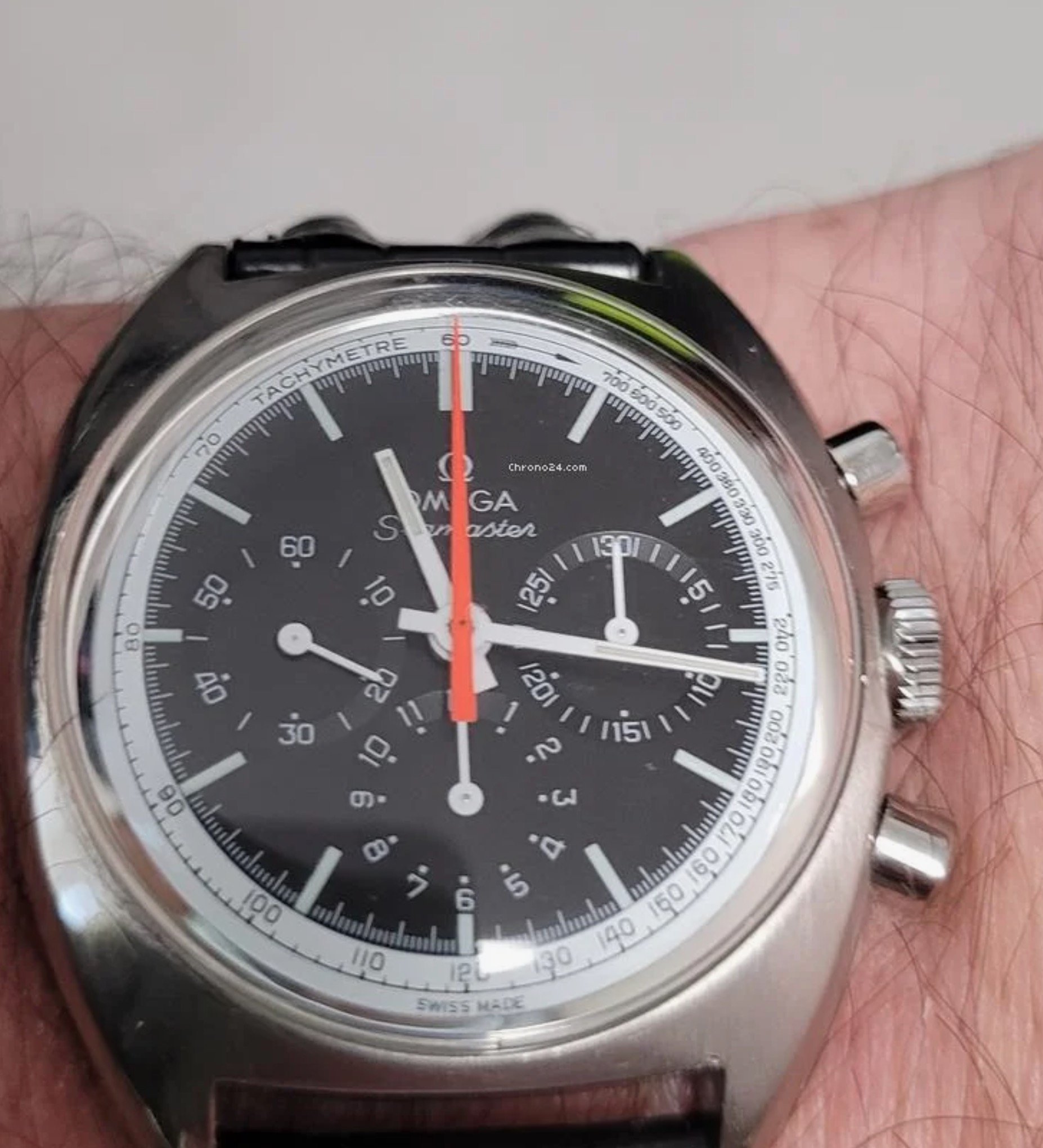

Thank you for the thoughts so far.
To add the photos, as suggested.
The first watch:
The second watch

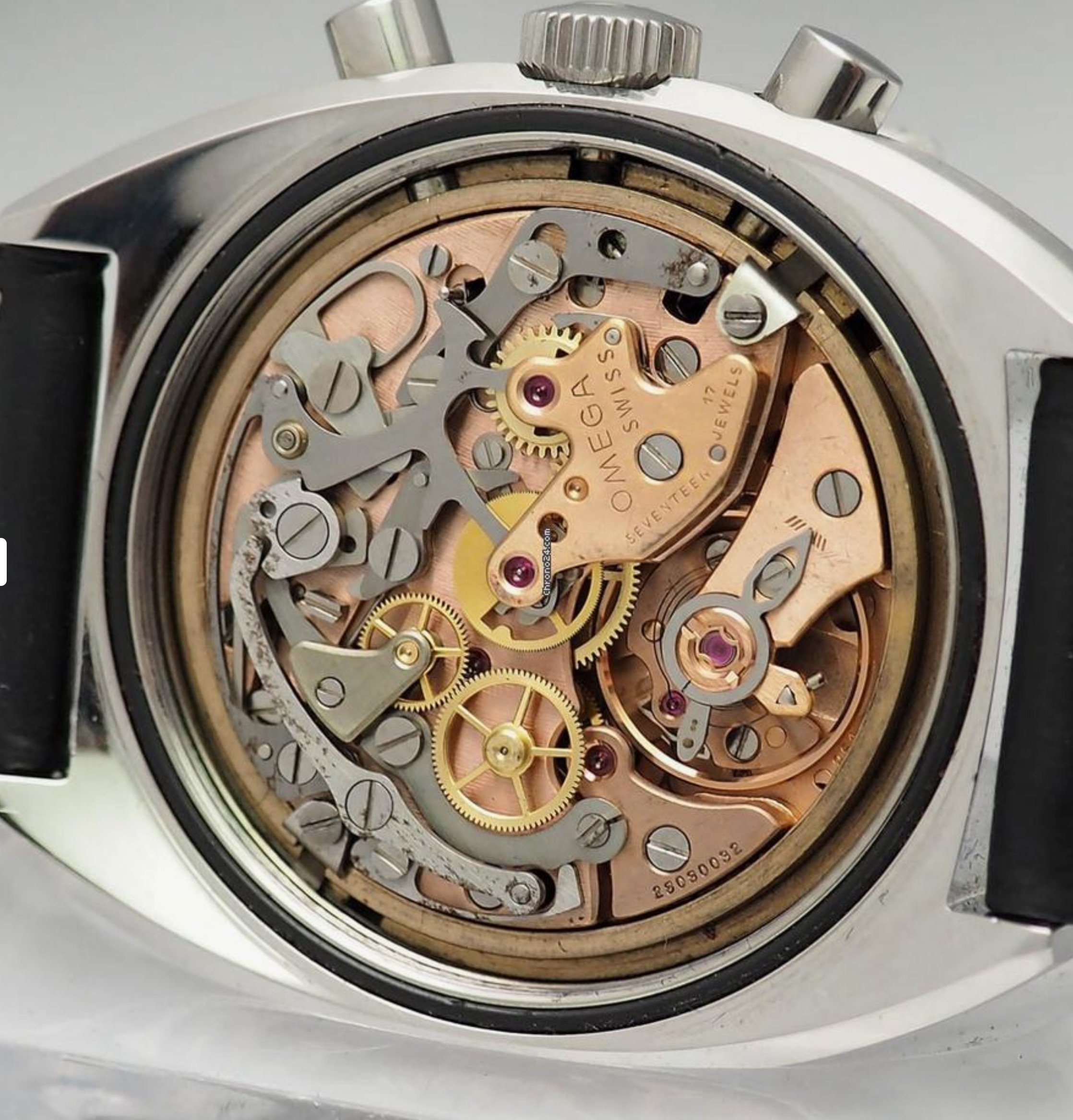

There is no photo of the movement of the second watch.

First one with 861 movement appears to be re-cased with NOS case or case has been refinished.
Second one with 321 movement appears heavily polished.
Look at the one for sale in OF Private Sales better example of 321 movement and lower price

I would echo those last comments - also be aware of corrosion within the movement itself, which is evident here. Whilst it can be isolated and no problem, it can also run deeper!
