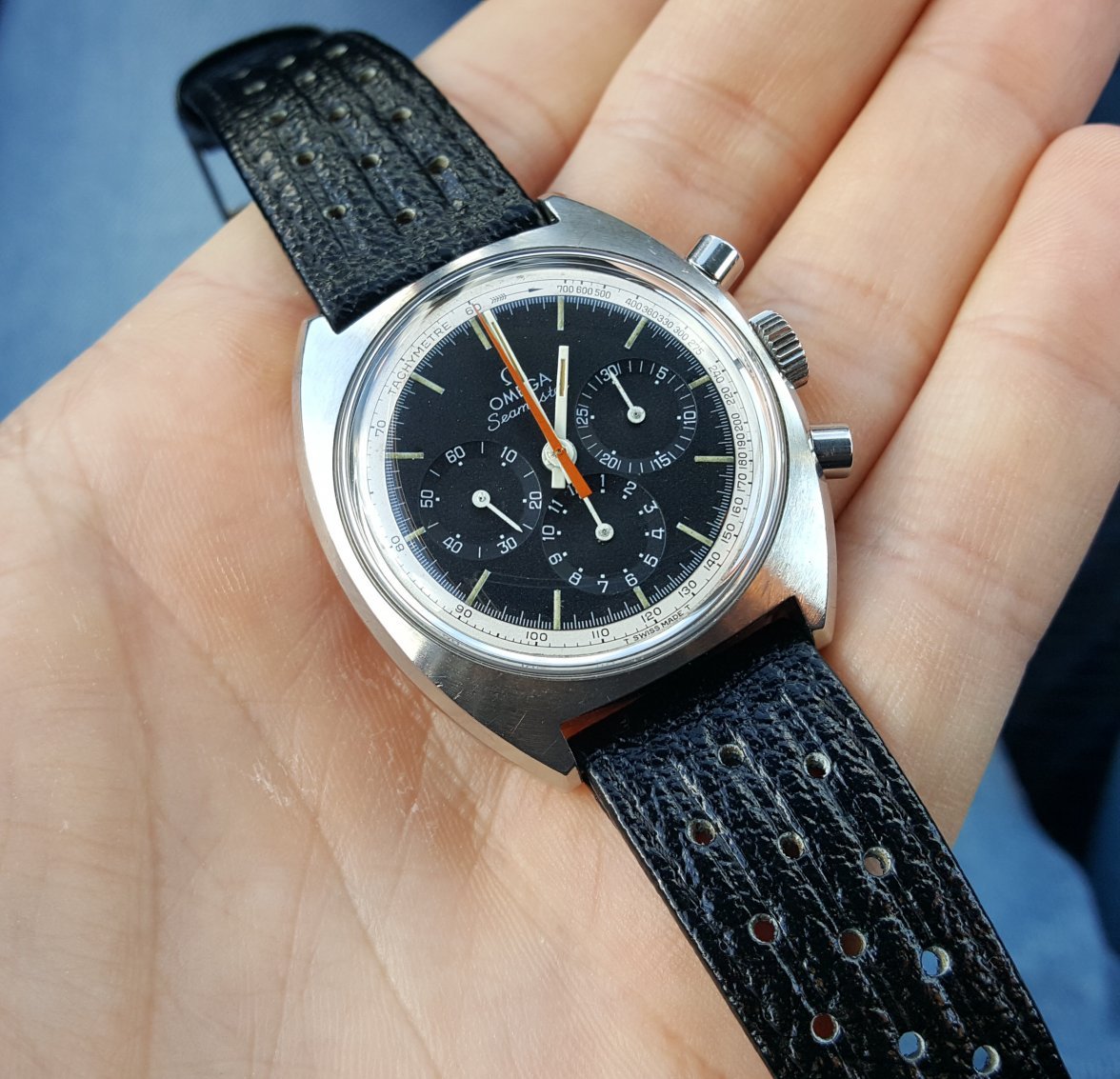

Let鈥檚 start with the 145.016 with what I called a Silver radial dial with thin indexes :
- Silver dial
- Applied logo
- Radial sub counters
- Long thin applied indexes with tritium dots at outside edges
- Integrated tachym猫tre scale
- Chrome hour and minute hands with a tritium track and a black track
- Orange chrono hand (18.20mm)
- Black sub counter hands

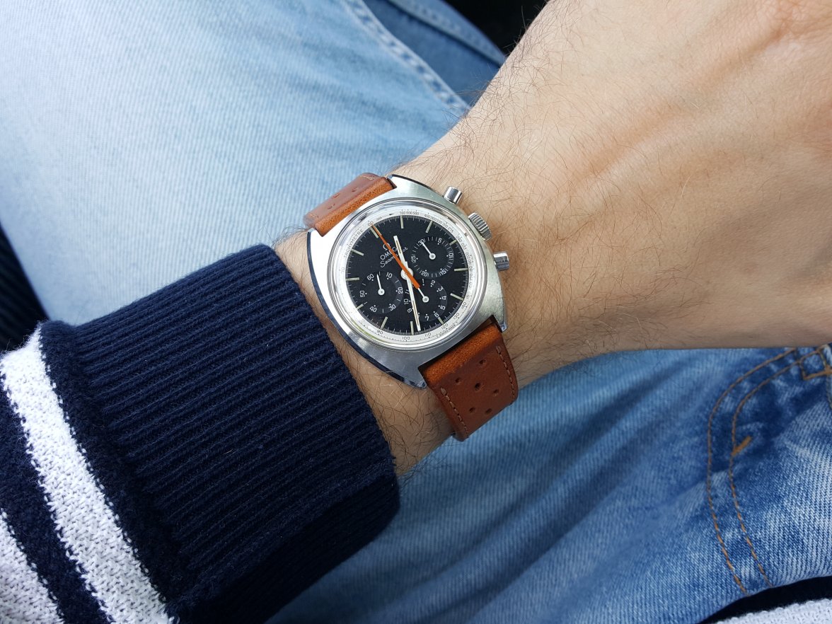

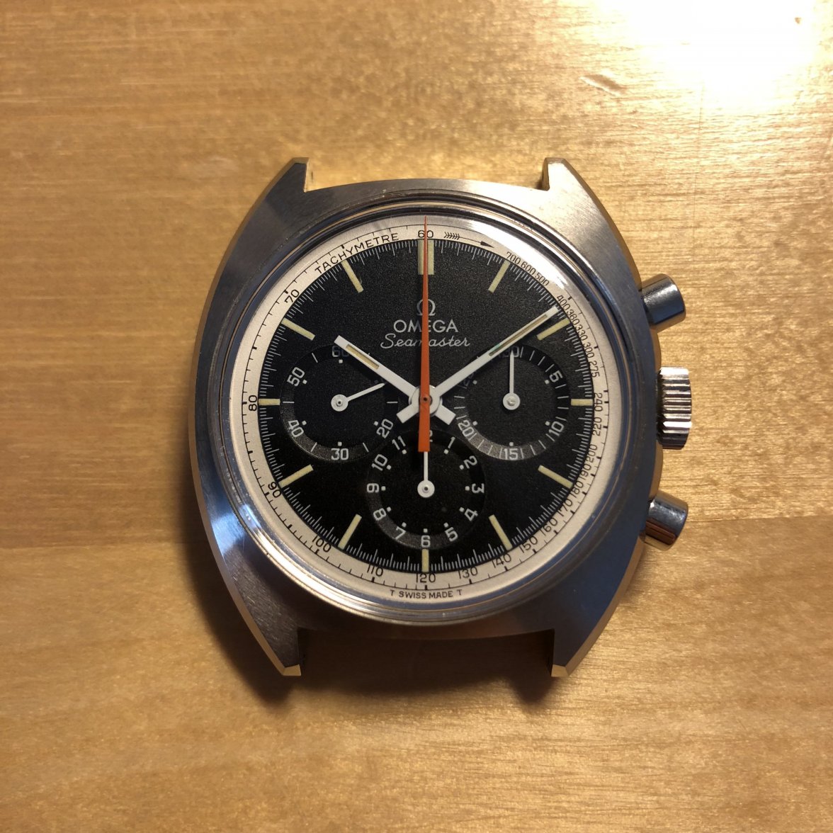

Nice Tread...very nice watches 馃榾 these watches represent geat value imho. 321 movement...very cofortable casesize und you can have theme for (relativ) small money in todays vintage market.
Here is my 145.006 with a black radial dial in, what i believe, all original and unpolished condition.
Best, Fabian
4,114
16,311
@Fabulon Thank you for your contribution, Fabian. Fully agree with what you said and I linked your post in my first reference post. 馃憤
Let鈥檃 add a description of the Black radial dial :
- Black dial
- Printed logo
- Long tritium indexes
- Integrated tachym猫tre scale on a white background
- White hour and minute hands with a tritium track
- White sub counter hands

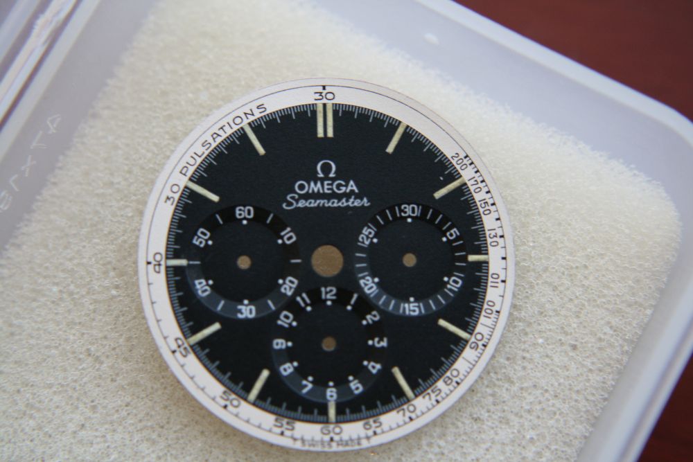

The 145.006 also available with Pulsations dial
Thank you ! Never seen any similar dial till now. Interesting 30 pulsations graduation 馃榾

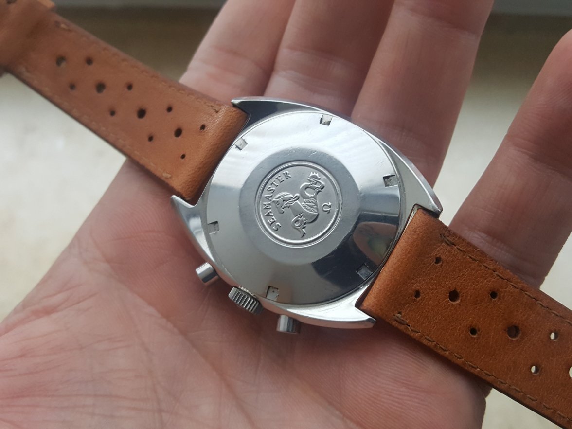

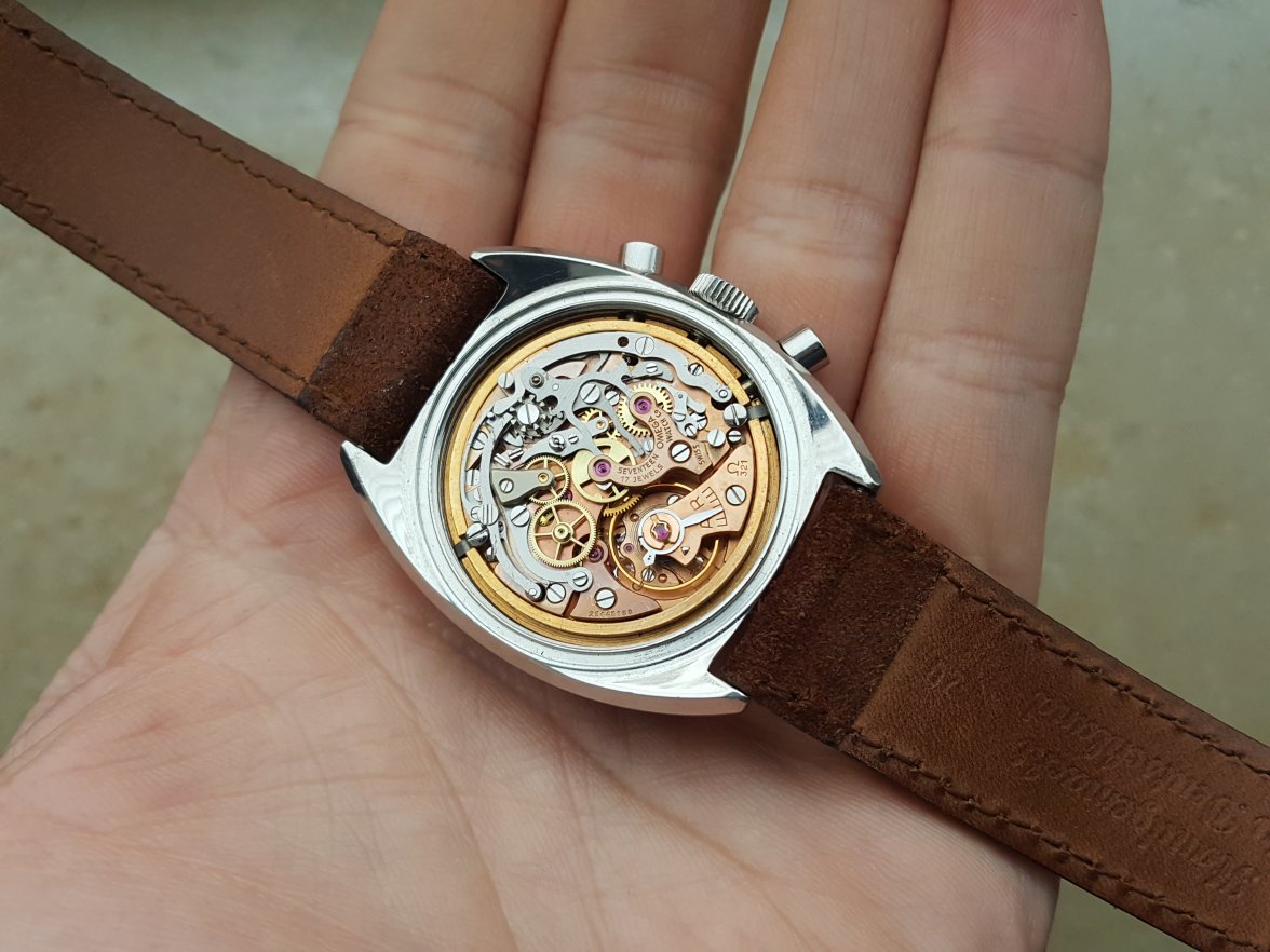

Are you sure it鈥檚 for a cal 321 and not 861? Can you make a pic of the back to check the fitting pins? Thanks in advance !
1,641
5,752
Yes it was originally for cal 321 as the dial feet are the thicker pins and the large base

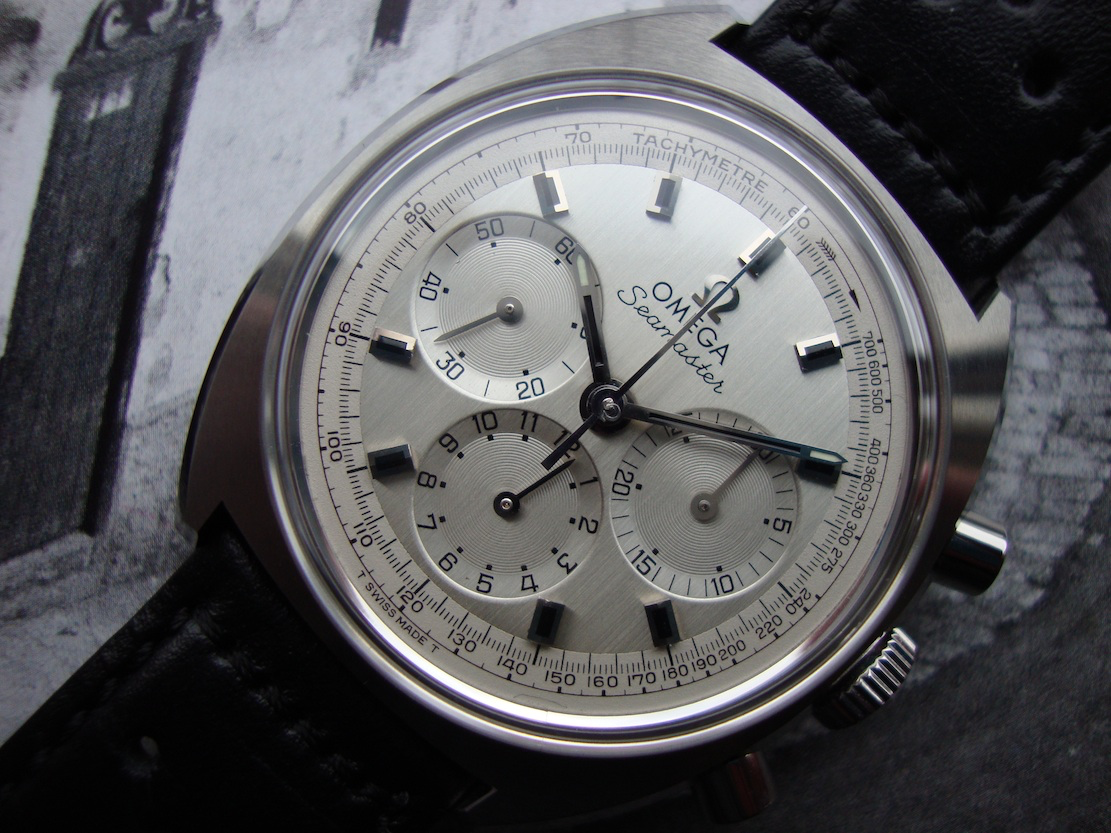

Let's move on with some pictures from @stefan 's 145.016 with what I called here a Silver radial dial with fat indexes :
- Silver dial
- Applied logo
- Fat applied indexes (any Tritium inside?)
- Chrome hour and minute hands with a tritium? track and a black track
- Thin chrome (2998-like?) chrono hand
- Chrome sub counter hands
An absolute beauty IMO and the only example I have observed so far. 馃グ
--> First reference post updated accordingly.

9,595
27,668
kov kov
- Silver dial
- Applied logo
Interesting. That's probably the first Omega I've seen where the hands have lume, but the dial hasn't.
Thoughts, anyone?
