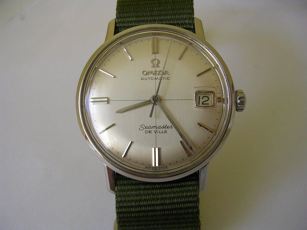

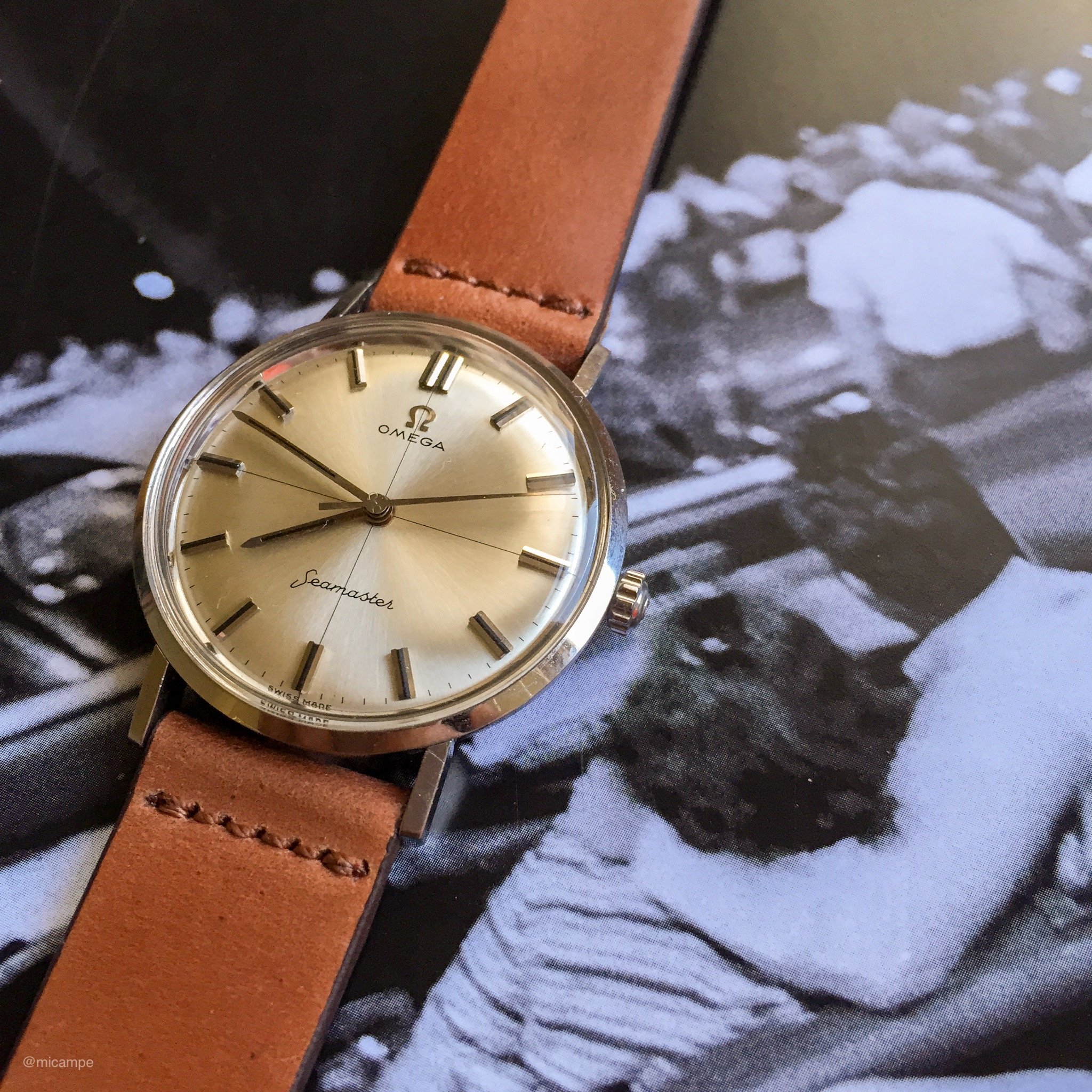

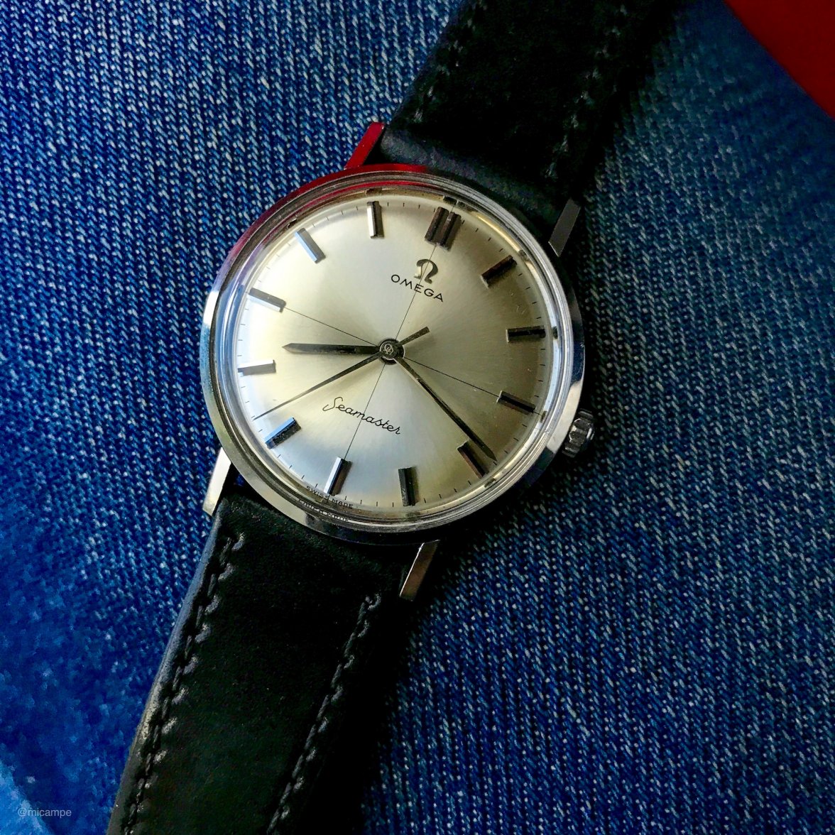

I am a self-admitted NOOB, that would be grateful for some expert eyes on this Seamaster that I am considering. But first I want to thank the community and everyone that contributes - I'm learning so much from this forum.

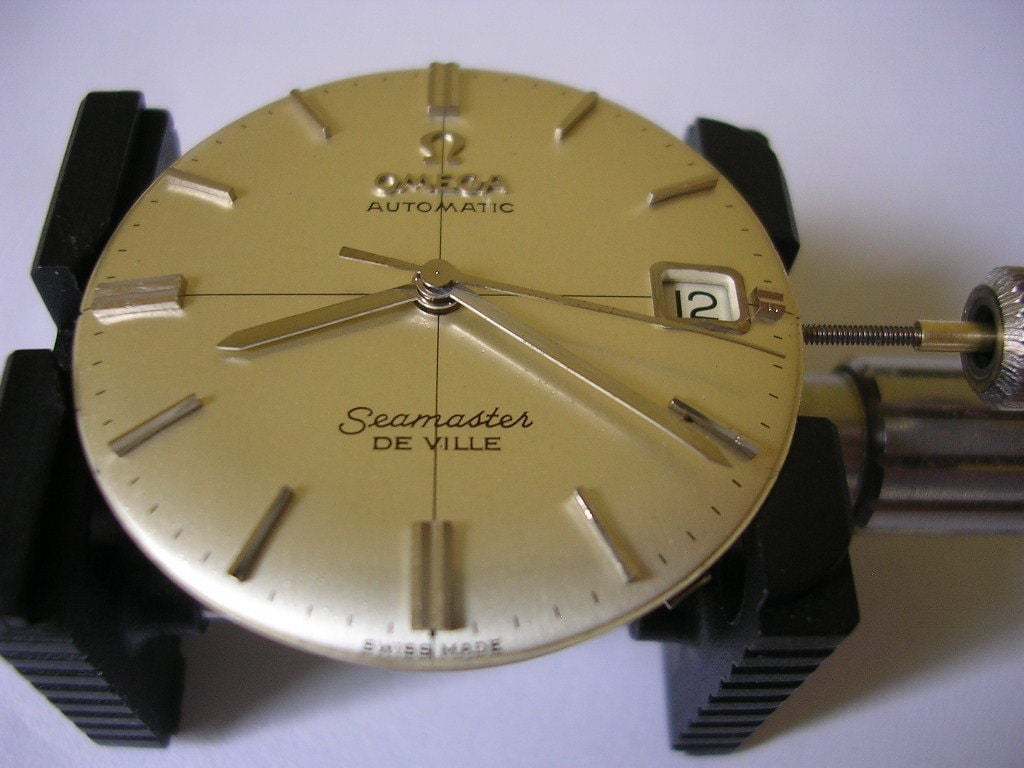

I've tried to do my homework... I am learning to focus on the dial for originality, movements, and cross-check pictures with reference models.

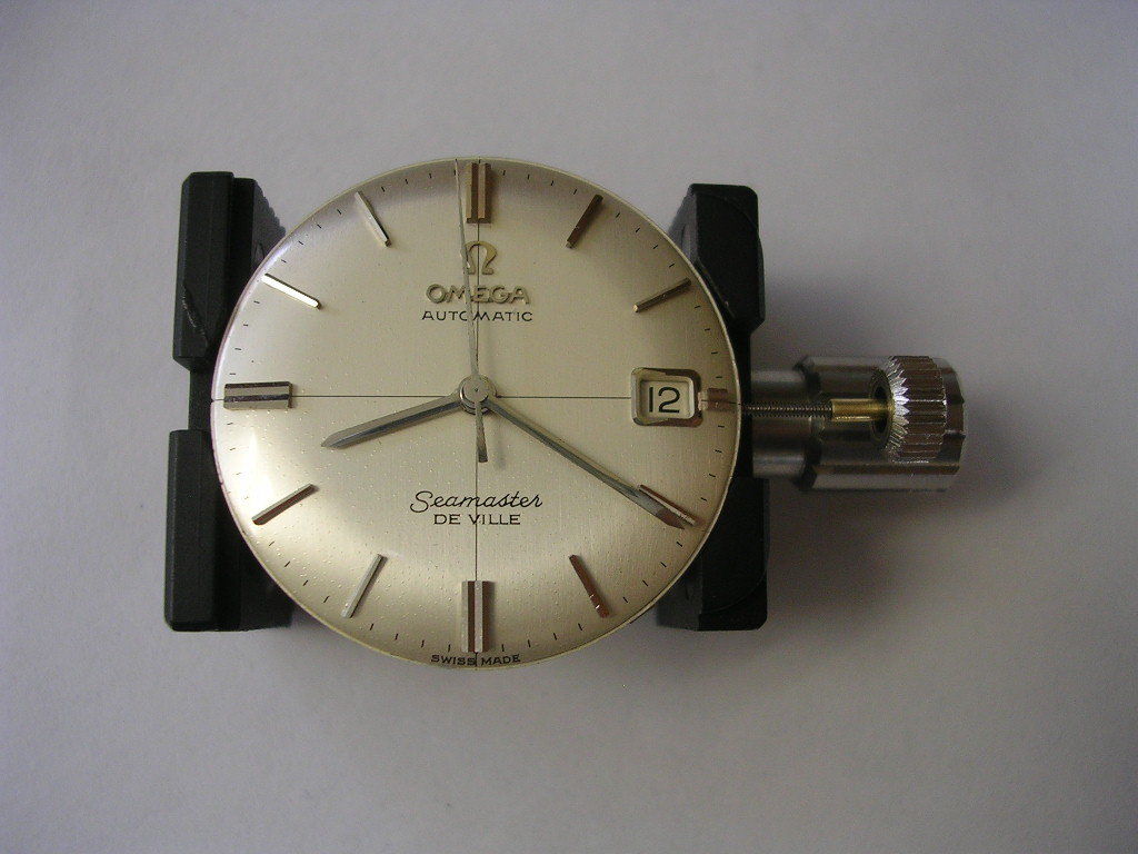

This (https://omegaforums.net/threads/omega-seamaster-de-ville-cal-565-650.62615/) seems to be a good cross reference and to my eye, it checks out nicely.
Of course there are the crosshairs.. but again they also seem clean and don't suggest a redial, based on what I could gather from this post (https://omegaforums.net/threads/crosshair.7889/)

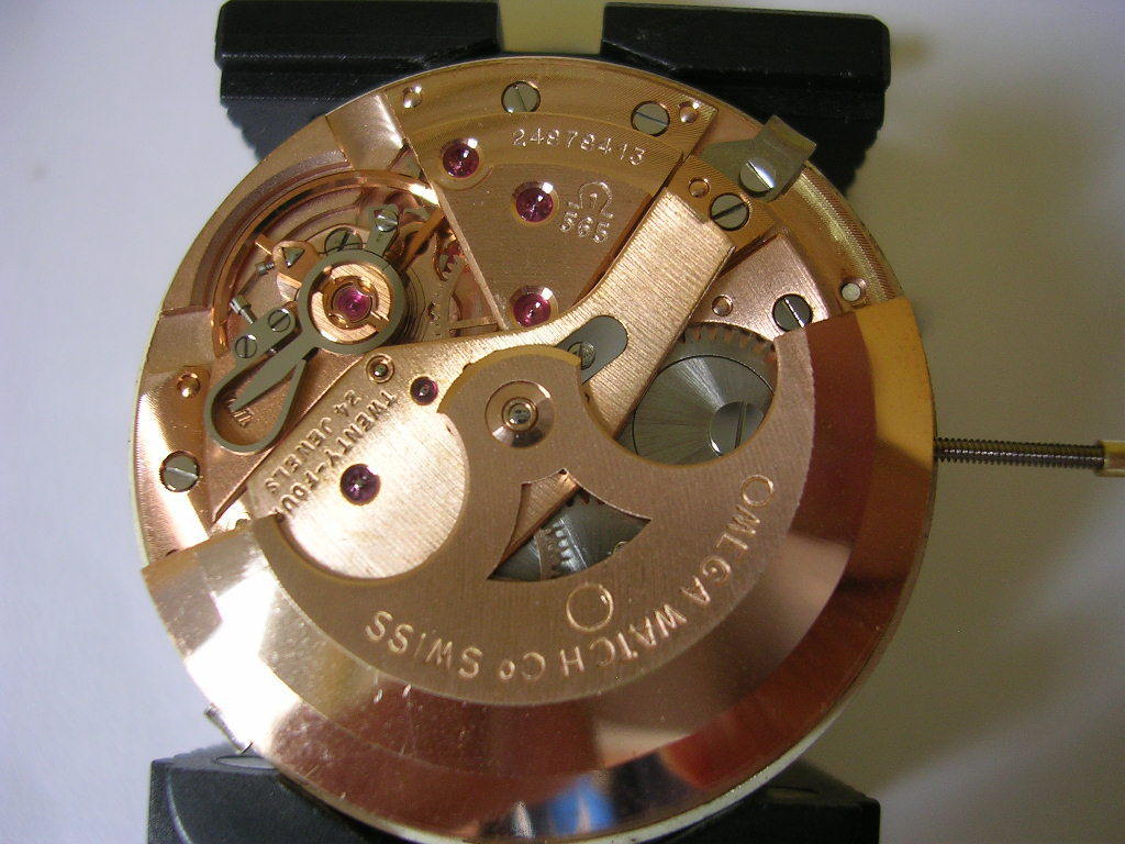

I also don't think that the movement has been frankened (the serial number, caliber and year all line up, and the parts are roughly the same colour / wear). the first 3 numbers on the case back (166) also seem consistent with the model type.
The seller says its an original dial. It looks very clean though without much patina so i am guessing its been buffed.If anything my overall sense is that the watch is 'too clean / fresh' if there is such a thing...
So I am wondering:
1. Any advice, or red flags? I would be most grateful!

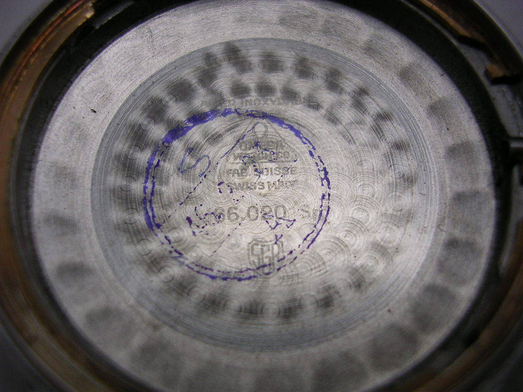

2. What does the blue stamp on the inside case back signify?
thank you

I think it looks nice and correct, even the crystal with logo and magnifier.
The blue stamp was probably left by the watchmaker at a previous service.

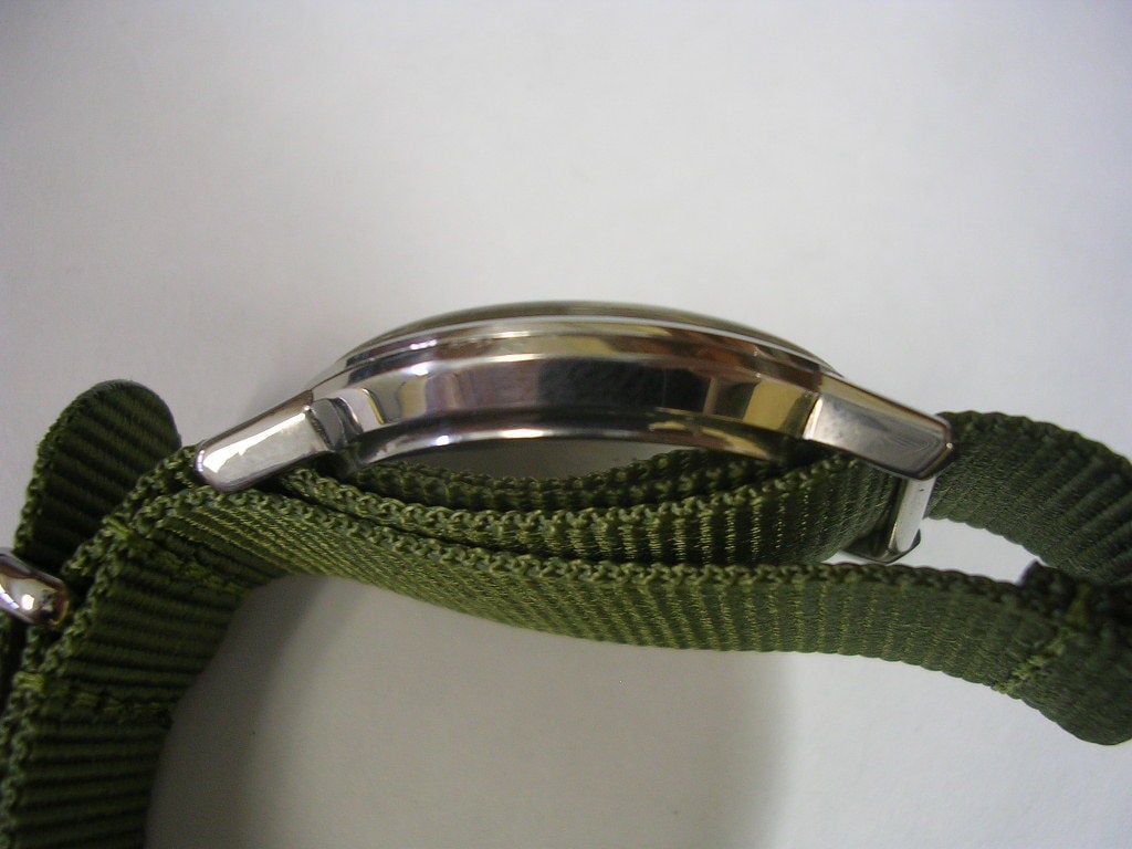

If you get it please remove that strap.

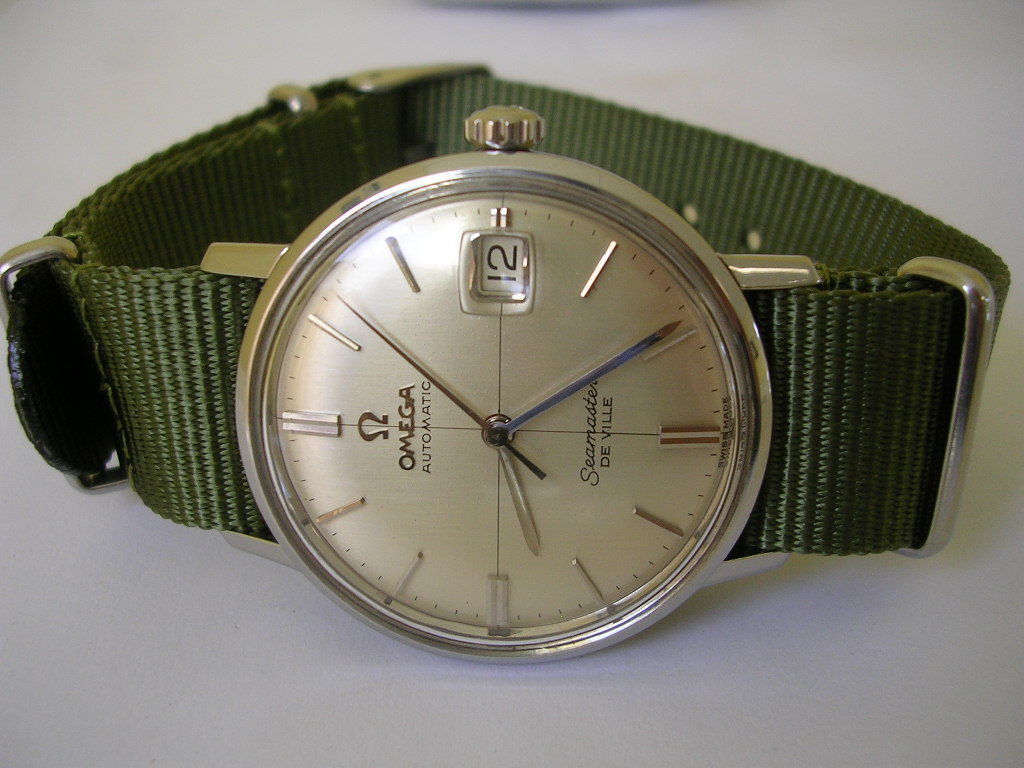

haha must be same seller with the same tacky green NATO on each. Good luck. Hopefully you won't have so much competition in the end!

Looks to me to be a nice watch in very nice and original condition. I can't comment on the condition of the movement only to say it looks very clean and from the nice sharp screw heads I'd say it hasn't been messed about with.
In fact the watch as a whole looks like it hasn't seen much wrist time over the years, which is good from the condition standpoint but also will generally point to a service being absolutely necessary due to dried oils.
A great watch for a starting collector IMO, depending on the price of course?

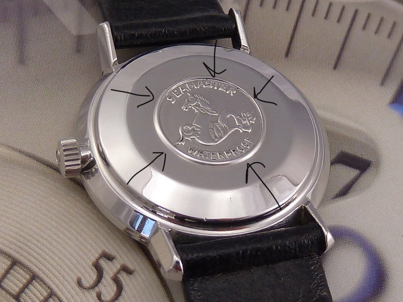

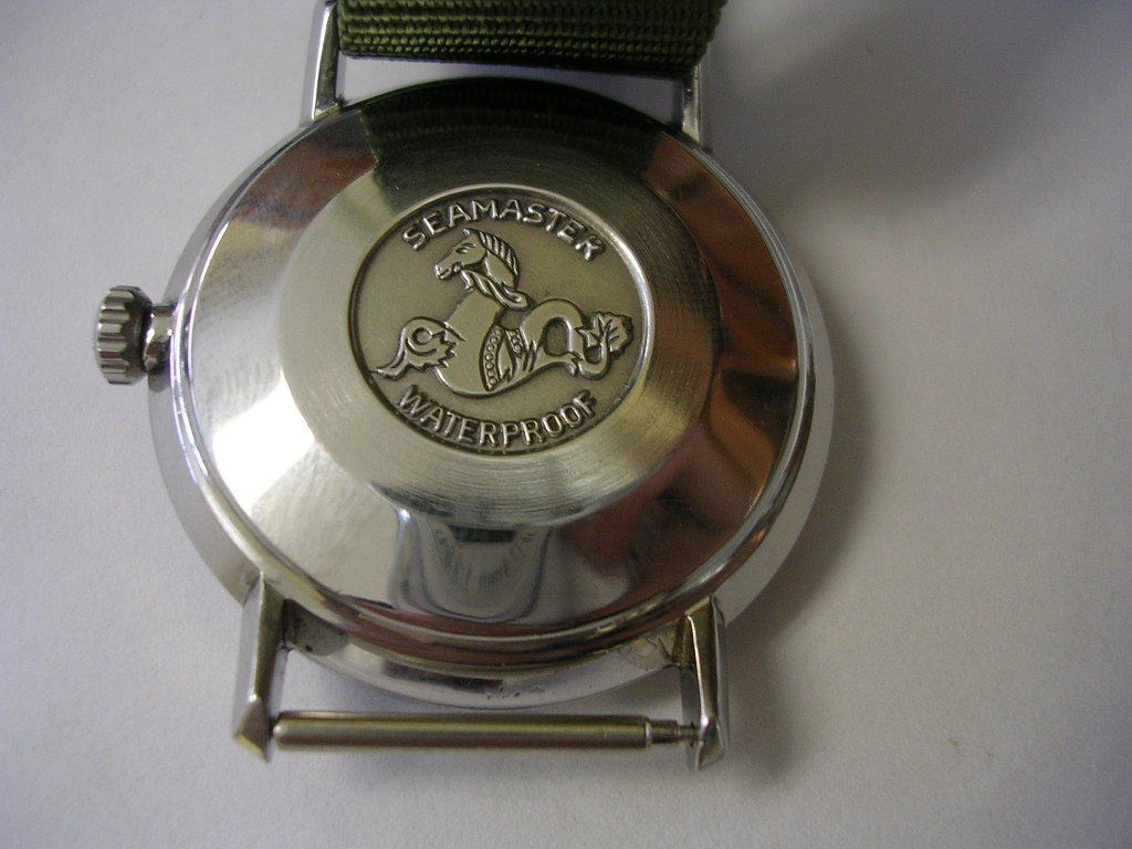

Great dial and original crystal but the case is very heavily polished. Uneven as well. The lugs have lost their bevel. On the case back, there is meant to be a protruding circular border around the hippocampus but it is missing.
EDIT: added an example (photo from google)
You have to factor that in and consider hard if it will bother you. I thought it wouldn't when I first started collecting but boy was I wrong.

just something else, may be not very important, the 565 has not this regulator. Lokks more like a 552 one. Not important unless it means the movement was changed

That’s a different case.
Can you elaborate?
Edit: I searched for several examples of 166.020 on this forum and it has the either this caseback or one with the “waterproof” word outside the circle. Regardless, they all have a protruding border.

Can you elaborate?
In your example the level of the base of the medallion and the case outside the lip are the same, which means if you remove the lip the emblem would flat with the rest of the case, while in OP’s watch it is pretty deeply sunk and the top of the hippocampus is level with the case, which means that there is no way to go from your example to OP’s by removing metal around the medallion.
Besides it just doesn’t look polished, why would you need to polish a case back so heavily that such a big lip is completely removed while the hippocampus still looks so thick and defined.
Can you elaborate on what you're seeing wrong here?
Both 552 and 565 have the same regulator... Part 72205501331
Pointer is 72204701332 for both.
I've seen both these styles as well.

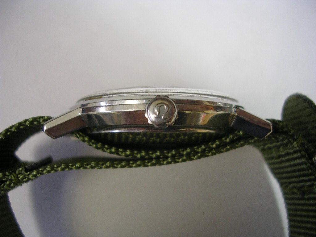

I also think it's only the lower right lug that appears to have been damaged and then heavily polished (not brilliantly). The other lugs are fairly sharp but have clearly seen a polishing wheel at some point. As @cristos71 says, depends on the price 🙄 although it looks a nice watch overall.
I think he means the swan neck adjusting spring, part 1356, sometimes you see it with the ball at the end and sometimes straight. I think 5631356 has the round end and 5501356 has the straight end but just by looking at pictures online it’s not clear which calibers used which one.
Correct - however there is really only one part now available from Omega, and that's the one with the rounded end.
Personally I feel this difference is being overemphasized - it's a "nothingburger" in my view and not a sign of anything nefarious. If I go back and look at the last couple dozen 55X, 56X, and 75X watches I've serviced, it's a mix and match with straight and rounded found on all different calibers.
