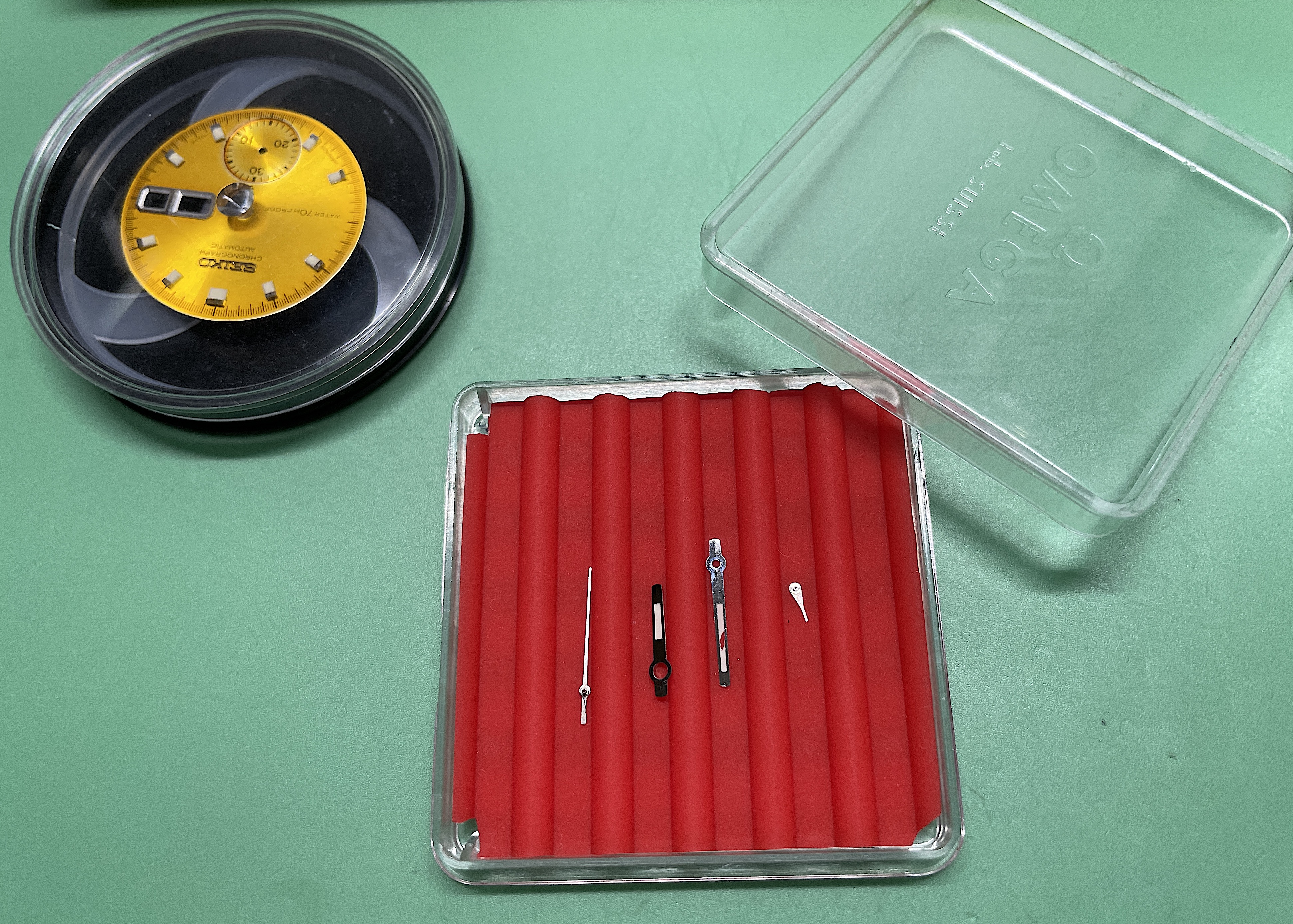

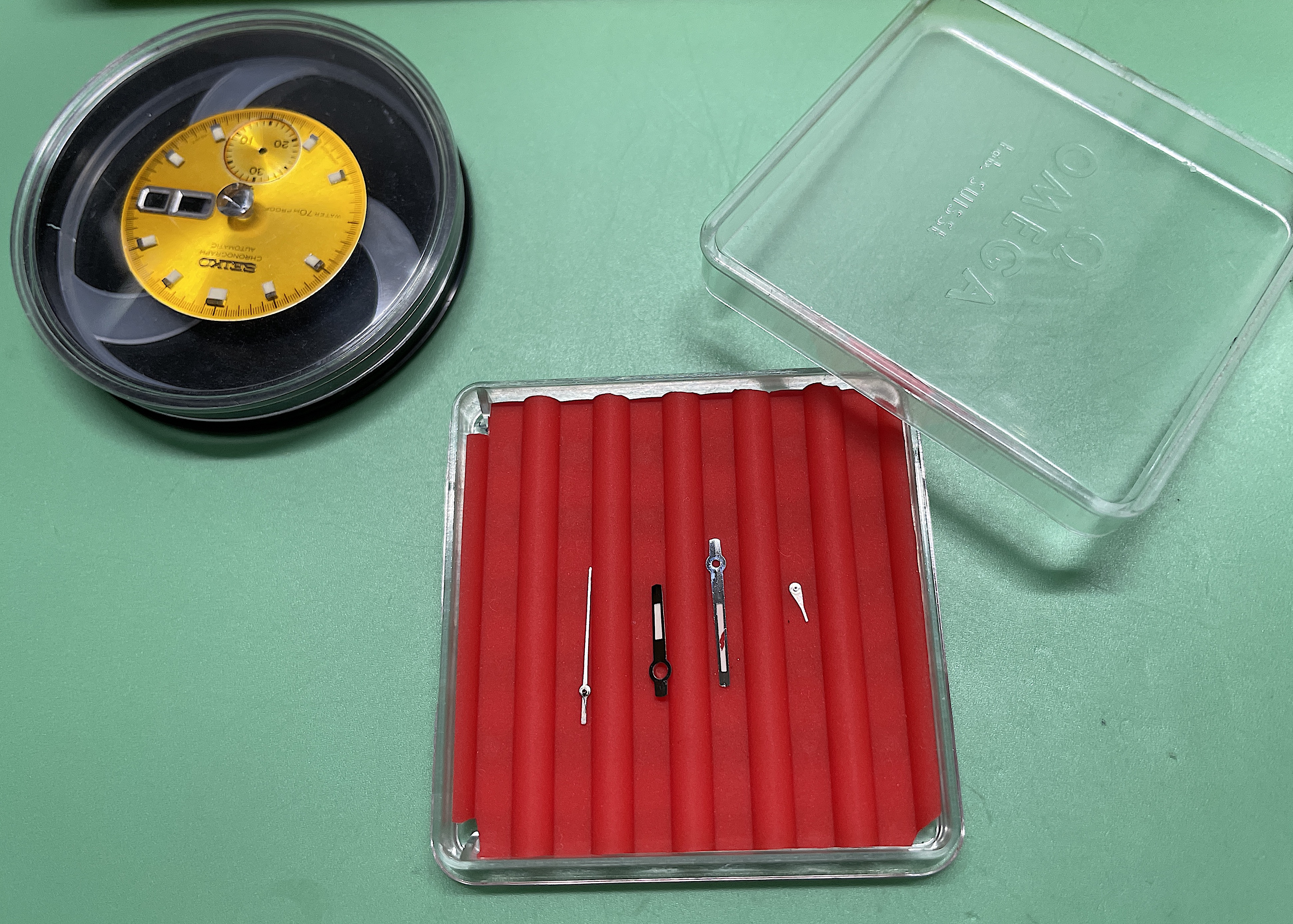

I have some of those cases that are the flexible films that suspend the parts, but I worry about using those for vintage hands as I wonder if it might stick to the lume. I currently just put them into a small box, but I have no way to stop them from hitting each other other than being careful when picking up that box. Perhaps I need to look for a suitable container specifically for hands like I have for dials.
18,748
38,904
I made a few hand storage boxes using soft silicone mat cut to size.
An idea based on some of the examples shown by @Archer.

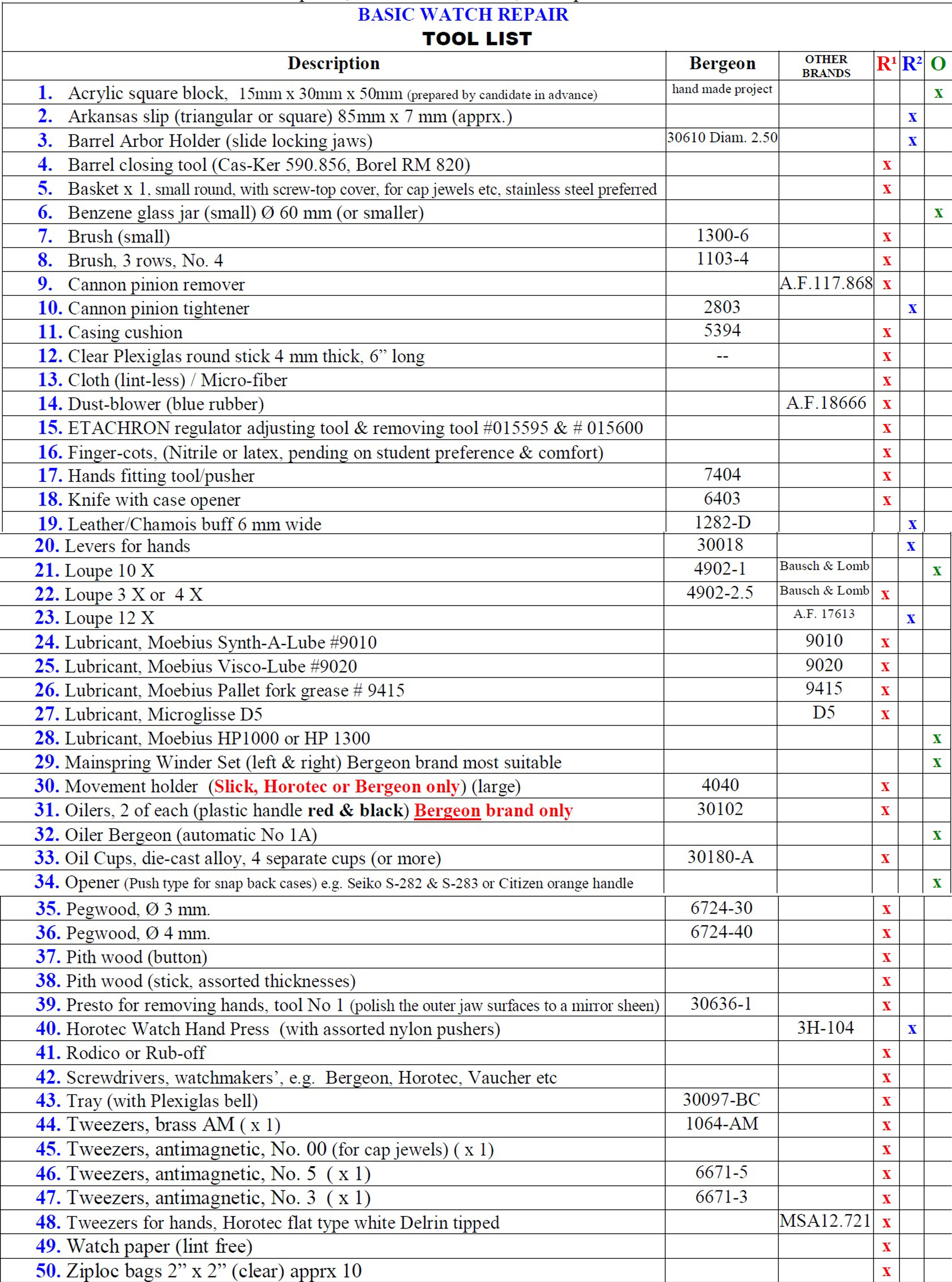

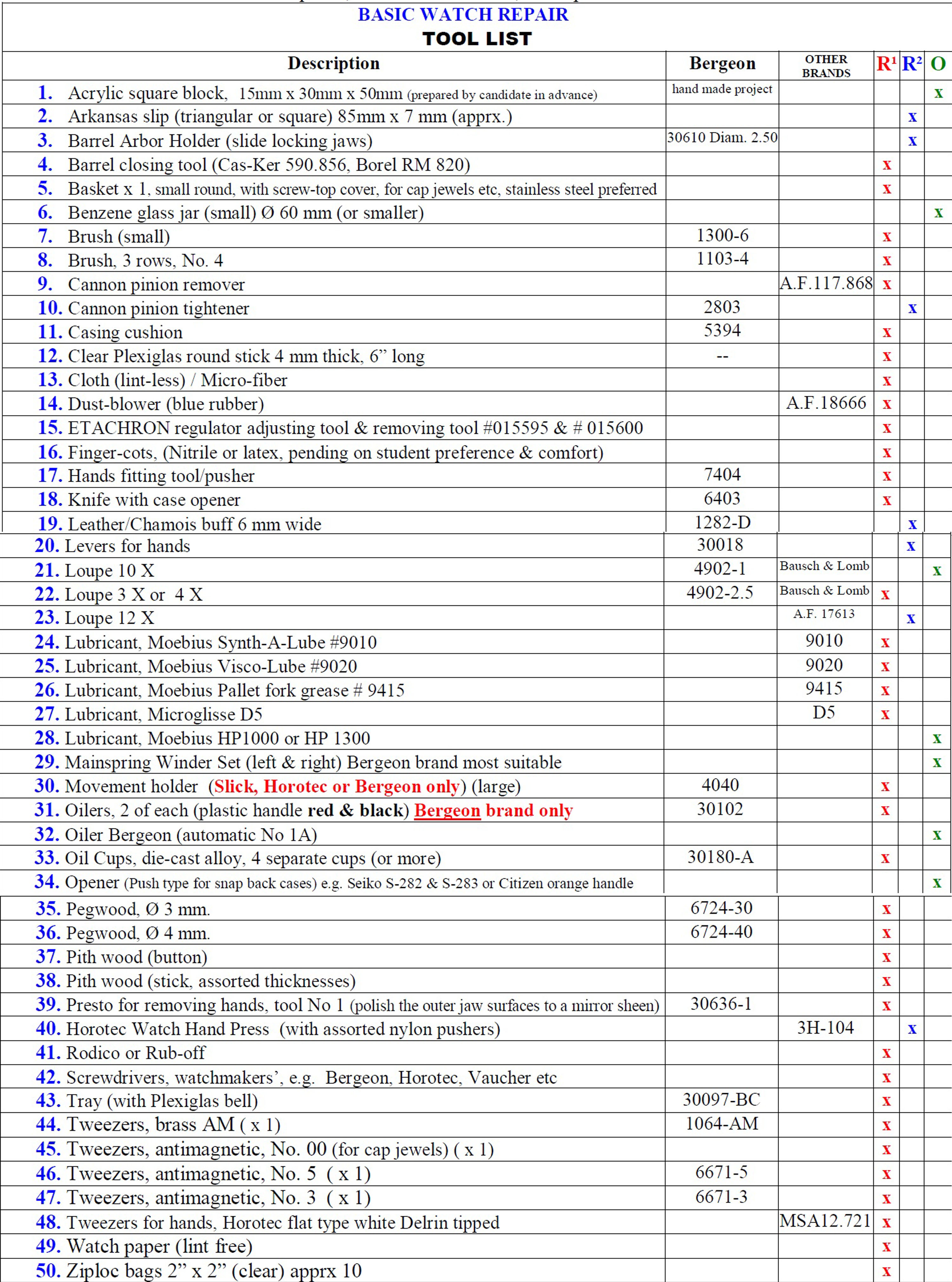

Is there somewhere in your watchmaker archive thread where you went over maybe a typical startup inventory for tools for an aspiring watchmaker who hasn't been to school yet? I was looking at starting out with a few chinese movements and pocket watches like everyone has said here. Obviously this isn't a cheap hobby but knowing the entry point might help us older new guys who are mechanically inclined.
30,192
77,939
No, but this is a tool list that came from the AWCI many moons ago, for their basic watch repair course (the beginner course). I'll drop it in as a photo that you can click on and download:
Some are required, some not so much, and some purely optional, so here's the breakdown:
R¹: Required
The items in column R¹ are the most important and you should have these for this course, or its exact
equivalent, unless otherwise specified. The brand name & number are given in order to facilitate with your
order.
There are always exceptions to certain items, such as a loupe. Obviously, if you wear spectacles and you
have the type of loupe that attaches to the glass frame and you are comfortable with this setup, you do not
need to buy extra loupes as per the list above.
R²: Recommended,
Any item in column R² implies it is recommended but not absolutely compulsory i.e. it would be preferable
if you possessed them, but if for any reason, they are not available, this should not present a major problem.
Also, it could be that you are more comfortable with a similar tool.
O: Optional
Items in column O are, as mentioned, "Optional", i.e. if you have
them, you may bring them, if not we have some in the classroom to lend, or you may use a substitute.
If you want to do the job properly, the "required" items are sort of the minimum you will need to service a basic movement.
Cheers, Al
