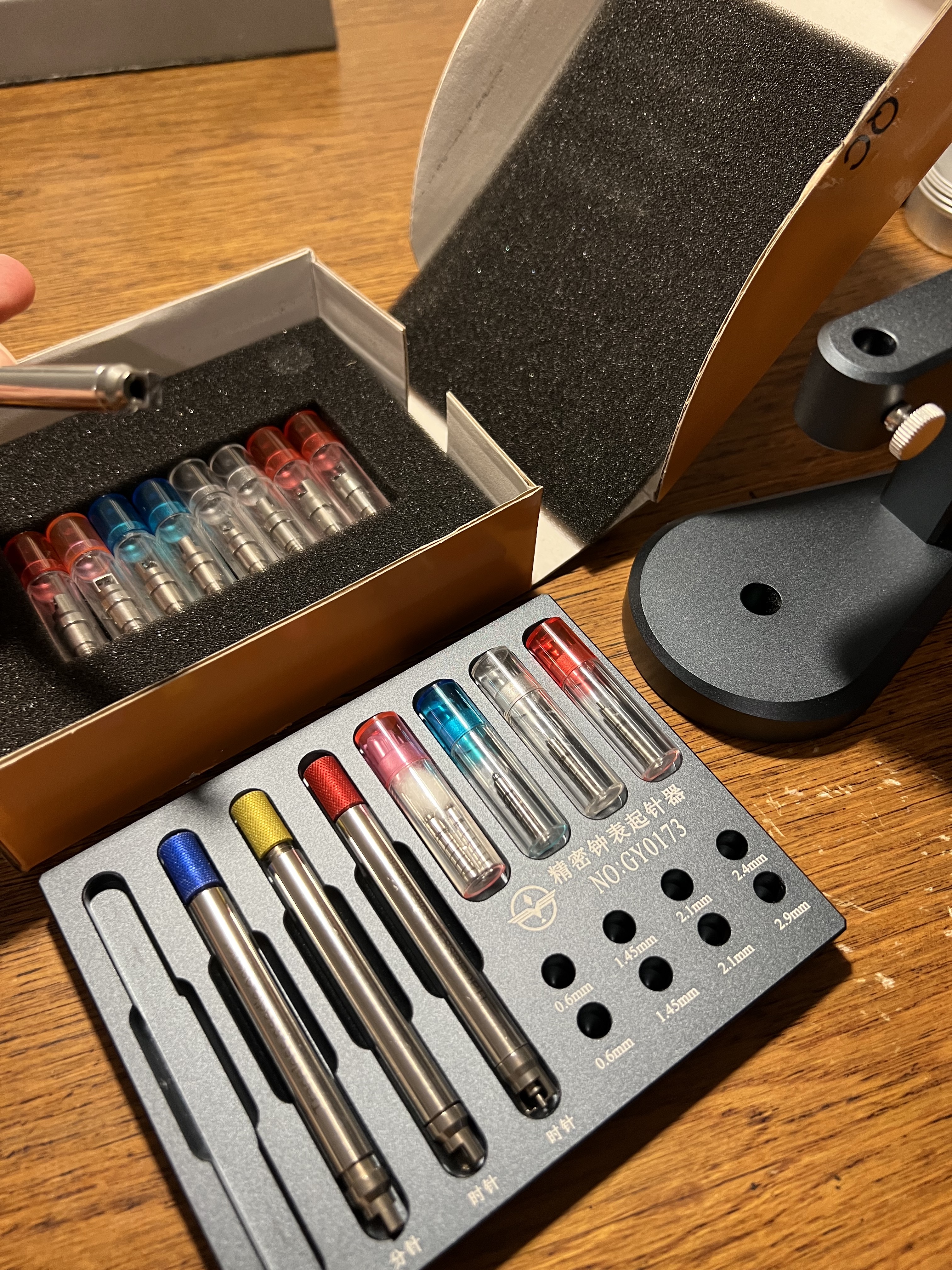

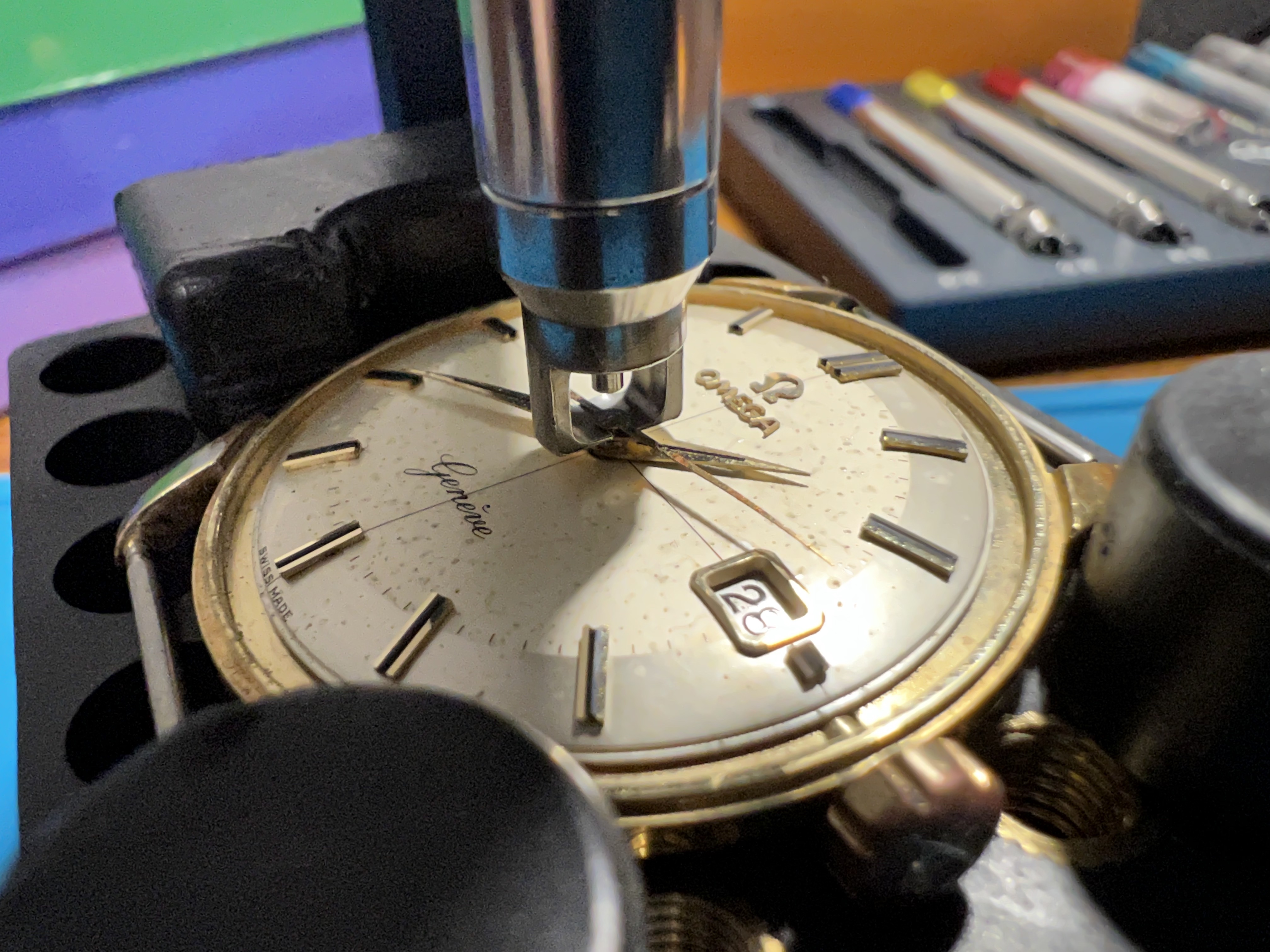

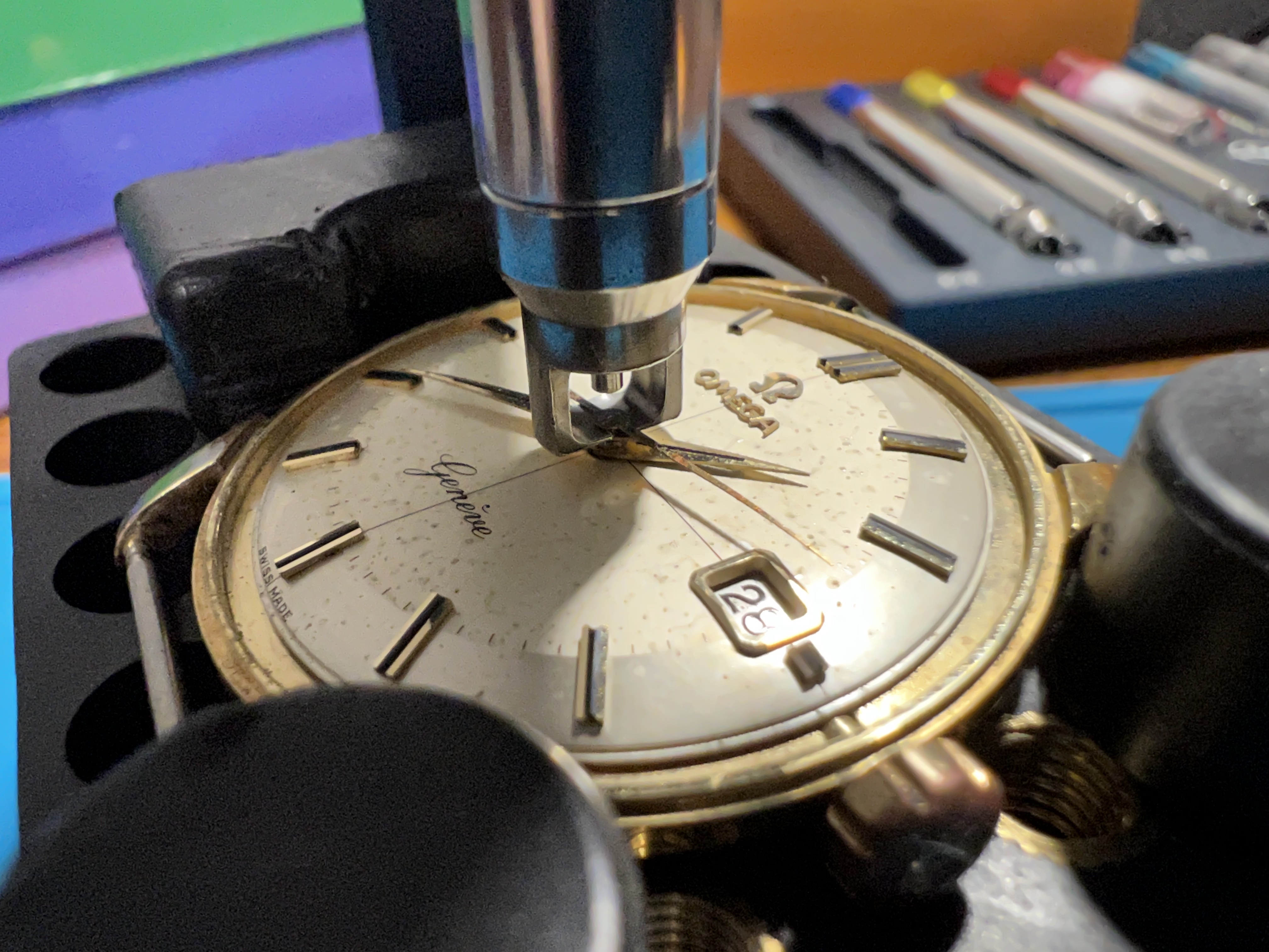

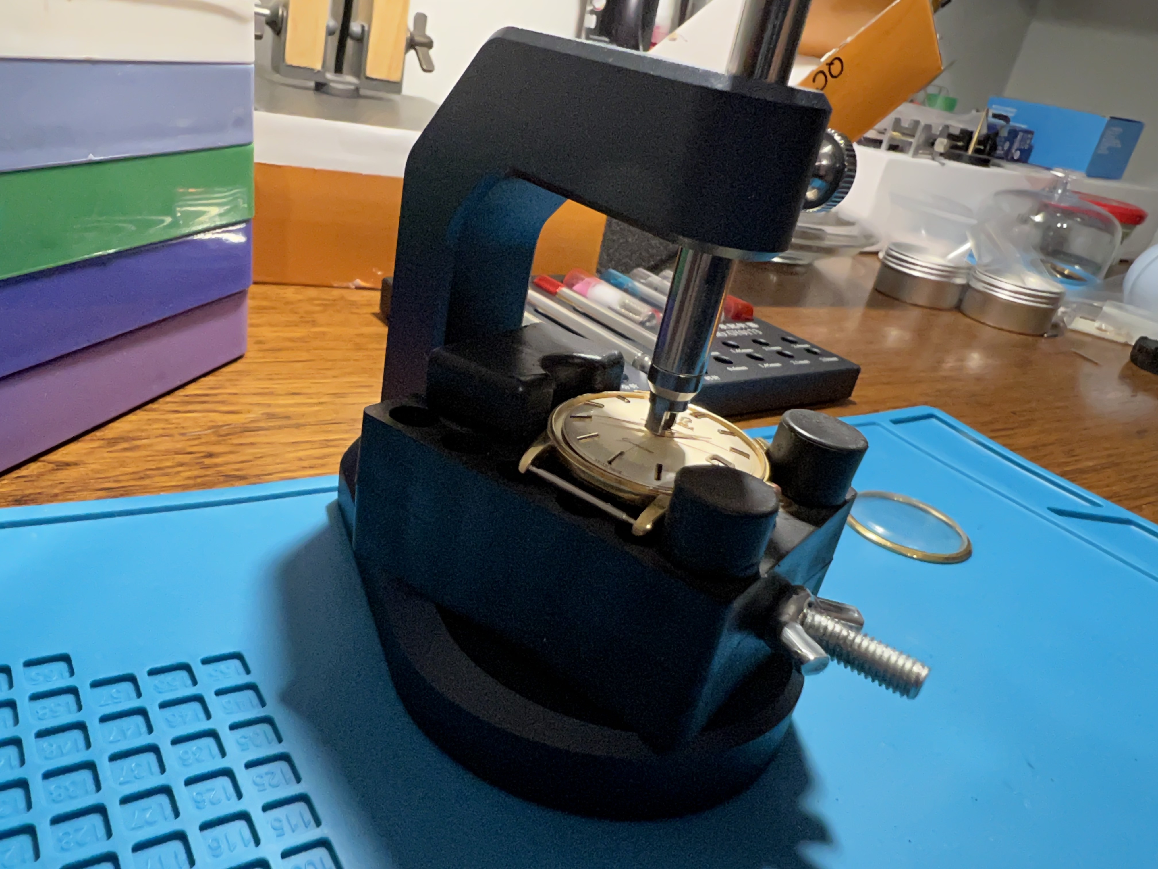

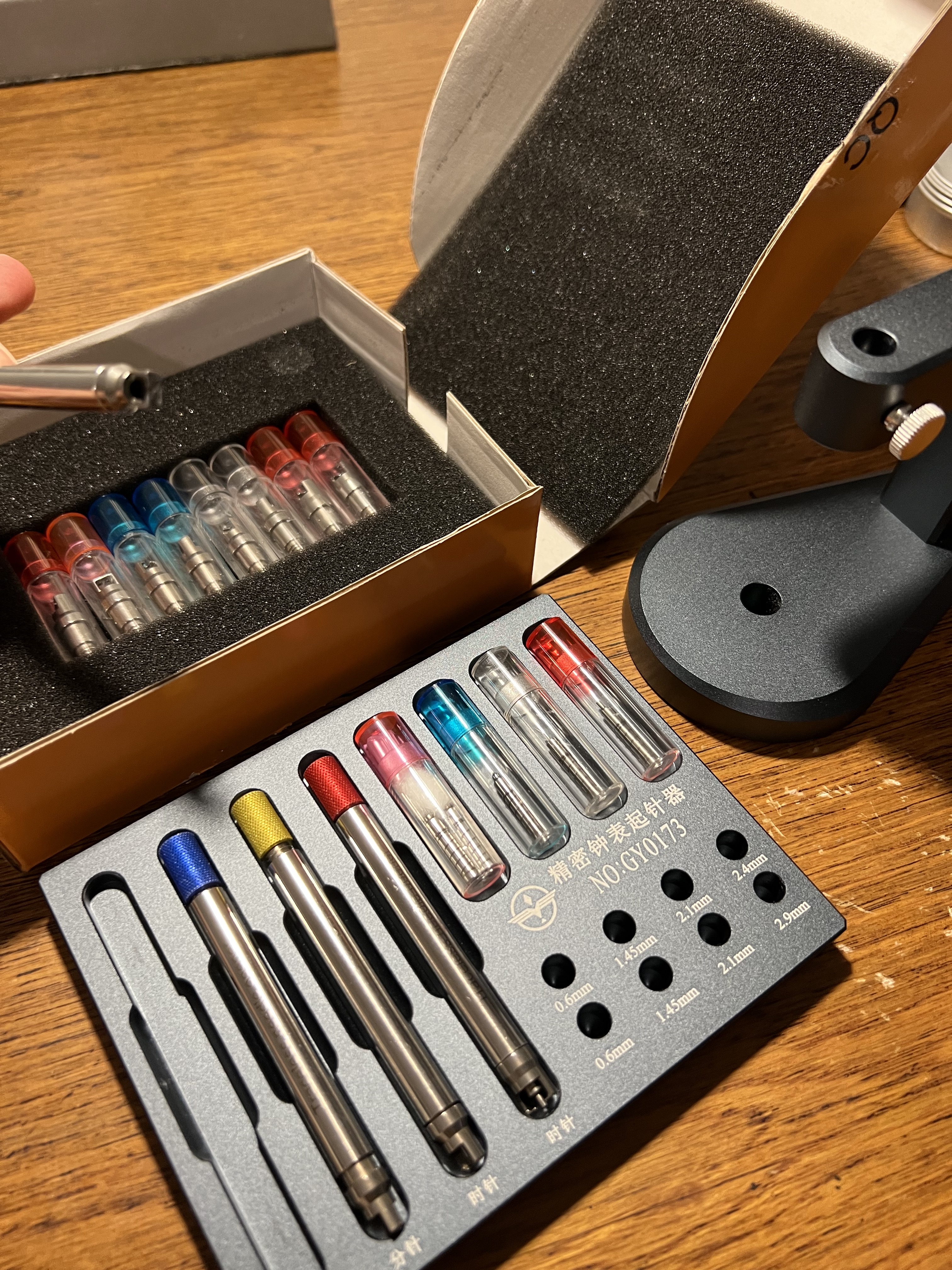

The sizing isn't optimised for Omega's, but still extremely useful - the 500 series hour hand is 1.5mm on the inside, the closest lifter is 1.45mm - I started extending one of the spares with sandpaper, however ended up using a bigger size
No damage to the naturally damaged dial, even without using the internal clasping mechanisms, it's pretty useful just as a lift - I only ended up using the grasp system for the seconds hand, the minutes hand was easy too, the hour hand which is the critical one wasn't as breazy as I imagined, but this watch/dial particularly cuts it close too
This tool is really only intended for "delicate" dials. Not really meaning your average vintage dial, because regular levers can be used on those, and if you use proper protection, the dial will be fine.
These are more intended for dials that cannot withstand any pressure on them. A good example would be the Speedy Tuesday 1, which has lumed concentric circles around the sub-dials, so you cannot have anything touch the dial or the lume will be damaged. Another is Buzz's butt on the anniversary model, the hidden Ultraman logo on the ST2, dials made of aventurine, or MOP, etc.

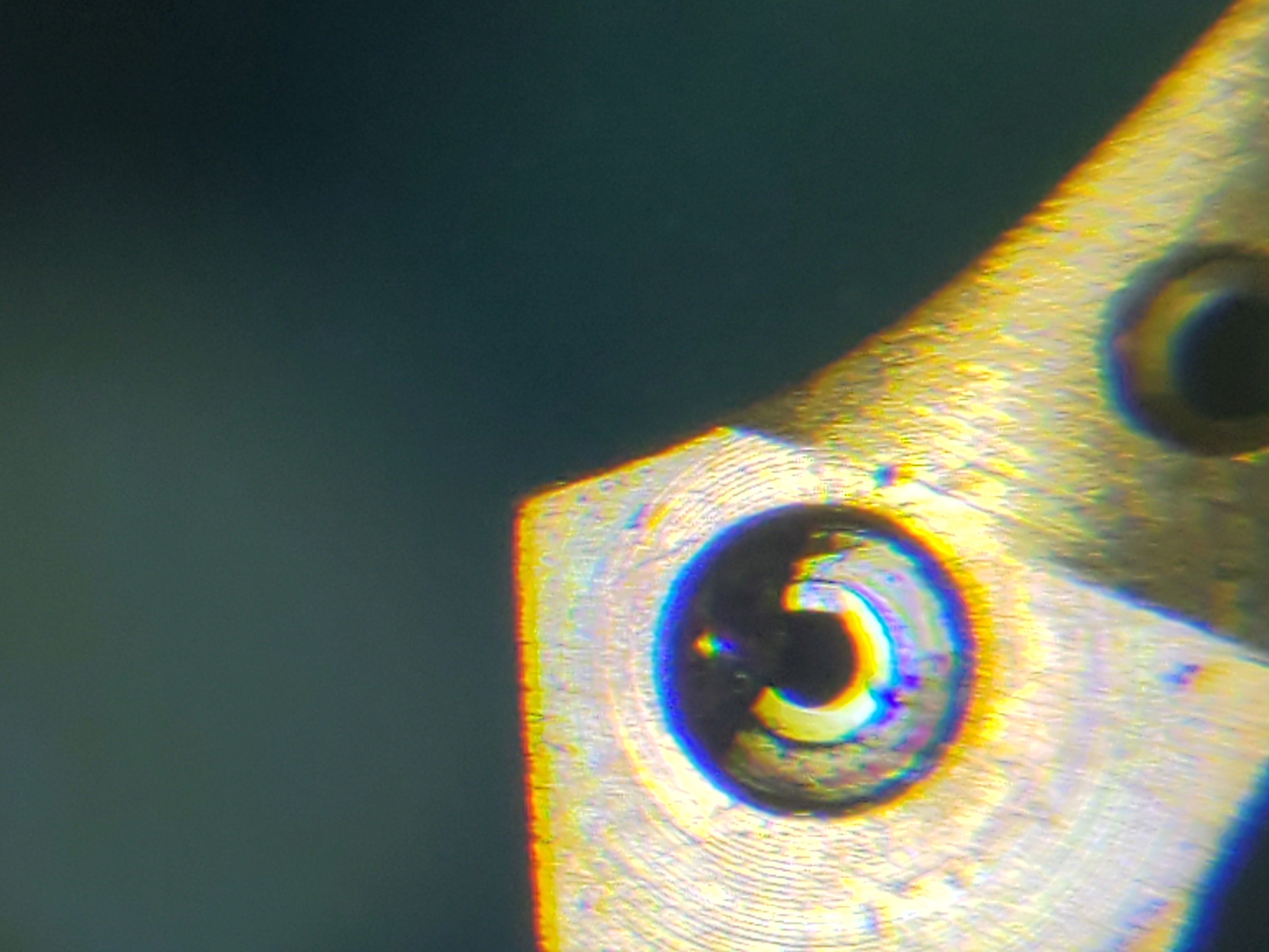

Speaking of tools, does anyone know of an alternative to a Seitz jeweling tool? I found a cracked jewel and ended up buying a replacement bridge, but I would eventually like to repair it and sell the old bridge or have it as a spare. I'm not sure if it's worth the investment of another few hundred $ for a tool I hopefully wouldn't use too often. But maybe I'm naive and broken jewels are more common than I realize?
631
788
Horia tool
I found some cheap knockoffs on eBay that seem okay (as long as the micrometer is reliable) except they don't come with reamers. If money were no object I'd bid to win this supposedly complete k&d staking set (which I'm sure I'll require before too long) with jeweling attachment.

Same set I have, but I wouldn’t use it for jewelling personally. It will work in a pinch but there are better dedicated tools.

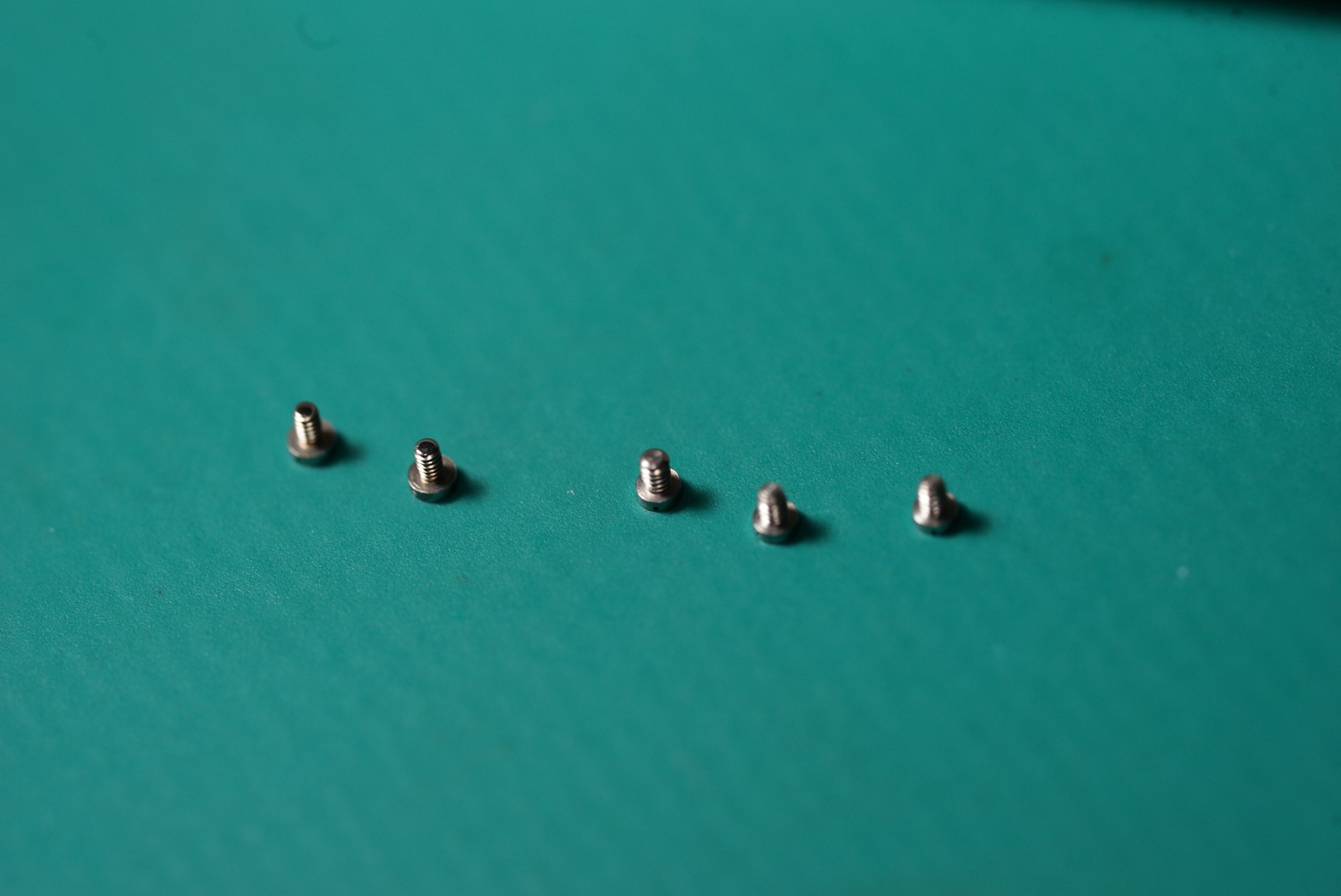

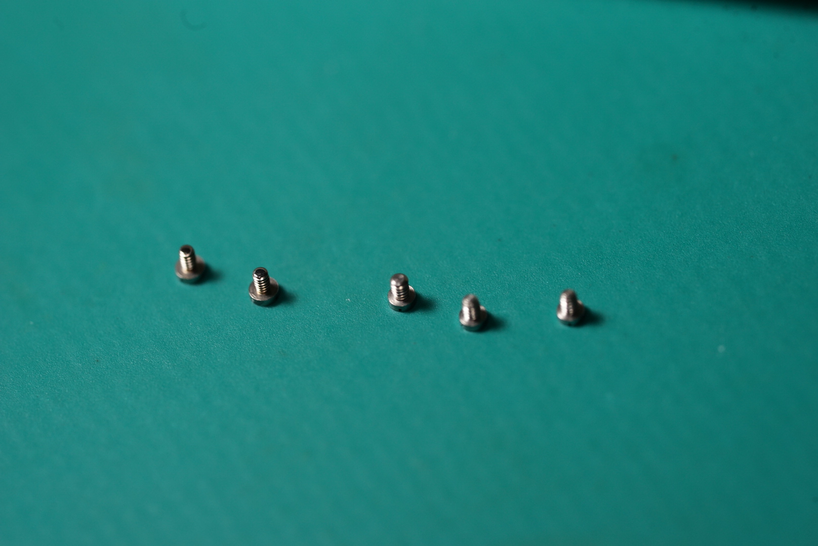

I remembered that @Olhenry56 mentioned identifying screws when I was sorting the screws post cleaning of this cal. 752
This is what I meant when I mentioned checking the bottom of the screws, the balance cock and train wheel bridge screws look a lot like the screws for the lower automatic device bridge (short) but you can tell them apart by the polish on the bottom!

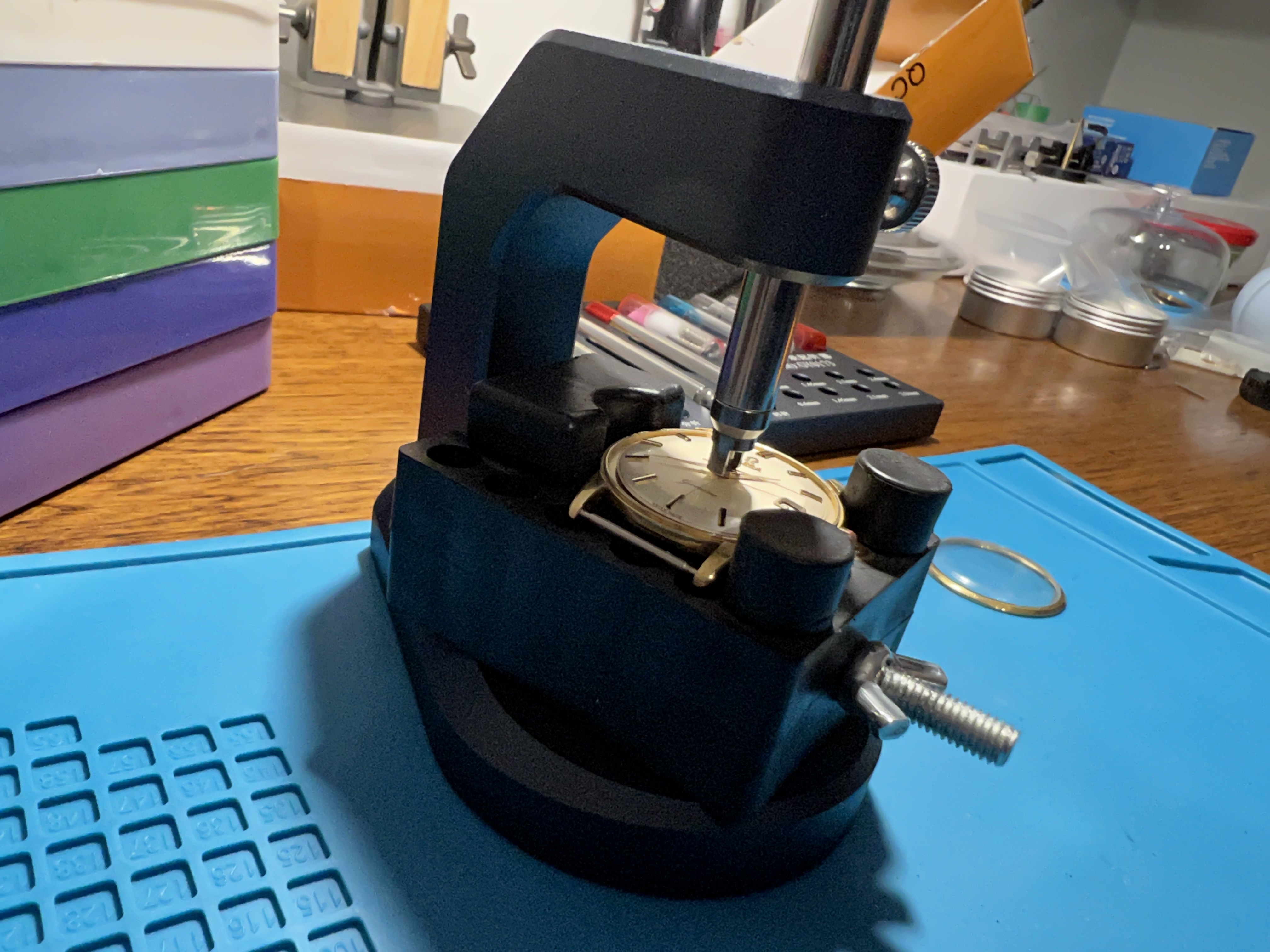

An interesting tool. I mostly use levers or Prestos, but this would be useful for delicate dials as noted by Al.
How do the jaws operate? Do they open/close, or do you have to slide the hand into the gap and lift?
2,677
3,151
Slide into a good position, optionally screw the top to get a grip and lift
Only for 550 series seconds hand lifting, I found the screw gripping useful, one of the pushers have a hole for the pinion needle
But for the hour and minutes hand I have no idea what they would achieve
Obviously I might not be using them as intended, but even so it makes life much easier for me
Edit: Basically the stand is static, you can tighten the lifter to a set position, and the lifters themselves only have one action, when you screw them, they can push one of the pushers you choose onto the hand you gripped
I didn’t use the stand tighteners and instead pulled directly with lifters

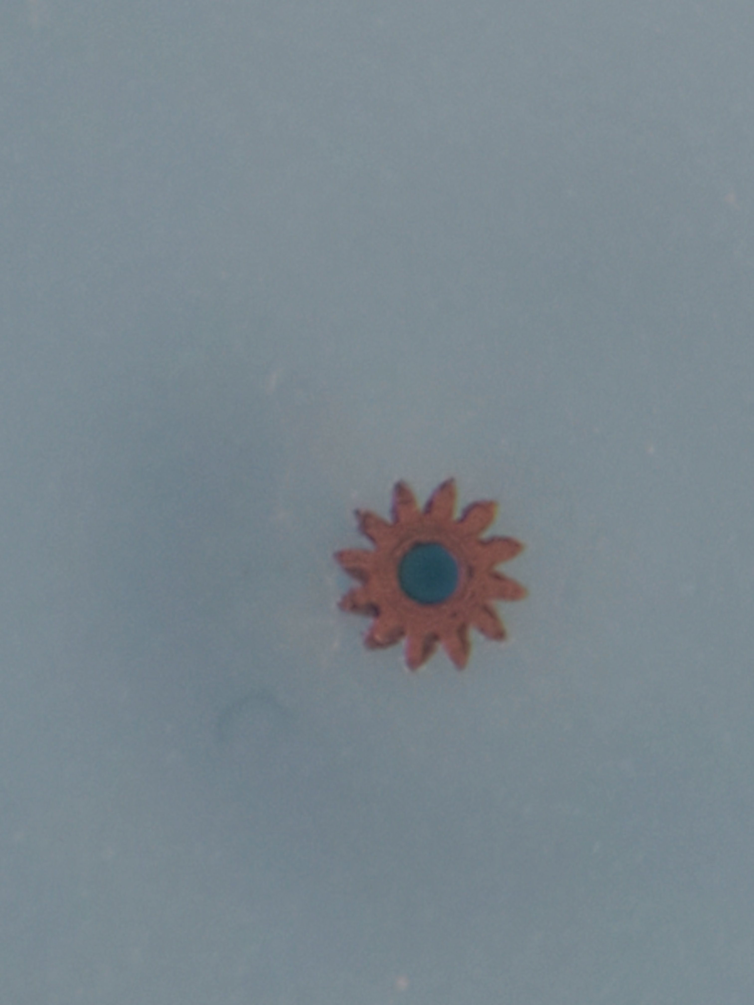

Setting a cal 471 I have causes the hands to rock (side shake, I suppose). I took a look inside and the best I can figure is that the cannon pinion is worn. In the photo, the cogs seem to be twisted slightly. Does this commonly cause this kind of problem? Or maybe the interior diameter is too worn? Or probably both?
Thank you!

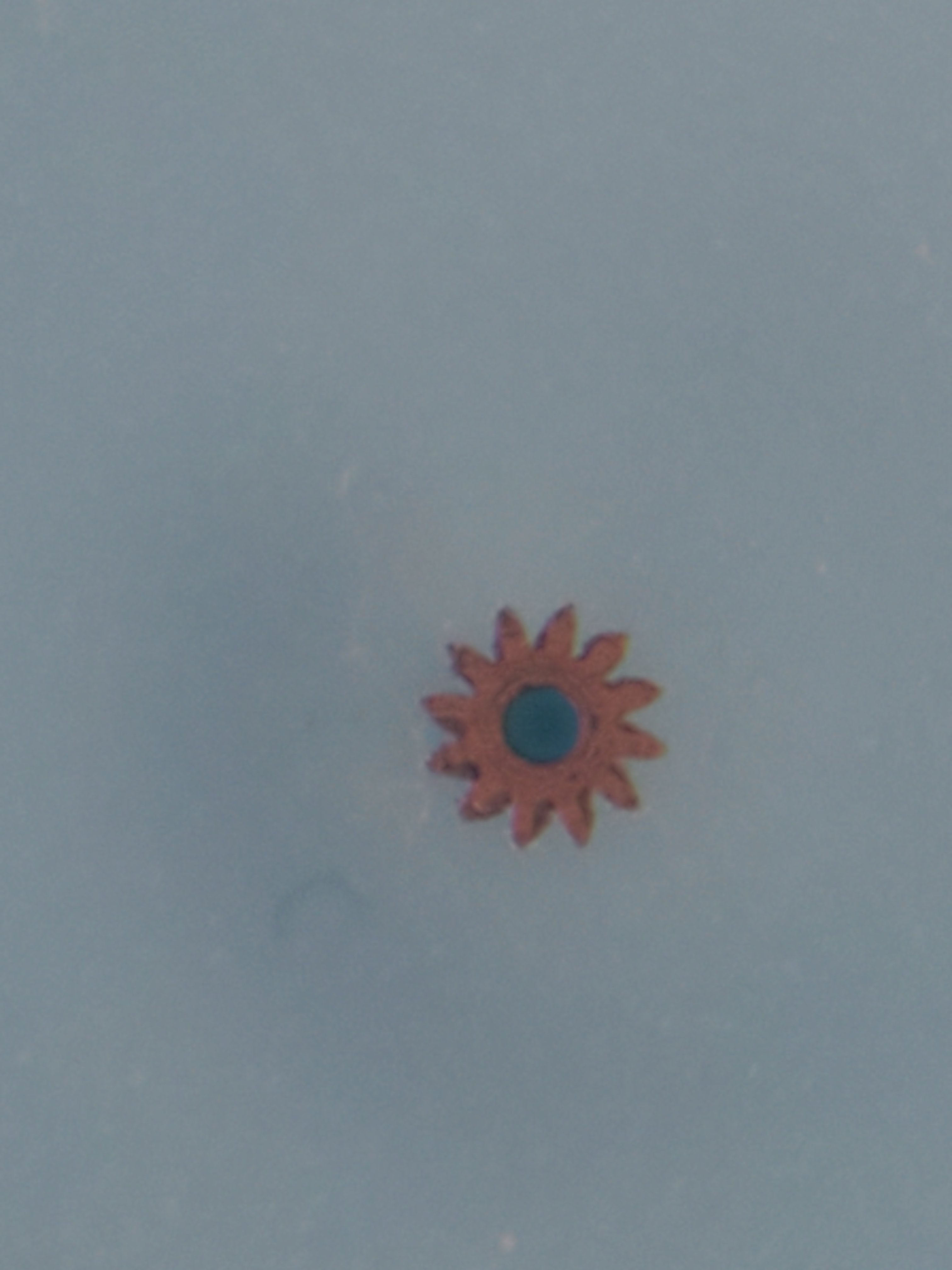

Is this what you are seeing?
If so, the cause is most likely the hole in the main plate where the center wheel passes through being worn oval. Repair would be to bore the hole out (while maintaining the original center) and then install a bushing.
631
788
Yes. I tried moving the center wheel when the cannon pinion was removed, and it would not shake, but I suppose the cannon pinion puts much more torque on it than I did.
Do you think the cannon pinion is flawed and caused the hole to wear oval, or is that just something that happens over time regardless?
Looks like I get to buy some new tools. Thanks for the guidance.
30,192
77,939
If the cannon pion has damaged or worn teeth is a different issue entirely. The hole in the main plate wears from lack of servicing over the years.
