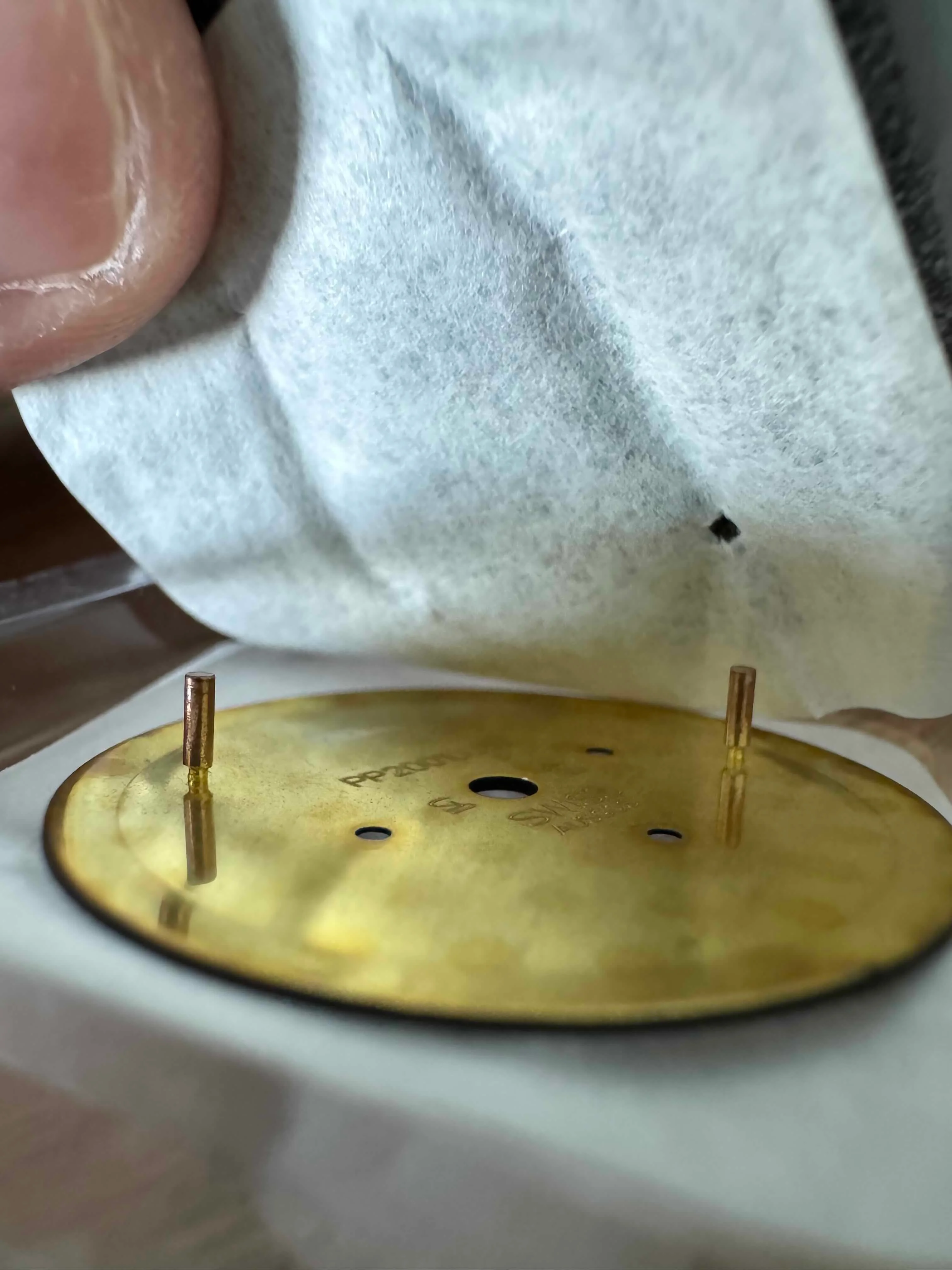

It's quite interesting, I originally referenced this post by Archer showing the difference between the 321 and 861 feet in telling the watchmakers what would need to be done. I thought the thicker base of the 321 dial would be an issue in trying to reduce the diameter, but when I opened the packaging the current Omega 321 dial feet looks a lot closer to what the 861 example was with the thin bit of solder/weld(?) at the bottom attaching it to the dial. Shouldn't be an issue for any watchmaker with the appropriate tool now the base isn't in the way of the diameter being reduced, but basically everyone I've asked seems to not have the tool to reduce the feet diameter, or just doesn't think it's worth the effort.
For reference - this is the backside of the dial with the feet. Same PP2001002A marking as the other dial, and Singer branding.

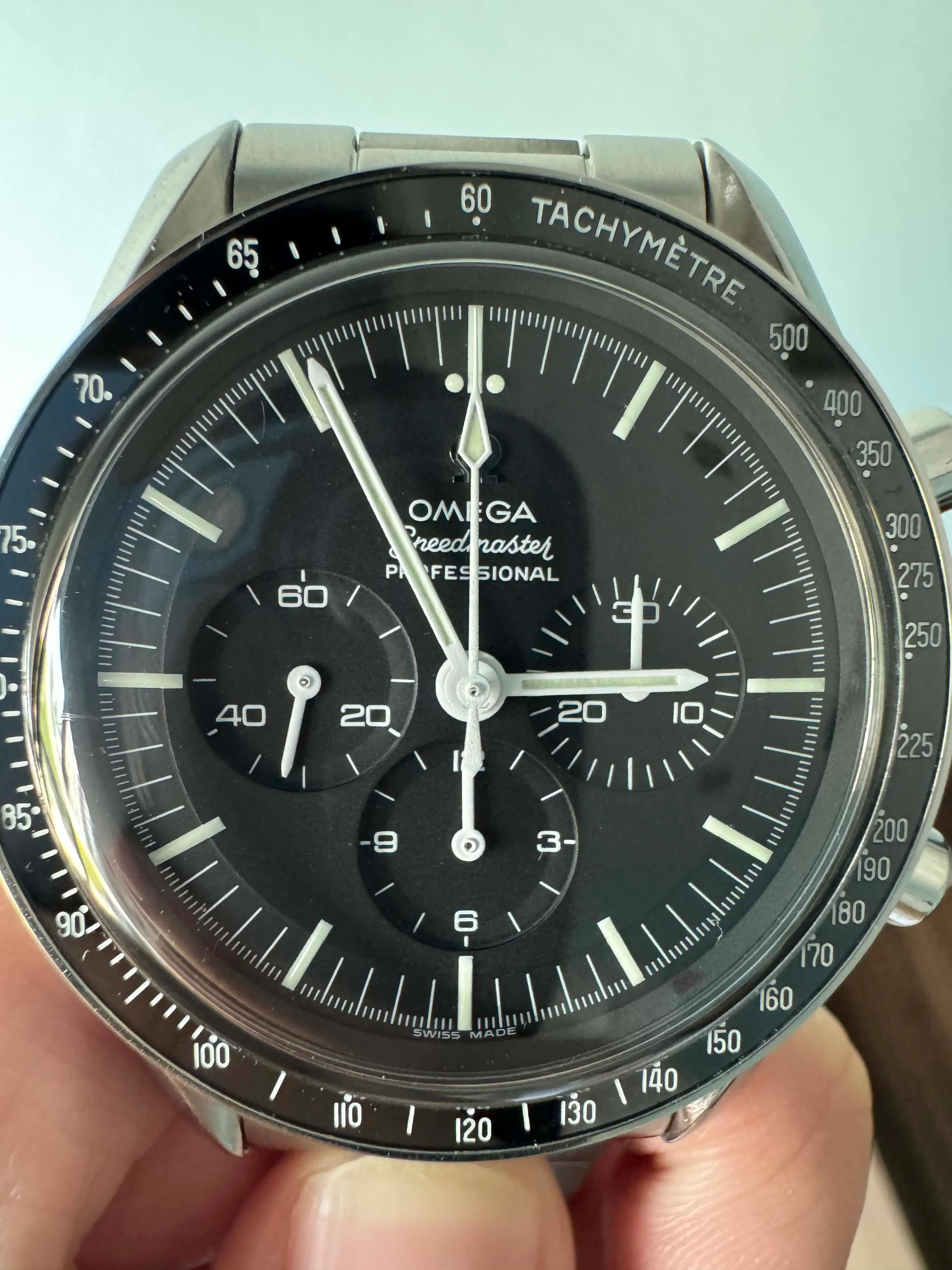

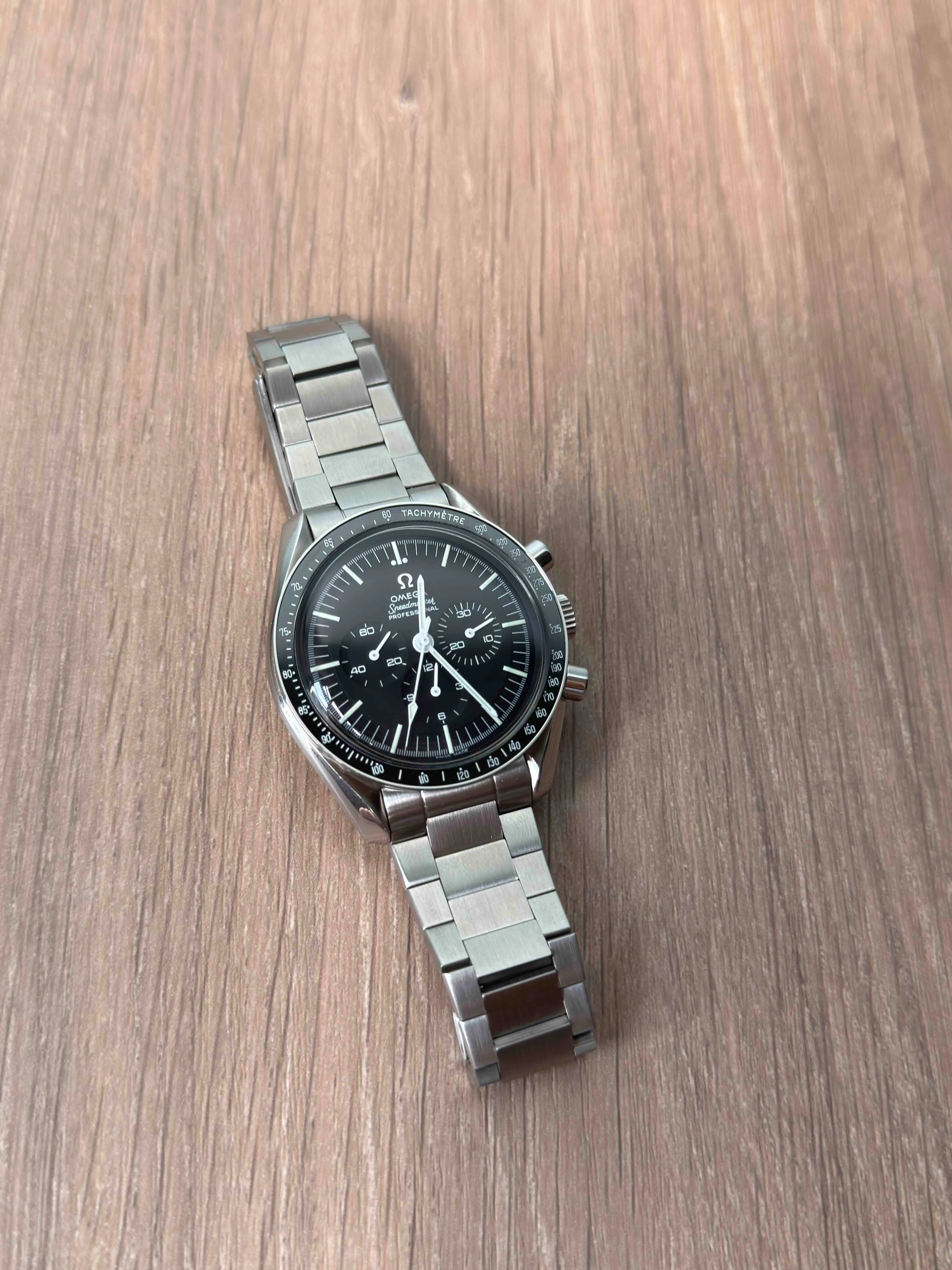

Hi everyone, thanks for all the tips. Went with Watch It! in the end to do the work as the other 2 service centres above also weren't able to modify the dial feet.
They didn't know about the Bergeon 30512 but were confident in being able to solder new dial feet on as in their experience only lacquered dials have issue with heat from the soldering (quoted the 321 dial feet as 1.13mm in diameter and the 861 dial as 0.95mm, if anyone would like to know). Price was quite reasonable at $200 for both dial feet, $80 to swap the bezel and $80 to re-attach the dropped minute sub-dial and adjust the chrono hand to stop it fouling on the minute hand - about US$280 in total for all the work. Handed them the watch on Monday afternoon, confirmed the dial swap was possible on Tuesday night, and got a message that the watch was ready on Thursday evening, so super fast as well.
Because every thread is worthless without at least a photo:
If the soldering did damage the dial, I can't see it (and please don't tell me).
Full list of mods:
  • eBay Japan special 3594.50 base (with case polish and recent service, but corroded applied logo, broad arrow hands, and dented bezel so perfect since I wasn't going to keep any of those parts)
  • Spiralwinder double-bevel display caseback and black ceramic lumed bezel
  • Omega service 321 teardrop chrono hand
  • Generic 1861 baton and subdial hands - subdial hands had to be adjusted to fit
  • Omega 064PP2001002A 2020 dated stepped 321 service dial
  • Forstner fully brushed flat link with new toolless microadjust clasp
  • I also have the Radial Project Apollo 15 radial bezel as a spare to swap when the reflectivity of the ceramic in sunlight gets on my nerves - it doesn't really fit with the whole "daily-able 145.012" theme I was going for.
Absolutely over the moon (pun intended) with the work and nice that it came on the Apollo 11 splashdown anniversary as well!

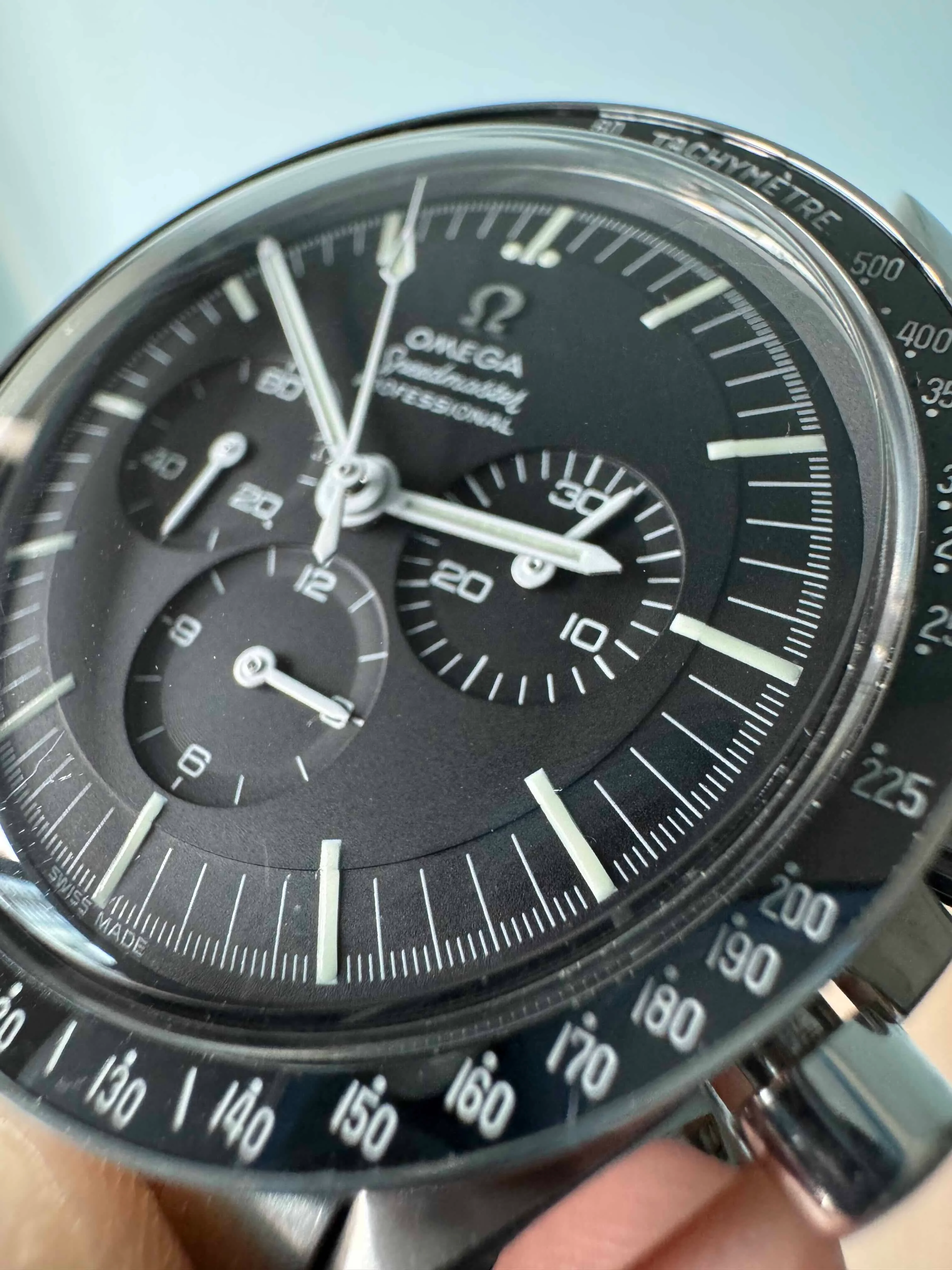

Hi Ron. The step is quite low and rather dependent on the light to show. Definitely not as obvious as the old dials, and can be easily confused for an earlier 2000s 064PP2001001A service dial without the step but with the normal curve at the edge.
Head-on in more diffuse lighting you can see a slight step where the shadow is (7-10 o' clock) but the rest of the dial looks quite flat:
If you turn the dial to the side slightly, the step is more obvious thanks to the sunlight causing a shadow at the edge of the step:
