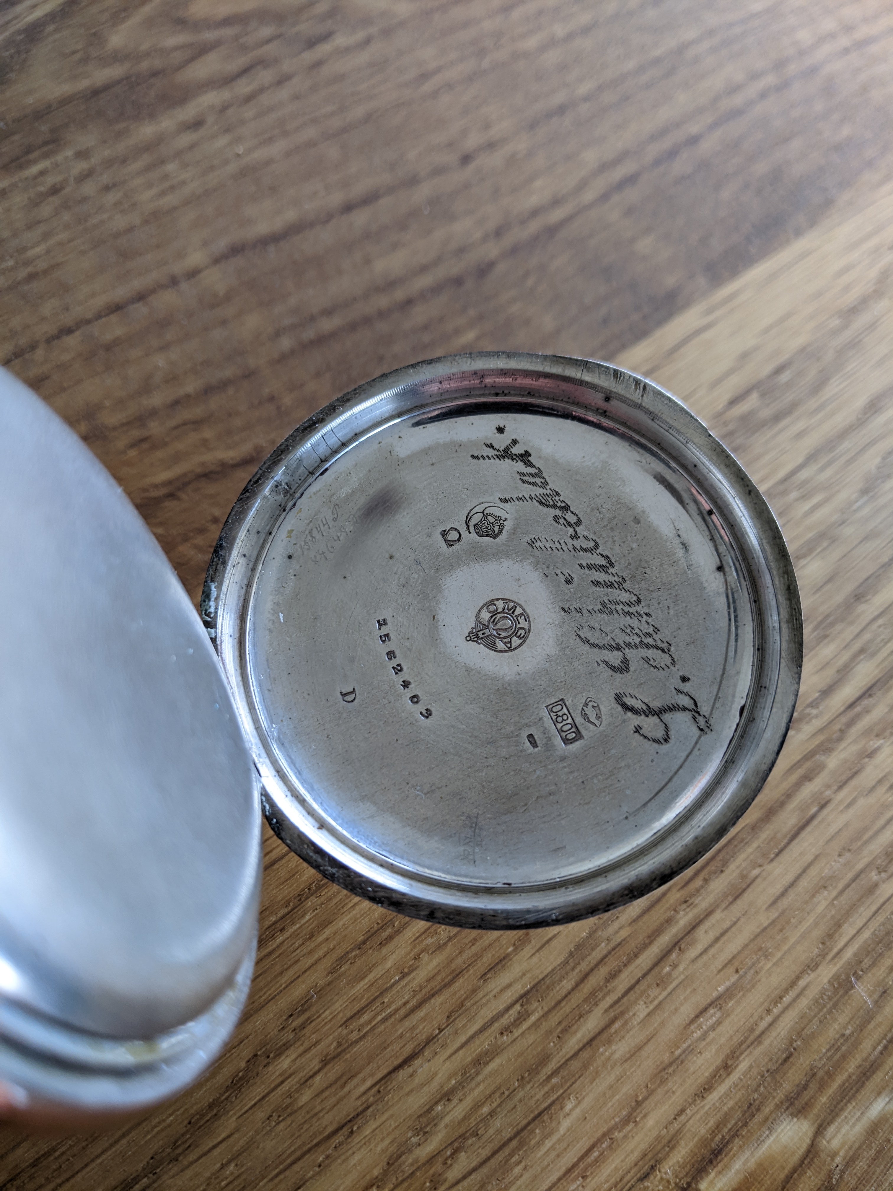

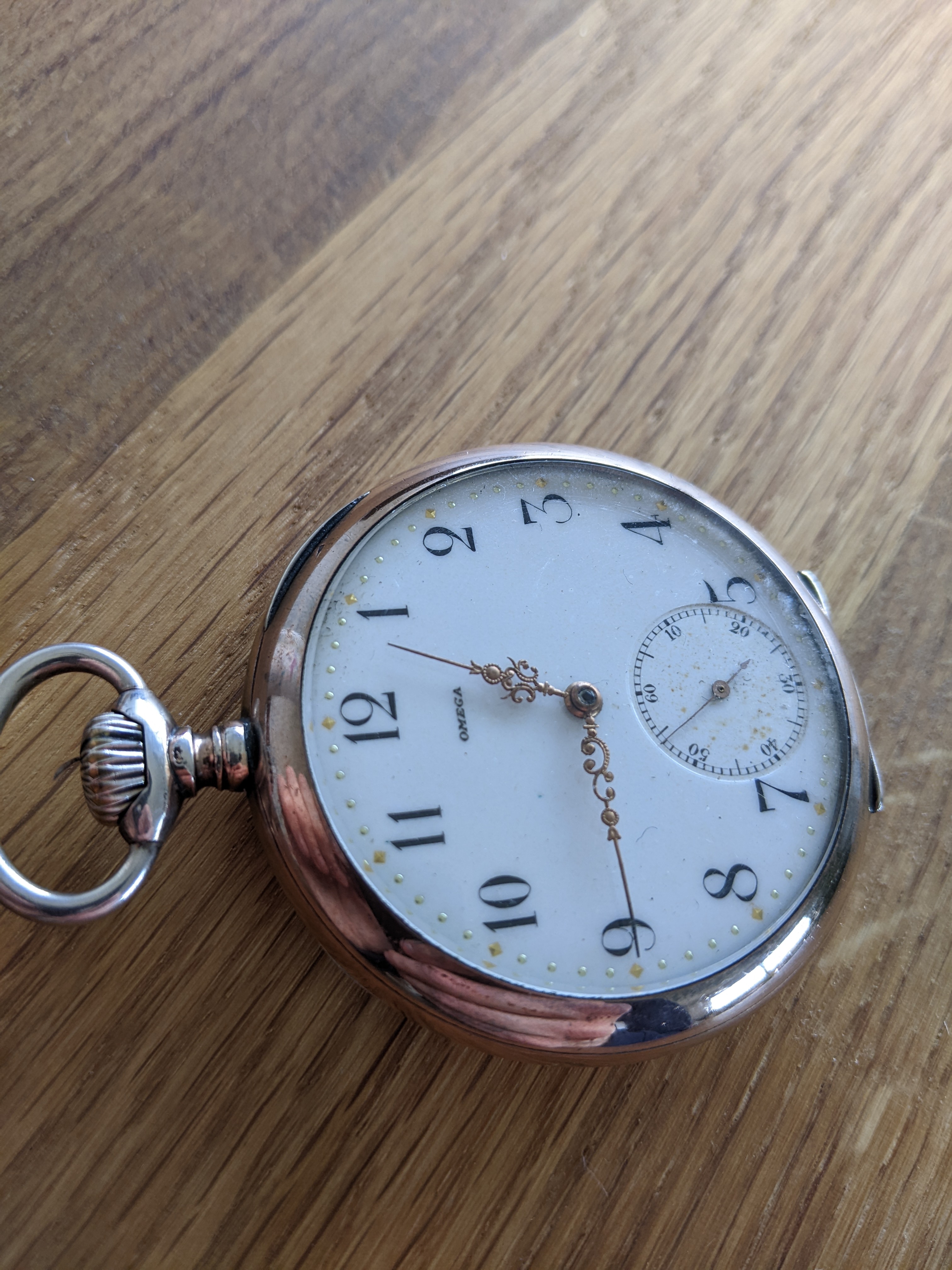

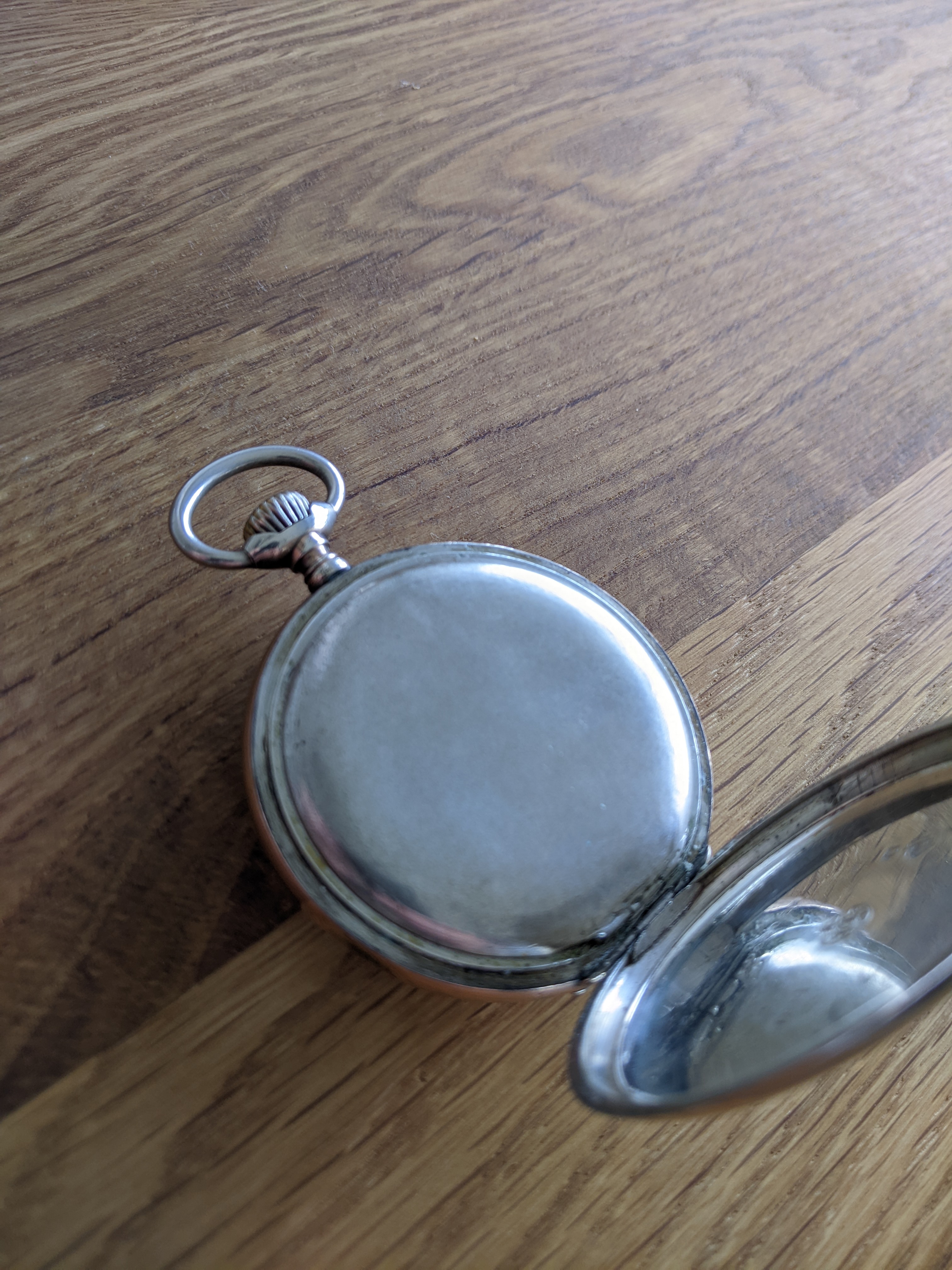

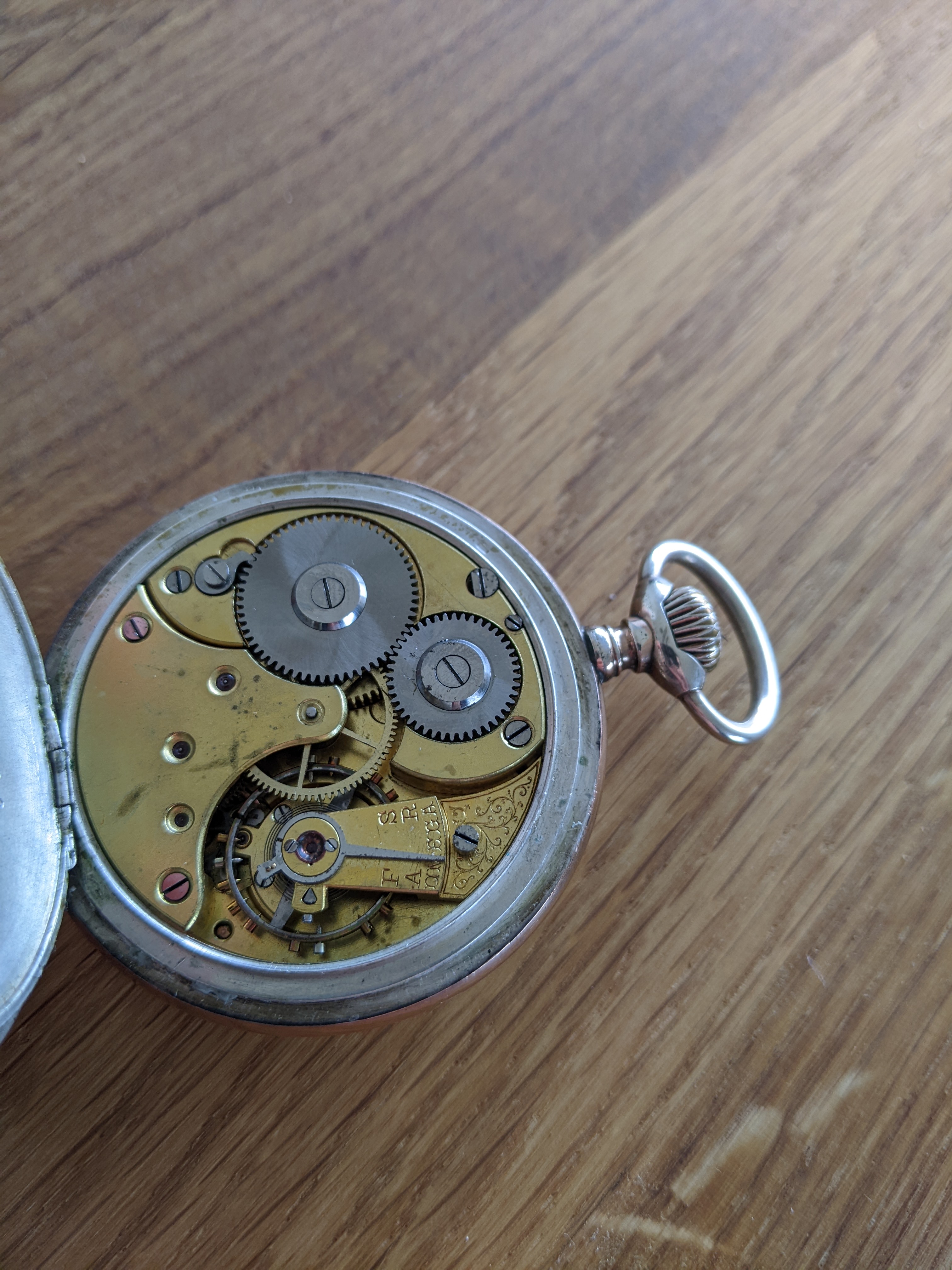

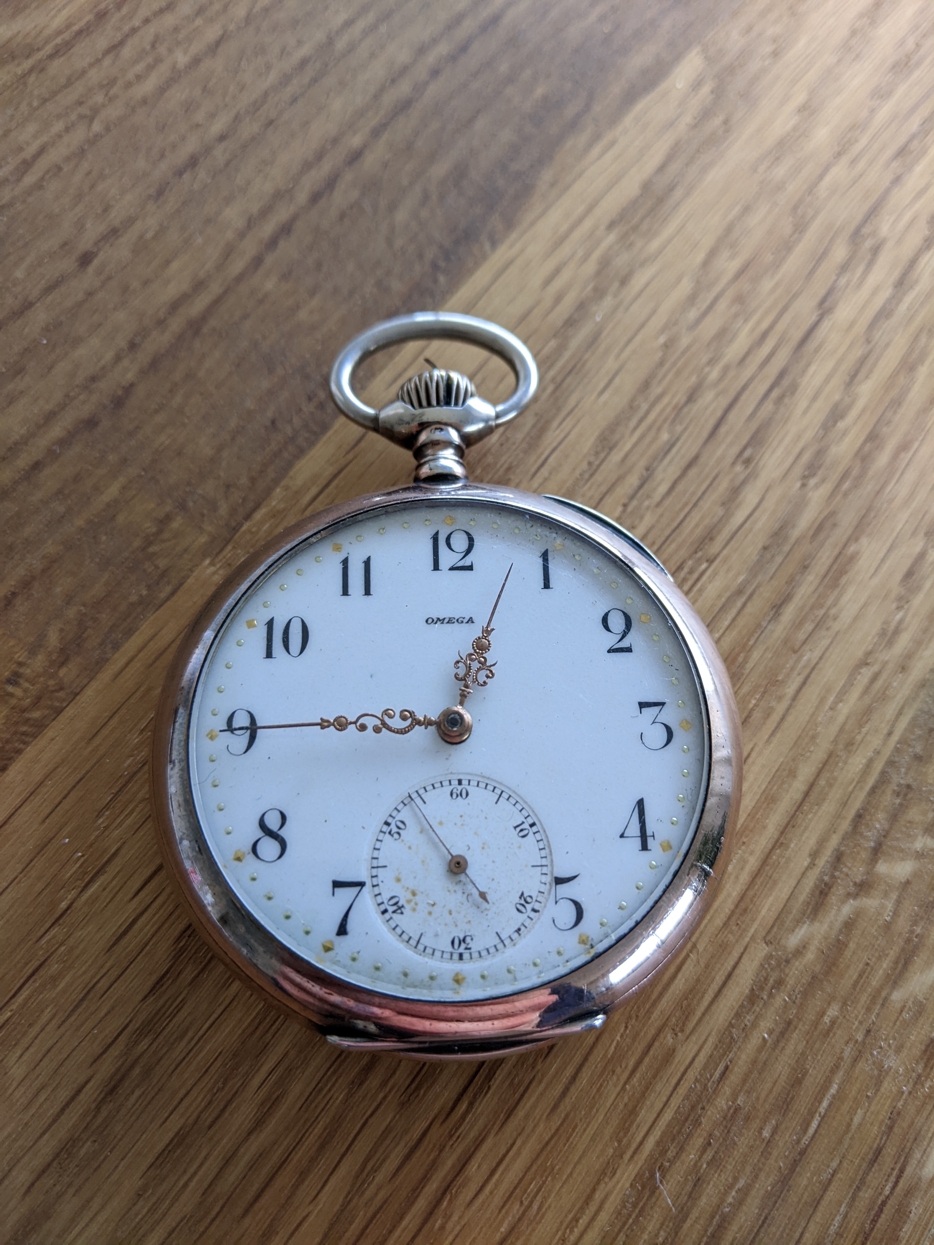

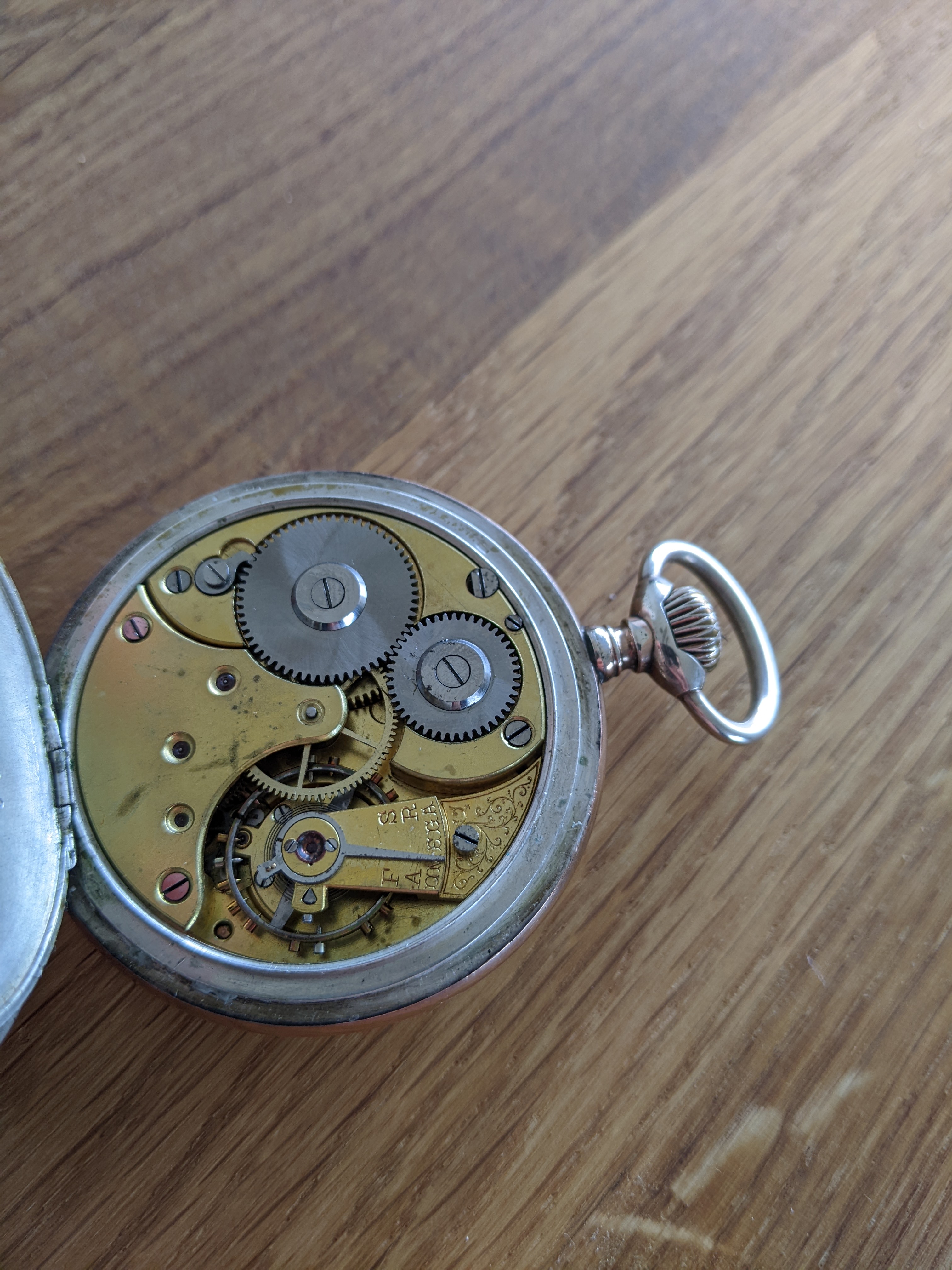

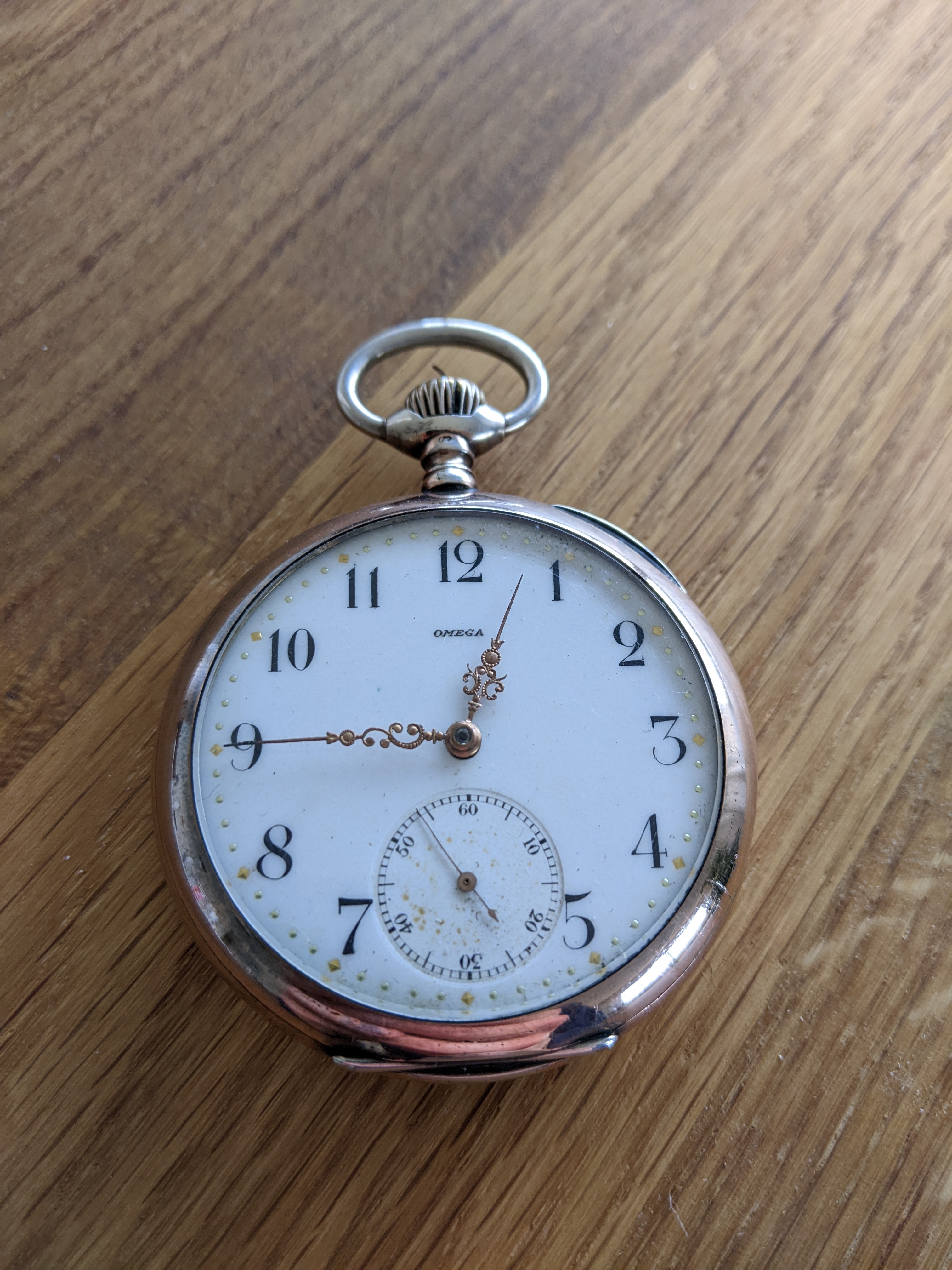

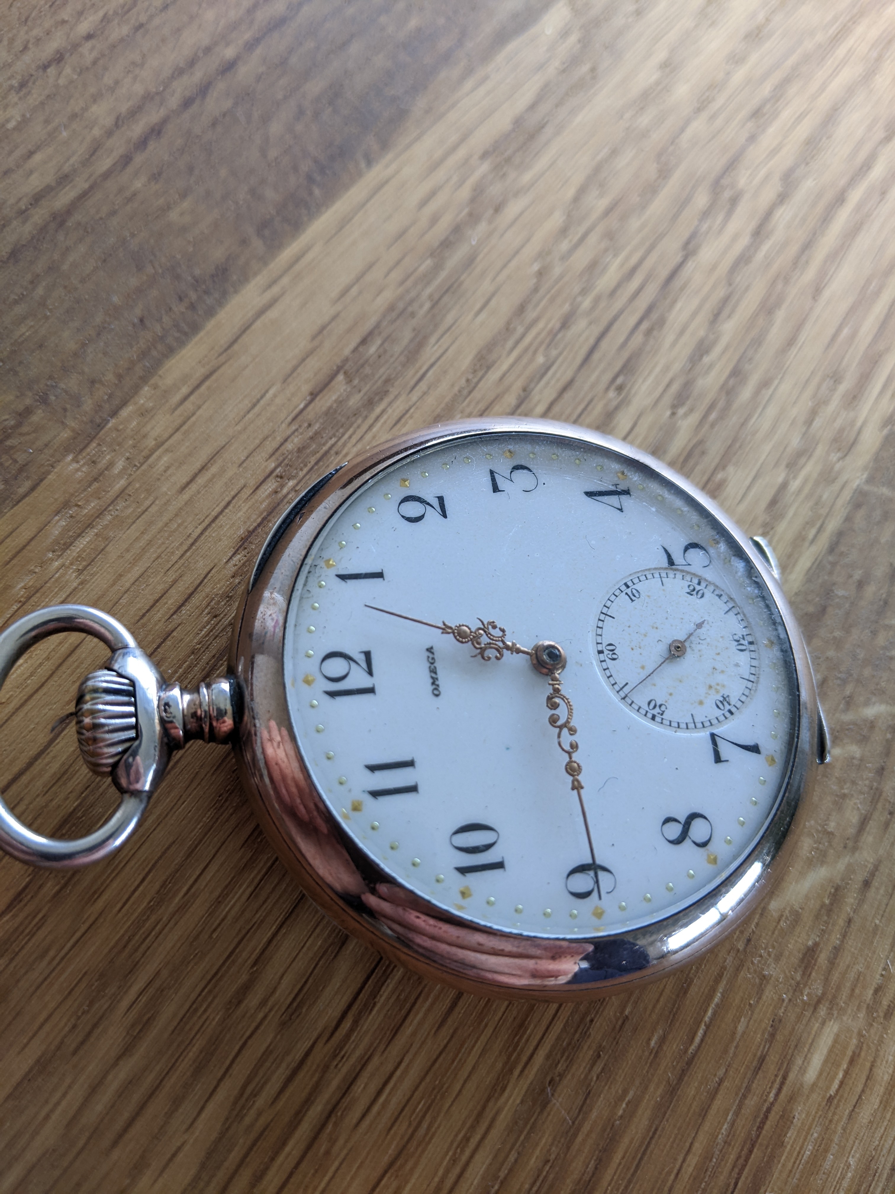

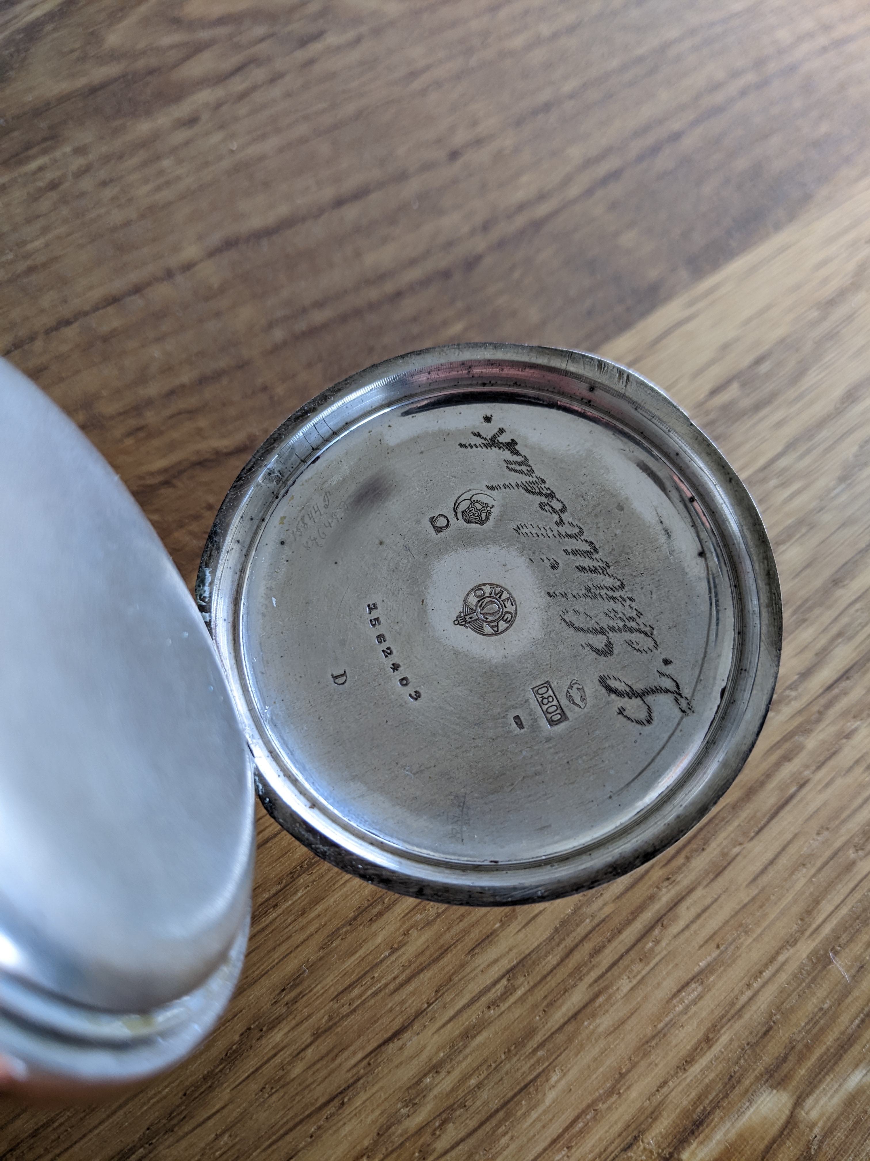

Good that you mention pocket watches: Actually I might have a project available. My grandmother gave it to me but it is not working. I think the axis of the balance wheel is broken.
