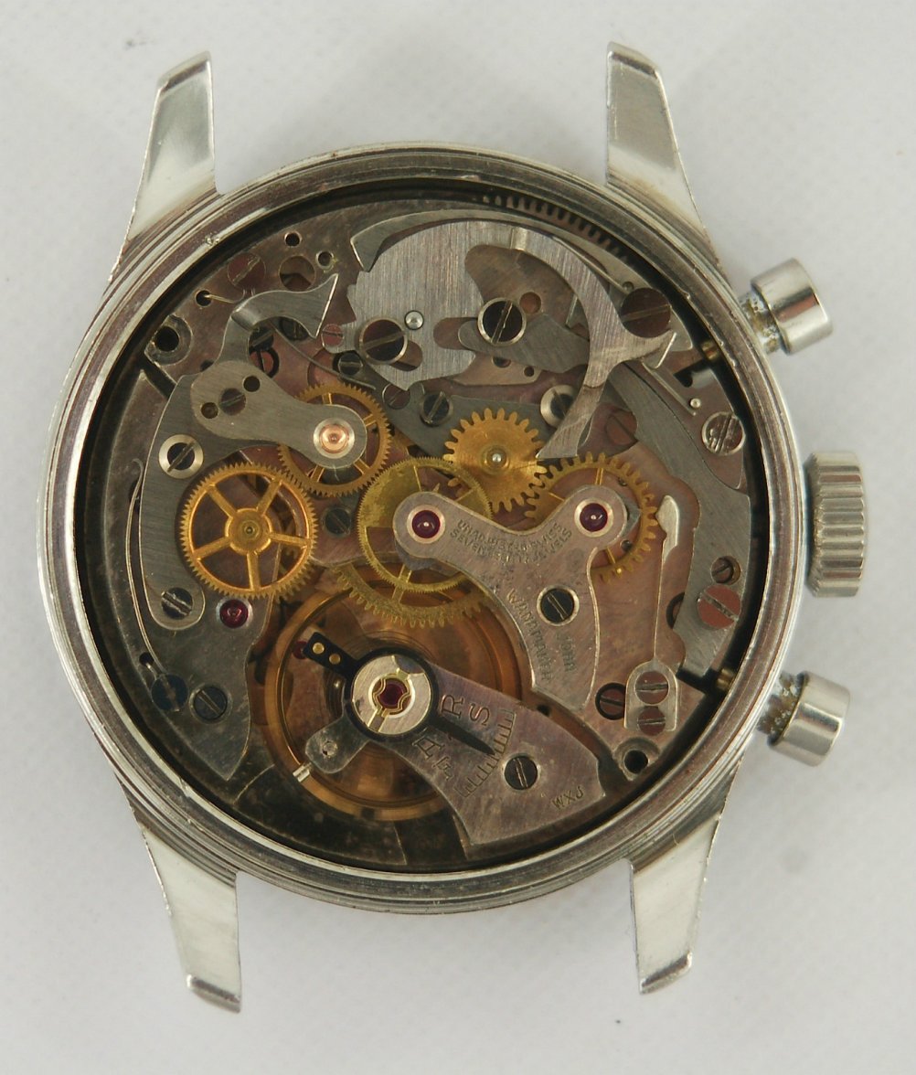

Here is mine!
These are mostly cheap to buy, but servicing can cost almost as much as the watch...

Very common mouvement but easily repairable due to the fact is easy to find pieces. There are very robust if well serviced and adjusted. I had a lot of them and never met a big problem. As possible try to find an stainless steel case and not gold plated or alloy chromed wich are IMO more fragile to shocks.
Enjoy it anyway, there are cheap and some of them are georgous, here is mine :
