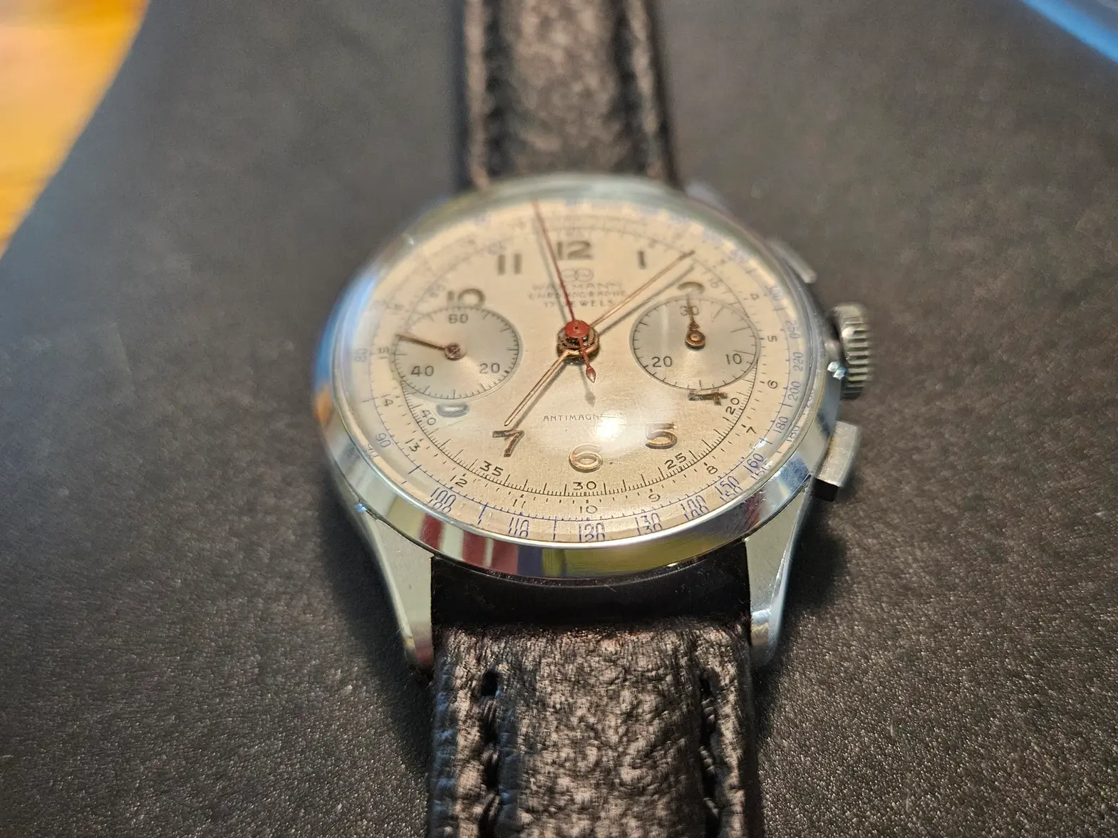

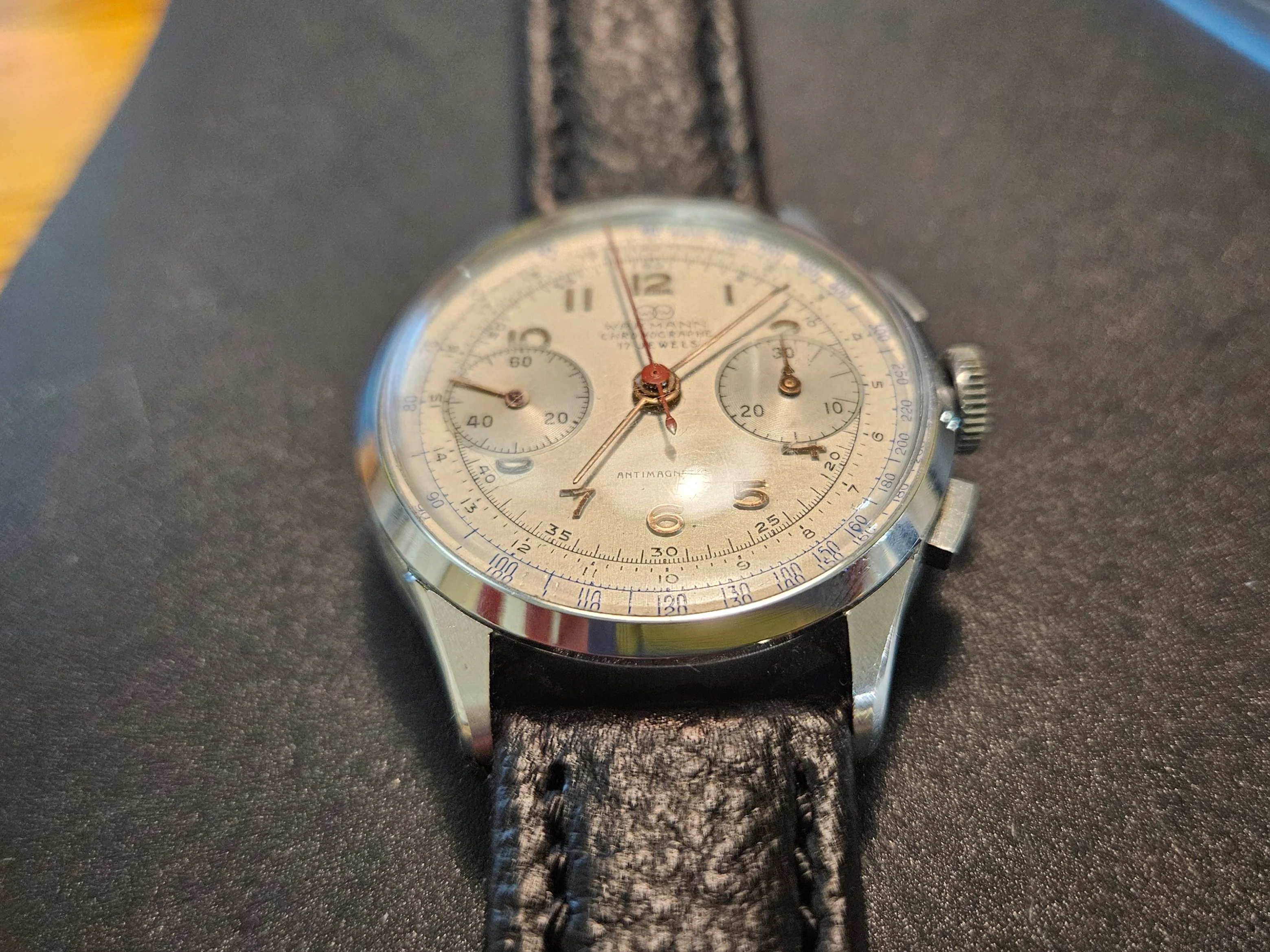

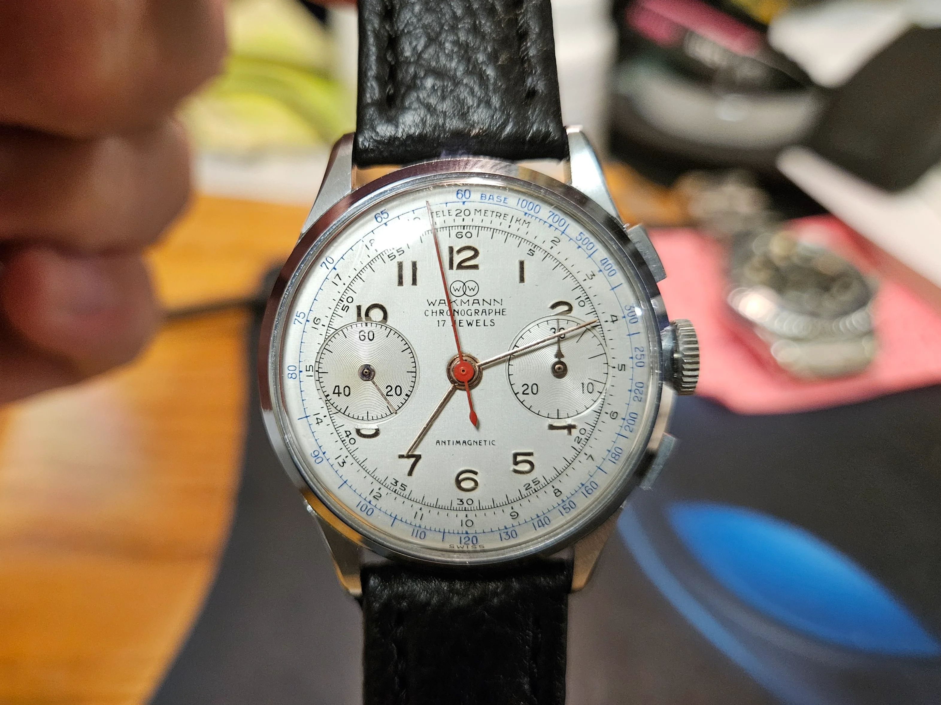

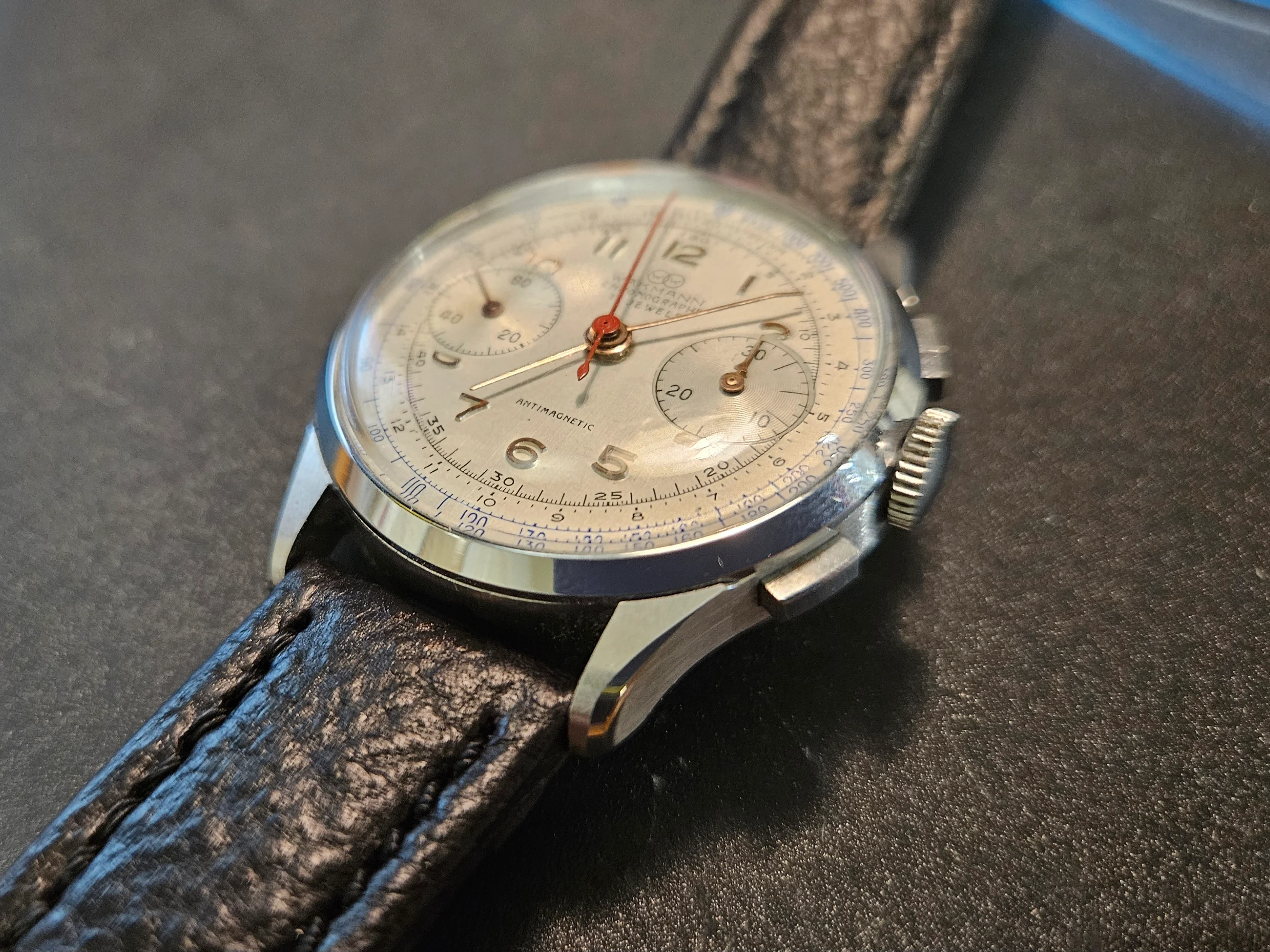

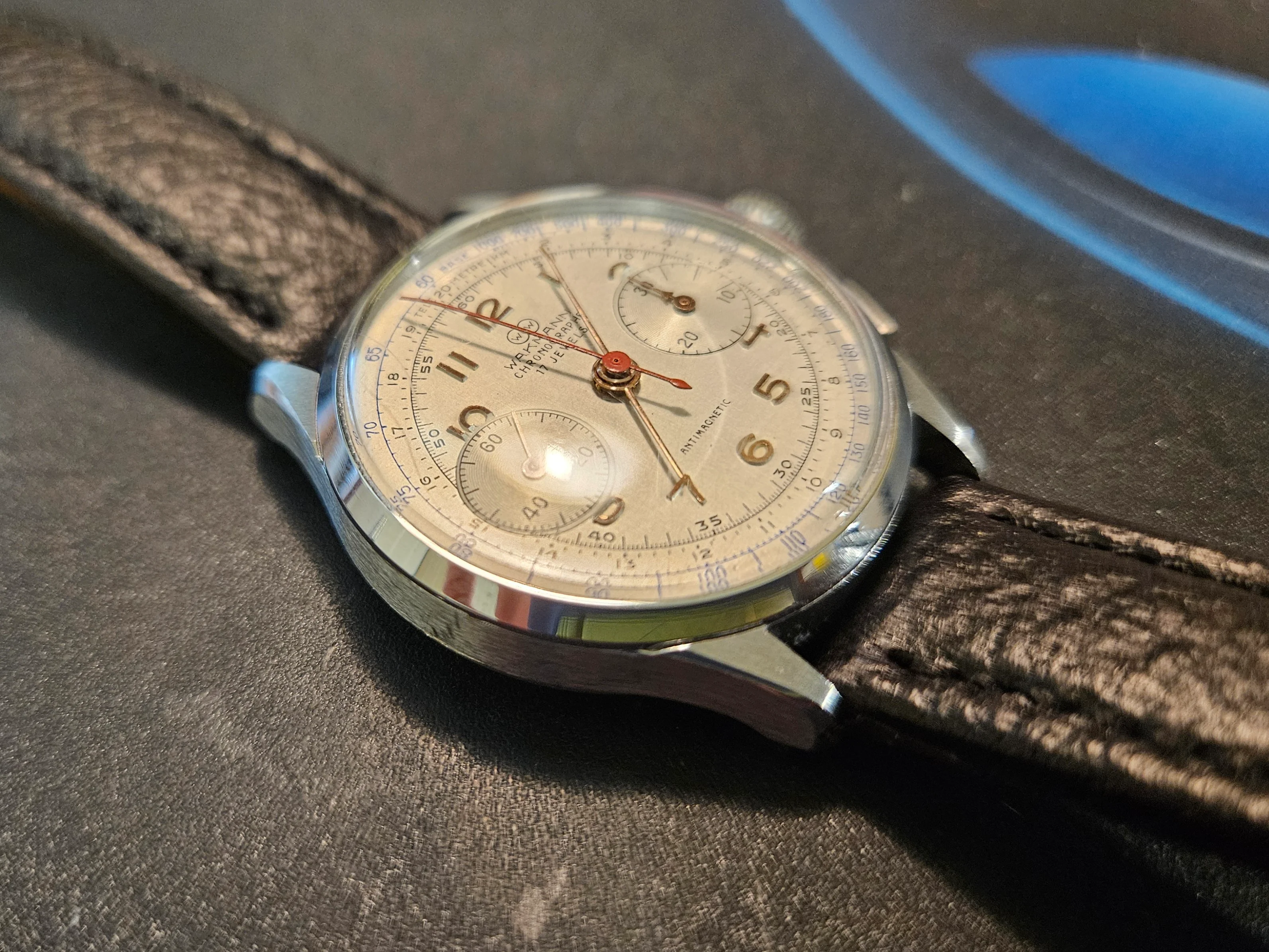

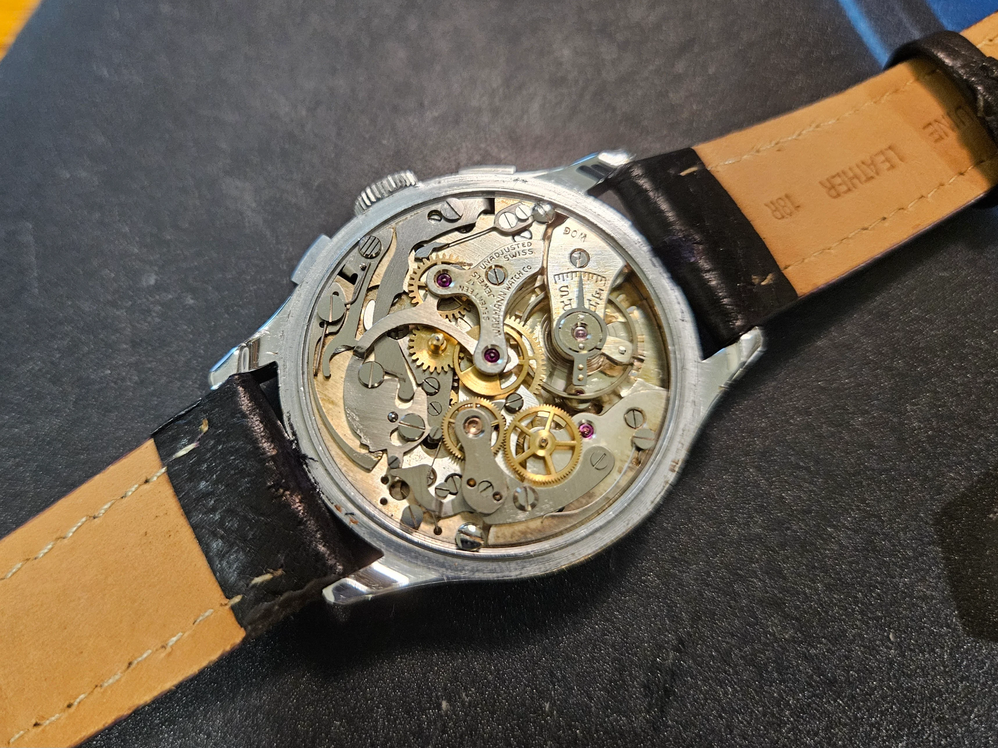

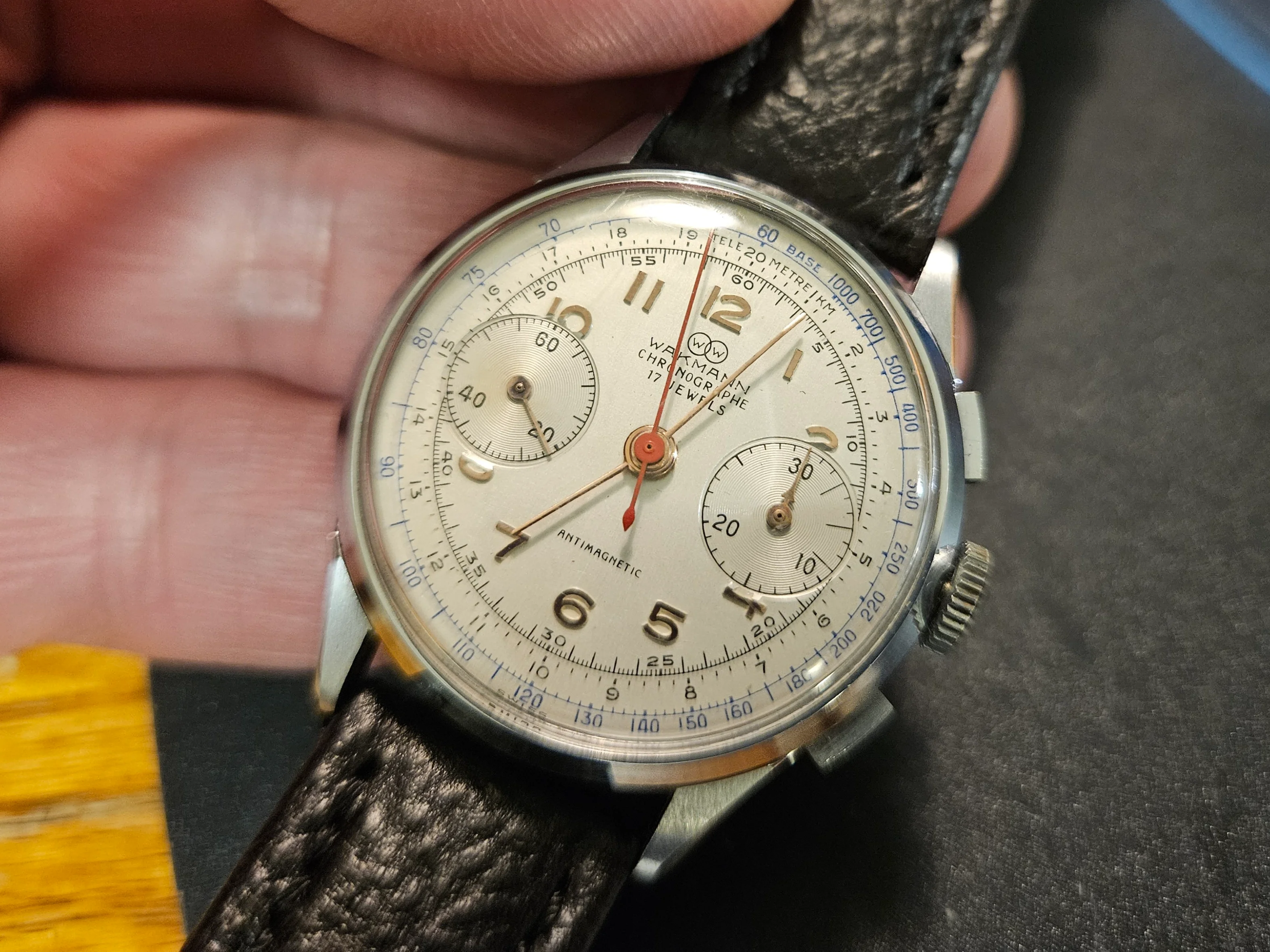

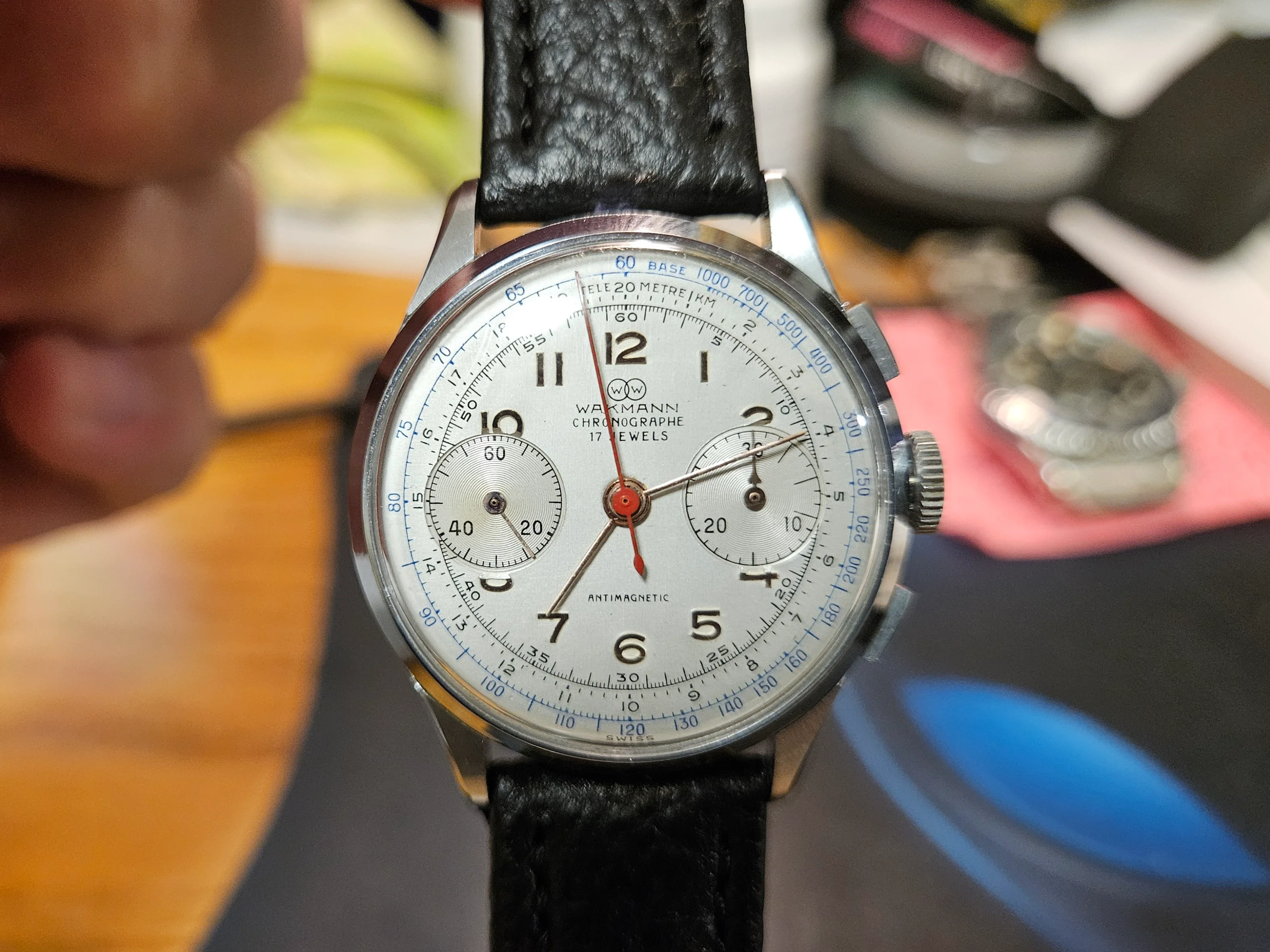

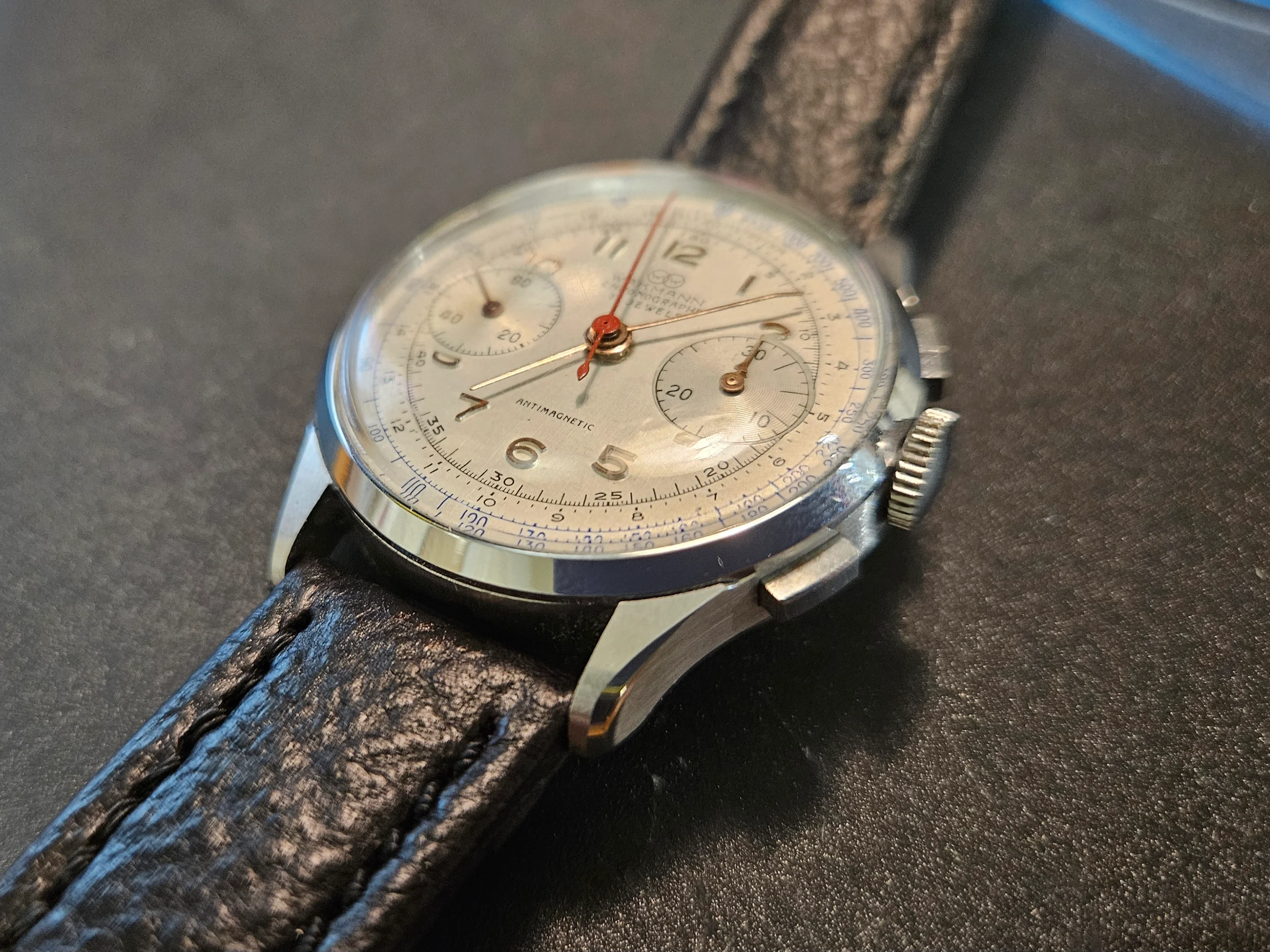

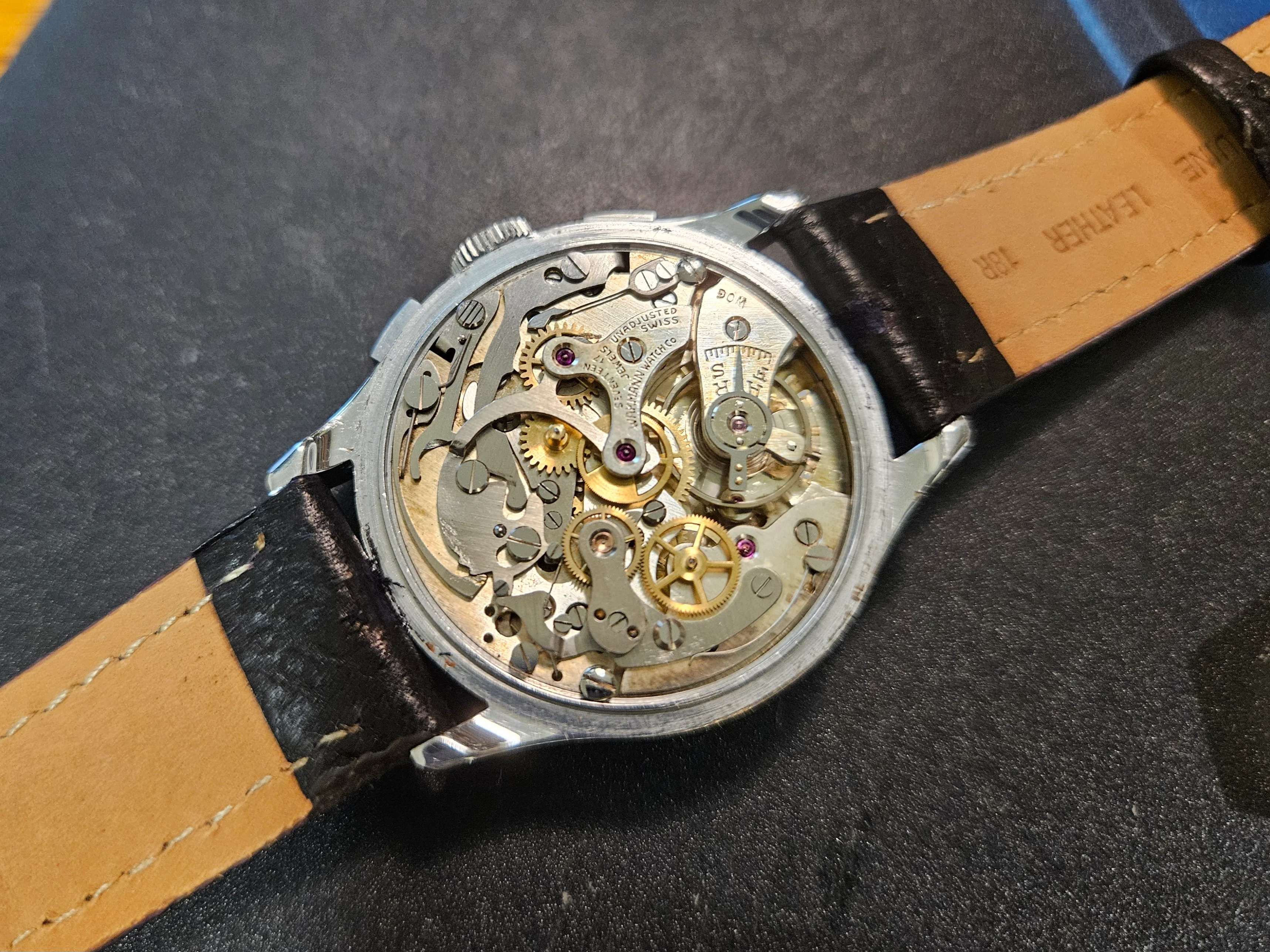

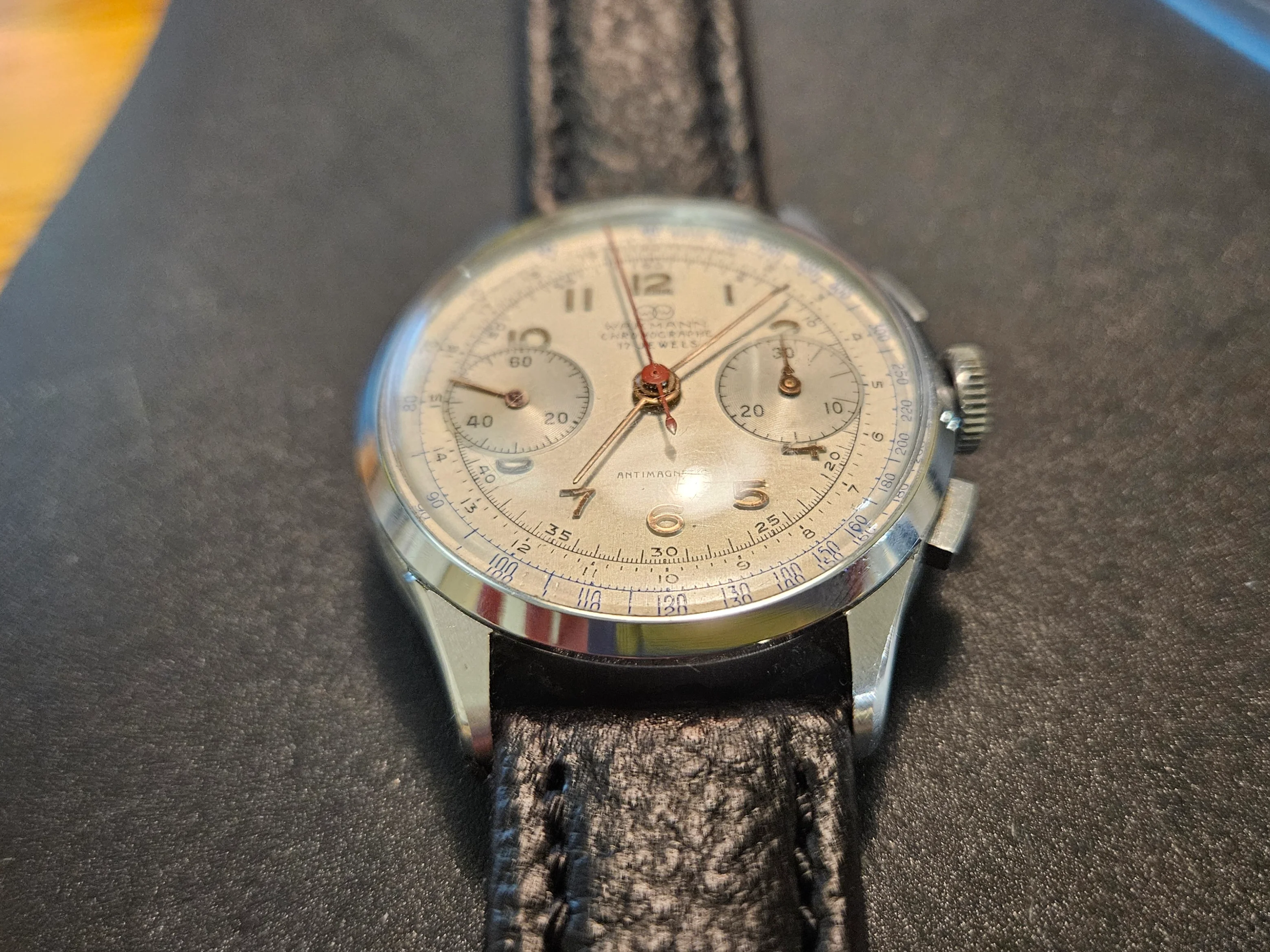

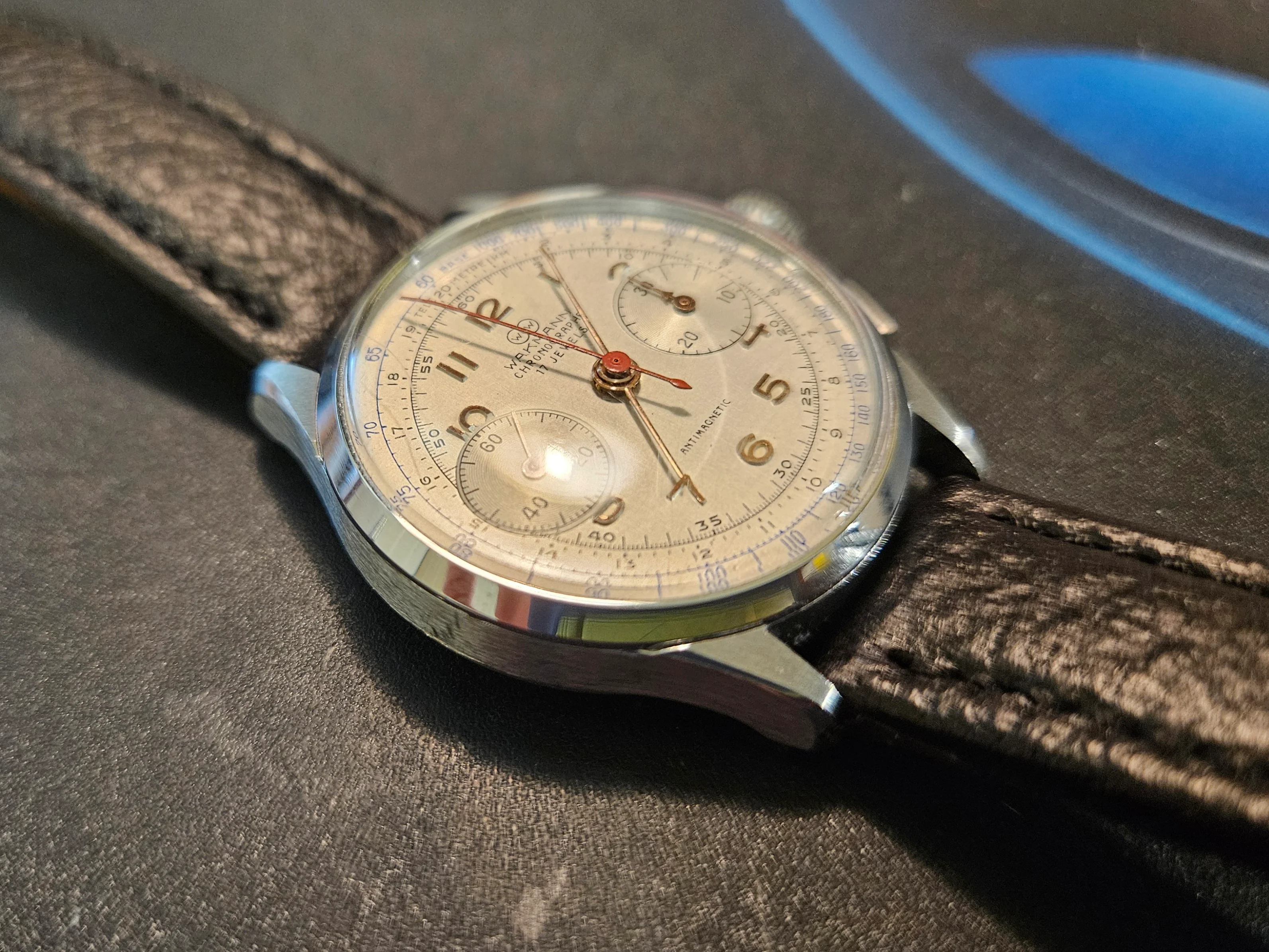

Hi. Found this Wakmann from the 1950s or a decent price, even if the movement is "just" a Landeron 48.
However, the dial and case are what sold me. Could something be this minty from the 1950s? Is it a redial? I found another example that someone posted a youtube on it, but it had at least some patina and they said it was mint as well. This is super clean and the colors still pop.
Any eyes better than mine to see if this is a redial or not? Still learning...

I'm by no means an expert on these dials, so take anything I say with a grain of salt.
The subdials and the seconds track aren't perfectly aligned, the minute subdial looks a little low and the seconds subdial a little high. The seconds track looks like it goes into the sunk portion of the seconds subdial. That said, it may not be evidence of a redial, I don't know what Wakmann's QC was like and these details are picky things but nothing that makes it unreadable by any means. Nothing else really jumps out at me.
The case looks almost as sharp as the dial, and the mov't is virtually pristine. I'd say there is a decent chance someone bought this and either only wore it on rare occasions or put it away and forgot about it.

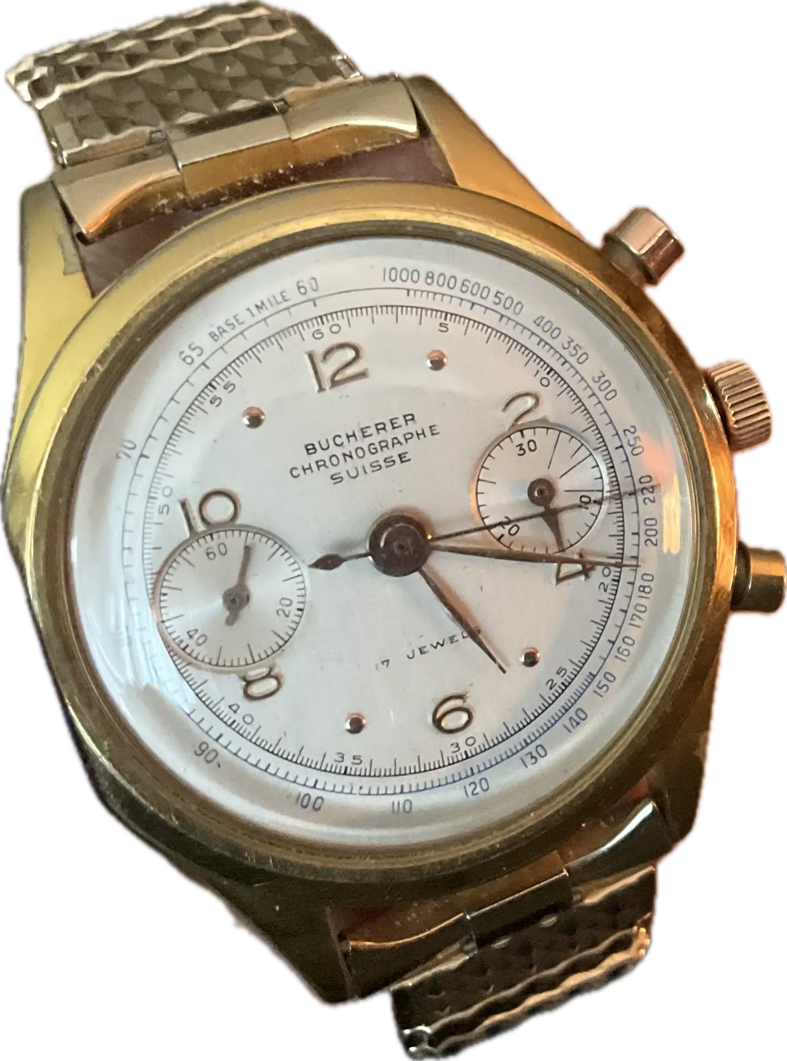

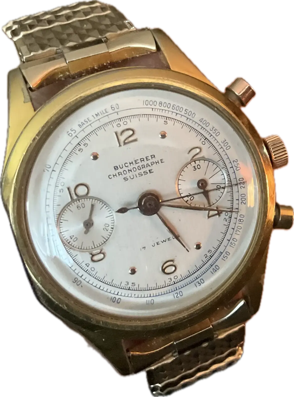

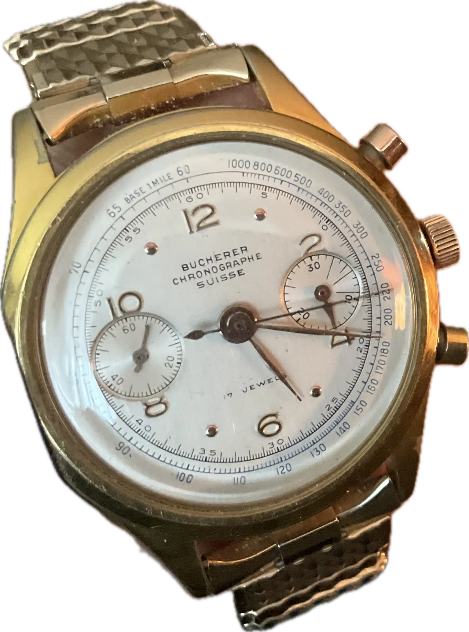

The condition of the case and the movement would seem to indicate an original dial. Leastwise, to me! The picture is of my Landeron 48 behind a Bucherer dial. The watches are about the same vintage, and my dial is original. Just for comparison sake.

Yeah, it's a Wakmann, so not on the same tier as Omega. But it I do wonder about the QC of the dial, now that you mention it. It's suppose to be decent and a representative of Breitling. But it also could be a lower end model due to the Landeron 48 and not Valjoux 23 or 72. However, it is a period correct 35mm and very pleasant to the eyes to wear. I wonder if the case was refinished as well, it looks too new/clean. Especially the brushed areas. But who would take the effort to refinish a Landeron 48...lol.

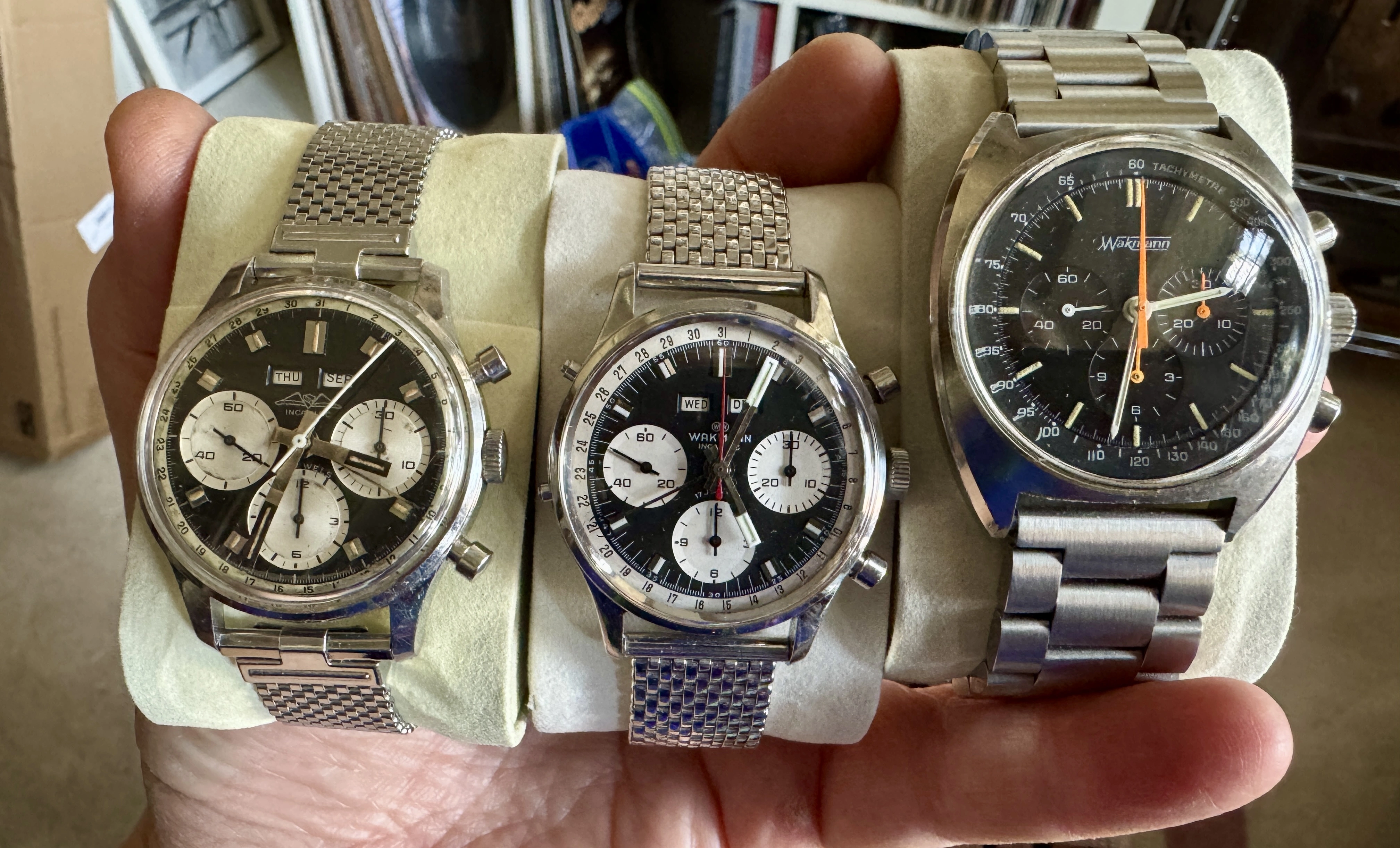

Might tap the brakes on Wakmann criticism they had access to design many top notch, yet affordable versions of great watches.

Oh I fully agree and I think my example is beautiful. That's why I'm taking the effort to inquire about it. Just wondering if my Wakmann 190 Case, Landeron 48 is too beautiful to be true for a 1950s watch.

I’m not a fan of the fonts on your dial nor the off center print on the right subdial.
