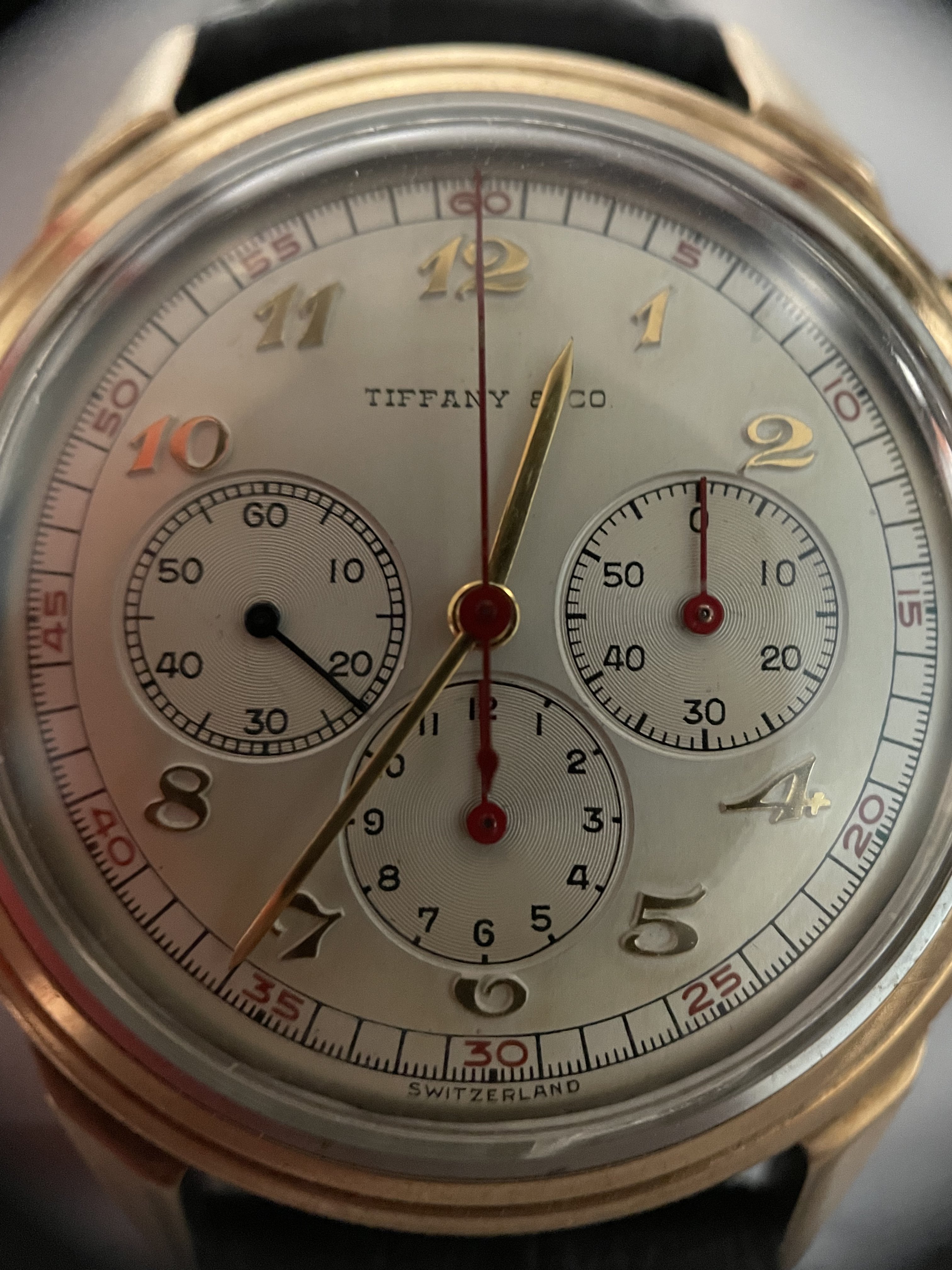

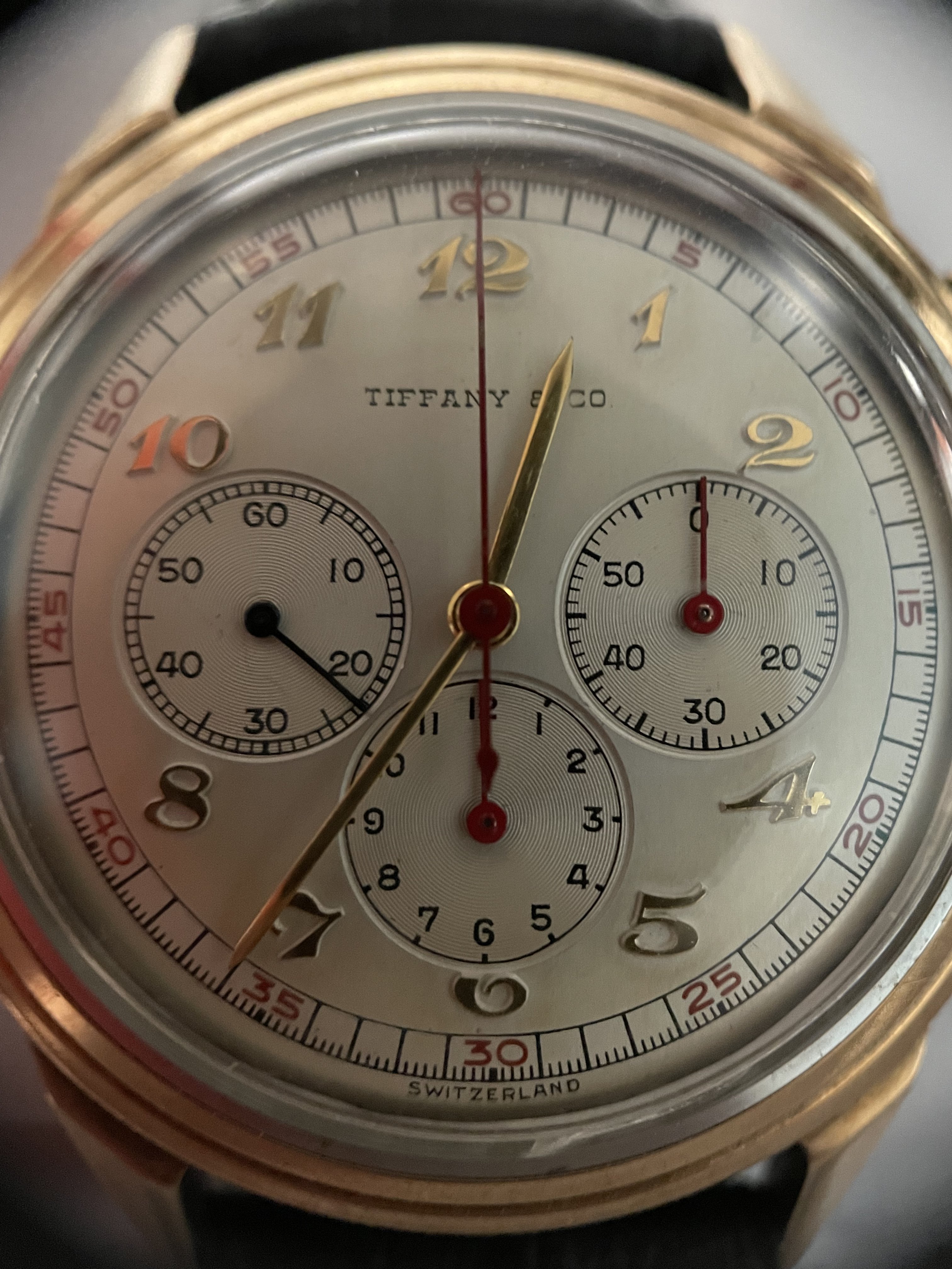

Is this tiffany/movado m95 original or a redial?

Will do. I bought this one in person for a good price and was trying to determine the originality so all the photos are mine. I just got a macro lens for my iPhone to aid with my watch photography

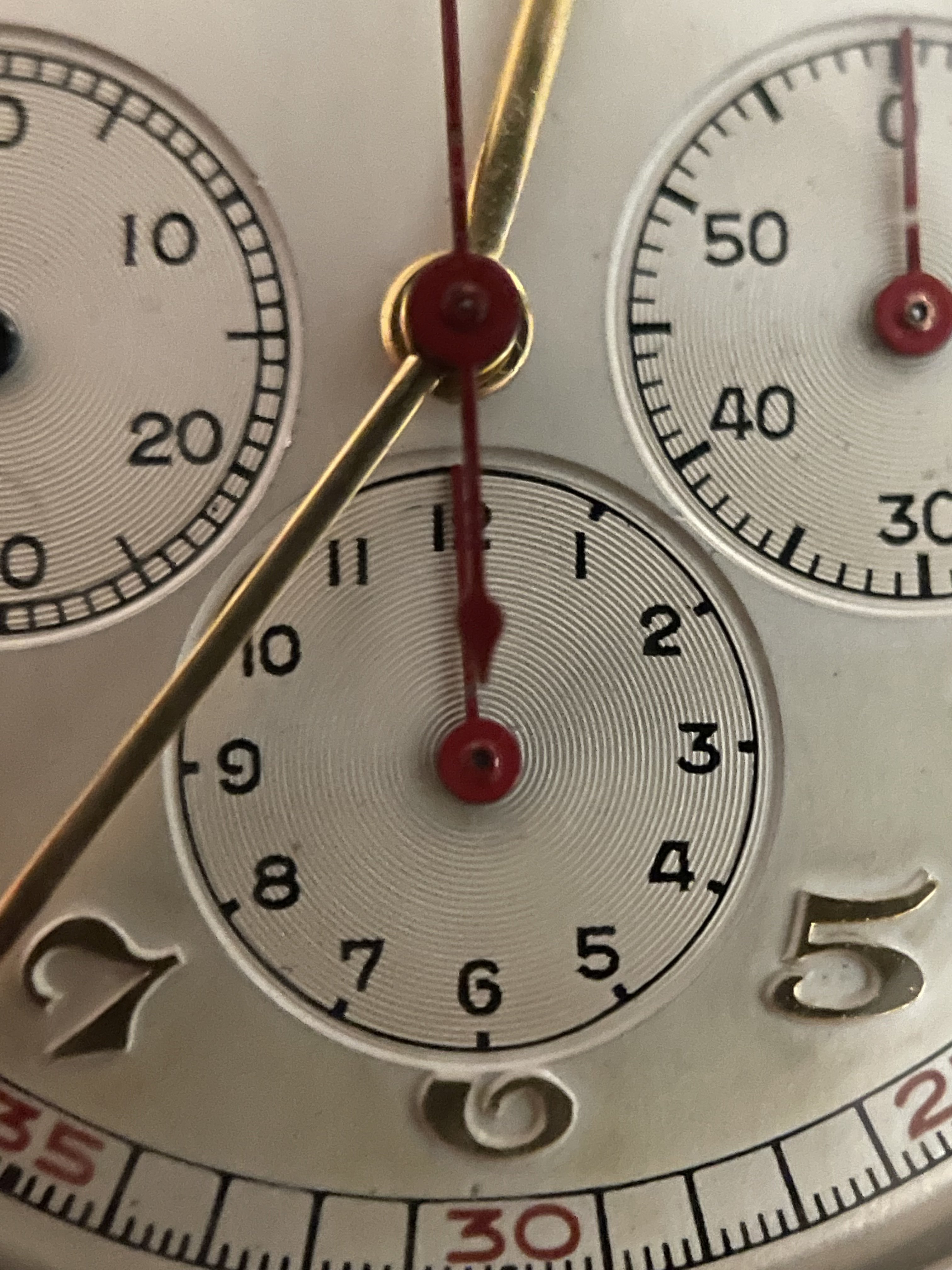

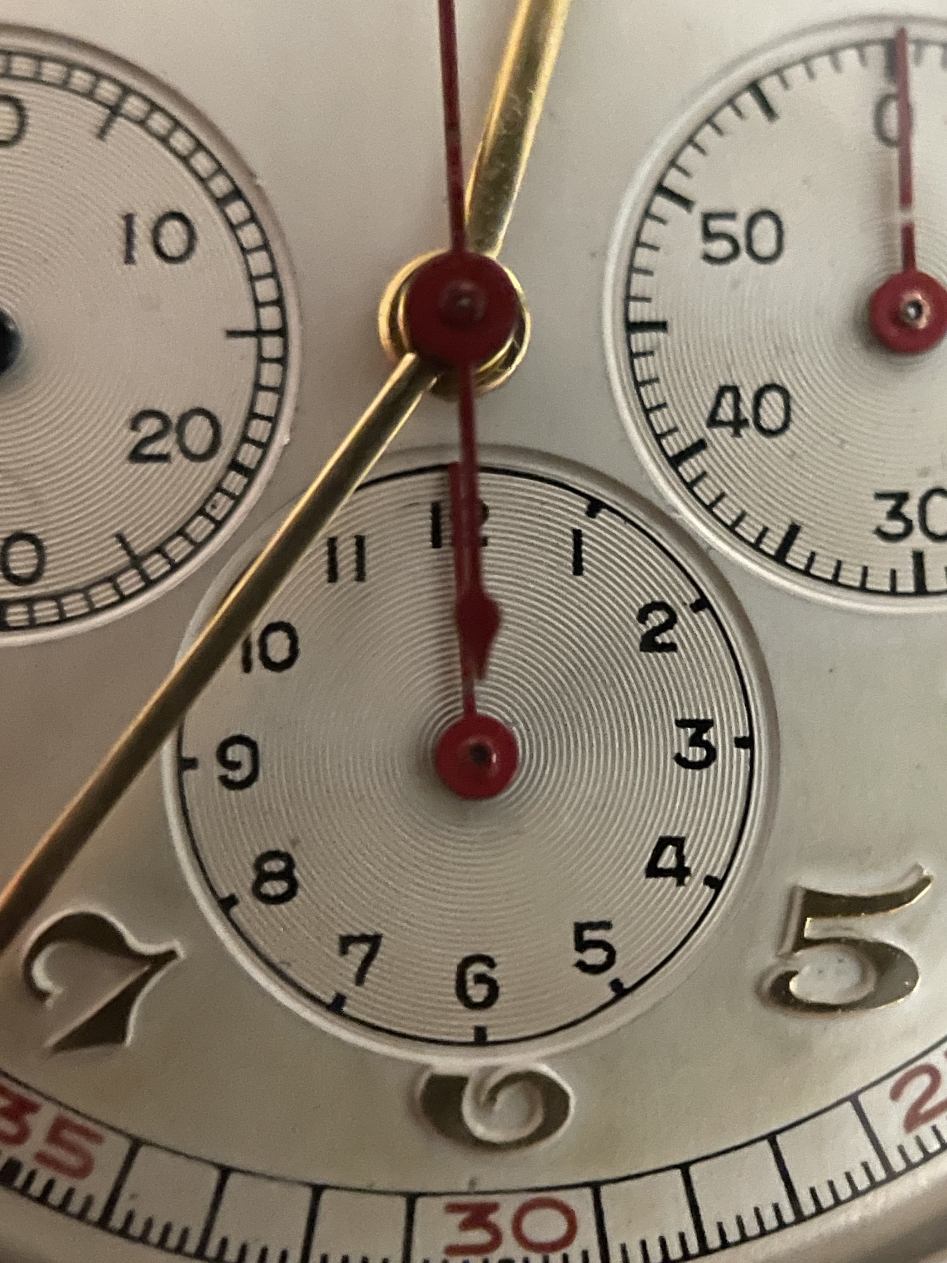

Some macros from my new iPhone lens

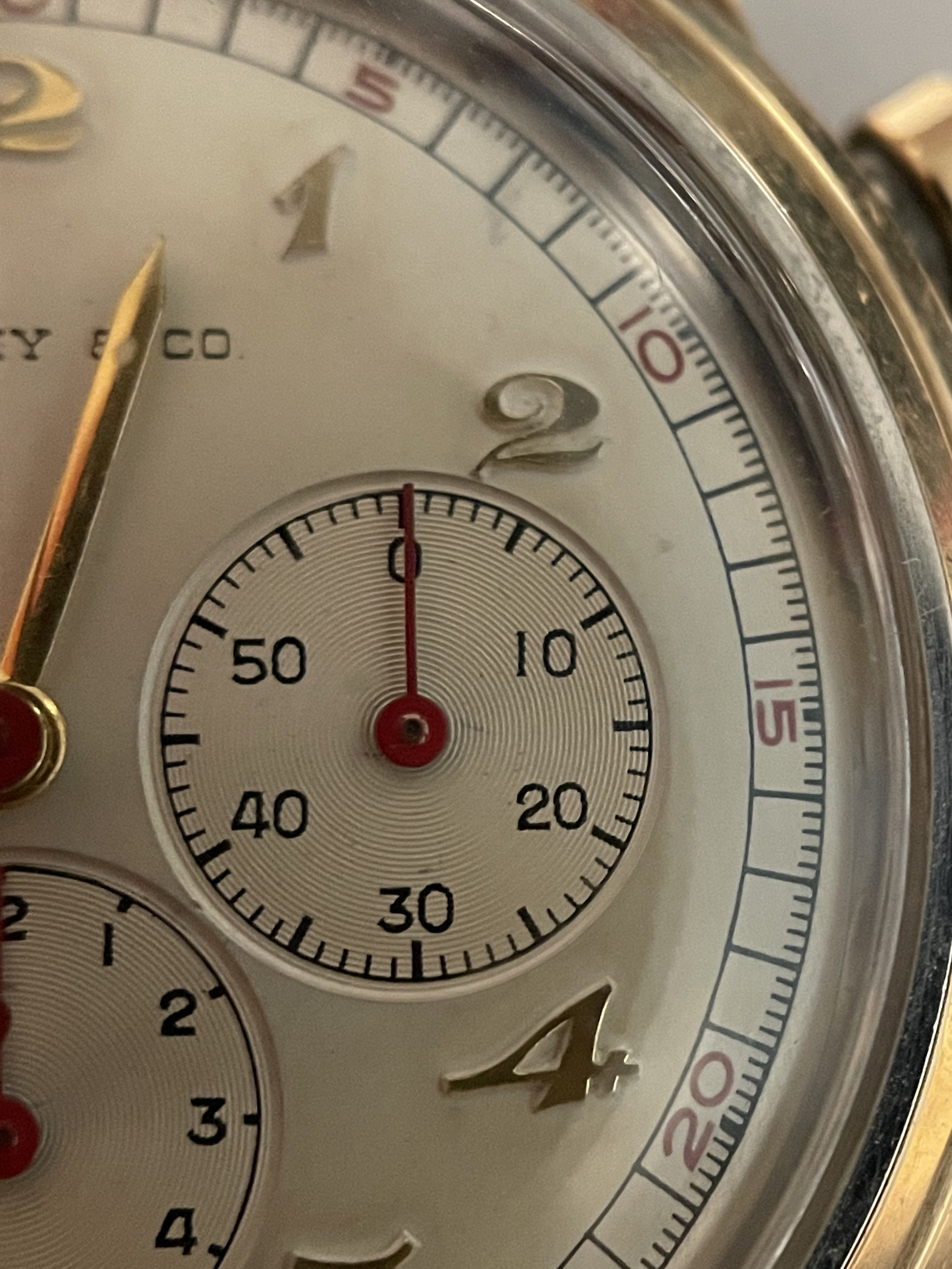

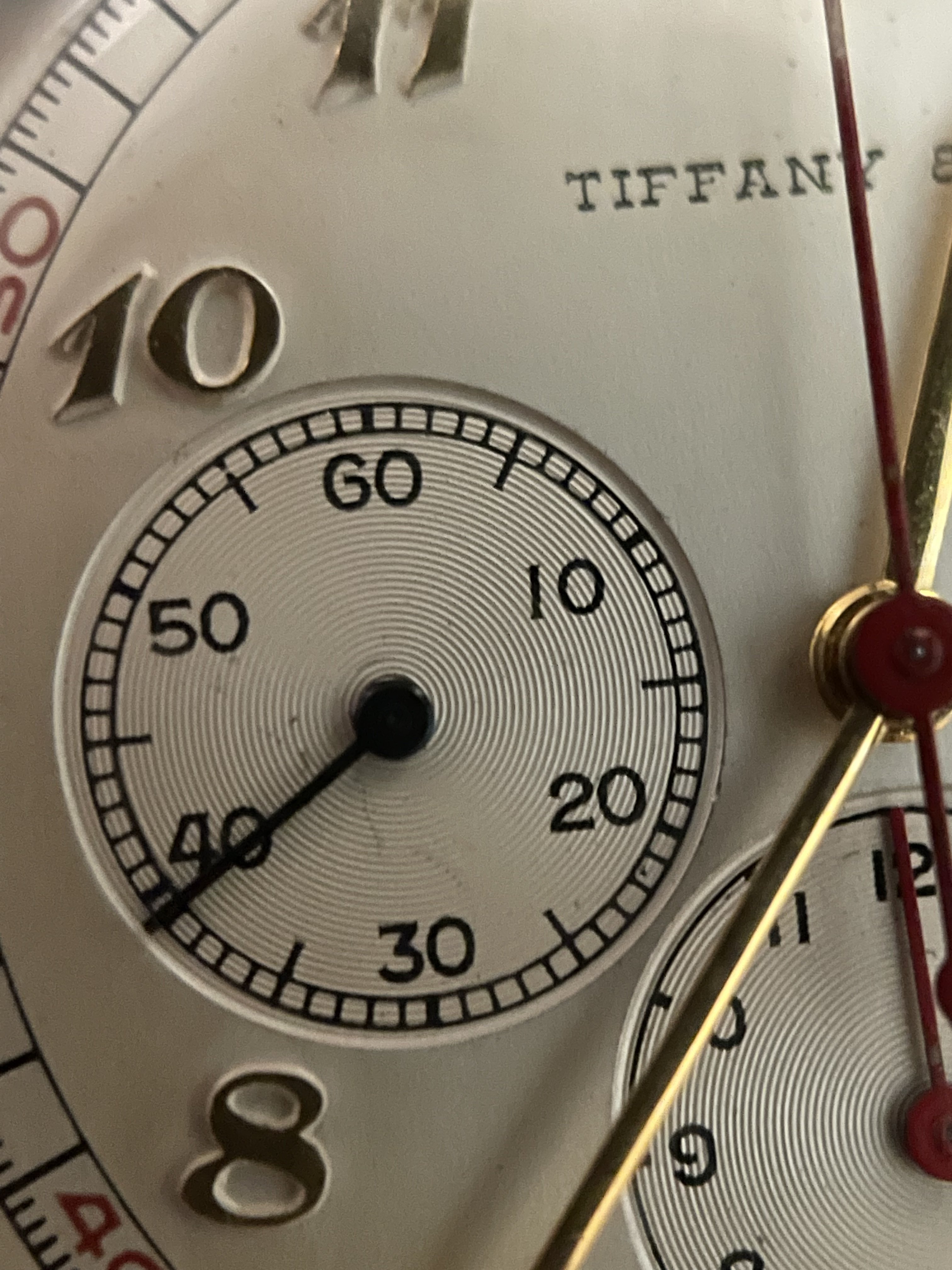

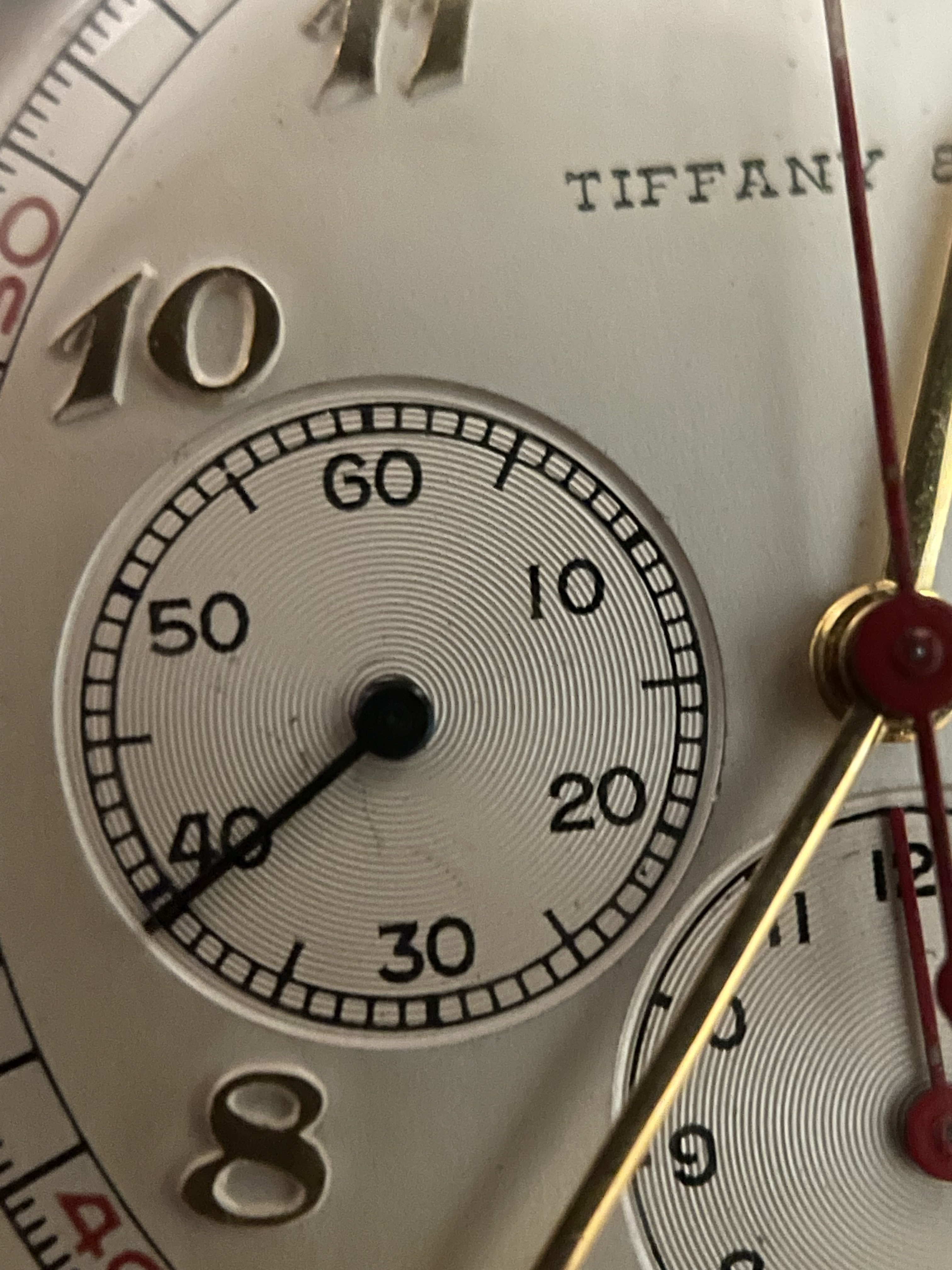

See my problem is I see 5-6 applications of ink to the dial. You would assume 2-3 in this case. I have never seen a (I assume) singer dial with misaligned subdials.

I mean this watch is a custom make for Tiffany. Maybe they didn’t have a streamline process for the limited run

Singer would have used one screen/ball to do all three subdials. It looks like they used 3.
I’m not saying it’s not original but things like that raise flags.

Yeah looks like 3 separate inkings

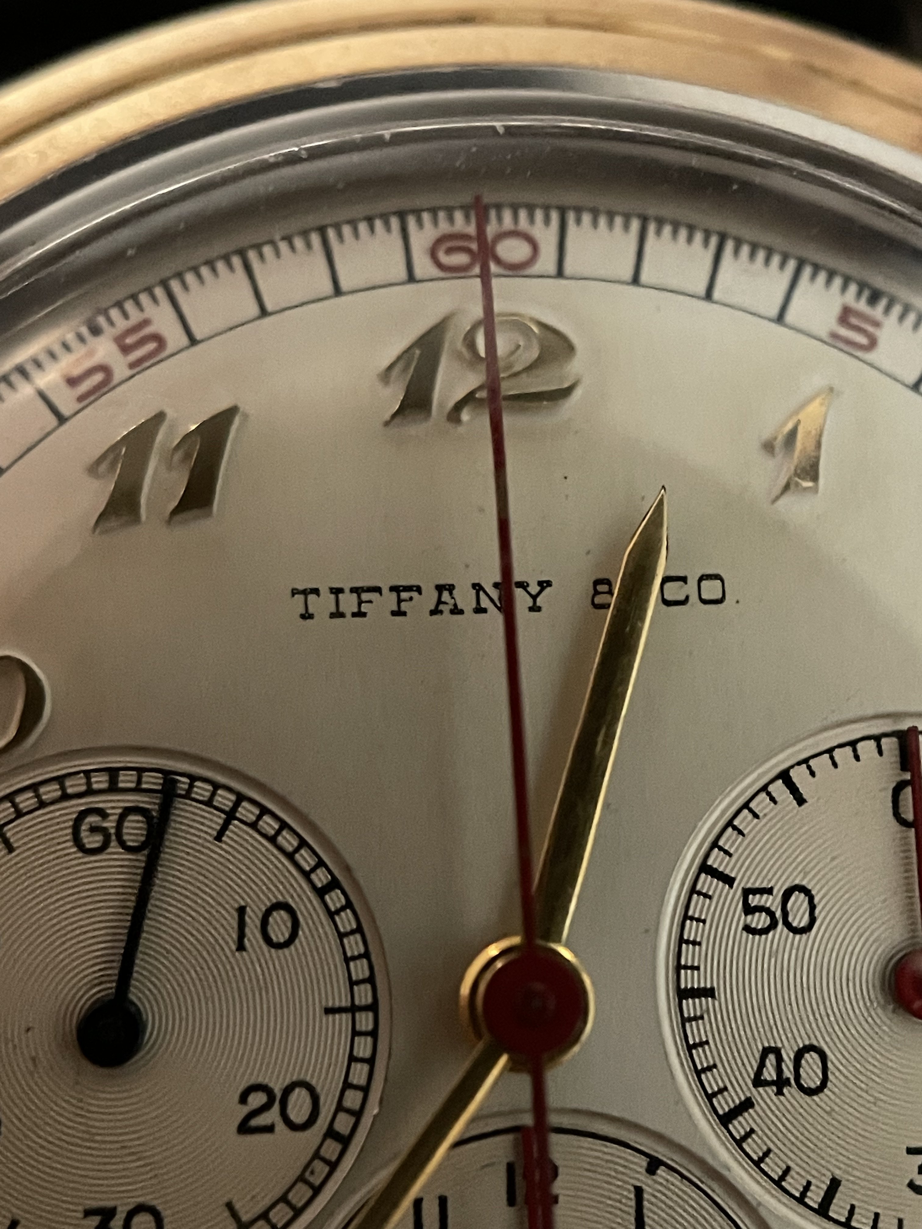

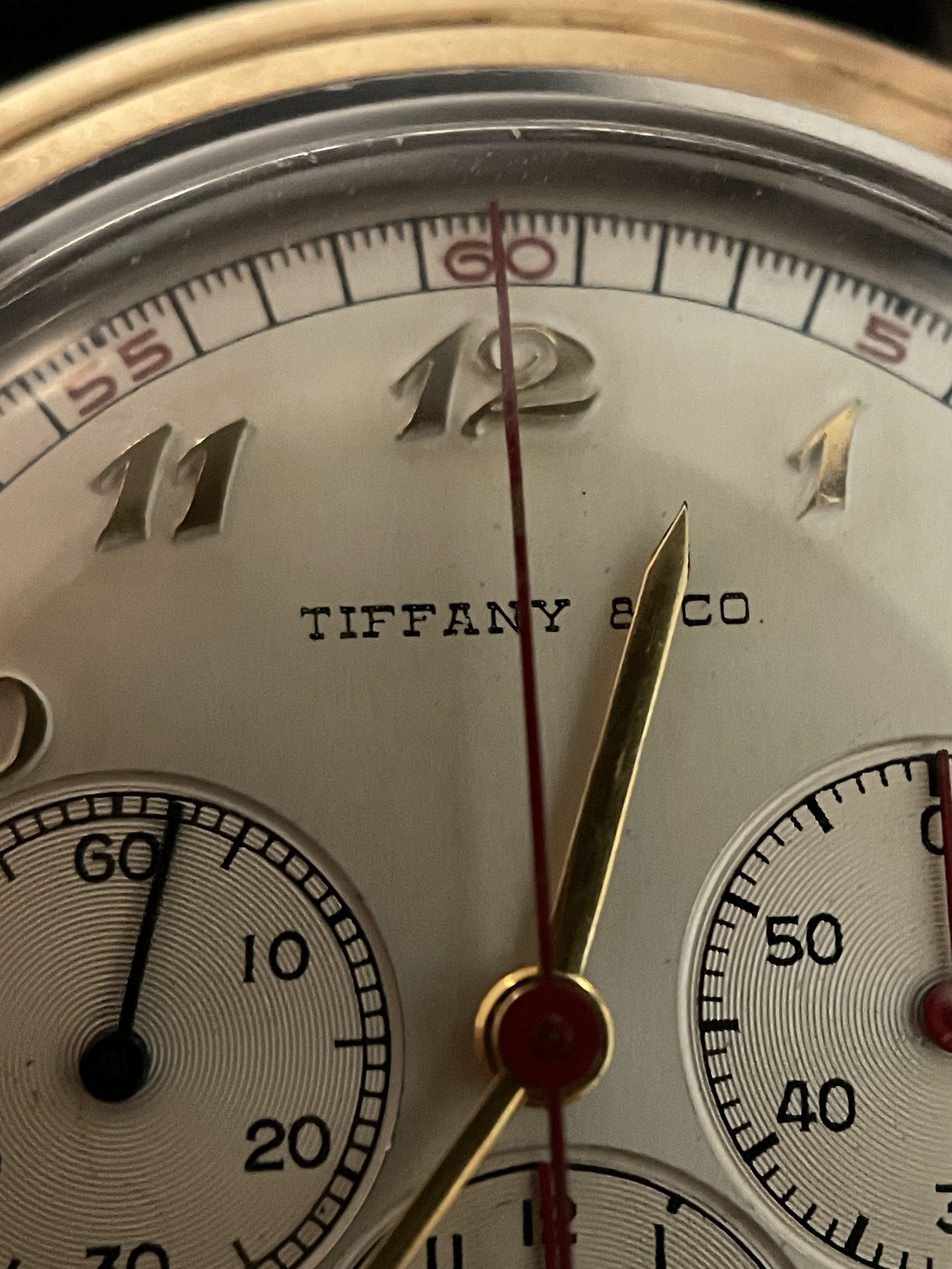

The Tiffany & CO printing is not like any Tiffany imprint, I've seen. I would never pay ant premium for a Tiffany without the retailer's invoice with the correct number. Have a look over at the Vintage Rolex Forum. They covered that in the past.

ive seen that logo before and it was an official Tiffany Font. That doesn’t prove legitimacy.
