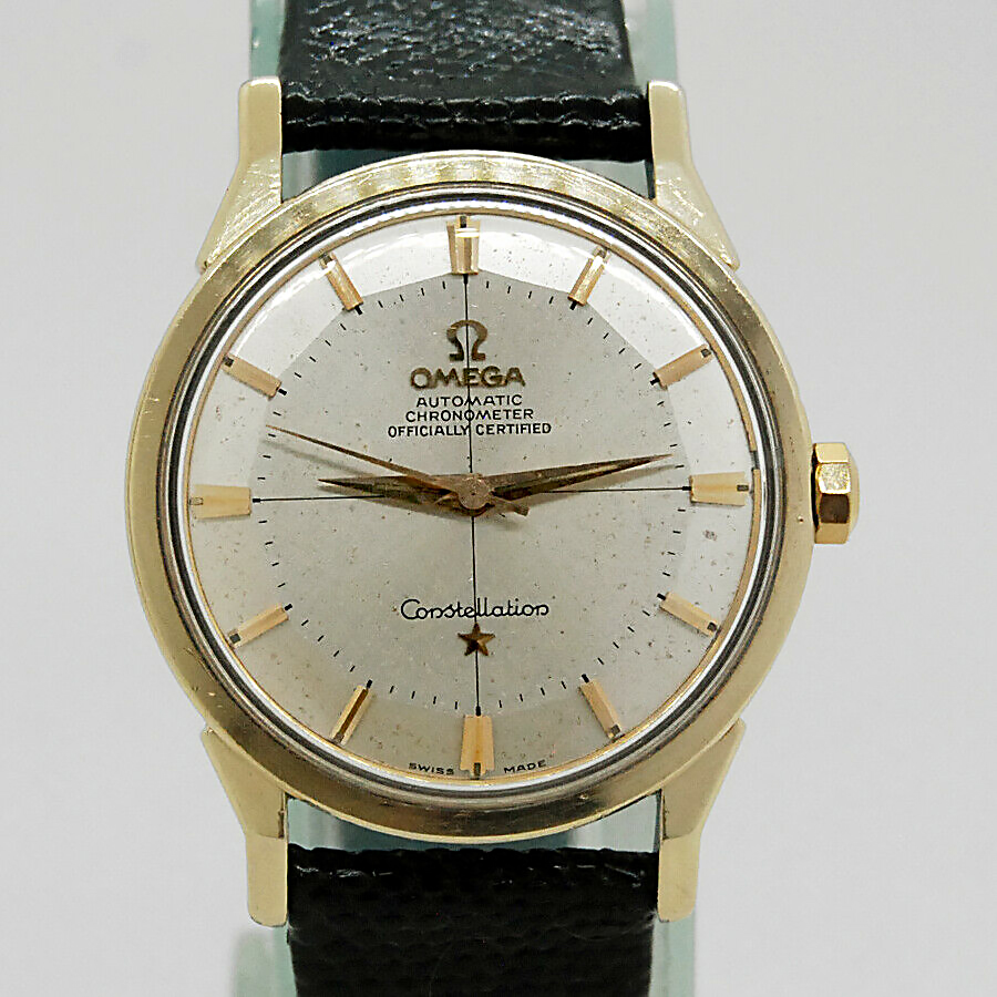

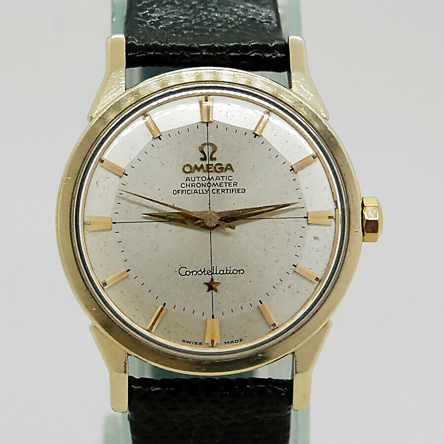

Is this a redial constellation piepan ?

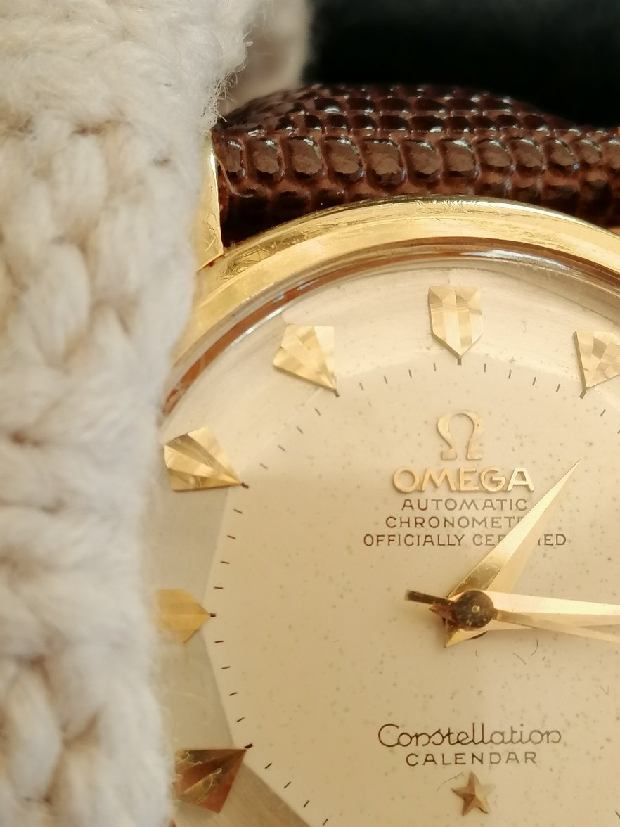

I didn't expect my post would make another discussion and i've also learned a lot. My watch buying wise, I decide to cancel this order due to the missing screw and my suspicion of repaint of dial.. I'm not a collector but i would definitely avoid if it is redial because i personally think originality(especially dial) is one of the most important thing of vintage.. Anyway, Thanks for helping guys!
I think that was a wise descision; 👍 I am convinced that it´s a redial. The crosshair is too thick. Serifs are missing, "swiss made" is to small. A genuine dial shall deliver a crisp, sharp impression.

I still think it is perfectly fine. The dial dirt and patina on the lume suggests to me it has been that way for decades, redials done back in period weren't usually all that accurate and are often easy to detect. There are question marks on that crosshairs and the lack of defined step (often seen on this model) its true but much of it is down to dirt and poor resolution IMO. Its all academic as after you add in the $300+ needed to make it healthy it becomes less of a bargain anyway. Not one to chase.

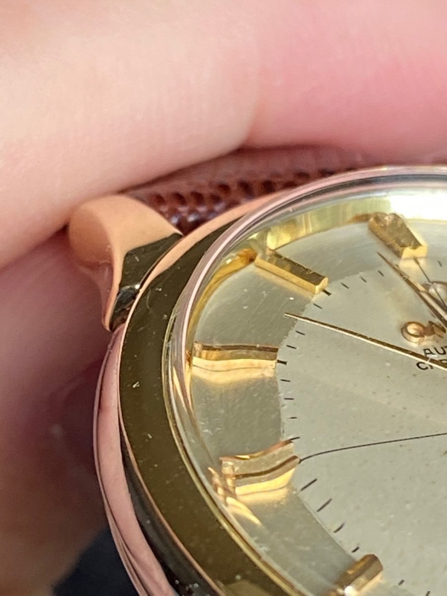

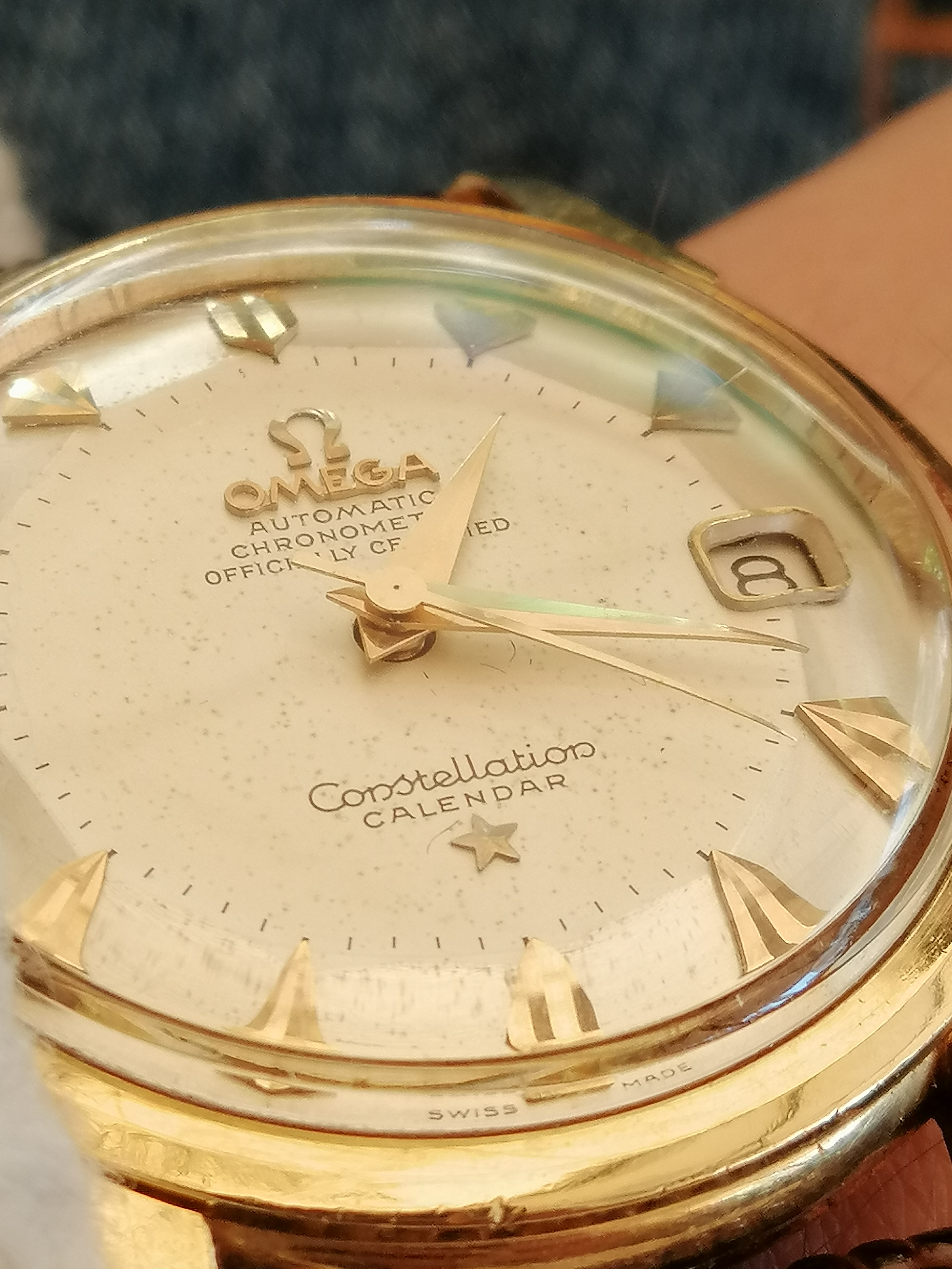

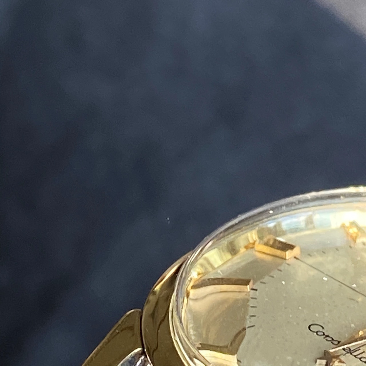

@Dan S As you asked I did take a couple of pics of my less steppy PP, the one on the LHS earlier which is model 14381. While I am 100% there is a kink, I realise that it isn't proven by these pics so I don't think you will necessarily agree. The problem is to really show it you need a very low angle, something that is prevented by the crystal in a cased dial. Anyhoo you asked and I deliver. I would be genuinely curious to see the opposite, a 12 sided middle section with a non kinked rim ie a faux pp done by brushing, if you can find me a verifiable one:

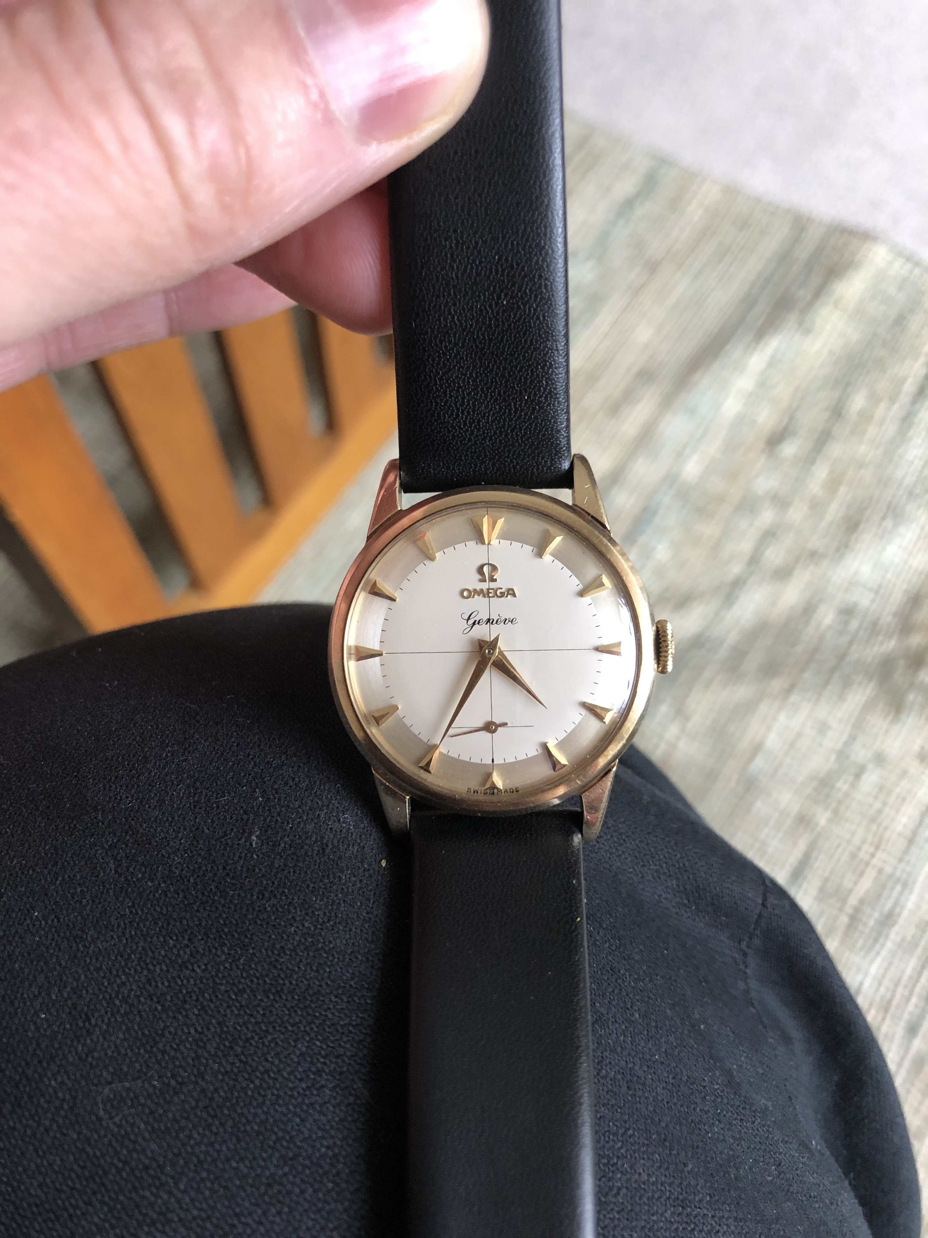

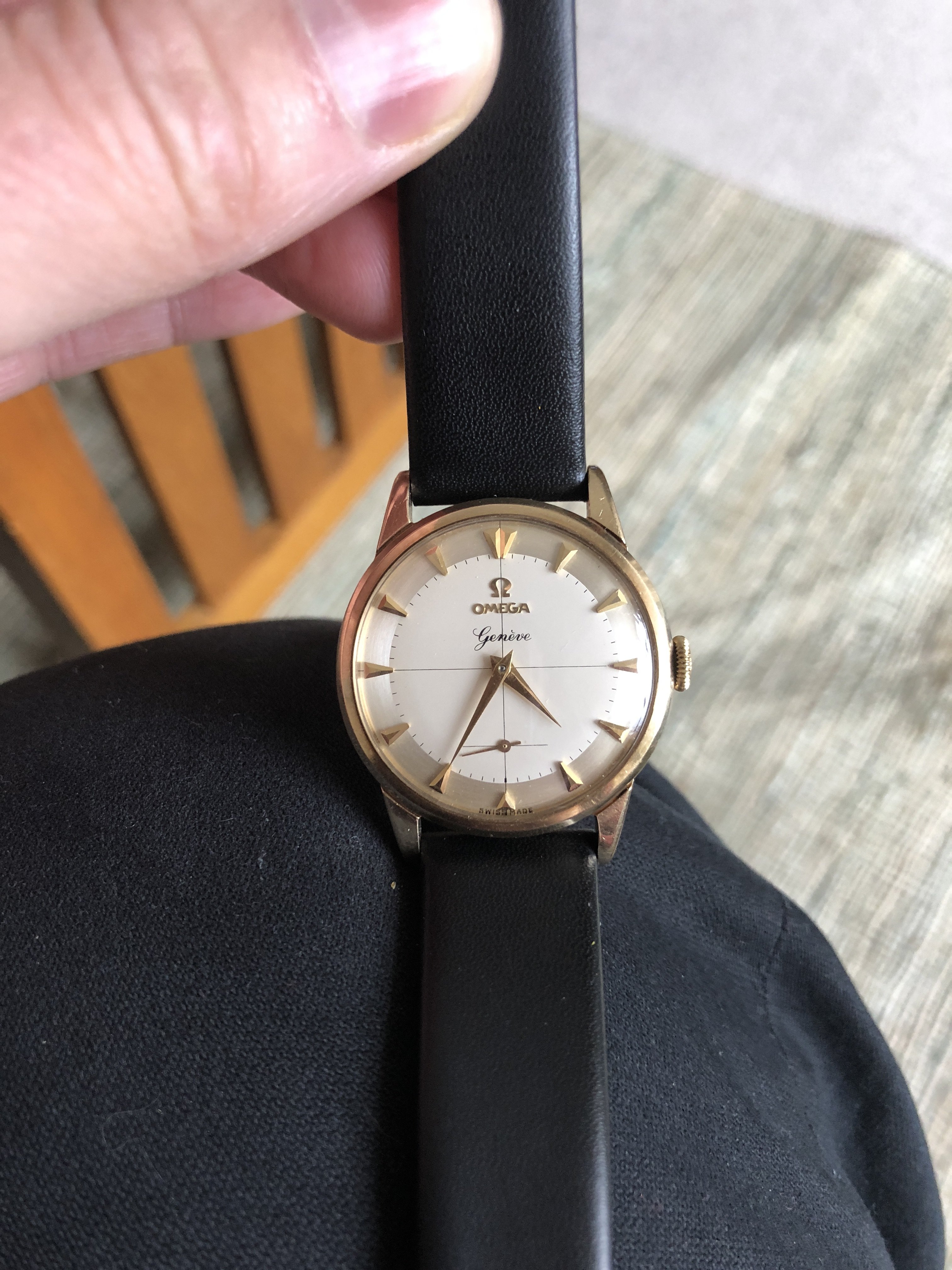

I know you dismissed the pic of a 2 tone that gbesq posted of the Geneve earlier as irrelevant , but I have one too which has one of the best faux pp dials IMO so thought I’d post that too, mostly because I like it lol.
That step is good to see between 8 and 9 o'clock.

I still think it is perfectly fine. The dirt and patina on the lume suggests to me it has been that way for decades, redials done back in period weren't usually all that accurate and are often easy to detect. There are question marks on that crosshairs and the lack of defined step (often seen on this model) its true but much of it is down to dirt and poor resolution IMO. Its all academic as after you add in the $300+ needed to make it healthy it becomes less of a bargain anyway. Not one to chase.
I disagree. Serifs are all missing and the fonts are to fat.

You can't enhance pixels that aren't there. I do see traces of serifs but neither of us can be 100% when using a low res shot like that. I think on the balance of probabilities it is fine, I fully respect that you do not. Without a close up neither of us will fully convince the other.

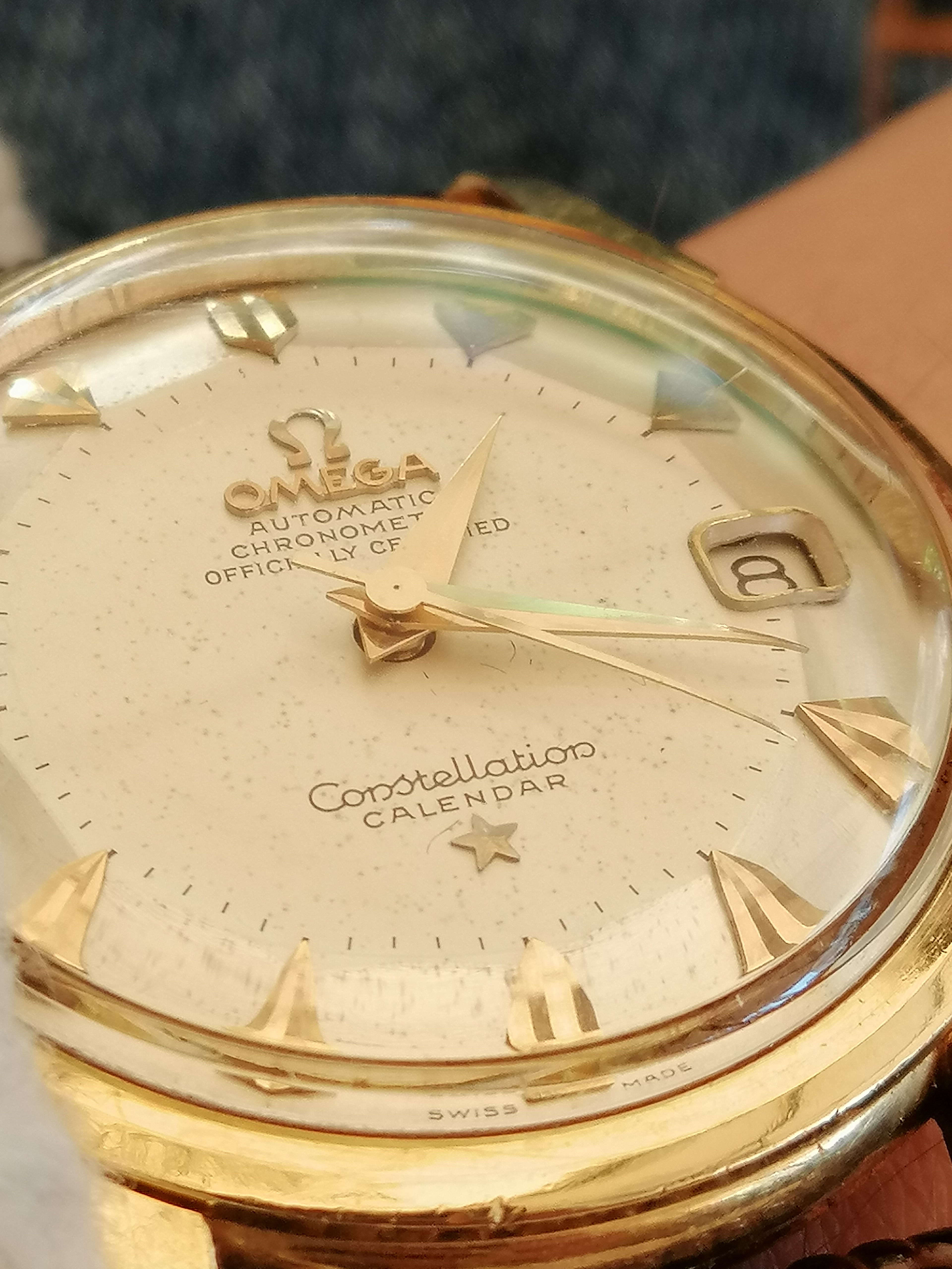

Hey @Dan S,

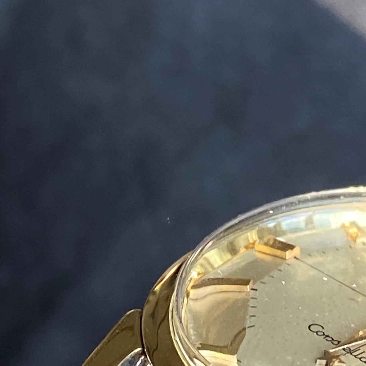

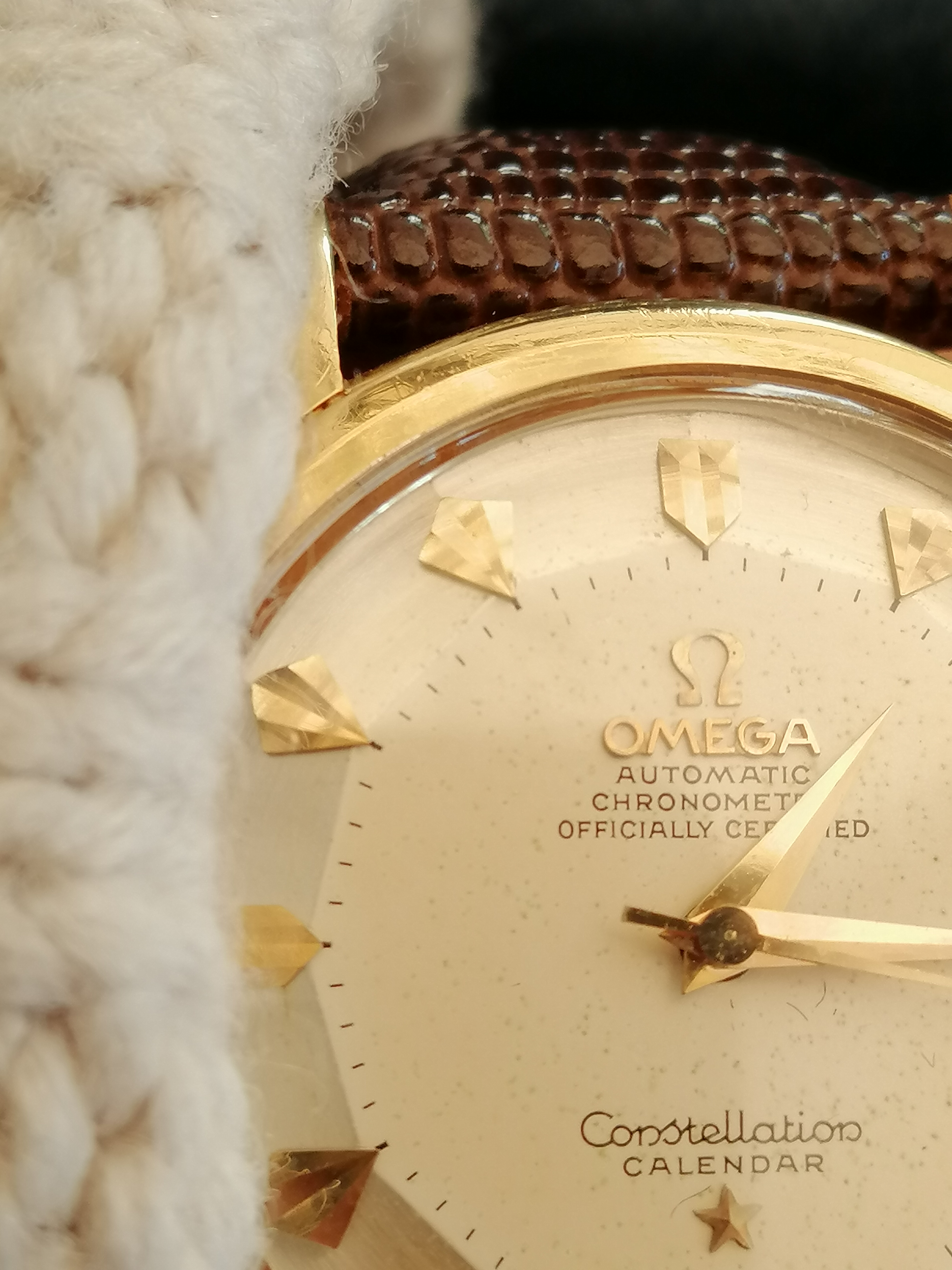

This is my 2943 with "pie pan" without step. Hope it helps😀
No step but a clear kink. It’s most obvious at the date window.
I guess we all see what we want to see. 😁

Hey
Im with you.
Step or no step, all kink shape dials are pie pan in my book. Its the shape of the dial that makes it a pie pan not necessarily the “step”.
The step only makes it more obvious.[/user]

My conclusion is that there are 2 types of PP dials. One with kink like mine but with painted edges, and with little step like shown few pages before. In my book both pie pans. 🍿

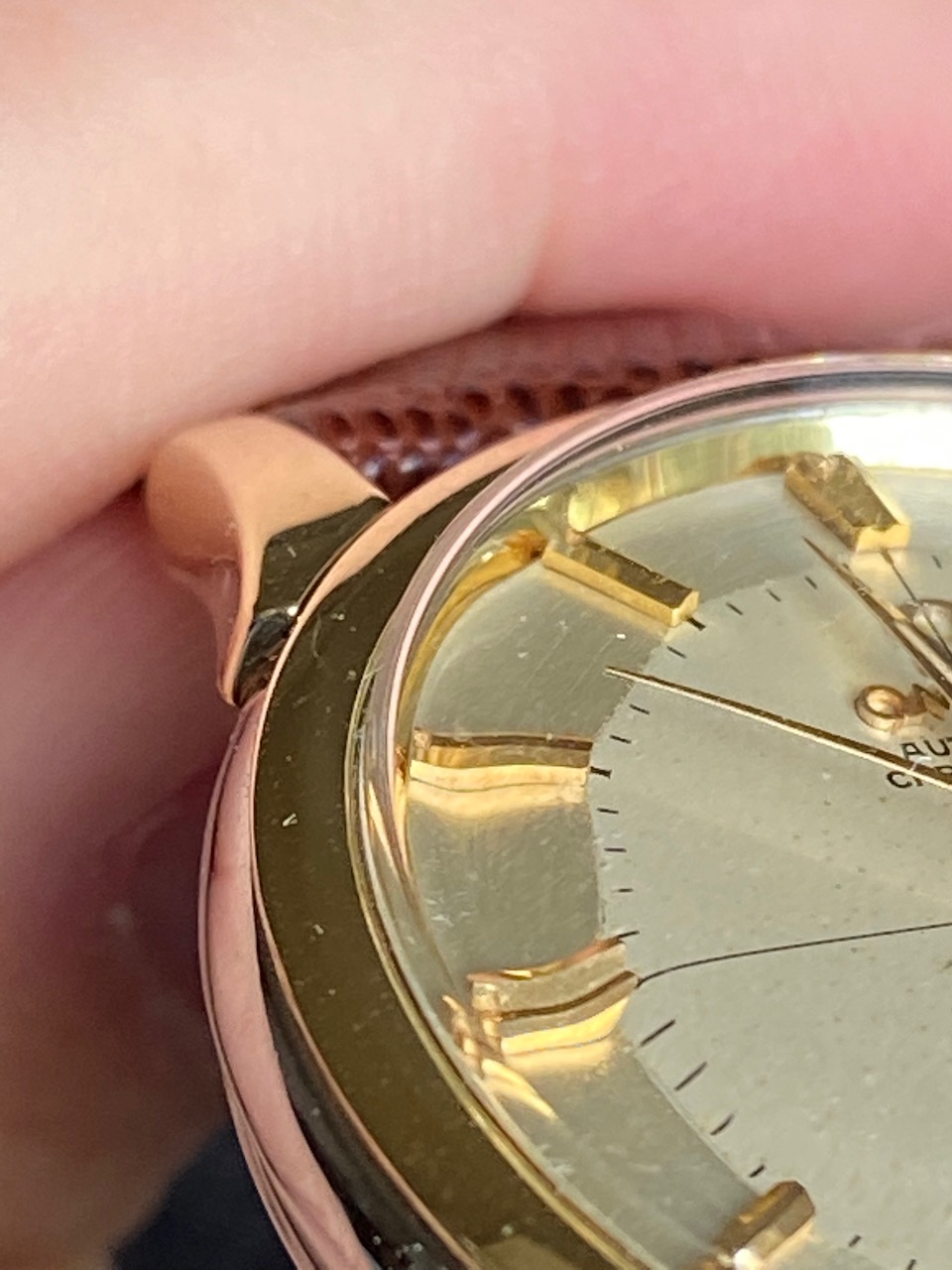

Would this one work, or is it repainted?
https://www.ebay.com/itm/Vintage-Om...228267?hash=item2179228d2b:g:akQAAOSwcd9fdWD8
24,836
55,255
Actually, this view from the back is almost convincing me of the kink.

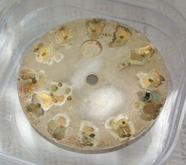

What exactly is happening here Dan? If this is a flat dial with a brush PP effect, how come the line continues over the bit where the paint is missing...
