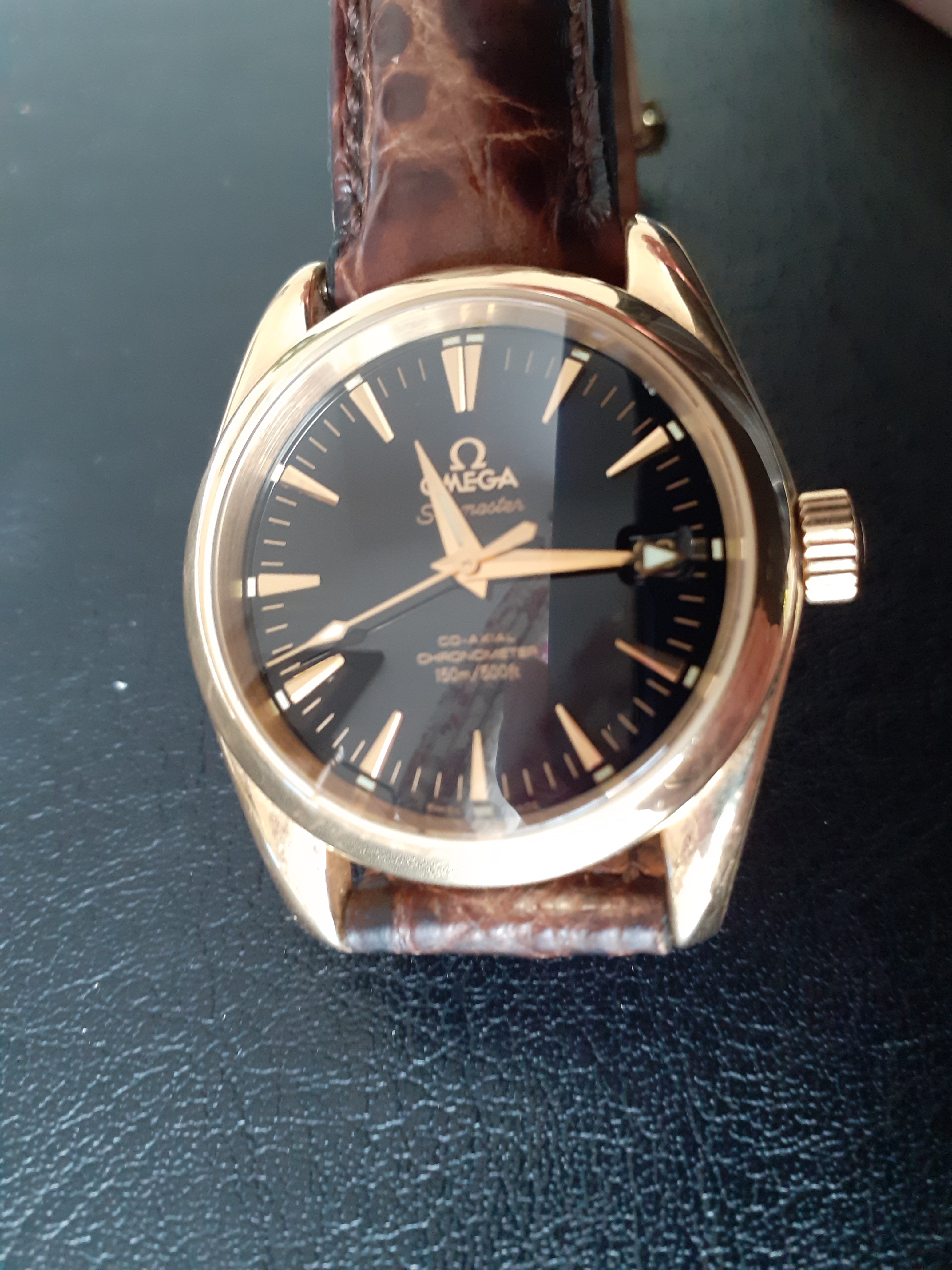

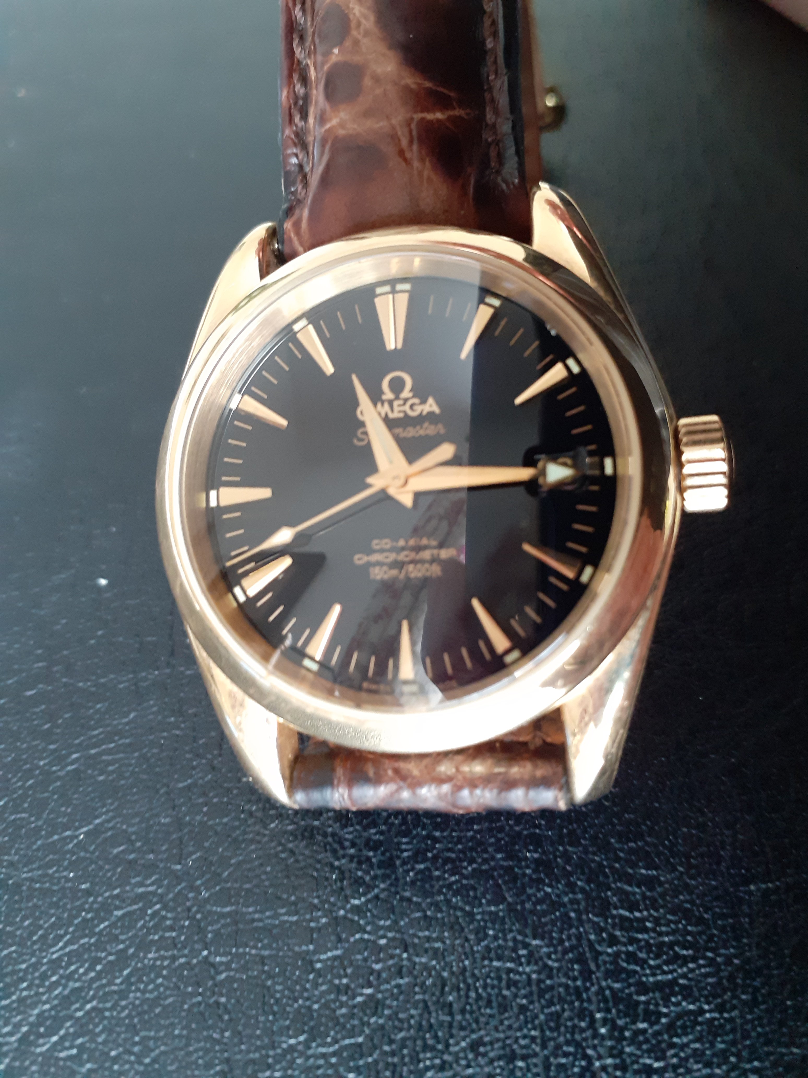

The watch in question is ~15 years old with a questionable service history. As discussed previously in this thread, although the jeweler claimed it was completely serviced, there is a lot of evidence that it was not done properly. Although it was water resistant when first made, unless the gaskets in the crown and back are replaced on a regular interval AND the watch is pressure tested to verify them, moisture can get in and damage a dial.
With that said, the one photo you posted doesn’t show any obvious damage, so I think you made the correct call not to put in a new dial.

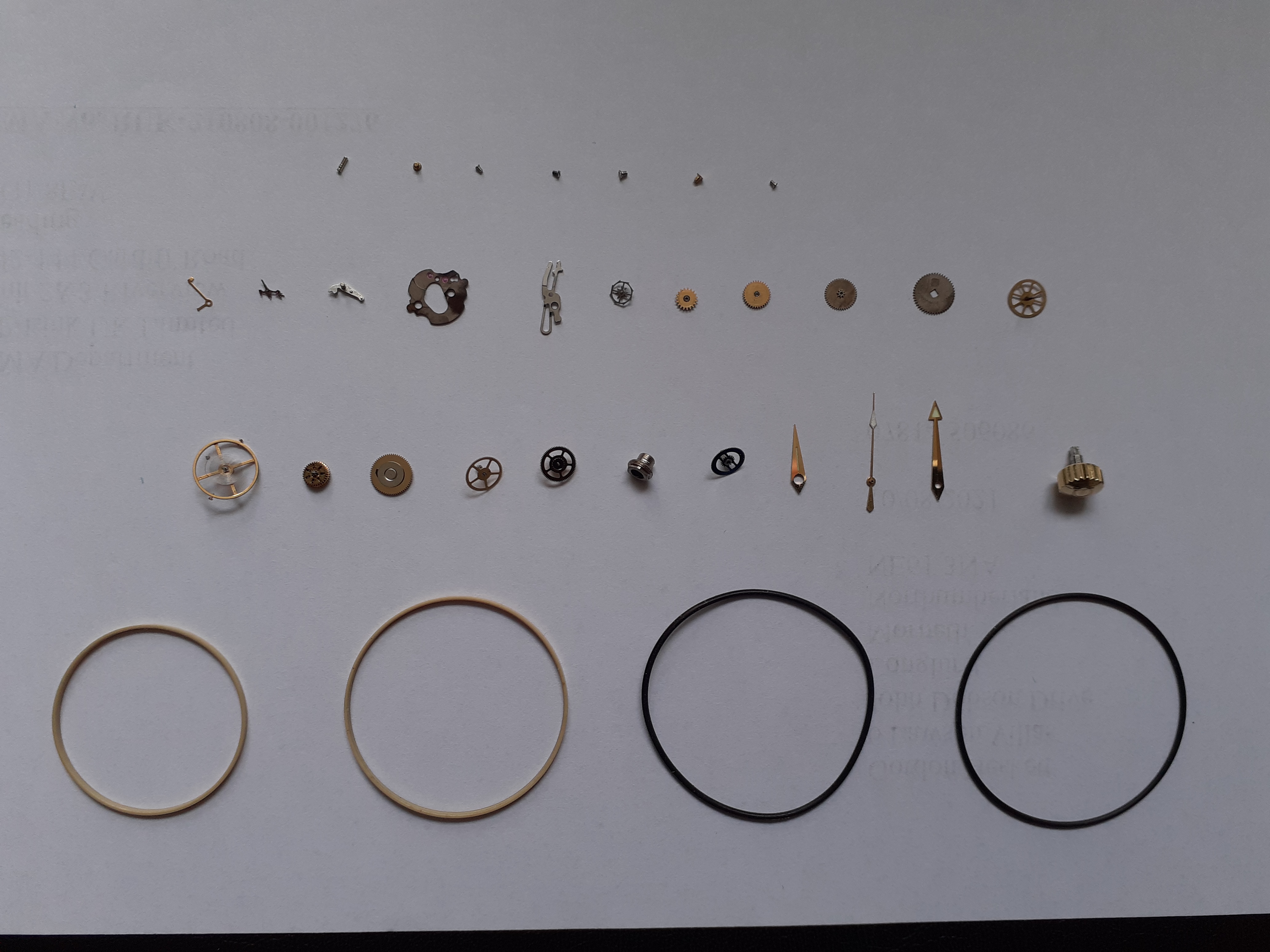

If you didn’t notice the dial or crystal, I’d say you’re fine. Sometimes, Omega can make some kinda wonky suggestions or claims. I just received my Seamaster 300 Master Coaxial back from service (well, several weeks ago) and I remember the initial findings when they inspected the watch indicated an exgraved case back…odd for a watch with a sapphire case back, no?
I suppose the discolored dial could indicate water damage, but if they’re willing to service for the standard service cost, seems like a decent deal. Omega’s services are very inclusive, and they tend to replace a lot of stuff.
You can see here they replaced both mainsprings, the crown, some jewels and several components of the coaxial escapement. This was a 6yr old watch worn in rotation with around 20 others, and left unwound when not in use.

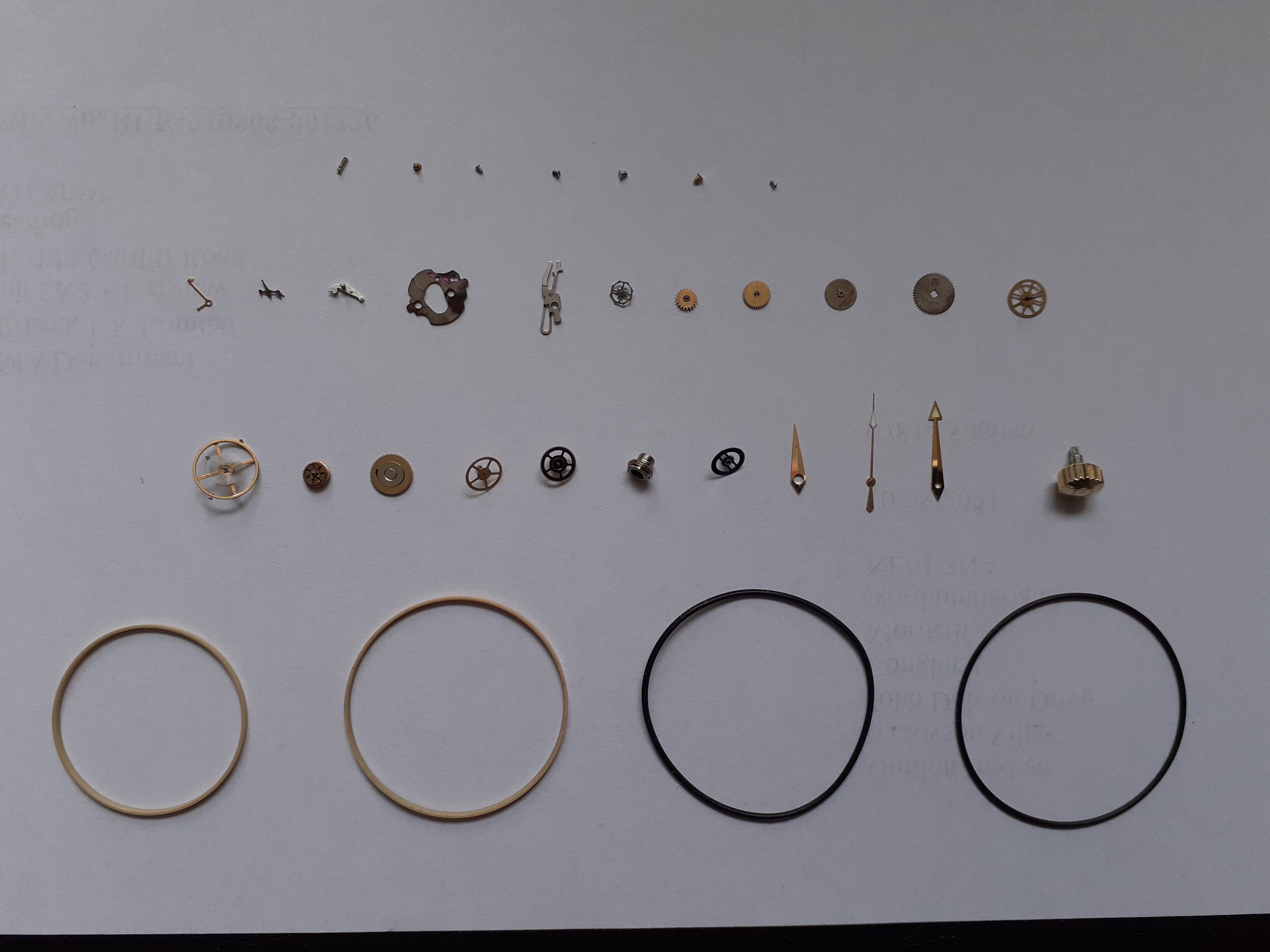

I've had my watch back for about 4 weeks now and am very pleased with it - time keeping is fine, losing around a minute every two weeks and the crown feels totally different when I pull it out to set the time, with a much more positive feel. I cannot see any marks on the crystal or on the watch face, so I'm glad that I didn't spend the extra money on replacing them. From the attached photo you can see that a large number of components were replaced, so I think that a service must have been long overdue!
135
143
Wow—thanks for posting. I love seeing what Omega replaces. I’m not a watchmaker, but it looks like most of the escapement, gear train and a bunch of other parts I don’t recognize. I’m a little surprised that there’s no mainspring and barrel in there.
