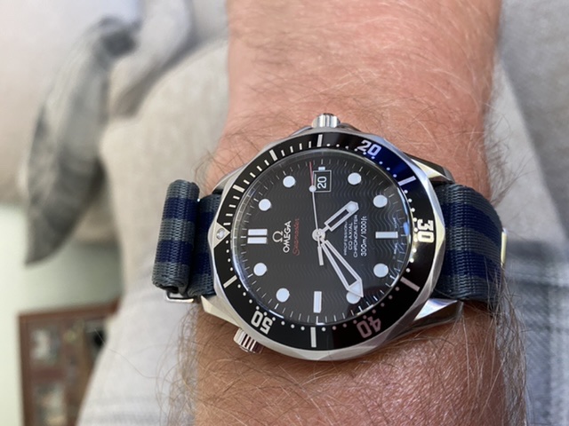

I had my 2010 Seamaster Diver (2500c movement, see picture below) serviced by Omega last September, on collecting the watch from the AD I asked how long Omega could continue to service my watch, the AD stated that it was likely that parts would still be available in 25 years time as so many watches using this movement have been made and the 2500 is still being used by Omega, I therefore shouldn't be concerned about the watch becoming unserviceable.

SkunkPrince: I hope you're right, especially on the coaxial movements, not everybody can service them properly. I was once warned by an Omega Authorized Service Center not to buy the older 2500 with its a-b-c-d versions citing that they will be problematic in the future as far as the availability of spare parts is concerned. I naturally shied away that time and headed for Rolex. YMMV I really don't know much about these movements.
I'm thinking of buying an Aqua Terra with the new 8900 movements though, I hear it's a good movement. I need to do some research.
At any rate, I definitely prefer the Omega policy to Rolex, despite the $1500 price tag. I hear of horror stories on the Rolex forum of watches being returned to customers, just like my Tissot, asking customers to go buy themselves a new watch. It sure is the new business model in the industry. Watches are heirloom items and most have an emotional value attached to them far greater than their market price. I'd fix my dad's 1950 Eterna or my grandad's Zenith pocket watch for far greater than its market price, just to keep it going and hand it over to the next generation.
