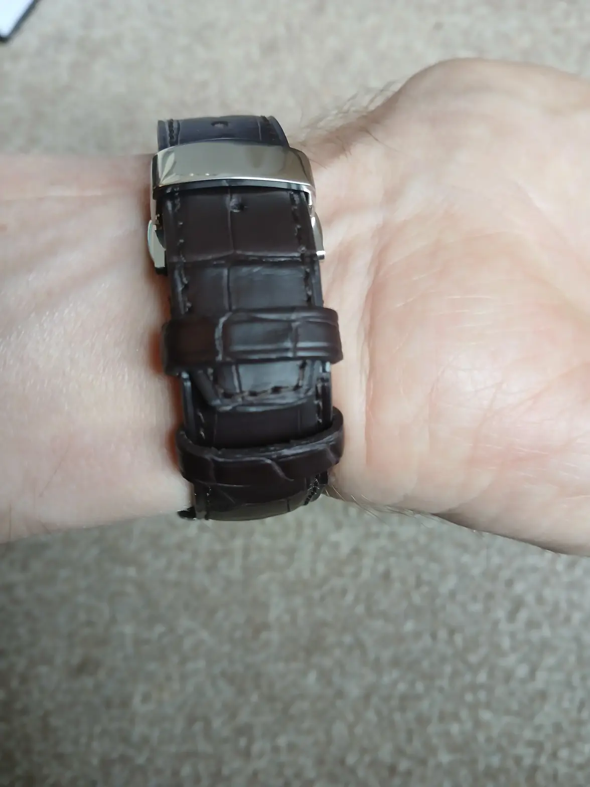

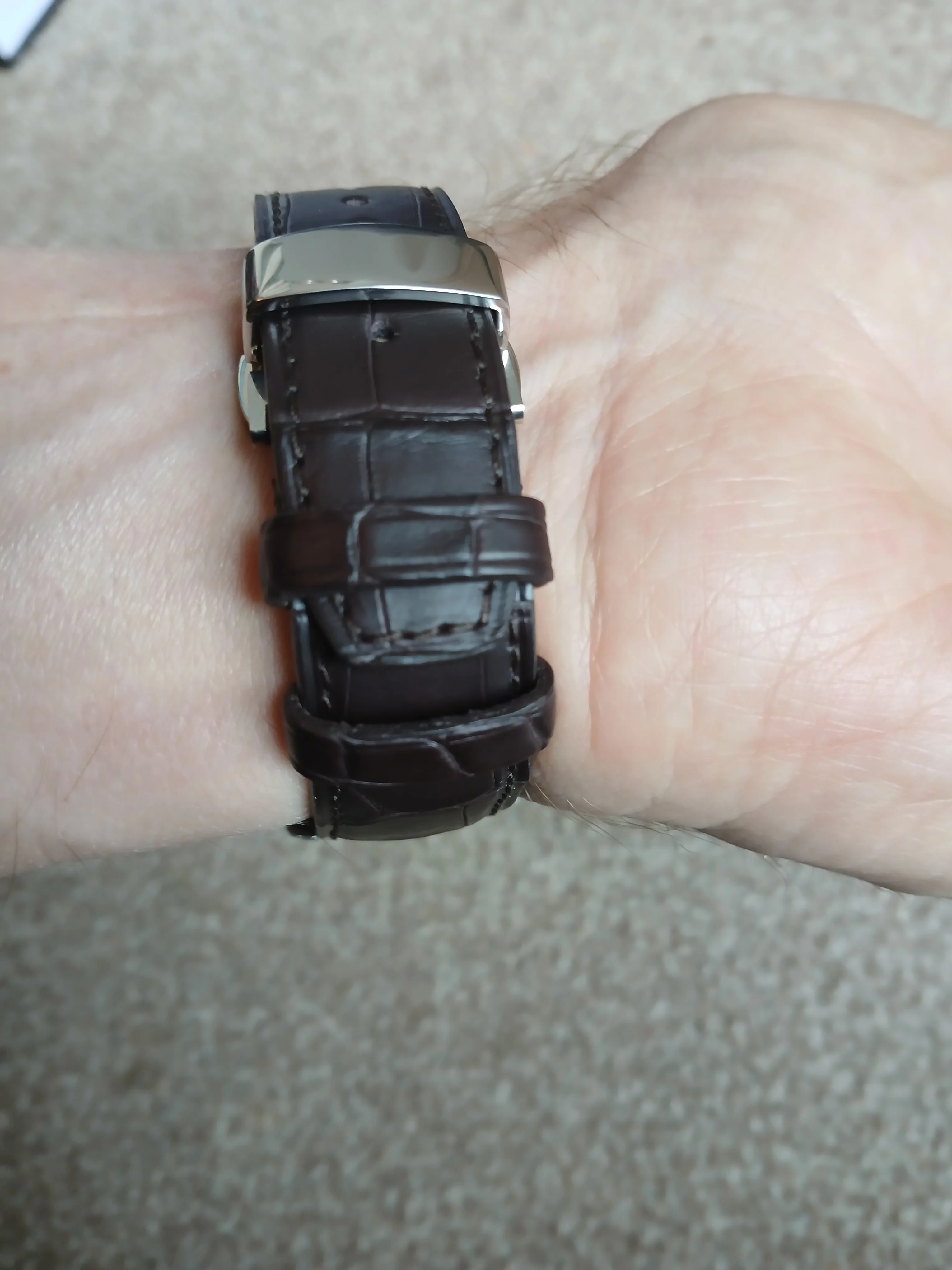

Just that ^^^ - bought a custom leather strap for my Speedmaster - followed the instructions for ordering, chose the correct length for my 16.5 cm wrist - problem is, the strap was for small wrists (15.5 - 16.5) well that's me, 16.5, so I'm at the exact extreme end of that scale.
However, once I got it on my wrist, I need to use the second to last hole (the other 3 are too tight) and the end result is that the end of the strap that feeds through the "keepers" is so short, it doesn't even go through the second keeper!
To my eyes it needs at least another cm of leather, maybe 1.25 or even 1.5 to look right.
Maybe I am comparing it to normal leather straps where you need that extra length - perhaps it's normal on deployant straps to not need the extra material?
Thsi is my first strap with a deployant clasp - any experienced members who can give me their opinion?

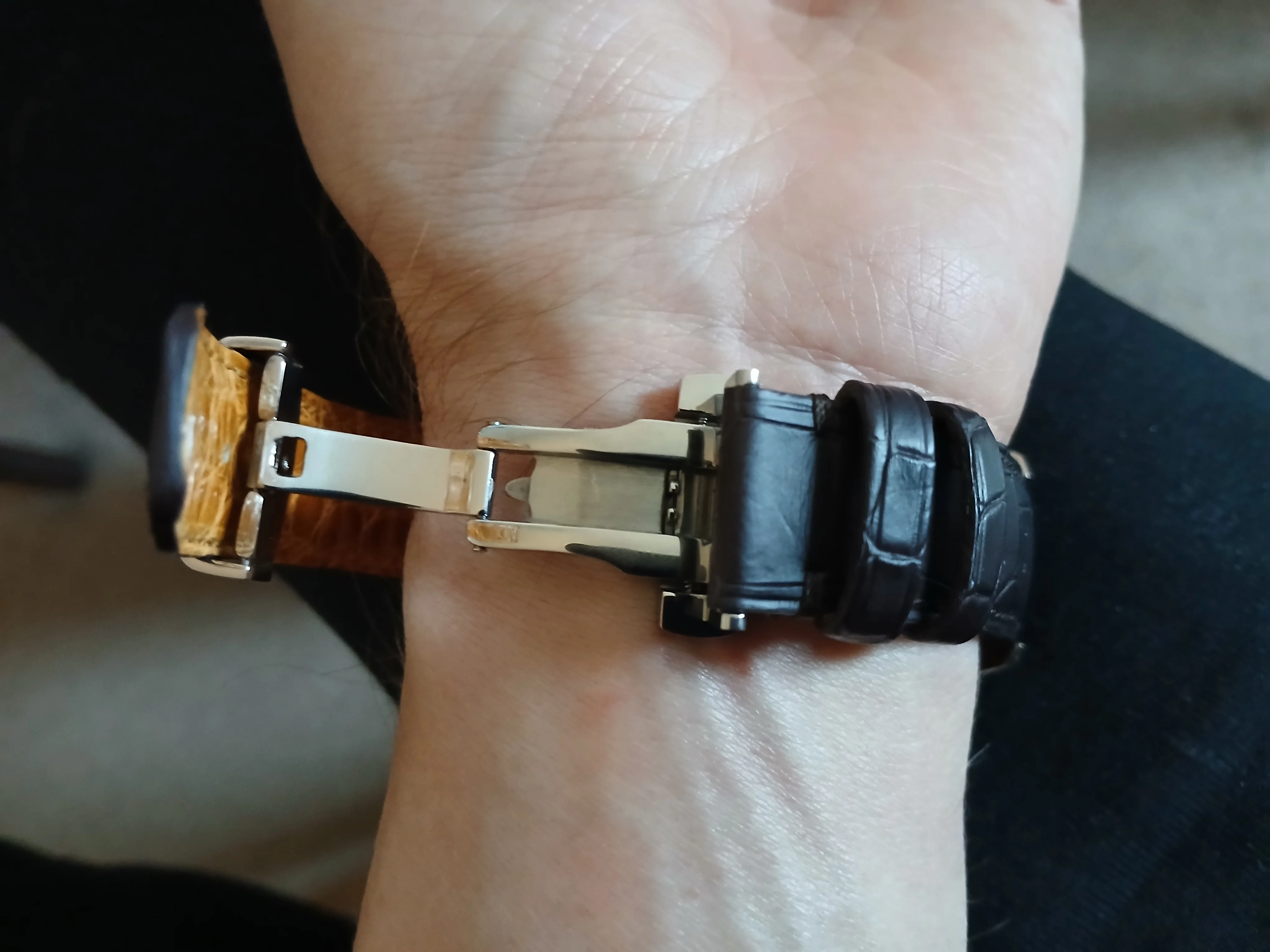

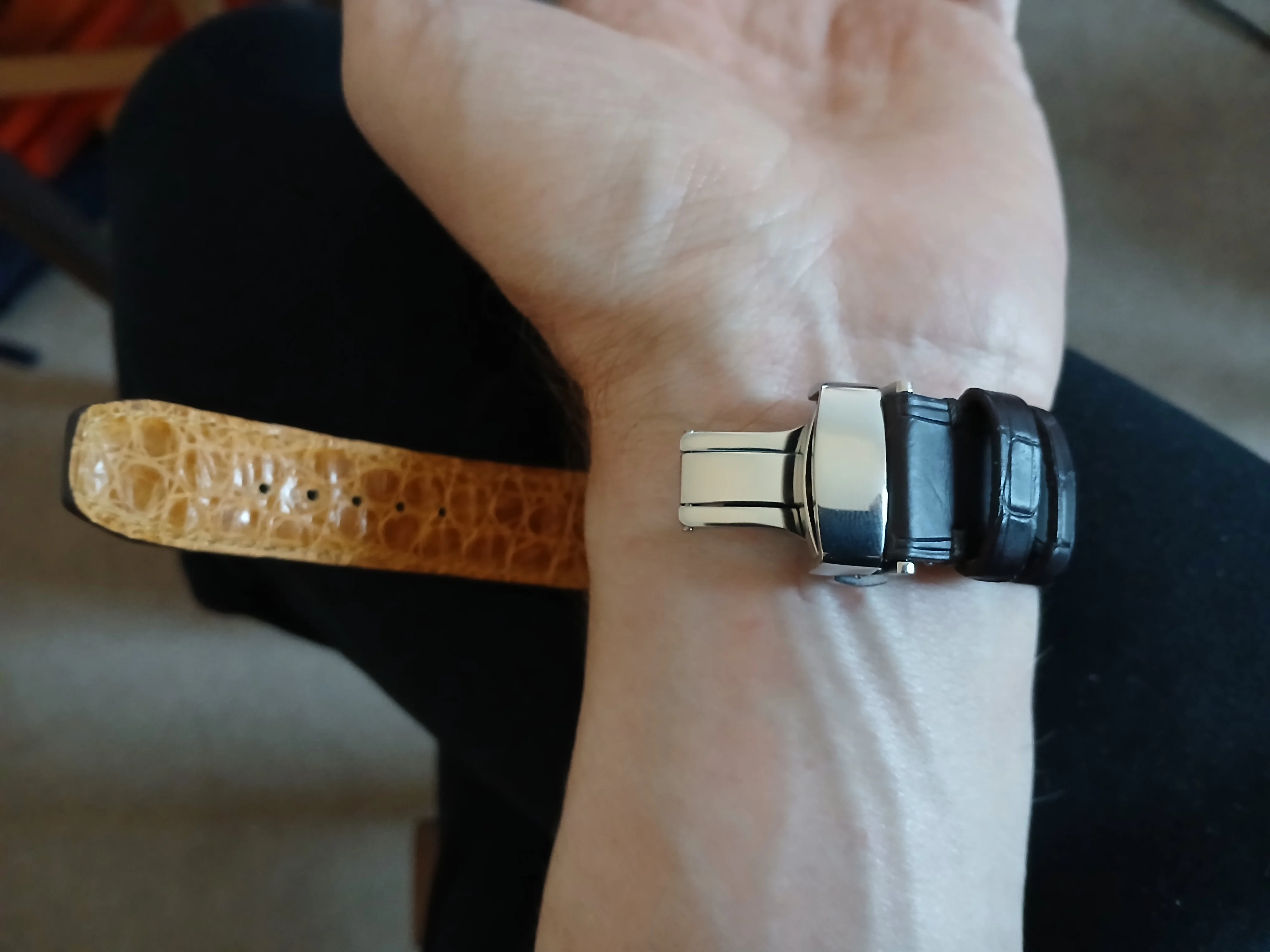

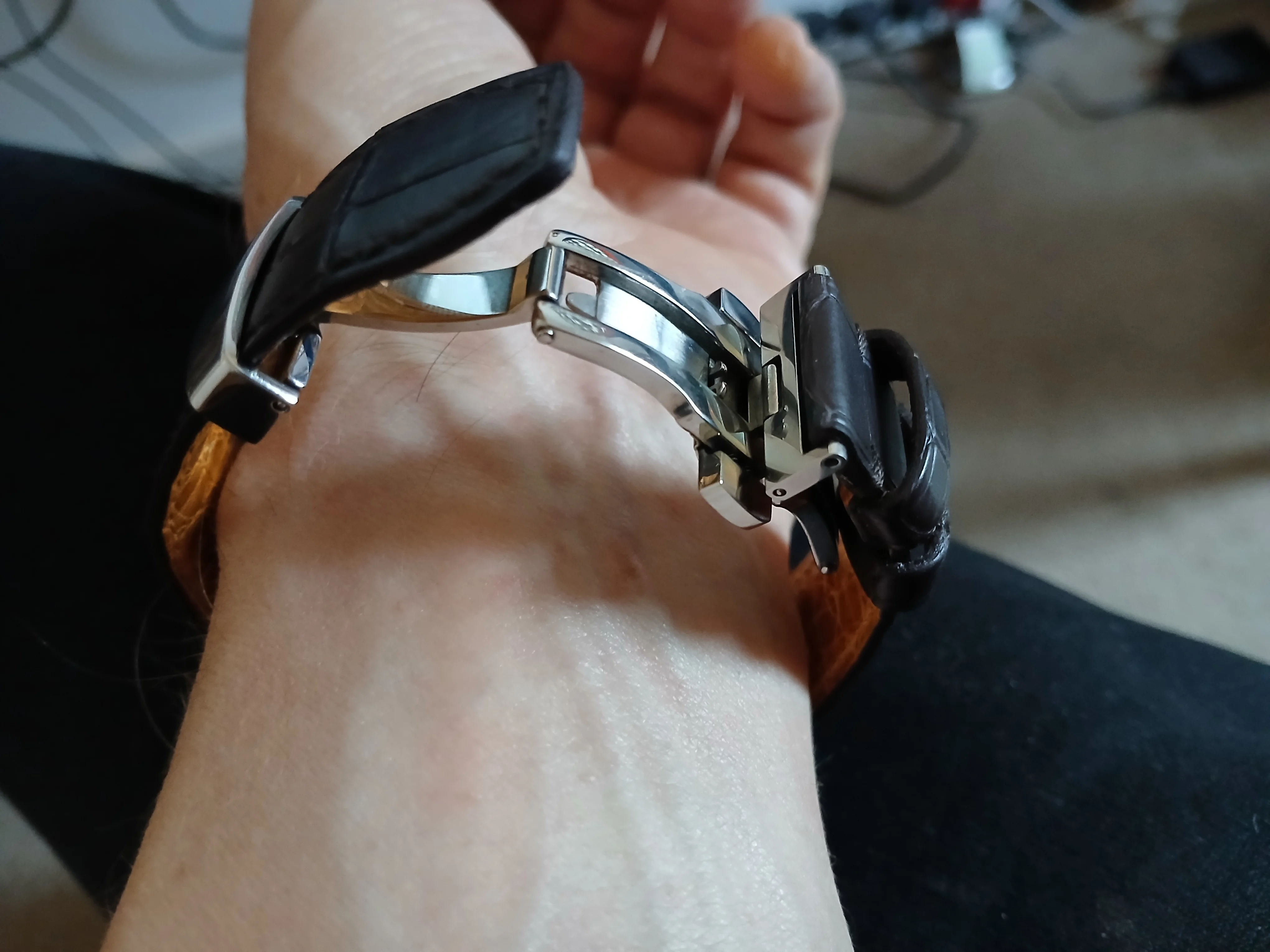

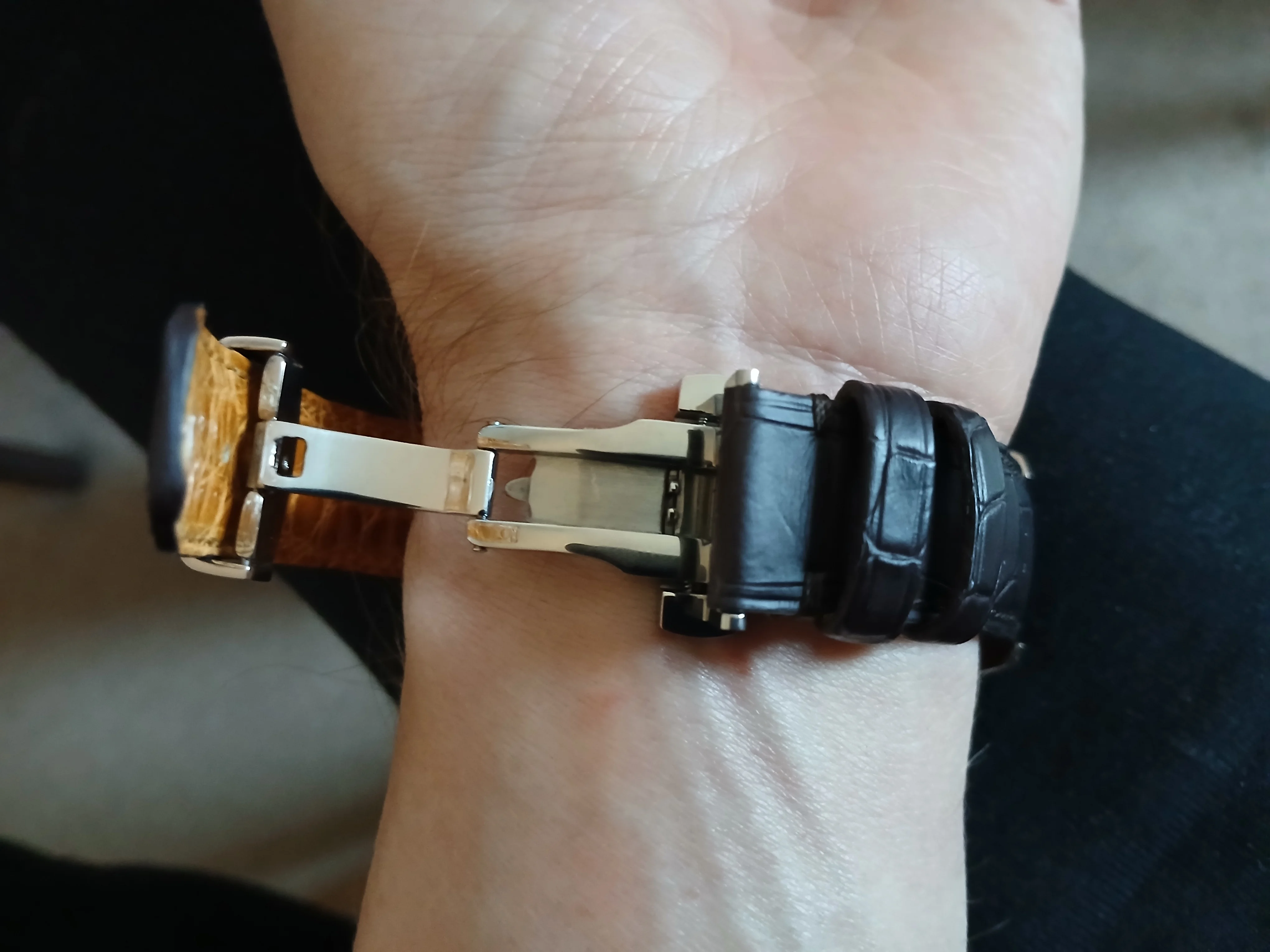

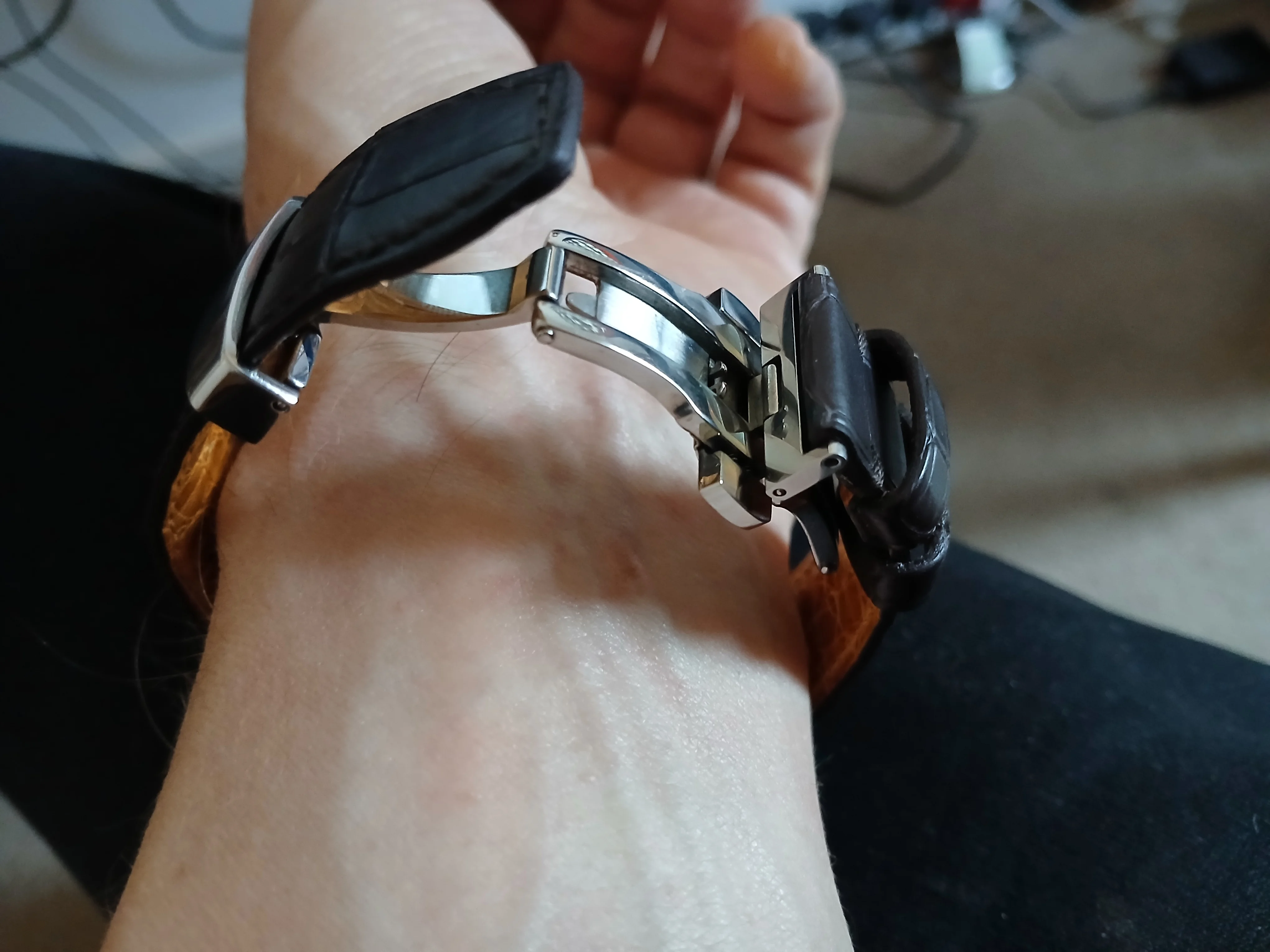

Yes it's a butterfly type - here are 2 pics with just the 12 o'clock side of the clasp snapped shut:
6,459
31,812

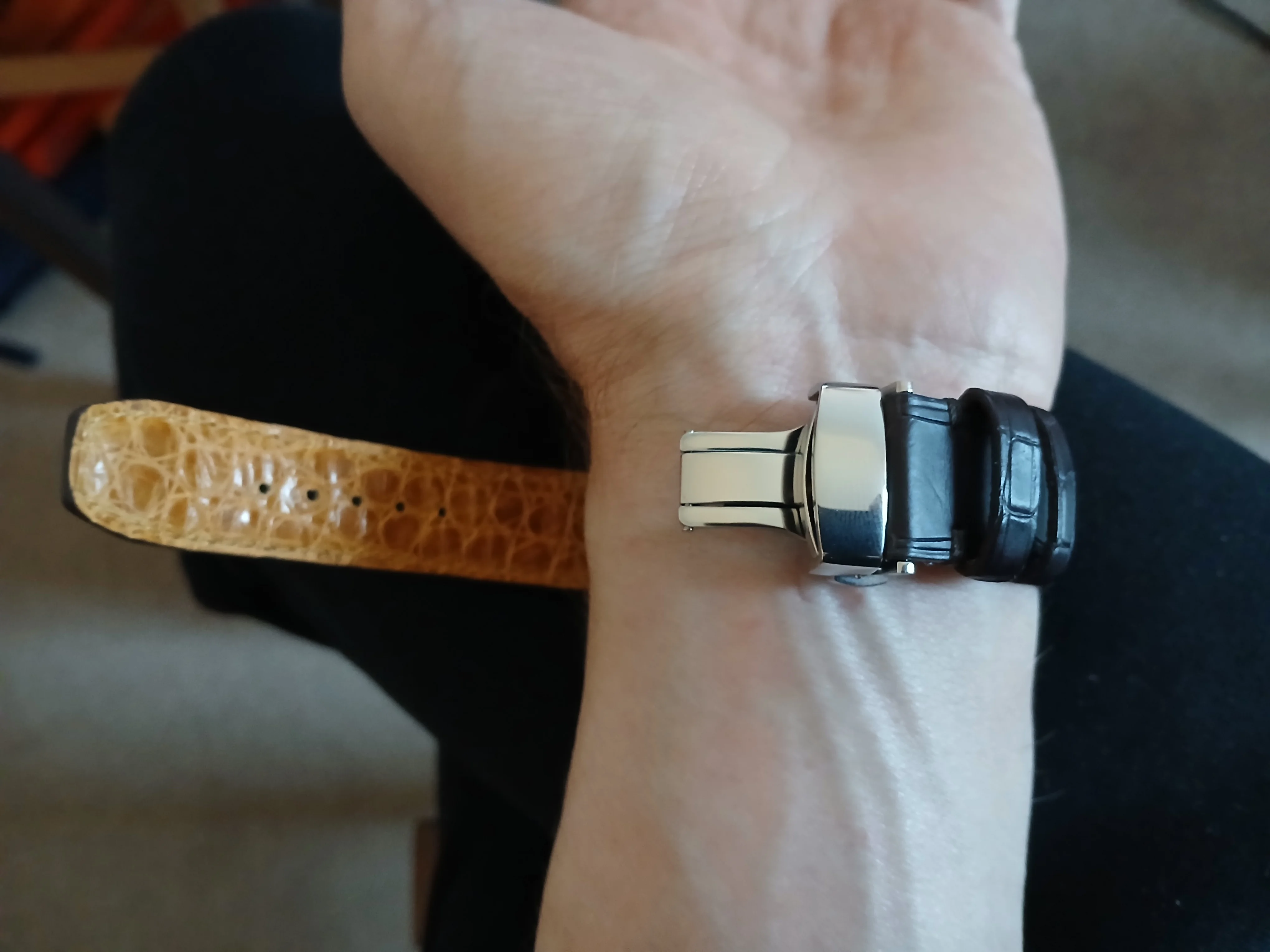

Could you show it closed without the 6 o'clock side strap on the deployant?
24,815
55,164
IMO, it should look the same as with a buckle. No difference.

It seems to me having tried the smallest wrist size hole (at this point the strap sticks out enough to easily fit through both keepers) that's it's simply because it's the smallest strap that will still just fit my wirst - maybe I'd have been better getting a medium sized one, and being on the smaller end of that.

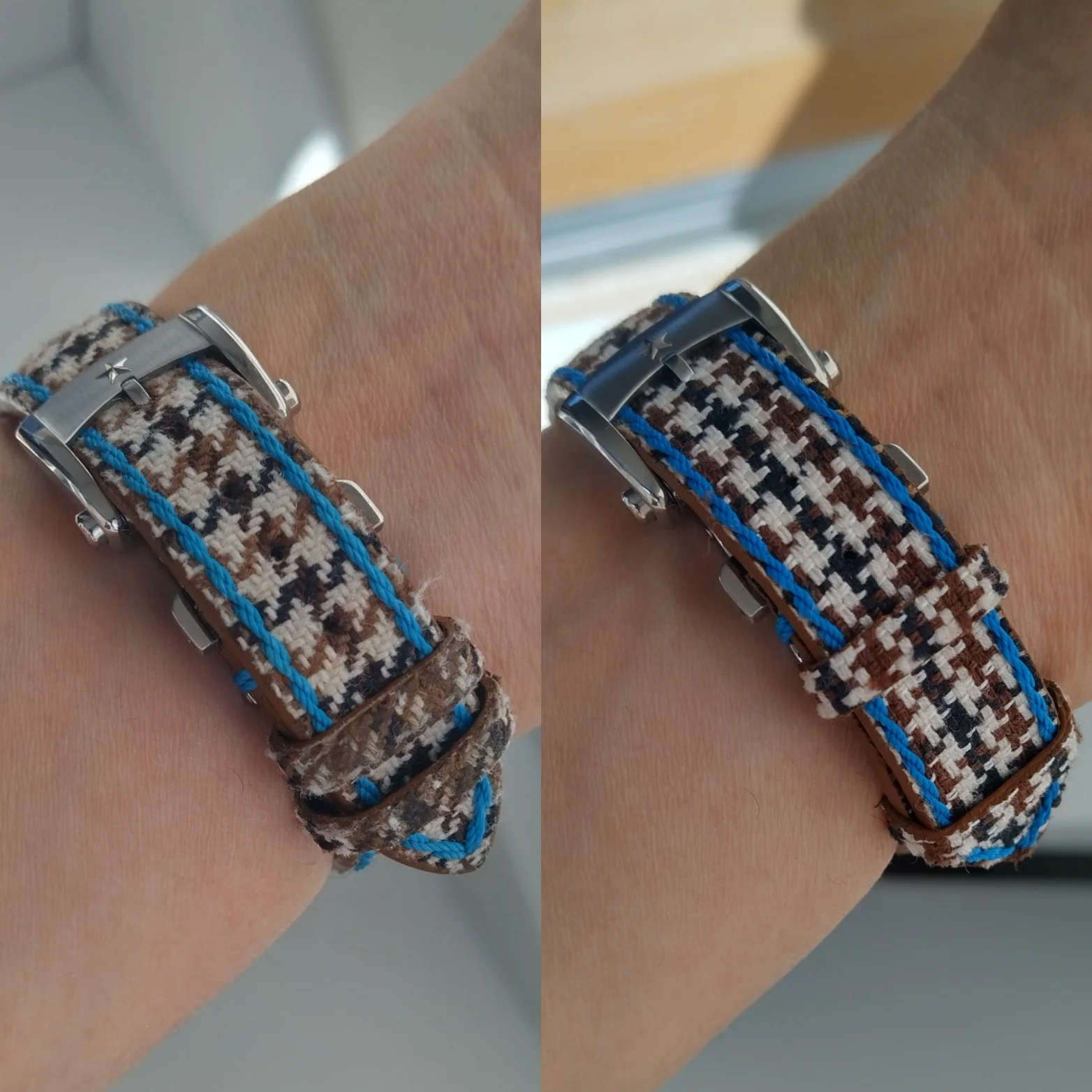

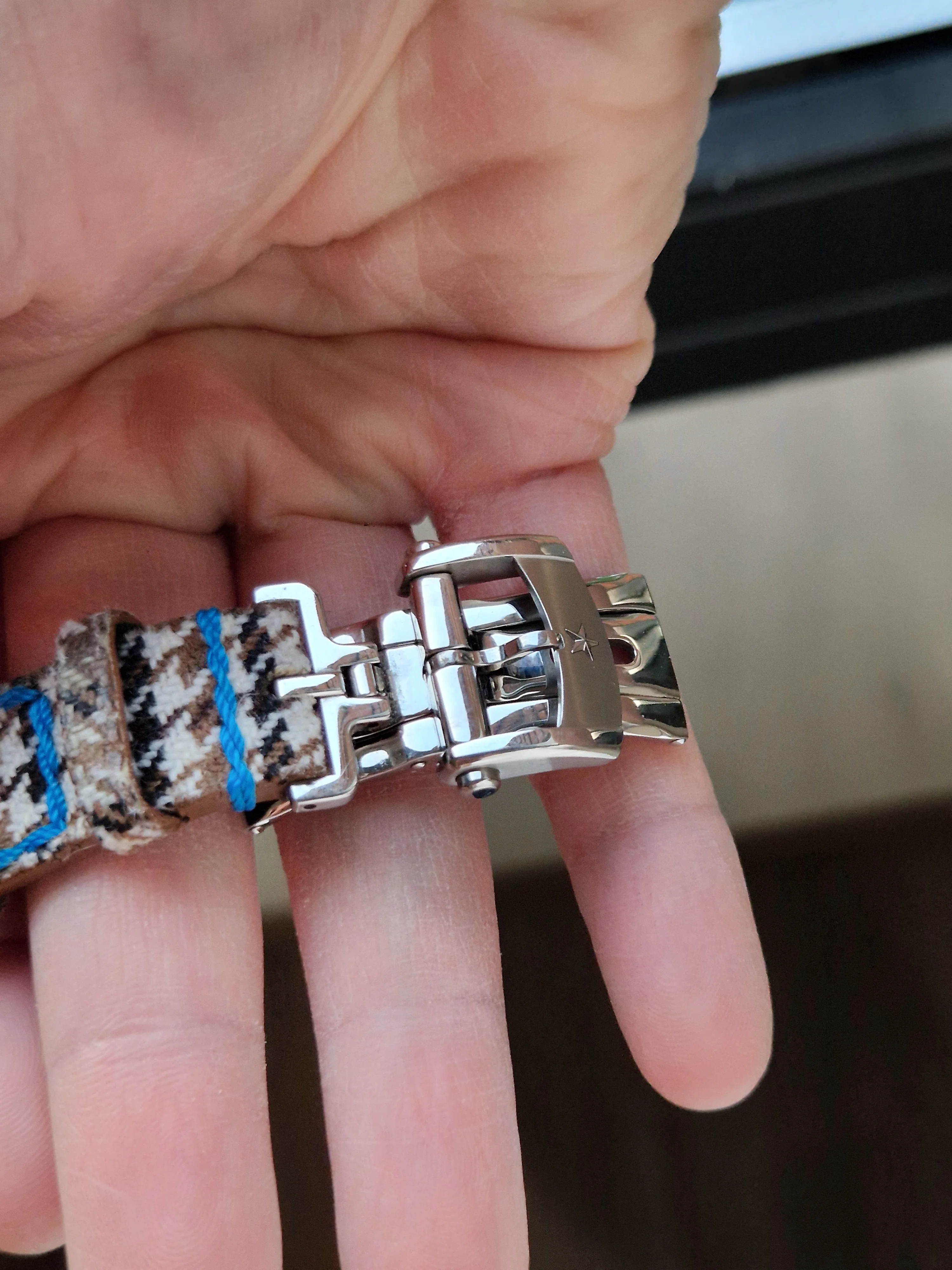

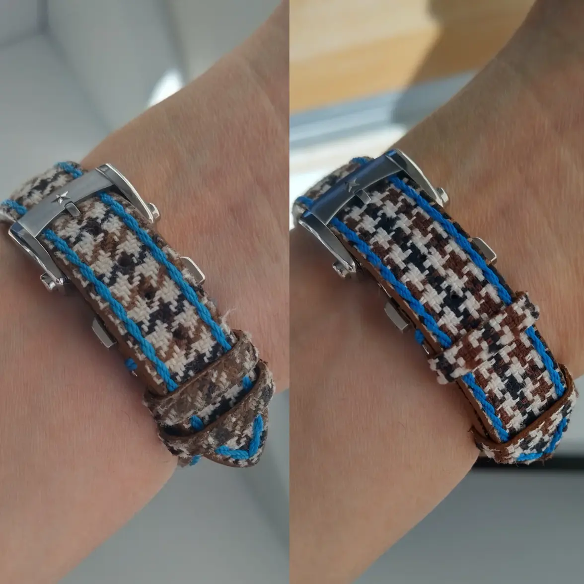

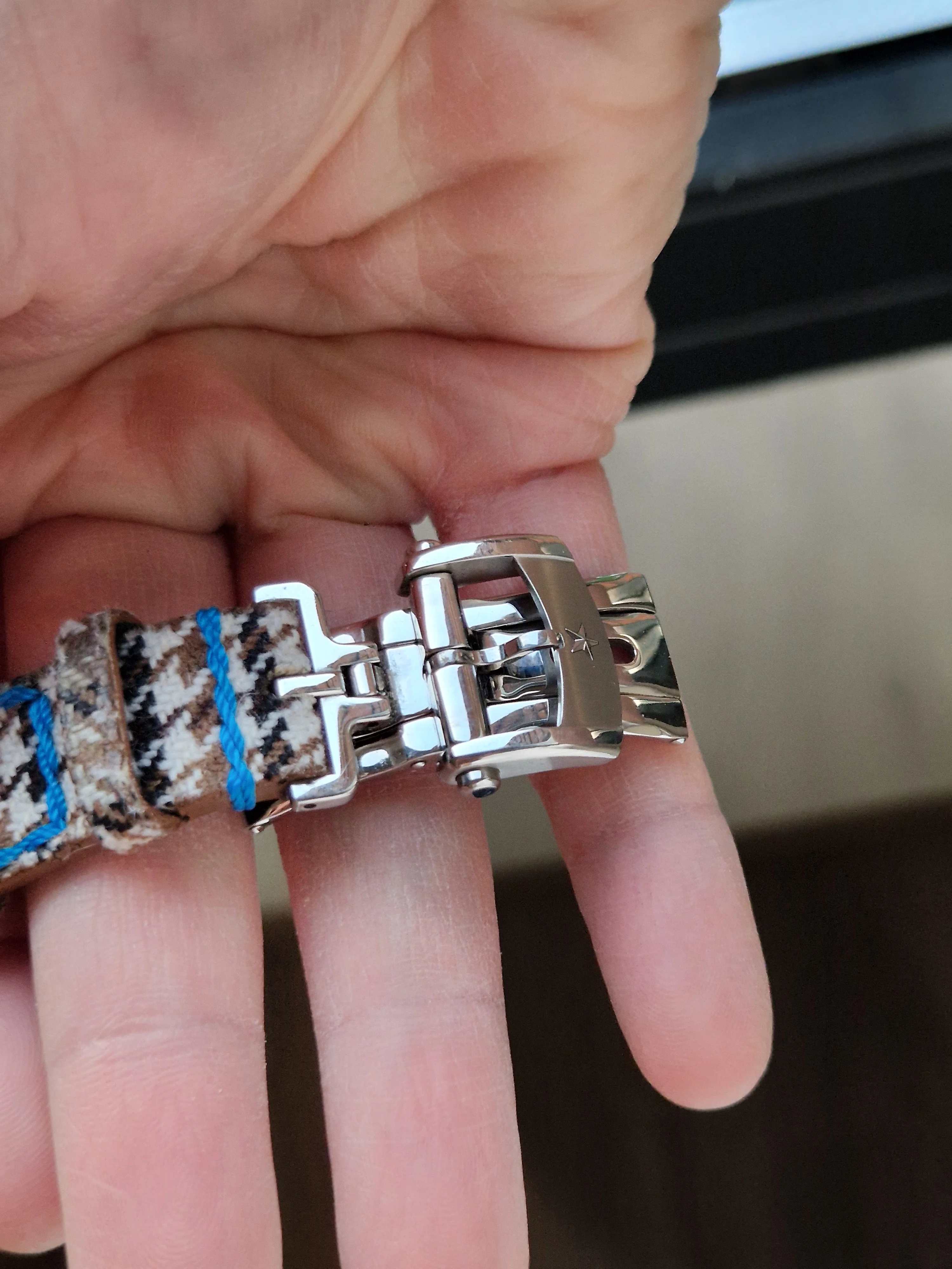

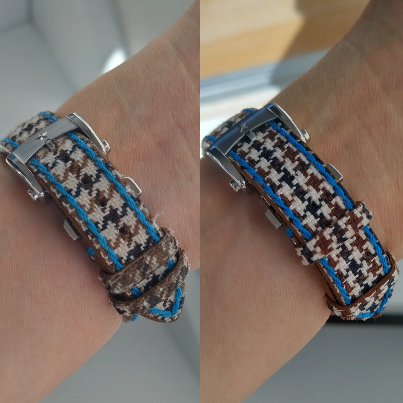

Some butterfly deployants have a gap which necessitates a longer strap, Zenith for example, left is 112/72mm, right is 127/72
223
337
This one is 105/70mm
I'm thinking I should have got a 115/70mm
6,459
31,812
Agreed, 120mm (if they even make that size) would be even better.

Yes, it might have to be longer. I just meant that cosmetically one would want to have the same amount of extra strap showing

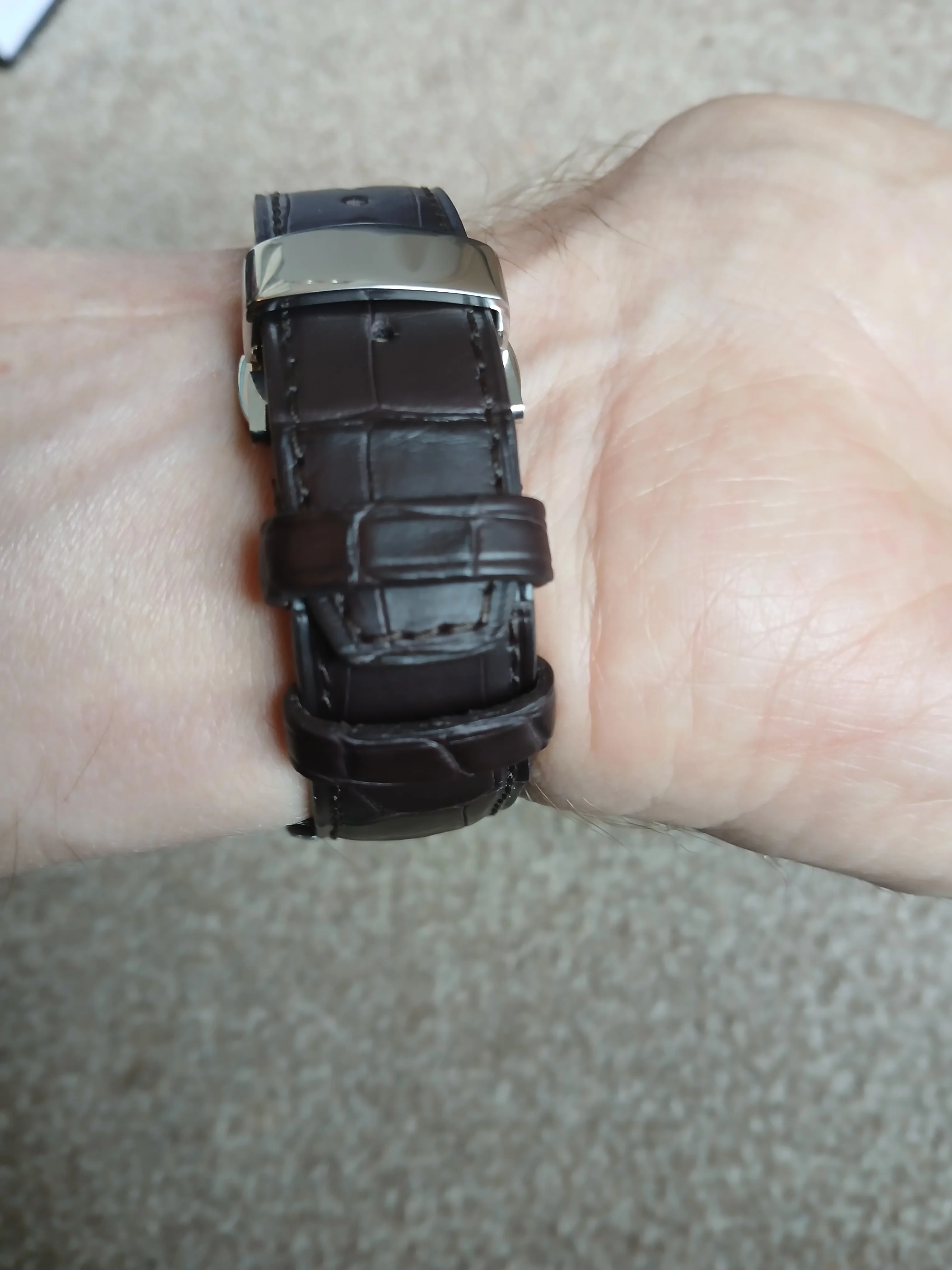

It should go through the second keeper to look right. In this case get rid of that keeper because it's not doing anything. Next time you'll have a better idea of the correct length for your wrist.
I might try and convince them to make me the longer side a bit longer, see what they say. Otherwise, yeah, I'll just snip it off.

If you used that strap with a tang buckle, it might be OK. The strap probably needs to be longer when using the deployant, because it is routed around the bulky clasp. So put a buckle on that strap, and buy a longer strap for the deployant.

I wouldn't give up on it so quickly. Like Dan said, try it with a tang buckle and see if that works. It looks like a nice, well made croc strap, use it if at all possible. You won't get much if you try to sell it, and giving it away is just money down the drain.
