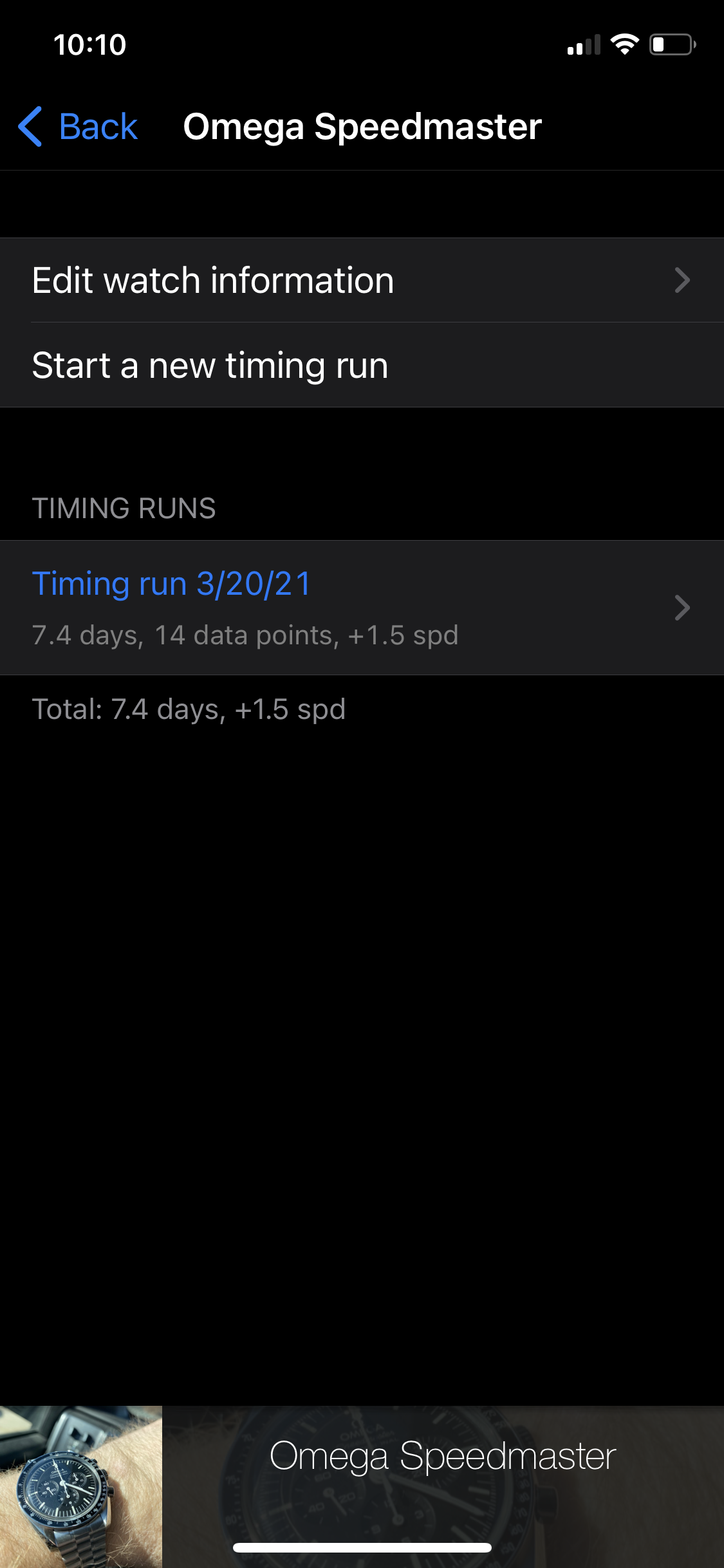

I have the new speed master professional, it picks up around 1 second per day. Amazing to me!
25
How are you measuring this?
