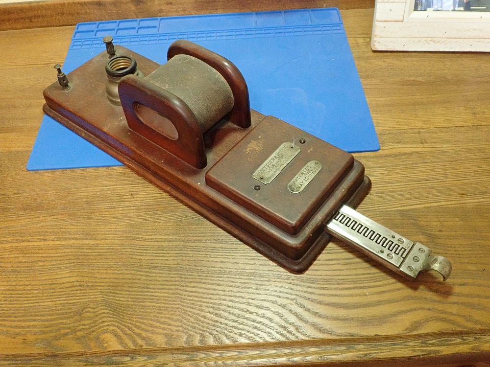

I like mine but it's getting hard to find batteries!
I like the "alternating current" device Jim 😁. Looks like you only need three hands to operate it.
Lovely bit of horological nostalgia. Have you found a bamboo filament globe for it yet?
I've worked out a "third" hand but you have to be careful not to spill the glass acid battery!
I couldn't possibly show you as all my "hands" are in use.
