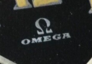

If you like repainted dials, why not ? All 3 are not correct. All repainted dials. The last one seems to have a generic case back as well. The non existing pics " inside case back " should be the red flag. The description is completely Bogus. Educate yourself about Omega sign fonts during the decades.... Then you will know.

Hi @Harry jenkins and welcome to the forum! If you're interested in vintage Omega fliegers, there are a few threads on this forum that show these rare watches, and it would be worth your time to find them and study them.
This thread has photographs of two lovely examples - compare the dials on these images from that thread to your ebay listings and note the differences in the Omega logo and numeral fonts...
24,847
55,283
As noted above, if you take some time to study how the Omega symbol and logo changed over time, that will be a good starting point. After a while it will become second nature and you will look back at this thread and laugh. A 1930s watch can't have a 1980s font.

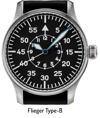

On a similar thread did Omega ever do a Flieger B-uhr dial, examples from others manufacturers.............
1,030
2,618

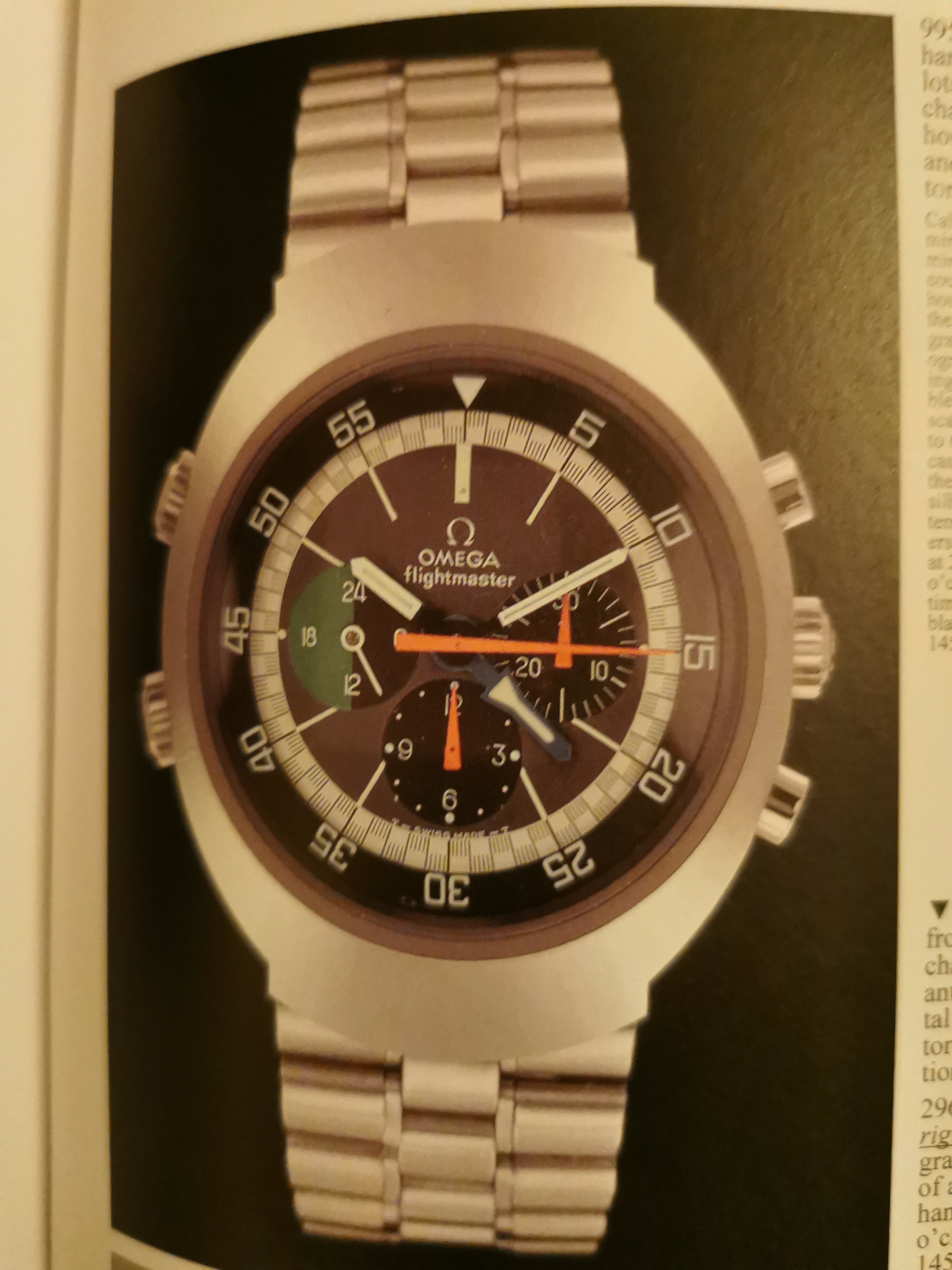

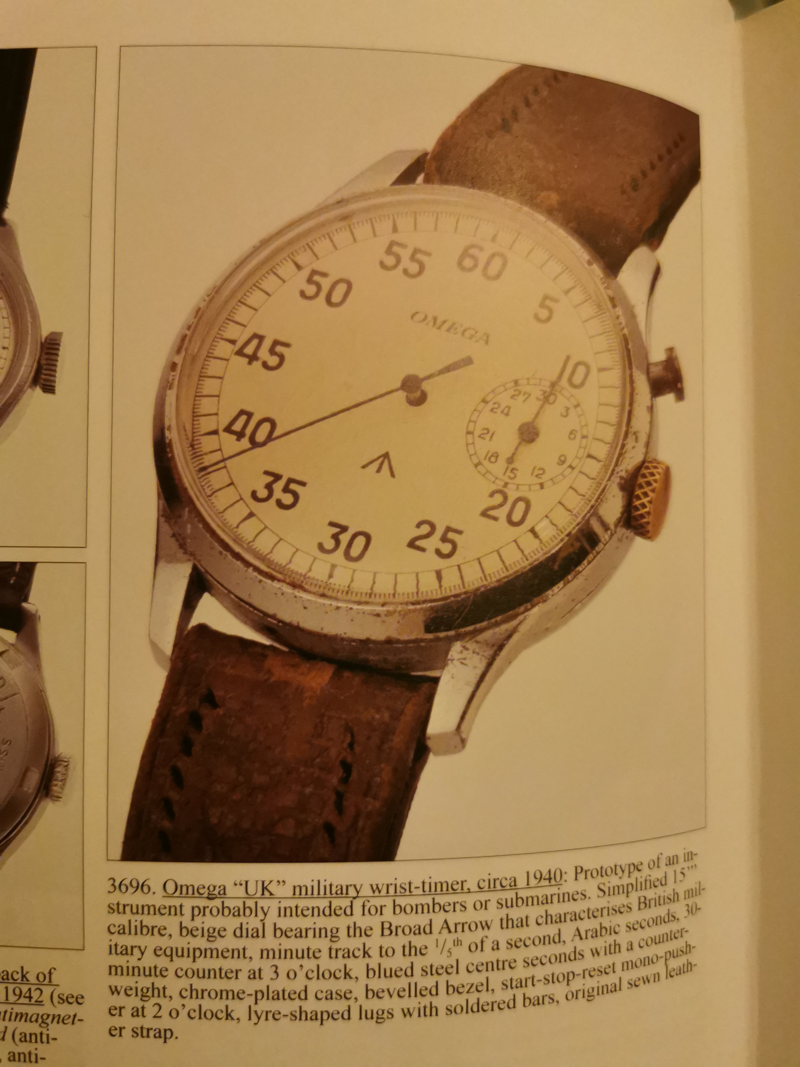

In AJTT there is a reference and picture of a military prototype timer and the flightmaster is similar.
5,737
9,524

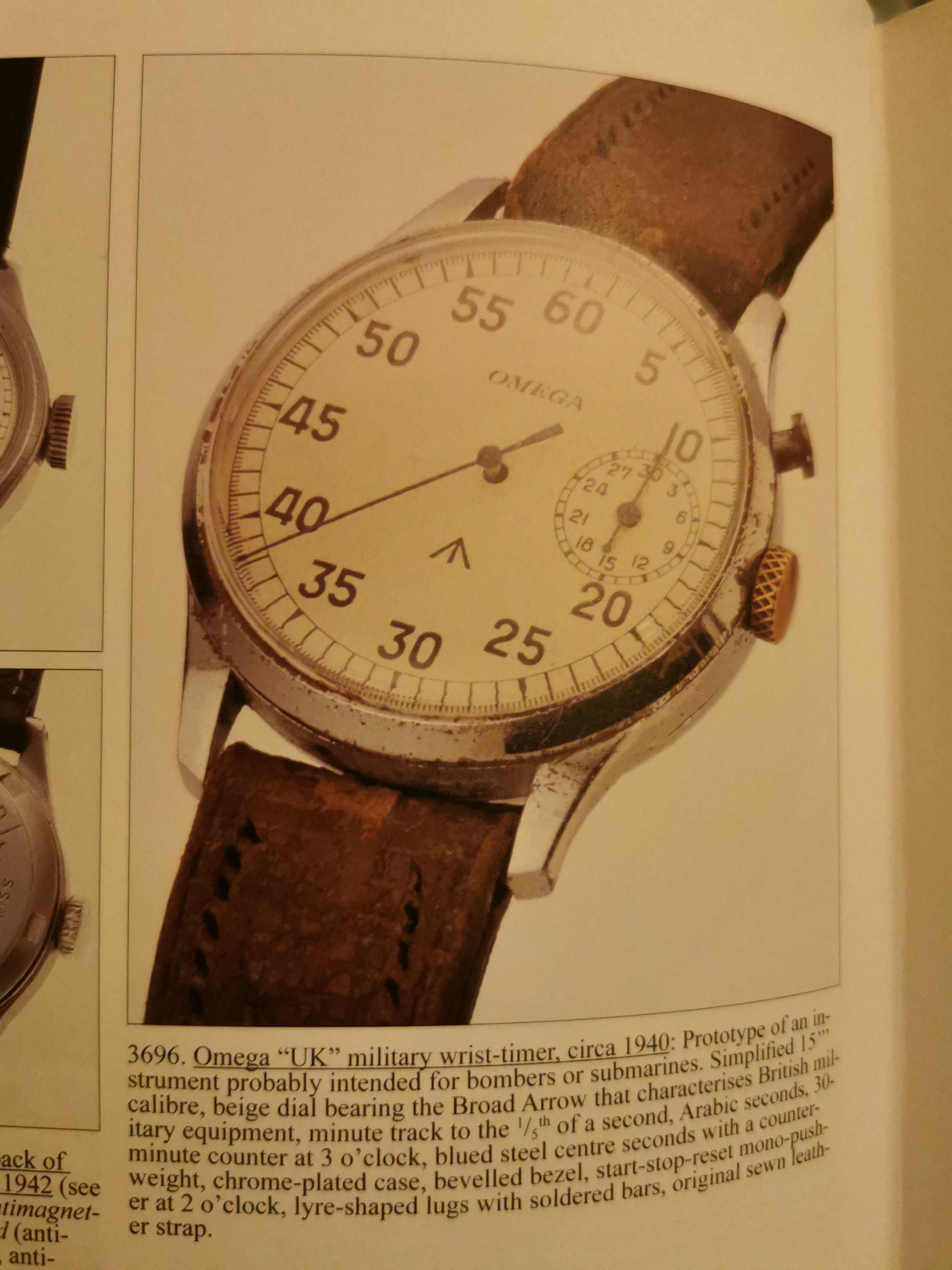

Pls. Provide pictures.
18,861
39,231
Don't remember ever seeing an Omega with a Flieger style dial (unless it was from Ukraine).
Can't see anything in AJTT either.
1,030
2,618
As we know AJTT is not the definitive list so wondered if anyone has a true flieger dial Omega.
5,737
9,524
So, what new evidence do you have to offer ? First is a stopwatch. Second picture is not anything like it either. Maybe make it easy for you: Omega NEVER made a B Uhr like model. These fulfilled a need during the Wars. Omega was NOT on board. If you want to re-write the Books, pls. offer conclusive Evidence.
