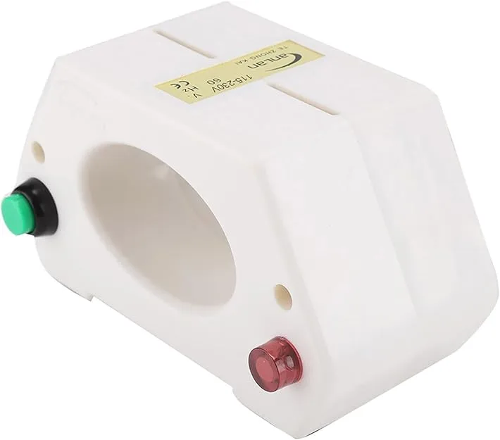

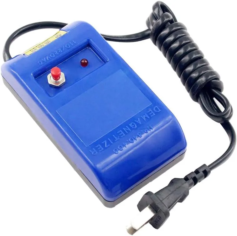

So I bought two cheap watch demagnetizers on Amazon. A blue "Tui Ci Qi" unit for about US$13 and a white "HUAXING" unit like a mini MRI machine for about US$20.
I put both of these devices on a power meter, and found the blue one used about 7.6W and the while one about 23.3W. And then I played with both, magnetizing and demagnetizing a small screwdriver. IMO opinion the white unit worked better, but it could be the technique.
For the blue unit, most recommend putting the watch on the pad, turning the unit on and then slowly lifting the unit up and away from the pad for more than 24" (60cm) before turning the unity off. But some recommend rubbing the unit back and forth and around on the pad. I tried both with my magnetized screwdriver with variable results.
For the white unit, most recommend putting the unit in the unit's hole, turning the unit on and then pulling the watch out and away from the unit for more than 24" (60cm) before turning the unit off. However, some people recommend passing the watch completely through the unit from one side to the other.
For either unit, multiple passes could be used to possibly improve the results. I found the white unit consistently demagnetized my screwdriver in one pass.

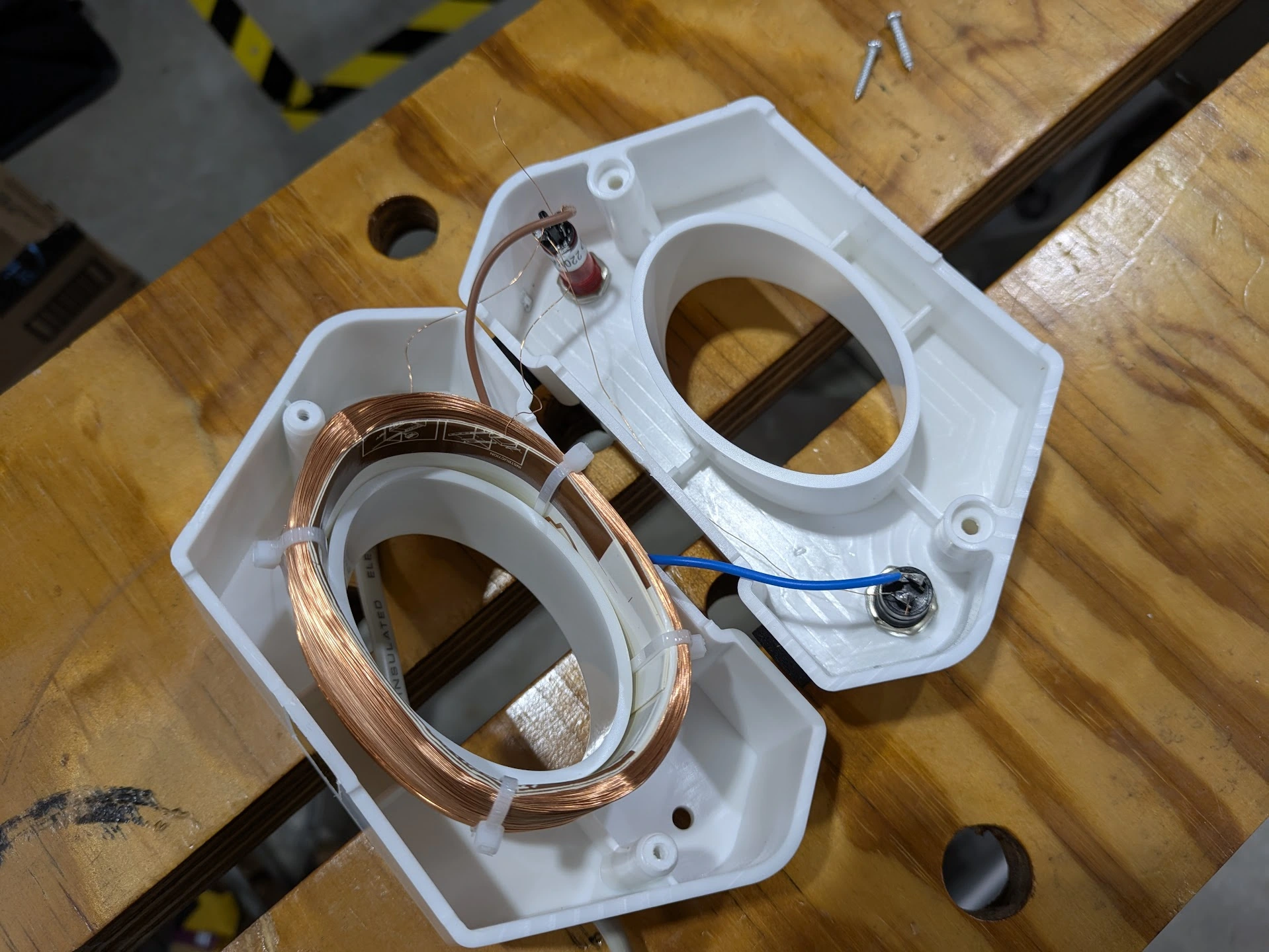

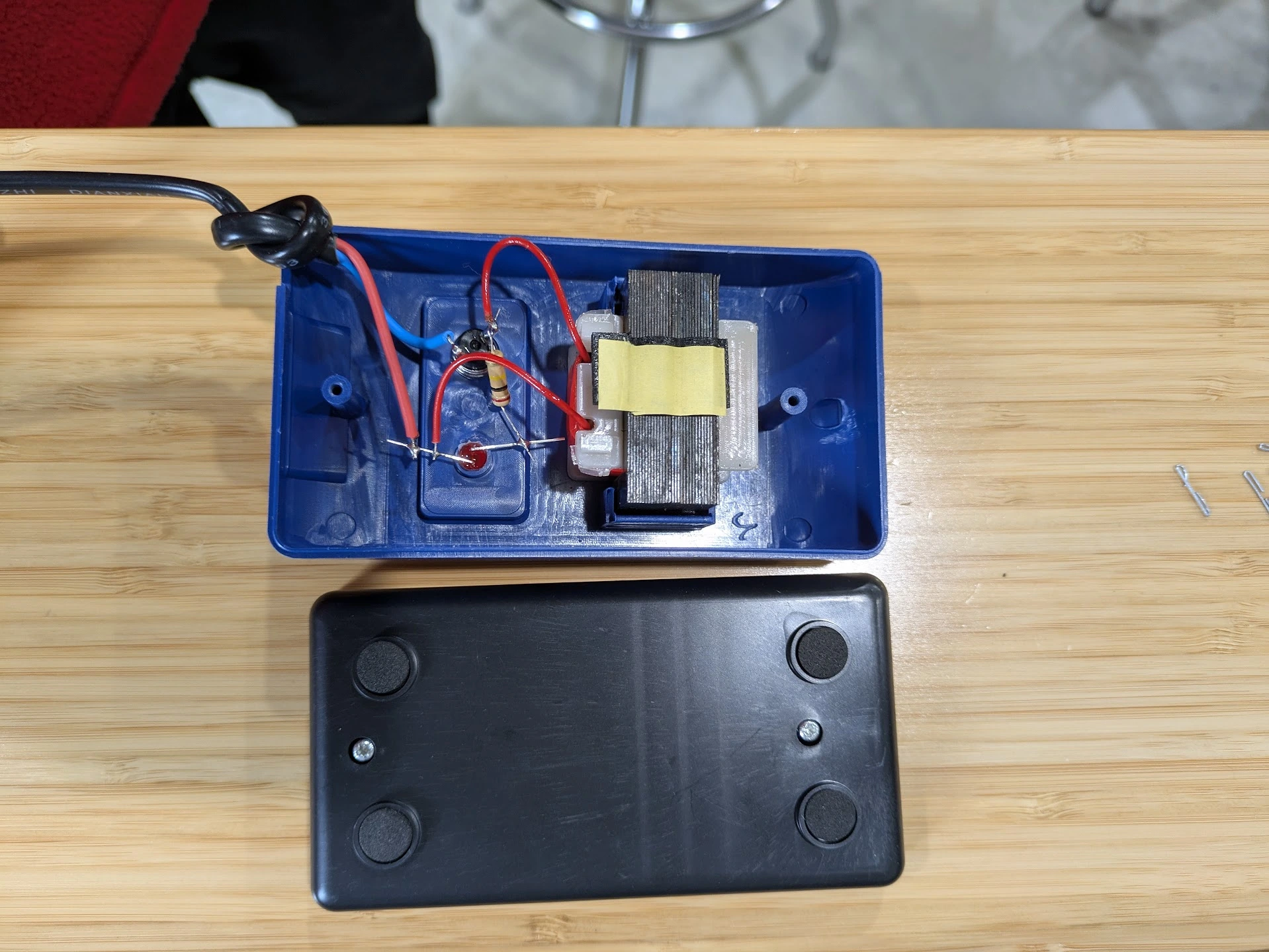

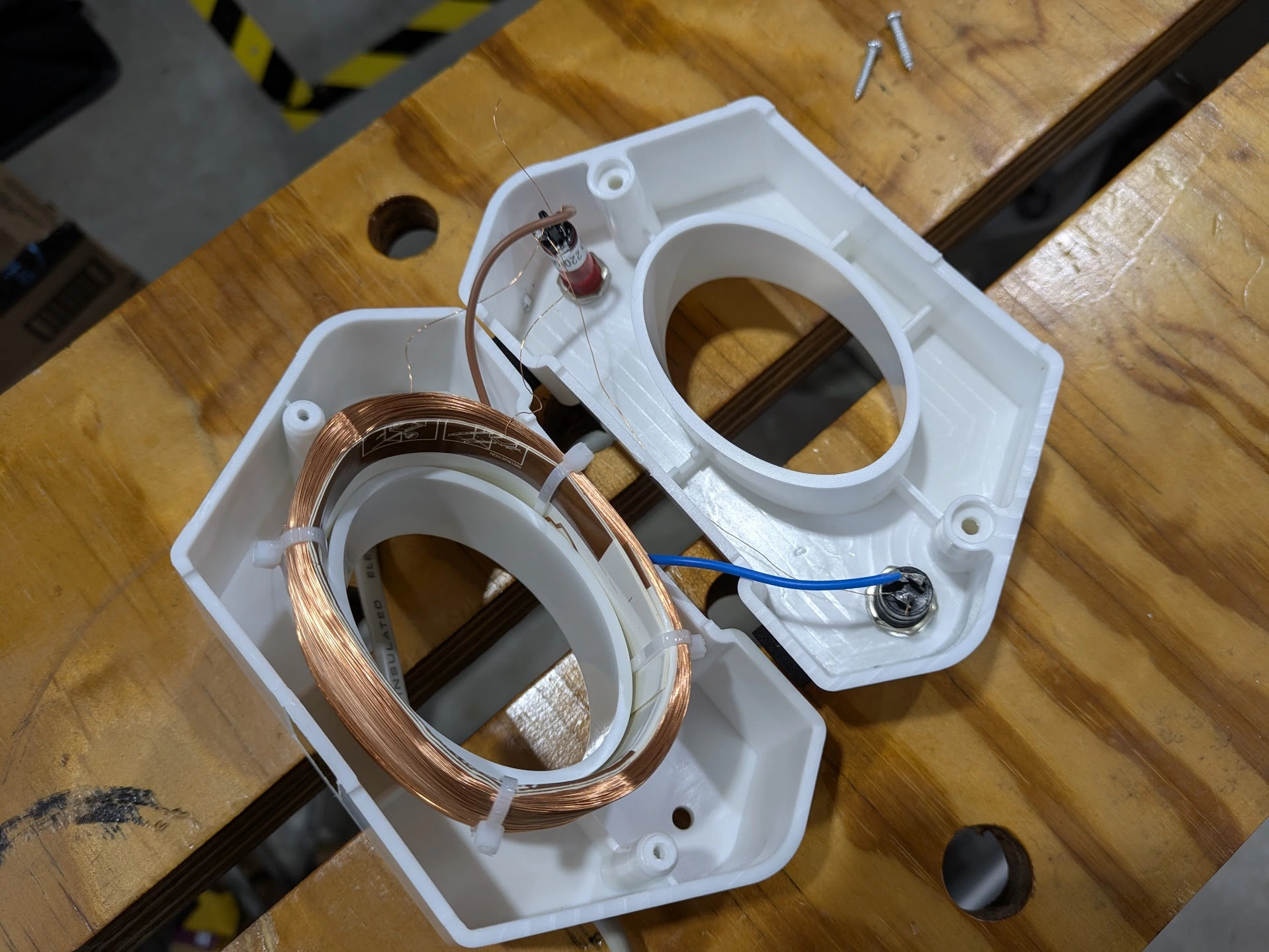

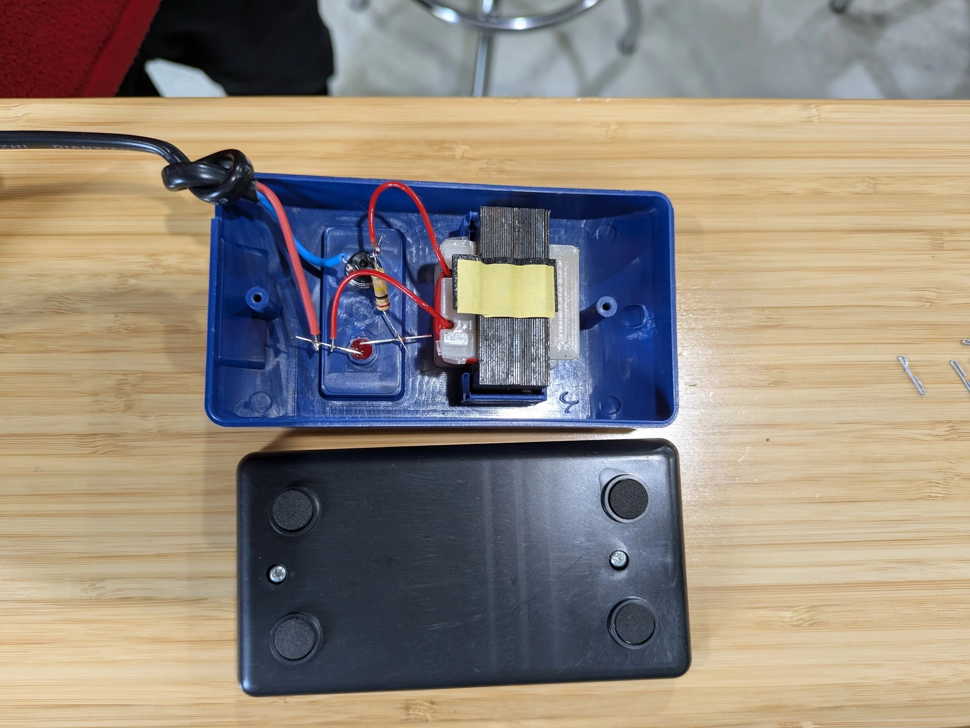

I did disassemble both units, and both are VERY crudely made. I highly recommend only plugging these in when using them and unplugging them when done!
Interior photos for those that are curious.
Oh, after a pass through the white demagnetizer the performance of my Speedmaster is restored. ;-)

For the blue unit, most recommend putting the watch/tool on the pad, turning the unit on and then slowly lifting the watch/tool up and away from the pad for more than 24" (60cm) before turning the unit off. But some recommend rubbing the watch/tool back and forth and around on the pad. I tried both with my magnetized screwdriver with variable results.

Also, that the manufacturers note these heat up and recommend only using them for a very short time before letting them cool off. The white unit says to use it for 1 minute maximum. I did disassemble both units, and both are VERY crudely made. I highly recommend only plugging these in when using them and unplugging them when done!

The white one is the better (and more expensive) of the two. One thing to watch out for is overheating if left on too long.

I have both but only use the blue box for demagnetizing disassembled parts before the sheep dip.
