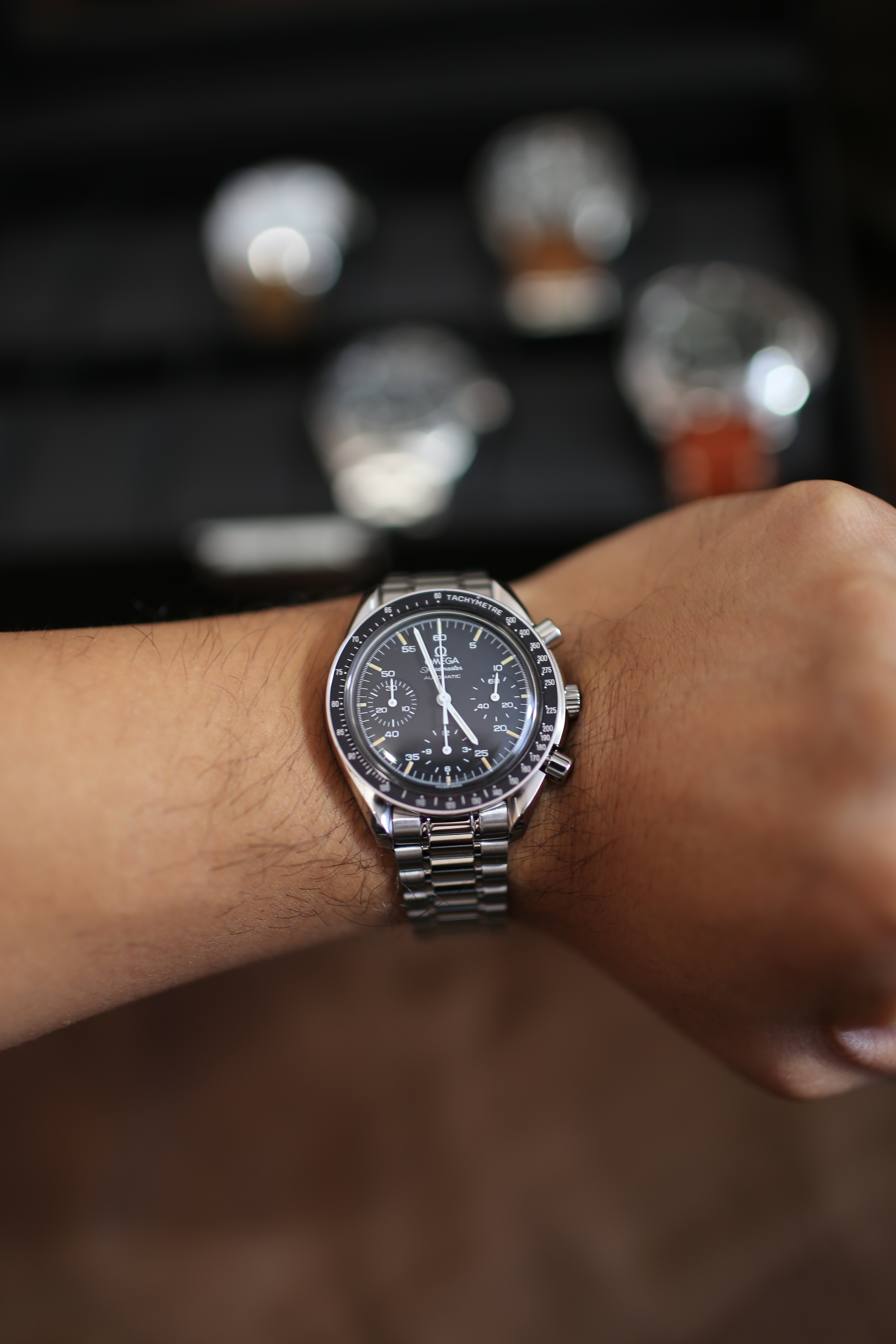

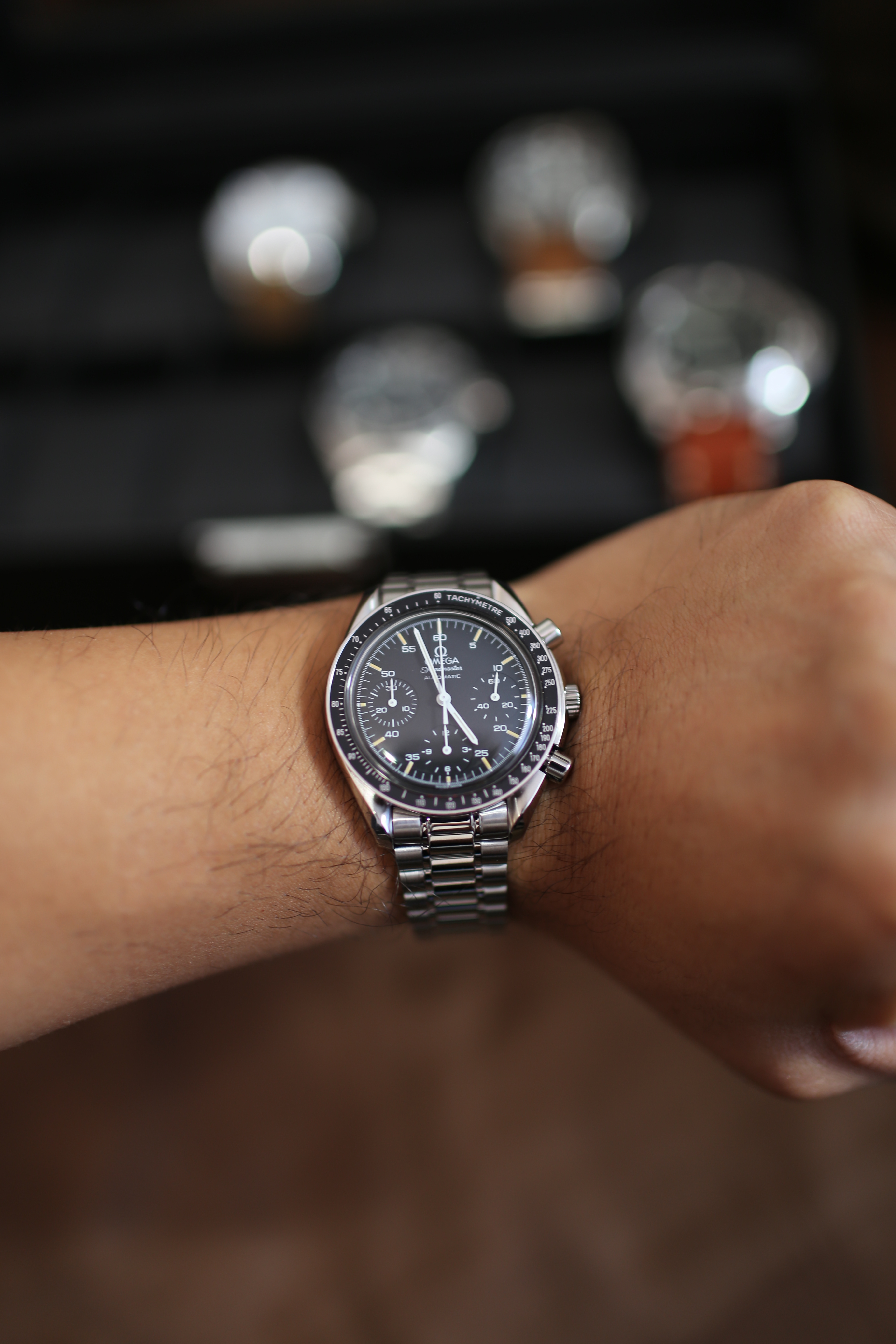

For a while, my watch had been gaining about +2min/day. Since it's a Speedy Reduced, I thought it was time to send it in for service (no prior servicing history known before I bought the watch).
However, last winter, I remembered was flying a lot with the watch. I've read online that those security checkpoints can wreak havoc on automatic pieces (I always had to place the watch in a bin, which went through those x-ray machines).
I came across this YouTube video from Chrono24, and thought that just maybe, my watch had become magnetized.
So I downloaded the Lepsi app, and purchased the same demagnetizer that is linked in that video. I thought to myself, why not try this method before spending a huge chunk on a service.
Well, I followed the steps in the video, and during the initial reading, the watch sure enough read, "Magnetism Detected."
Less than a minute later after using the device, I ran the watch back over the phone, and to my surprise, it read "No Magnetism."
I timed the watch over the course of 24 hours, and the watch has settled down to +4/sec a day!
Just thought I'd share my experience, in case any of you with watches that have gained time want to try this method before spending money on a service. It might not work for everyone, but for $15 for a demagnetizer and a good return policy from Amazon, it doesn't hurt to try!
