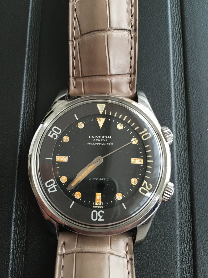

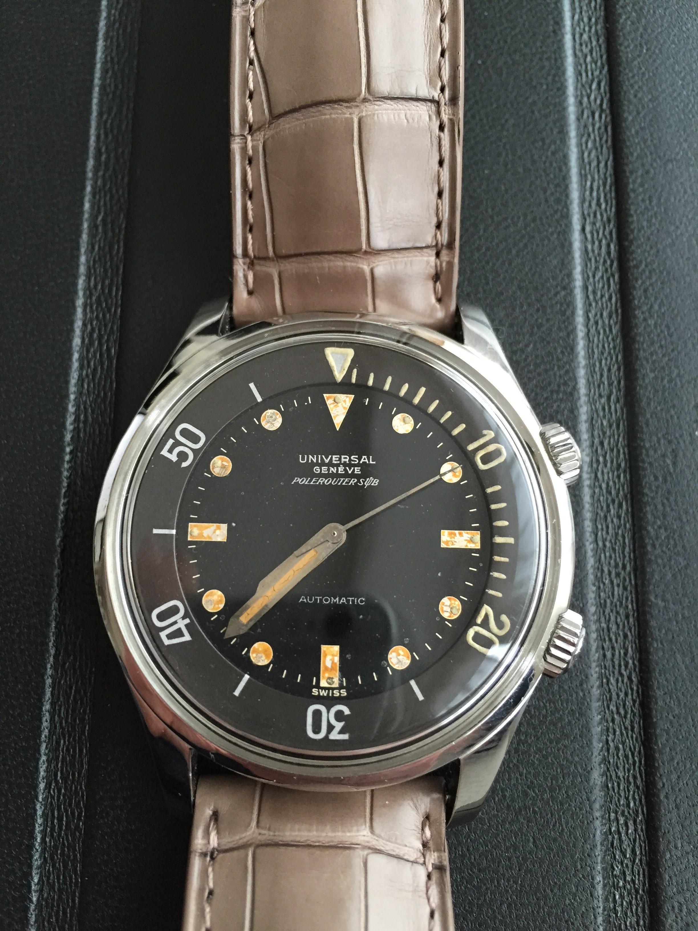

Here is a picture of mine for the record. It is a first generation. The case is pristine, very well finished, crowns are identical to the Tiffany one mentioned in a post, Micky Mouse did picture the top triangle on the rotating bezel, Genève shows no space, SWISS is entirely visible, the small lume dots are still there even if not very visible on this pictures, hands and dial show the same patina, the back has no engraving whatsoever, just the 2 reference and model numbers.
I do believe it is a nice one, i thank very much everyone on this forum who educated me on this model.
Nice weekend!

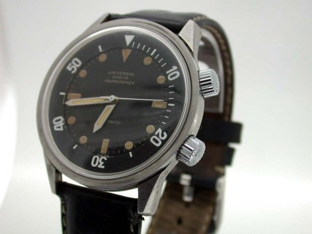

Another "Australian" Polerouter Sub up for auction in the UK at William George by the looks of it.
159
197

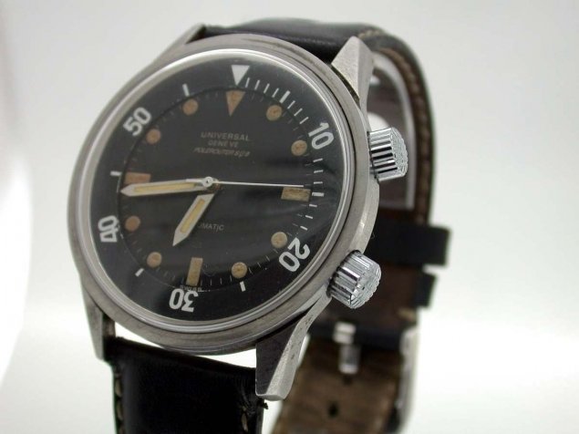

Very likely, it has all the signs, crowns, the case with black spots, the space in Geneve, the swiss not entirely visible, hands looking new ...

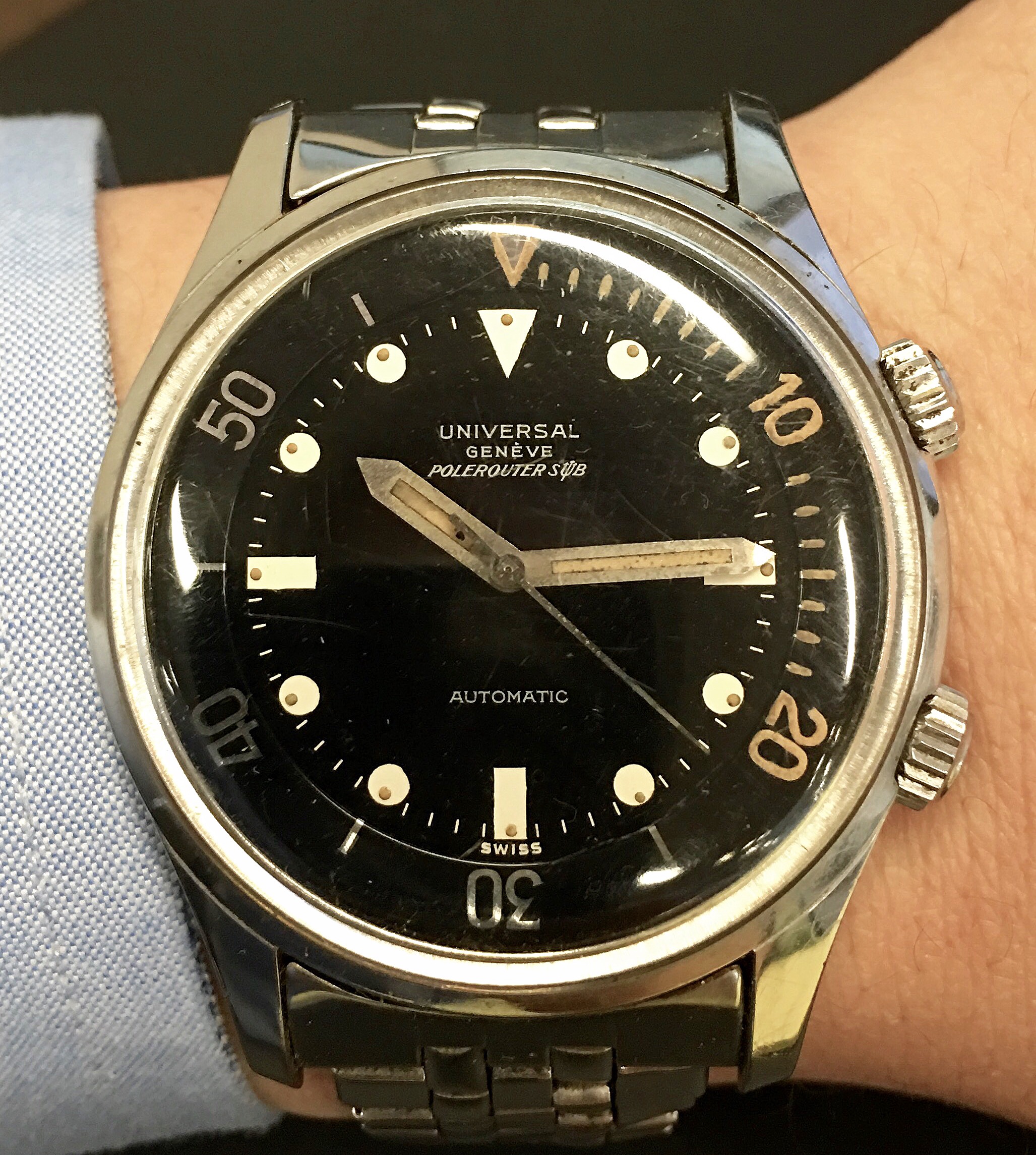

I'm not sure what to think of that one. The case looks OK to me, it does show a good finish, no black spots, lugs look fine too. The back is heavily polished, no serial number. Dial looks ok too, patina looks coherent between the hands and the dial, there is a lot of debate about Swiss not being entirely visible on gen 2... The crowns look wrong to me, at least the bottom one, it is too big and look like a replacement. The top one I don't know, it could be original as on some the top crown is bigger than the bottom one. The movement does not look very clean, but it does not look as bad as on the fakes we have seen....

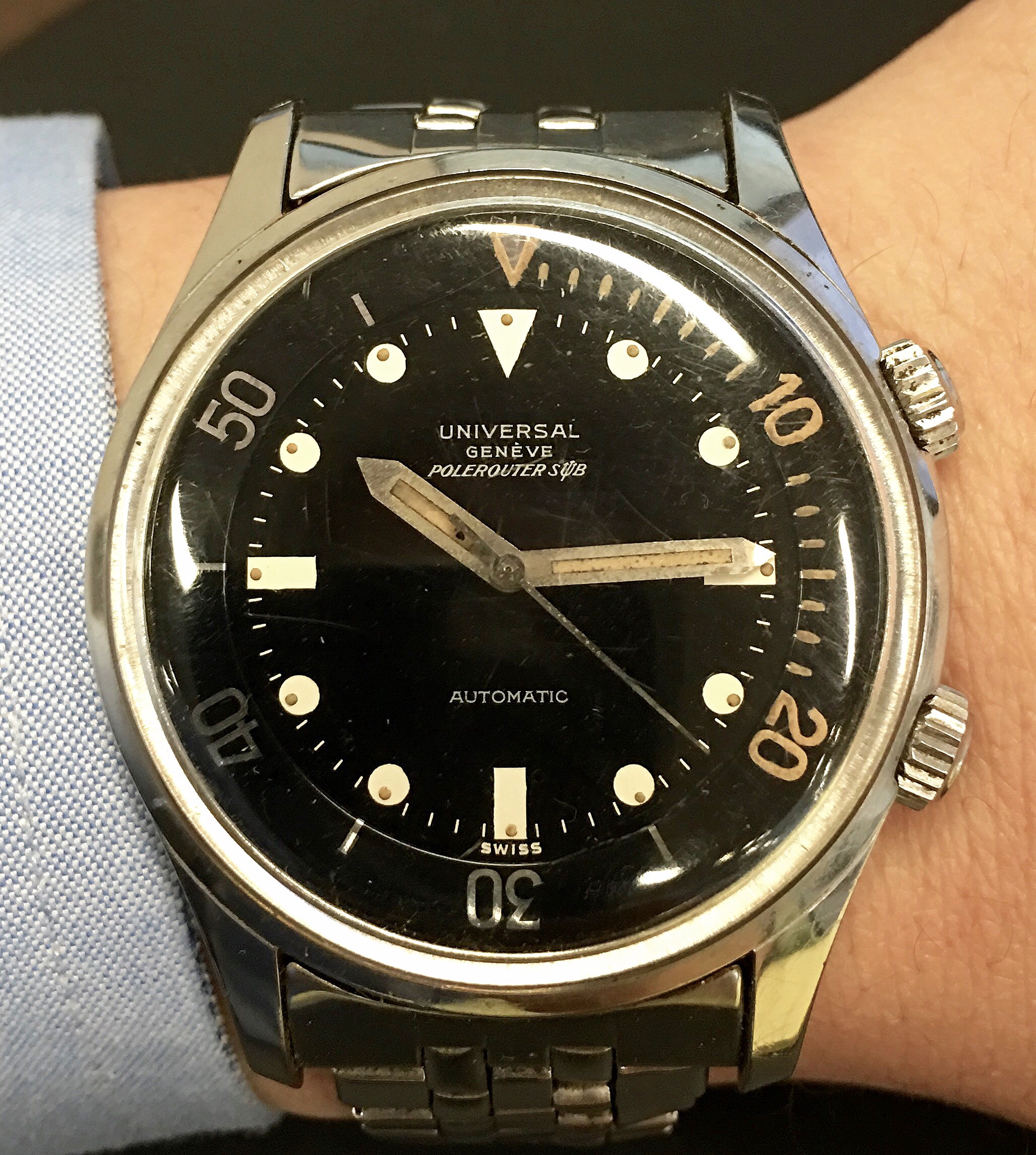

I'm surprised this seller will sell this watch. I've never seen Sassella sell something dubious before, right @jordn ?
No dealer is impervious to selling dubious watches unfortunately. I know most of us here have relegated this one to be a counterfeit watch, but the greater watch community often disagrees. I contacted an auction house that was selling one, and they flat out told me that I was wrong... (shrug)
This particular example has survived pretty well, but you can tell that the case is chrome plated along with all of the other signs.

Again, this one does not show all the obvious signs of a fake. The hands do not look new, patina on dial and hands look ok, and I don't know how you can say that the case is chrome plated... I would not buy it because of the crowns and polished back and all the doubts this watch will always raise, but this does not look like an Australian fake to me...
