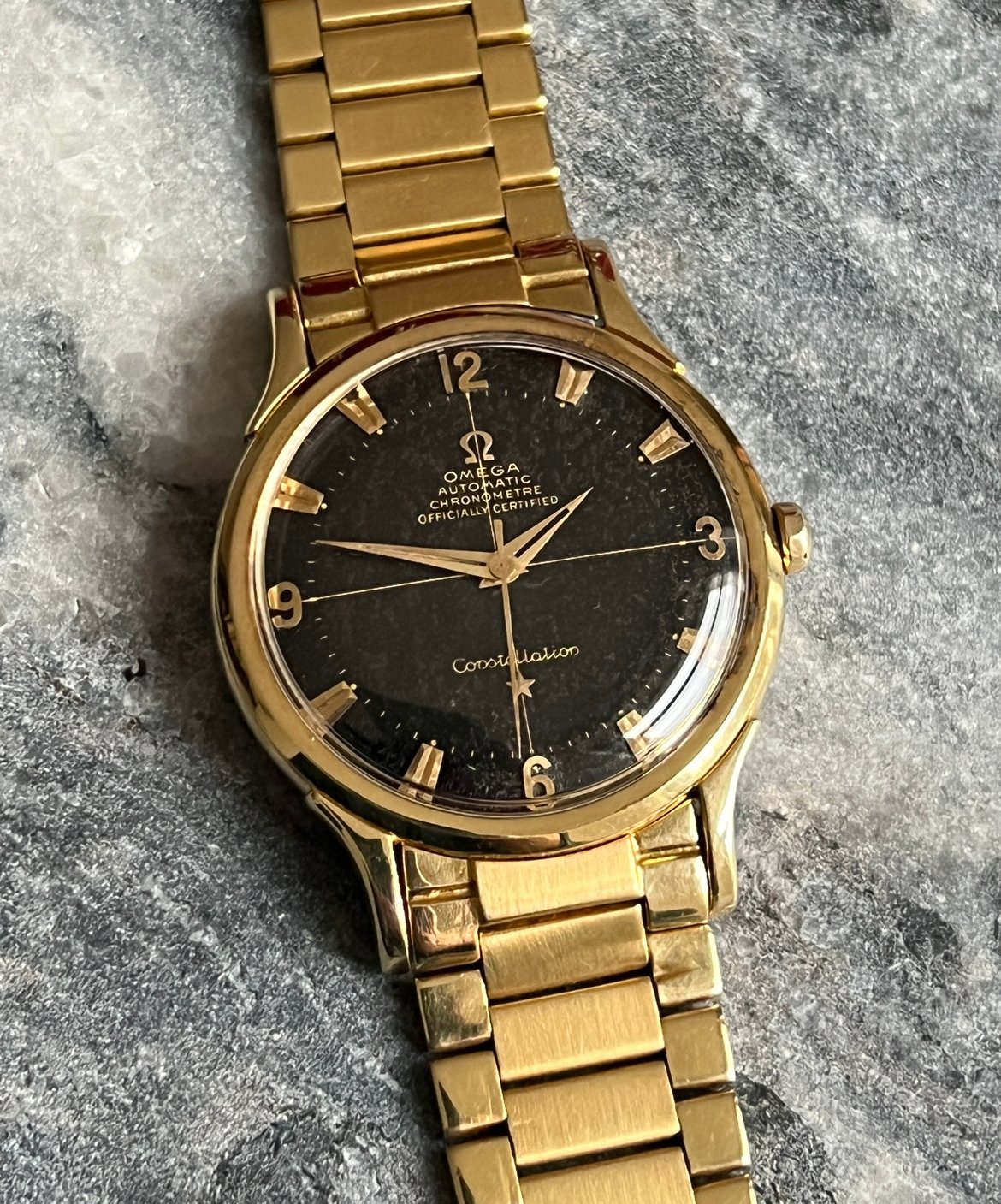

I recently got my hands on this Omega Constellation CK 2943 sc 1 and have been looking around for what would be a good fit authentic bracelet and end-link wise. I've looked around at Desmonds blog for example about Connies and have found that there isnt any clear choice to go for, other than a 5 or 7 center row BoR or the more sought after flatlink 7912. I've looked upon a few threads here before creating the account trying to find answers but havent came that far for those perfect references that would be the perfect fit, as this 2943 has other case/lugs than the more typical 60s Connie, and it has gone even worse with finding a correct end-link.
Would a 1036 BoR with 512 (?) endlinks be a time-correct example that I should look after? I'd prefer it to be a good fit and time-correct. I don't mind if it takes some time to lay my hands on it, it took me a few years to hunt down a correct 18k 14mm buckle for my 2846...

Photo for attention of the 2943 😀 dsc03483-jpg.1562856

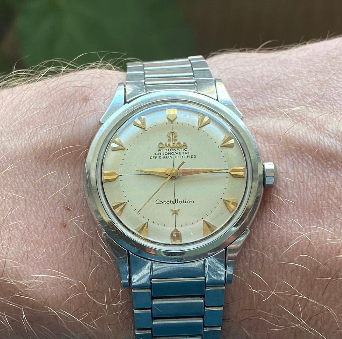

I’d guess that as with most 50s Seamasters / Constellations, a flatlink on #4s or #7s will actually be the best fit. #4s usually sit great in those cases. That is if money is no object though - the flatlink option will be 4-5x of what a BoR is, and that’s if you go with a cheaper (and not period correct, yet visually very similar) 1035. If you want an early 7077/7912 the price will even be higher.

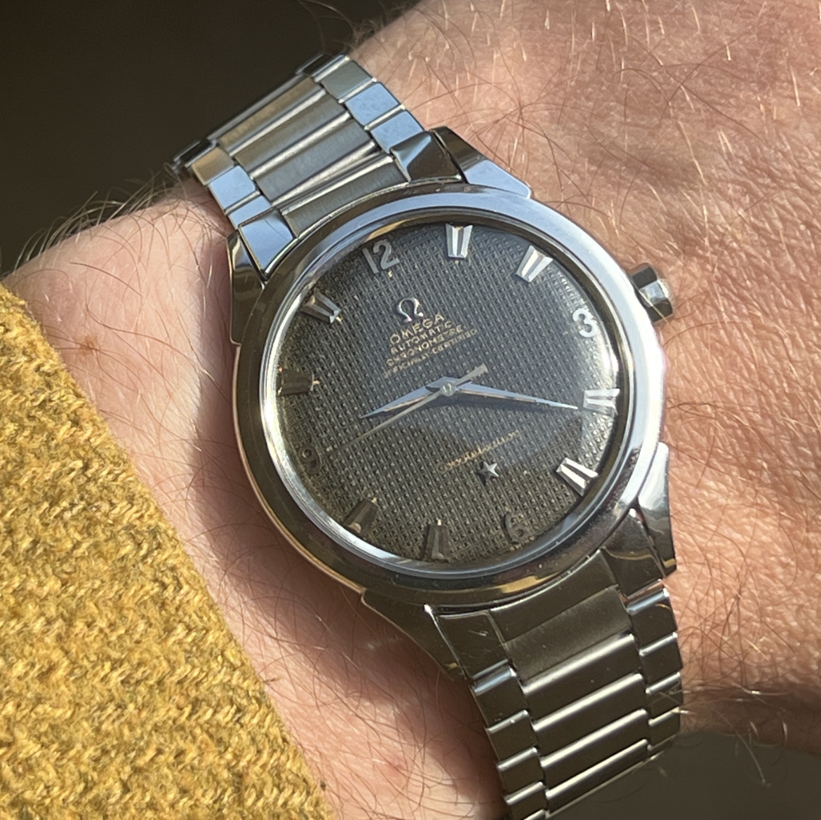

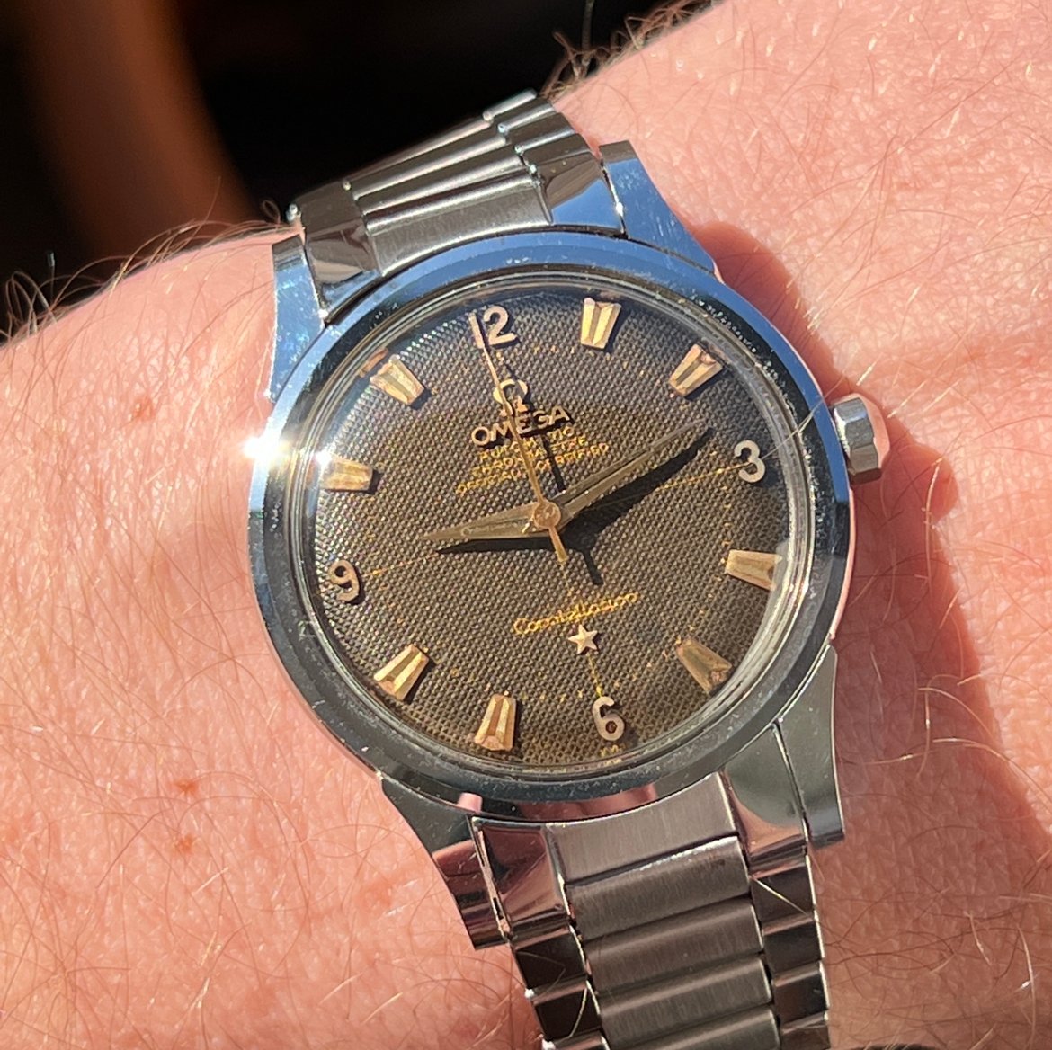

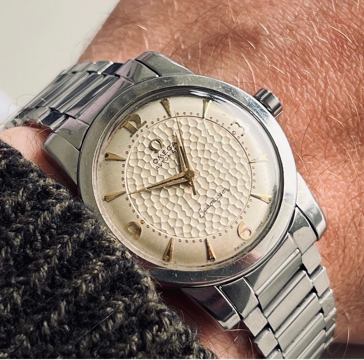

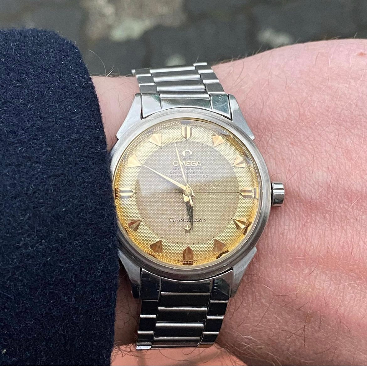

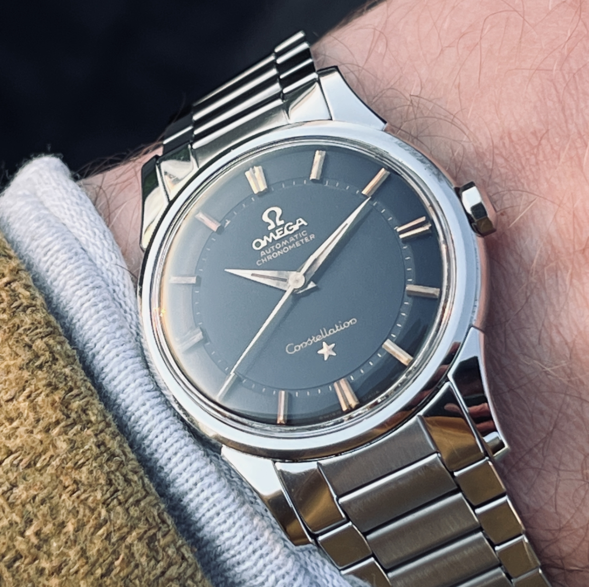

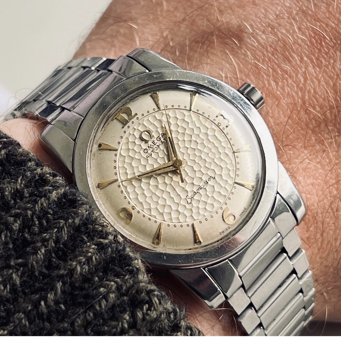

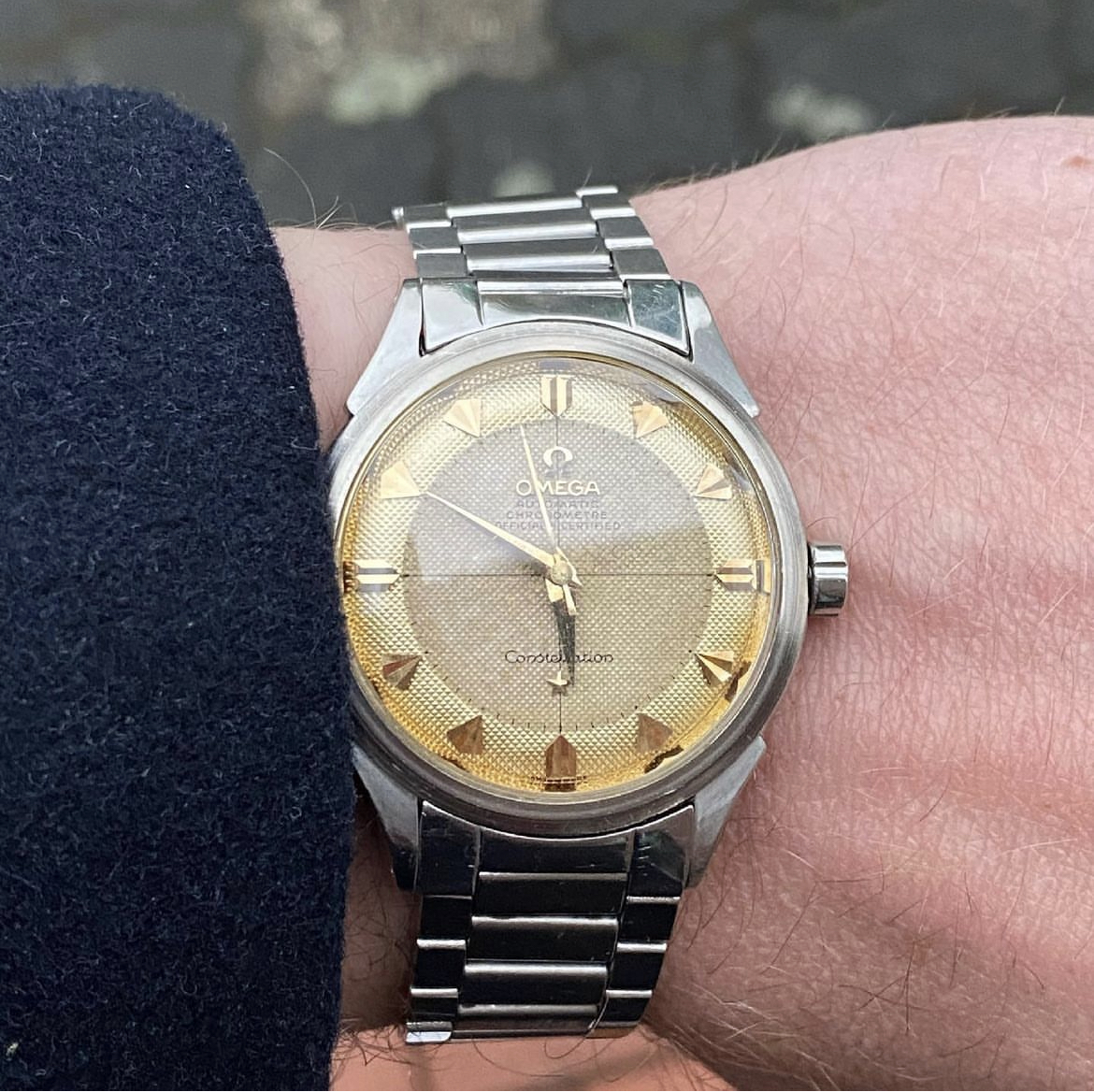

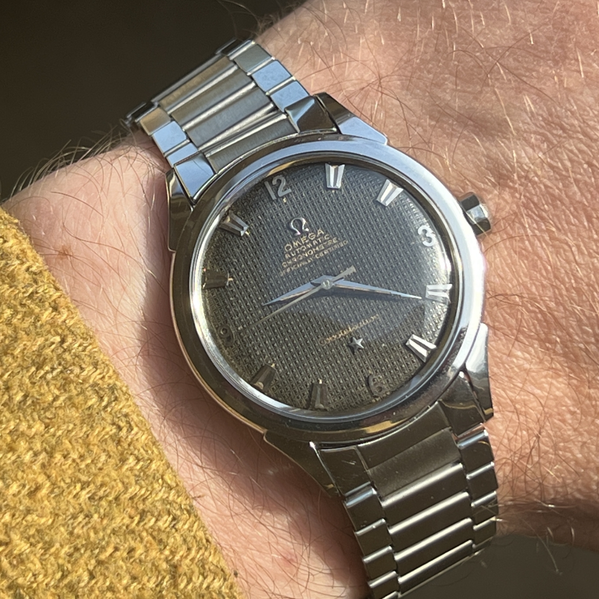

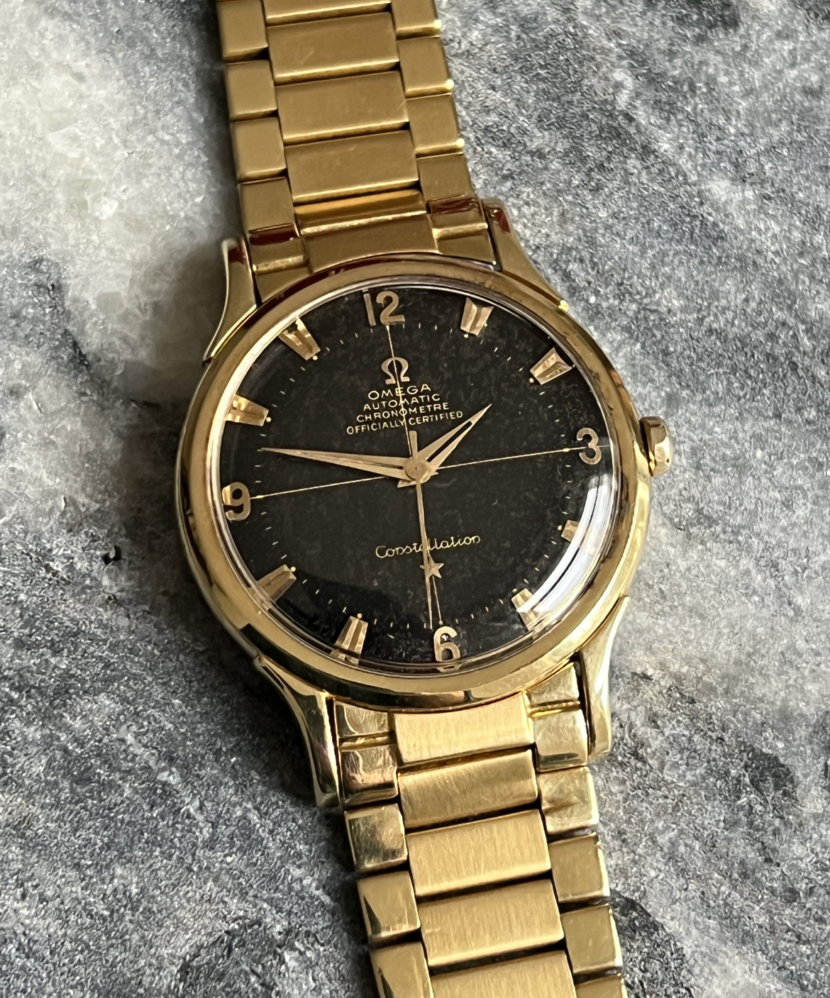

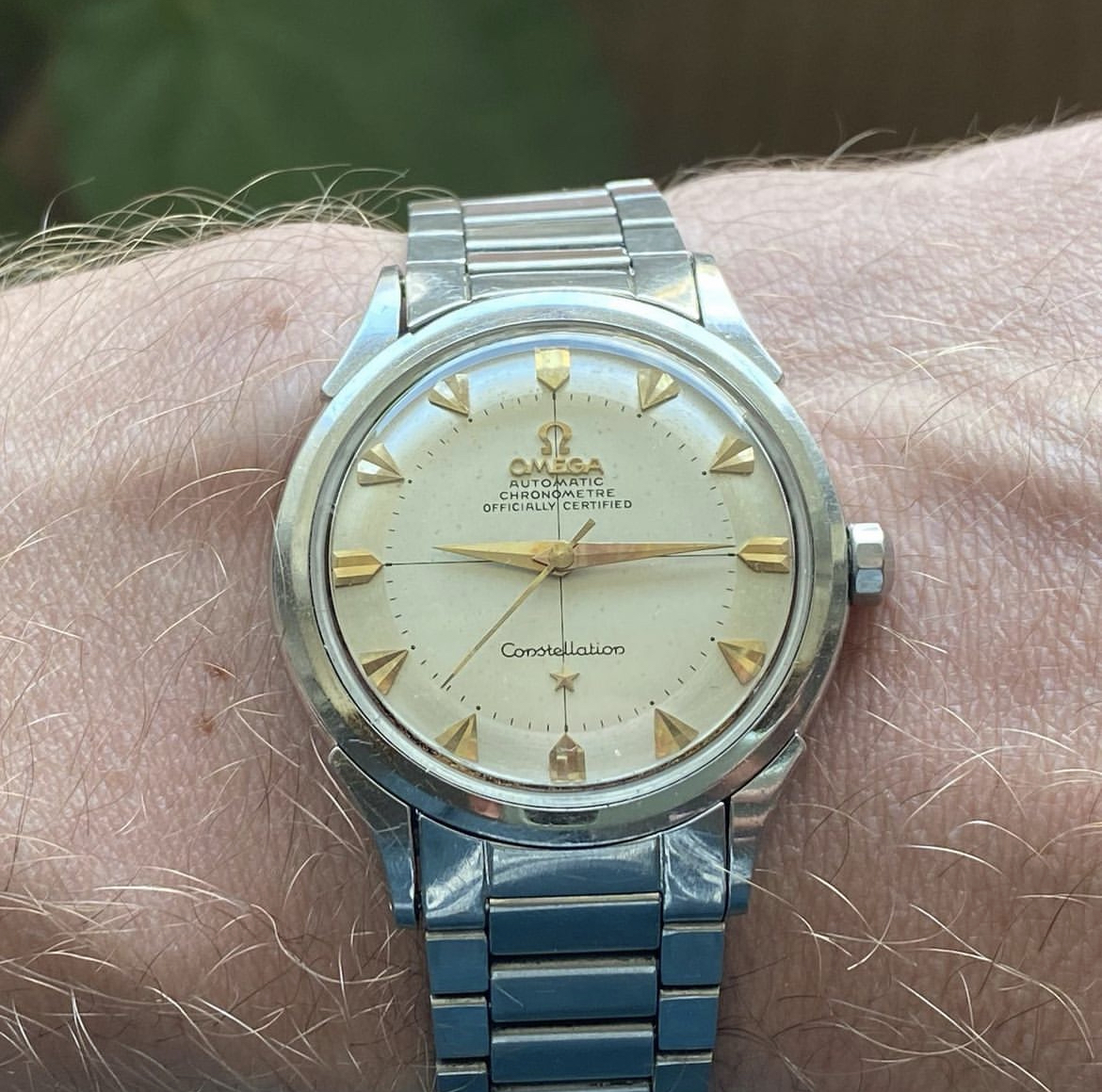

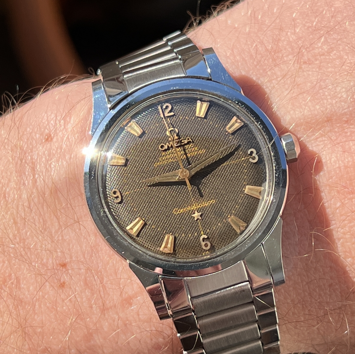

Not sure if I’d say „go-to“ as the extra cost is significant, but it’s definitely my favorite. A beefy lug example, ref 2577:
And they work for the Constellations all through the 50s, I believe.
2648 (steel works all the same):
2652:
2782:
2887:
2852:
14381 (same as 14393):
I don’t have a picture of the flatlink on a dogleg 14900/14902 at hand, but I think I remember that even those completely different, angled lugs work with the flatlinks and #4s.
If you collect 50s Omegas it’s incredibly versatile.
edit: I have a 2943 case at home. Can install a flatlink and take a pic, if you’re interested to see how it fits.
