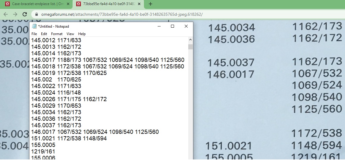

Hi, the lists don’t mention it but I believe that the 1171/ 677 combination works on 145.022 cases. Any thoughts please?
411
627

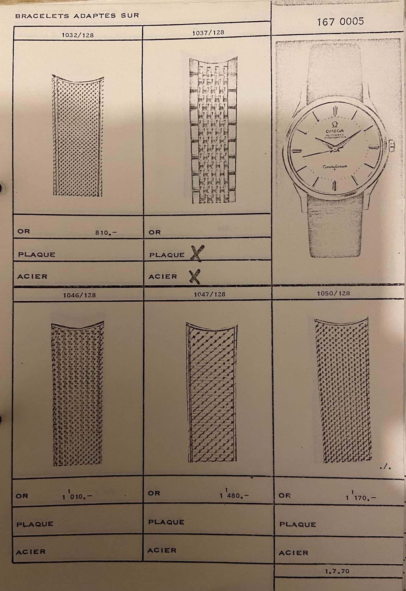

This might be of use, that is if the photos come across ok and people can read them.
Case ref / bracelet ref / end pieces ref
Thank you for the comprehensive documentation.

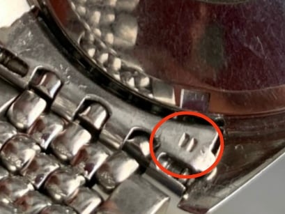

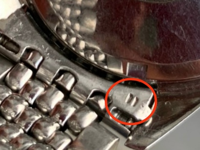

A question from neophyte please help me to make it clear. Some endlinds are 2 digits, for example a endlink with "11" ref#.
What could be the equivalent one in 3 digit ref system on these photos.
Thank you
PS:
Above is one endlink to illustrate my question in poor English.

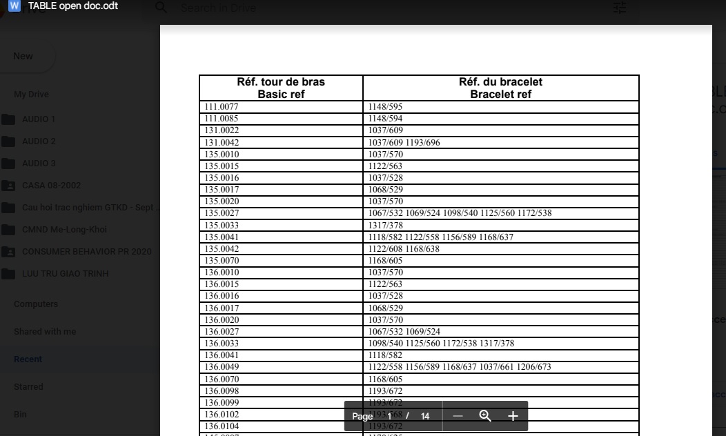

Here is a searchable version with bracelet/endlink in italics. Please let me know by PM if you find errors.
111.0077
1148/595

@Dan S Thank you for converting via OCR to text
Here I am trying to convert to table (not yet done)

Does anyone know whether the currently available 528 endlinks are the same as the old 128's? I'm thinking the reference number might have been updated, similar to the 70 endlinks becoming 570?

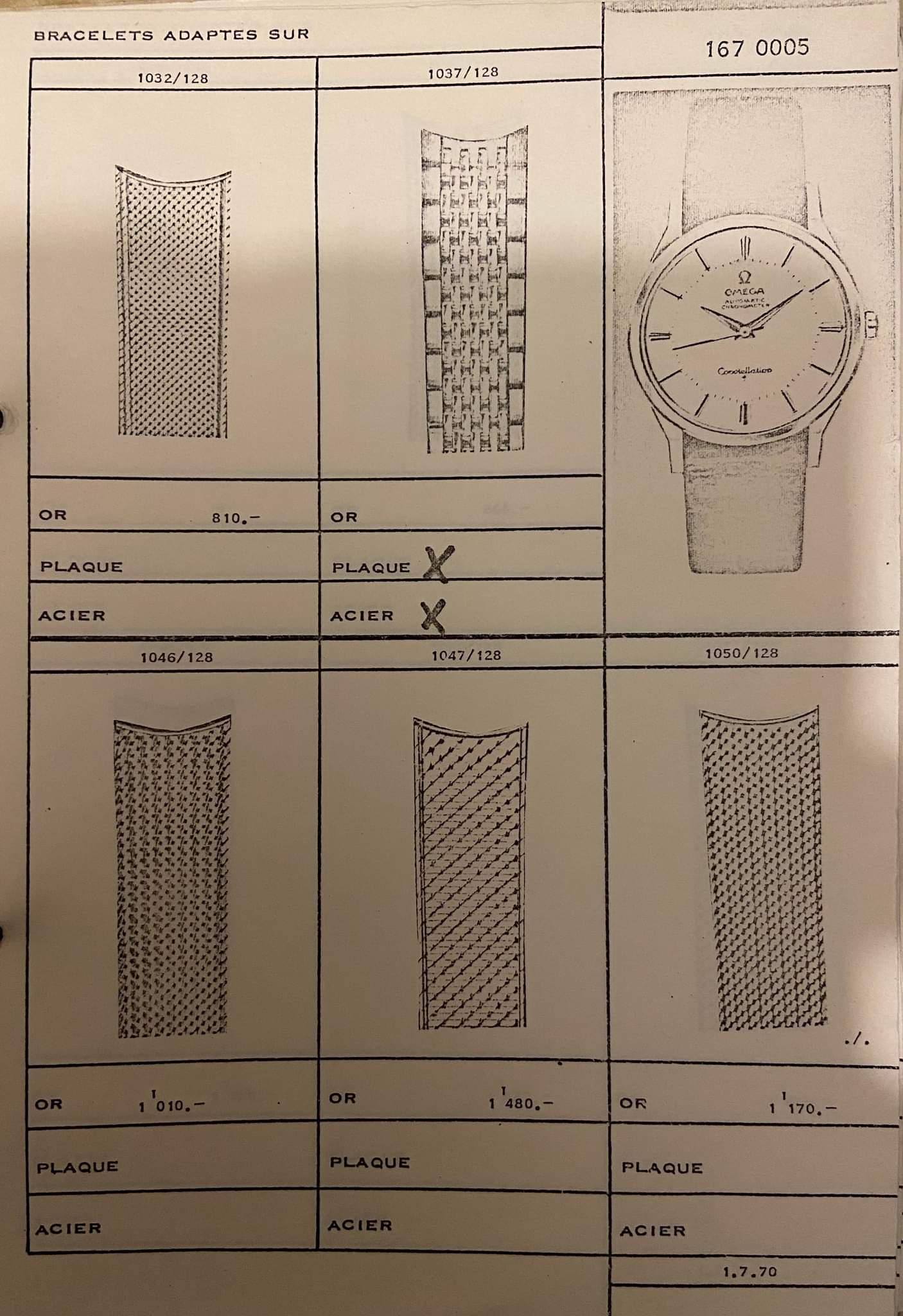

I can answer my own question; no, they're not. The 128 and 528 are very different.
Also, I can add another one to the list:
167.005
1037/128
1,050
2,619
165.0023
1037/513
I had one of these watches, and it came with a 1037 bracelet with 523 end links. I think there may have been a typo in the list on page 1, as I can find no examples of 513 end links online.
8
Hi all, I'm looking for bracelet for my vintage Omega but I can't find the reference 101.010 from 1966, it's the chrono with 321 mov.
Someone could help me? Thanks
From google images it appears it accepts 11 and 70 endlinks and paired with those bracelets regularly? So very easy to find bracelets
8
Forgive me Kaplan, I didn't explain properly..
I'm looking for the original bracelet reference for my watch.
