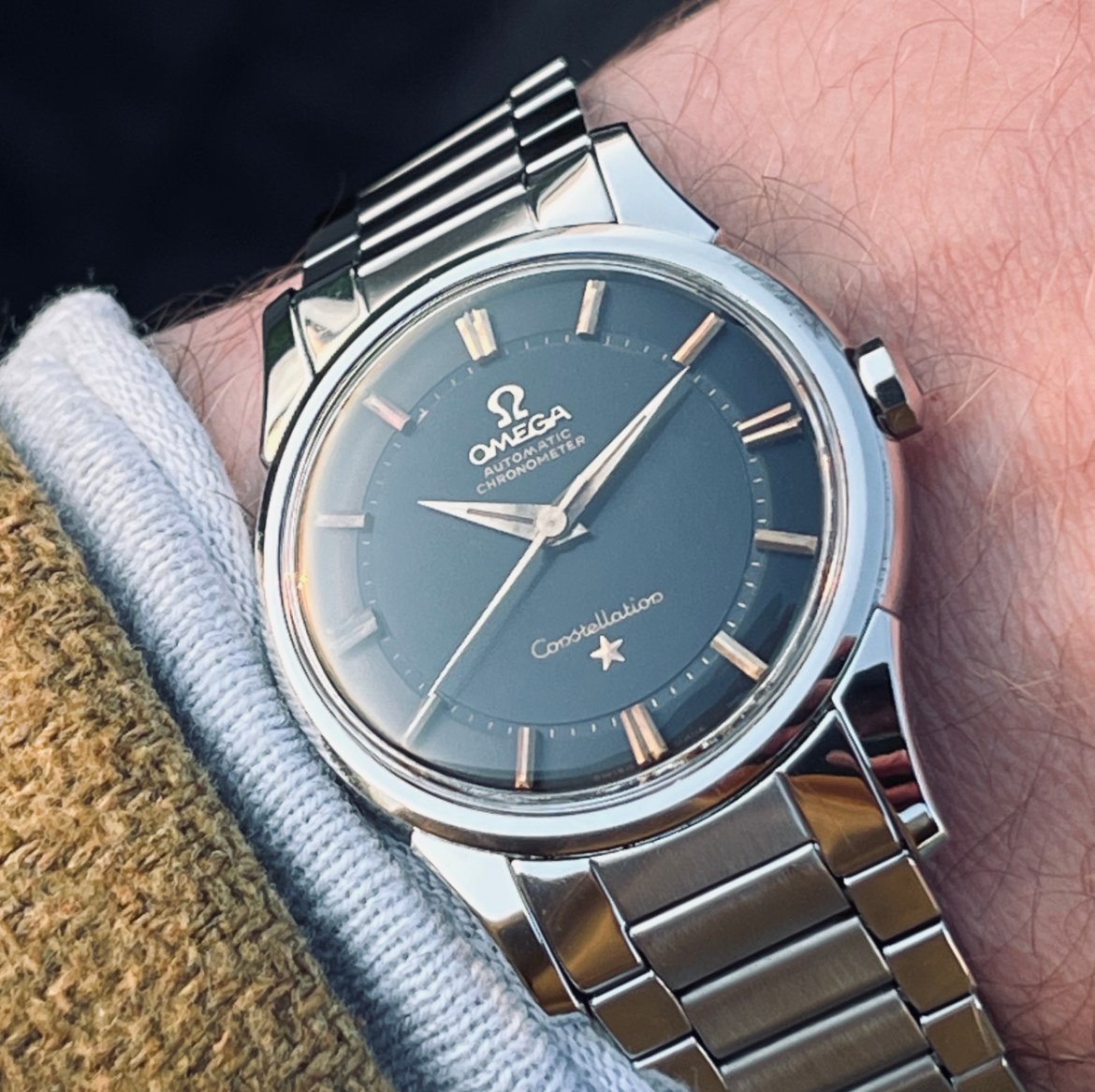

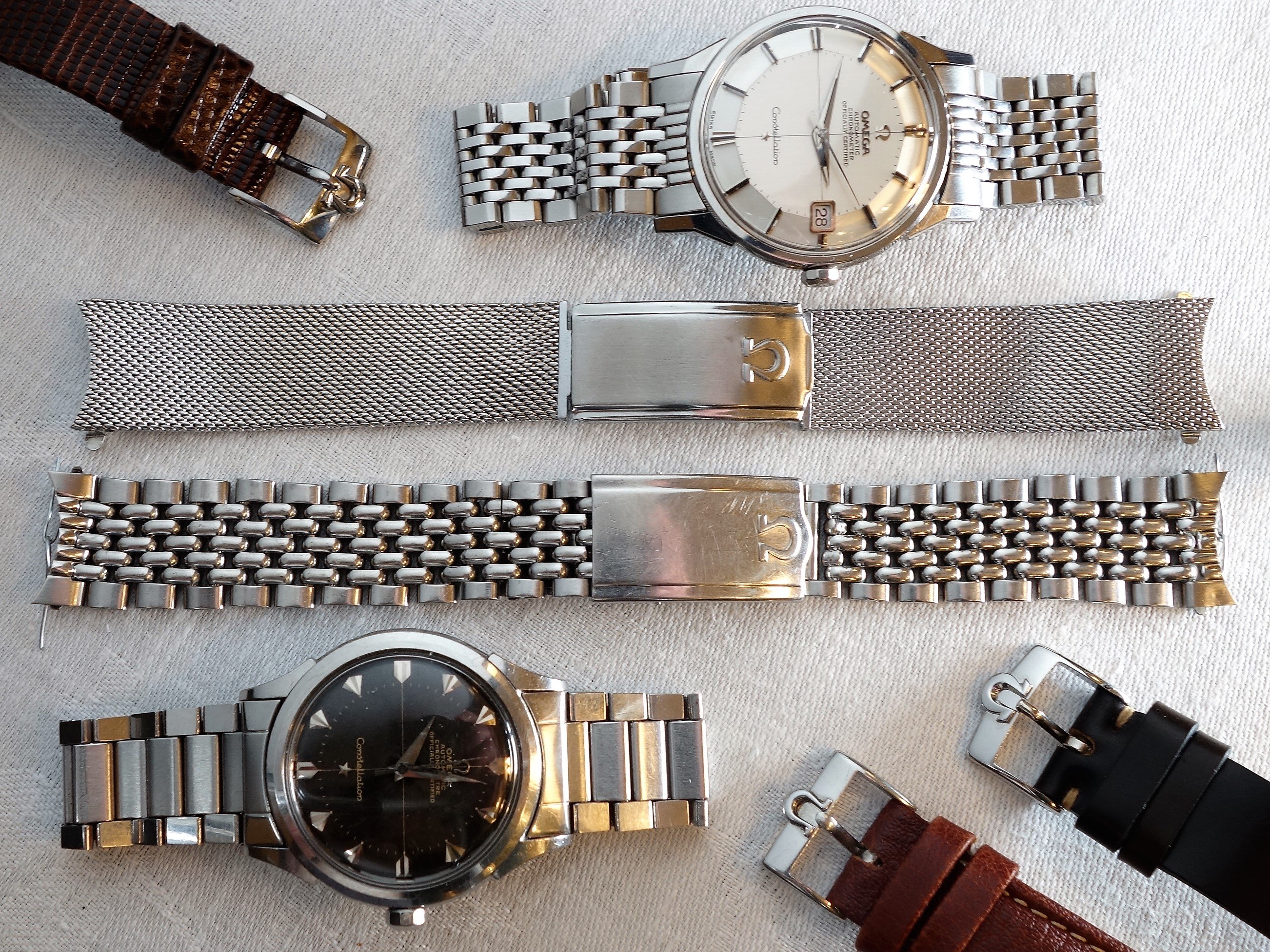

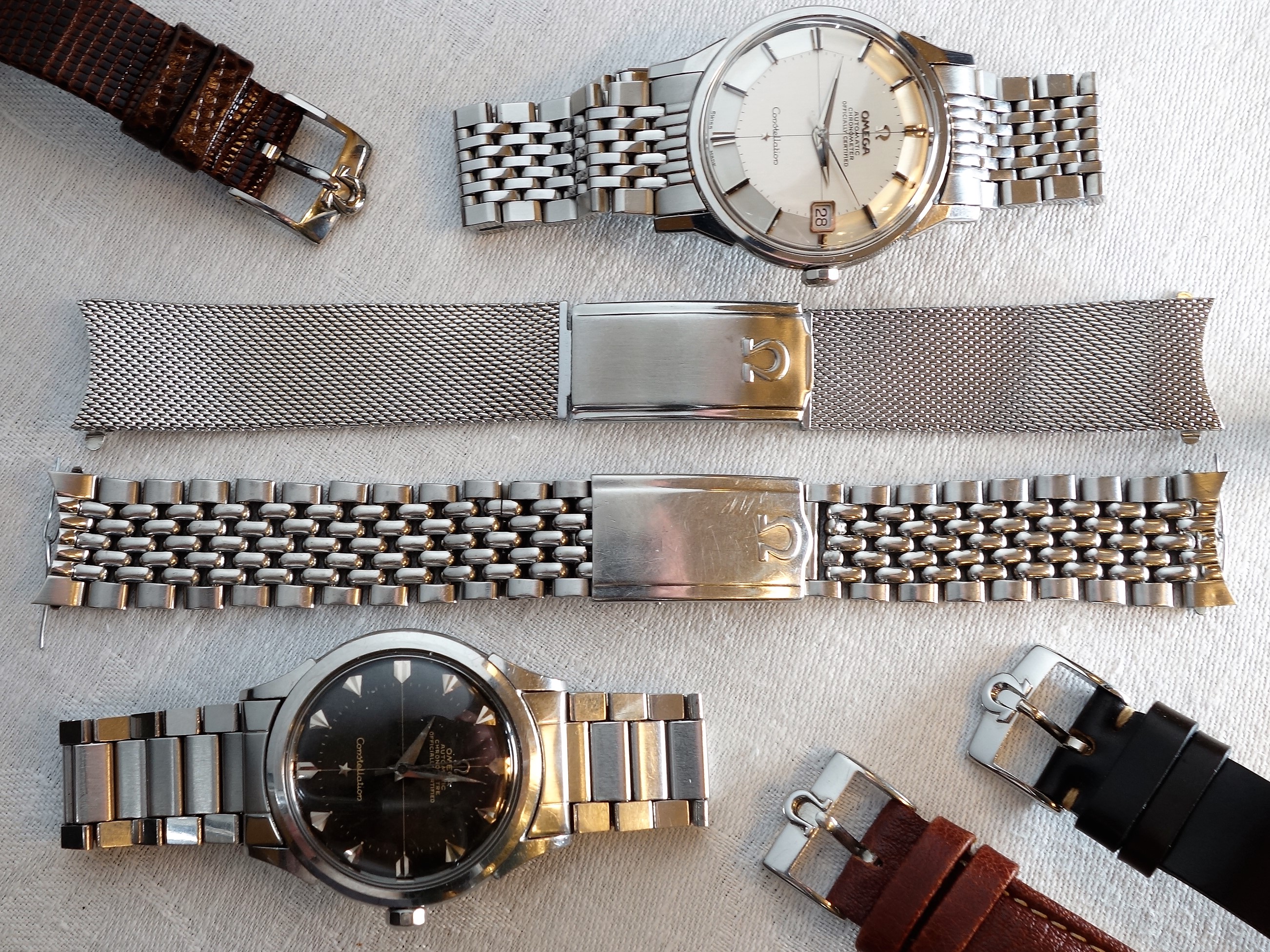

Not sure if I’d say „go-to“ as the extra cost is significant, but it’s definitely my favorite. A beefy lug example, ref 2577:
And they work for the Constellations all through the 50s, I believe.
2648 (steel works all the same):
2652:
2782:
2887:
2852:
14381 (same as 14393):
I don’t have a picture of the flatlink on a dogleg 14900/14902 at hand, but I think I remember that even those completely different, angled lugs work with the flatlinks and #4s.
If you collect 50s Omegas it’s incredibly versatile.
edit: I have a 2943 case at home. Can install a flatlink and take a pic, if you’re interested to see how it fits.

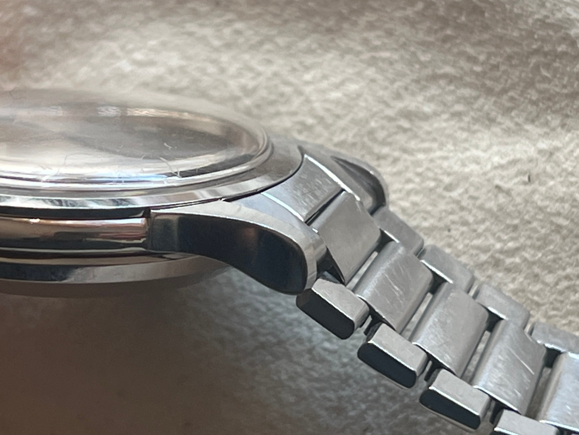

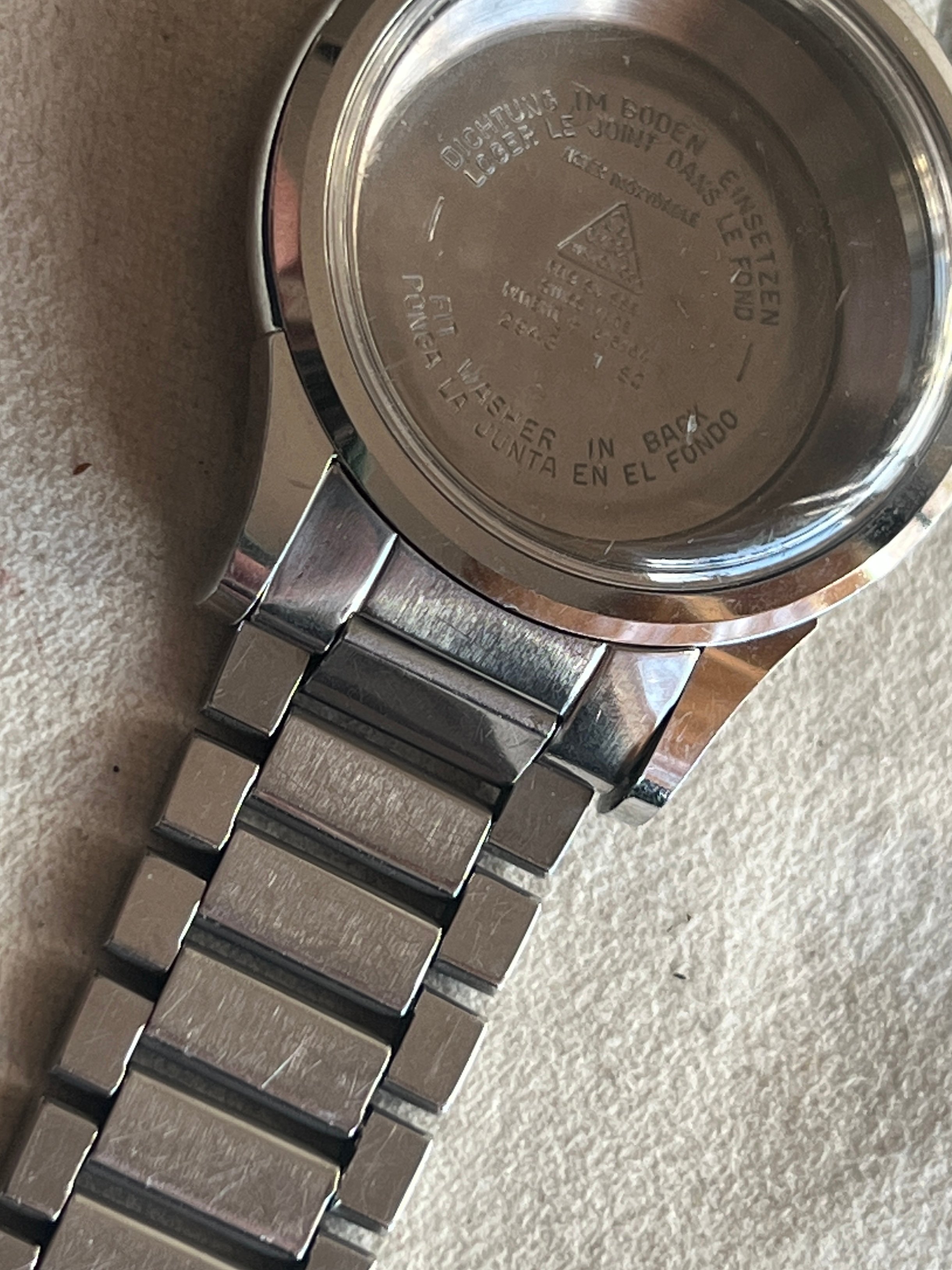

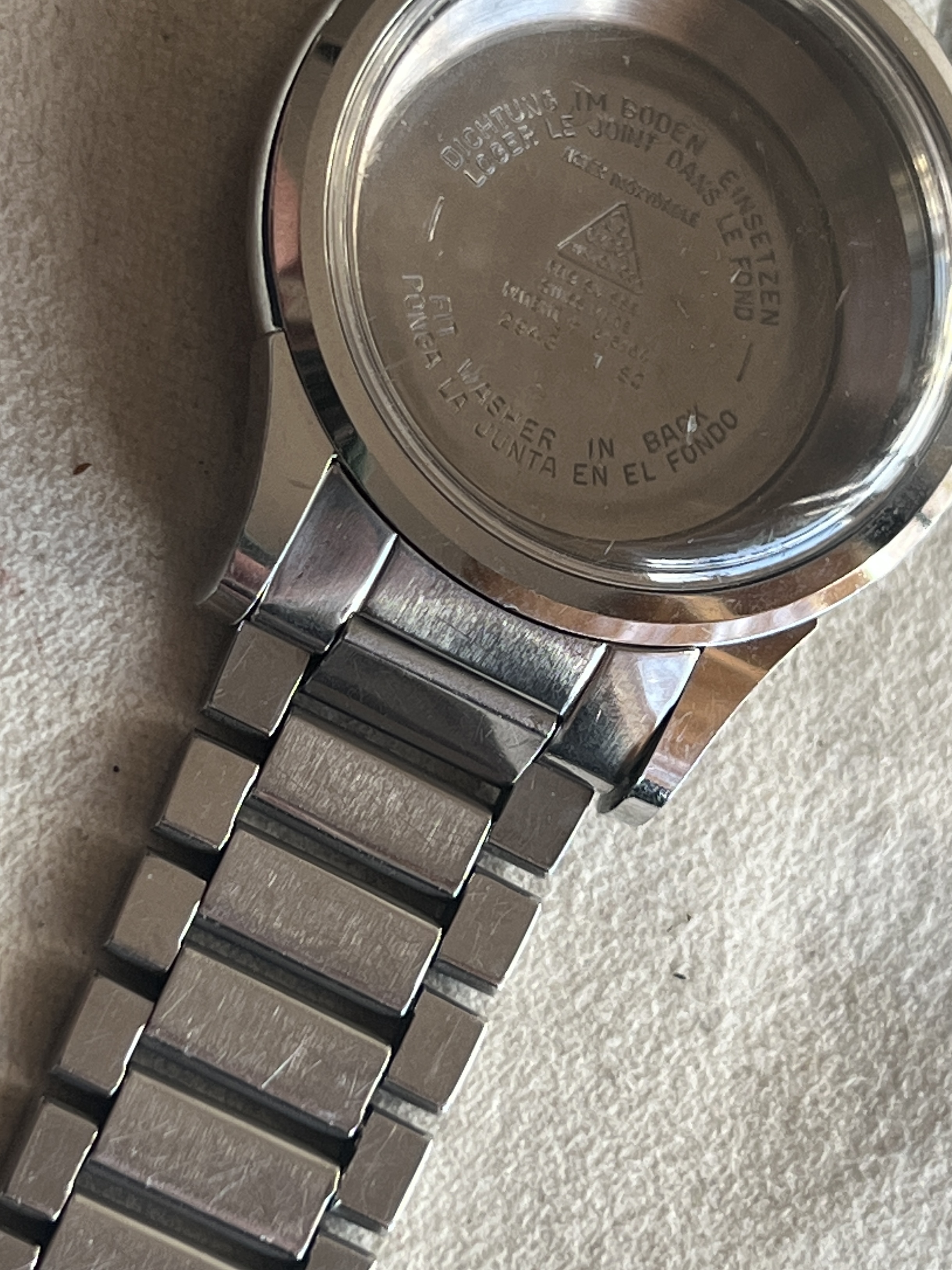

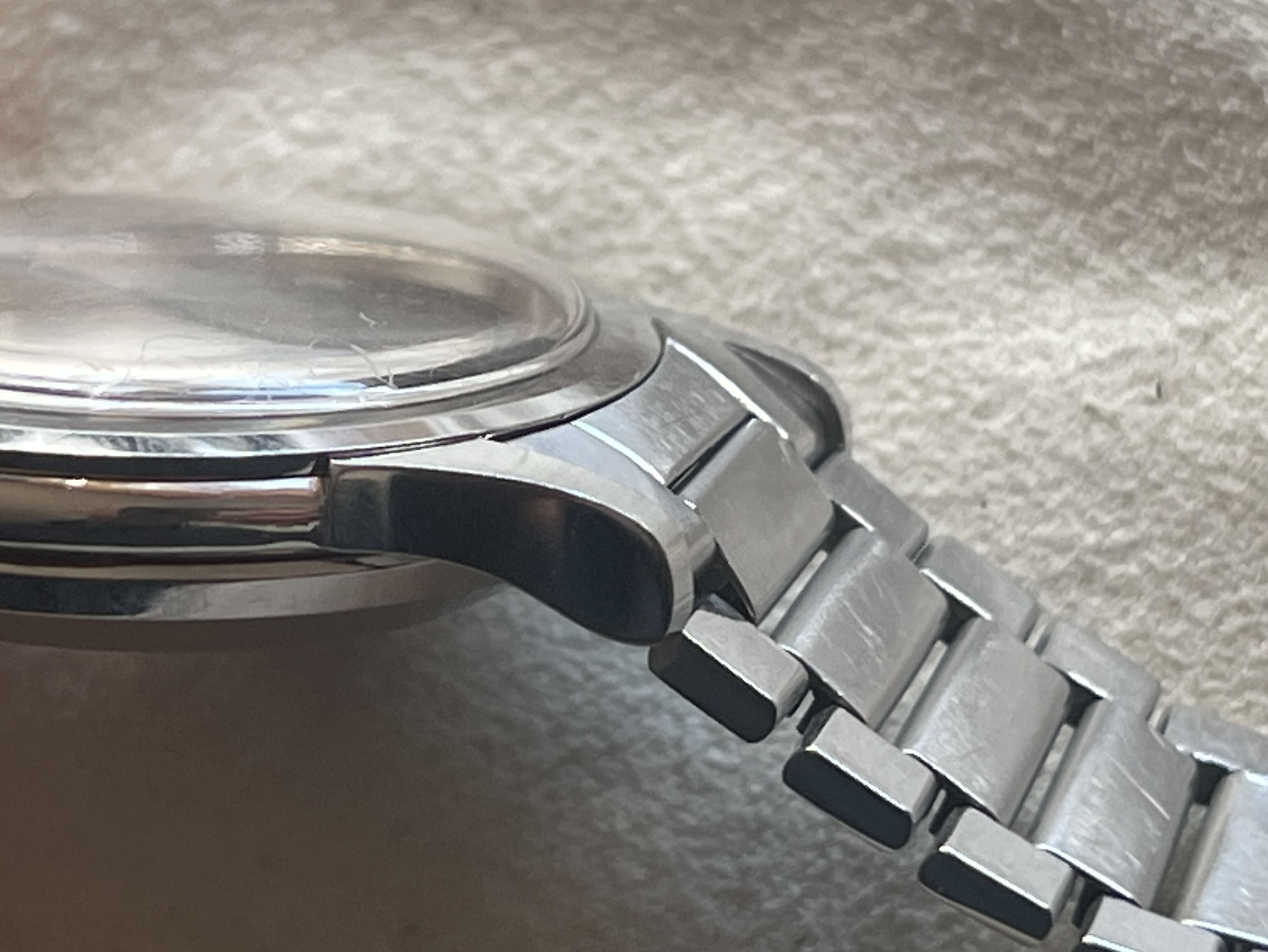

Example pictures of the #4s on a 2943:
However, do note that just like the #11s on BoRs, the #4s can also be adjusted to sit tightly on various cases. Mine are shaped so that they fit a 2782, which significantly more curved lugs. I’ve noticed the 2943 is very similar in shape to the 2887 I’ve posted a pic of a few posts ago, and #4s can fit these perfectly, so I’d assume the same for the 2943. If you’re not comfortable doing that yourself, it might be a job for your watchmaker, albeit a relatively small one.
196
2,790
Thank you very much for displaying this, Matt! I feel like this is the way to go, with the adjustments suggested to the end link.

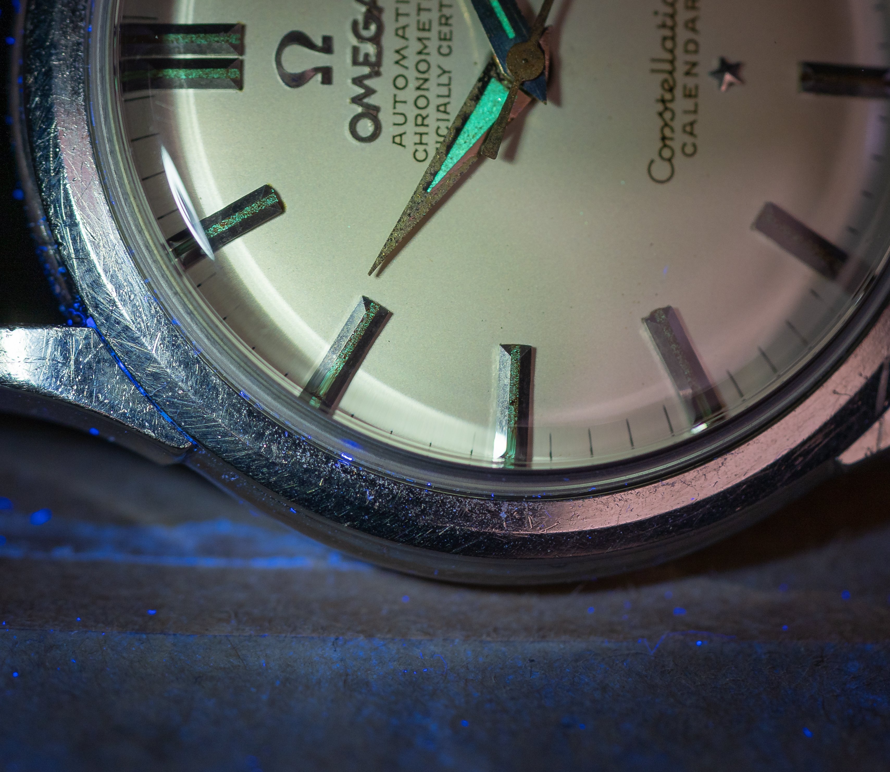

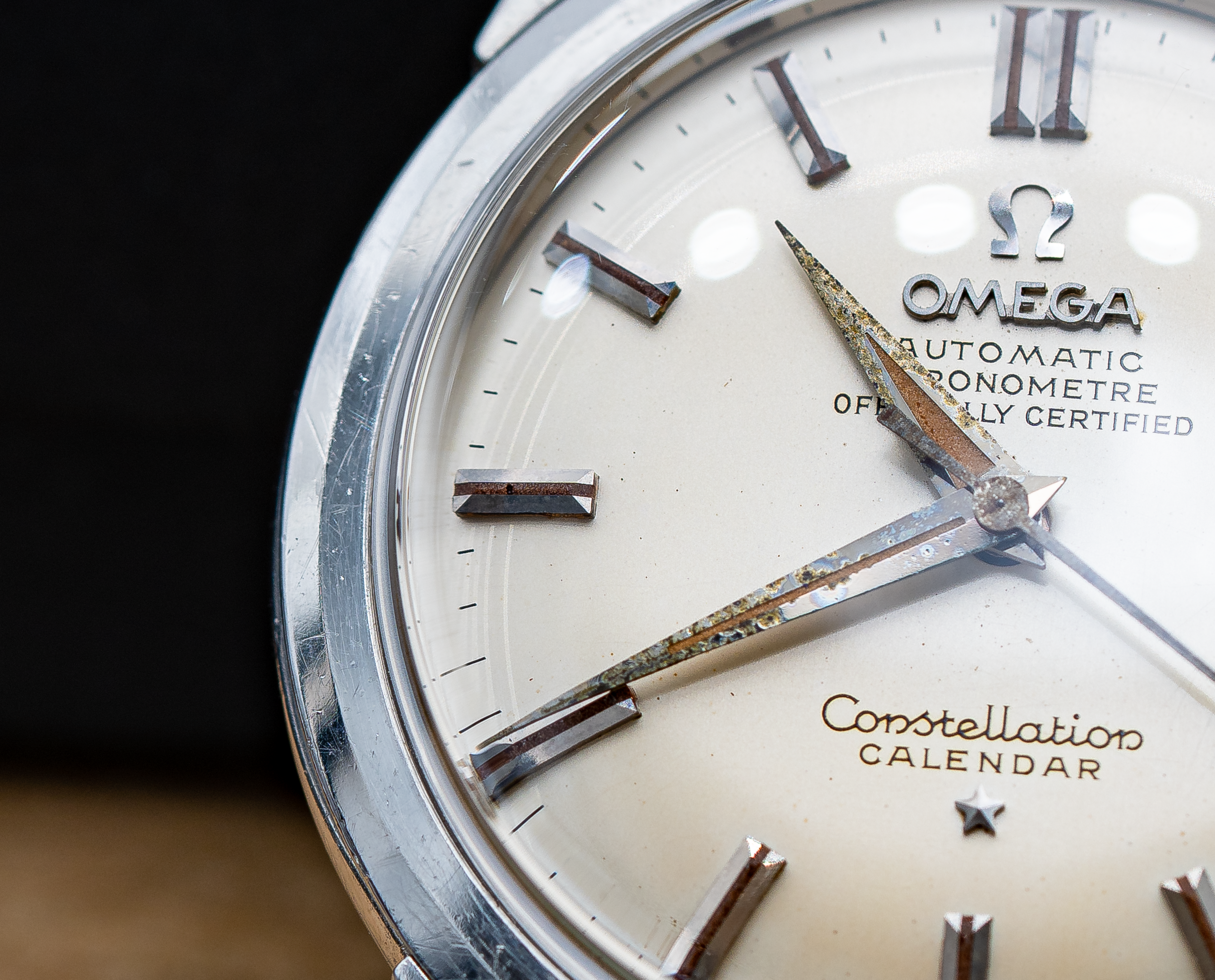

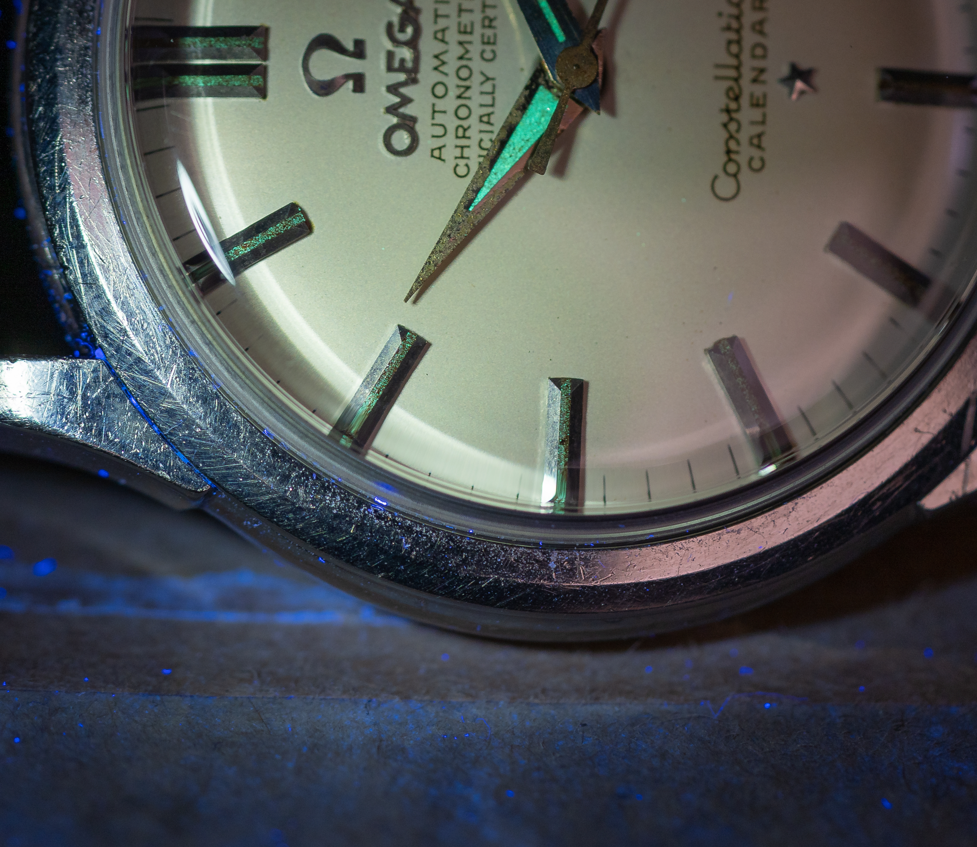

Rather than creating a new thread I'll reuse this;
What are these indexes made of? Somewhere I read about rubber inlays but cant seem to find where it was... Onyx - doesnt look like it... Radium? Dont know... As seen in the 9'o'clock index it has been broken in the middle. Ive included a picture with UV light aswell.
