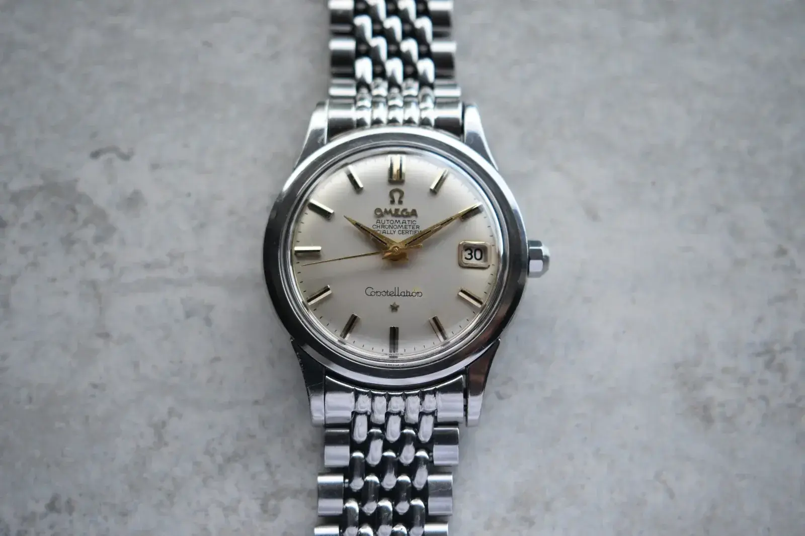

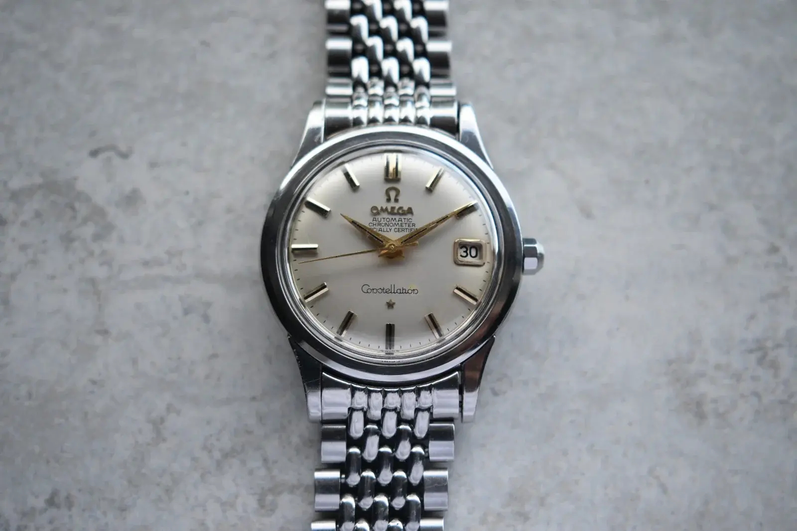

Thought I would show off a new acquisition of mine. I noticed a few posts here with the 2943-1 but not the 2043-3, so I thought I would share this one.
This is a Constellation 2943-3-SC with a Calibre 504 of which there were only ~25,000 produced.
This one needs a bit of a service, the crown is broken so I will be ordering a new crown and stem. The crystal is also not original.
Here are some photos. Feel free to leave your thoughts on its condition/originality.
I do suspect the dial has been redone, regardless it is a great looking piece!
Enjoy!

Redialed and case is pretty polished. But as long as you enjoy it that's all that counts 😀
94
105
Yeah the polishing is the main detractor, the redial looks pretty good to me.

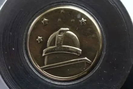

Its a shame it seems the gold constellation medallion looks to have taken the brunt of the polishing.
6,860
10,555
I suspect that, rather than just a redial, the dial is from another watch (e.g. Seamaster ) which has been repainted to look like a Constellation dial.
A 2943 should have an applied 'OMEGA' (and of course Constellations should have an applied star.)
However, I think the repaint looks really quite well done - if whoever did this set up in business repairing knackered Connie dials they could make a killing.
As long as you didn't pay too much for it you can enjoy wearing an attractive watch.

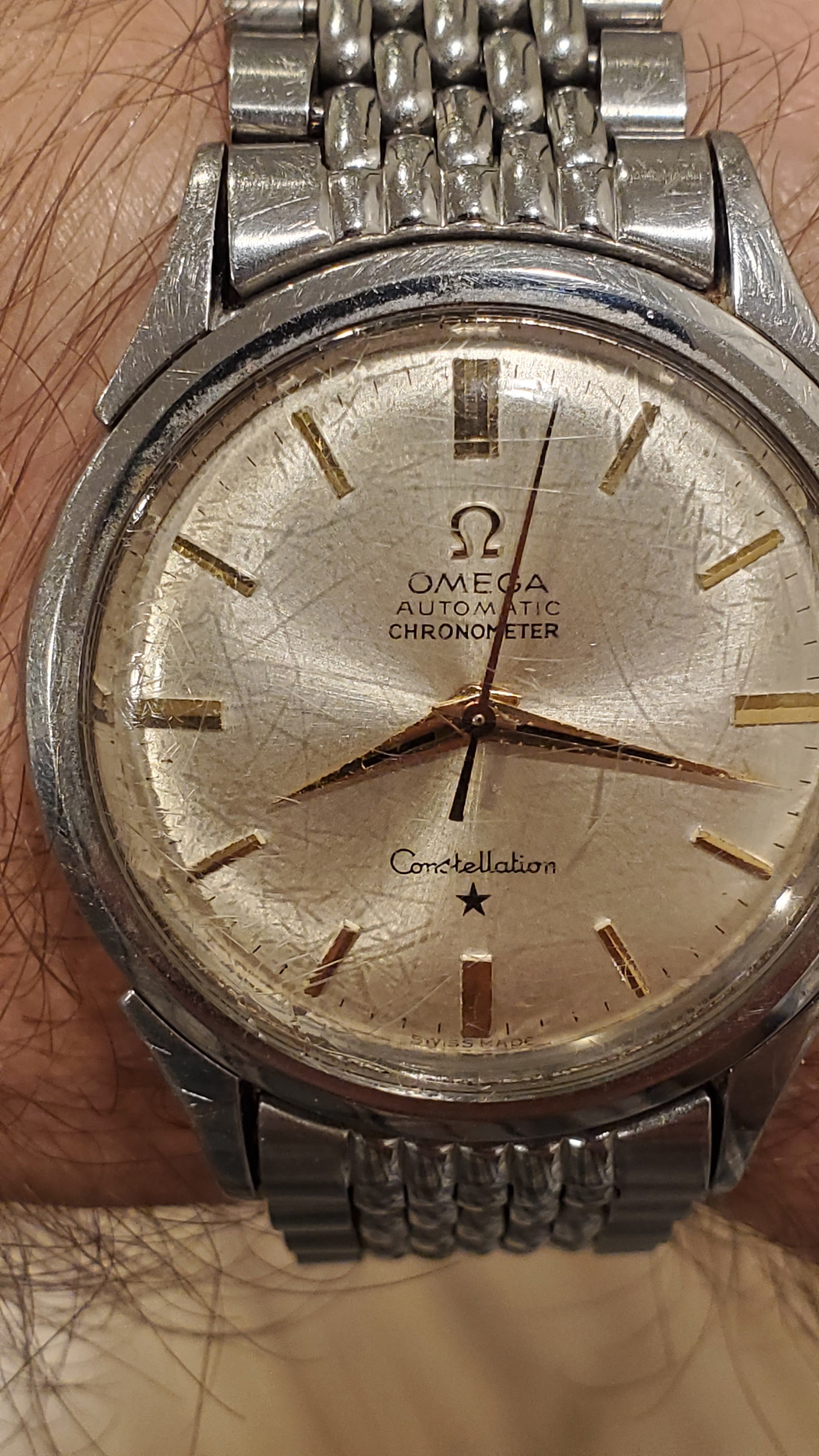

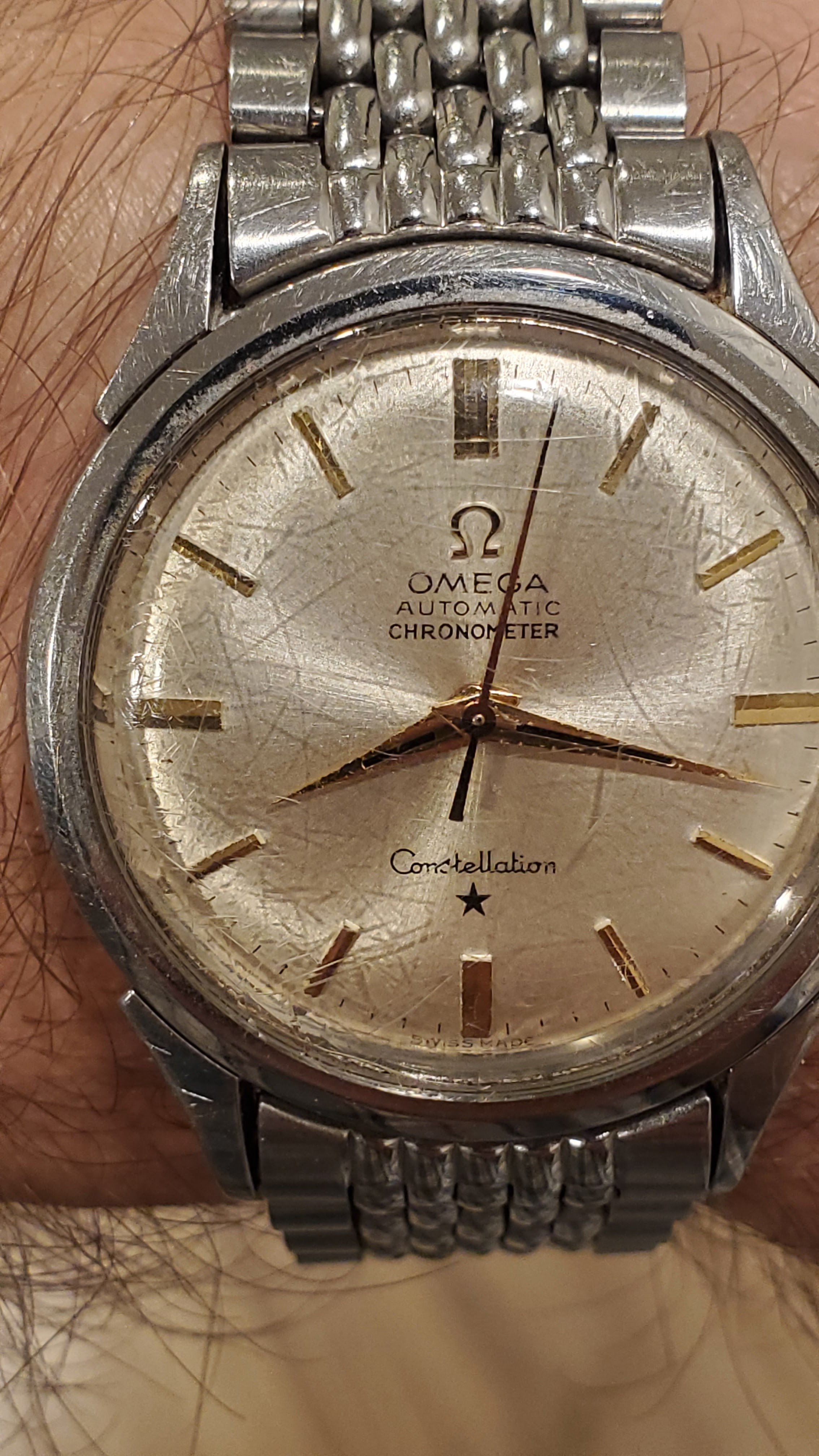

My first Constellation purchase (which I returned) was a 2782 with a similar dial.
13,506
31,844
I believe that both examples shown in this thread have service dials, not dials which have been refinished.
6,860
10,555
That would be interesting.
Have these dials been discussed on OF before?
Do we know when we think these dials were produced?
The indices are different from one another and the text differs.(with and without OFFICIALLY CERTIFIED)
The first one has large centrally-ridged vertically-ended solid indices, where you would expect them to have flat tops for a Constellation.
The second one has thin indices that didn't appear on Constellations, coupled with large indices - again both with central ridges.
Odd that Omega would produce Constellation service dials that look like this.

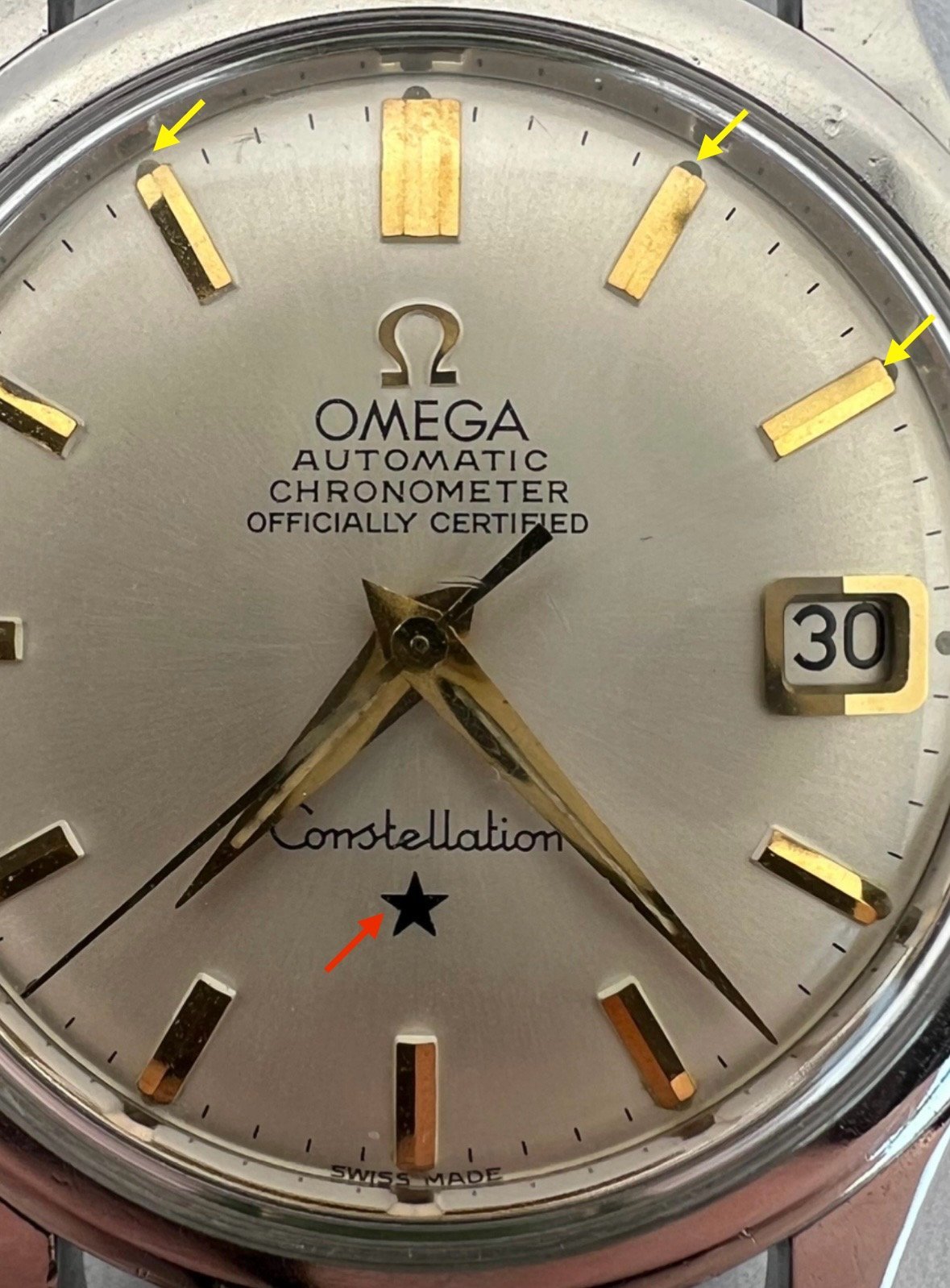

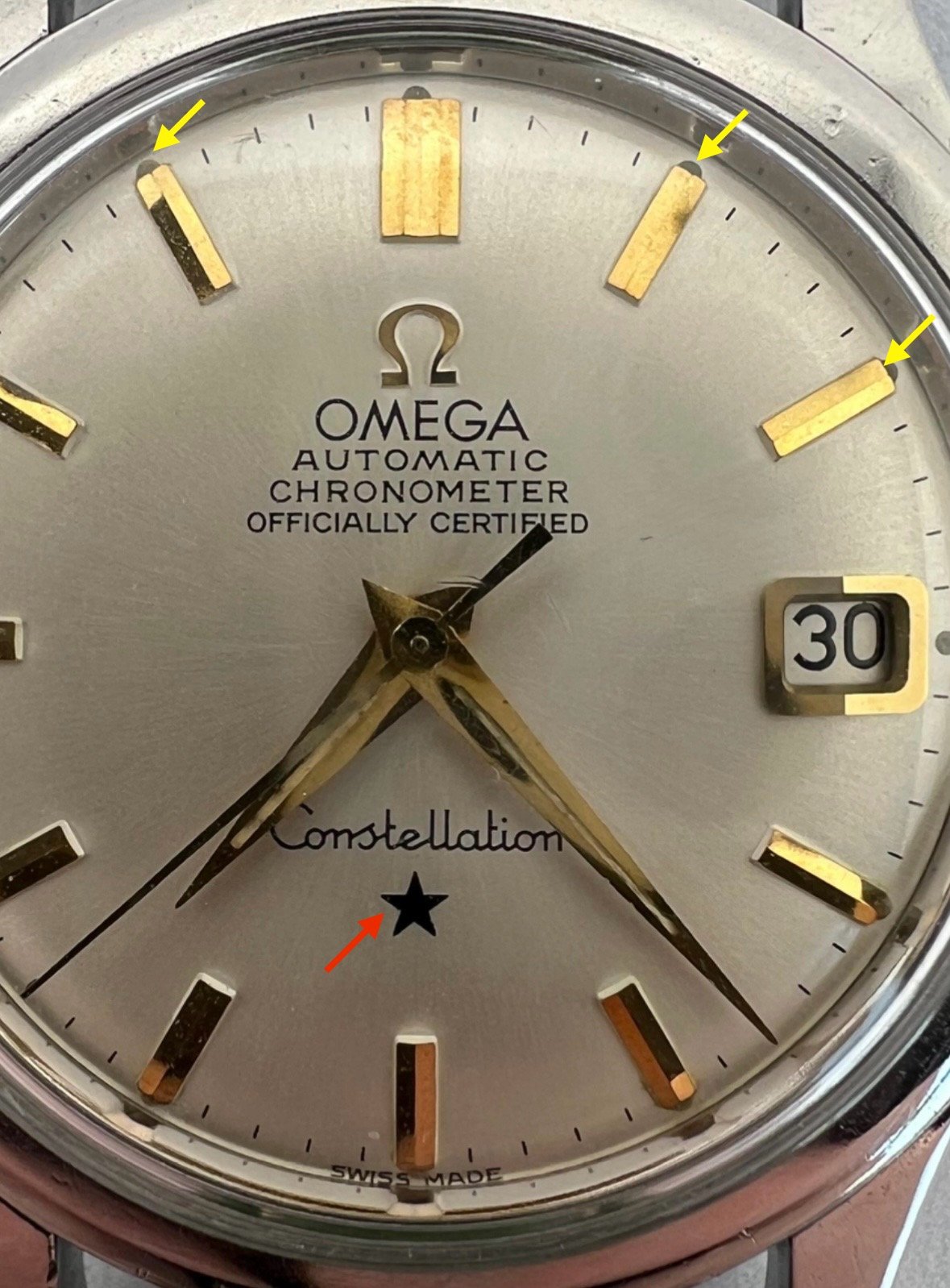

I noticed that the star below the word constellation was printed (marked by the red arrow)?
In general, will we see these dots next to the hour-markers (marked by the yellow arrows)?
Also, the quality of printing is not that good.
I vote for redial.

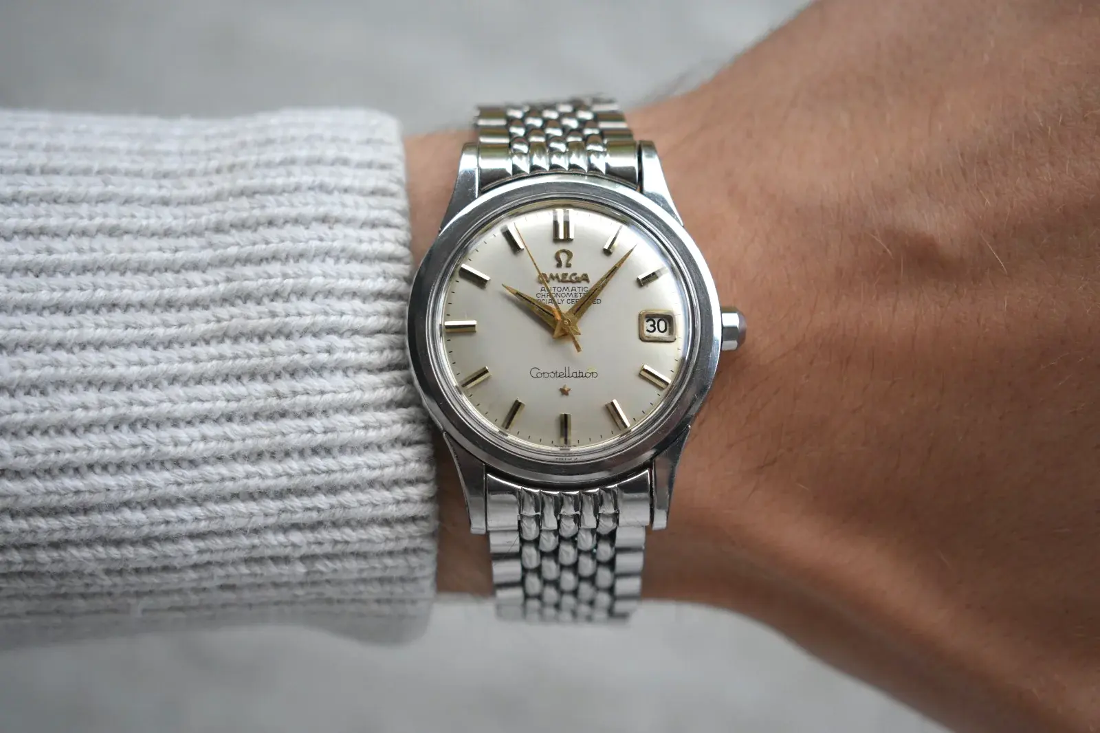

Hey there, looking at possibly buying a 2943-2SC and came across this thread in my research. What do you think of this one? Any chance it's been redialed or taken from another watch?? Thank you!
6,860
10,555
The images really aren’t great but the ‘Constellation’ doesn’t look right
10,142
58,196
Same thought that I had. In addition, the medallion is fair at best. I’d pass.
1,024
4,126
1775 GBP is pretty high, even if it had the original dial - but that’s not the case here.
I’m just wondering why it was described as ‘The watch’s dial is original and in excellent condition. 😅
10,142
58,196
