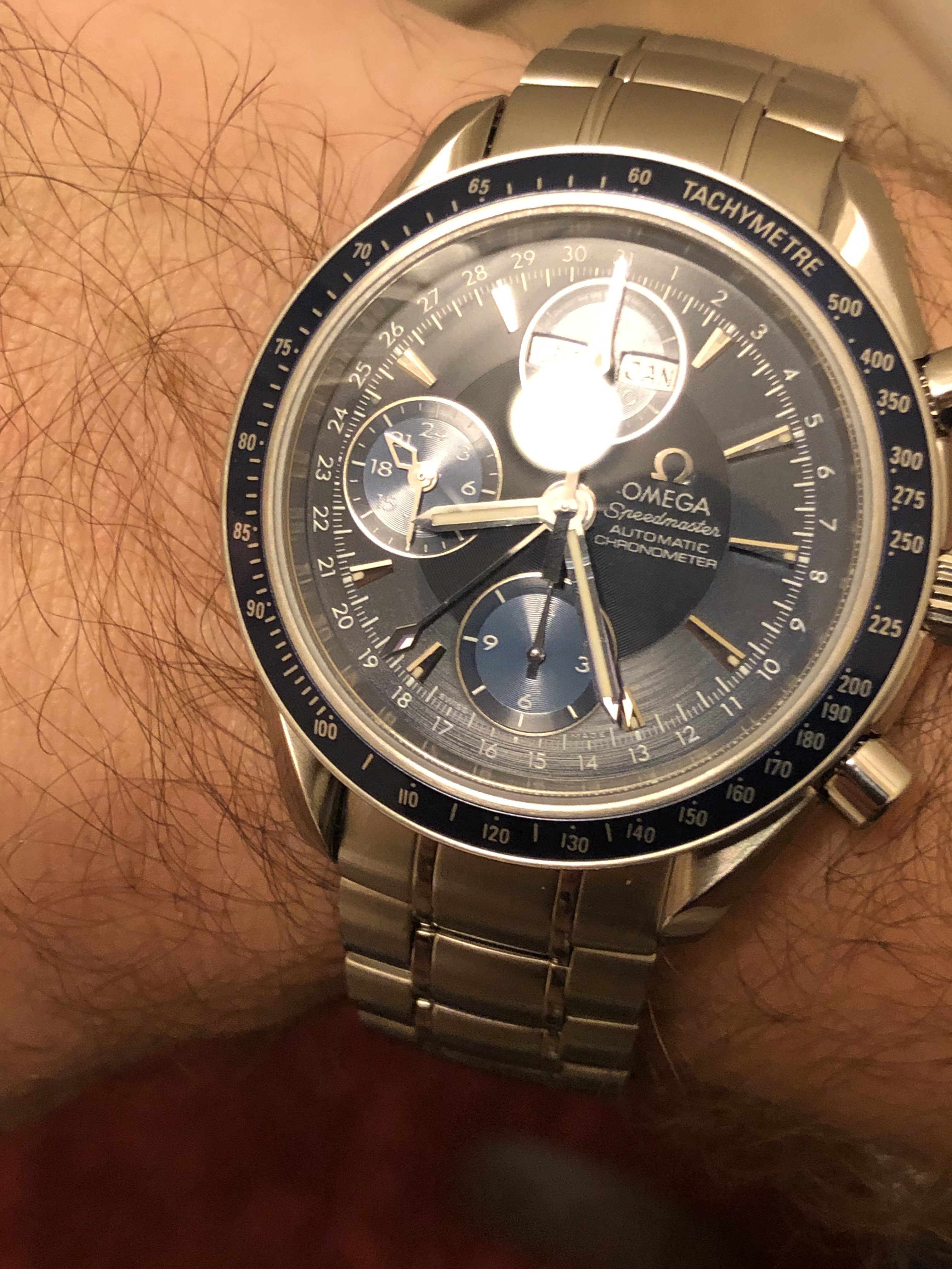

My Speedy is home. I am overjoyed, elated, and thrumming with happiness... and then, the ceiling comes crashing down. The watch looks amazing, but something peeks out at me in a flash of light. I look closer. A speck of dust under the crystal. I can deal with that. It’s very small. But what’s that under it... SCRATCHES!? The minute hand and chrono second hand have been placed very close together, and when I set the time, it swept scratches across the minute hand. After 17 weeks, do I want to send it back for scratches and dust? Should I bother making a stink? What would you do?

Unfortunate and will require a new hour and minute hand to fix this (they are sold as a set).
There’s a good stack of hand on the Cal. 1151 based models and you have to pay close attention to the division (spacing) of the hands on these...

It was definitely serviced by Omega. I called them regularly to check the status of the repair. I am going to call them tomorrow and raise a fuss, as I shouldn’t have hands rubbing together on a watch that the manufacturer just serviced. I have the original hands they sent back, and they do not show the same signs of wear, so it was something clearly missed during QA.

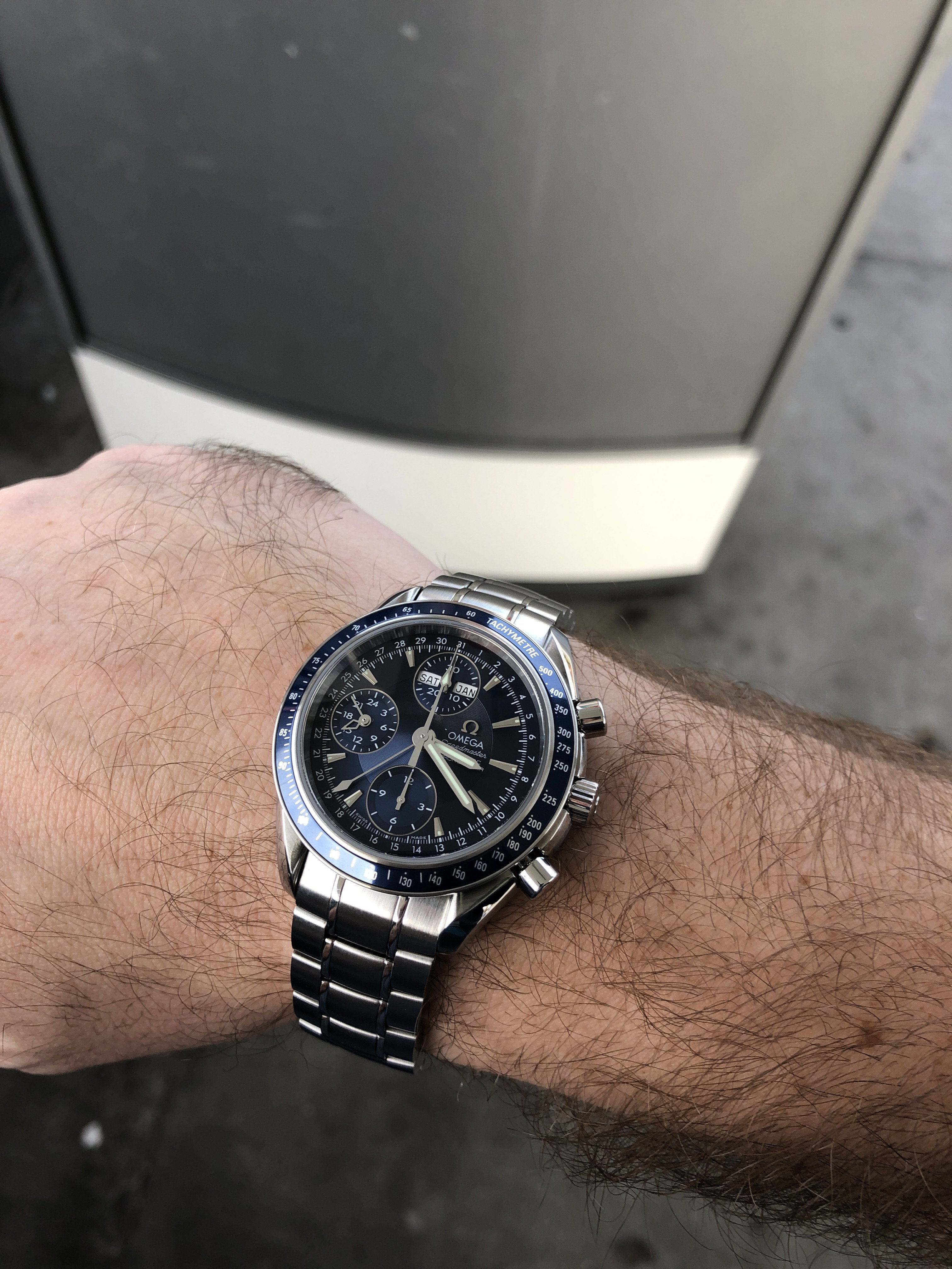

Pic from last Friday:
I ADORE the Day Date, and as my first Omega, fulfilling a lifelong dream, I'm very satisfied with the selection 😀. Wear yours in good health!
