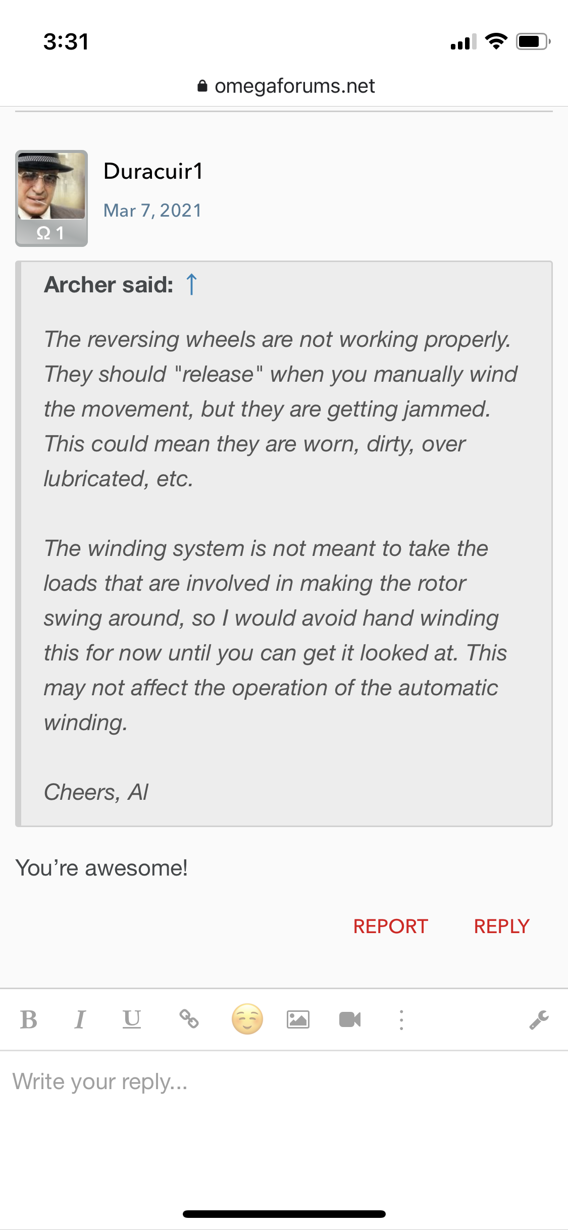

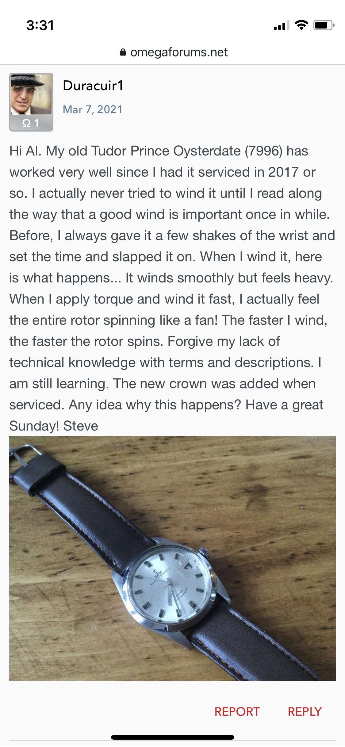

I think I have the same issue and have asked the expert… here is a screenshot of my question and of the answer…
