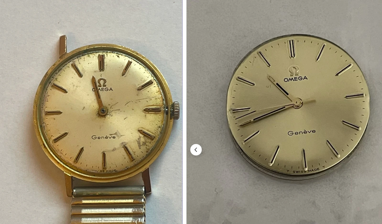

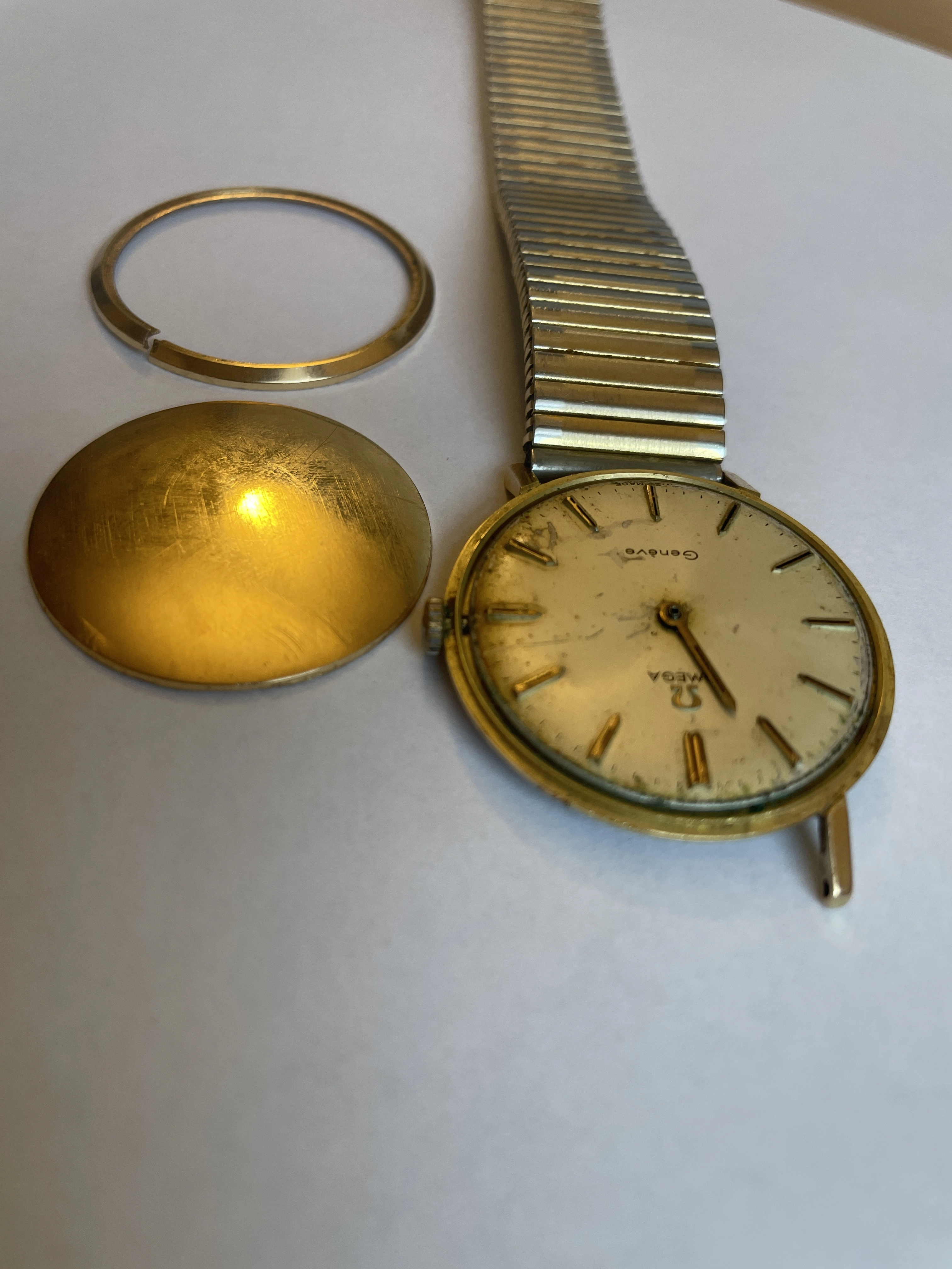

Hi all,
Apologies in advance if I'm posting incorrectly, and this query is on behalf of my elderly father.....

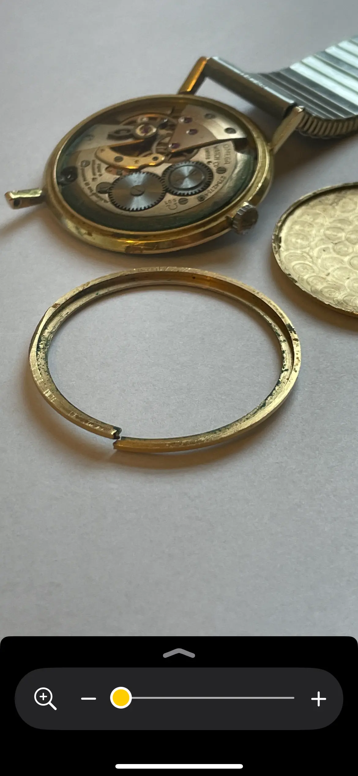

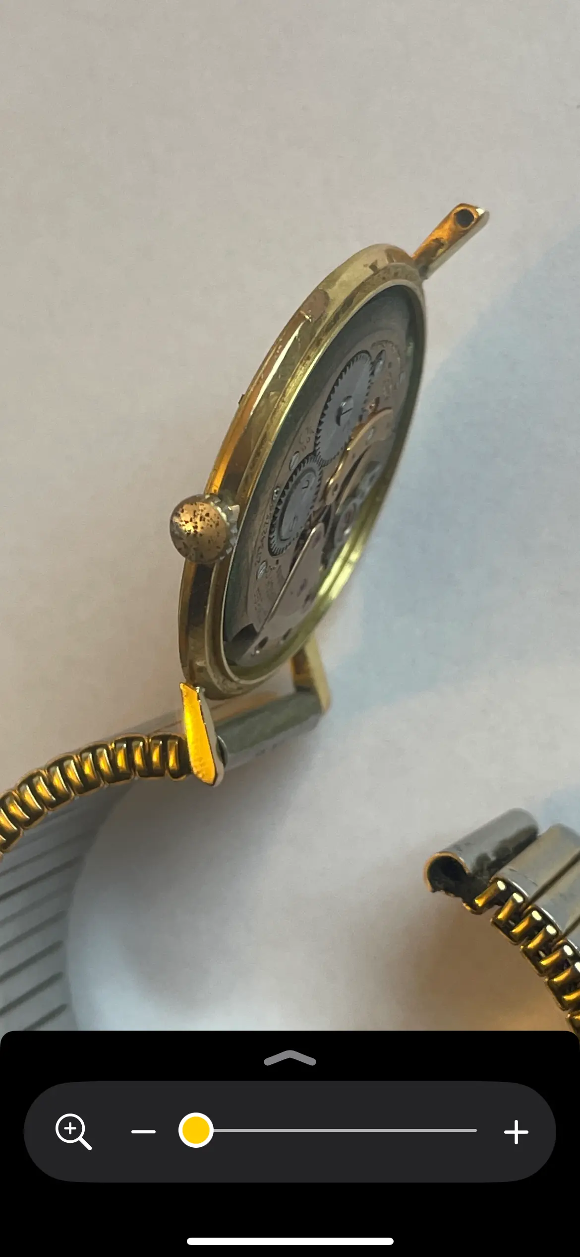

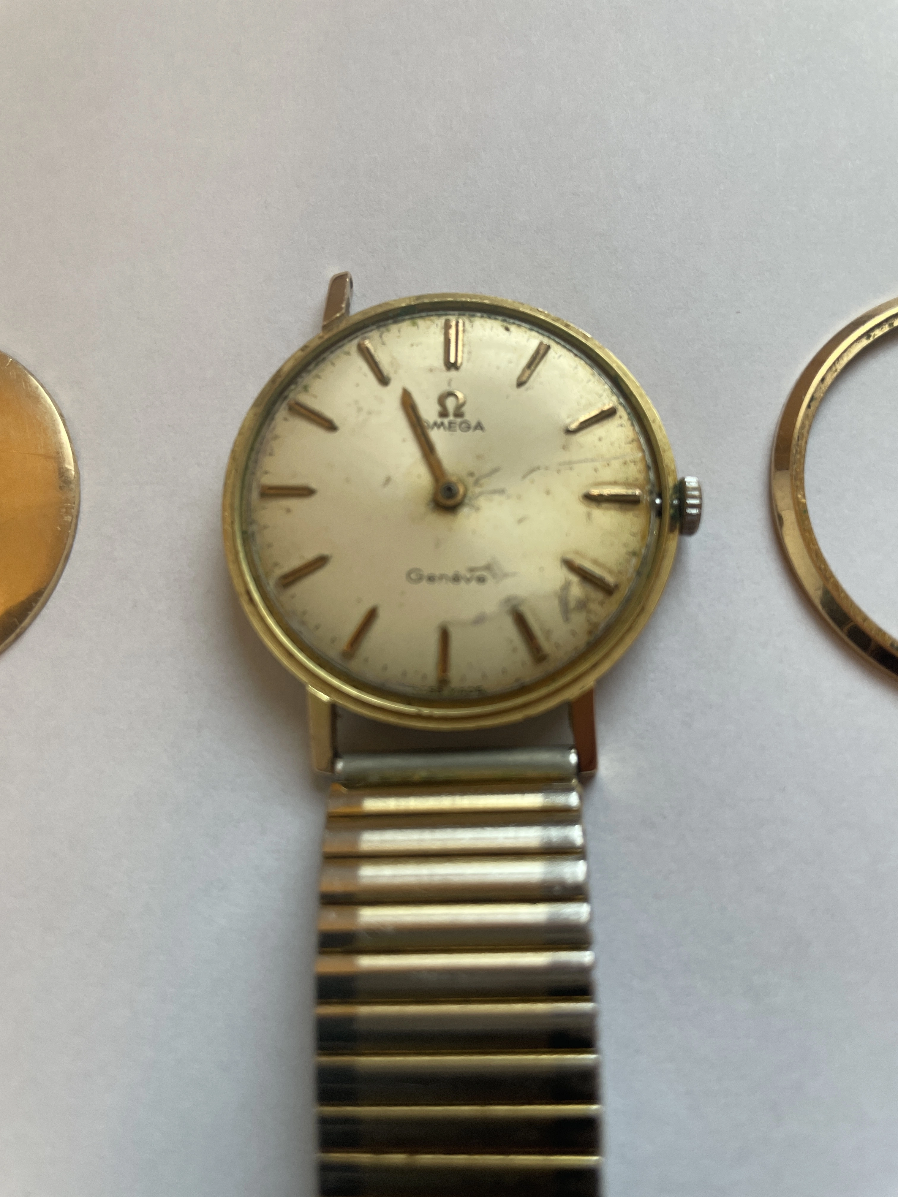

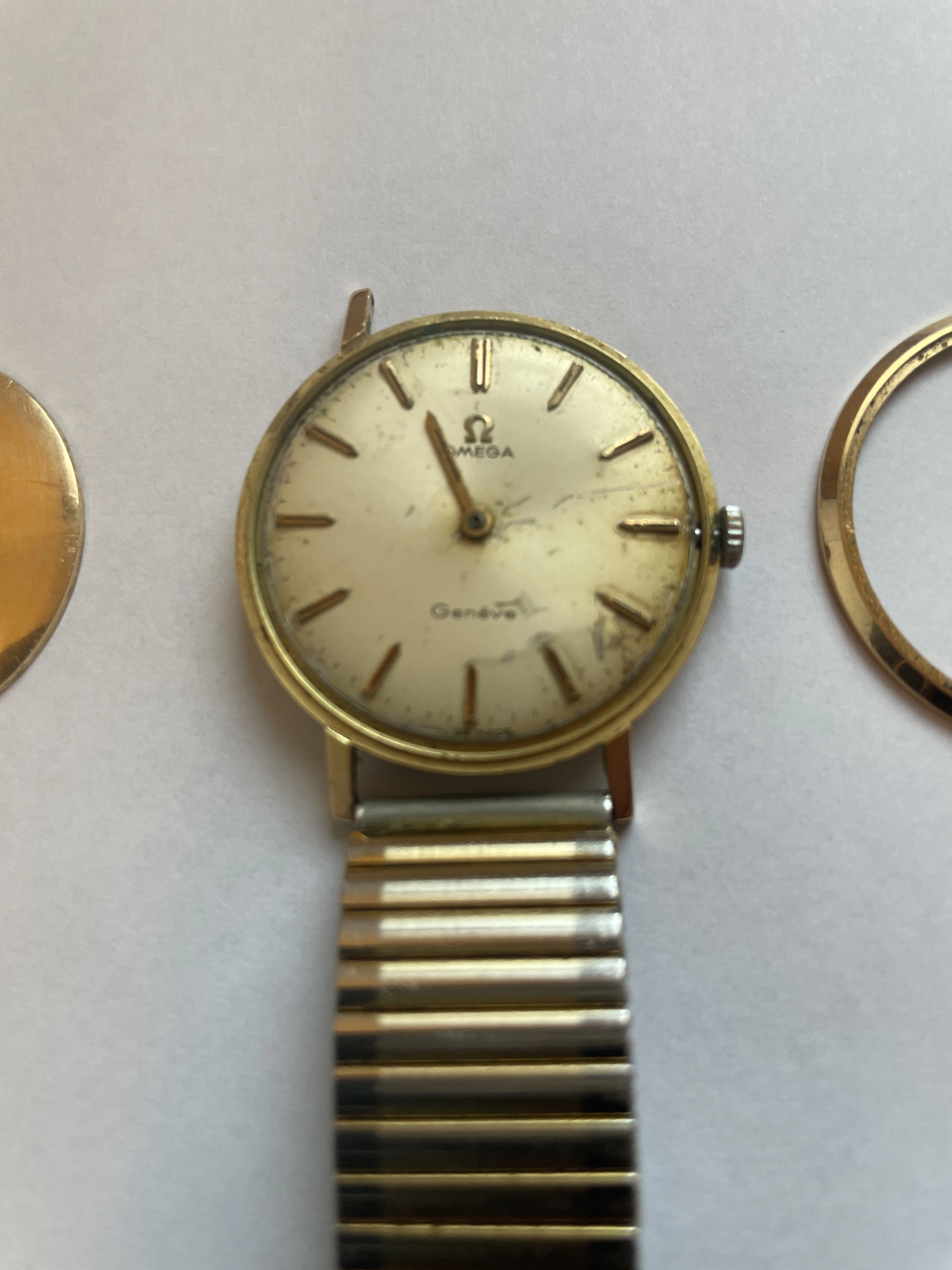

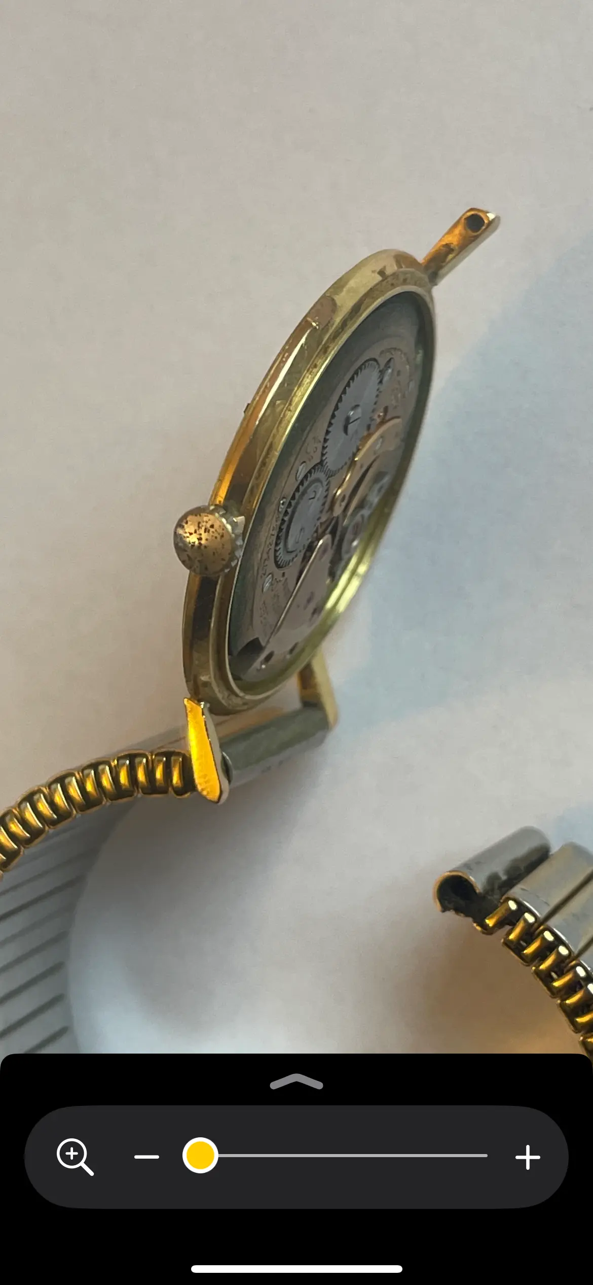

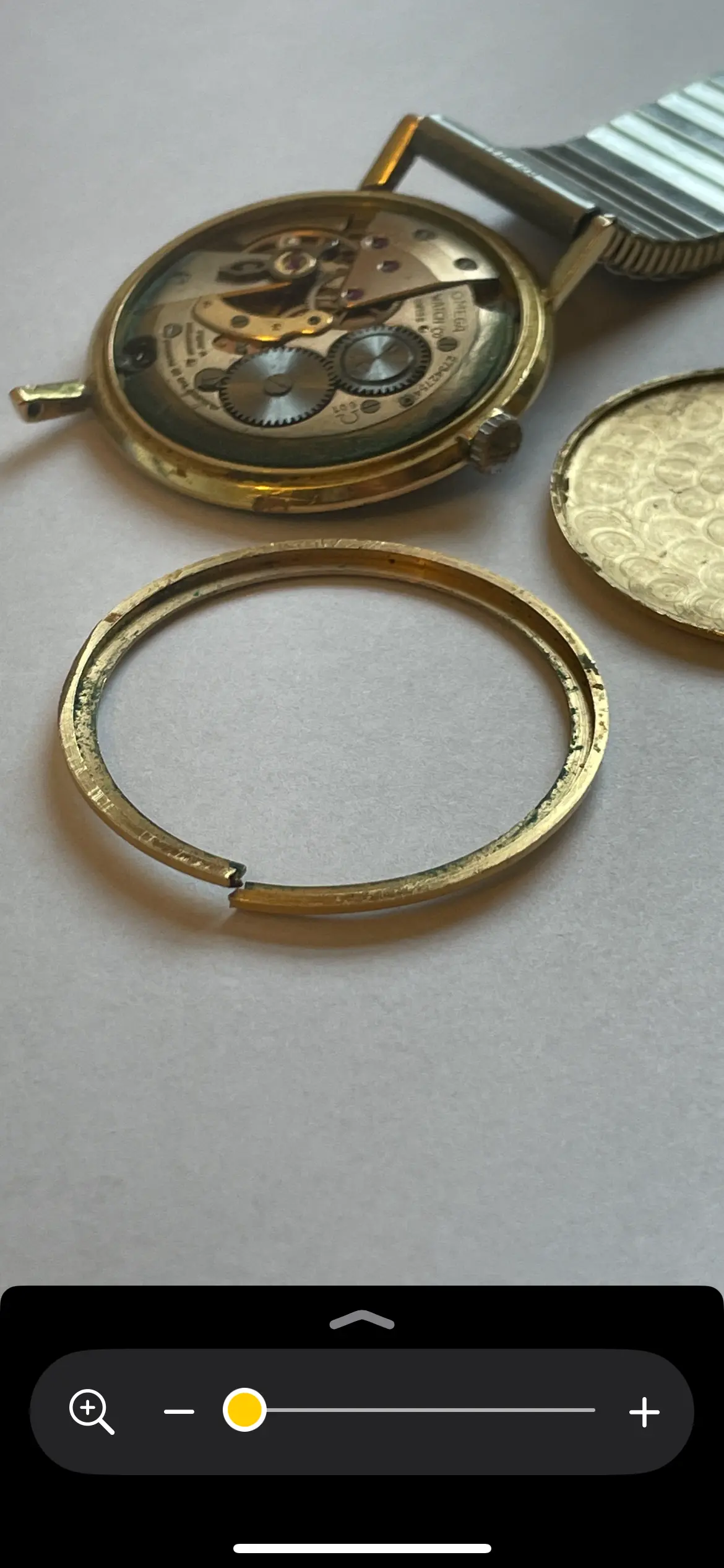

After a fall crossing the road a few years ago (2020), my fathers watch, which is the only watch he has ever had, and which was given to him by my grandfather as a wedding gift, was very badly damaged. One of the lugs is completely broken off, the glass was smashed, the outer ring has been cracked and the minute and second hands were lost, along with some quite bad scratching to the face of the watch.
I'm not familiar with Omega watches, so can only tell you what is on the watch itself - It say 'Omega Geneve Swiss Made' on the front and is about 33mm wide.
The back has the numbers 27342754 OMEGA WATCH Co SWISS 601. It was given to my father back in 1969.
It does work when you wind it as the movement turns back and forth on the rear side and the hour hand does go around, though unsure how long it last or how accurate it is.
A friend of ours said you would have to find a donor watch for any chance to replace the broken parts.
Just thought I would ask here if it is possible to repair or if a donor watch would be easily obtainable?
Any help or advise would be most appreciated.
Thank you in advance

Hi Rob,
Sorry to hear about your Dad and I hope has recovered.
As to the watch, it's pretty well stuffed. Even if you find a donor, the only thing useable in your watch is the movement.
Finding a case like your sans movement will be unlikely in the extreme and the expense involved to do a restoration would far outweigh the value of the watch, even considering sentimental value.
To put it bluntly, it's a lost cause.
Maybe you can get the parts (not bracelet) encapsulated in a lucite block as a memento of what it was, what happenned to it and what it means to you both.
Just my thought, other will offers theirs I'm sure.

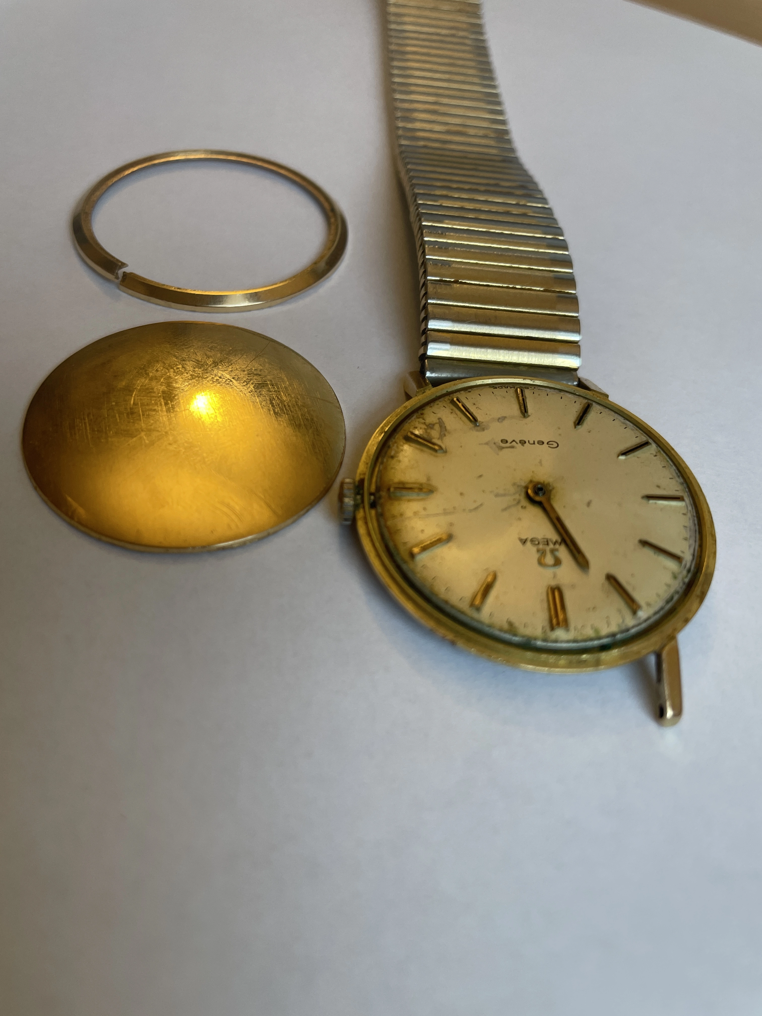

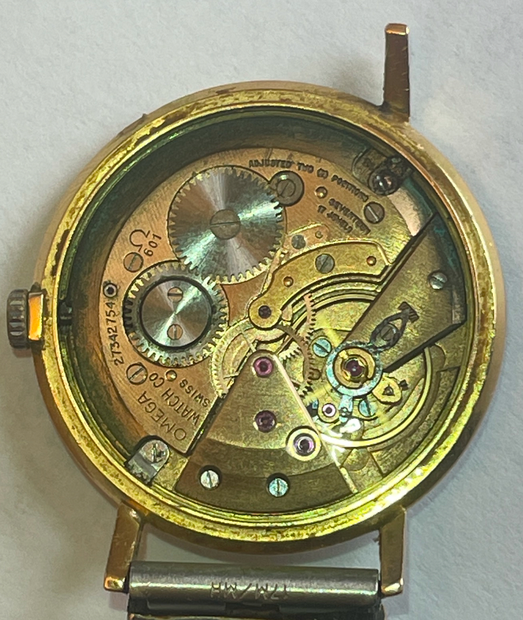

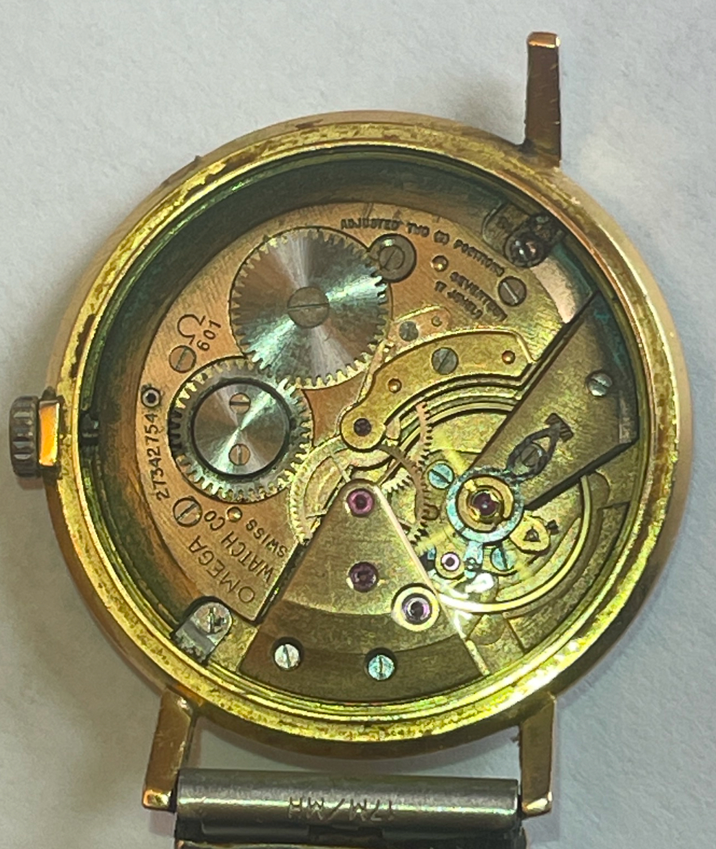

Can you please show a clear photo of the inside of the caseback? And of the movement? Your photos give a sense of the damage, but in order to help you think about restoration, we need to be able to first identify the watch. If you are not looking for that sort of help, you could contact a watch case repair specialist who can fabricate a new bezel and lug.
18,847
39,196
Yep, I thought of that (English 9ct case?) but thought that memories are better than cash that just slowly gets used up until it's gone.

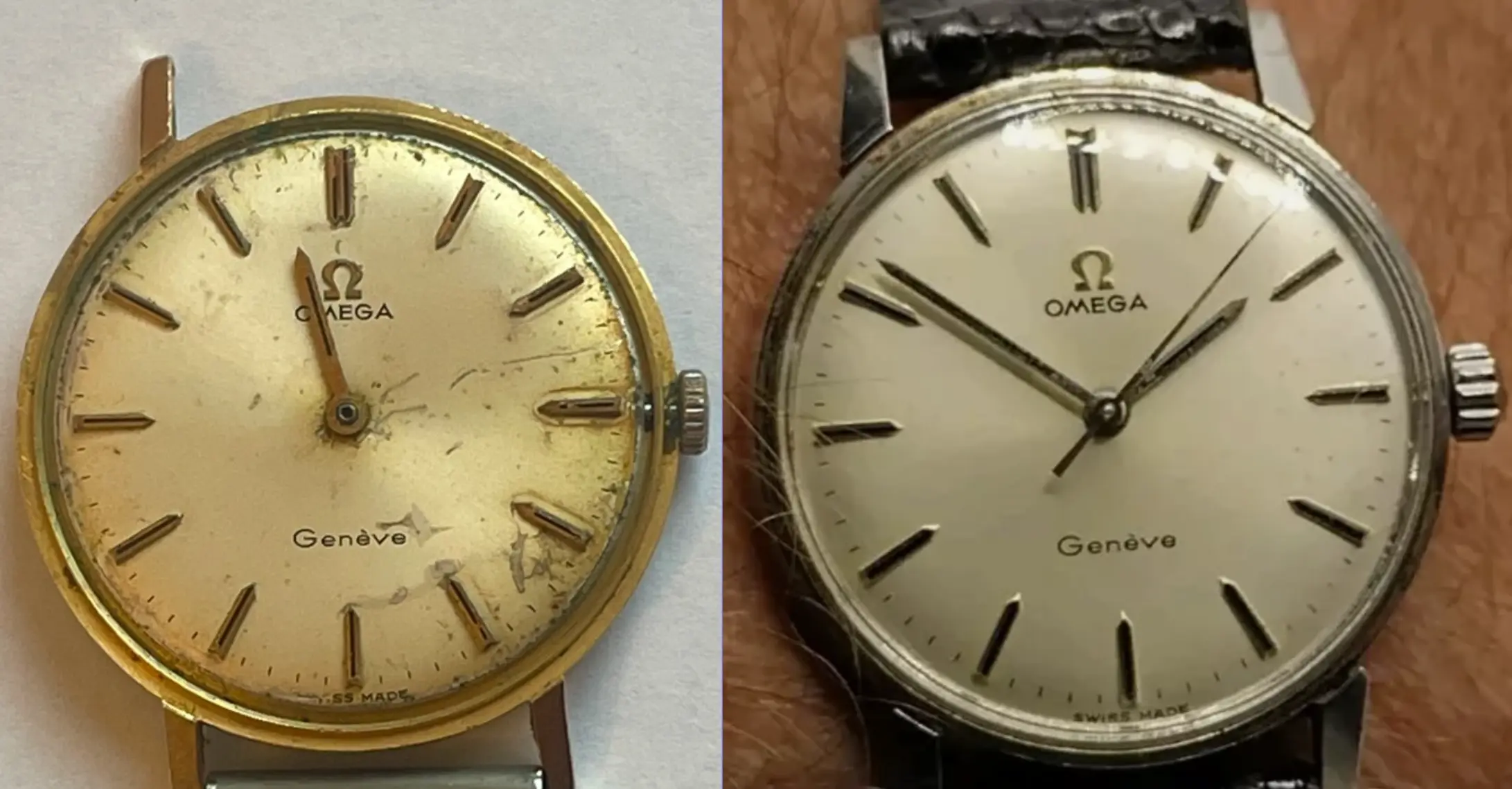

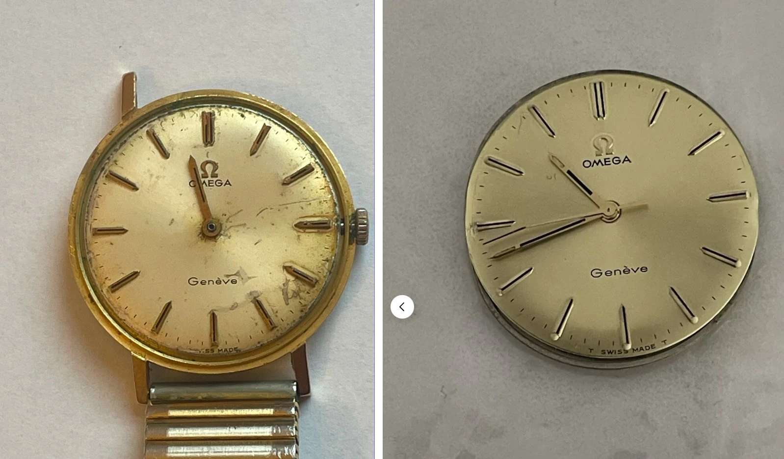

Echoing Jim's thoughts, there is little chance that any watch seller would be able to have the watch restored at any reasonable cost. Put another way, a good example of the same model on the used market would almost certainly cost less.
Having said that, it is possible that this "orphaned" dial and movement are from the same model, and if so, it would reduce the renovation costs substantially:
https://www.ebay.co.uk/itm/26712669...75&ssuid=foROAuEUSze&widget_ver=artemis&media

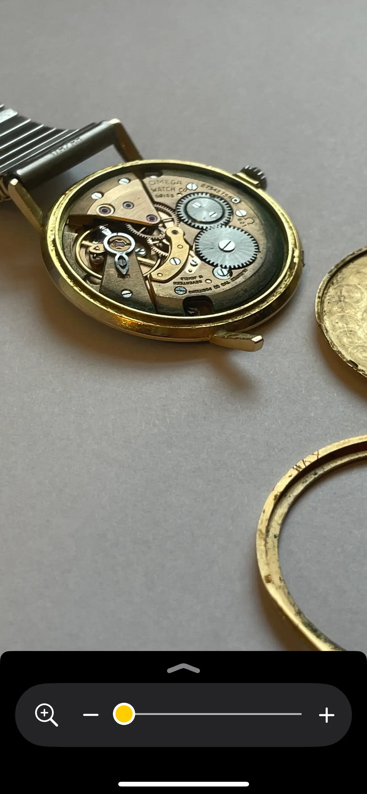

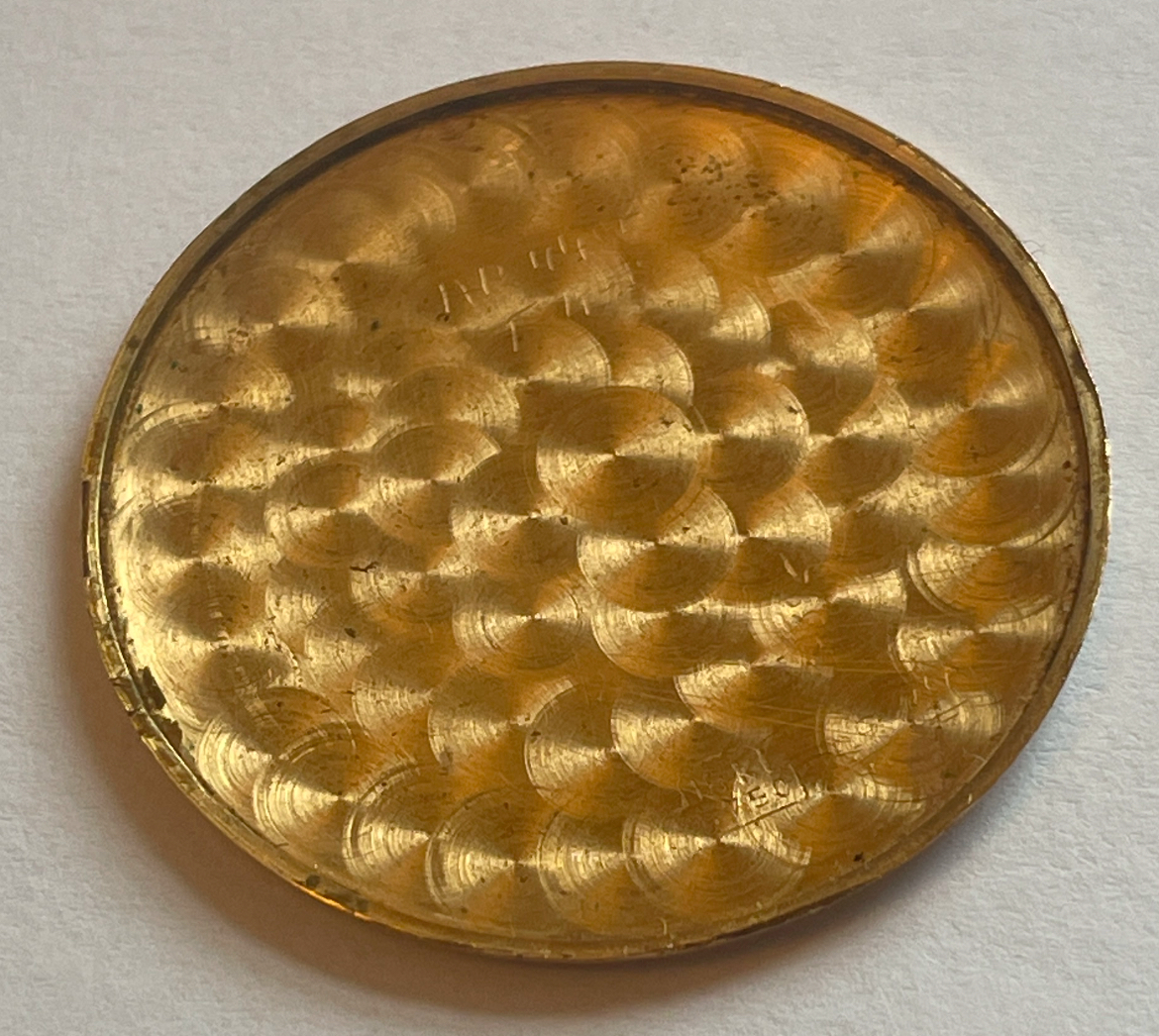

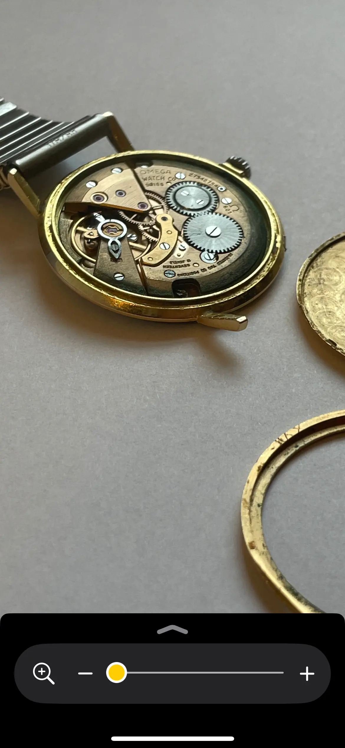

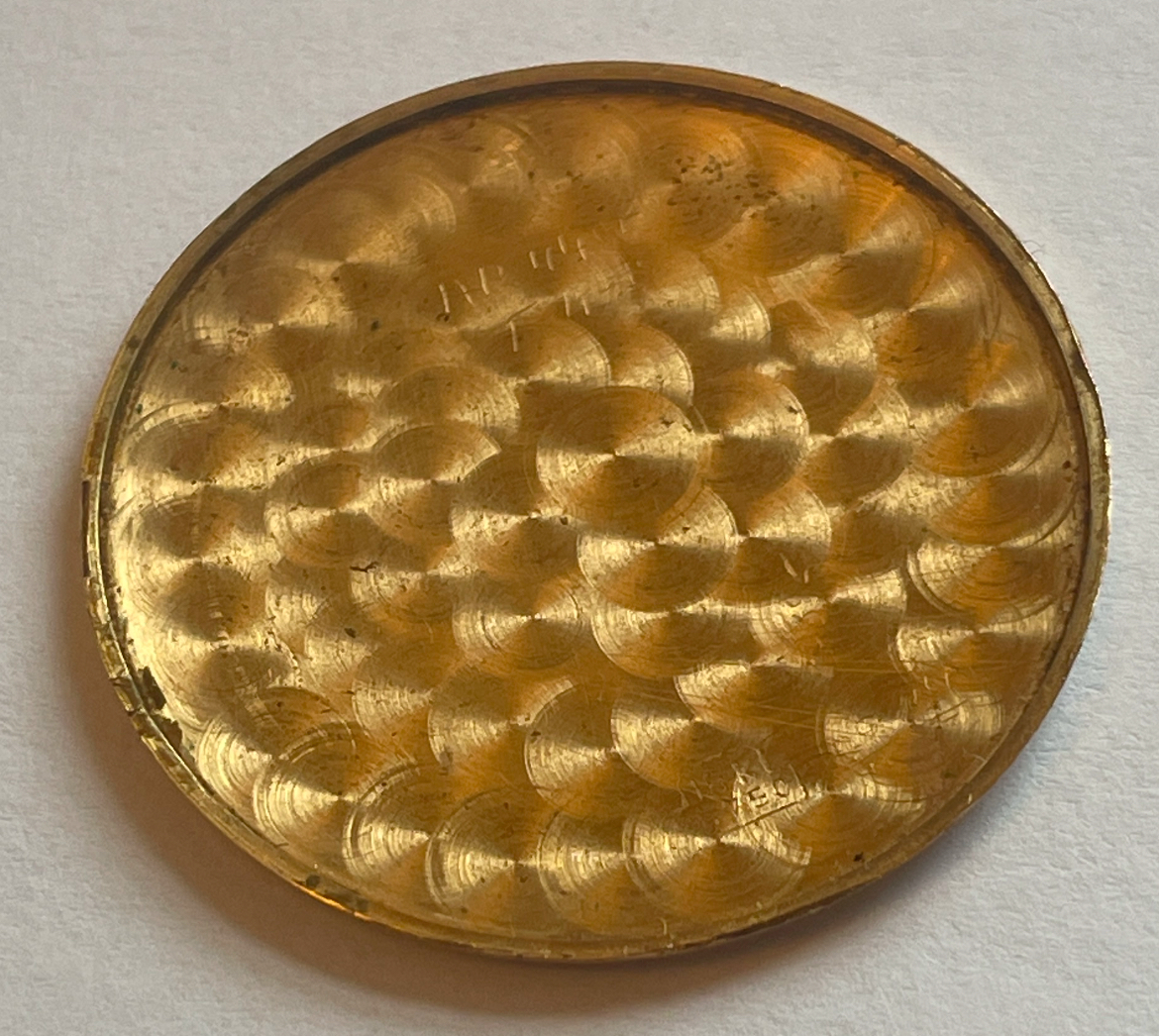

Here are some more photos of the case back and inside movement - I only have my phone camera so these are the best I can take.

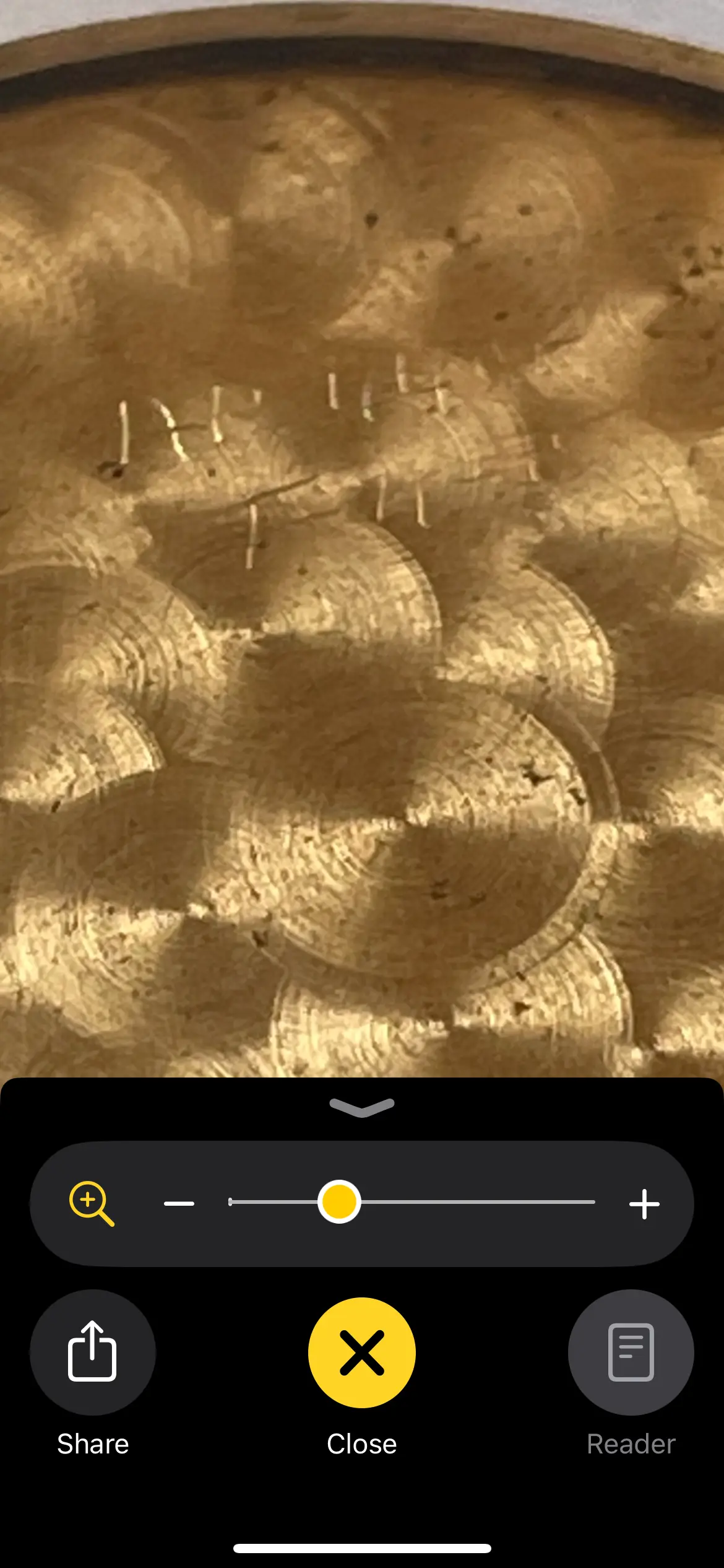

I can just about make out 18k 750 mark on the caseback and some engraved numbers - I'll ask my father about those.

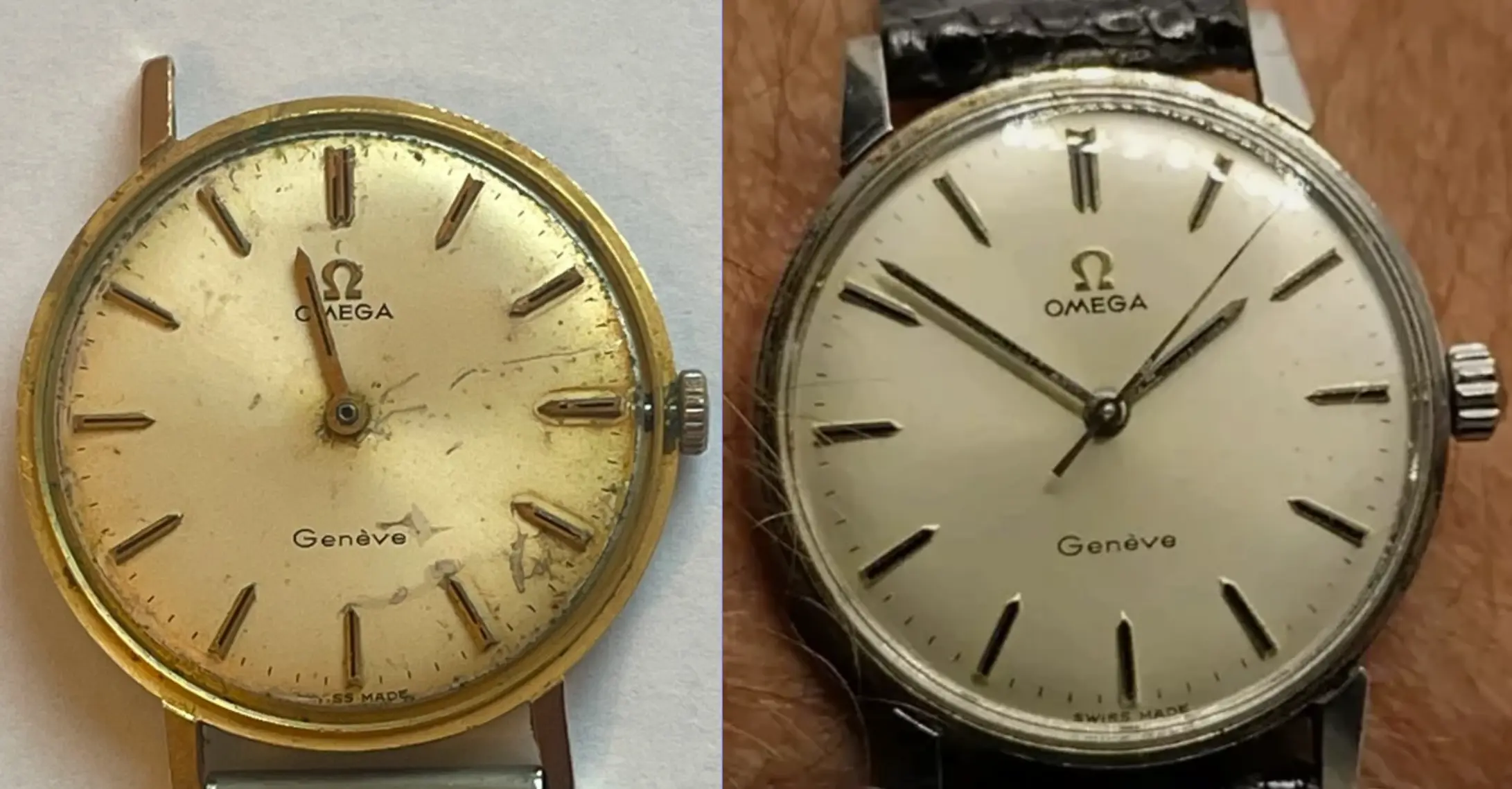

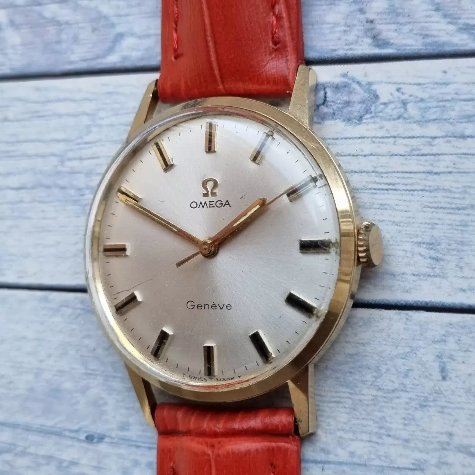

Tony C - thank you for your input and link to an orphan - how can I check the size of the 'hands' and that they will fit? - The hour hand looks ever so slightly different - the black inset section is split in two parts - also looks a little wider?
8,288
29,323
The hands should be interchangeable, as the movements are identical. The question is whether they were two dial variations found in the same model, or if the cases were of different sizes. You can measure the width of your dial, and if it is also 29mm, they should be interchangeable.

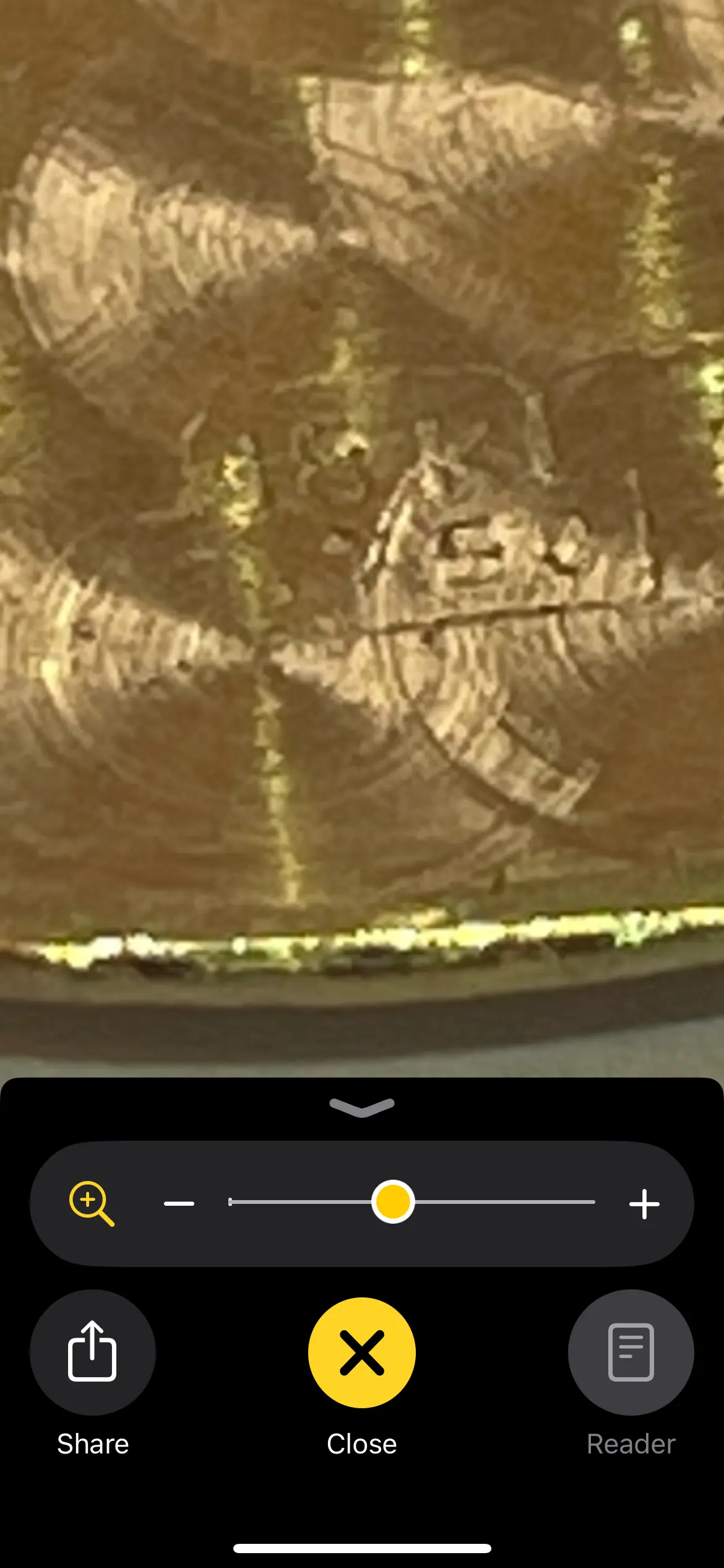

It is going to be difficult to say much about that case since it has no markings inside. No Omega marking, no case-maker marking. It could even be a custom made case. A repair could be your best bet, and you will need a goldsmith.
16,001
48,138
Case back is not marked the way I would expect an Omega case back to be marked. But it is possible to see the .750 (18-karat stamp). A skilled goldsmith might be able to re-attach the lug, and solder the bezel. IF the broken lug is still available. It doesn’t show in the pictures. By the time the case is repaired, hands replaced, crystal, condition the movement (including necessary parts), the cost will be considerable! The dial is a mess, and he will have to live with it, unless the dial is refinished or replaced. Not a good prospect, I’m afraid!

As for finding someone in the UK is going to be a hit or a miss. From the little that I see, the case seems to be a locally made, possibly licensed by Omega to avoid import tariffs like Dennison case makers in the Uk and L&K in the US, I cannot see for sure if it is 18k solid gold but the broken lug section seems to show a different base metal than 18k from the poor image you have posted. If solid gold a gold smith may be a solution. If your father would like to restore it at whatever he deems as reasonable cost, I know of two case restorers that have worked on Rolex watches and other brands of watches but are not in the UK . If you are willing to send it abroad then you can make enquiries with these guys by sending an email with the same question you posted here, Firstly visit their webpages to get an idea as they seem to do the type of work you may be interested in. They may even know someone in the UK that does the same sort of work. Good luck!!

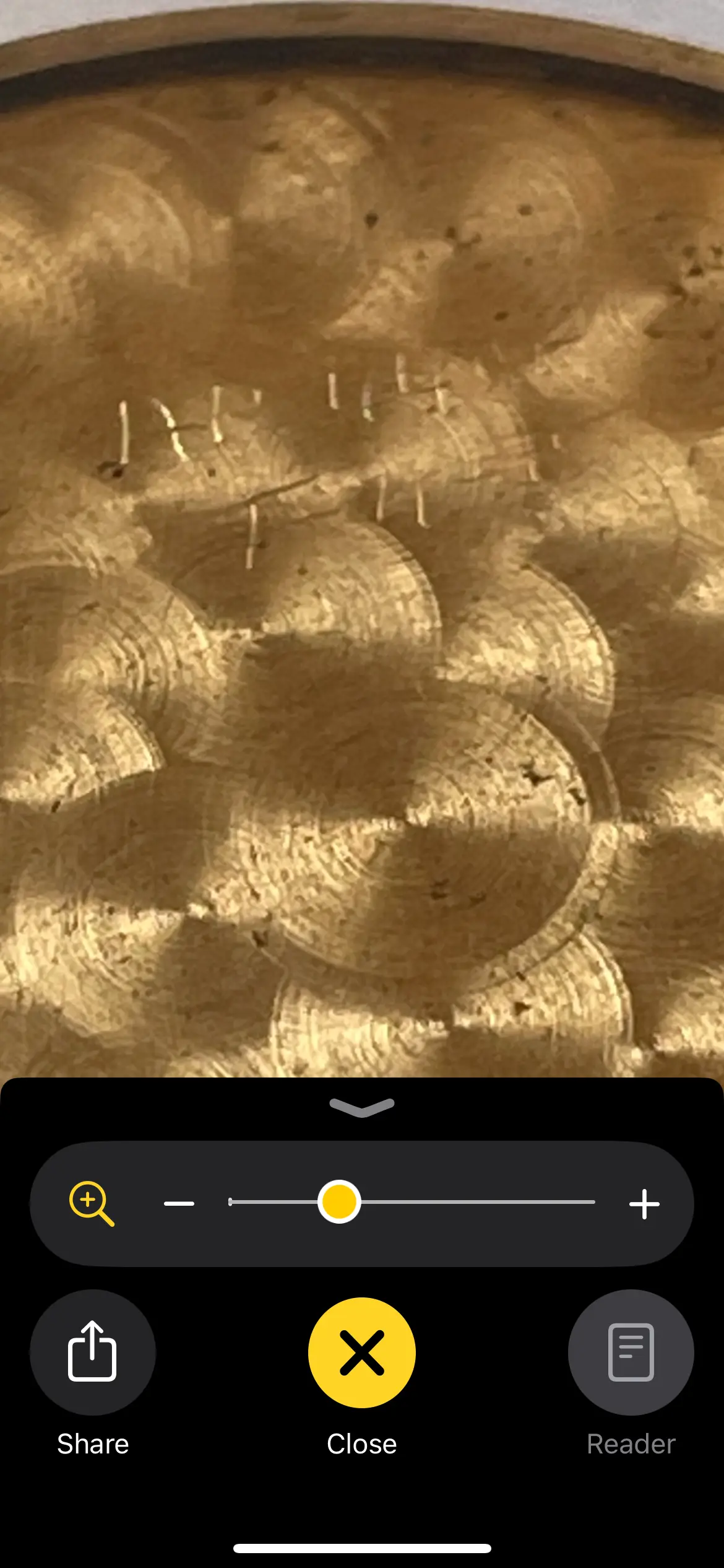

I am meeting him next week and will try and uncover more of the storey, particularly with regards to the non standard 'custom' back. Along with the basic 18k 750 stamp, there is also some hand engraved text which I can just about read, 'AR4485' and 'E4415' under that. I can also make out '40895' scribbled randomly.

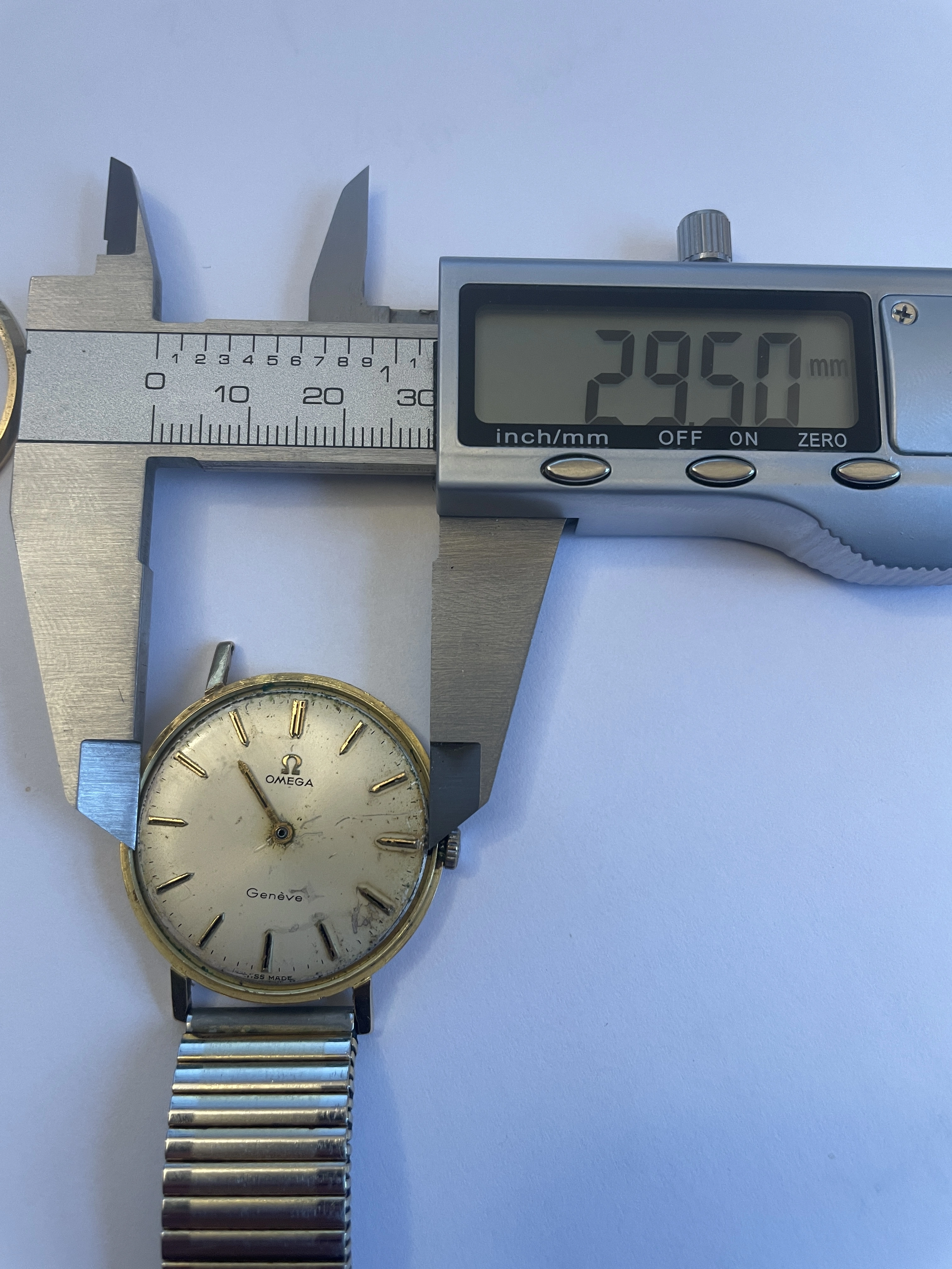

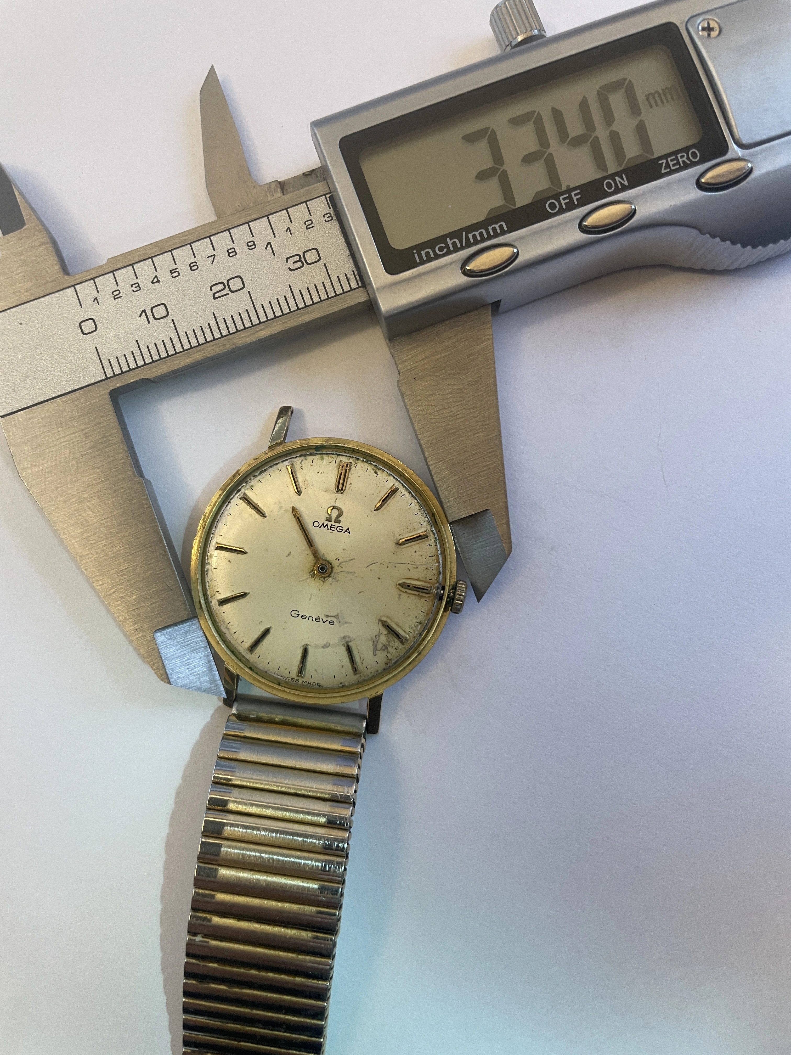

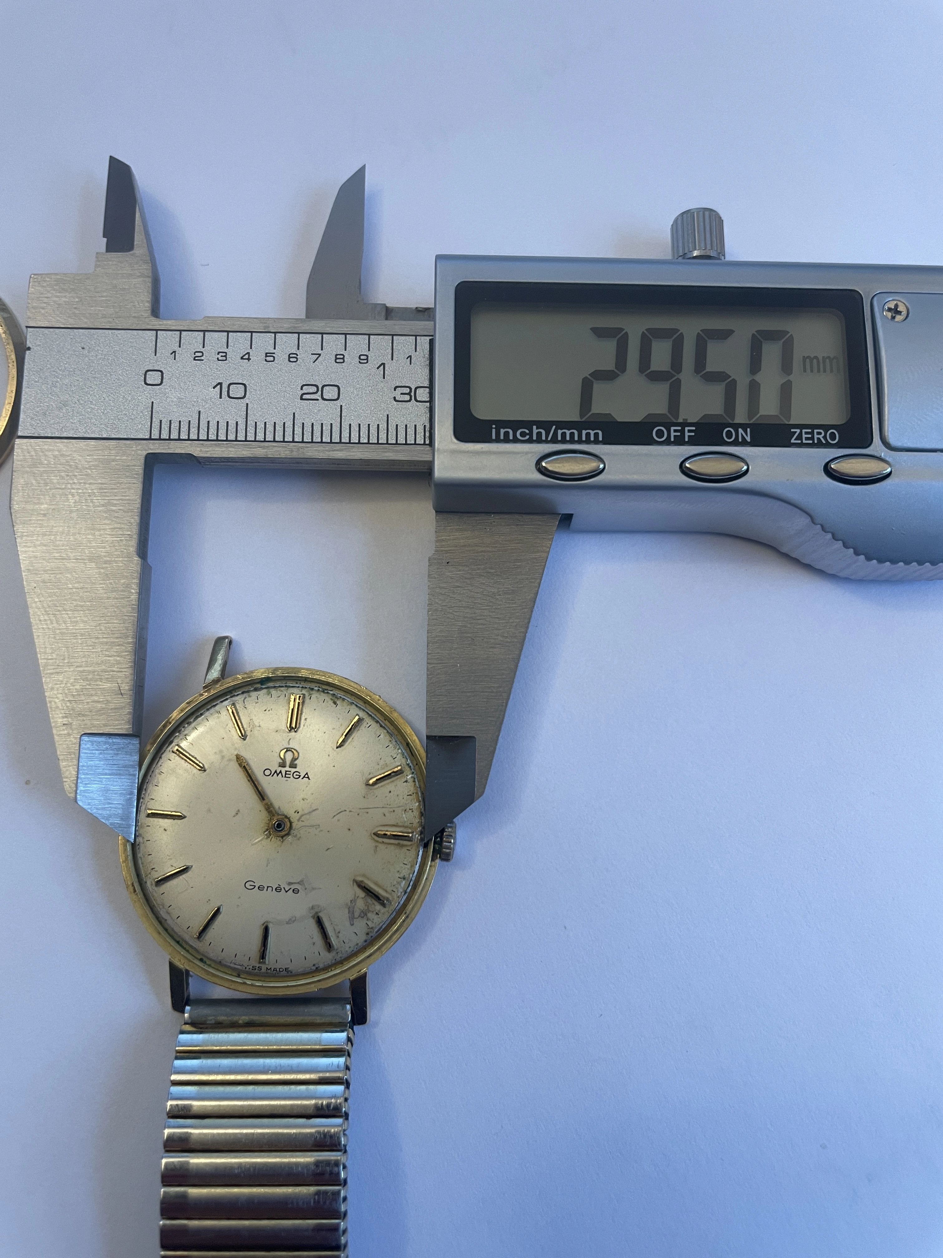

If the 'back' is custom with no model number, does anyone know how else to determine the actual model number? Here is a picture with the dimension - its 33.4mm diameter.
Thank you again. I'll let you know as I discover more about it.
robbee

My father's family are from Spain, as was my mothers family, so the watch must have originated from there.
This explains a lot. It is most likely a locally cased Geneve. As such it will have no actual Ogega case reference
In the past, Omega shipped movements (with dial/hands) to be cased locally by an approved agent.
This was done to reduce import duties on precious metals and even so called "jewels".
Unless a highly skilled goldsmith/watchcase maker is able to rebuild your case you are highly (extremely) unlikely to be able restore it and the cost would be considerable.
Buying another watch case or other parts will result in the ship of Theseus as noted earlier.
I stand by my earlier proposal to embed it in a tomb which can be viewed and passed on through the family.
The other option is to part it out for the gold and sell the movement for parts.
Note that the metal mounting ring holding the movement inside the case is not gold.
The cash can be put towards a similar vintage Omega Genève if that's what your Dad would like.

You are asking the right questions. It is certainly possible that a case from a different Geneve reference with cal 601 might work. Certainly the movement will fit. However, there are nuances that could make this hit or miss. For example, not every Geneve with the cal 601 movement necessarily has the same size dial.
6
Thanks Dan,
I just measured the dial, which is 29.5mm diameter.
I thought I found a very similar dial on a 601 movement on eBay with a different case, though its silver coloured. Seller is saying its 35mm case. Do you think the dial would have fitted (in case one comes up in gold)?
Thanks again.

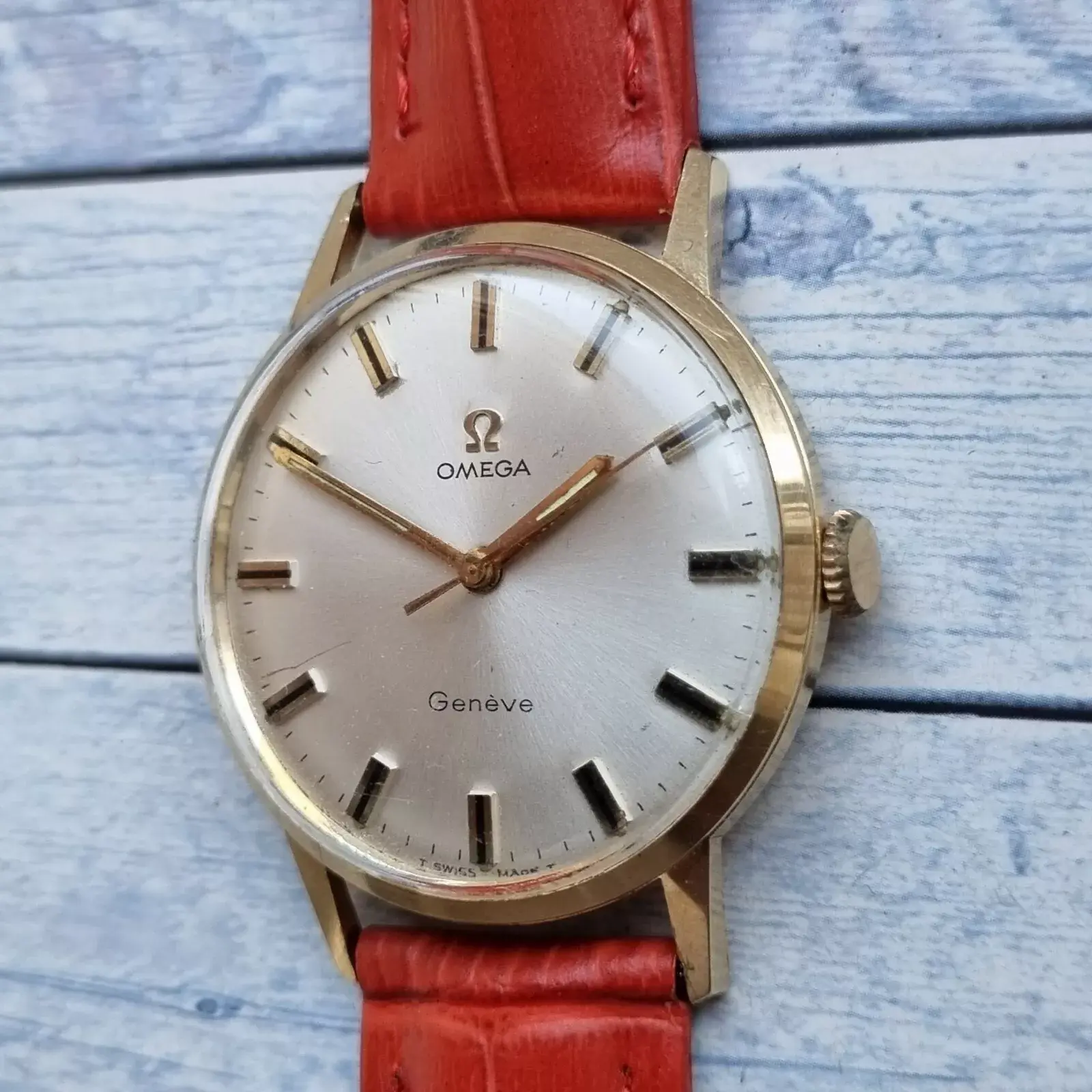

I am not sure if you have seen this one listed on ebay in 18k gold that is as close as the one that belongs to your father with the same type of dial. The other plus is that it is also in the UK (Bristol) and the asking price for the watch would be astronomically cheaper than to get the gold lug and bezel made. Even the case back shows no typical markings indicating it is a locally made case. As a bonus you would also have e the dial and hands with a spare working movement. See if he accepts an offer for an immediate purchase? eBay item number:115748569289 (Disclaimer: this is not my watch that is for sale, nor belongs to anyone I know either from this life, past life including any parallel universe, as the information is purely to help your grief in finding a solution to a similar problem that I have experienced in horological restorations)
