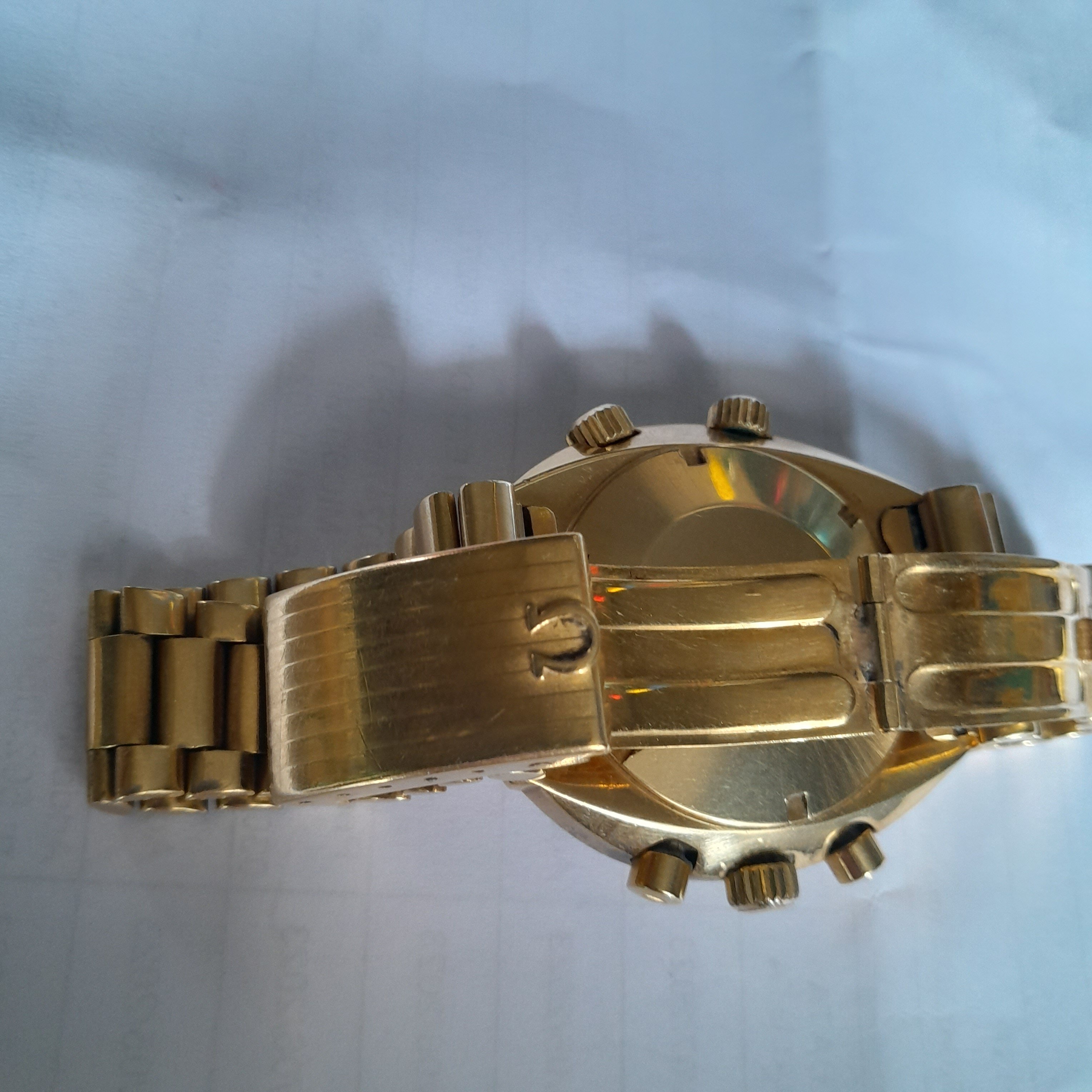

Hello to all. First time posting here with a question on this special timepiece that belongs to my father. This flyghtmaster was gifted to him in the early 1970's while he was working in Switzerland and has not been used in the last 25 years. Given the state that is in, I forsee it would need: a service, a new crystal, maybe new crowns, a couple of gold links of the bracelet that are bent, and the bracelet is a bit loose. In addition, the case has some dents on the lower part below the 6-hour mark. Would it be better to do a restoration of the case? I am debating to have it sent to Omega factory in Bienne or using a company in Milan that specializes in laser relapping. I know it would be more expensive with Omega factory but also they would issue a factory certificate, any thoughts on the work to be done would be appreciated.

perhaps the most sensible course of action is to service it independently with no polishing. Don’t replace anything except gaskets and crystal. Then you can wear the watch and decide how far to go later.
Be very clear with the watchmaker - no polishing and no replacement except movement parts, crystal and gaskets.
these are super rare, and of the very few originally sold, I suspect many were melted.
The last one sold at auction for $52,000 in 2015
https://www.phillips.com/detail/omega/CH080515/243
You might consider polishing it - but there are two sides to this course of action, and many here will have strong opinions on either side. I personally don’t like beaten up gold watches, and others will prefer the unpolished look.
The watch would look much better with the original finish, and so I would consider returning to the factory (not an independent) - working on a gold case is something I would want the factory to do - and yes I would do the case if it were mine. The original finish is done on a lapping machine and not many people have the machine, less have the skills, and even fewer have lots of experience with gold.
Sending it to the factory is giving it a “blessing” as opposed to an independent watchmaker, who however good, risks “cursing” it by polishing it, in terms of future value. However good he is.
Others will demand leaving the case alone and I accept that it may be better to leave it - this is something you have to decide as the owner.
if you are going to sell it, then definitely don’t touch it - every bit of work you do eliminates a group of buyers, so in order to appeal to everyone, leave as is. The pool of potential buyers for this is small enough as it is - let the winner decide what to do. Don’t eliminate the ‘unpolished’ brigade by polishing.
If sending direct to Omega, before you do ask if they have original spec pushers and crown.
I suspect this is a rare enough watch that the right people in omega will pay attention and not mess it up.

Fantastic watch, Personally I would have the case refinished but you can't go wrong heeding to the advice of @Spacefruit.
It would be interesting to see how Omega would price the restoration of the case. It looks like it needs some gold lazer welding in before it is relapped, and with current gold prices that is likely to be incredibly expensive.
Ditto for any additional links.
It looks to have the later type of pushers that were both red/yellow, rather than the early single dot ones used on some .013 models - so possibly something that Omega still have (ditto for crowns) - and given the rarity of the watches when new, I'd suspect theres a reasonable chance that any crowns/pushers are the original designs.
I understand from talking to a couple of dealers that have sold these in recent years, that the typical gold flightmaster buyer (if there is such a person?!) wants a watch in mint condition, and they don't seem to be bothered if its been restored, as long as its been restored by Omega.
Interesting to see one that's clearly been heavily worn... I suspect that's even rarer than the watch itself.

Gold is obviously flying high at the moment, but even so, 1ccm of 18k gold would “only” cost around £550-600. I can’t imagine more would be required to laser weld the case, and I can’t imagine the material costs being more than 1/4 of the final bill.

Pay close heed to the pusher situation as per @tyrantlizardrex said - he is more in tune with FM’s than many.
what I would say is really investigate the pusher situation and make sure you get replacements that are correct, or deemed correct by collectors - (not authors). And omega might just be the place to provide them.

BTW restoring a flightmaster case is something I would not suggest. Shape is definitely going to be modified. In my experience there are some details that cannot be redone and will be always spotted by a trained eye.
305
229
Even I agree, that the watch should stay unrestored, I must admit, that if you combine skills, welding and radial brushing, It can fool even trained eye 😀
As the micro welding is/was not very common, most of the examples are just overbrushed, to hide the dents.
If the owner is interested in restoration of the case, can PM me. But as I repeat, I would keep it as is, until the owner is 100% sure, that he would keep it for himself and wanted it restored.
Here are the pushers:
https://www.ebay.co.uk/itm/39237801...f/S9UIjt6Io/SzByWXzApv70AH|tkp:Bk9SR8iN3uveYg

Thanks for your post. There are a couple of external links on the bracelet that are a bit squeezed. Do you think they can be restored and is advisable to straighten up the bracelet to its original condition?
305
229
Hi, as it is massive gold, I can imagine to have the links open, reshaped and closed again. Hard to do on steel, but easier on gold. Please make more close up pictures of the dented bracelet from more angles. I will re-send it to my fellow jeweler and Omega trained service man. I can also ask him, what parts are available for this reference, as he has got access to Omega extranet, including prices.
