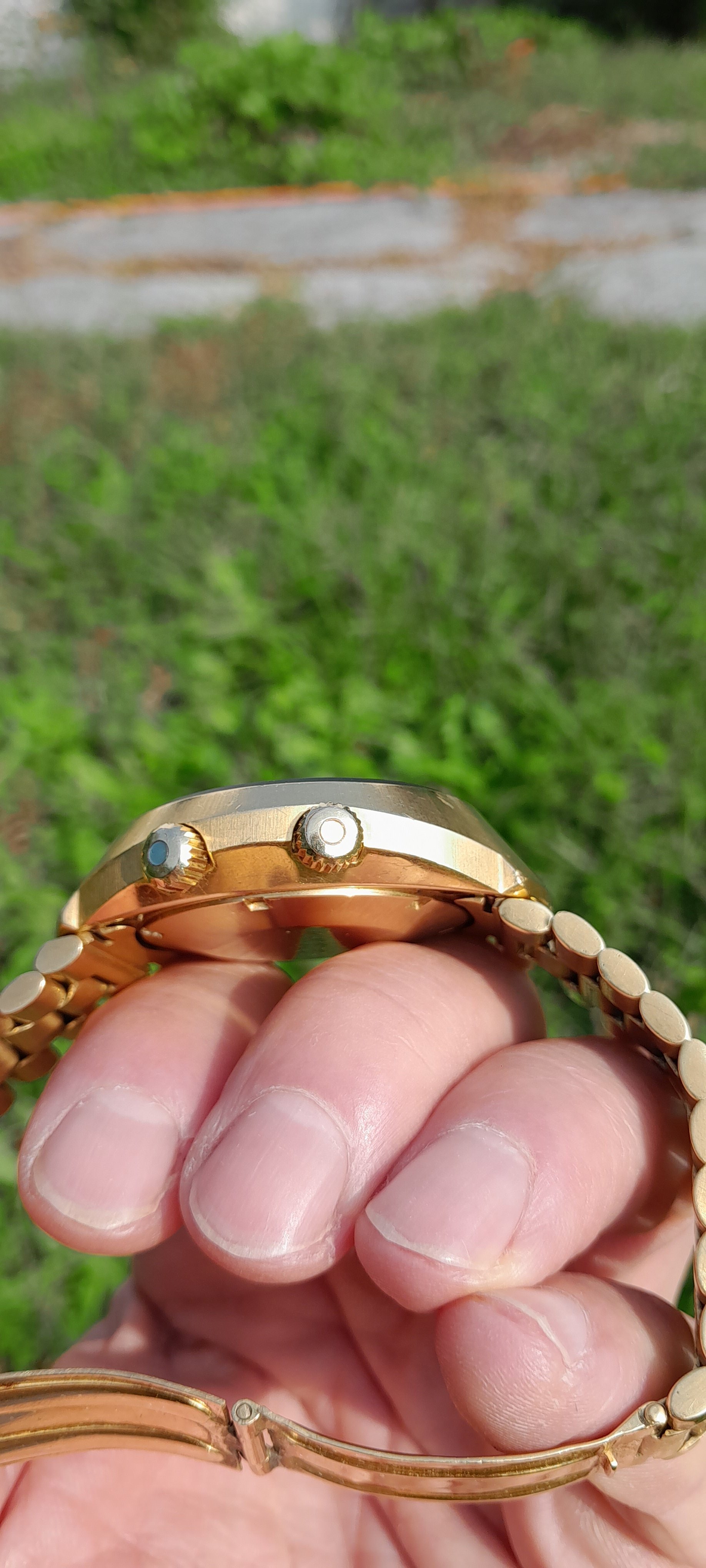

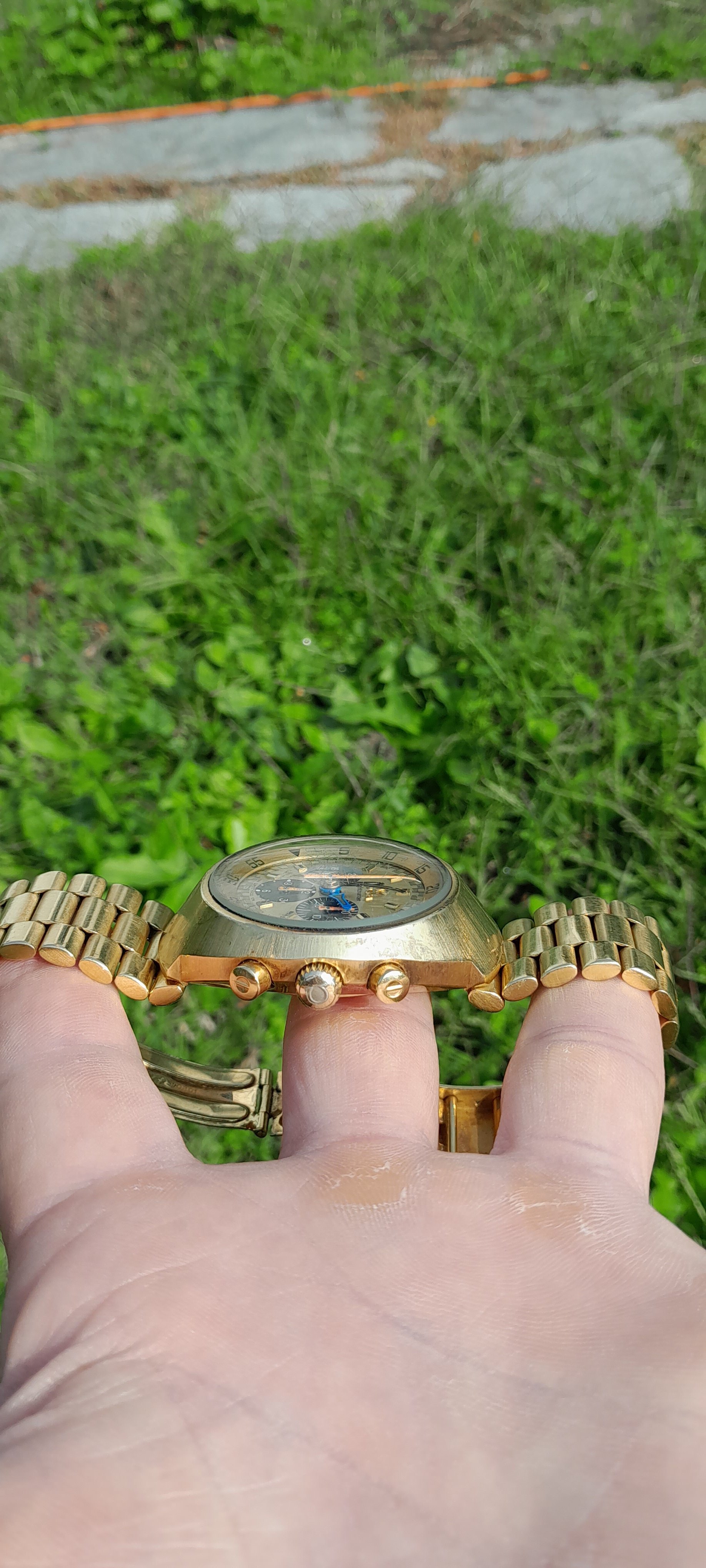

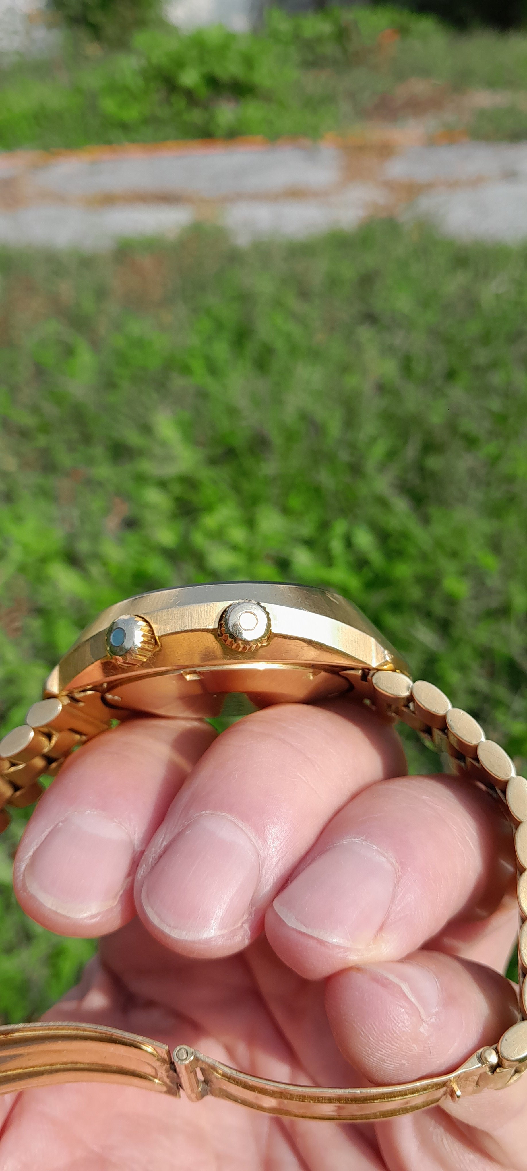

It looks to have the later type of pushers that were both red/yellow, rather than the early single dot ones used on some .013 models - so possibly something that Omega still have (ditto for crowns) - and given the rarity of the watches when new, I'd suspect theres a reasonable chance that any crowns/pushers are the original designs.
are you saying the pushers are wrong, or just worth to restore or replace due to the missing color? If second, isnt this an easy "paint job"?

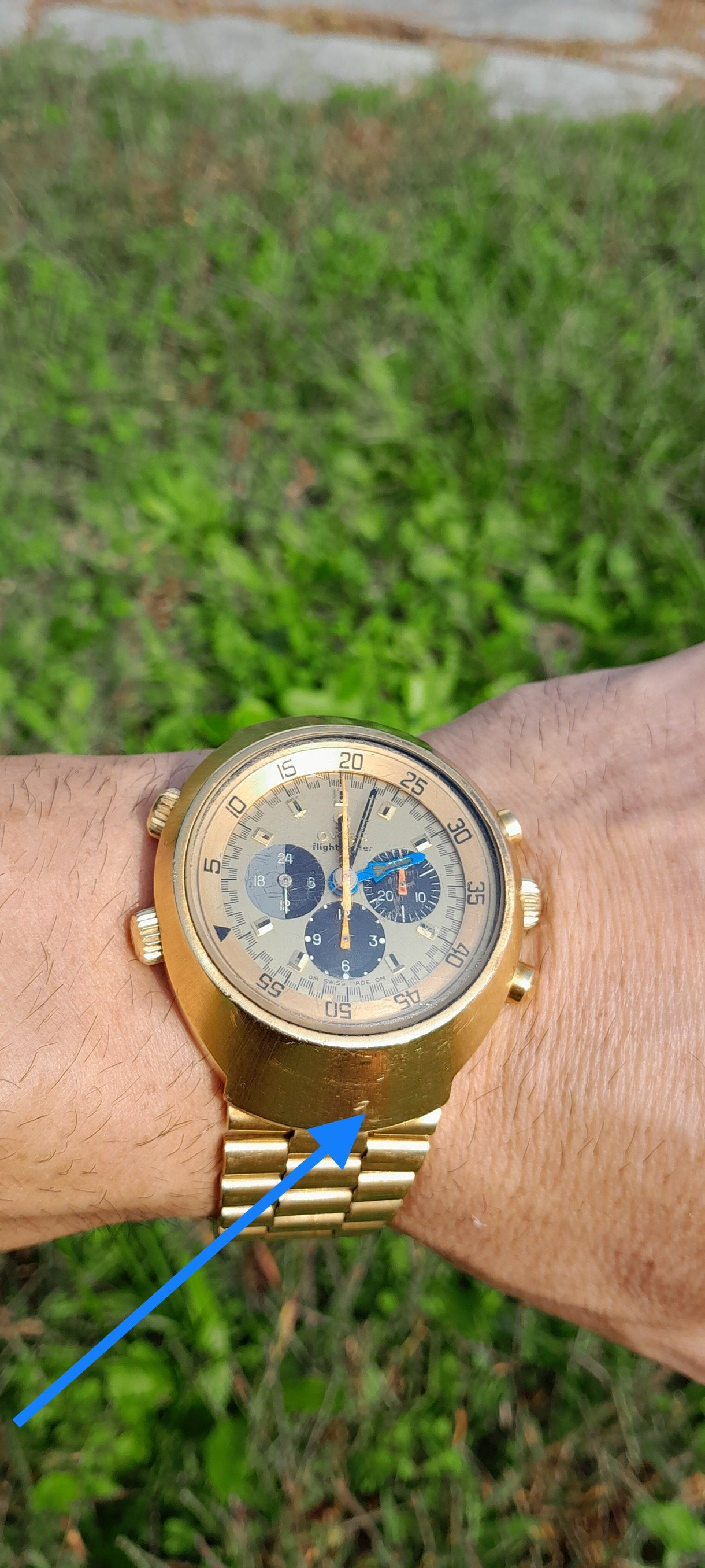

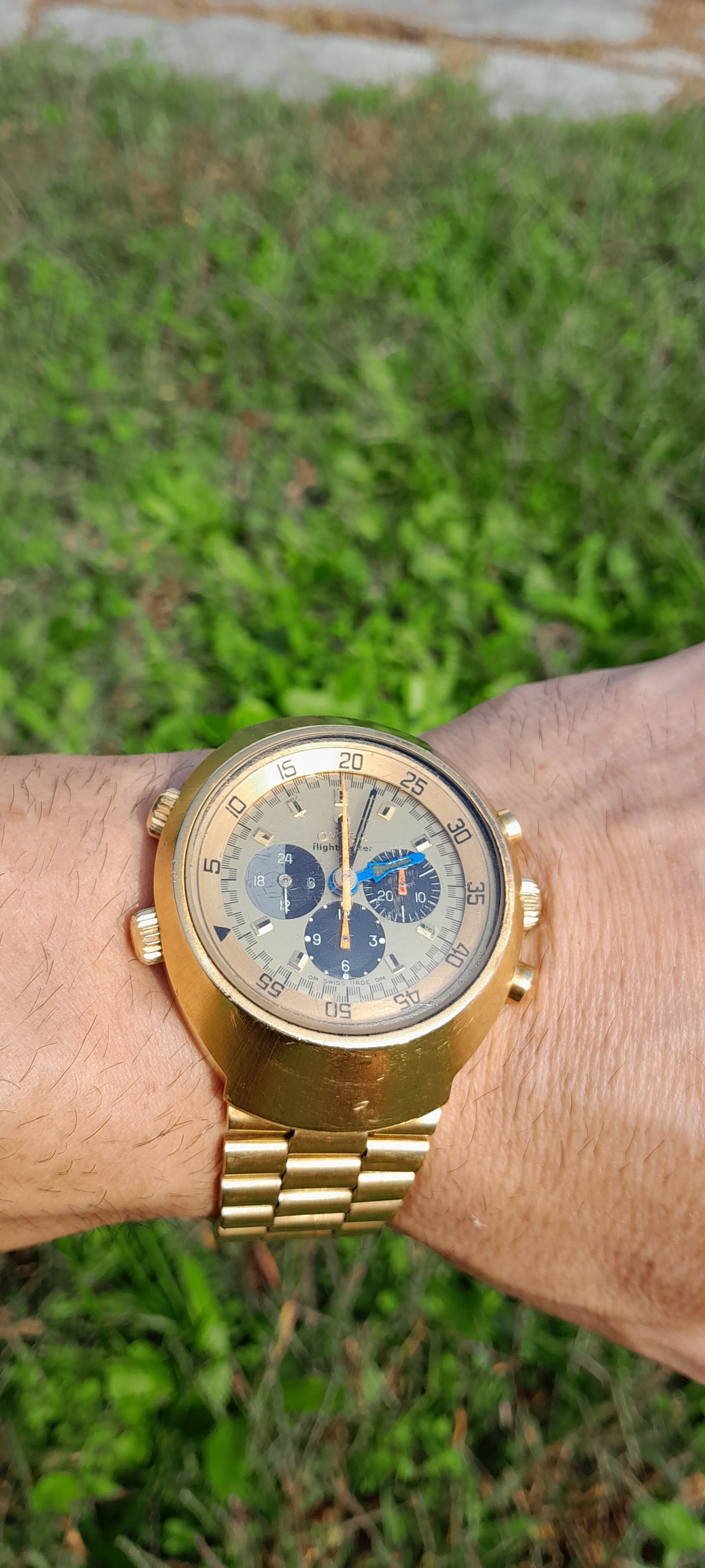

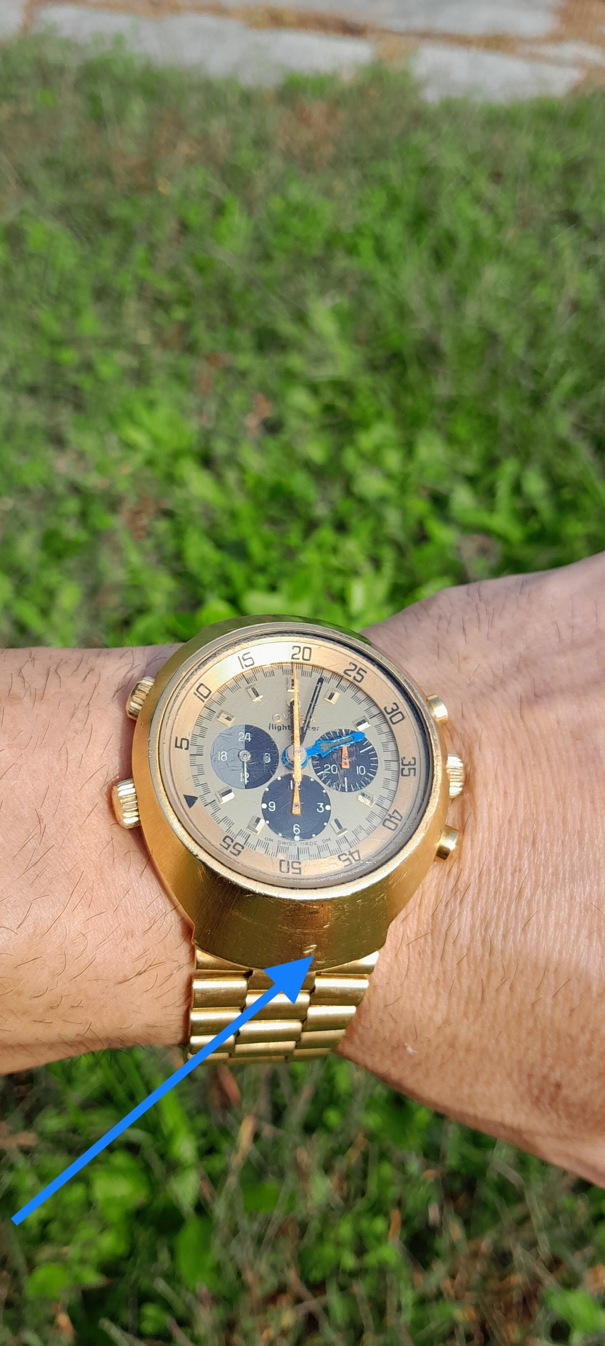

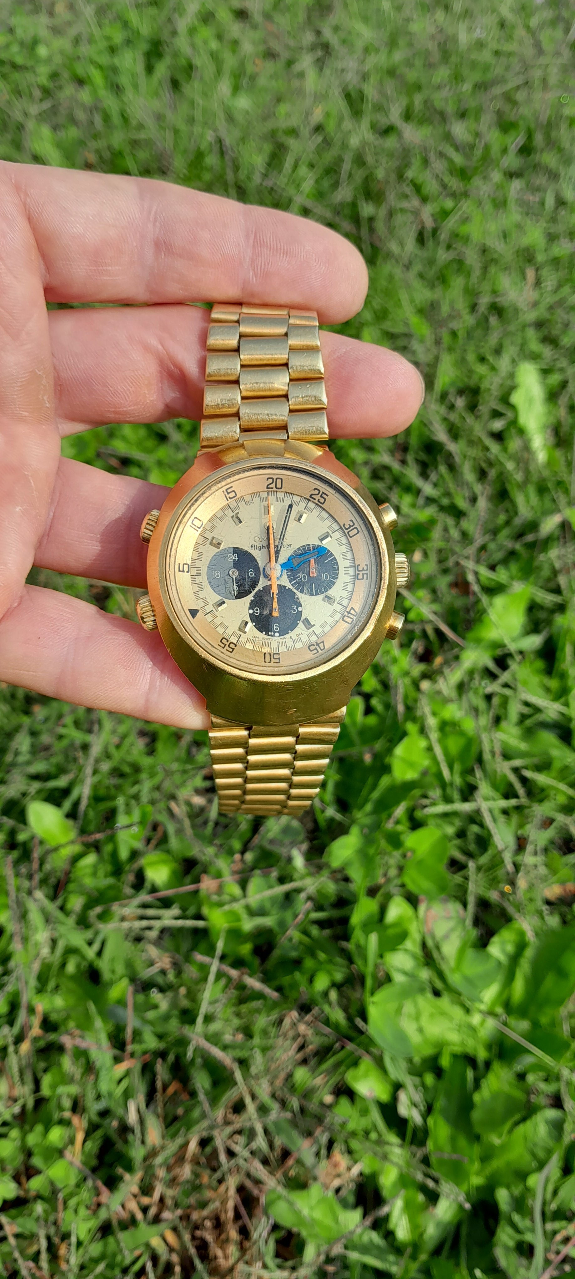

I apologize my cheap phone doesn't t have a good camera😉

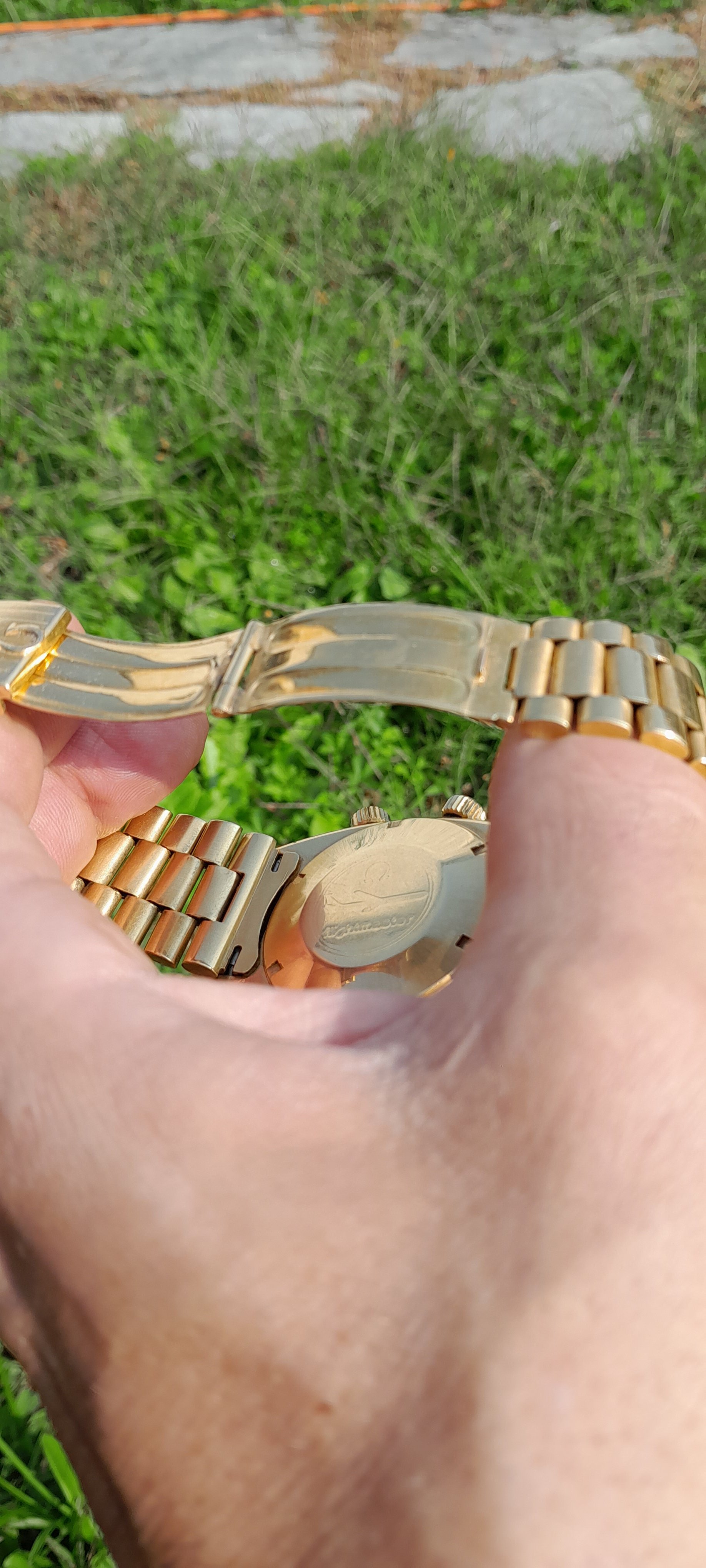

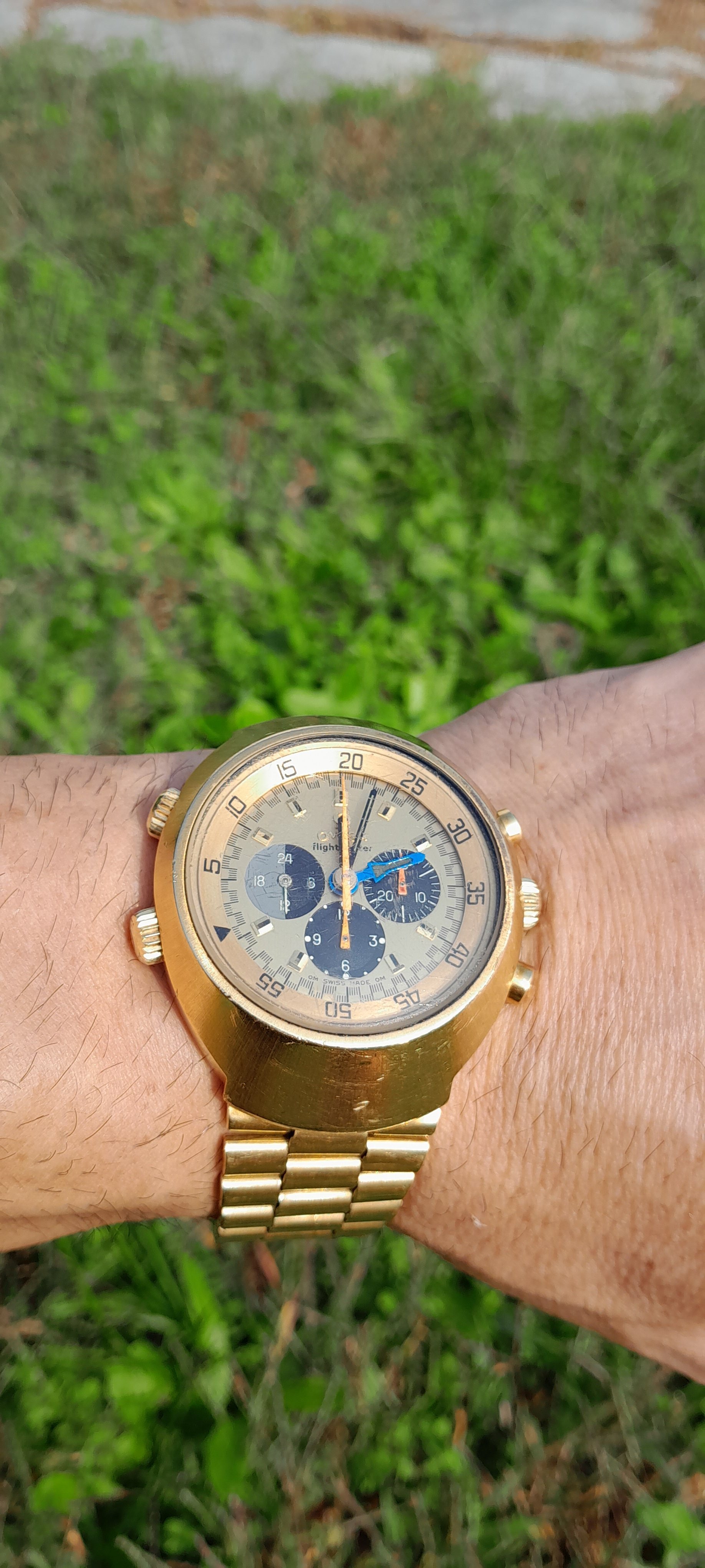

Andy, that case does not look bad at all. You have it restored and this ding… will happen again. Thank you for the extra photos. Caseback looks good too.

yeah it still has enough original finish for me, leave it alone IMO

It is a dream watch for me. I would not touch the case. Pushers are also ok, they only lost the paint. A good watchmaker can restore it.
😀Thank you, also the crystal is not heavily scratched, and don't think needs to be changed. Maybe it can be refinished?

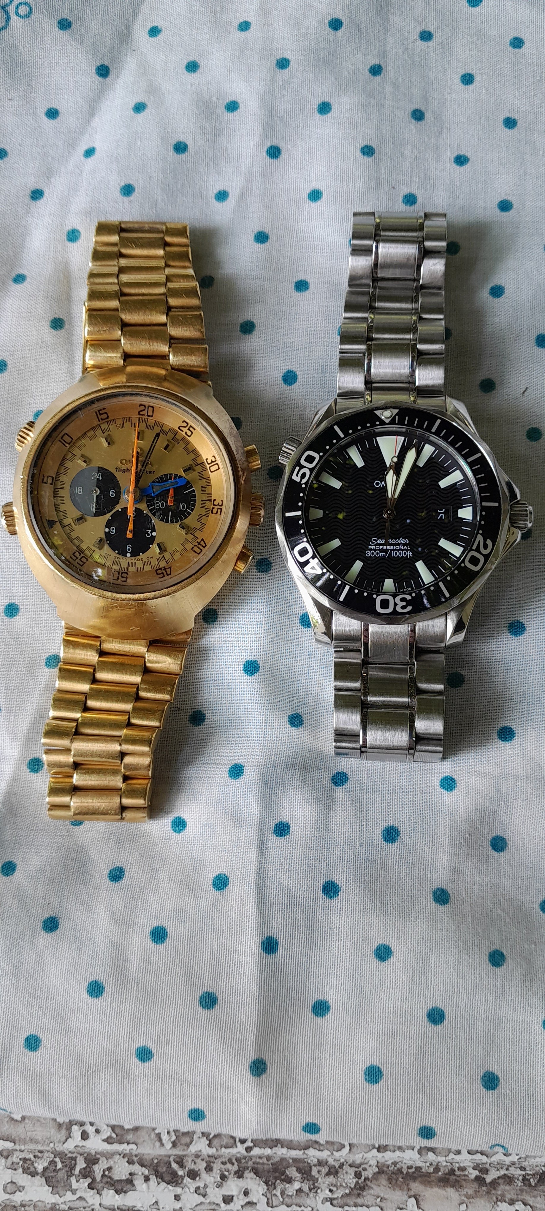

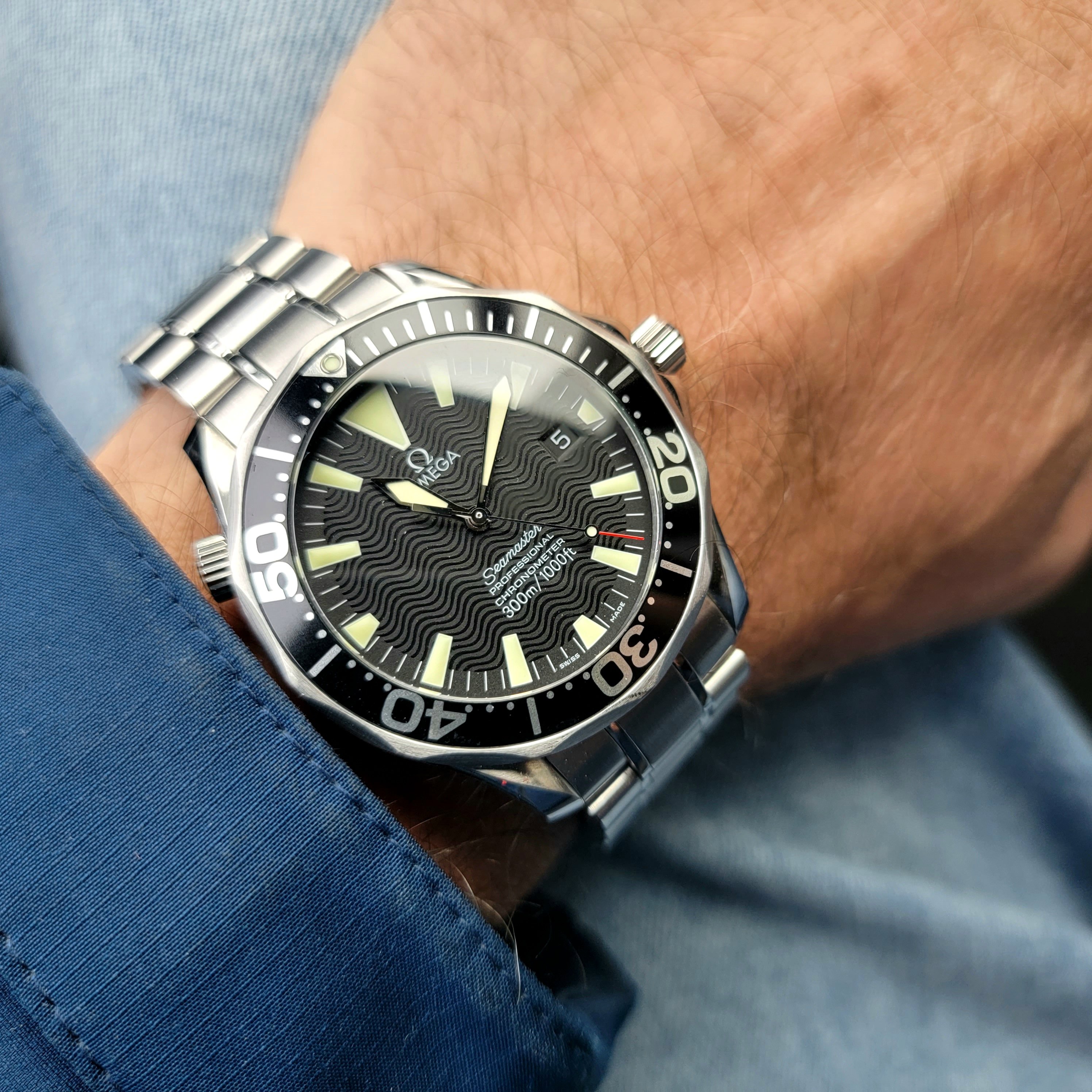

Ps your other watch isn't bad either...

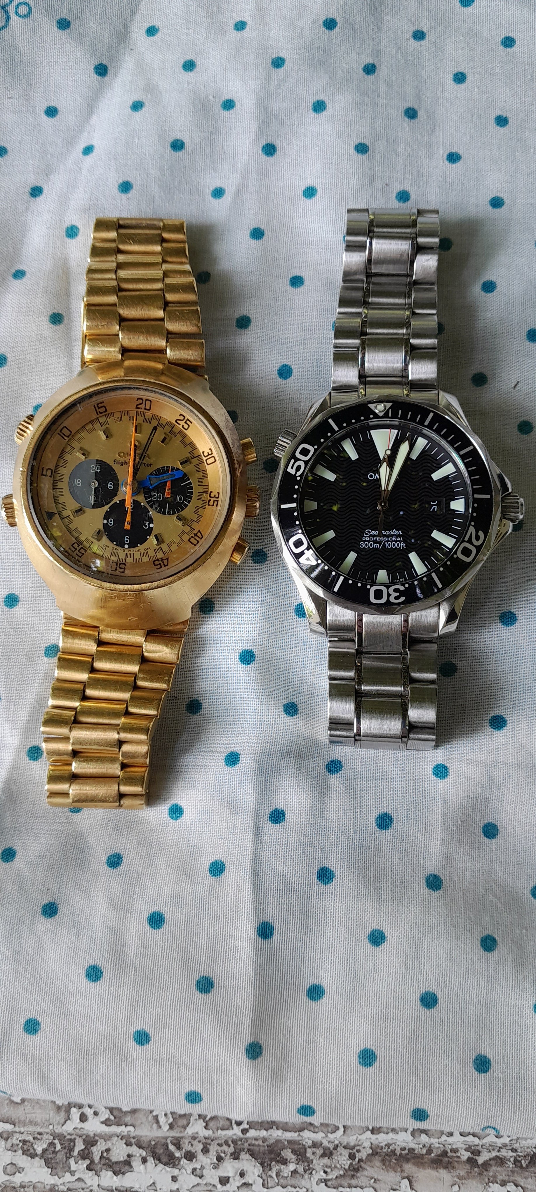

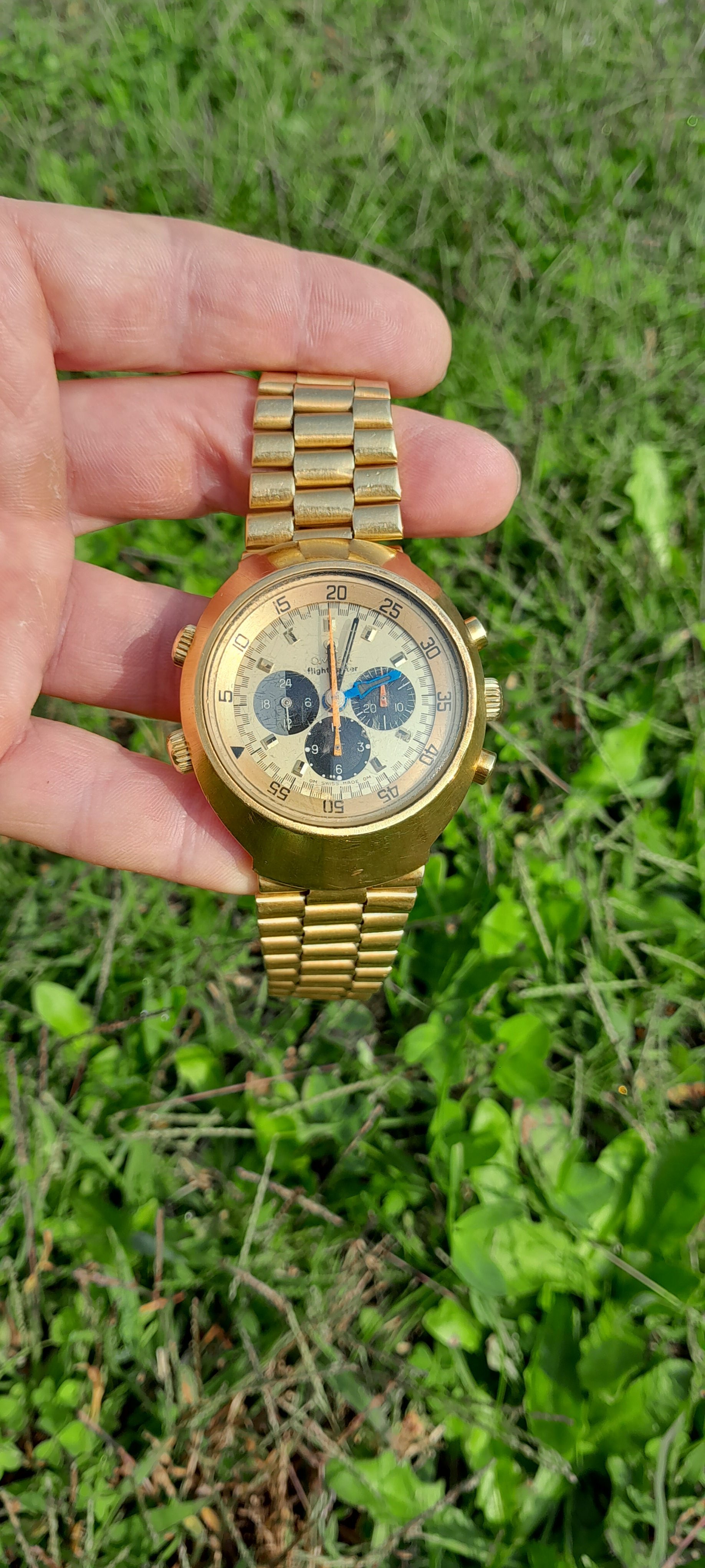

Hello to all. First time posting here with a question on this special timepiece that belongs to my father. This flyghtmaster was gifted to him in the early 1970's while he was working in Switzerland and has not been used in the last 25 years. Given the state that is in, I forsee it would need: a service, a new crystal, maybe new crowns, a couple of gold links of the bracelet that are bent, and the bracelet is a bit loose. In addition, the case has some dents on the lower part below the 6-hour mark. Would it be better to do a restoration of the case? I am debating to have it sent to Omega factory in Bienne or using a company in Milan that specializes in laser relapping. I know it would be more expensive with Omega factory but also they would issue a factory certificate, any thoughts on the work to be done would be appreciated.
I'm saying that they look like the original pushers. And that the service parts will look the same (they don't offer the single colour versions).
Given I like to wear my flightmasters, I've always had the pushers replaced, so that are dust/water resistant... I have yet to catch the insanity of the Speedmaster "don't make it usable, you'll affect the perceived value" gang.
