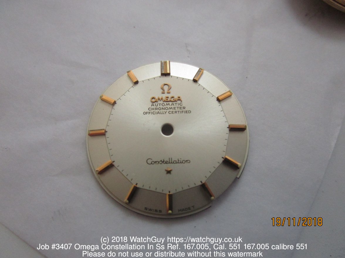

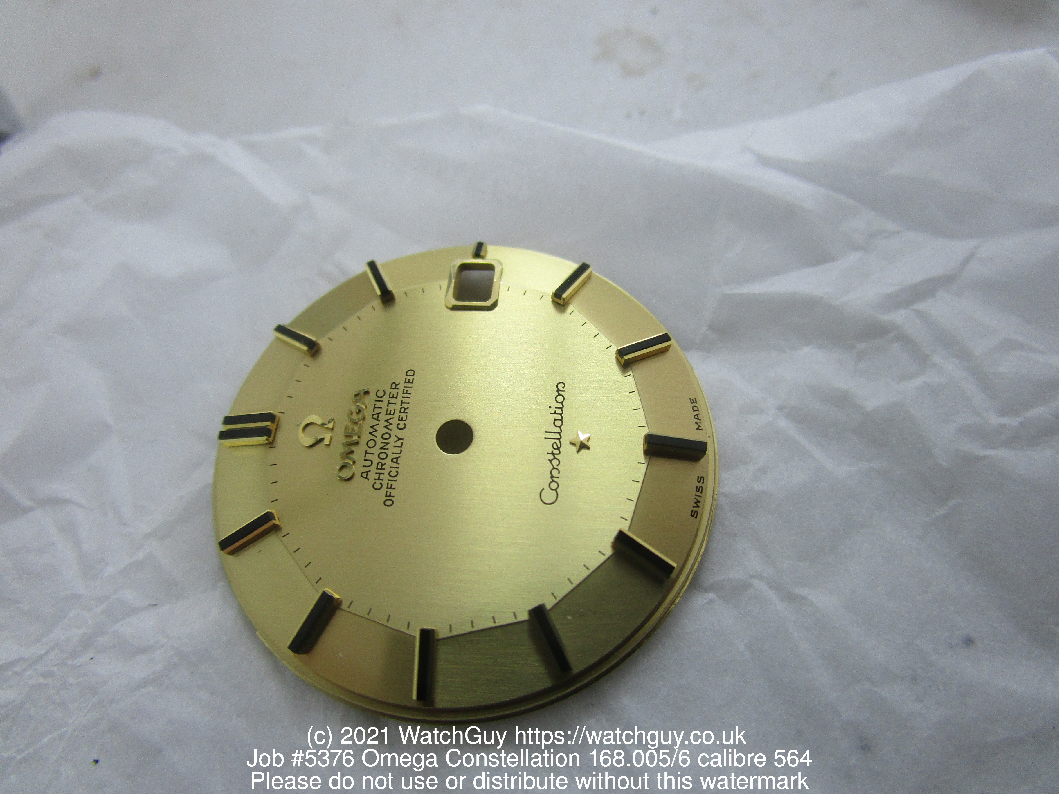

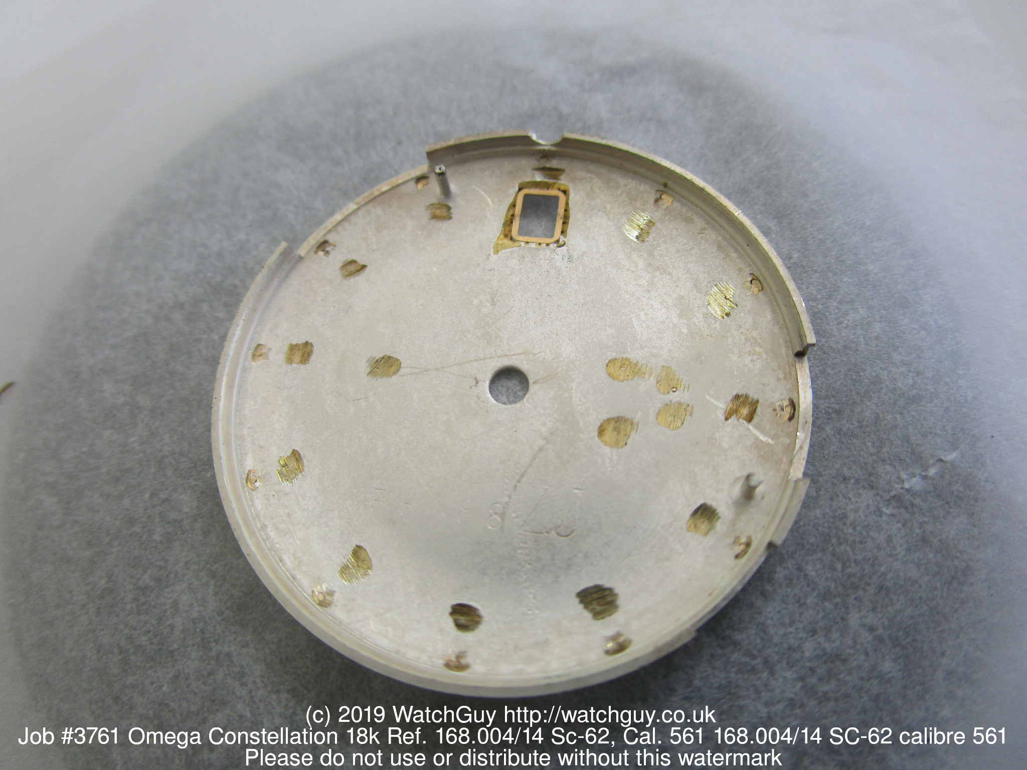

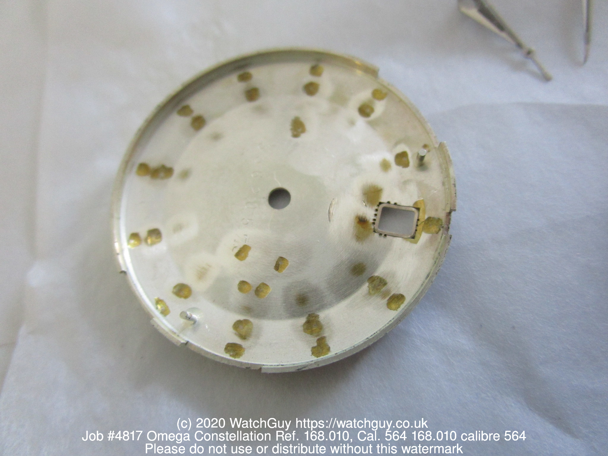

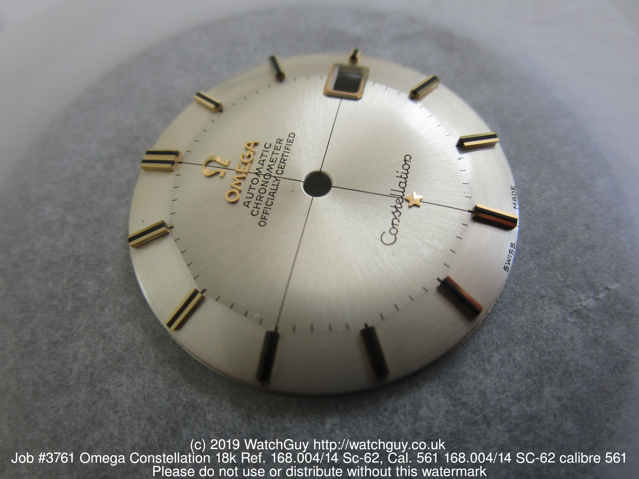

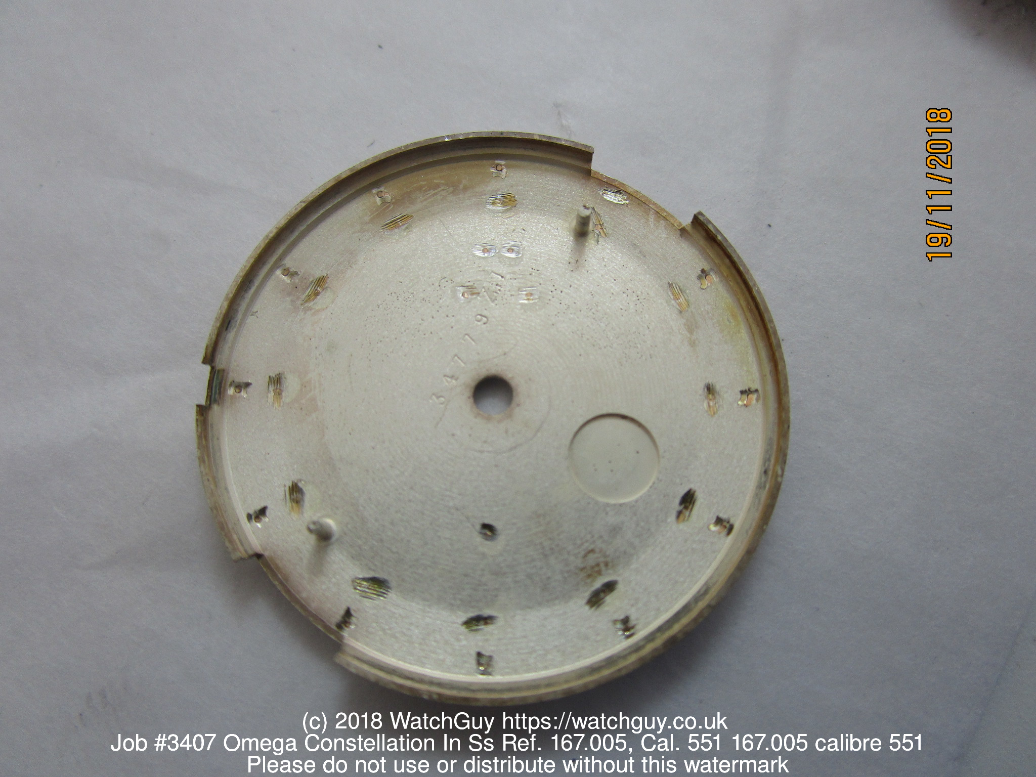

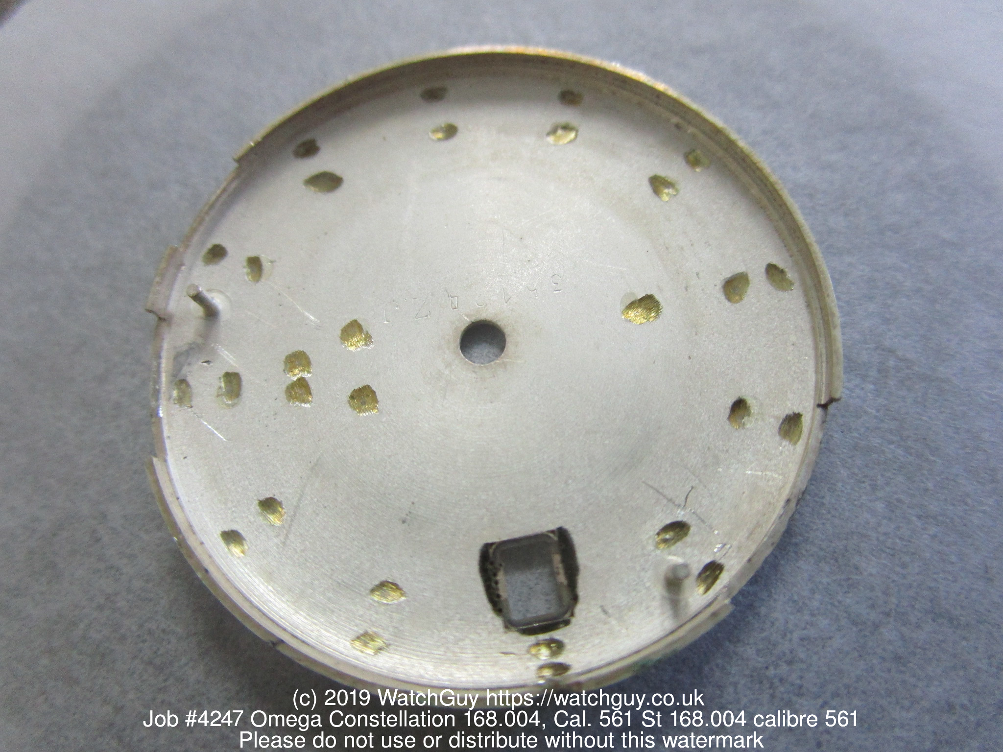

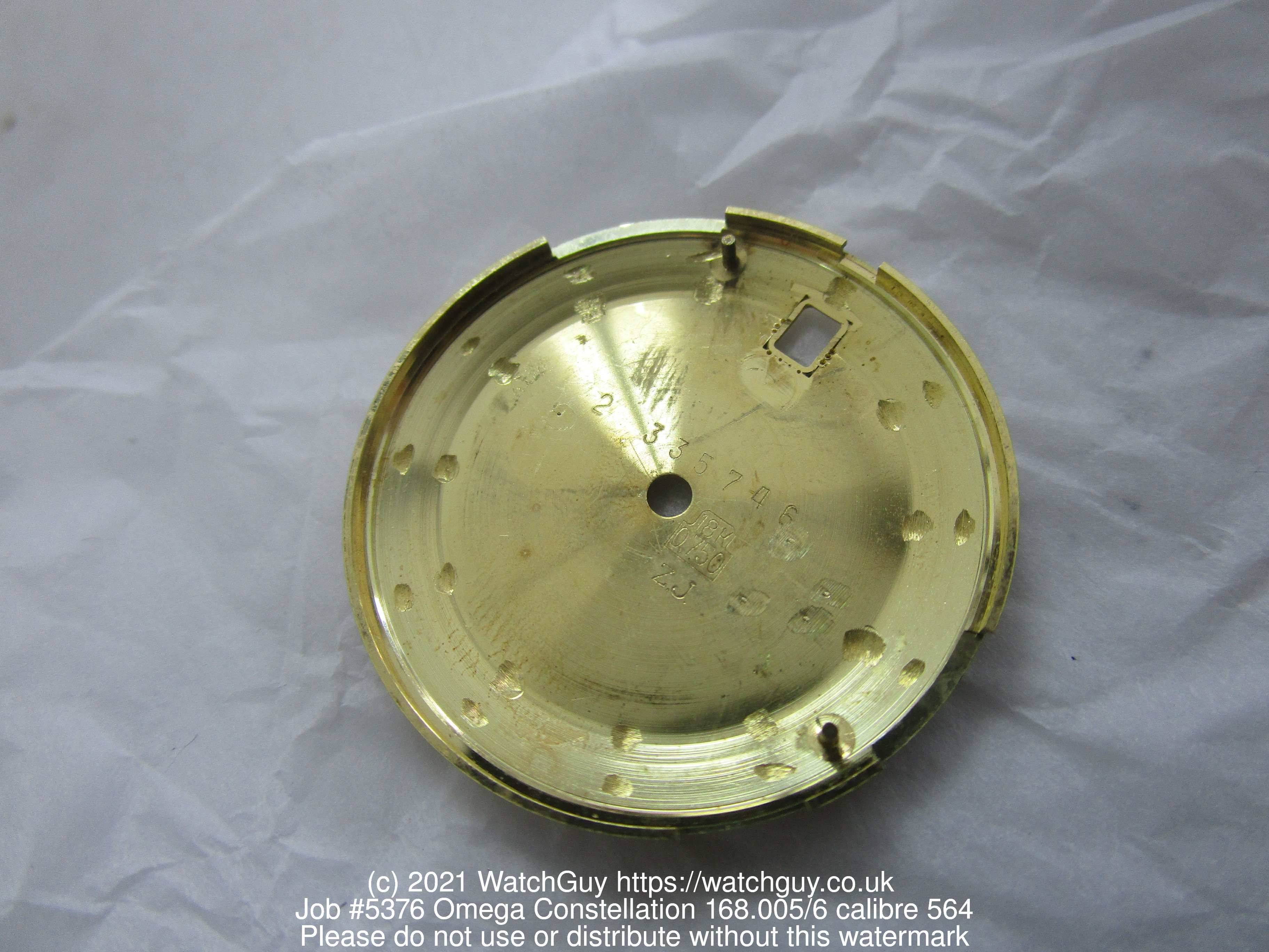

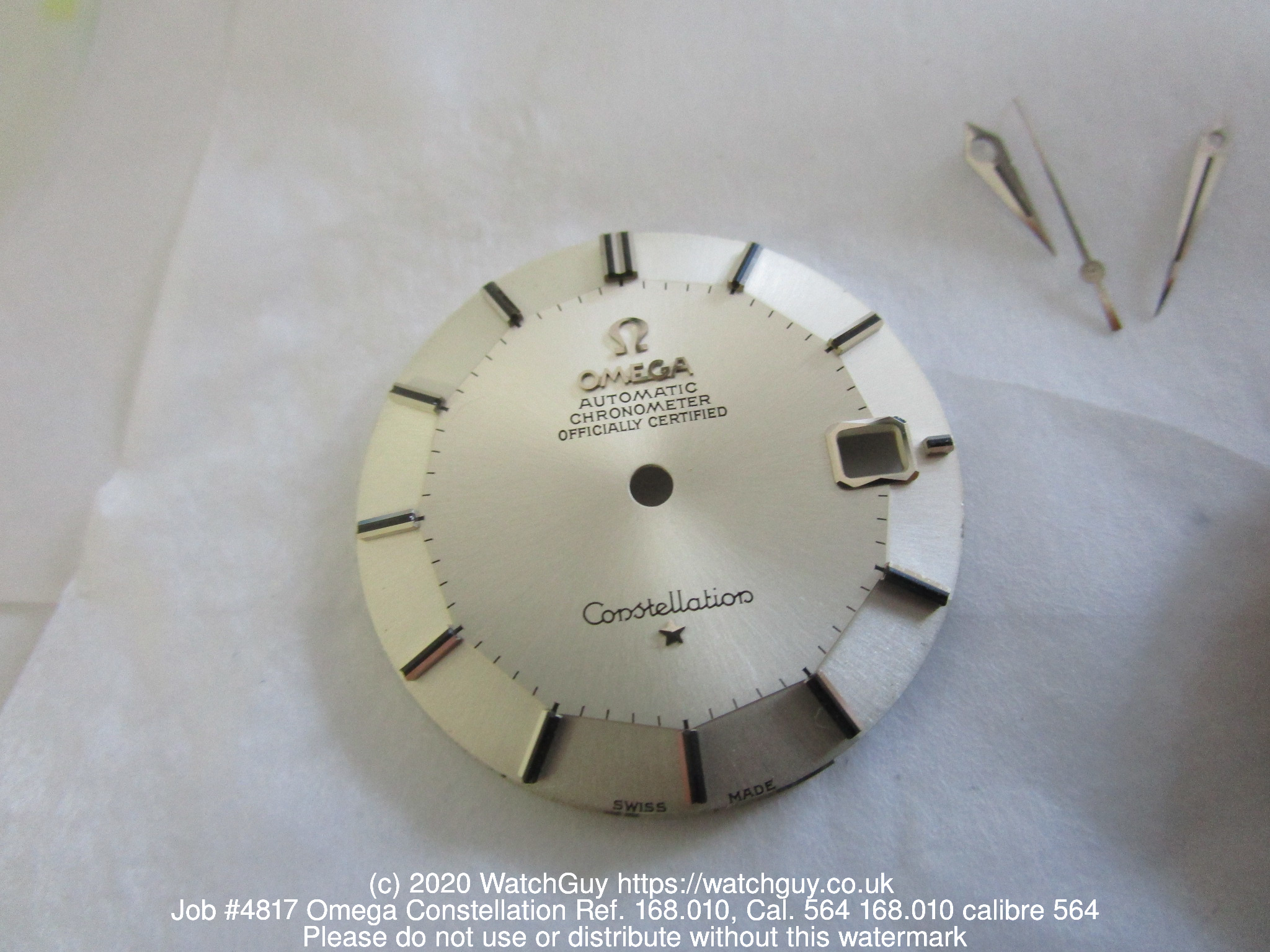

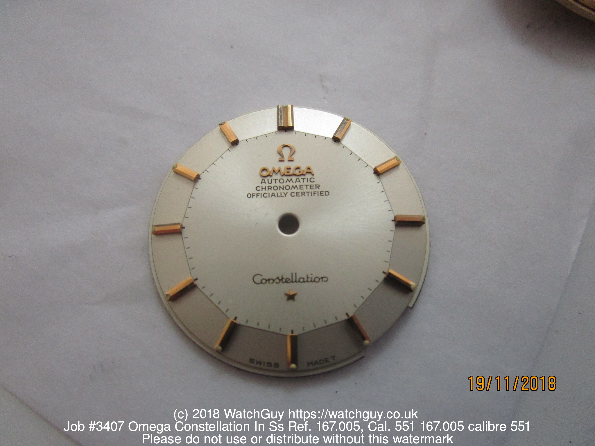

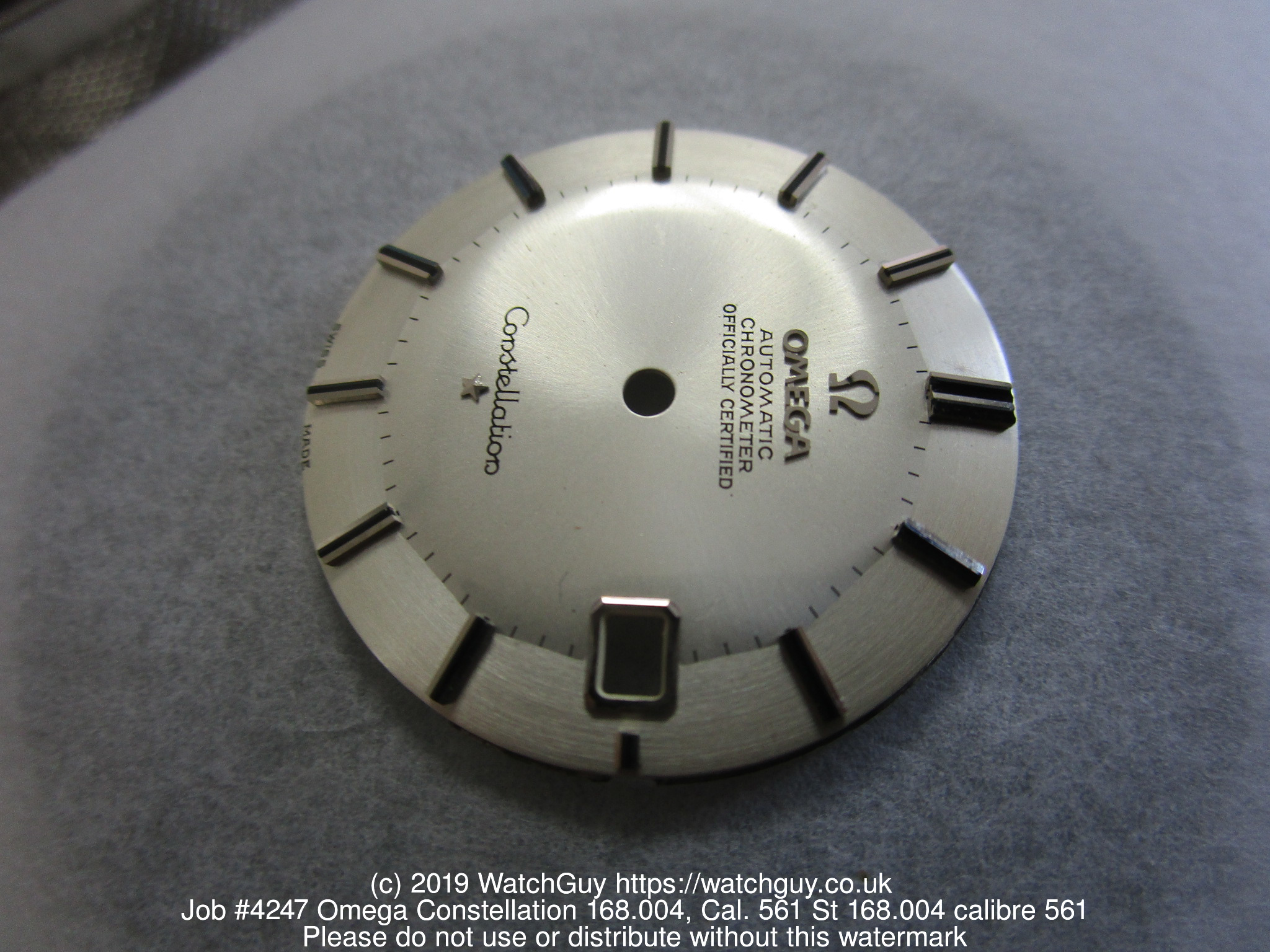

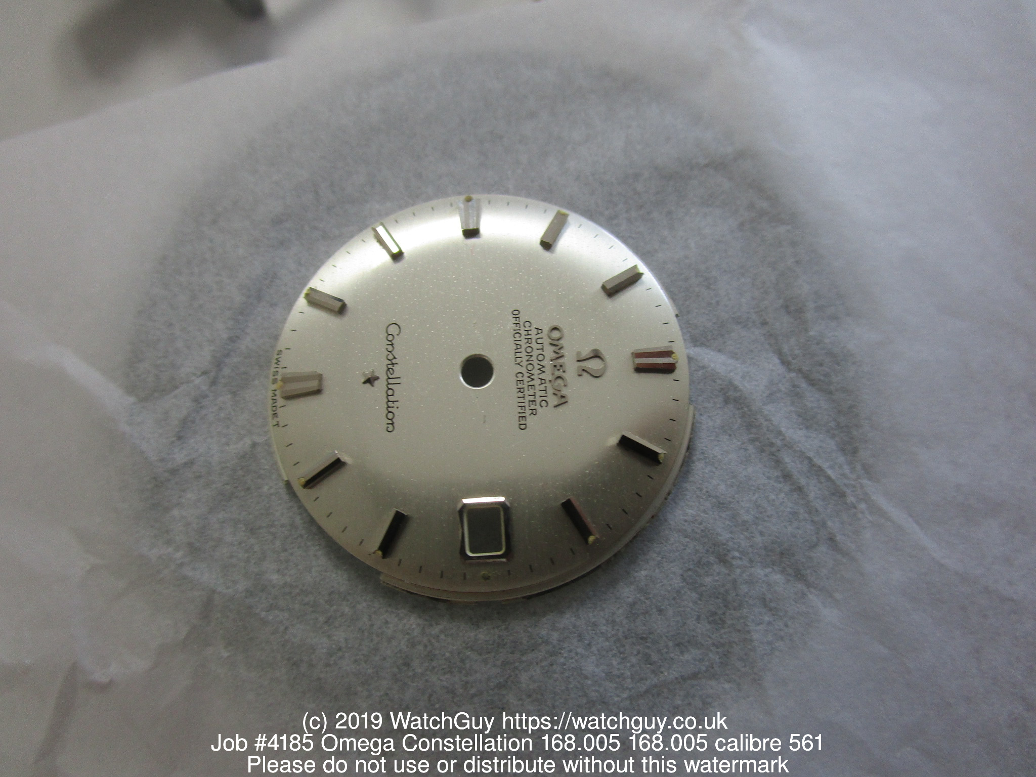

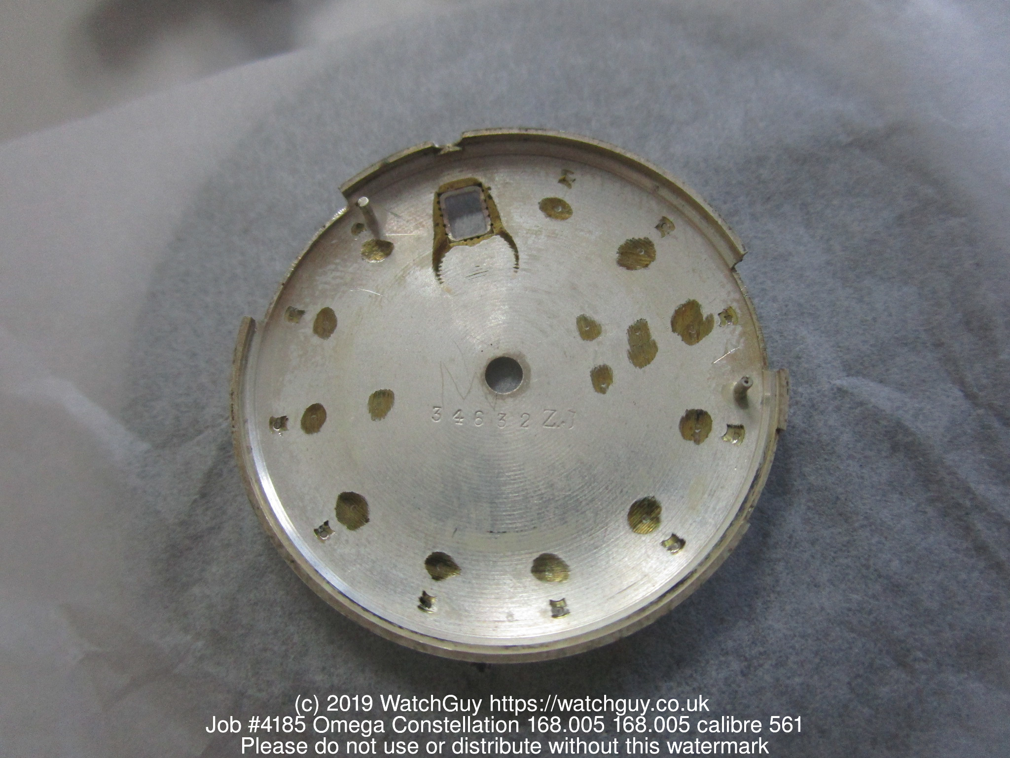

I have in my posession all versions, and all were serviced by Johannes at Watchguy, who is always kind enough to take copious pictures of the dial, back and front, so here goes:
First are two, as I would call them, "soft pie pan" 168.004:
No 1 front:
No 1 back:
No 2 front:
No 2 back:
And for comparison
a 168.010:
a 167.005:
and a 18k 168.006 which is even more pronounced:
And finally a run-of-the-mill dome dial 168.005 (it's the one mentioned above, previously of Davidt's):
So, in conclusion, looks to me that we are dealing more with trompe l'oeils than not with those 168.004 ...
Splendid!
A definite 10 out of 10 for illustration of the different types of dial.
So, now we know - trompe l'oeil it is.
And 'faux pie pan' it will be in my vocabulary from now on

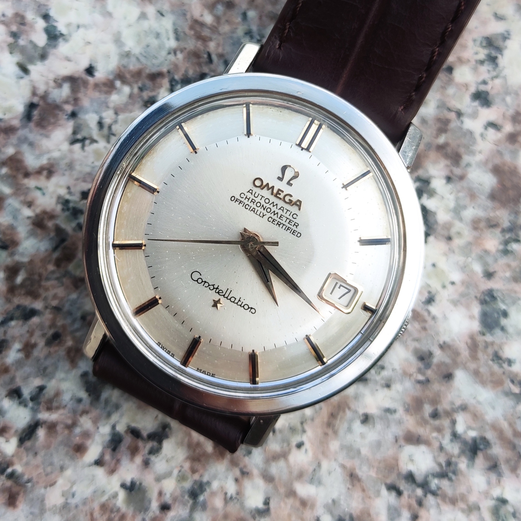

Really cool discussion guys -- already feel much smarter than yesterday 😀. Let me know if better to start a new thread, but thoughts on this one on Chrono24? Is it a redail? It maybe looks over-polished?
-REF 168.010
-$2160 USD

how did you tell a redial ?
Bad printing, wrong position of minute markers, etc. Takes experience.
9
10
The first one is a fair bit overpriced and the second is a redial.

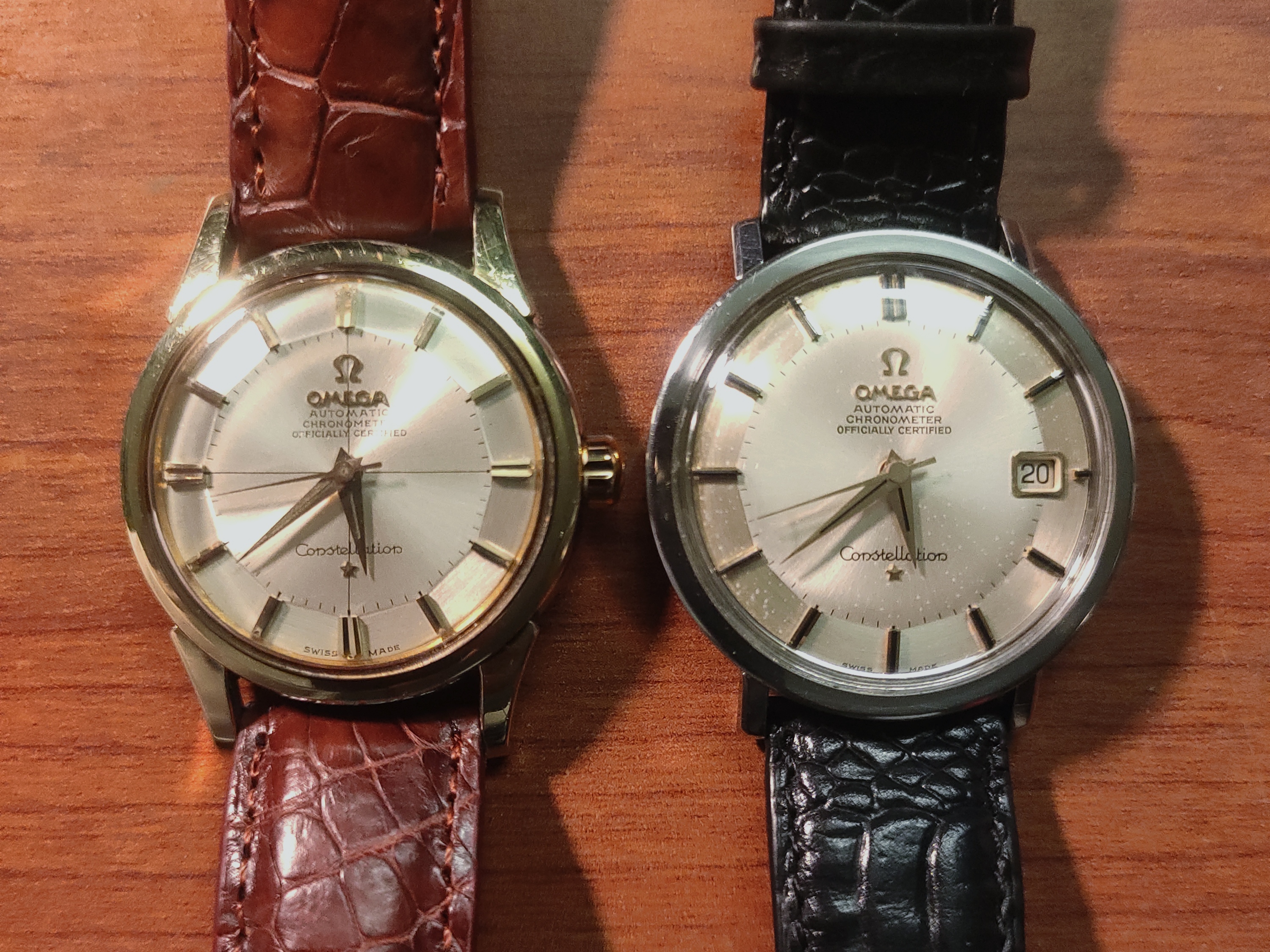

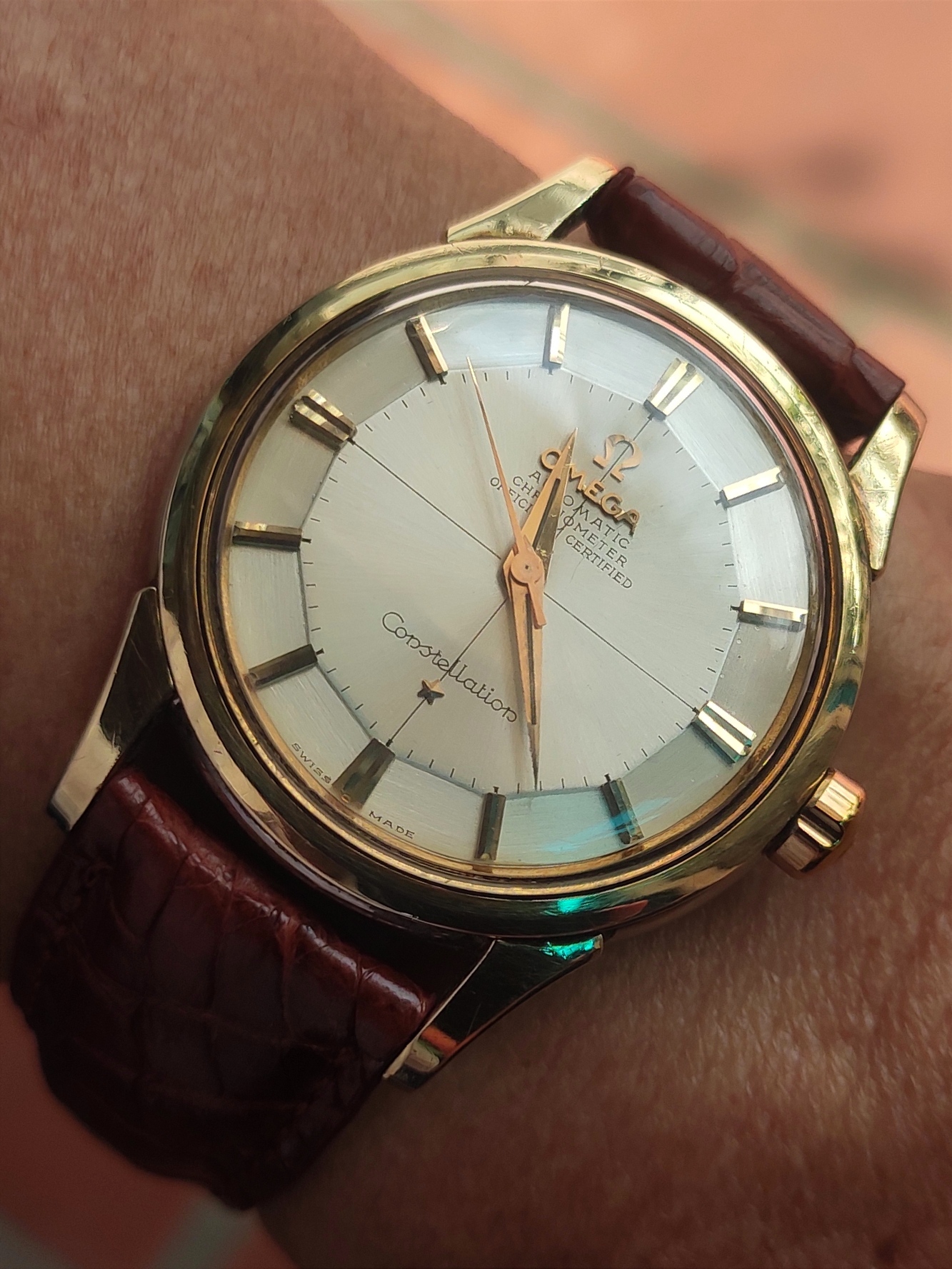

My humble contribution to the discussion (bringing water to yoit mill)
Left: 14381 ref. Right: 168.004.
In real life these dials are similar, at least to me 😉
