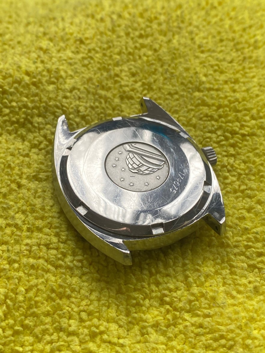

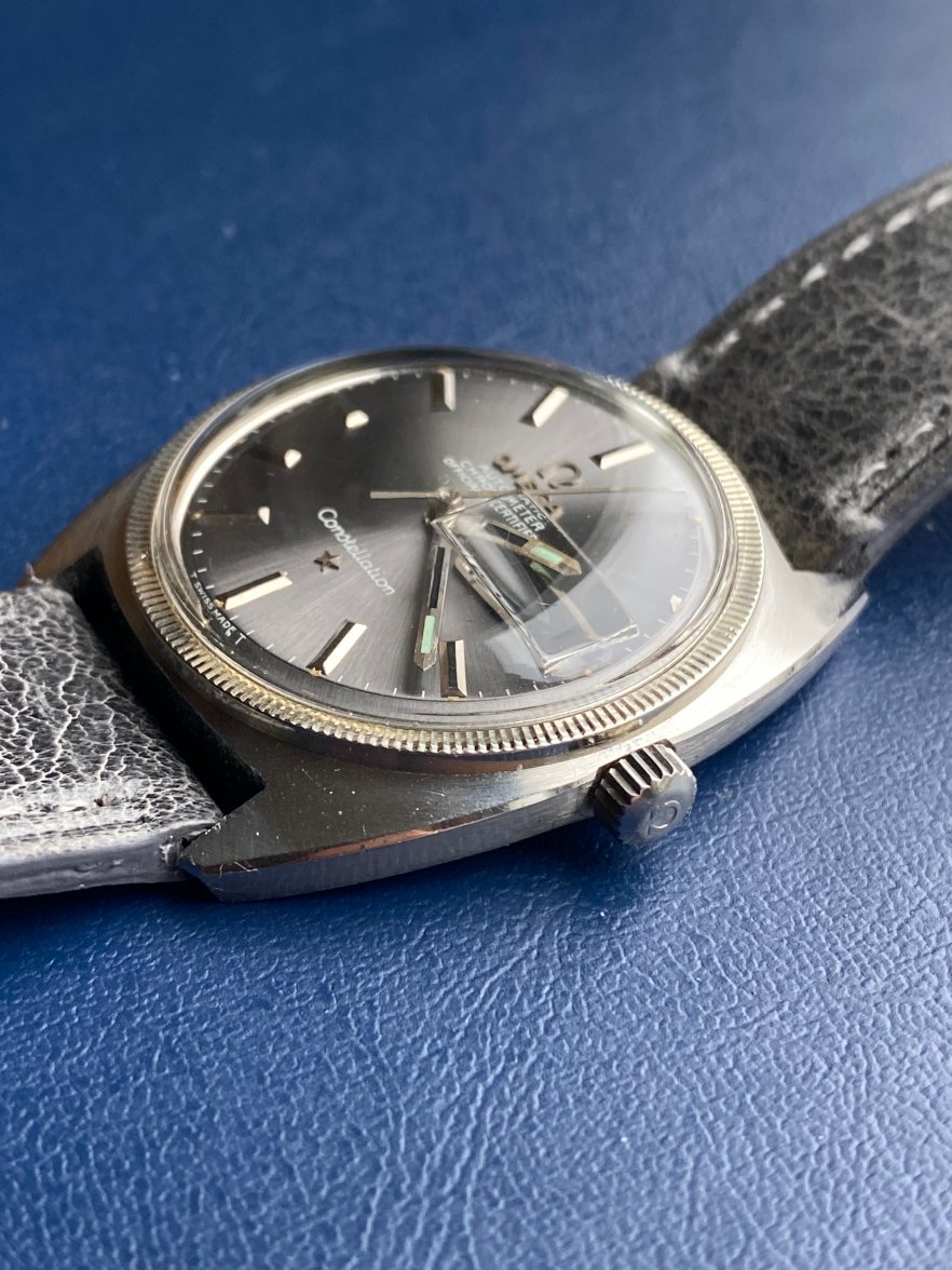

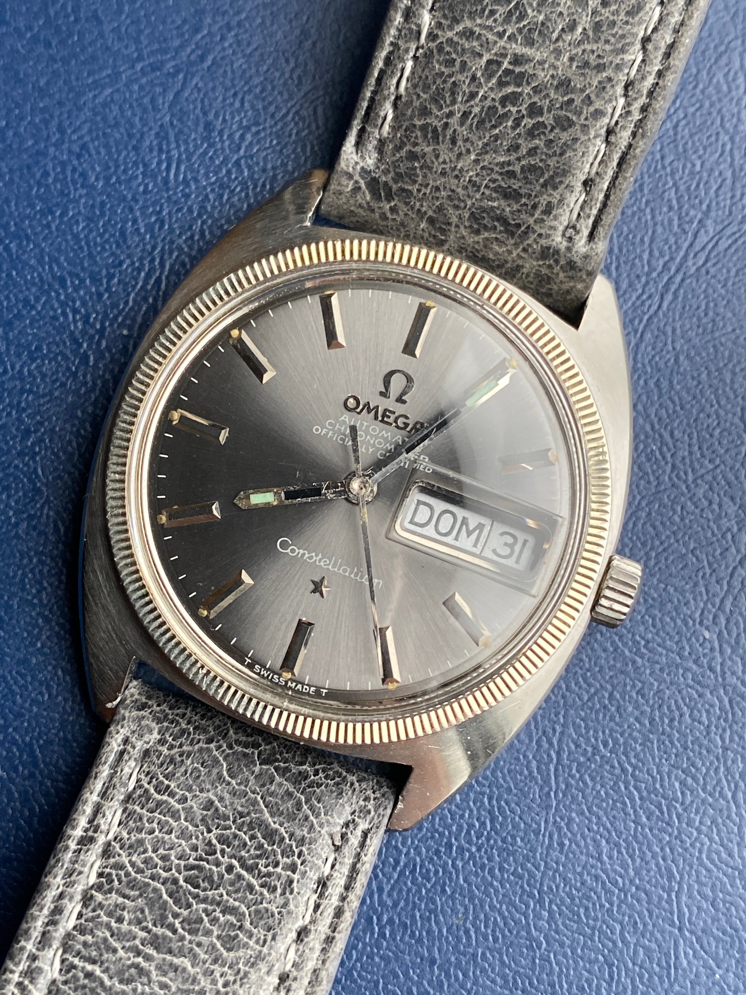

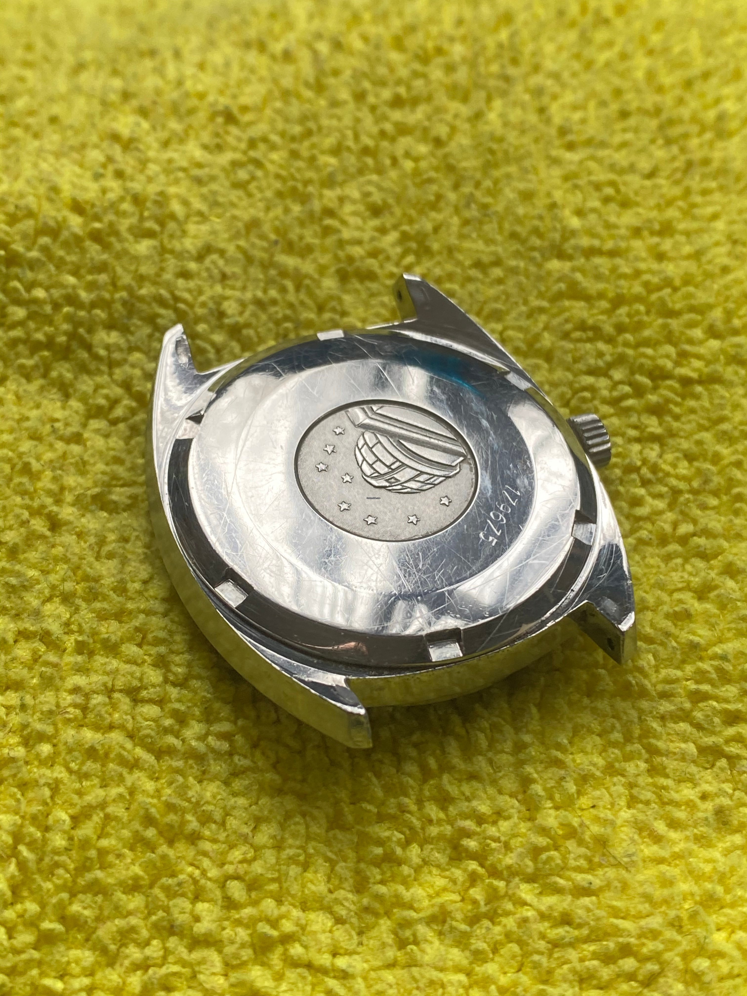

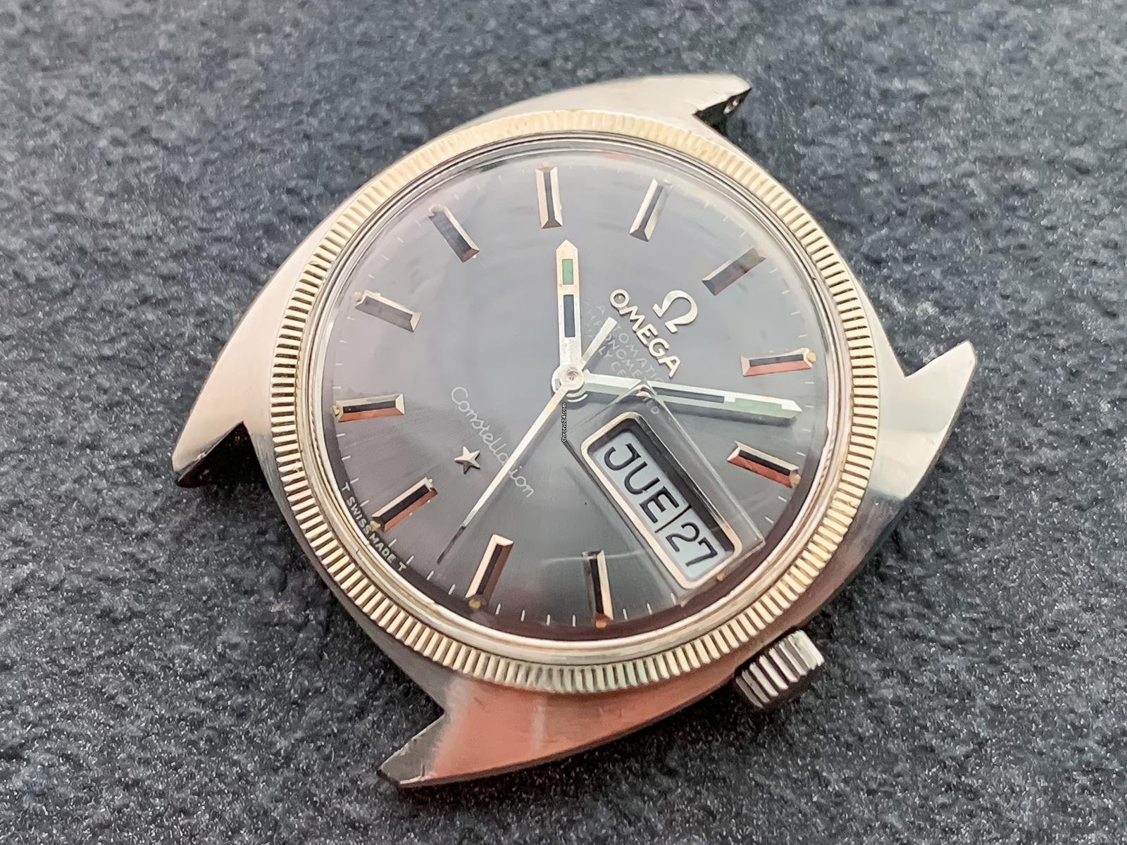

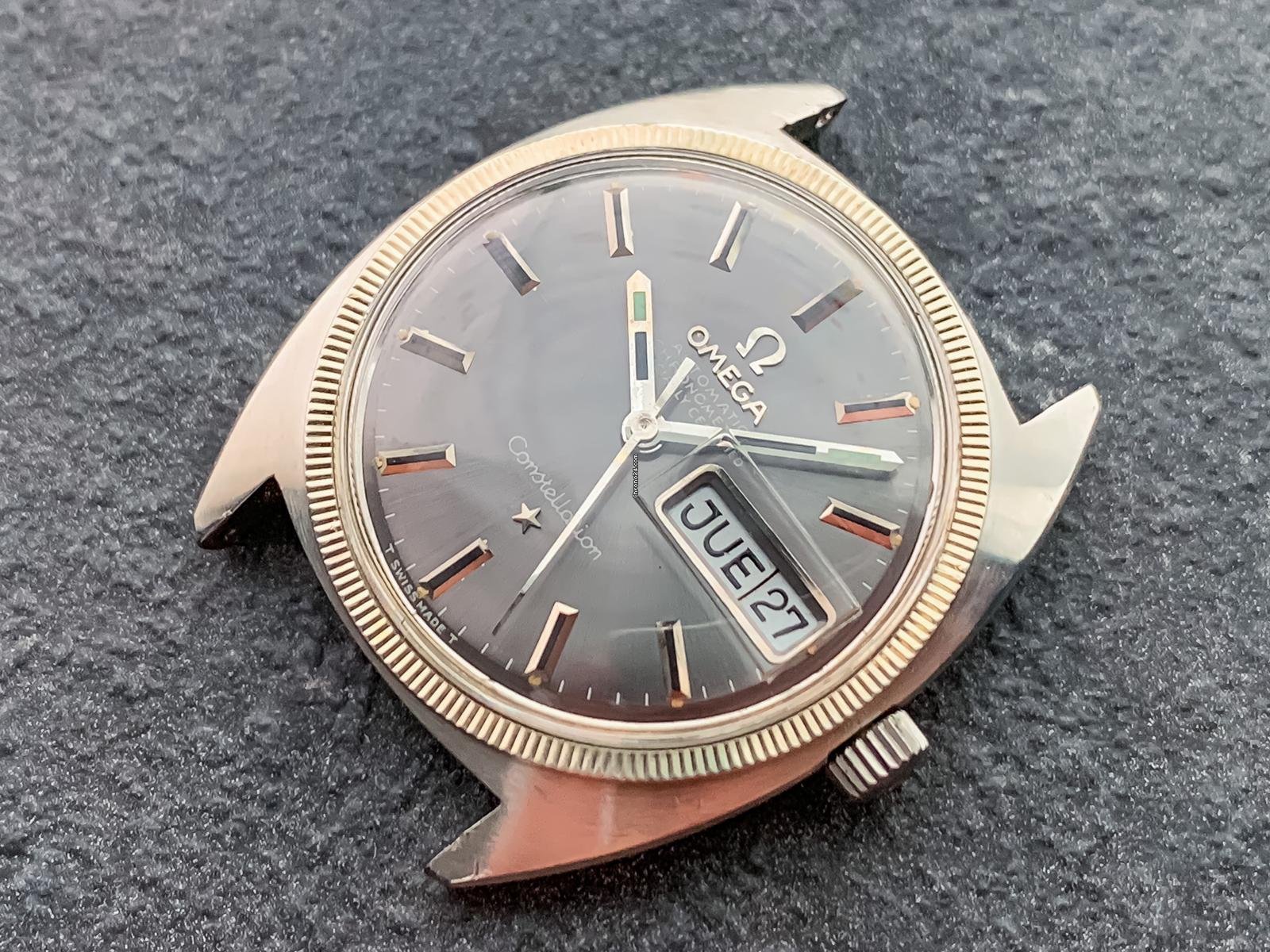

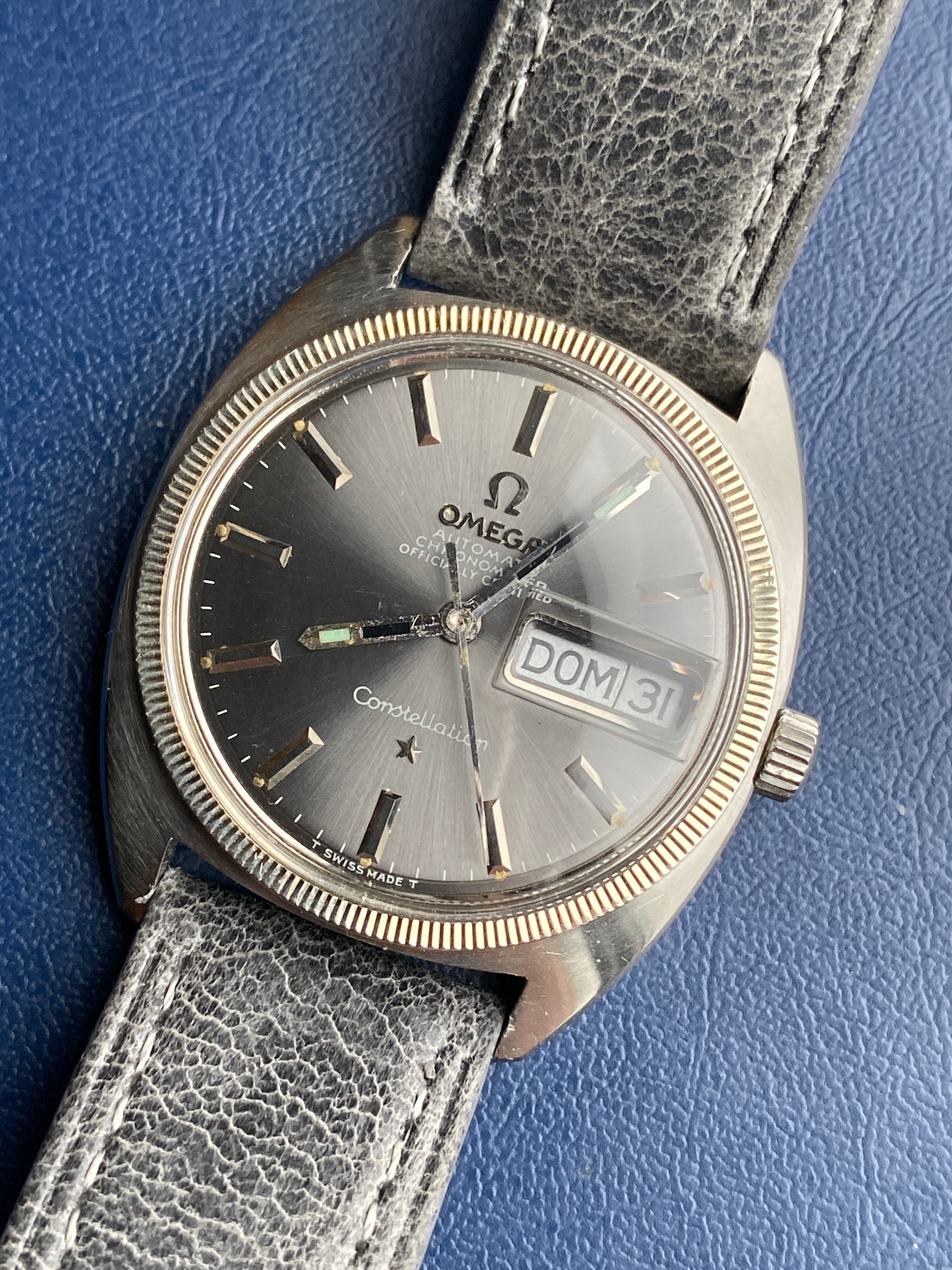

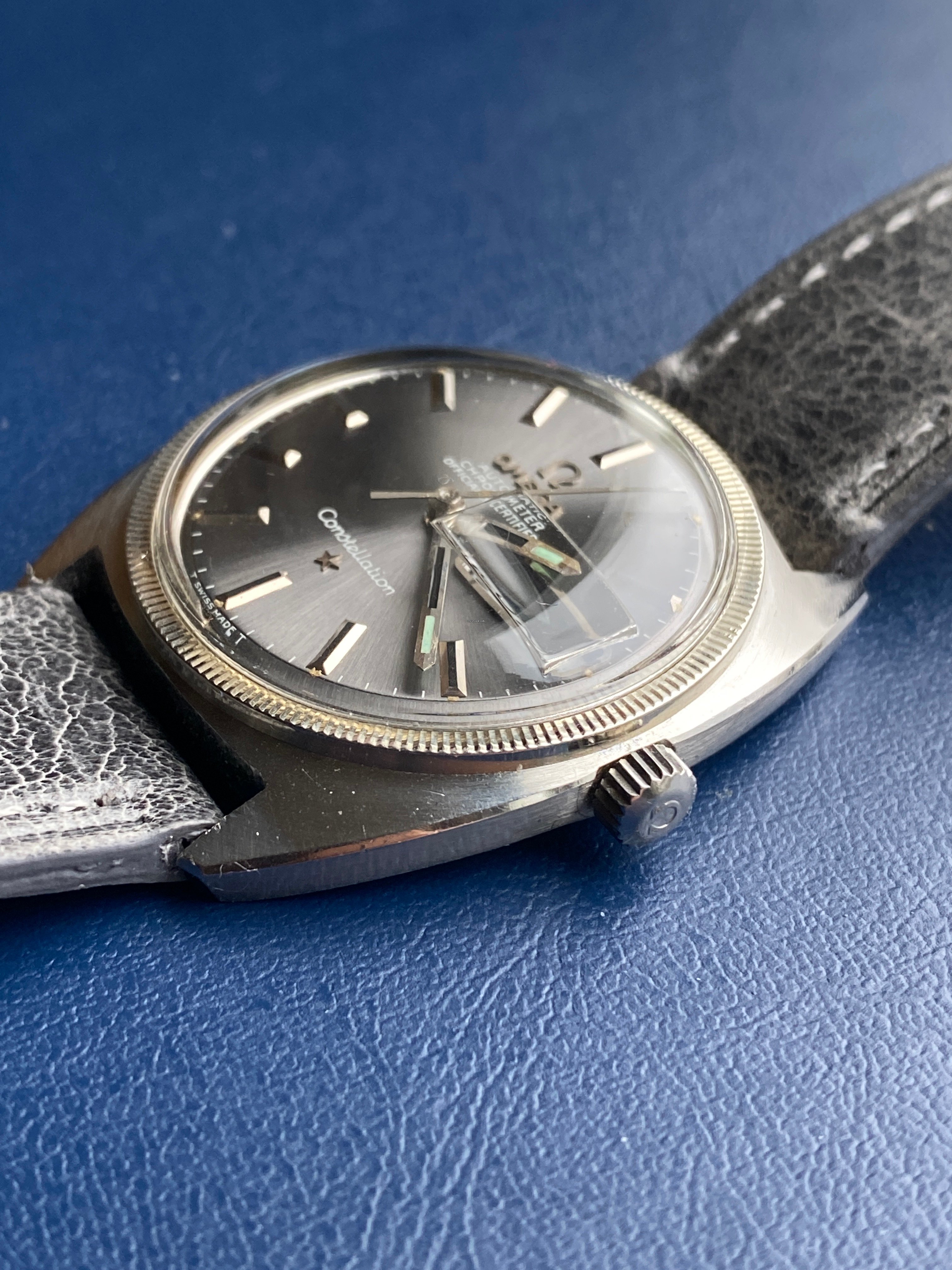

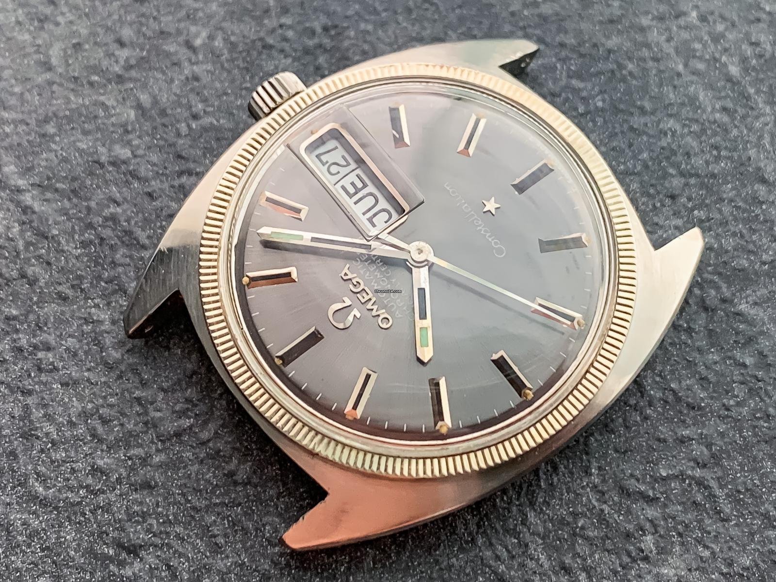

Hello all,
I'm looking to buy a vintage constellation
I've been looking at various watches at chrono and I don't want to make a mistake buying a redial or overpolished watch.
I prefer ref: 168.017, 168.029
Linen dial, brown dial and bor bracelet is a plus for me.
Can you guys see any wrong with these watches?
This looks like a good example, small scrath in glass and rare dial
https://www.chrono24.no/omega/constellation-day-date--id18319044.htm
https://www.chrono24.no/omega/omega-constellation--id17900796.htm
Linen dial, bor bracelet, bit overpriced?
I've tried to educate my self looking at various videos, but it"s hard to see repaints and overpolished case on photos for me.

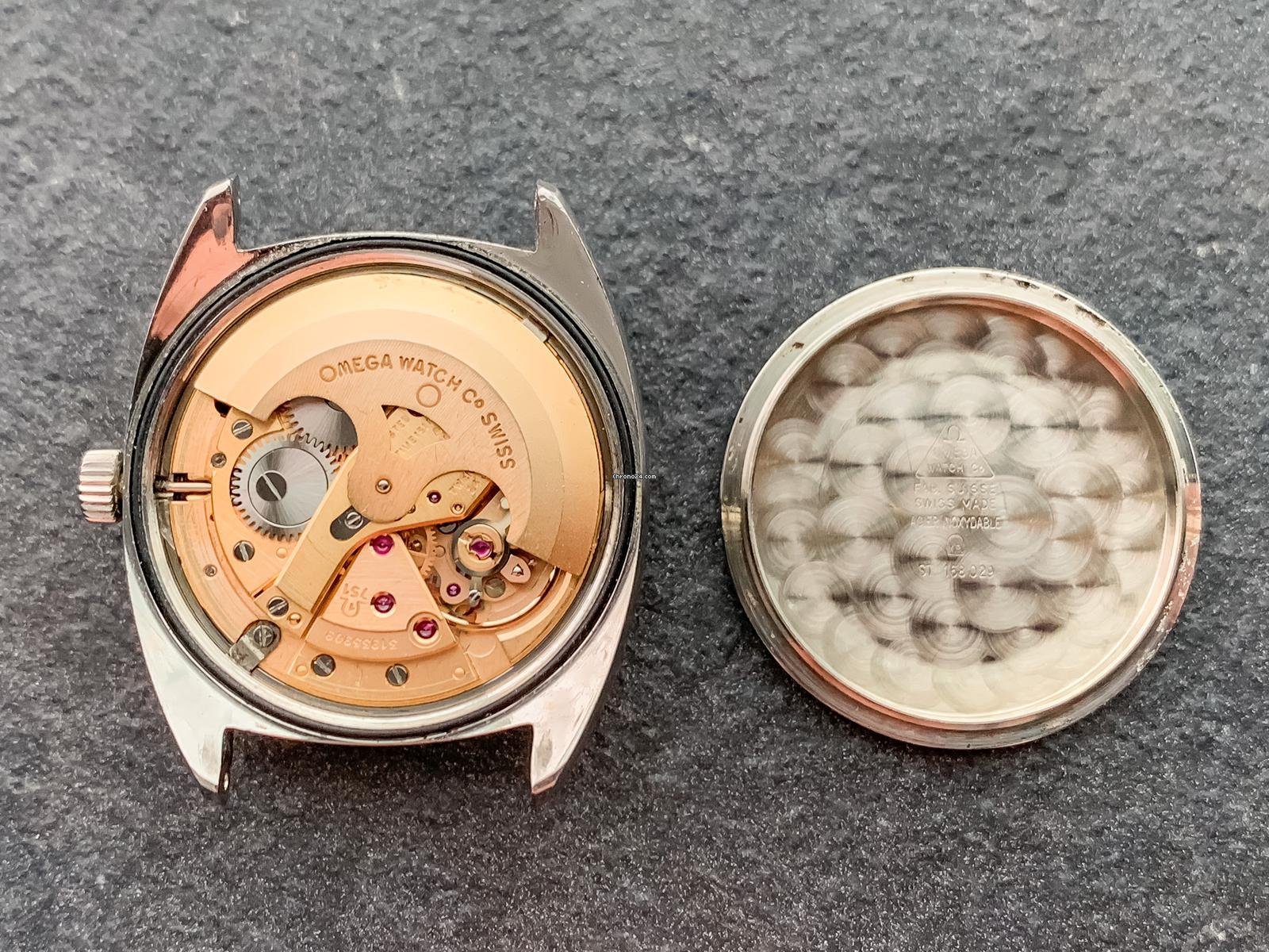

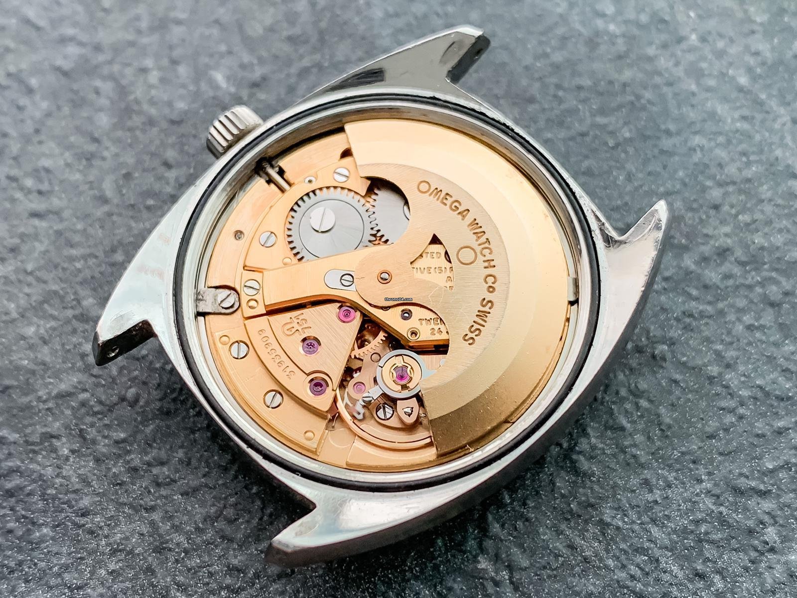

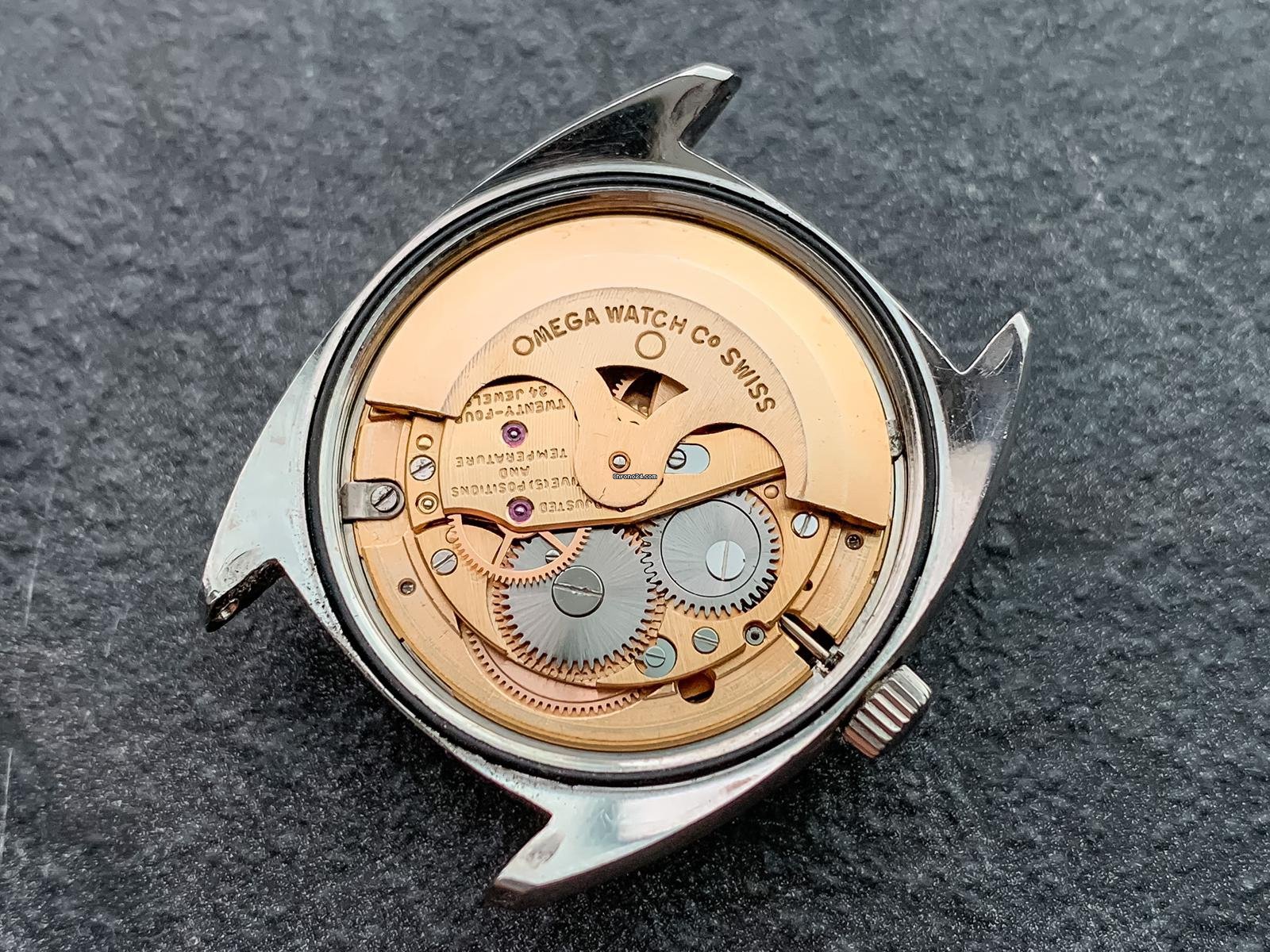

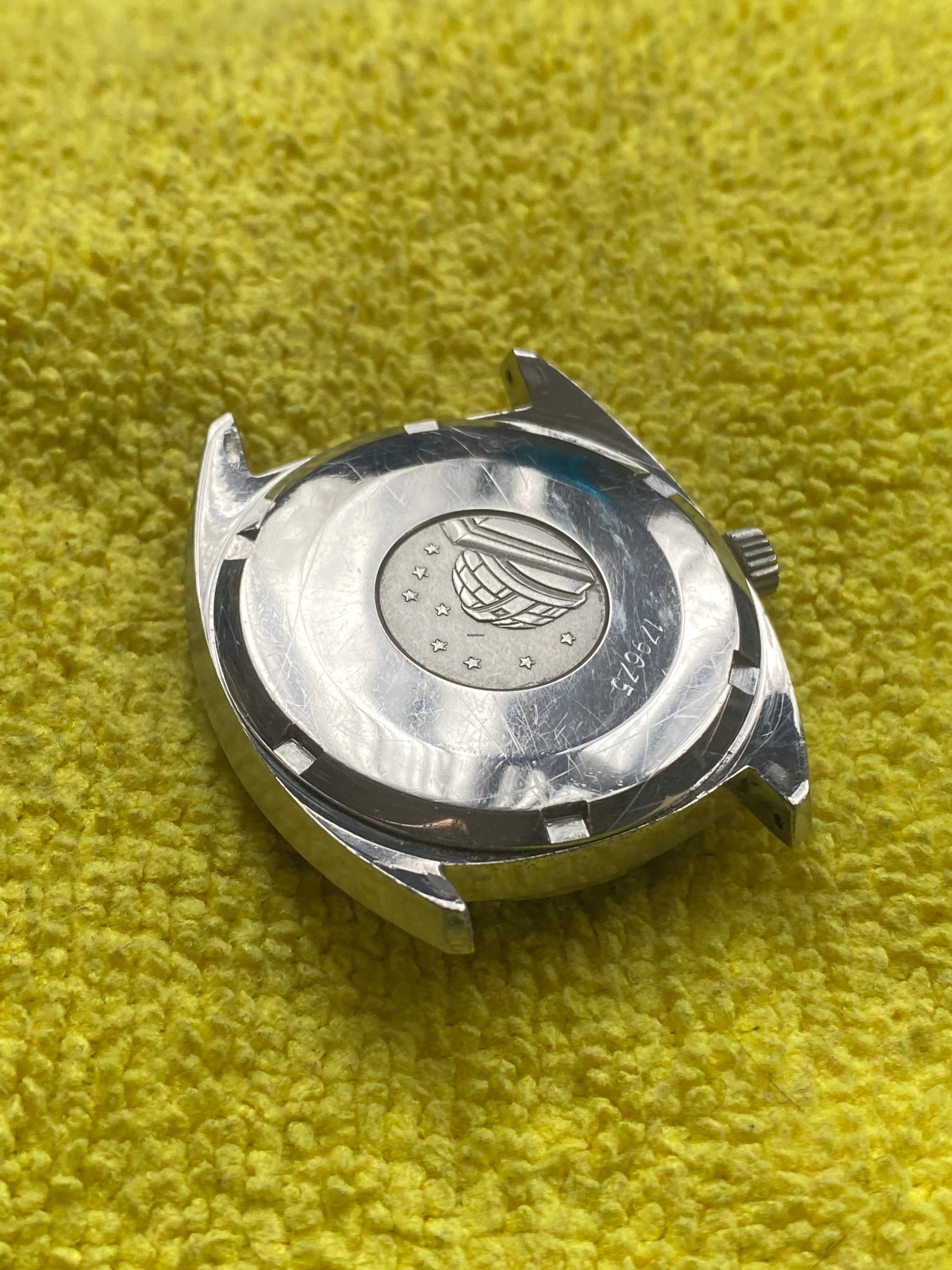

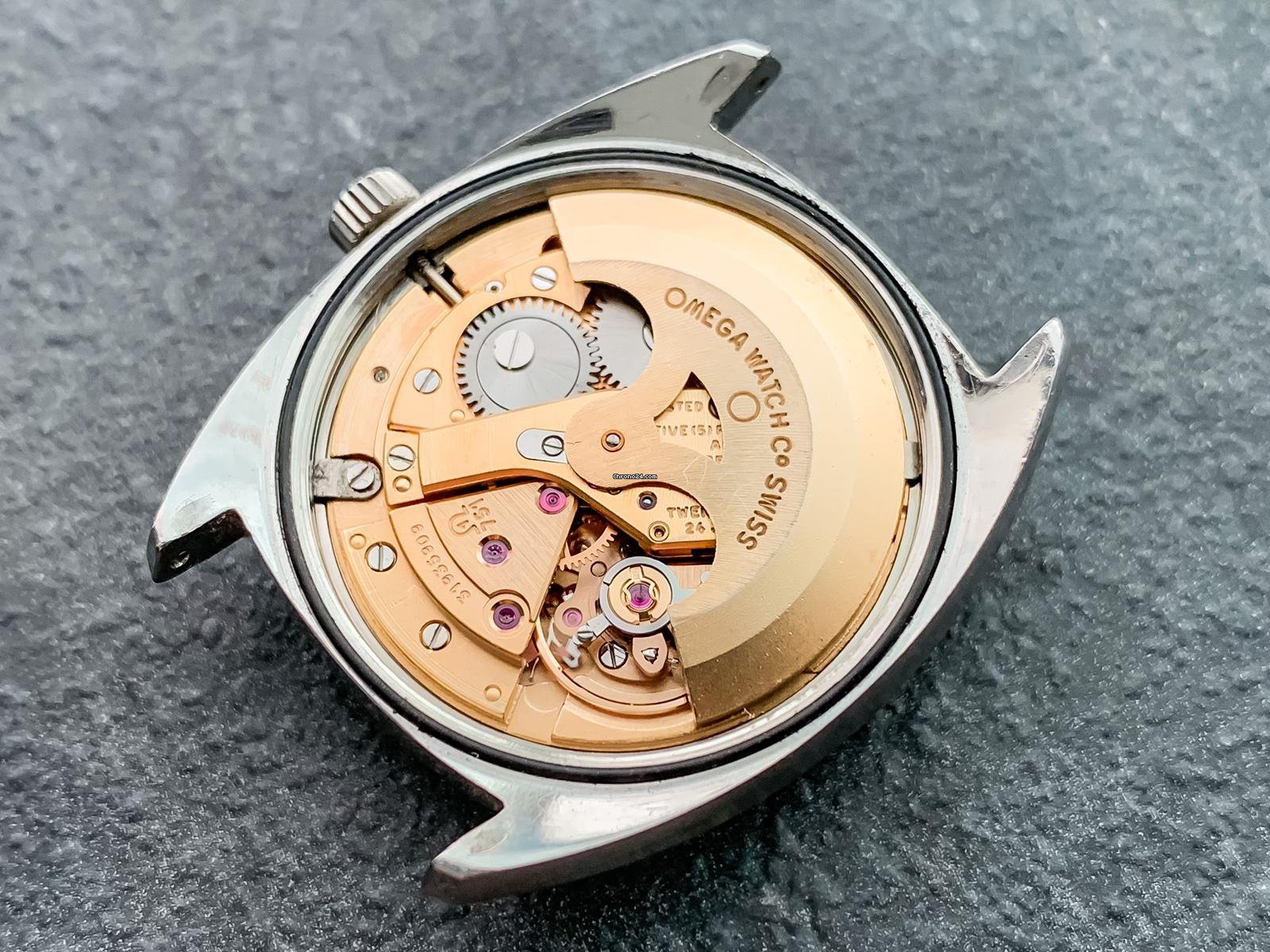

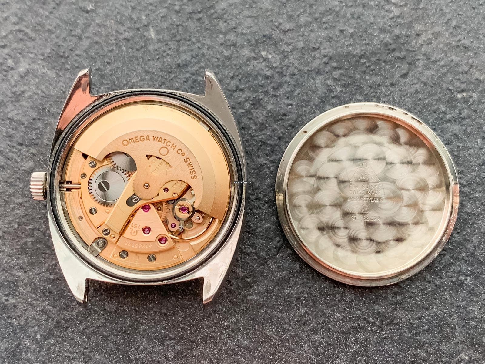

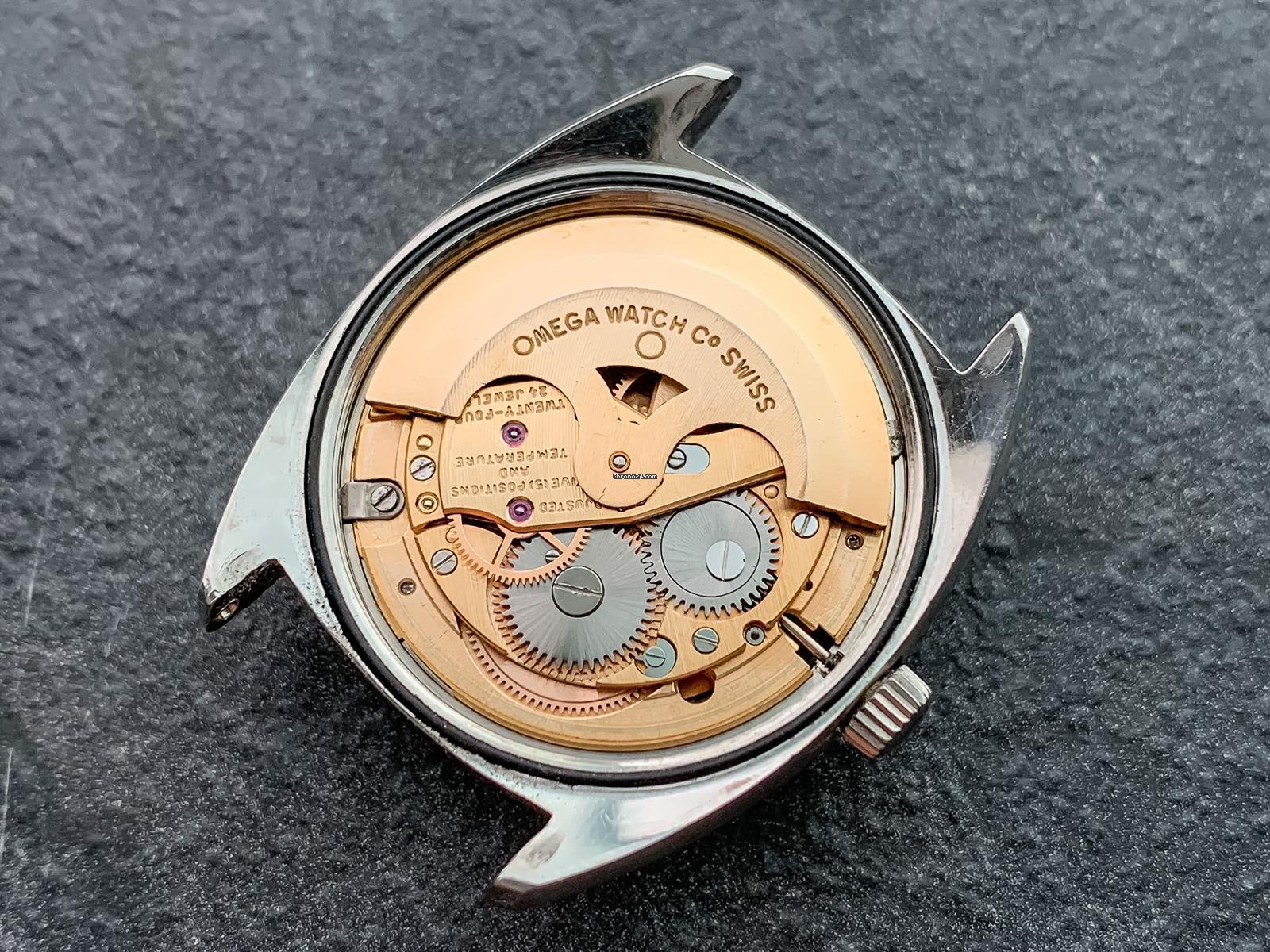

No movement picture of last one
Edit: Not all ads on chrono24 let me save pictures (neither on pc or mobile)🙁
Seems like image quality goes down on screenshot, and its not possible to download images from chrono. Or am I doing something wrong ? 🙁
Right click on the enlrged photo, save picture as, on the middle tab at the bottom left, click add photos.

Seller asking 1400 dollar but open to offers.
Seeems a bit steep without a bracelet.

Ouch, indeed. The bricks bracelet with correct end links can set you back another 200USD, which makes it 1600 - I'd say that's realistically about 500USD too much. That being said, the question is time vs. money really. If you're willing to throw the money at it you won't need much patience - if you are willing to invest the time, you won't need this much money. We've regularly had examples with the sought-after dial variants (grey or linen), 18k WG bezel and brick bracelet in nice condition for sale in the classifieds here for sub-1000USD. It's also roughly where I'd expect a no-reserve ebay auction to end.

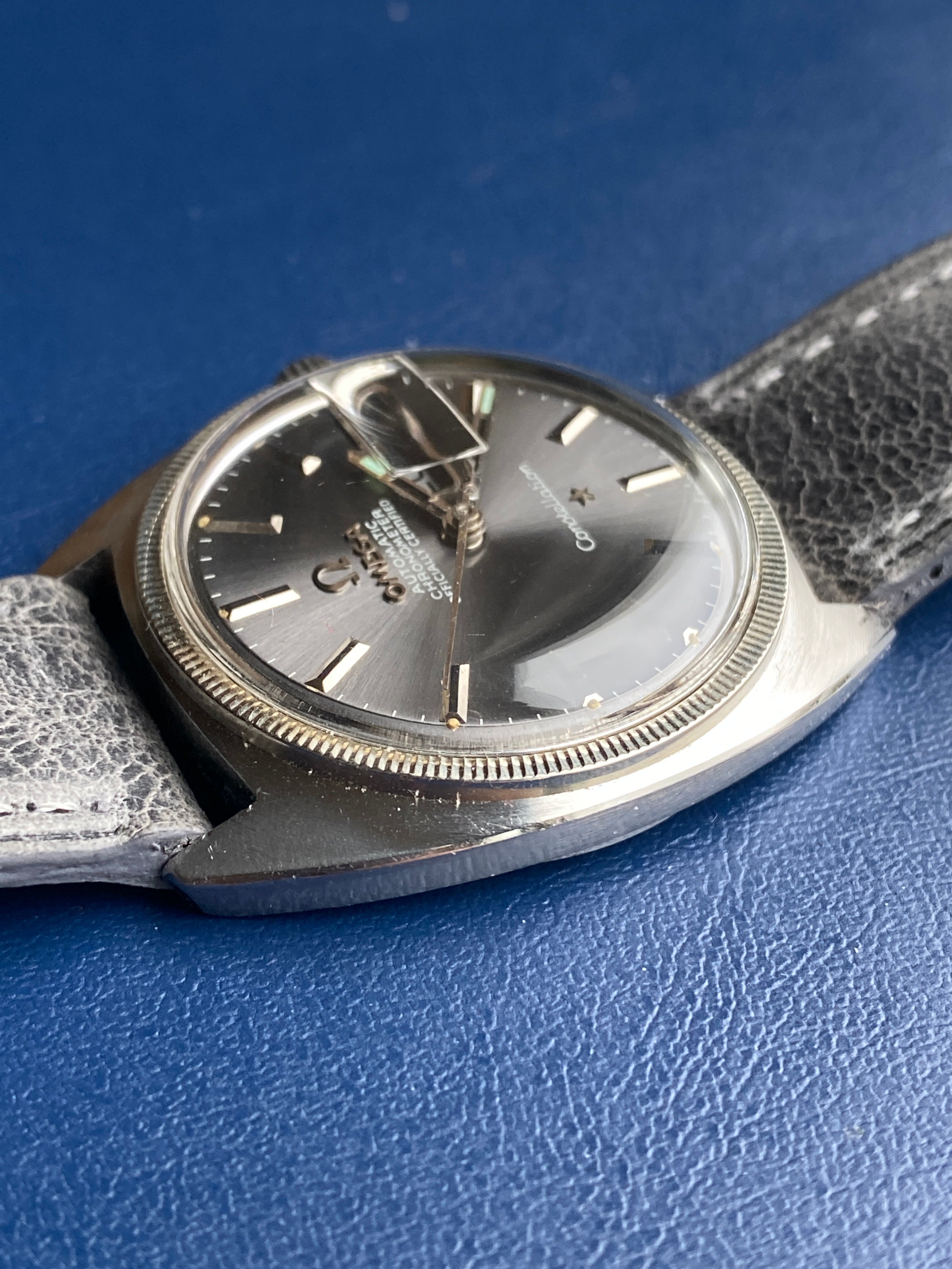

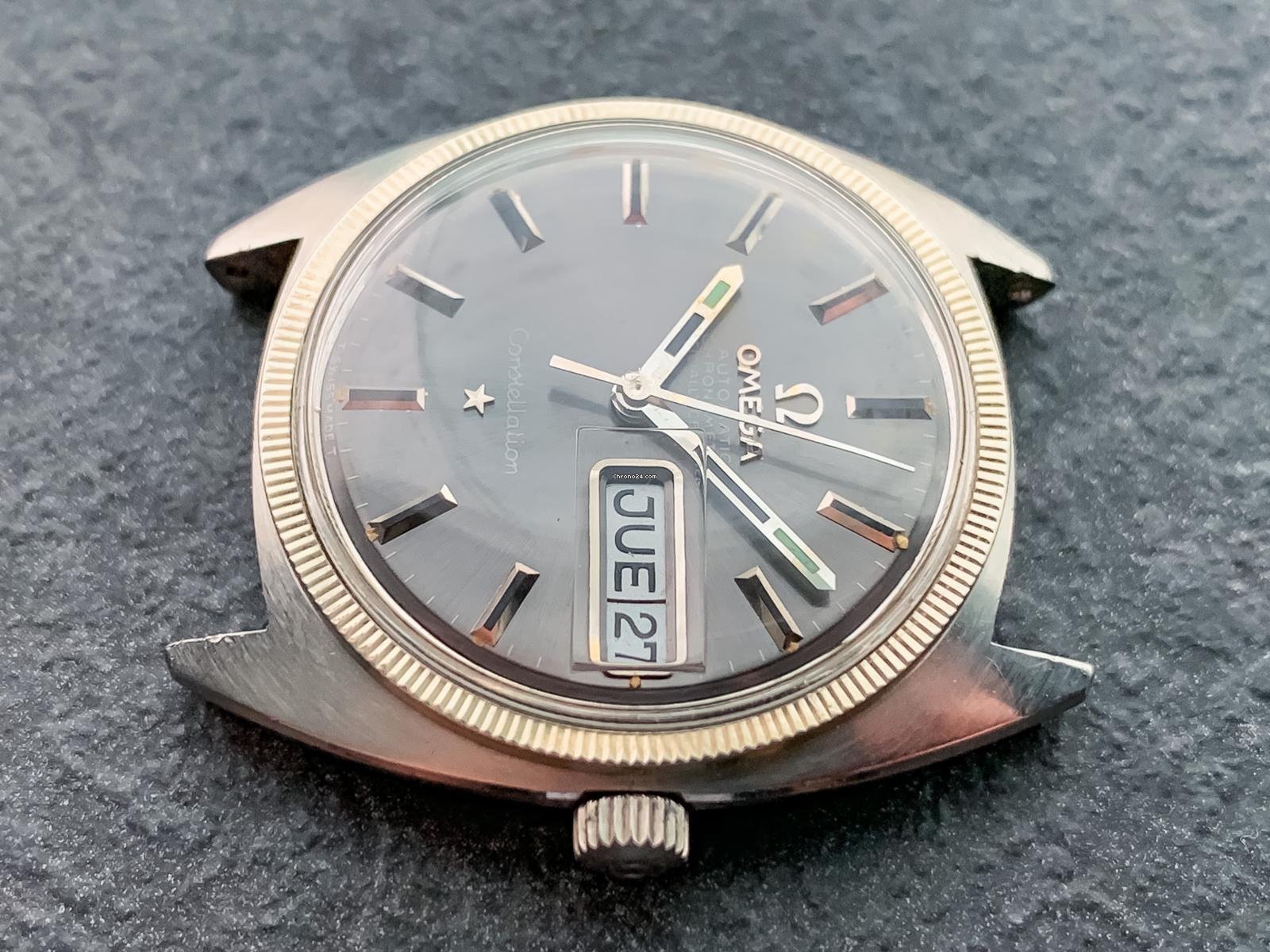

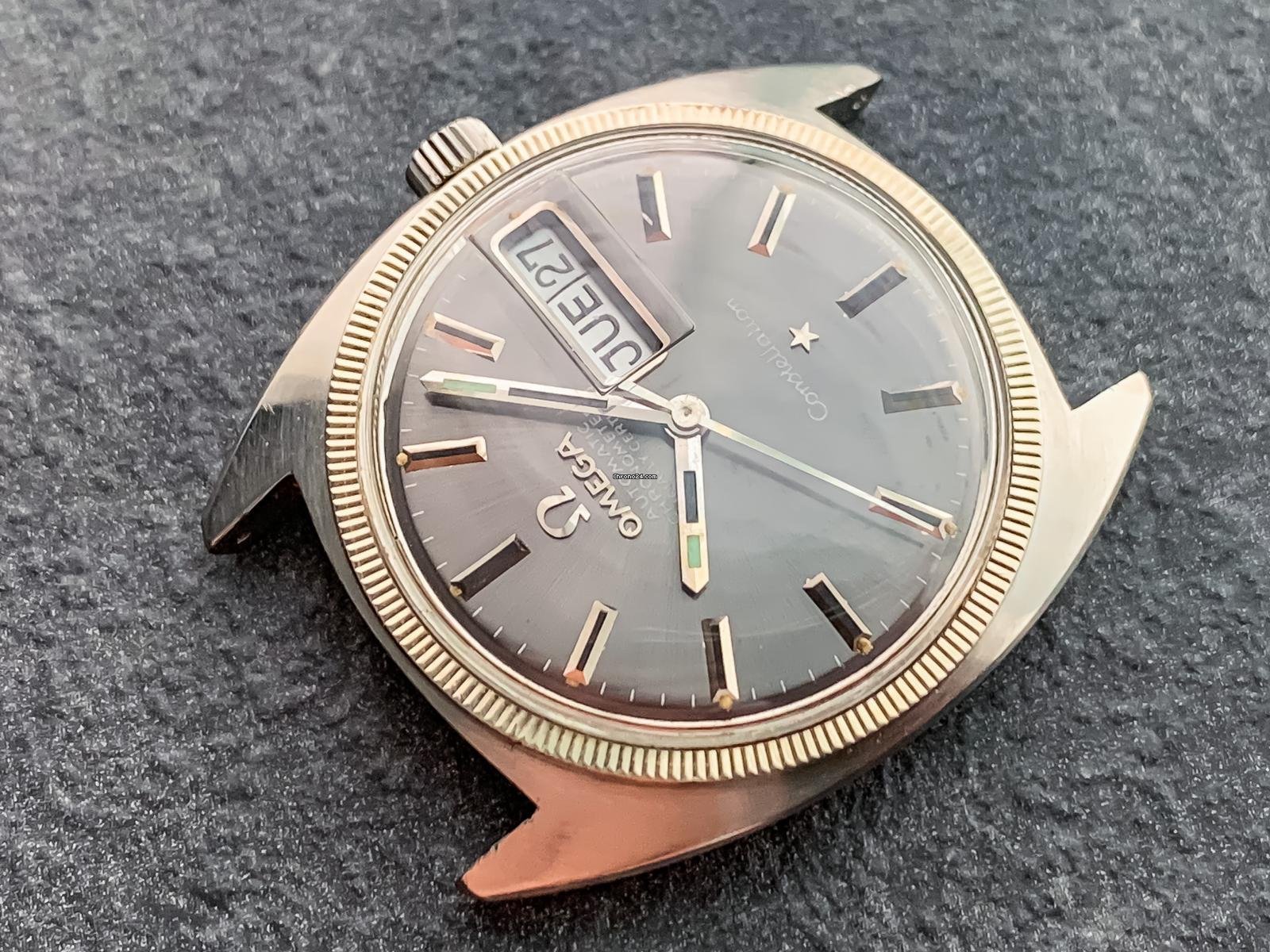

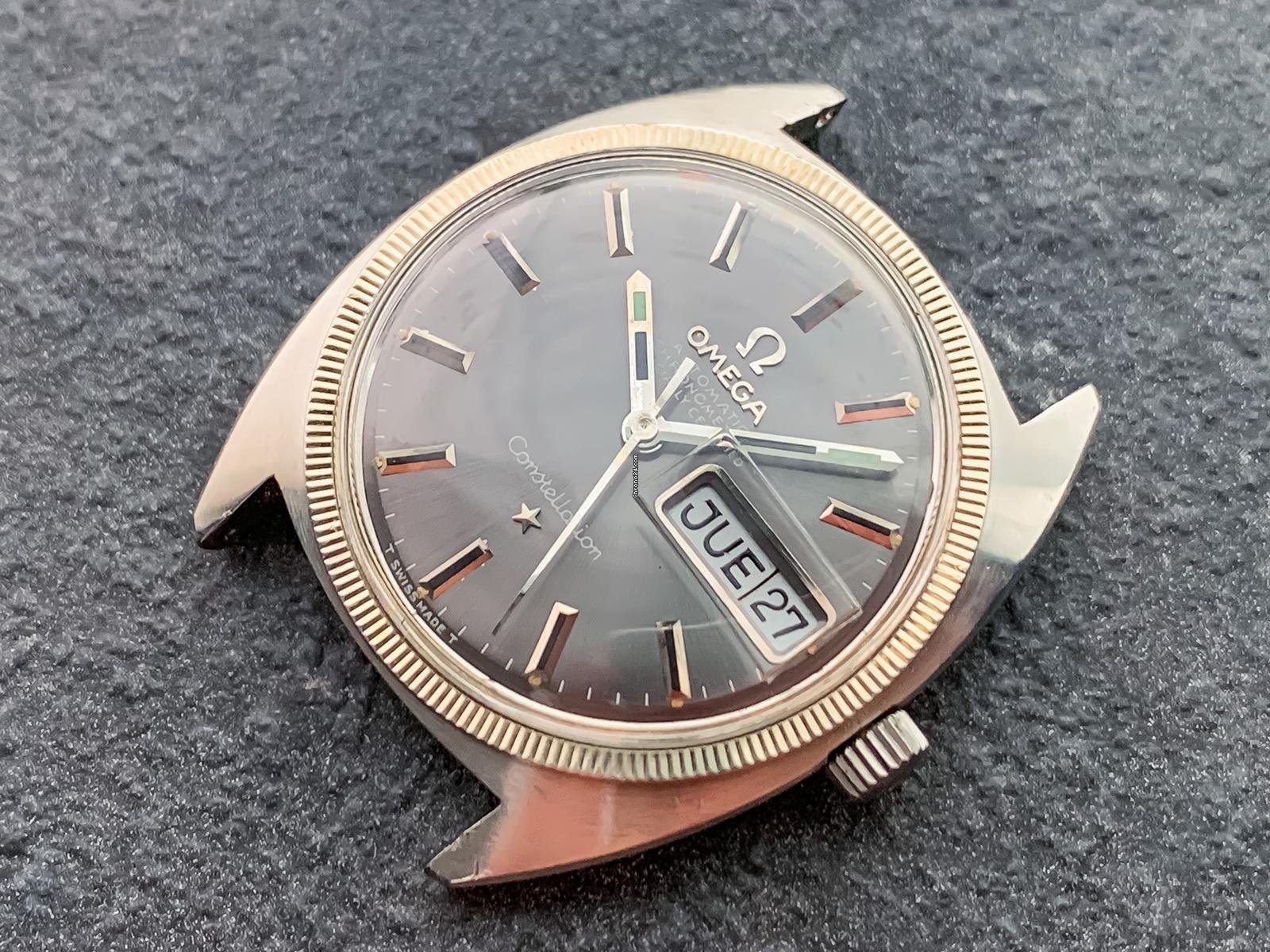

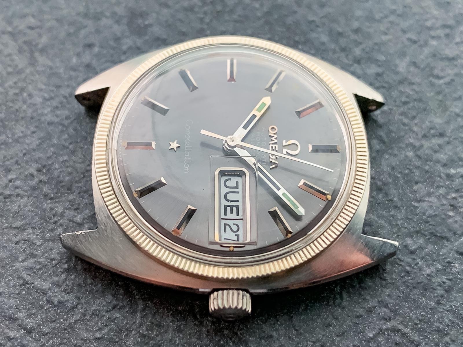

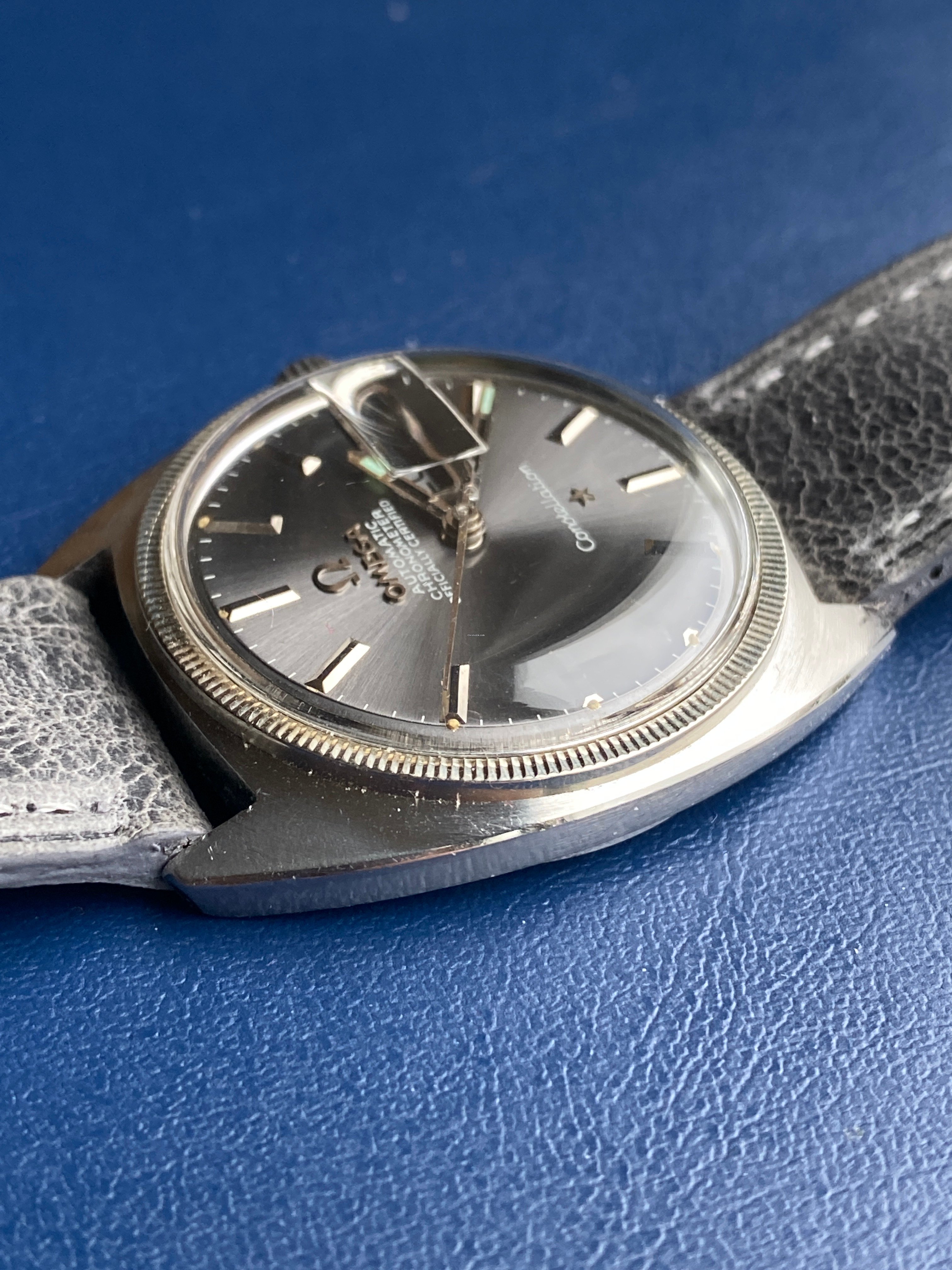

Surley not a major issue but the lume on the hands looks like redone and the colour isn't a good match with the dial lume
I'm no expert but when you say it I can clearly see the difference, it's a lot more green/relumed.
