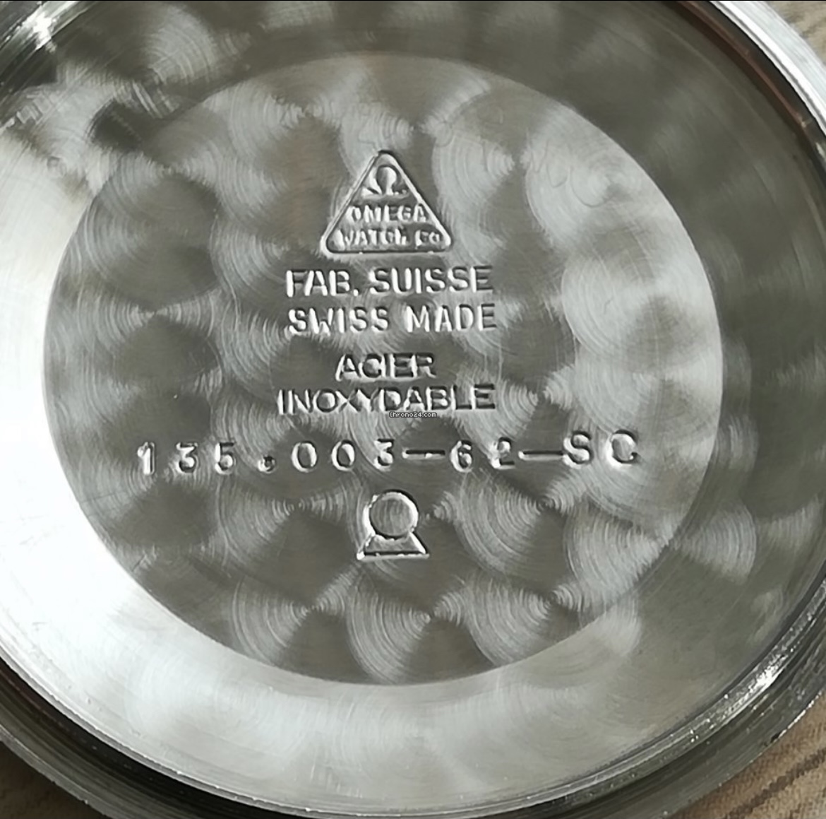

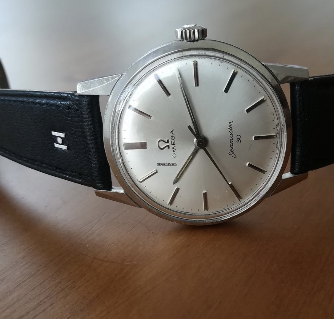

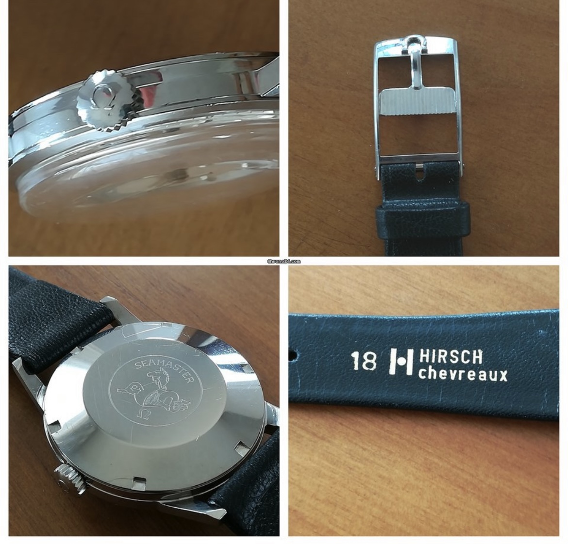

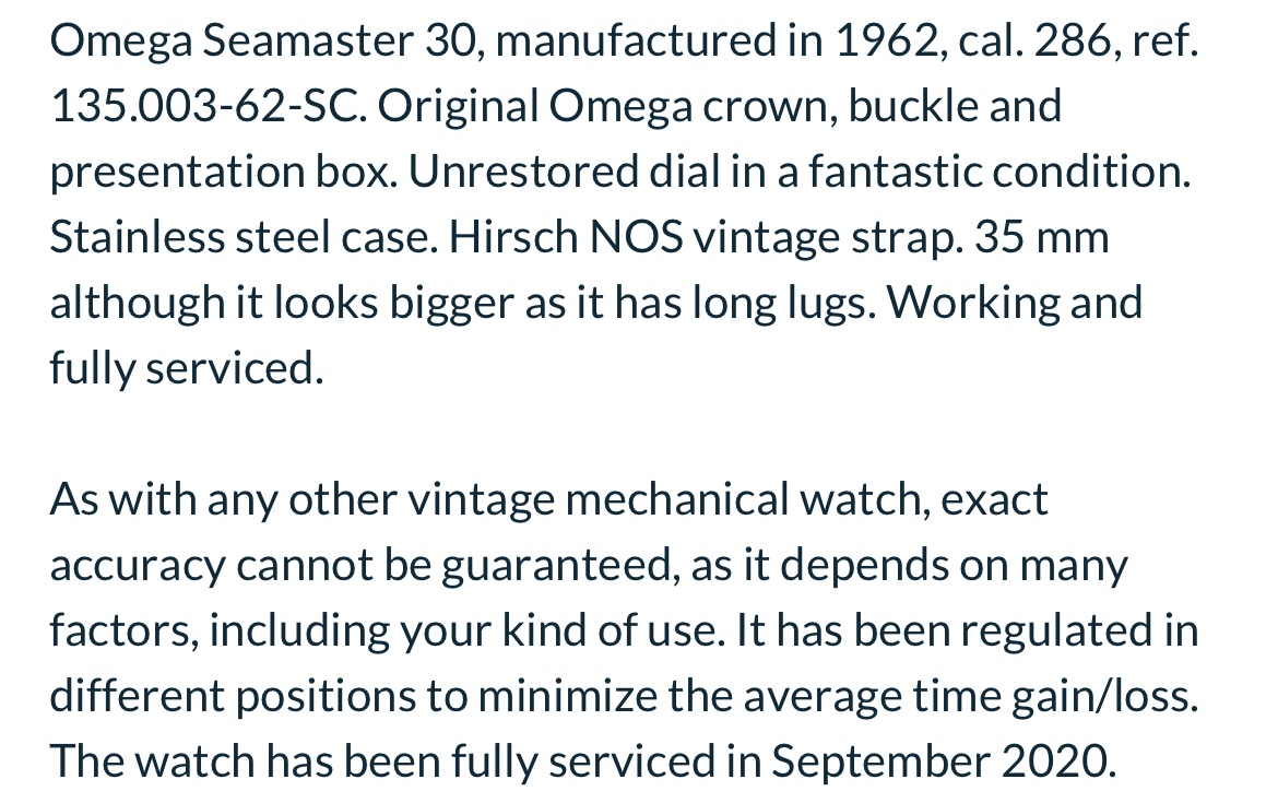

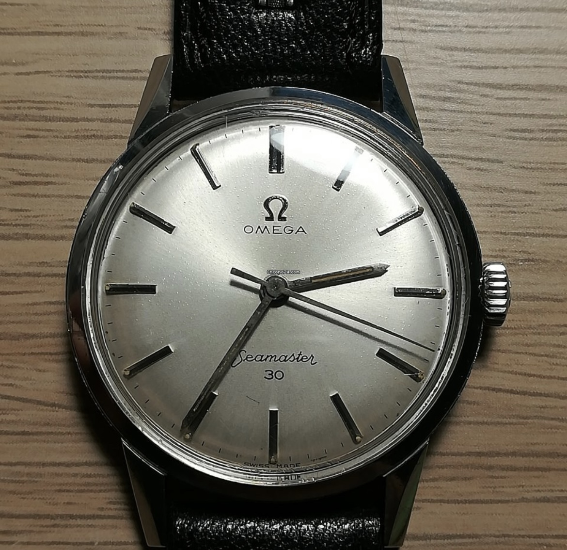

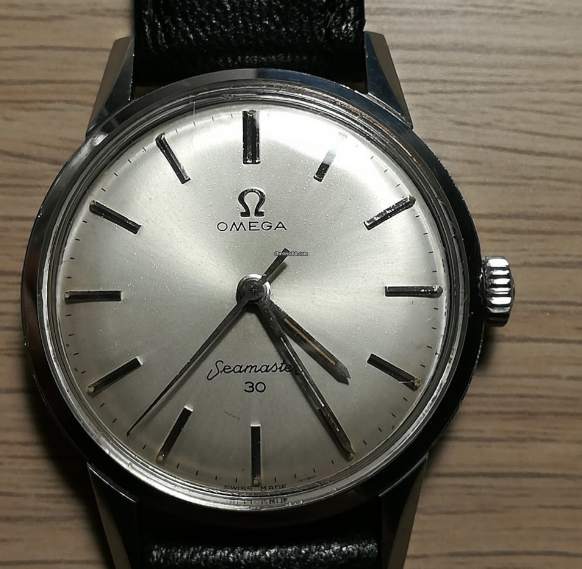

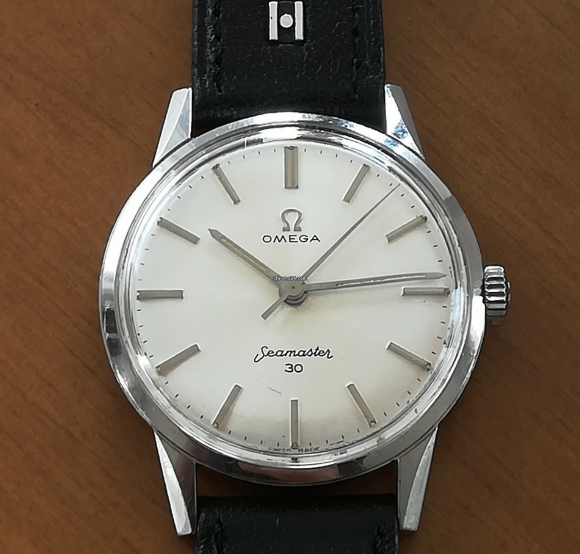

I have found a particular piece and wanted to get expert advice before I did anything. I have done a bit of research and reading online, but don’t want to do anything without some expertise. (Covid limiting travel makes this more difficult as I can’t travel to local shops/watch guys). The watch I’ve spotted is this Seamaster Cal. 286 ref.135.003-62-2C (see photos). It’s from 1962 and the seller gave the description in the photos below. He claims it was serviced in September 2020 and I have asked for proof of this. This brings me on to my second question...
Does the ads description match the photos and what other questions should I ask? My main suspicion was that the seller said the dial was not touched and yet looked so clean. The watch also comes with the original box.

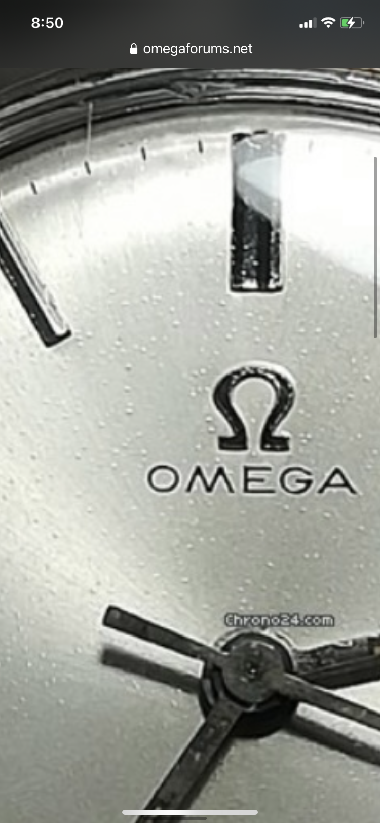

Welcome Shane. A seller claiming serviced always begs proof- good on your asking.
The watch is original, and the case is surprisingly sharp (many have been polished so the sharp bevels on the lugs and case get softened down). The dial however is suffering from the typically lacquer bubbling that comes from moisture getting into the watch and settling on the dial.
The darkened lume color also speaks to prior moisture ingress. If you don’t mind a little “patina” as some love, then it’s a nice watch. But dial damage like that is a no-go for me.

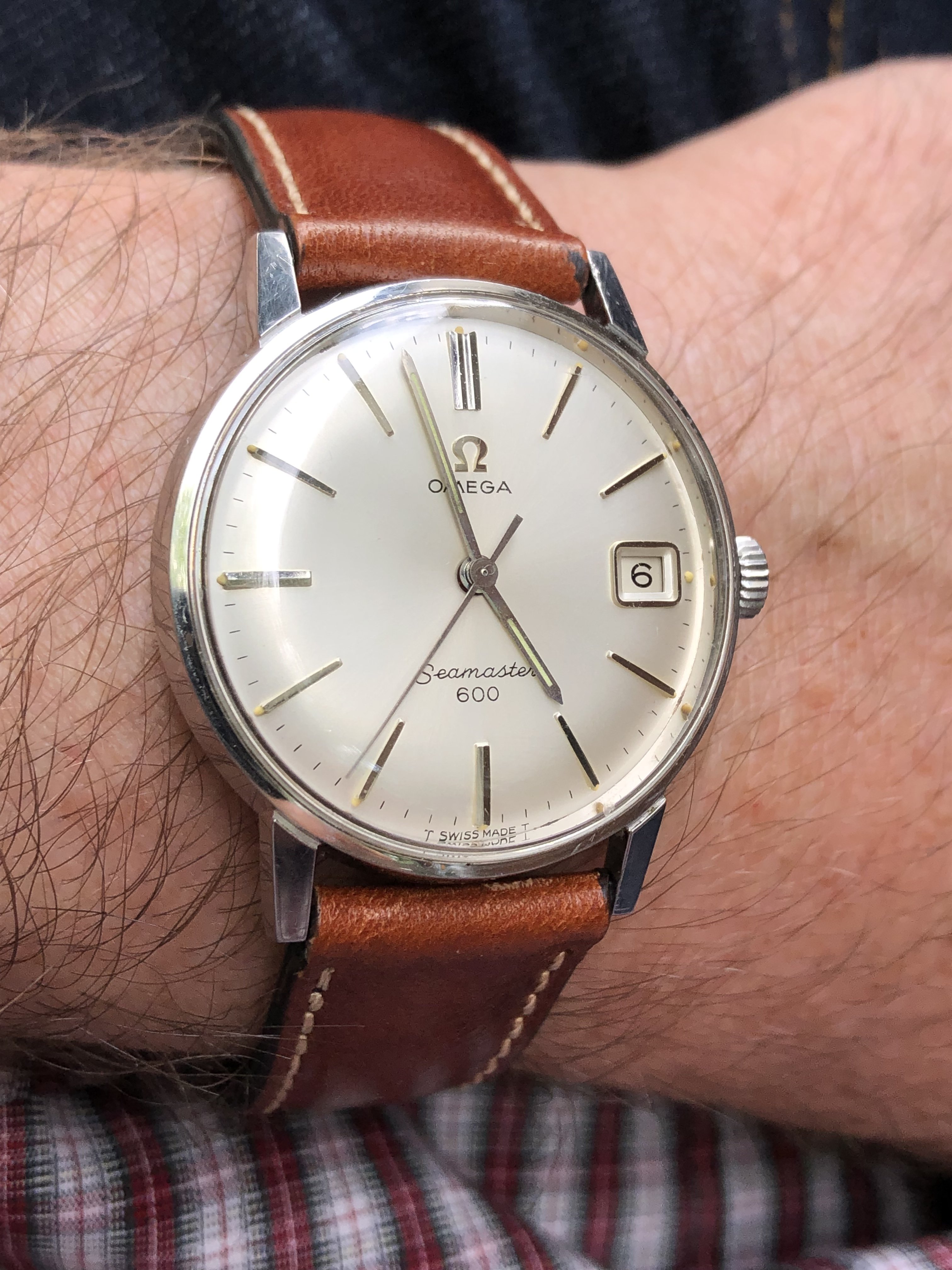

Here is one of mine from the same era- note the dial surface and bright yellow color of the lume.

The bubbling is a condition issue that affects collectible value, but may not be very noticeable to the naked eye under most types of lighting. Other major condition issues are the scratch on the dial near 6 and the missing lume in the minute hand. The case is quite nice compared to what we often see from dealers.

Hello and welcome.
Others more expert will be along shortly, with more detail about whether everything about that watch is correct. I will offer that the last picture shows some age appropriate patina, that’s good. The case has been polished, but not overly in my opinion (lugs look reasonably sharp).

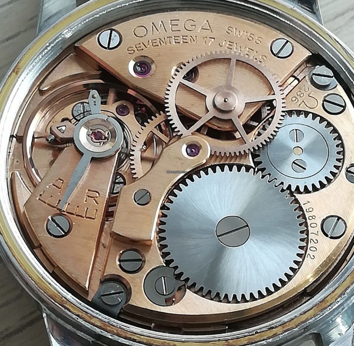

To my eyes, the movement looks clean and so appears to have been serviced.

Hi there. Thank you for the reply! Again, I didn’t notice the missing loom. Overall, the bubbling wouldn’t bother me unless I could fully see it or if it had an effect on the way the watch worked in future. My budget is €800. This particular piece is up for €795!
