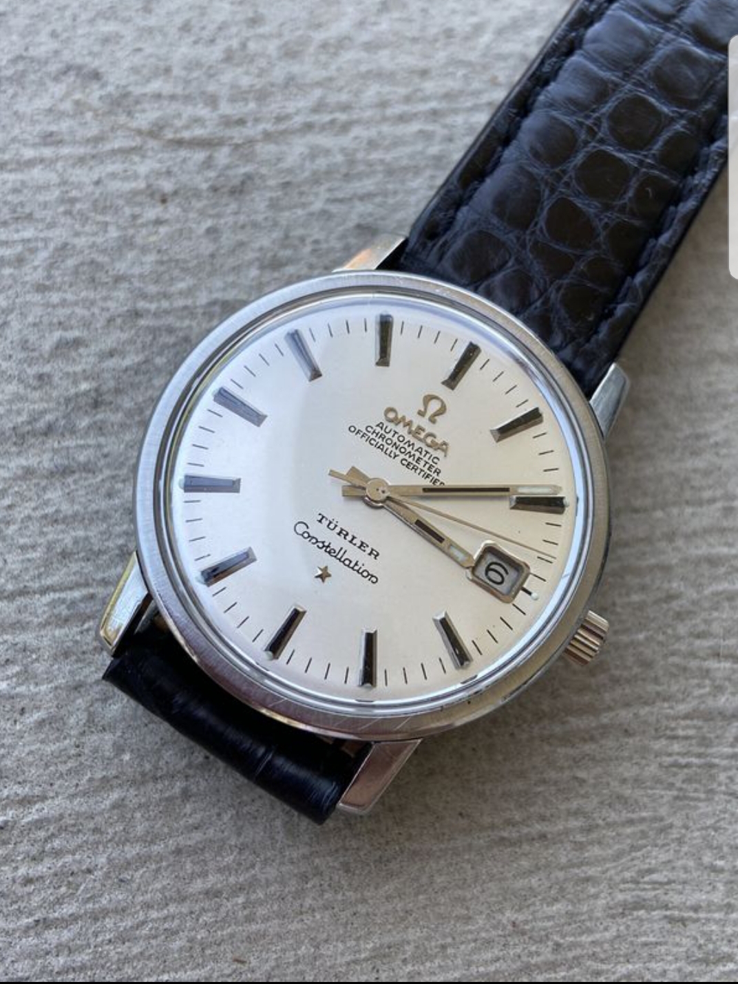

Hello all, I'm new to vintage watch appreciation and I have been interested in purchasing my first Omega constellation. I have been looking to purchase this one that is at a fair price. However, I'm a little skeptical about the dial. The seller is saying he purchased a few years ago, he has receipt paperwork from when the watch was serviced and I have seen both the watch and paperwork which matches and it looks nice. He believes it maybe a redial because of the Tuler badging so if anyone could give an opinion on. The "Swiss Made" is missing at the bottom but I would appreciate any help with this piece as I have viewed other posts referring to the missing "Swiss Made" insignias on other Omegas. Thanks

Its definitely a redial and also has a case that is not in the best shape. Avoid.

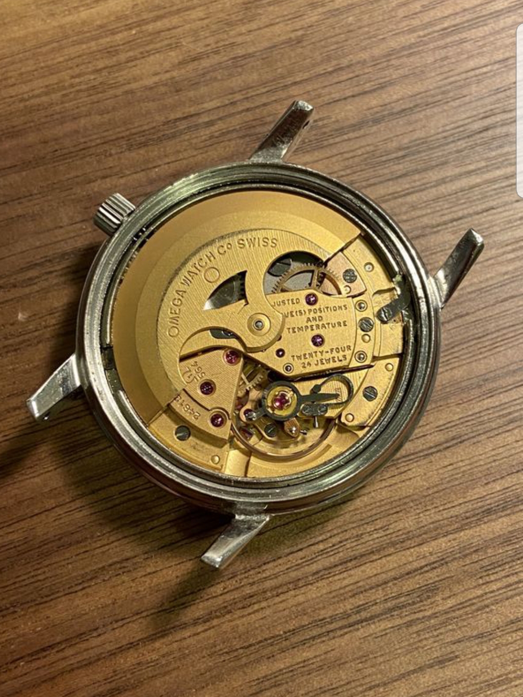

Maskelyne, even as a redial is it worth purchasing if the price is reasonable enough and do you see anything else that looks incorrect in the mechanics or gears showing it would be a fake Omega?
If the price is reasonable and the redial is of high class, I agree. In this case the redial is poorly done. The fonts and text are "fat" and the lume looks unnatural for a watch like this. The watch has lost it´s "soul"
Thank you Maskelyne for the advice and honest opinion, it is very appreciated by me. I will do a little more research on my quest for a nice Constellation.
