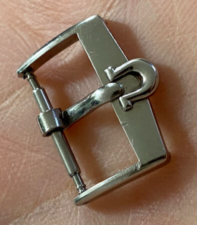

@VintageOmegaLove

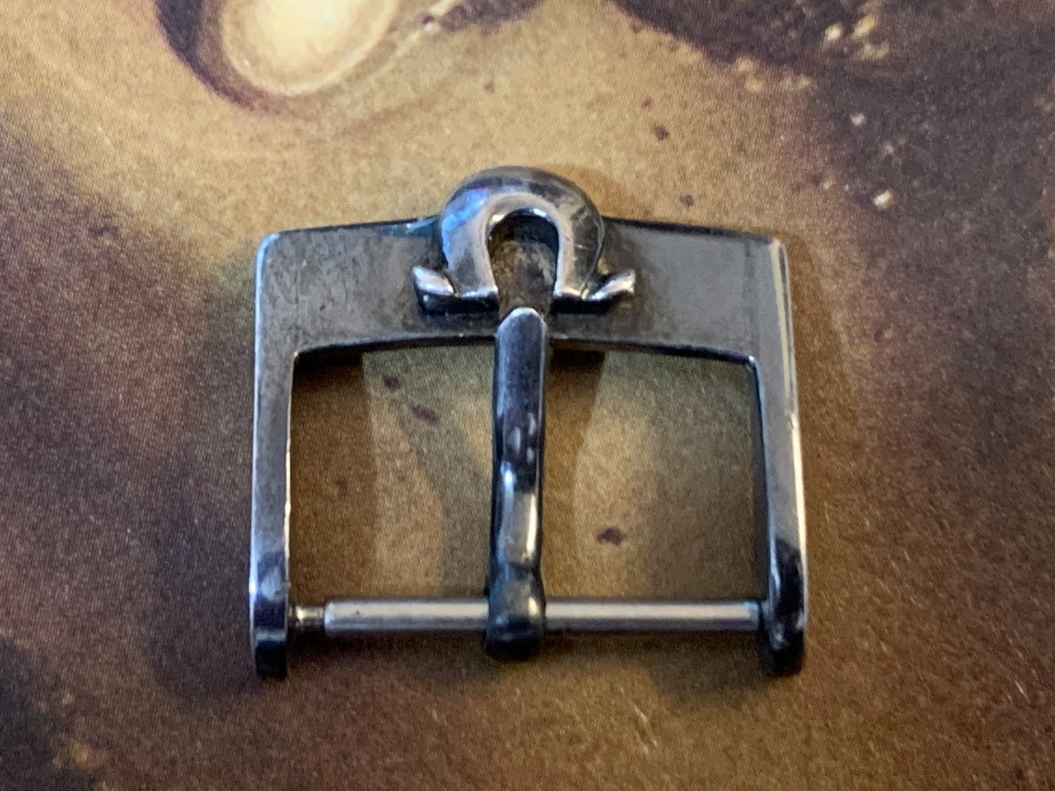

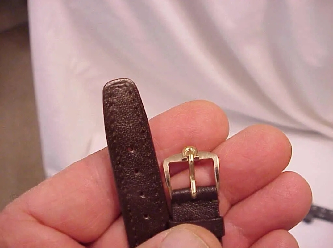

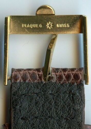

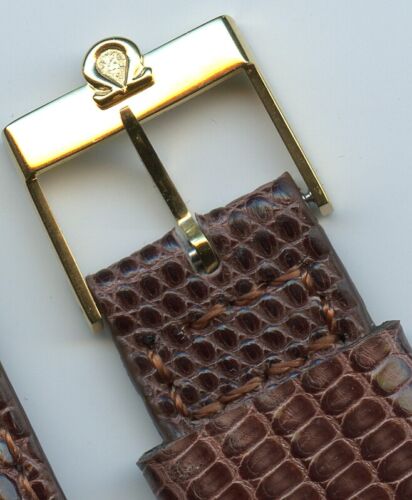

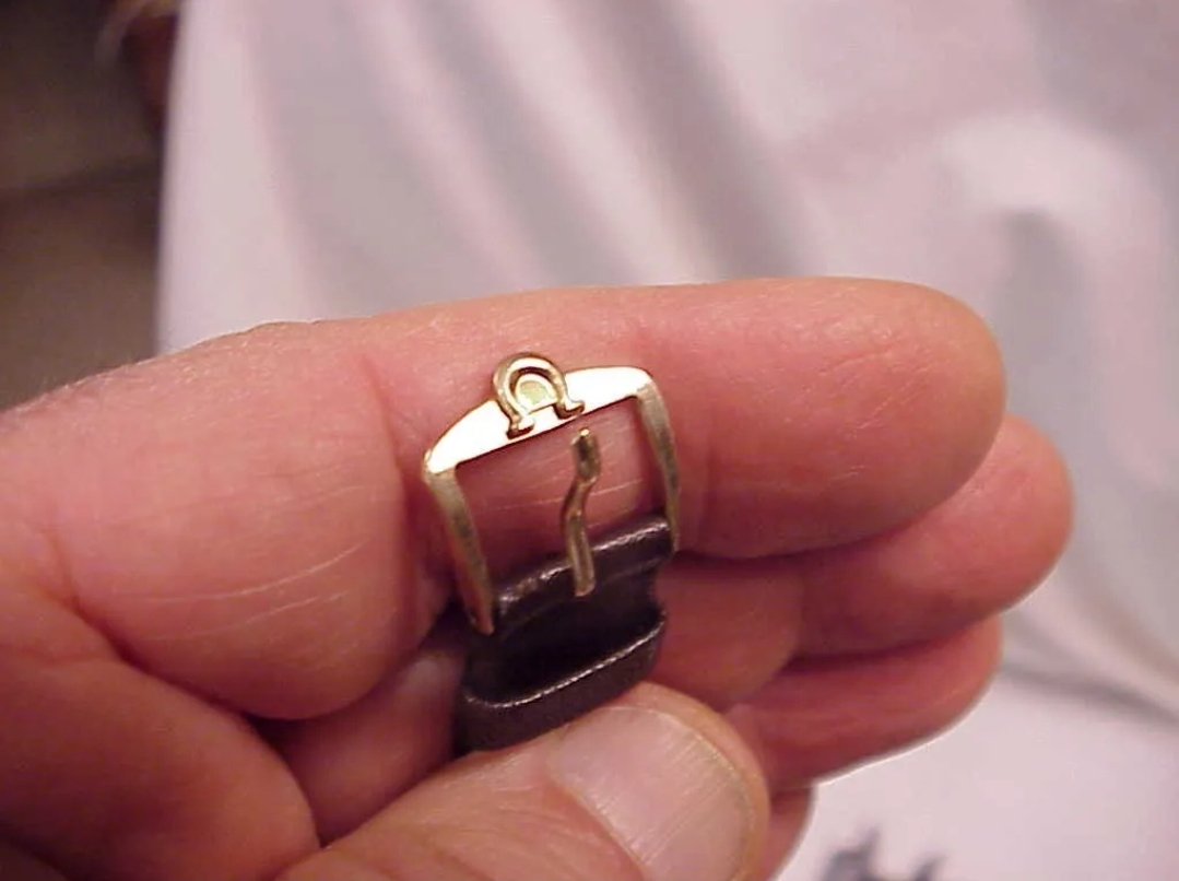

A little late but I have one and when searching found your post and our member Franco's great 30mm site shows this advertisement.
And our member Erich's outstanding ode (in book form) to 30mm's has no example.
Franco says maybe 1950's
Has anybody discovered a date range for these USA Market buckles in the intervening time?
Mine has neither Hallmarks nor wear-through, so I will just call it yellow, for now.
mine
nice one, fwiw the logo on the strap is jk for jacques kreisler

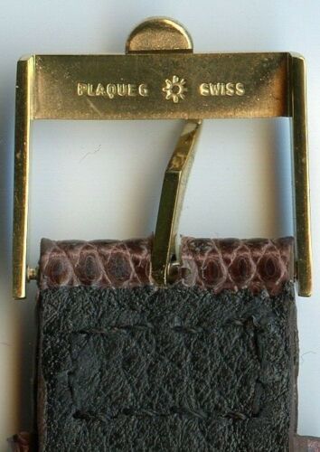

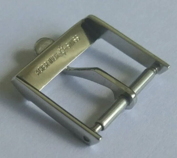

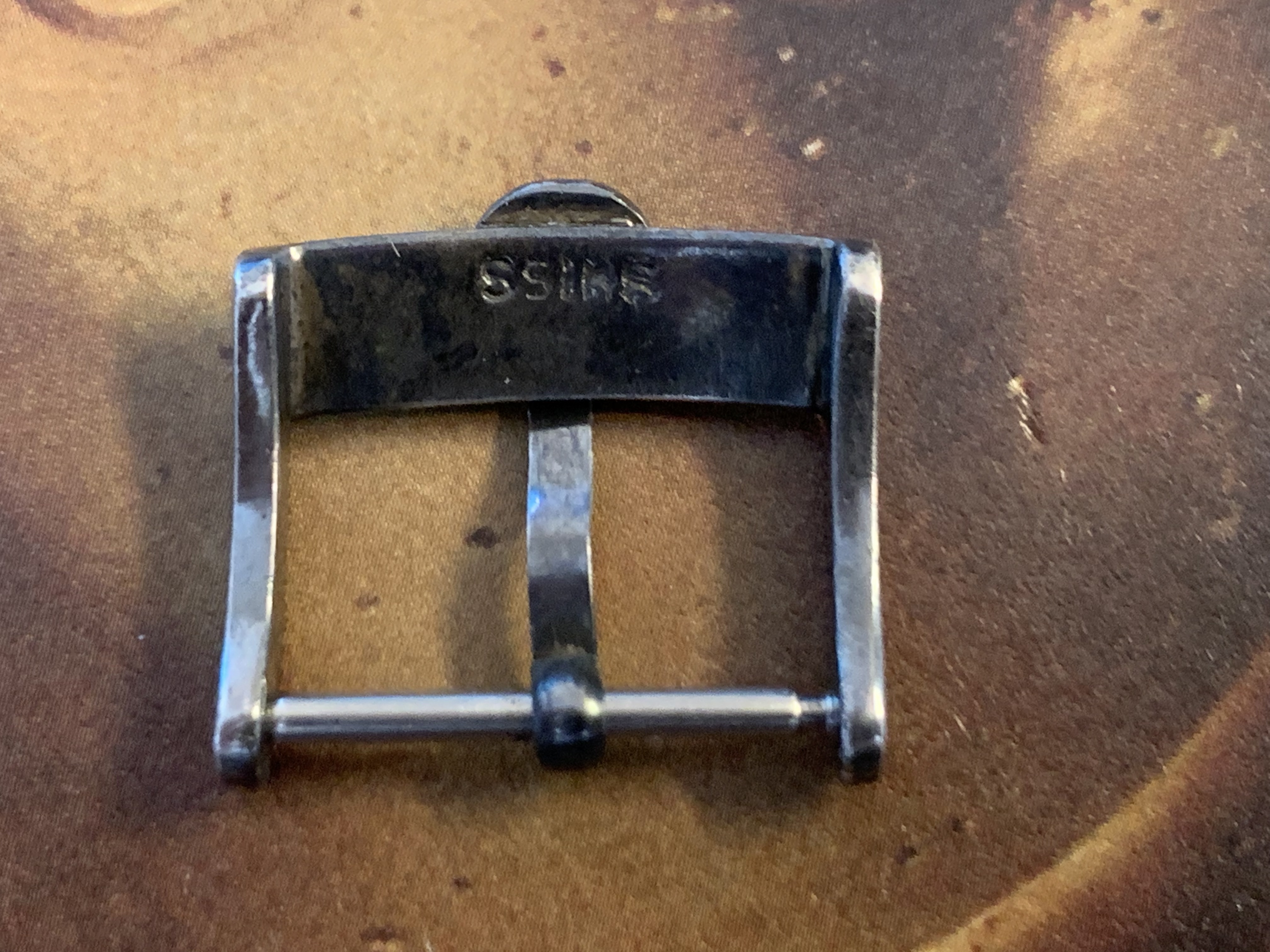

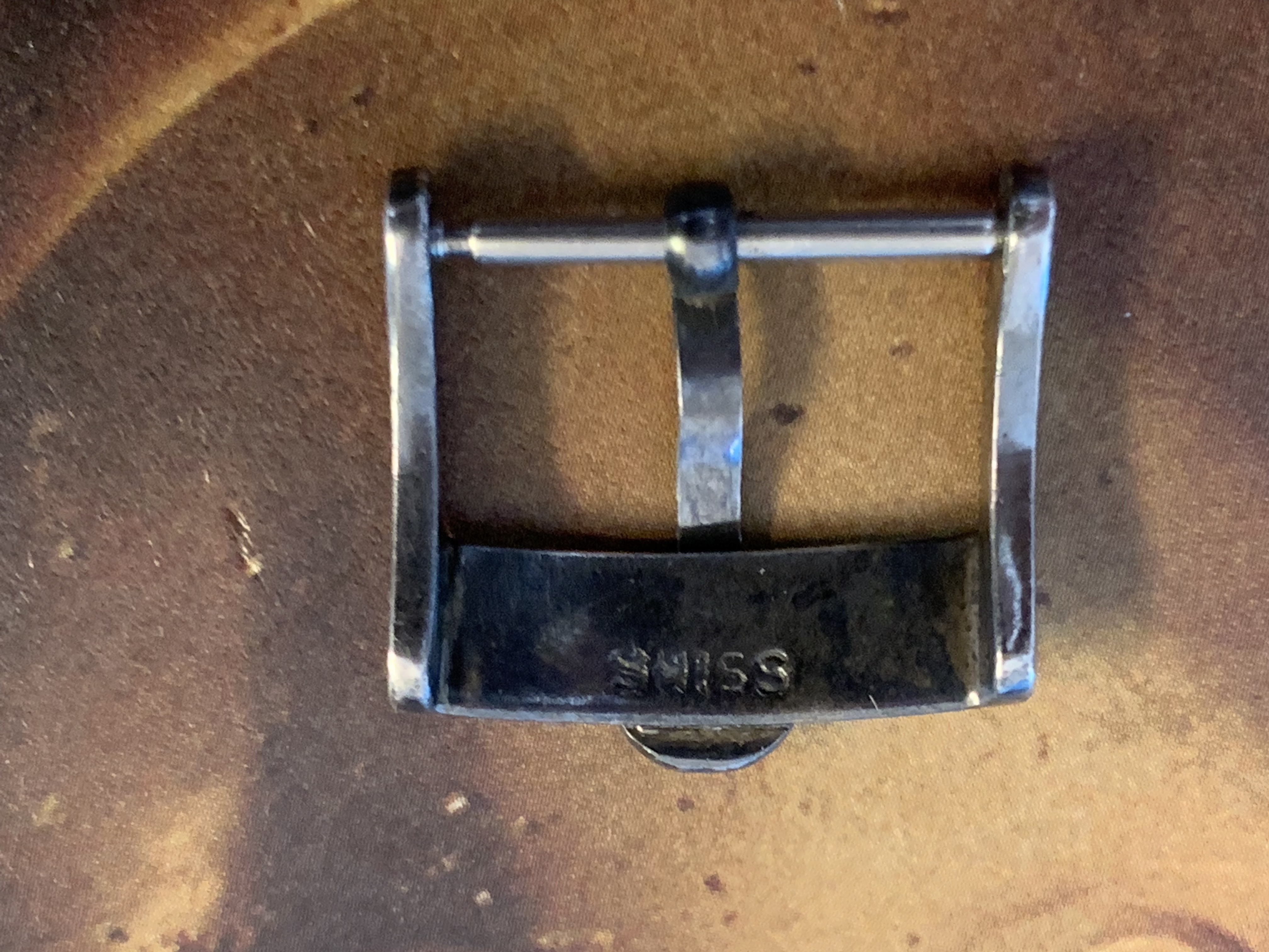

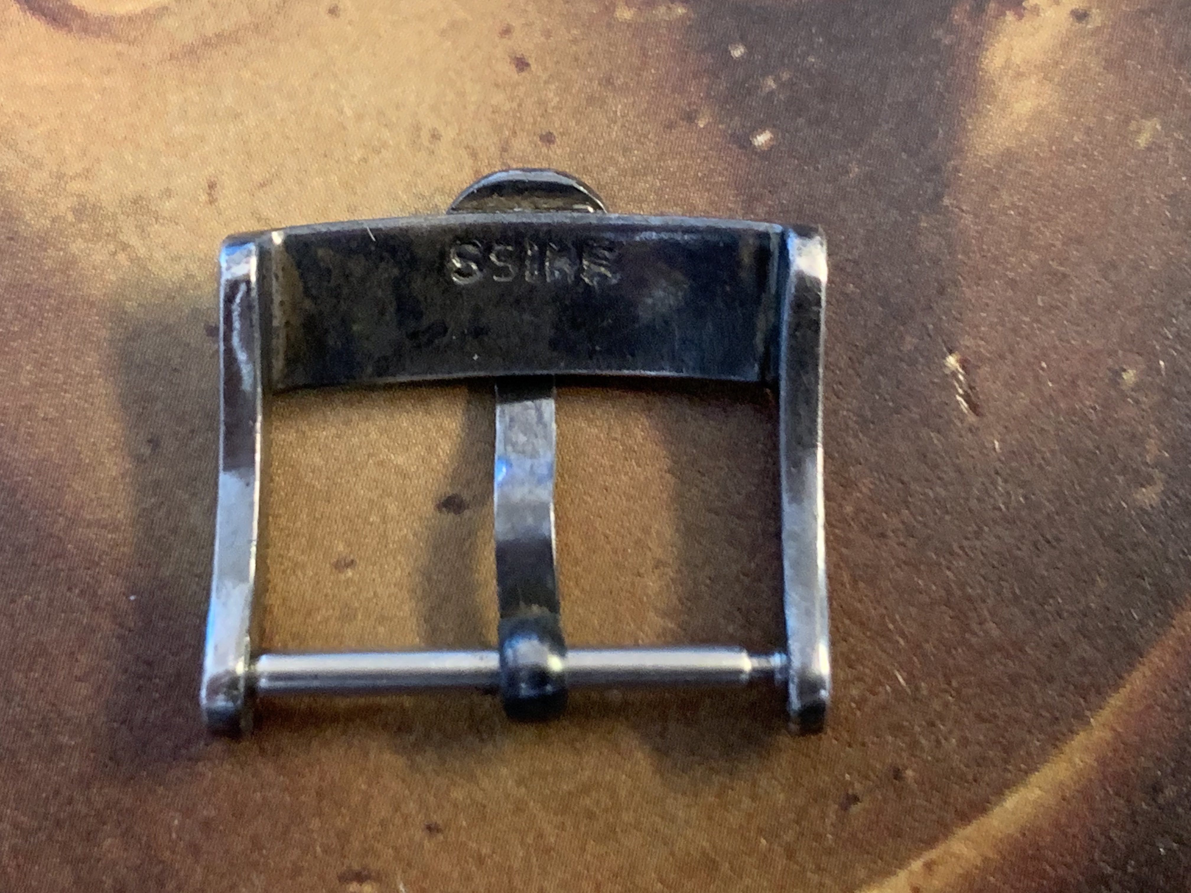

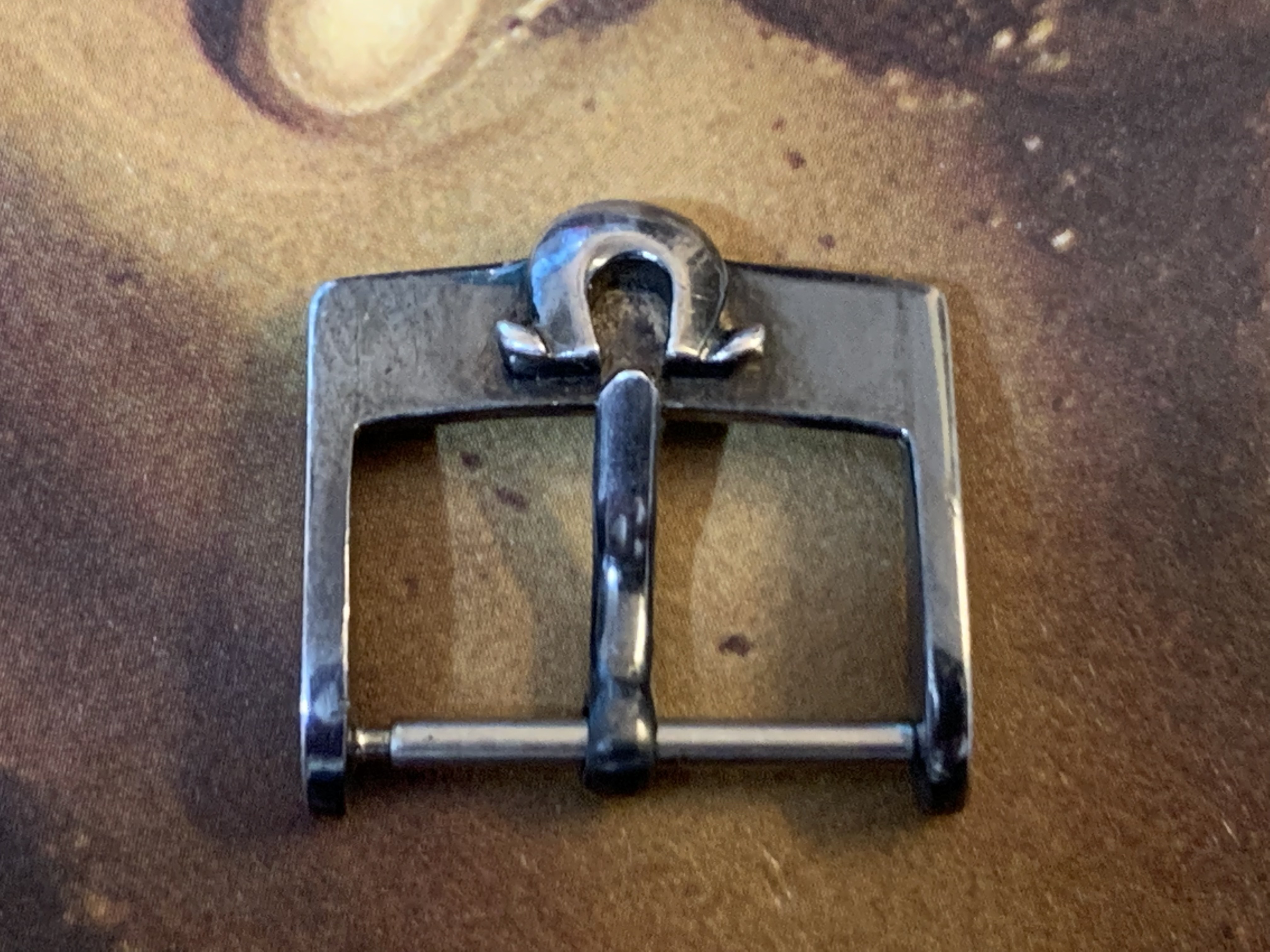

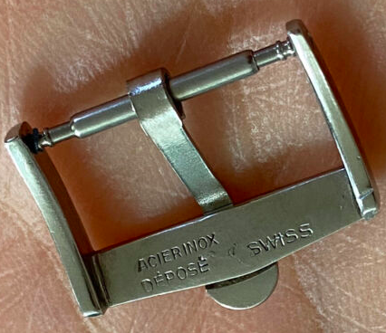

Hi guys, would anyone be so kind as to take a look at this buckle of mine? The engraving on the back only says “SWISS” with no indication of stainless steel. I have a feeling it might not be authentic but I am not 100% sure. It came with a 1950s vintage piece that I bought.
Thank you!
3,653
7,770
Sorry, I don´t read SWISS - it more reads like "SSins" so clearly not original Omega
13,491
31,809
Still fake.
5,631
5,815
If it is, it's one of the better ones. But you can buy the same thing brand new from Omega, so no need to seek dubious "vintage" examples.

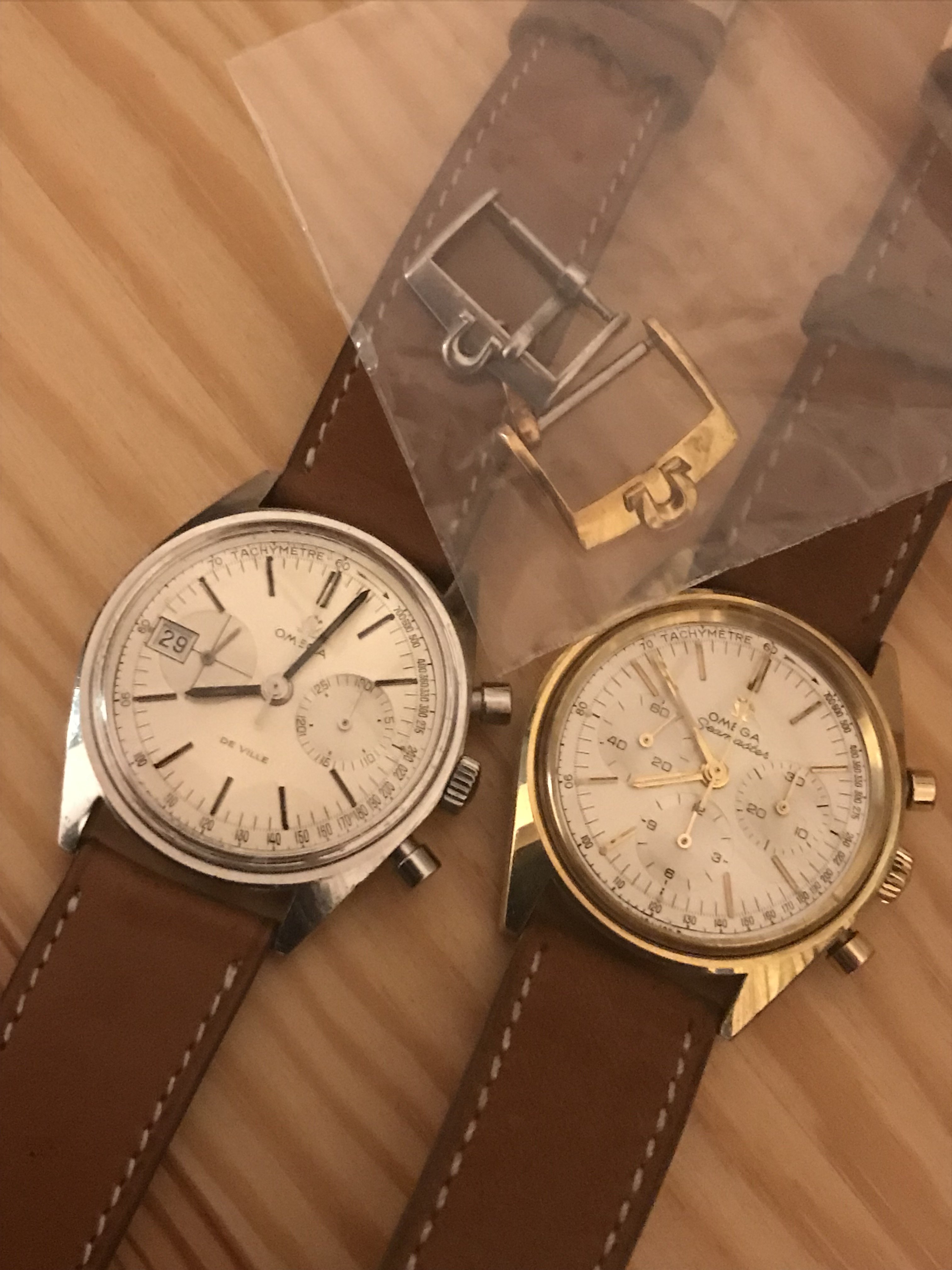

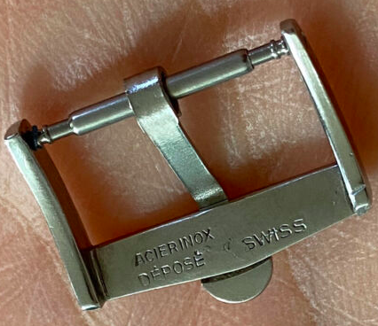

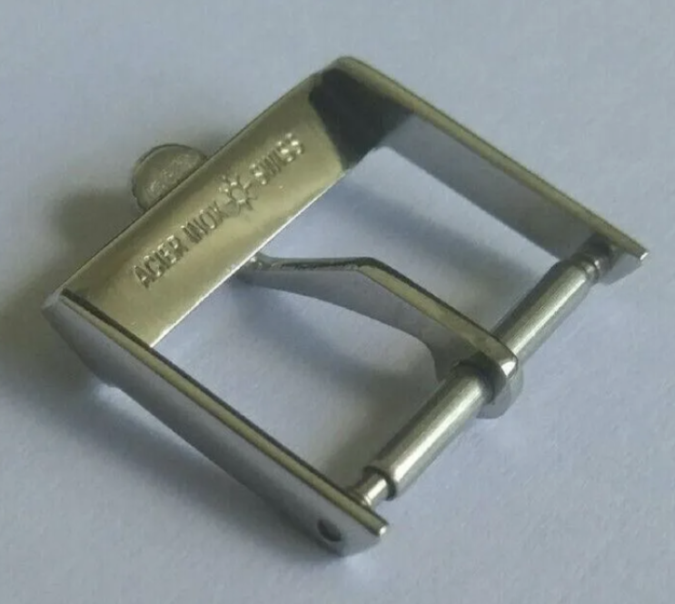

Hi OF,
I'm going to go for my first purchase of Omega Buckles. I intend to put them with some Deville chrono of mine a 145.018 in GF and a 146.017 in SS from 1969 (But if I realize later on they would be better fitting other decades... that will still be fine as I start to have a few watches to match with them).
My main question : are they both original ?
https://www.ebay.fr/itm/394243899087
https://www.ebay.fr/itm/394243847566
I can identify the GF one but can't see any sign on the SS one... What do you think ?
Thanks for your help.
5,631
5,815
The gold-filled looks OK. The stainess one, I have not seen that shape before. The tongue/pin seems legit, but that's all I can say about it.

Hi OF,
Looks like a hybrid of the "early" AW buckles. Same rectangle side profile. Hybrid meaning it has a long logo, on top of the "half moon" tang rest like the other one in the below images:
Evolution of AW. buckles
1,413
13,628

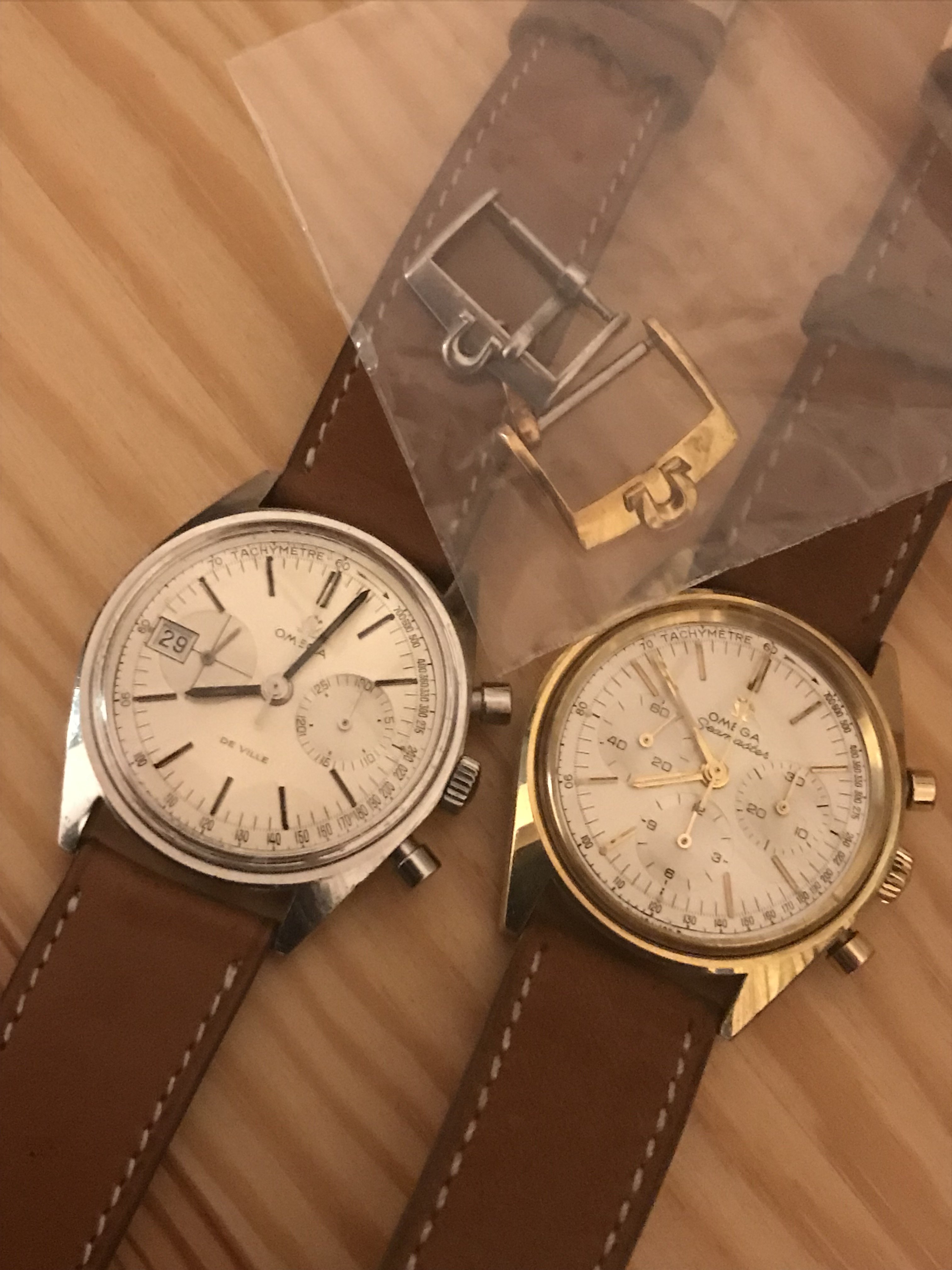

Thanks Everyone : they are now mine 😀 and they look ok to my eyes.
I'll have to wait for the customs straps to be made and come my way now 😀
Sorry for the bad picture 😀
Thanks for this thread and for the personal answers
243
751

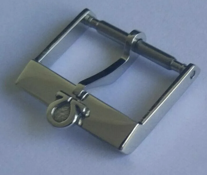

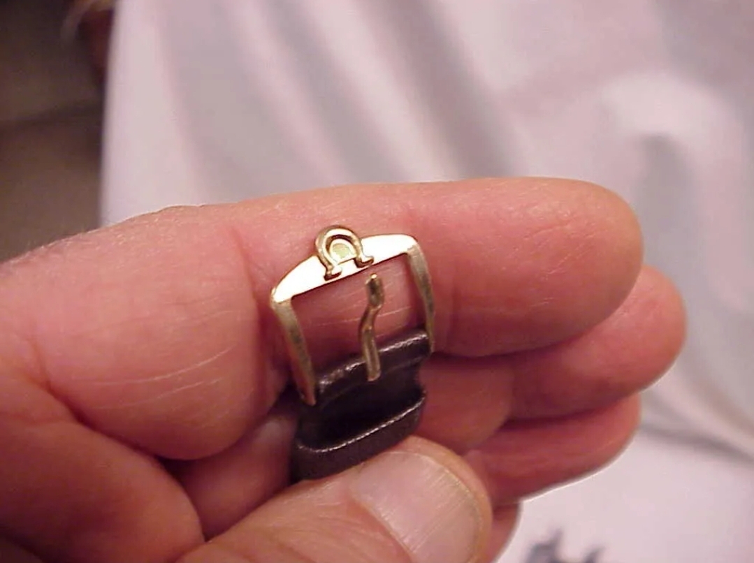

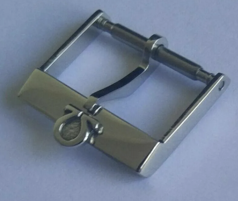

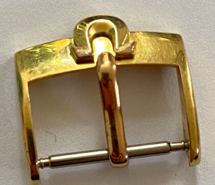

Looking for a SS buckle for my new 64 pie pan and I was directed to this one ... Seems alright?
1,193
6,193
It looks genuine to me. I may be wrong, but it would have been used in the later '60s or very early '70s.
883
1,773
This looks nice but probably fake
Looks like a genuine buckle made for the American market. Does it have a tiny "Omega" engraving on the right side in the back?

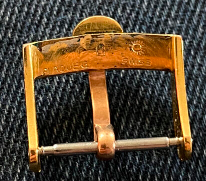

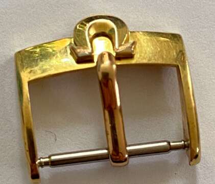

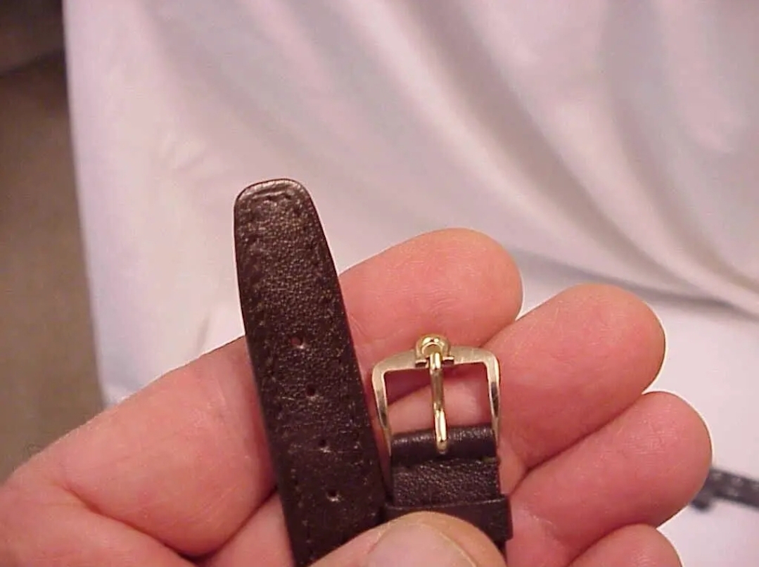

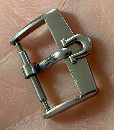

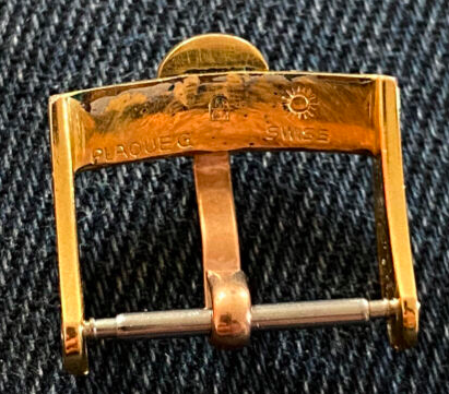

Found this gold plated 16mm ... The back side looks ok but the profile of the Omega seems more rounded when the pics I've seen in the thread appear more flat. Thoughts?
https://www.ebay.com/itm/254560474895
13,671
19,041
IMO, that one is a cast copy with modern engraving underneath.
As the supply of original buckles dries up and Omega discontinuing their line of vintage looking buckles, I think we can expect more of this kind of item to appear.
gatorcpa
2,078
4,246
gatorcpa
Yes, without the vast repository that is this thread, it's easy to believe these sellers have legit products. Once it's compared to absolute known good examples, it's the finer details that make the difference. It felt off to me too after looking at several pages in the thread so I appreciate the backup look.
