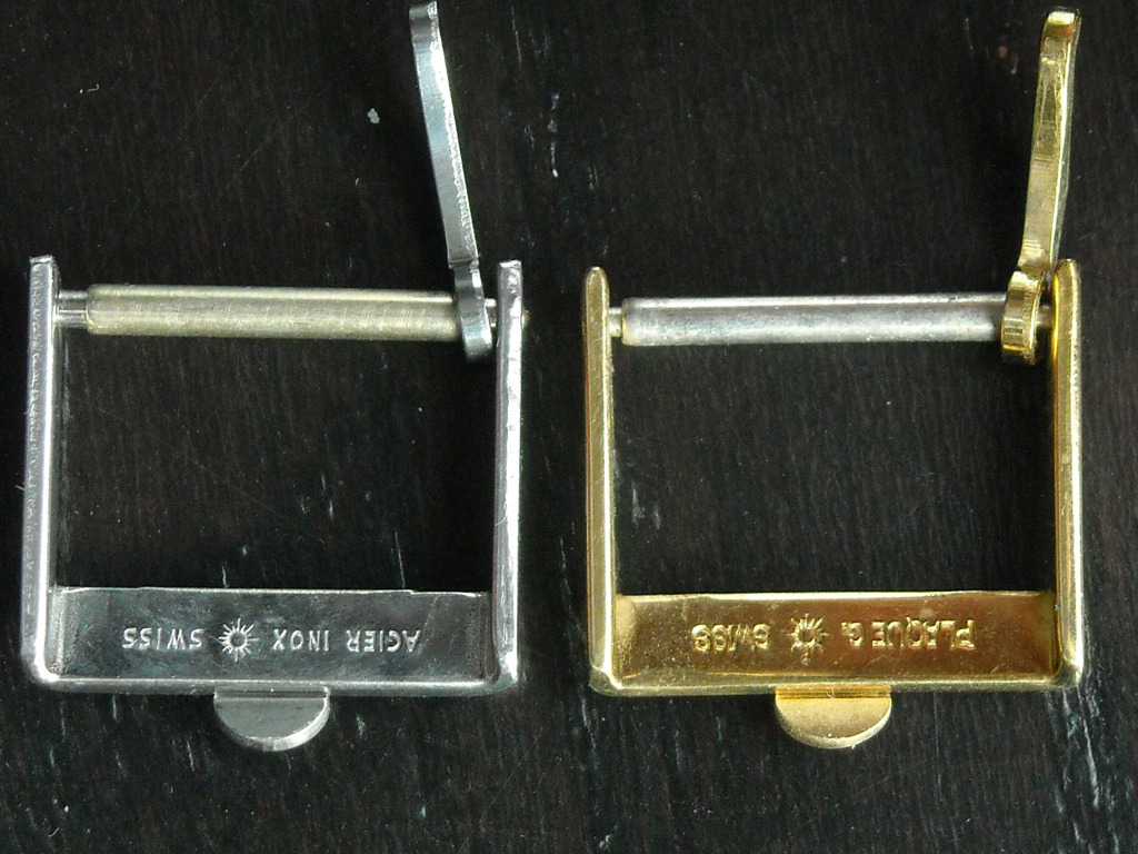

Thank you for answering. I'm trying to figure out how common was for vintage watches with solid gold cases to come with plated buckles. Is it because solid gold is soft?
9
Mine is solid 18k cáe but what does it has to do with the buckle’s originality?
I was under the impression that solid gold watches required solid gold buckles. But I was wrong.

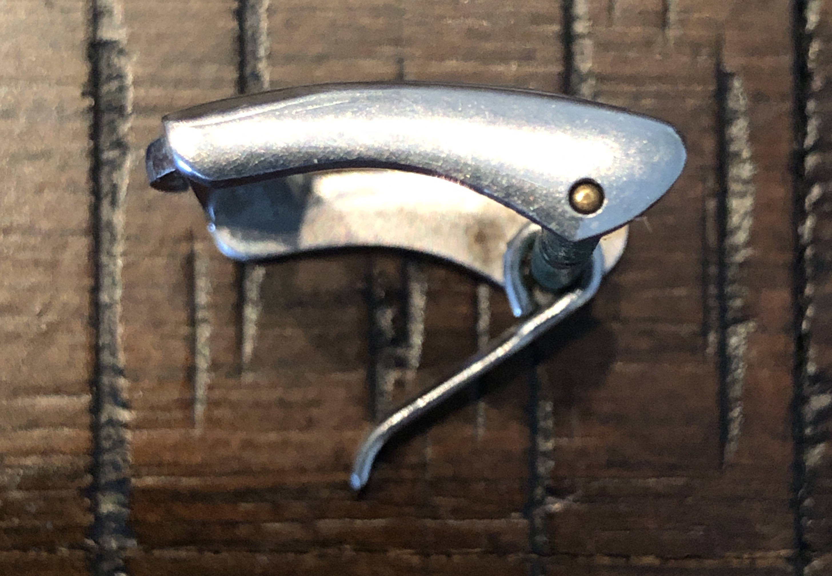

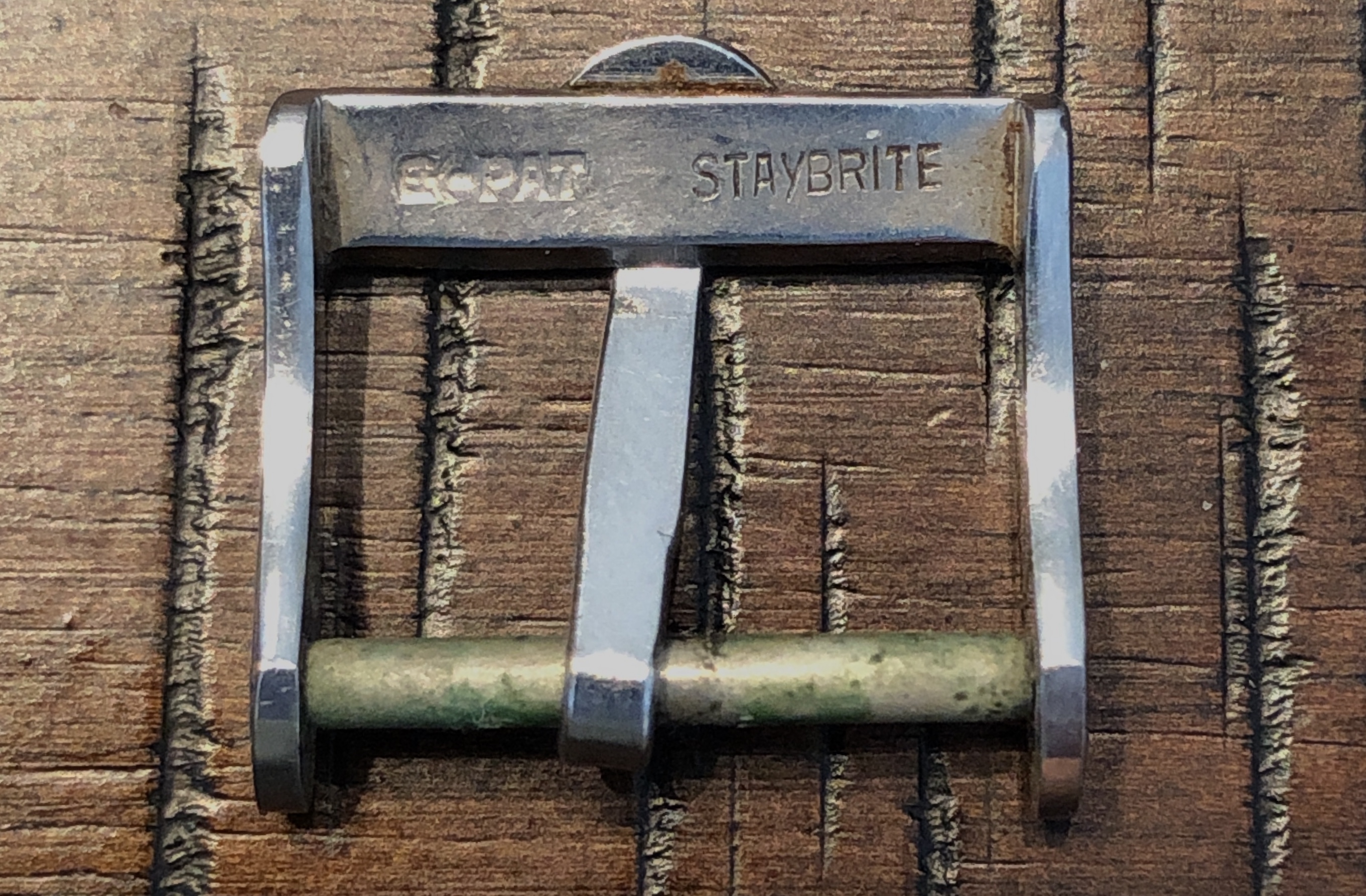

This buckle came on a watch I purchased recently. After a look through this thread, I didn't see anything about the "Staybrite" marking (although it's possible I missed something in the 500+ posts) I did see a "taybrite" buckle and this thread about a buckle that looks pretty much just like mine: https://omegaforums.net/threads/omega-buckle-from-50s.100011/#post-1306271 which has the same E.K. and Staybrite markings.
Let me know if you see any issues here. Hoping to clean it up and put it on one of my straps!
2,326
1,887
Looks good to me. Omega is also including these buckles with straps included in the 57 versions, which can also be obtained separately.

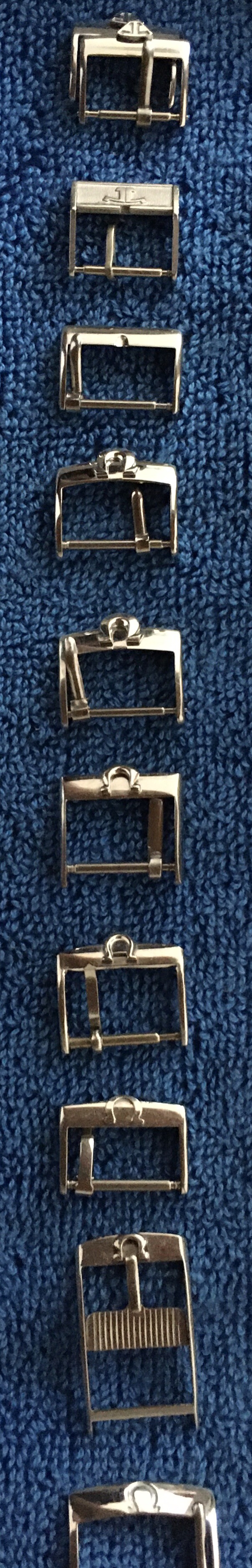

3.Older style MG.
Wonderful information. Than you for the work you put in.
brian
Note how the older style Omega symbol is much thicker
4.Old style MG.
Evolution of MG. buckles
Older style AW.
Old style AW.
Evolution of AW. buckles
5.Special EK.
8.Later B.
9.Even later B
Well, I think that's all folks.
I hope it will be usefull to someone.

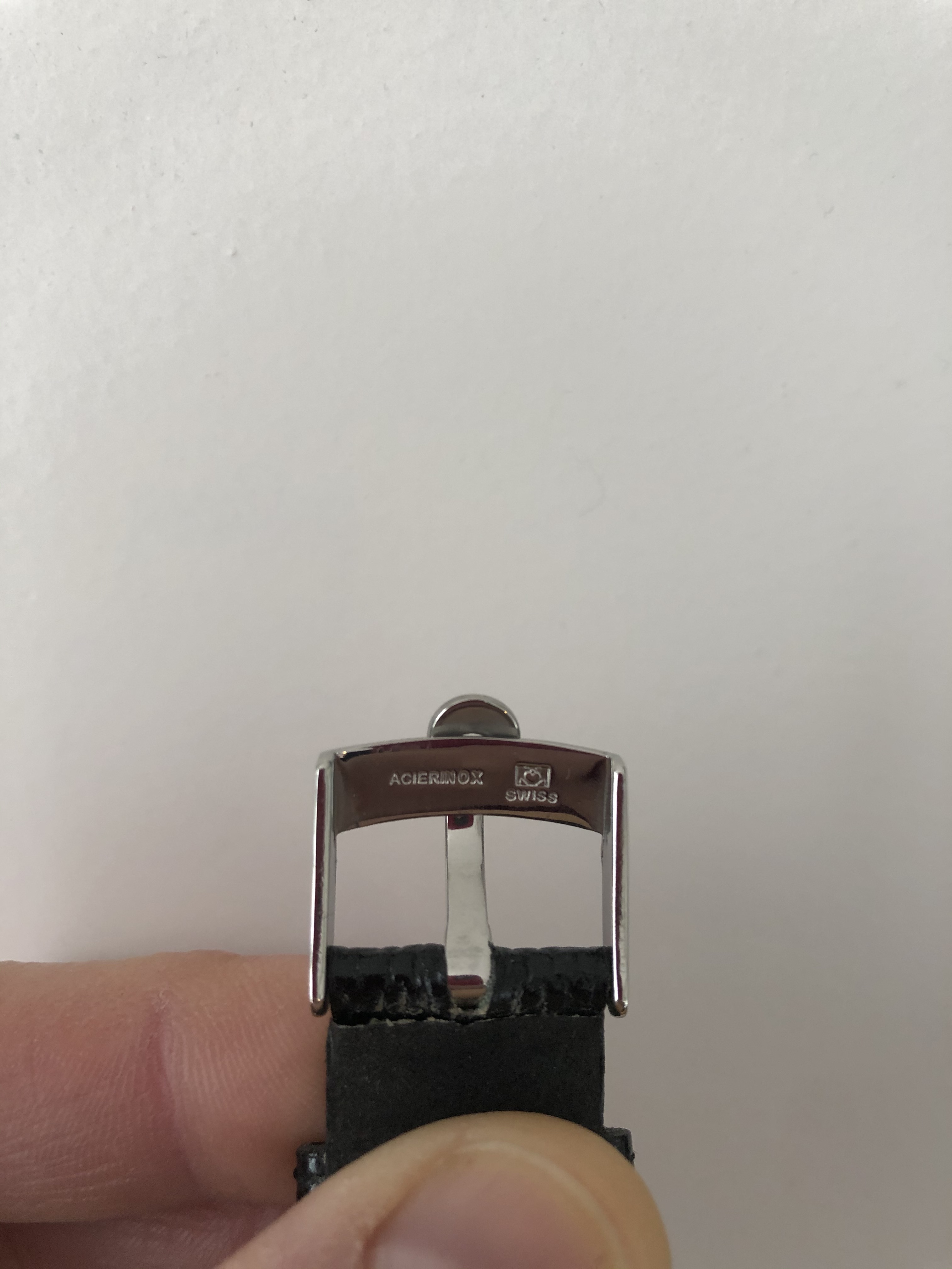

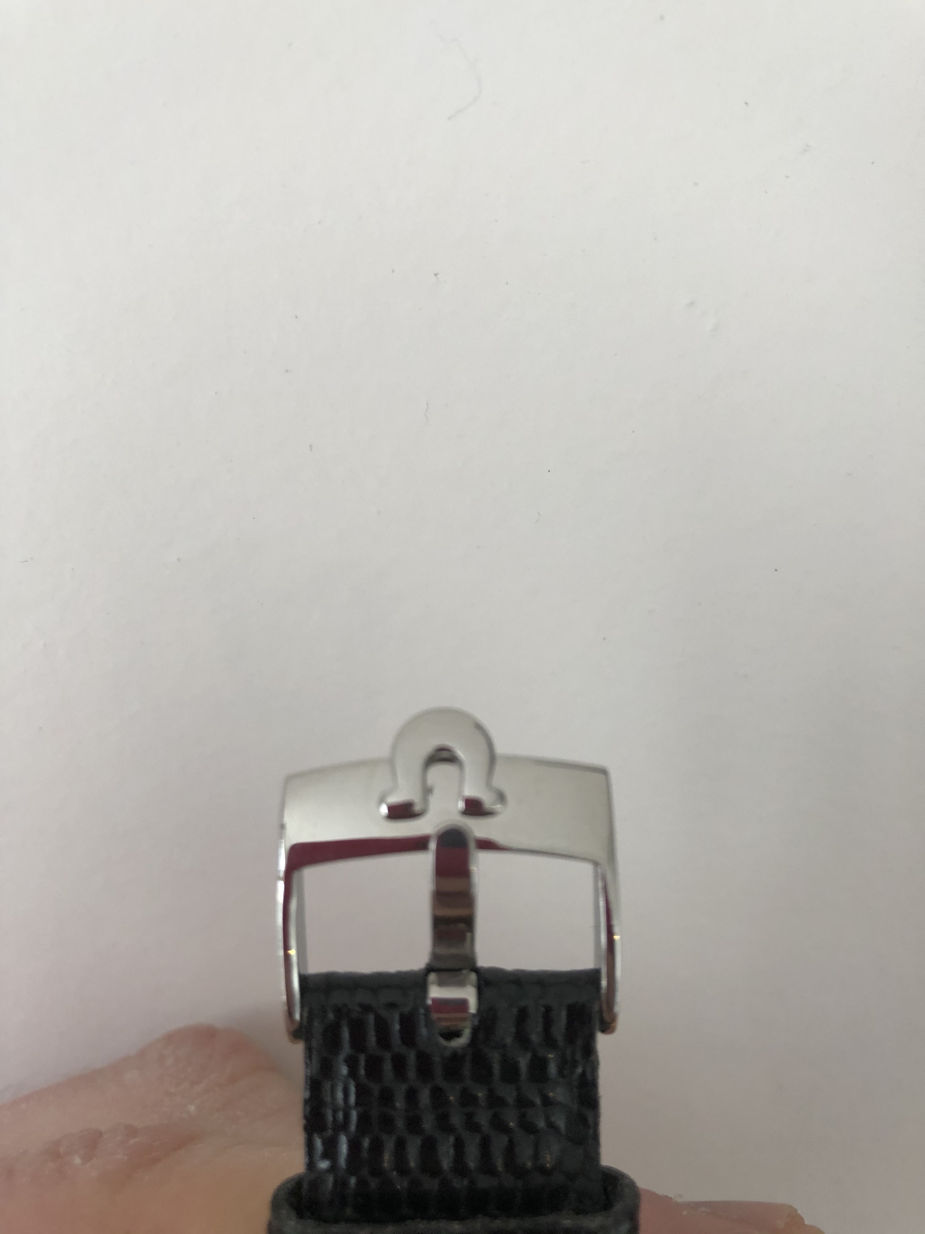

Hi guys,
I think I already know the answer, but I just want to be sure as I'm not an expert.
Could you please tell me if this omega buckle is genuine or fake (got it from a trusted UK watch dealer) ?
I would really appreciate your help.
Thanks in advance,
Ludo
2,326
1,887
Total fake. The flat, mushy symbol is also a clue.
Omega is selling new buckles of this type, by the way. Buy direct!

20
7

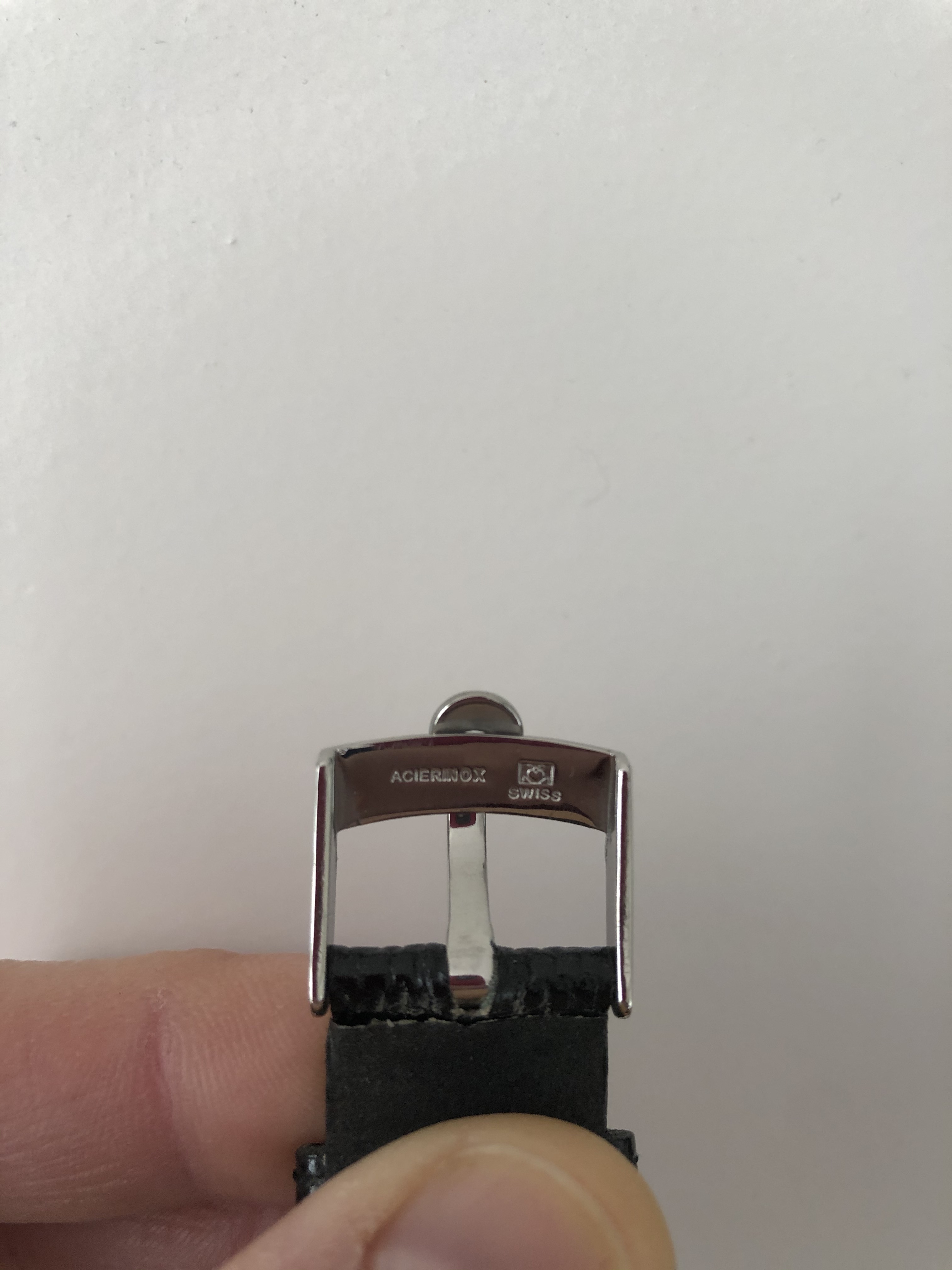

Hi guys,
Thanks in advance,
Ludo
A lot of information can be found on the first pages of this thread. Incredible job by @omegastar. It helped me a lot! Good luck with the search!
32
9
That's what I thought... Thank you guys for your input.

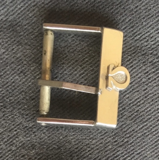

Can I ask you if you think these are genuine as you seem to know your subject (for me, they are... I read several time the beginning of this thread and the good work of @omegastar) ?
Thanks again
Lud
1,208
5,038
Thanks for your response Tom ! Very interesting ! Yes they don't have the 16 mm buckle, but I will find one (I know Cousins in the UK sells recent Omega buckles that are legit).
Yes for sure, a logo buckle is not an obligation, but I just don't want to stay with this fake one !
Thanks again
Lud
The laser engraved markings give it away as a fake. Finding genuine vintage buckles is a waiting game. Good ones pop up on eBay once a month from what I've seen (if the seller has 100 of them available, its most likely fake) so check daily!

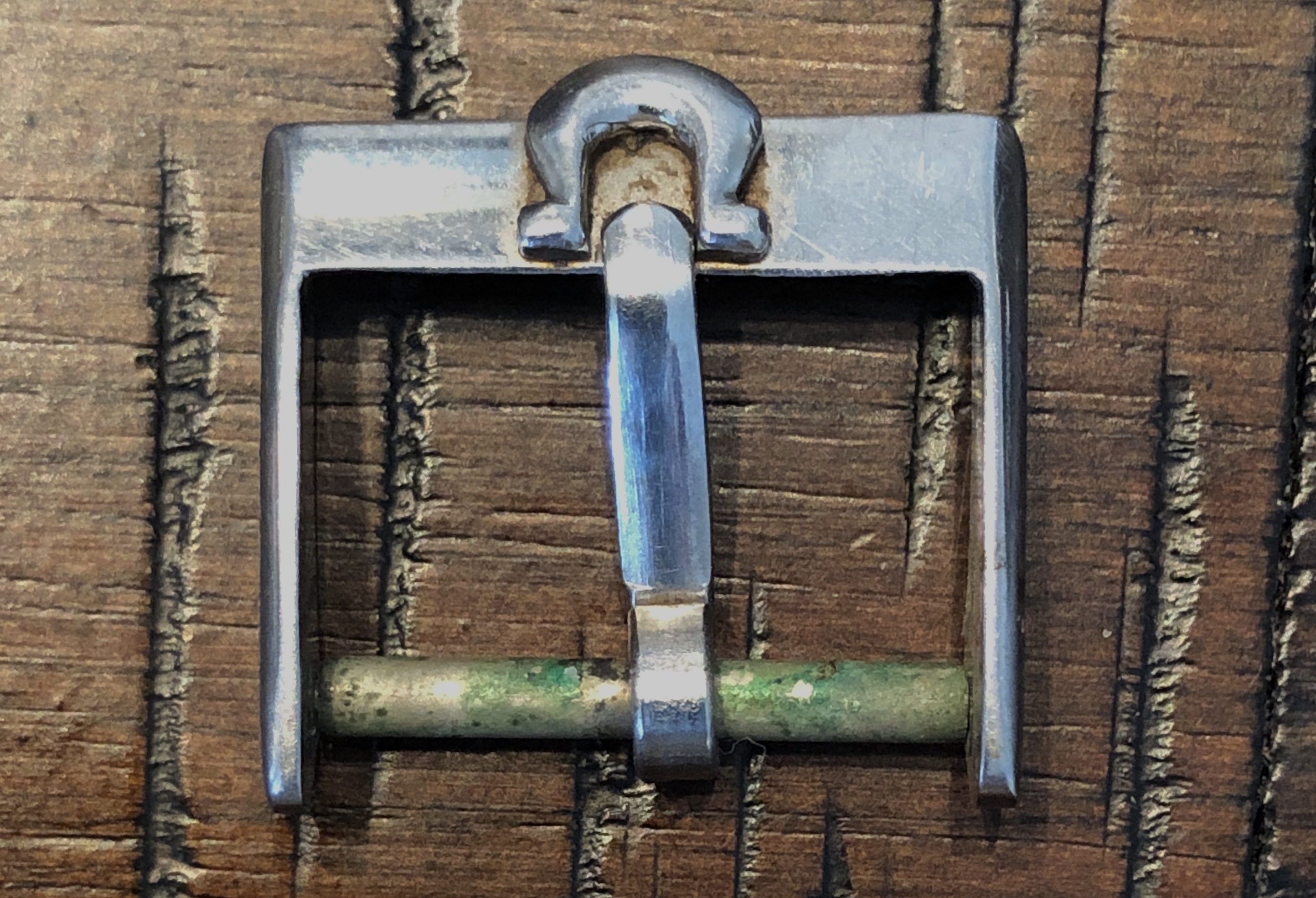

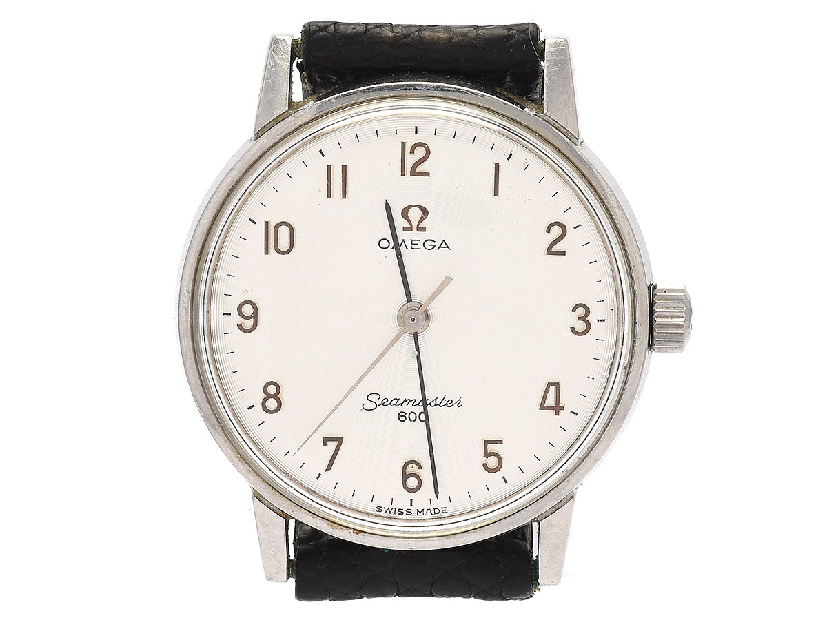

Great thread! What a wonderful read from top to bottom.
I recently bought a SM600 concentric dial (ST 135.011, Cal. 601, 1965). No original strap, buckle nor box, though.
Do you happen to know which buckle might be period correct for my watch?
My Google image research indicates the following:
* Buckle
(a) special buckle by EK a.k.a. dynamic buckle (stainless steel),
5.Special EK.
(b) some oblong buckle (stainless steel) by MG, or less likely by EK.
Have any of you owned SM600 concentric dial watch, which had had a period correct buckle? Are the buckles similar to other Seamaster's of mid-60's?
@omegastar , what are your thoughts on this?
