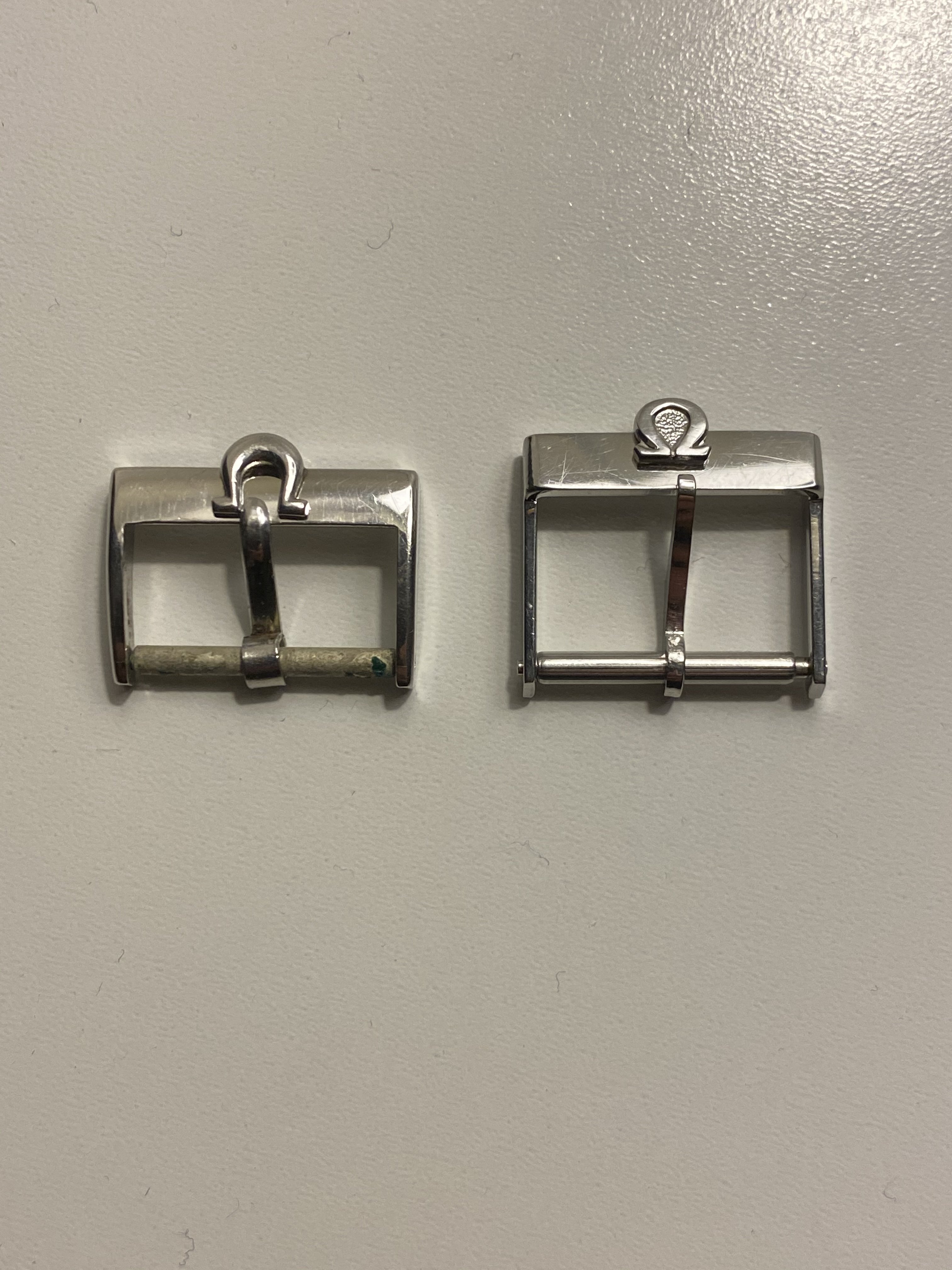

I acquired these two recently. Left seems original, what about right?
They came from Japan along with a watch on a 30 marked 1037 bracelet. It seemed like a barn find situation but definitely possible a fake found it’s way in.
I’ve managed to accumulate quite a few buckles and straps now so will post them at some point.

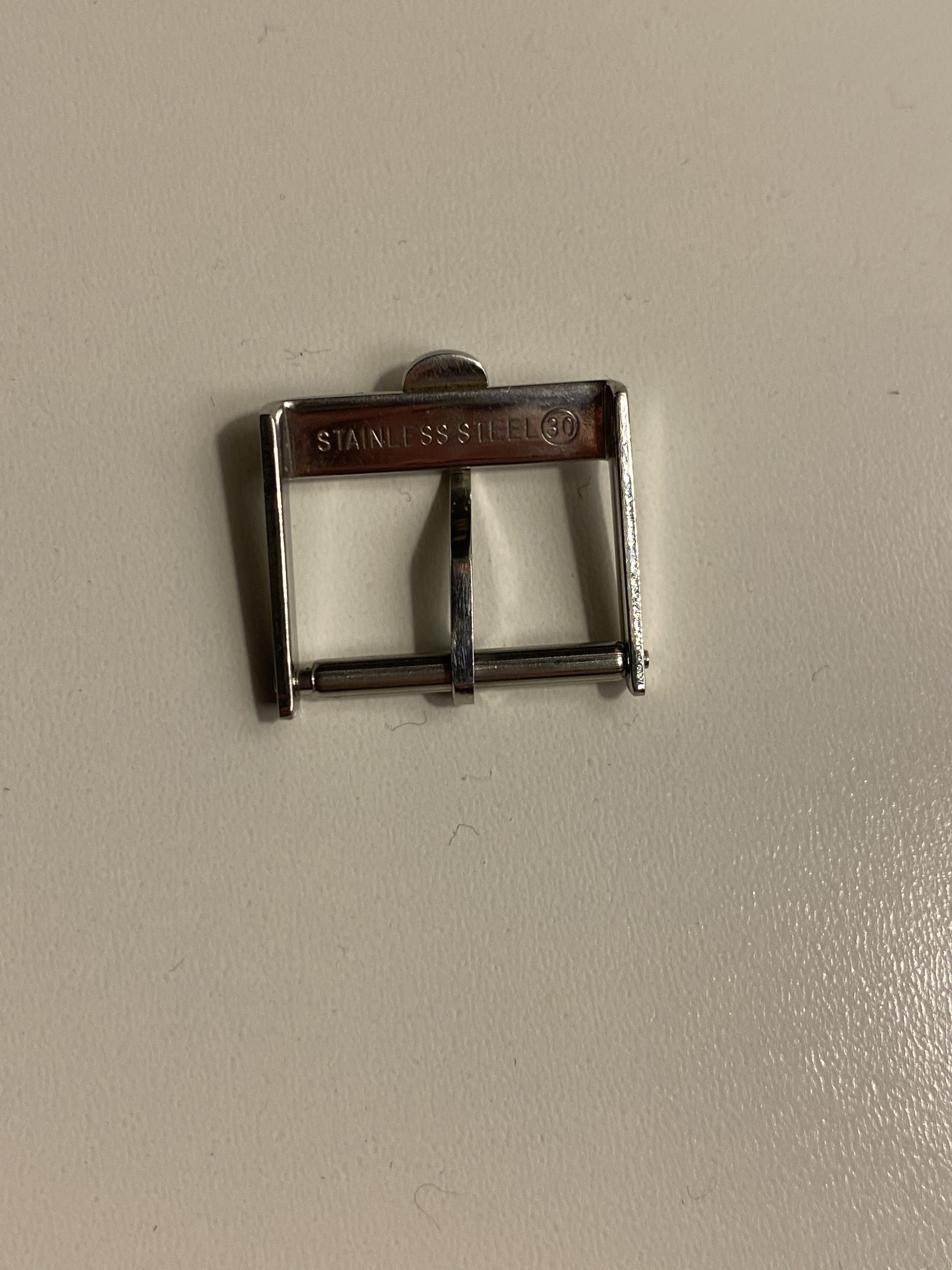

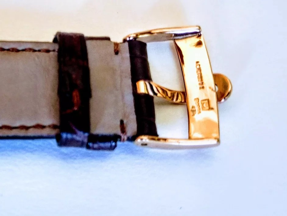

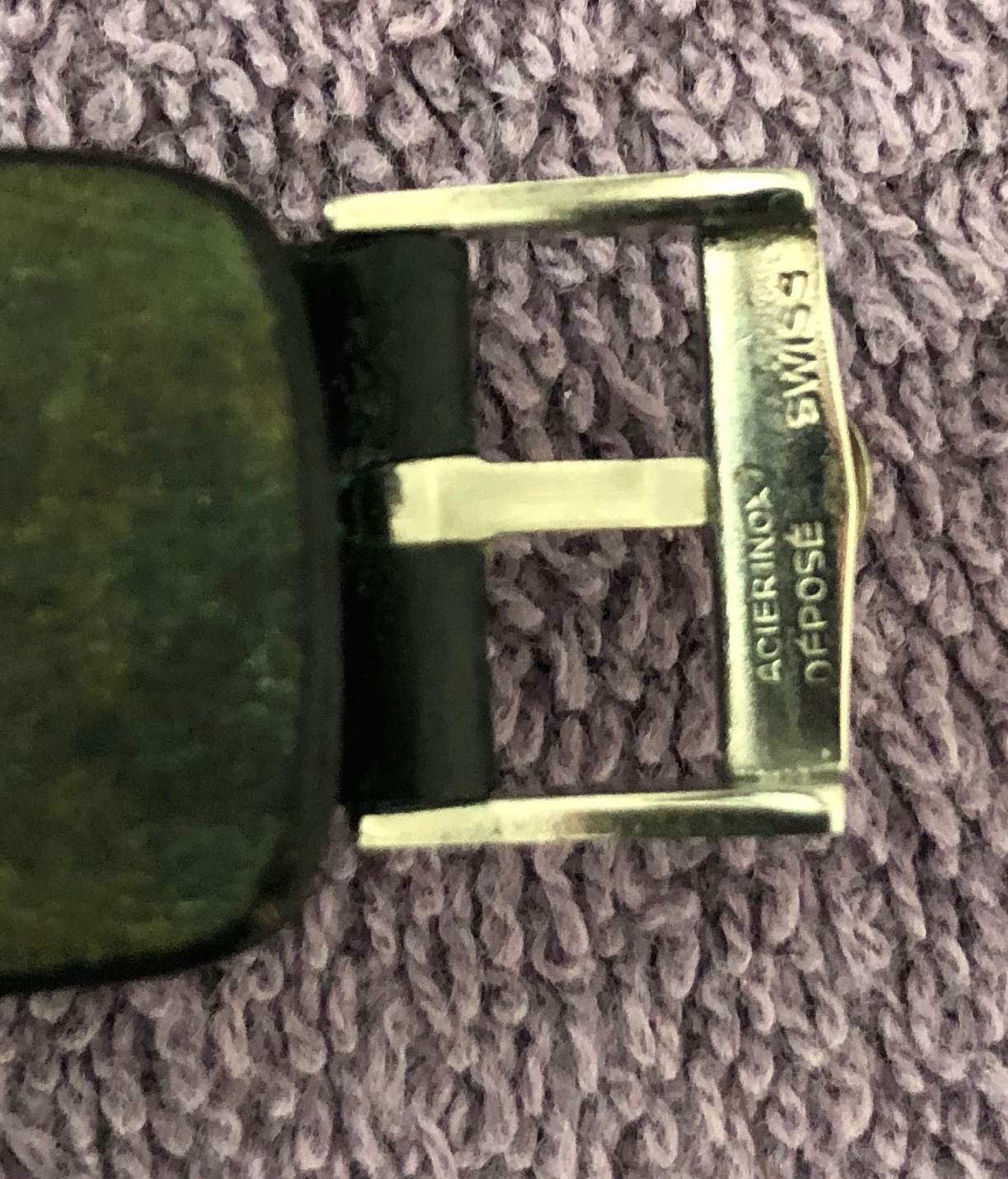

Found a strap with buckle for sale. The buckle attached to the supposed Omega strap looks a little different compared to what i have seen before. I cant really tell what the inner engravings on the left says. Is it a fake?
Acquired the same 14 mm steel buckle last summer from Watchadoo on eBay.
I believe it's authentic, but would also like to hear from the experts.

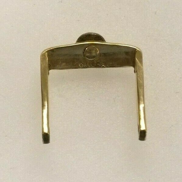

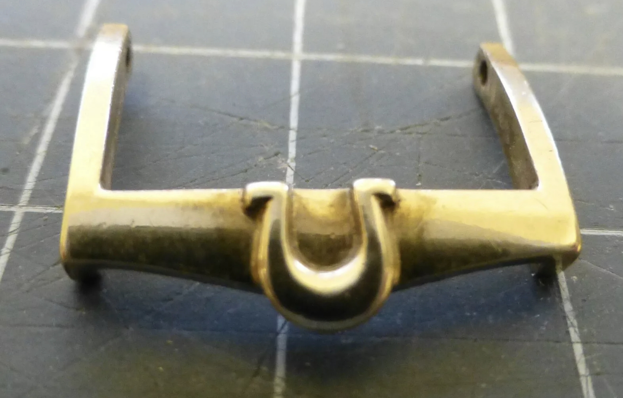

Can anyone tell me if this is legit?
It is not legit. First and easy giveaway: "ACIER INOX" means "stainless steel" and this buckle is gold plated 😉
Second: Look at the "molten" appearance of the Ω symbol. That soft shape shouts "fake".

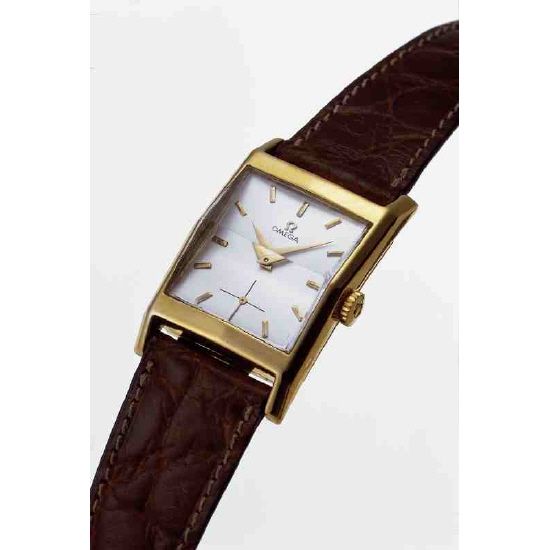

Thanks. Now which buckle should go with this watch?
1,719
7,387

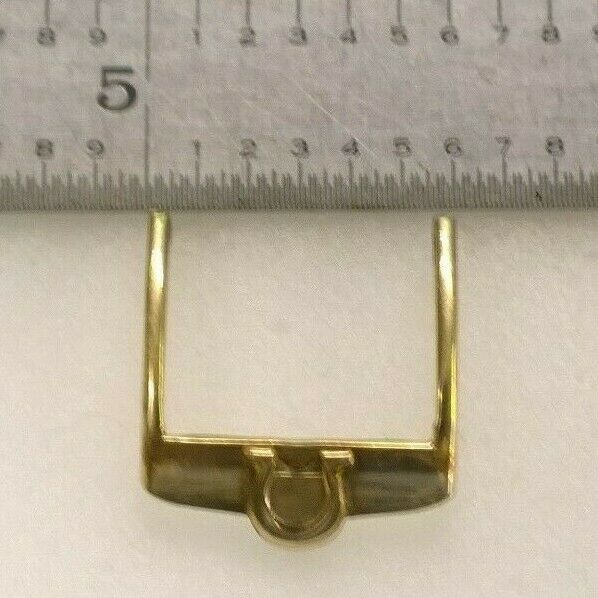

I would use one like this. At the moment on eBay but seller only sends to the UK.
2,326
1,887
The generic-looking buckle without symbol. Logo buckles weren't prevalent to the later 50s and that also varied by country of sale.

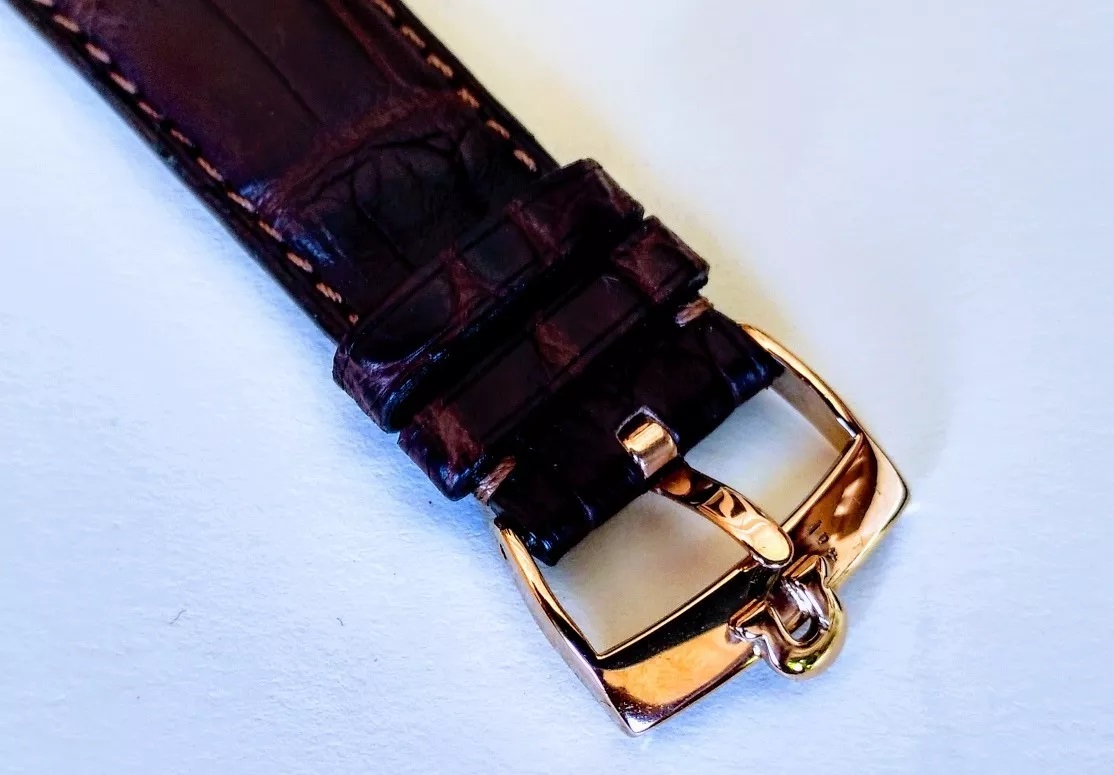

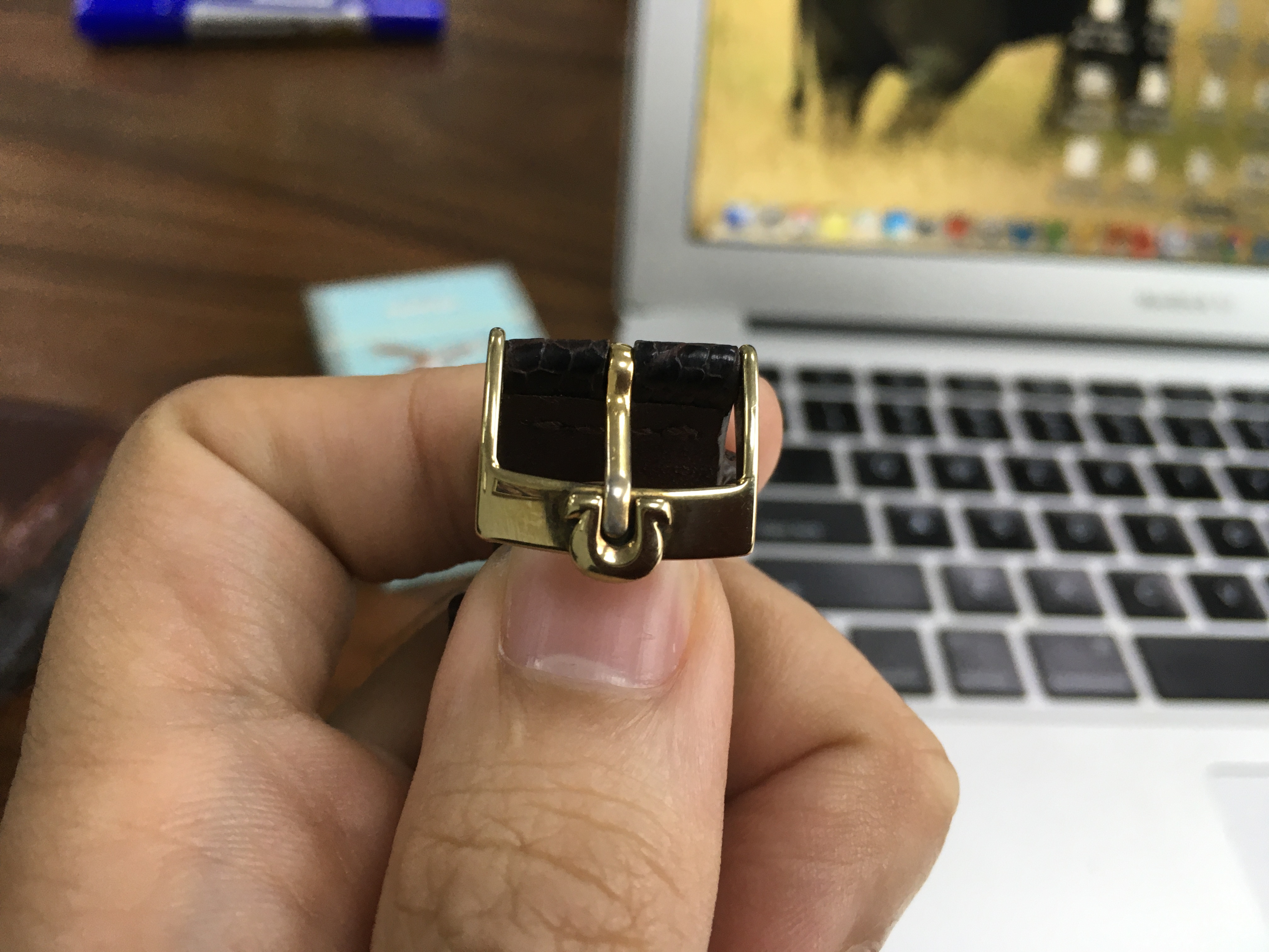

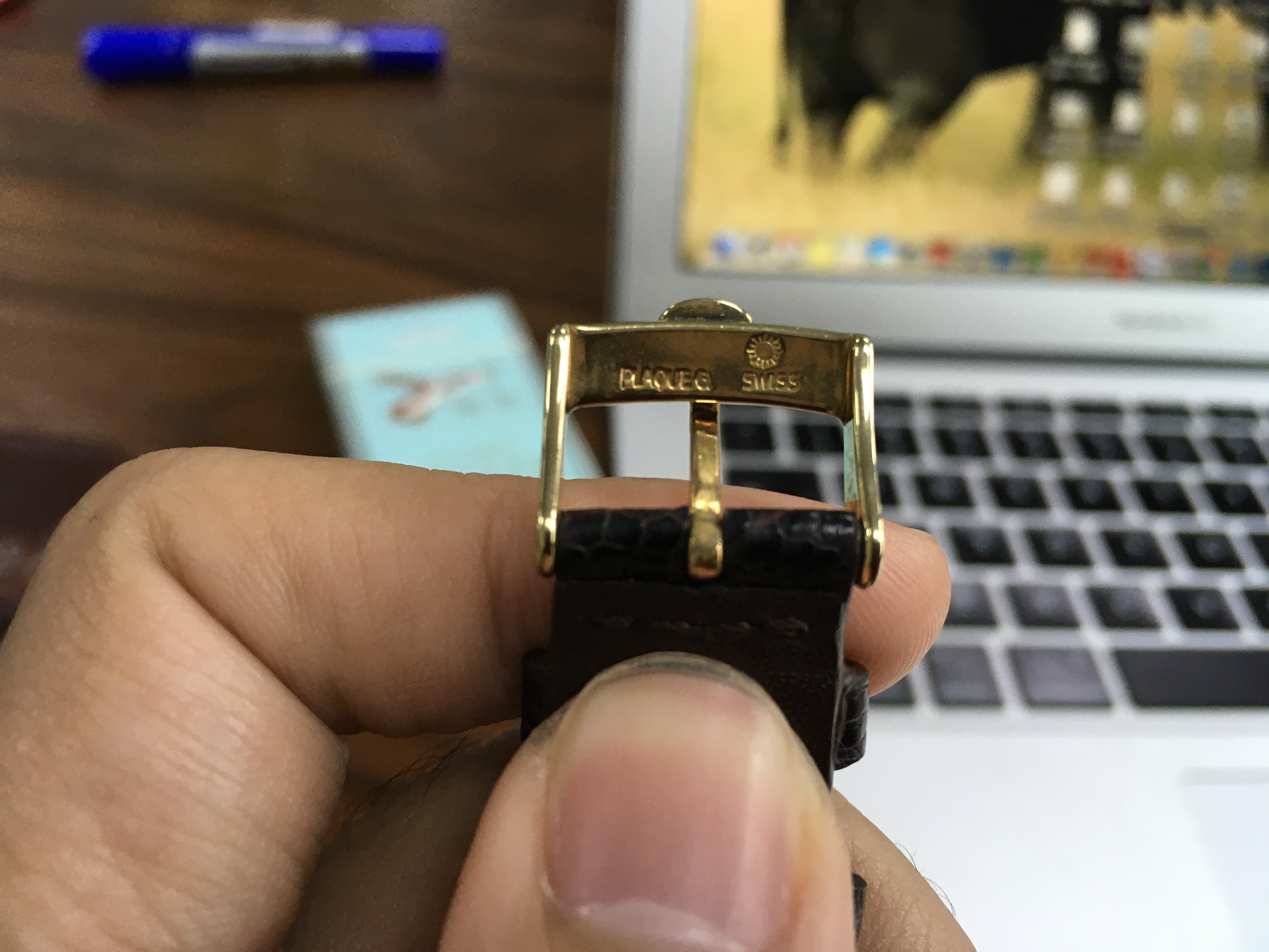

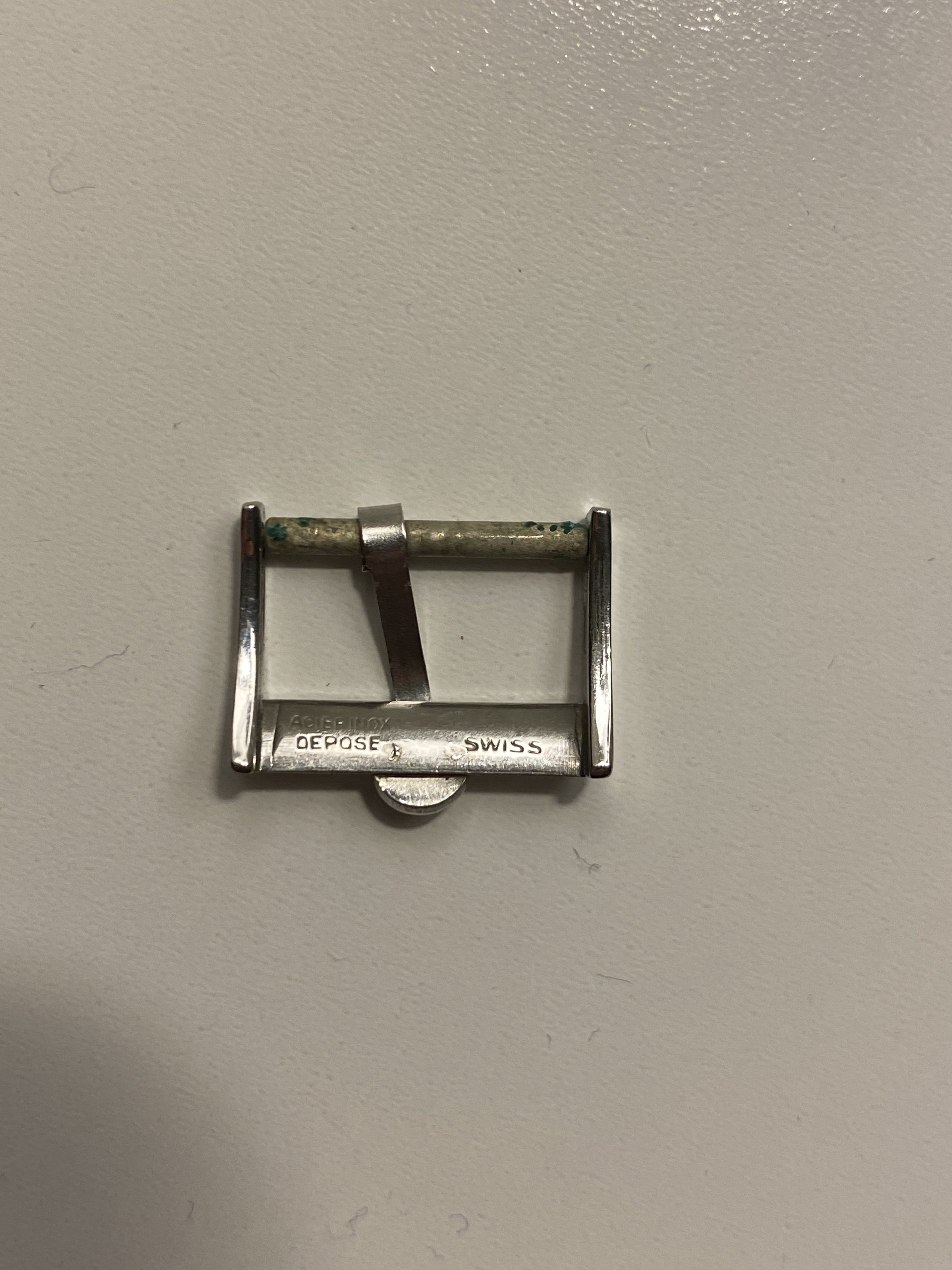

Always a headache to me when it comes to buckles. According to OP, this one look like an original gold plated MG, is it? Thanks guys!
9
Is your watch solid gold or gold plated?
