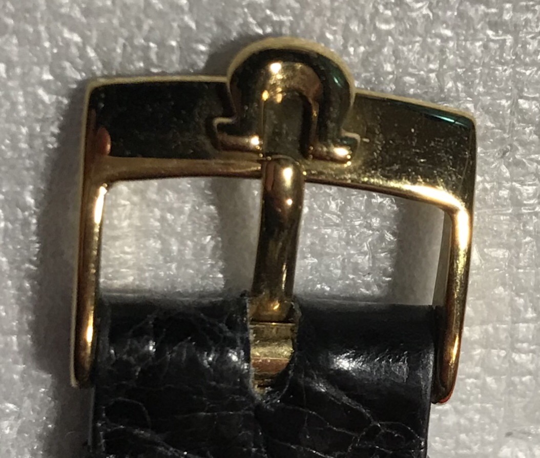

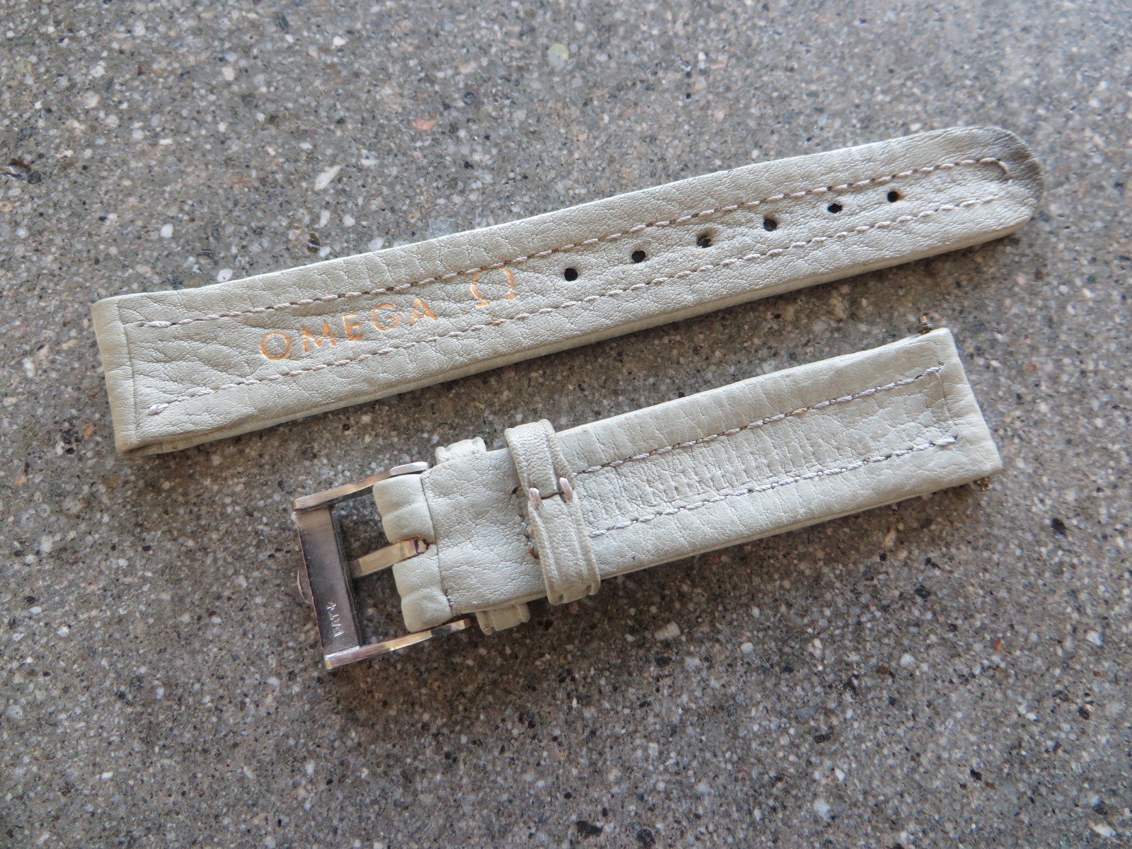

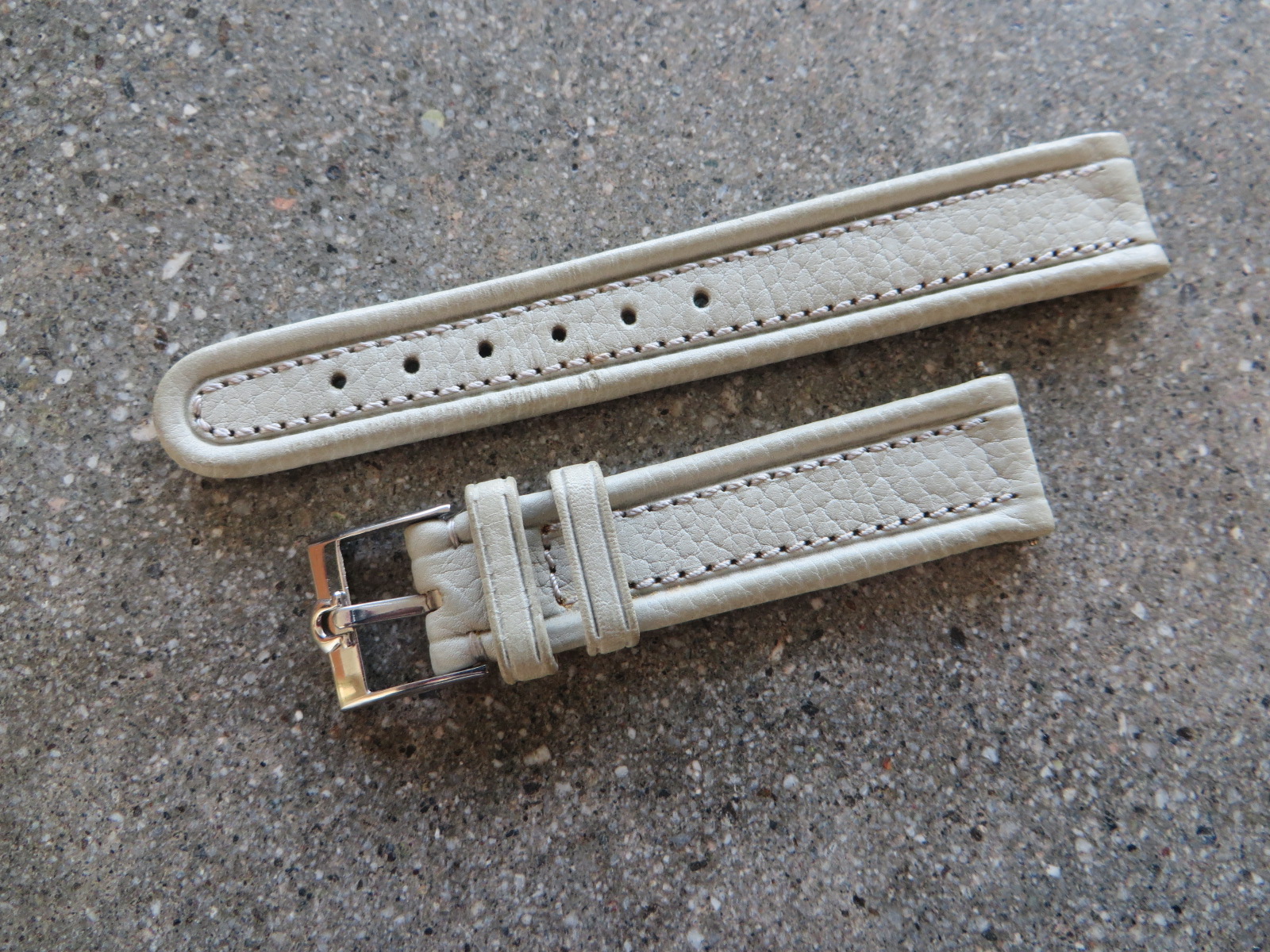

Judging by the last example shall I assume that this 16 mm buckle is also fake?
13,671
19,041

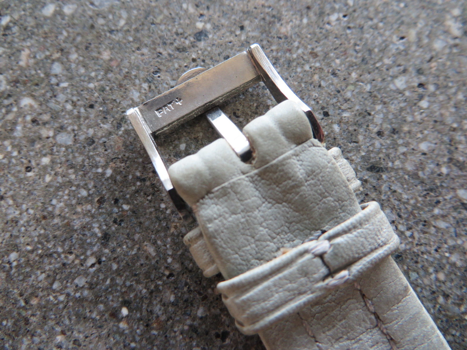

Not sure about this one.
The words and logo are correct, but font of engraving is different than those I’ve seen.

Thanks @gatorcpa. Anyone else?
Unlike @Aryen ’s example, the sun’s rays on mine aren’t symmetrical much like a genuine buckle.

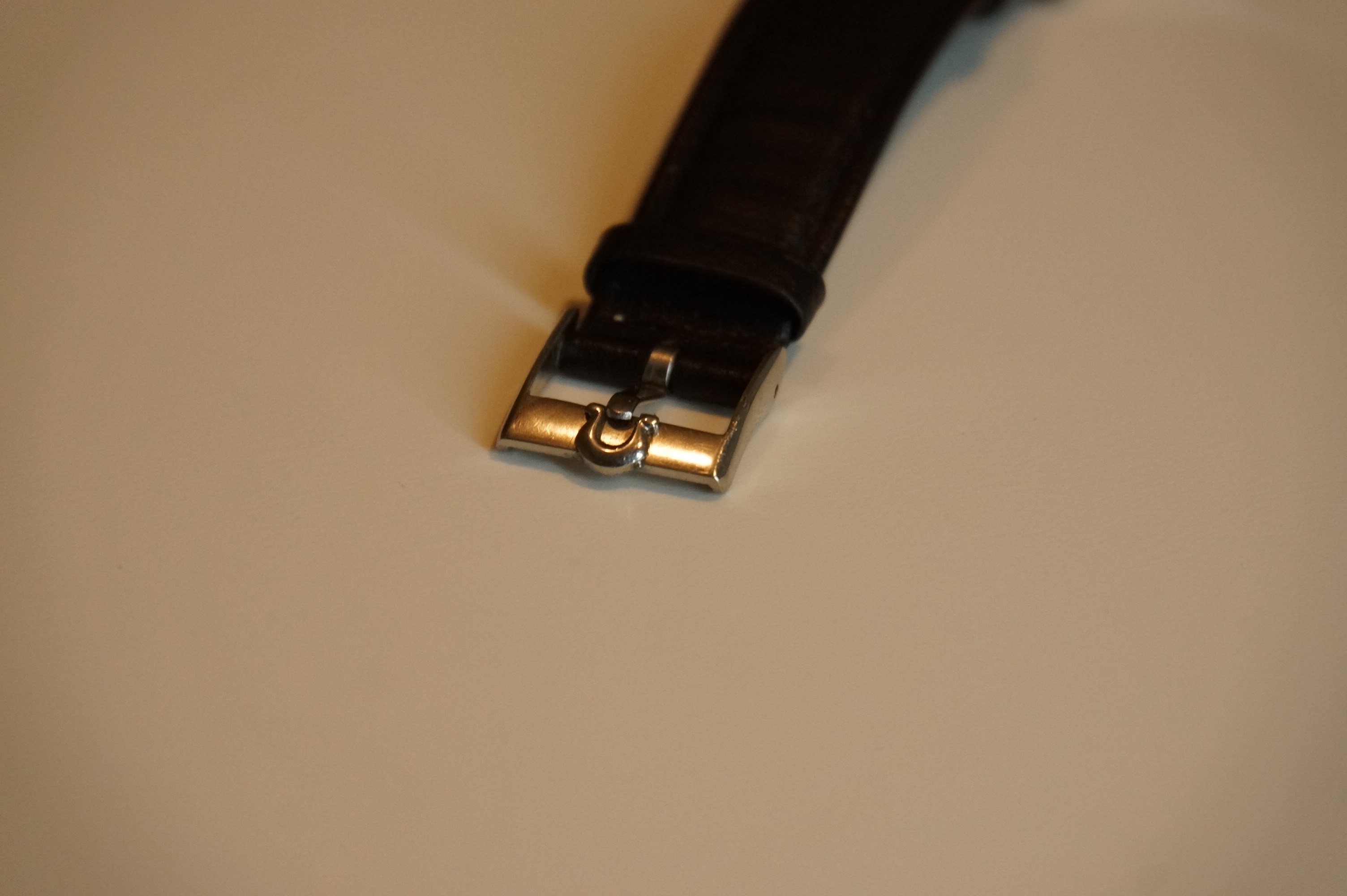

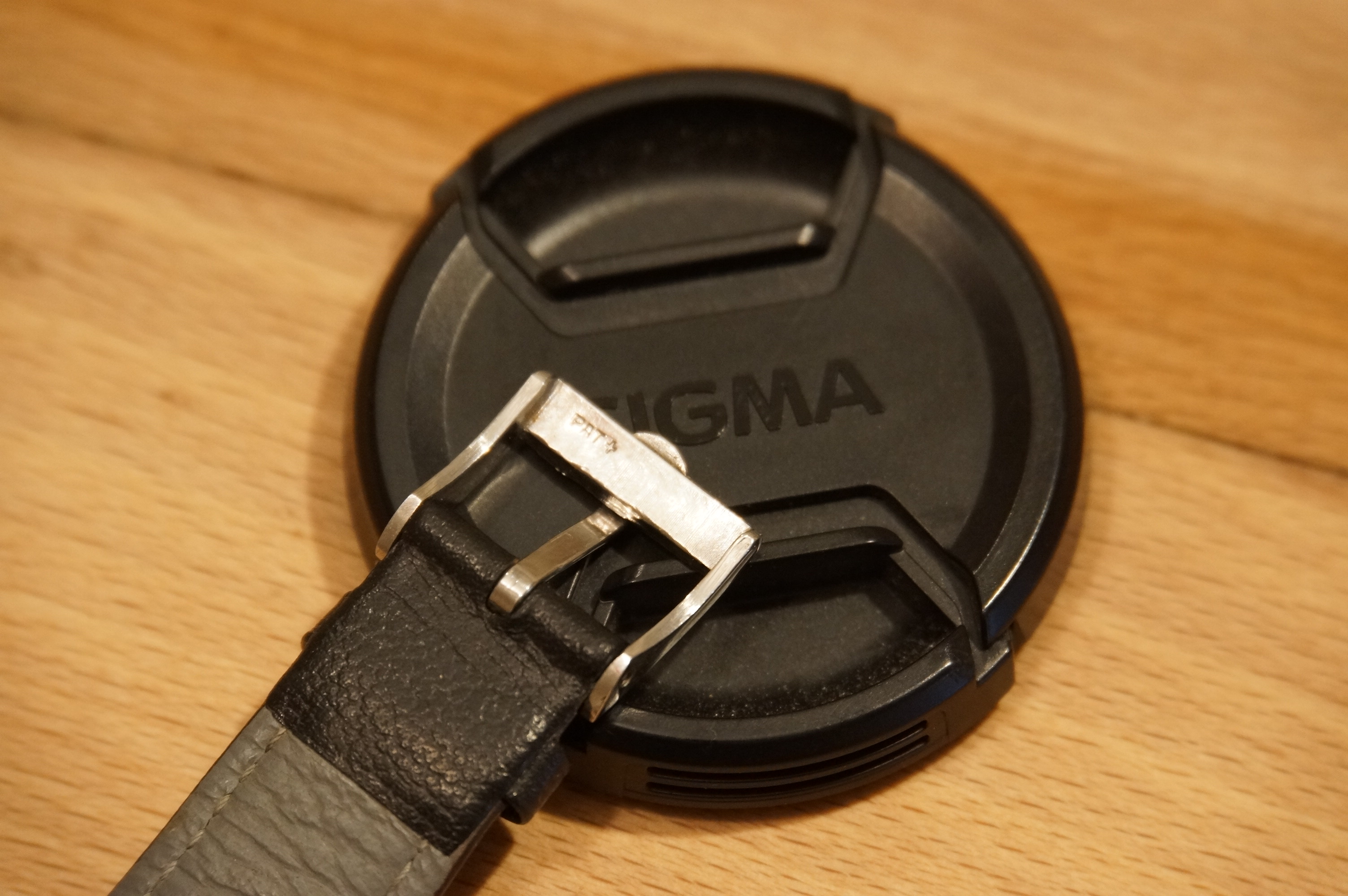

Hello, guys,
i bought this buckle a while ago, but can't find it in this article.
Fake or not, what do you think !?

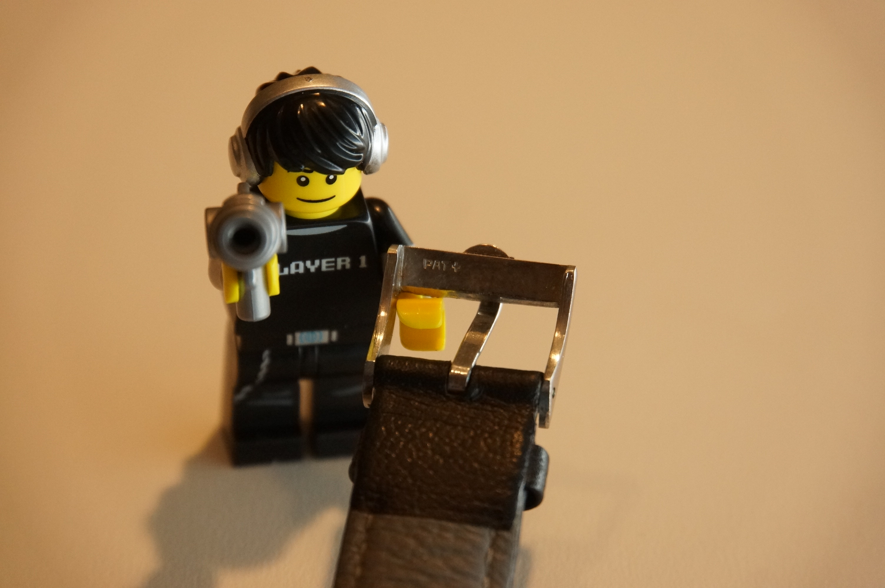

Be careful, Mr. Lego shoots sharply 😁

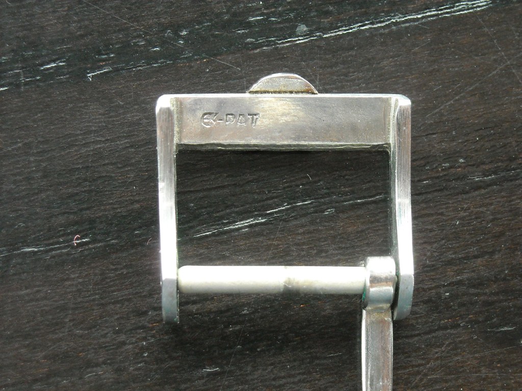

Hello, guys,
You’re not paying attention man...
There are so many exceptions and that EK. buckle that annoyed me a lot because it broke all my theories, but you always need exception. I believe that early buckles were not signed properly or nobody cared.

Thanks for your answer !
So i can say approved !!
Thought it could be usefull to add to your thread !!!

Picture and text come from the thread !
You are not paying attention...

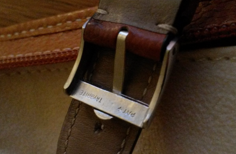

2,326
1,887

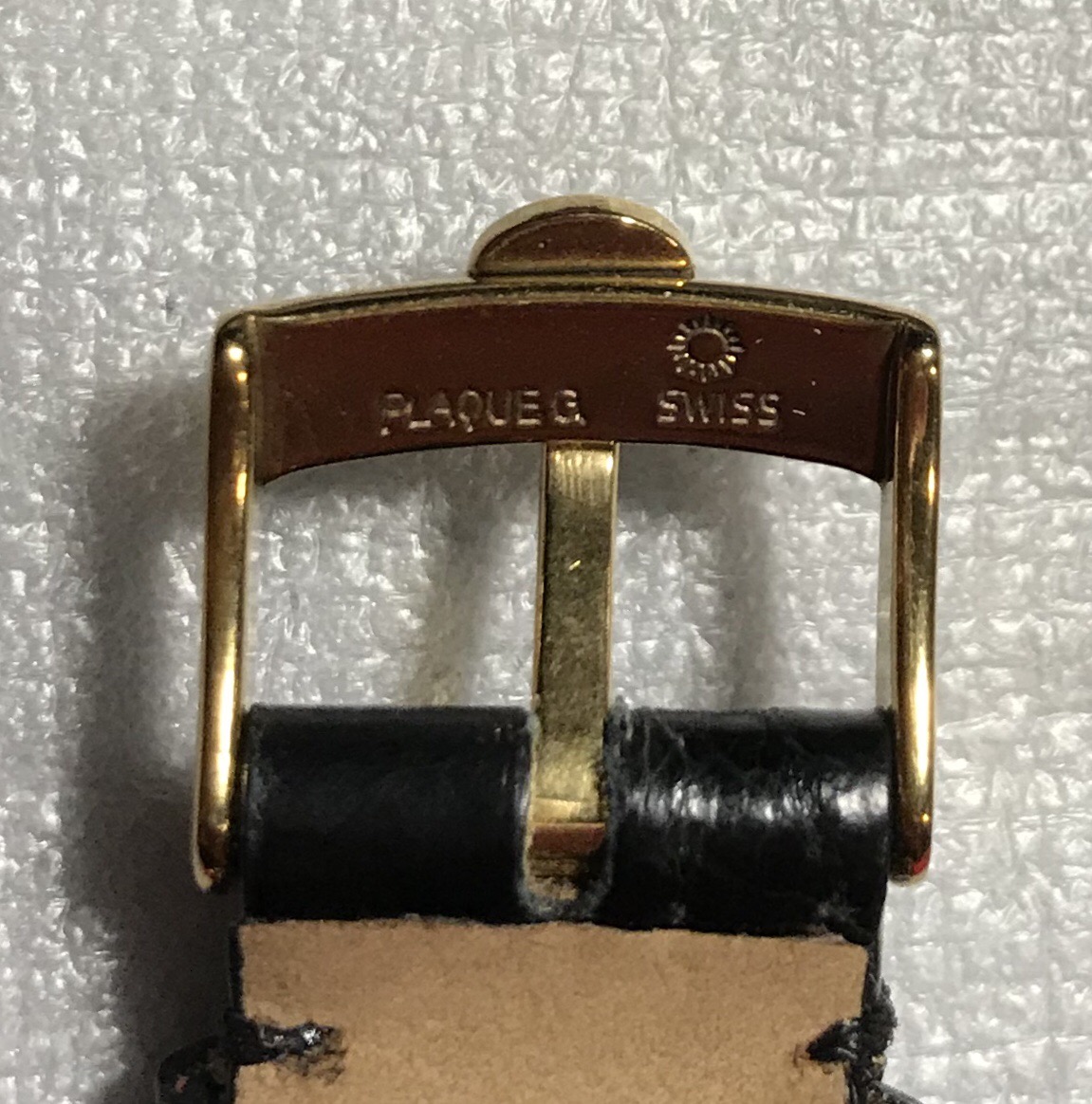

I'm having an issue with "PLAQUE G". French for gold-plated is PLAQUE OR. This leads me to assume that any buckle marked PLAQUE G is suspect. But, some of those look right. Anyone puzzle out an explanation?
You are correct. However, I don’t think I’ve seen any Omega buckle marked “plaque or”.
My guess is that the “G” is for the benefit of the English and German speaking people in the audience.
gatorcpa
1,531
1,088
In my record, plaque G is pretty normal. Like Gator I have never seen a plaqué or buckle. But I own or have seen plenty of plaqué g which I think are genuine.
I have read on several French sources that the G mean "galvanoplastie" - which is kind of the same as electrolysis. That would make sense as the French law concerning hallmarks is not fond of English terms or initials (so g would not mean gold here).
But this does not come from an official source (customs or any other government source). So I take that with a grain of salt, as concerning this topic I prefer to refer to official texts.
By the way, I shall add that plaqué or is a precise hallmark for the French law. A "doré" item can have as low gold as 1 micron, but plaqué must be 3 microns for jewels and 5 for watches. And in my record, 10 microns would actually be the low side for watches. Most often, good pieces would have 20 microns, and the best (Lip for instance) could have as much as 40 microns. (Not to mention Swiss Made Omega with 80 microns).
I do not know the standards for buckles. But at least, 3 microns - as I do not think bucles belong to the same regulation as watches.
