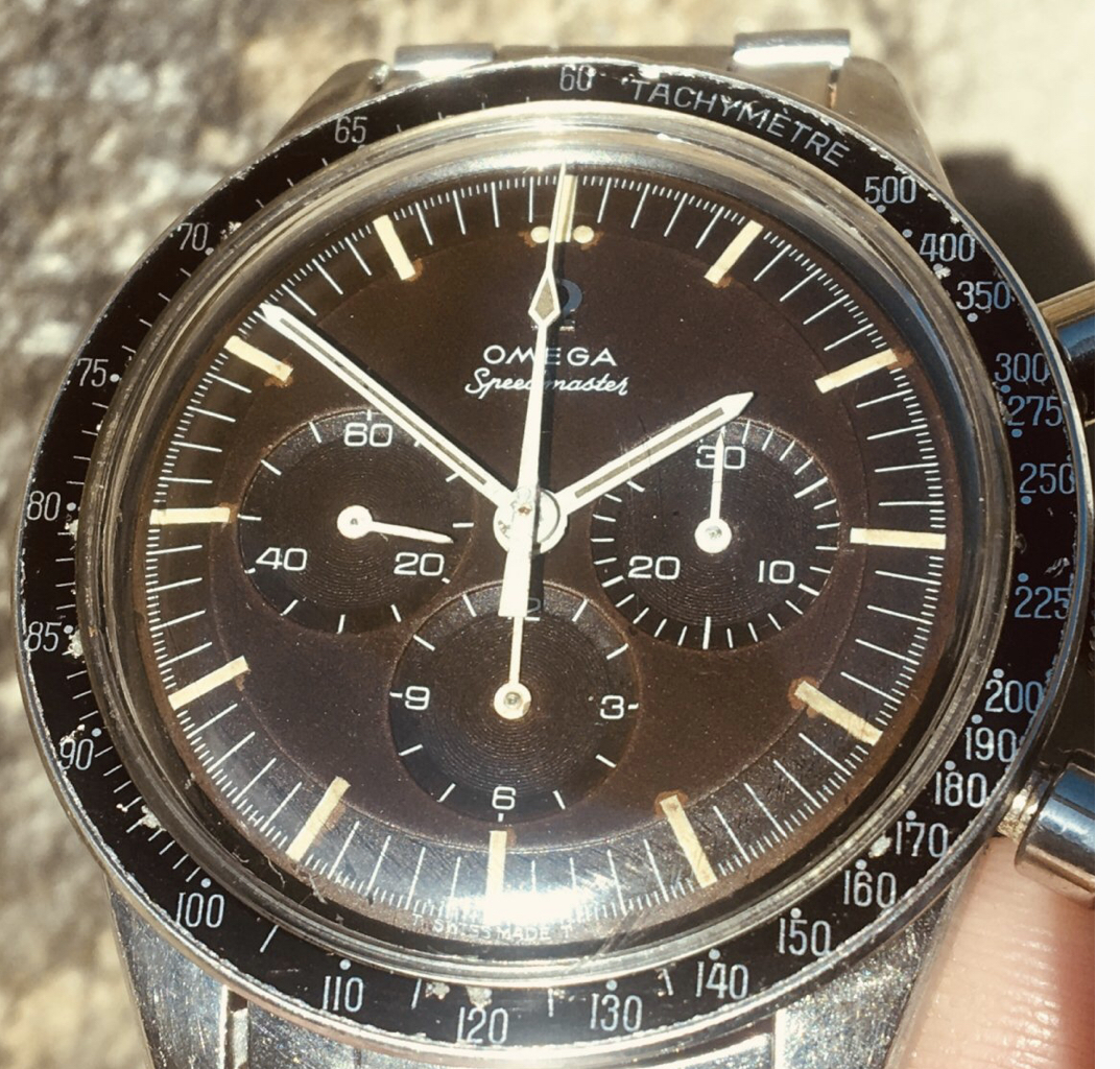

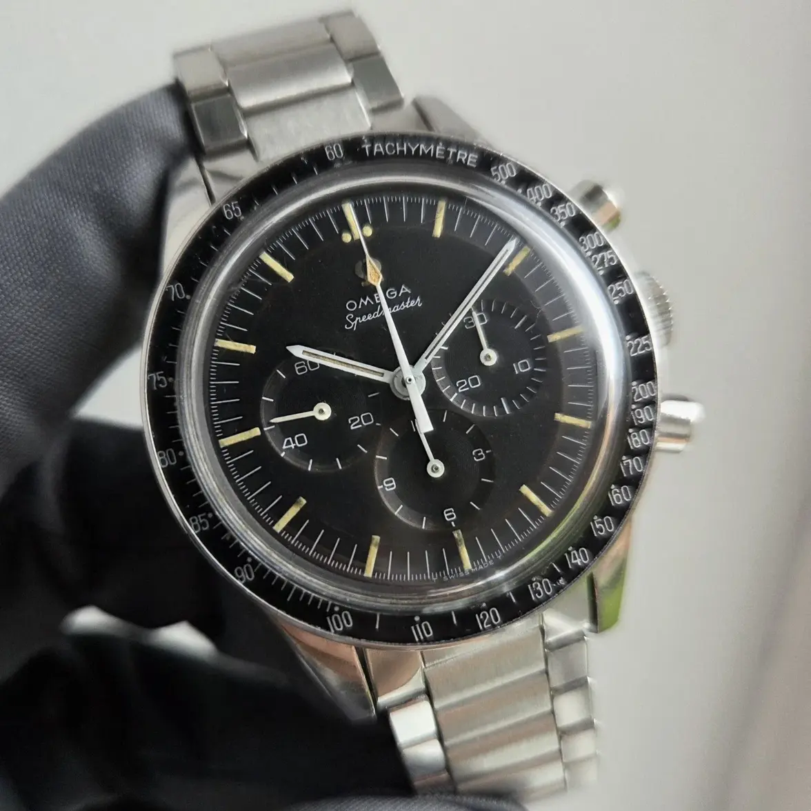

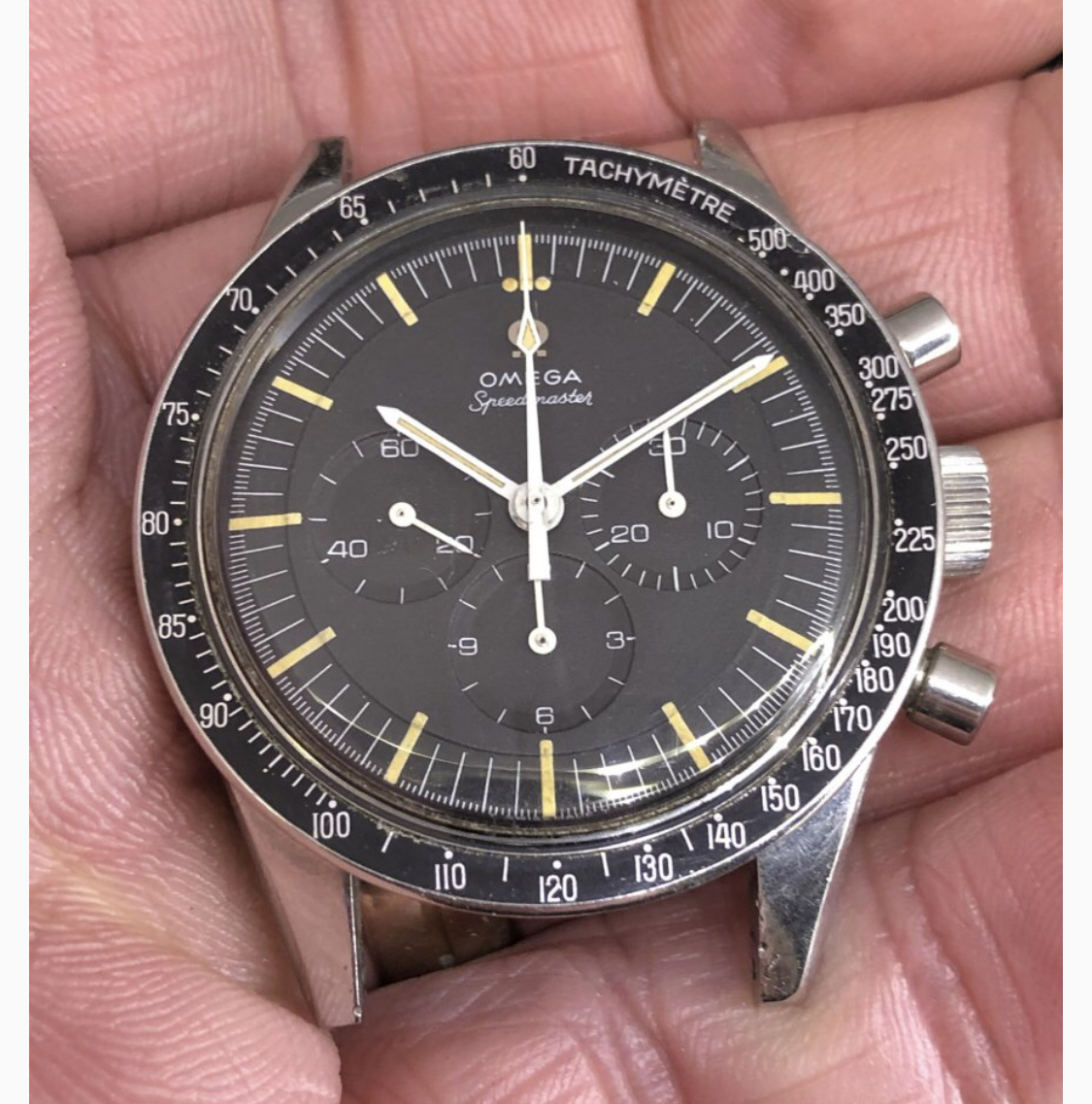

One more.

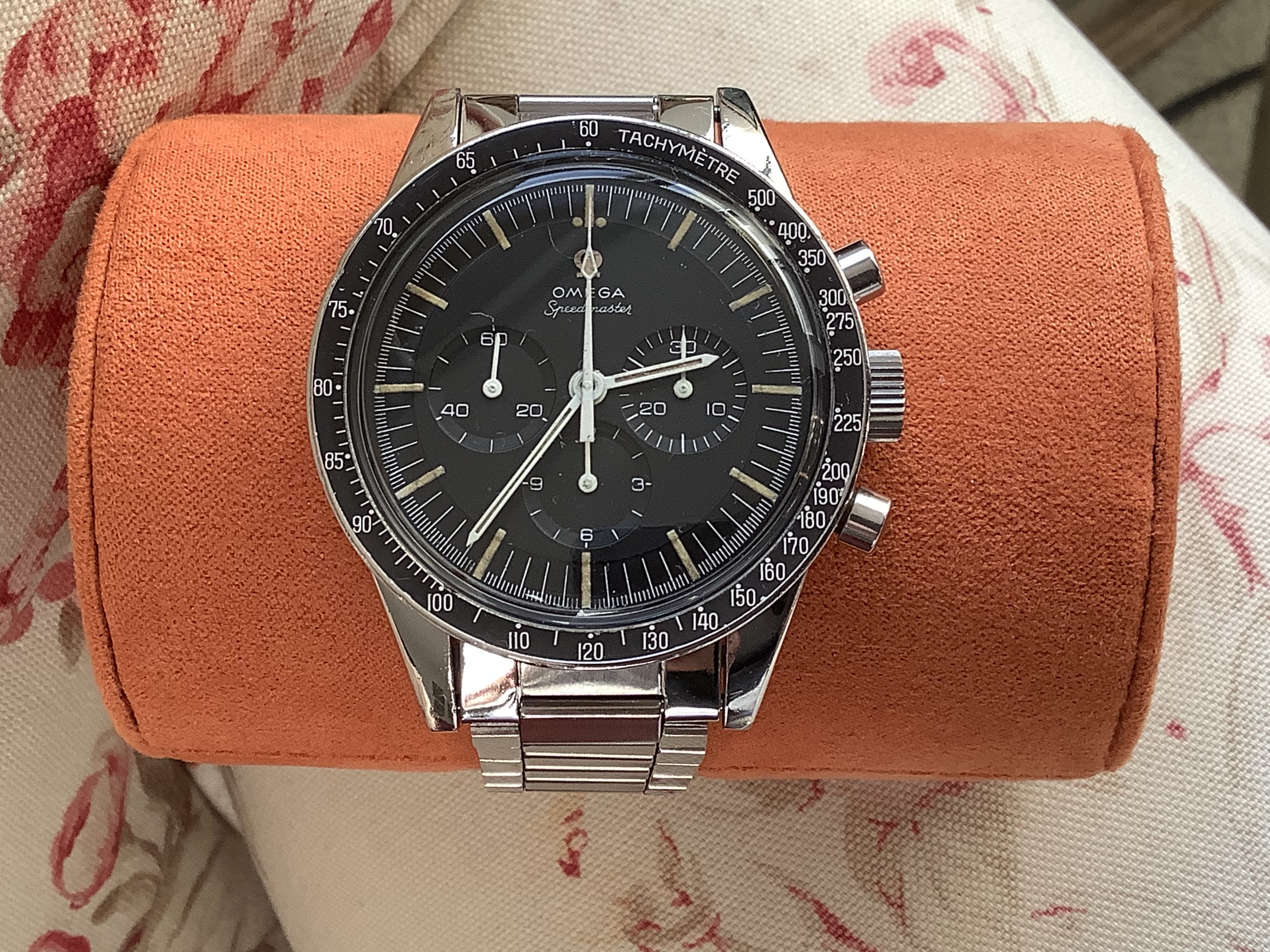

Serial number 2495098x. At the time I acquired it three years ago, the pushers and crown are the same as on the later 145.012 model. I am keeping them this way. I will go to OB for an extract next week.
1,522
4,786
Thank you @fzhu052
I contacted fzhu052 some time ago when I saw a photo of his lovely watch above and saw it had all the hallmarks of a SP 003, crown, pushers and fat tail chronograph hand. After many weeks his watch was finally opened at service to reveal the SP engraving.
So three of the four known 105.003-65 SP watches are in the very close serial range of 249509xx.
This is no coincidence. These watches did indeed come from the Omega factory like this and were produced with the upgraded pushers and crown, also with the fat tail chronograph hand late in 105.003 production.
So we can say the 105.003-65 SP is a very rare and factory version after all 👍

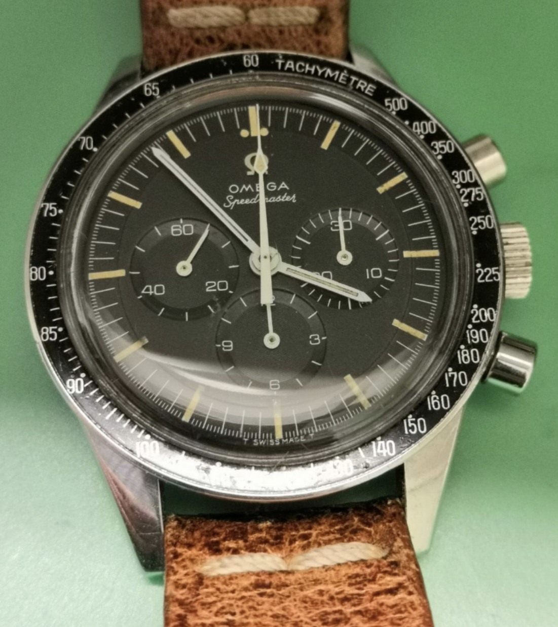

13,558
23,505

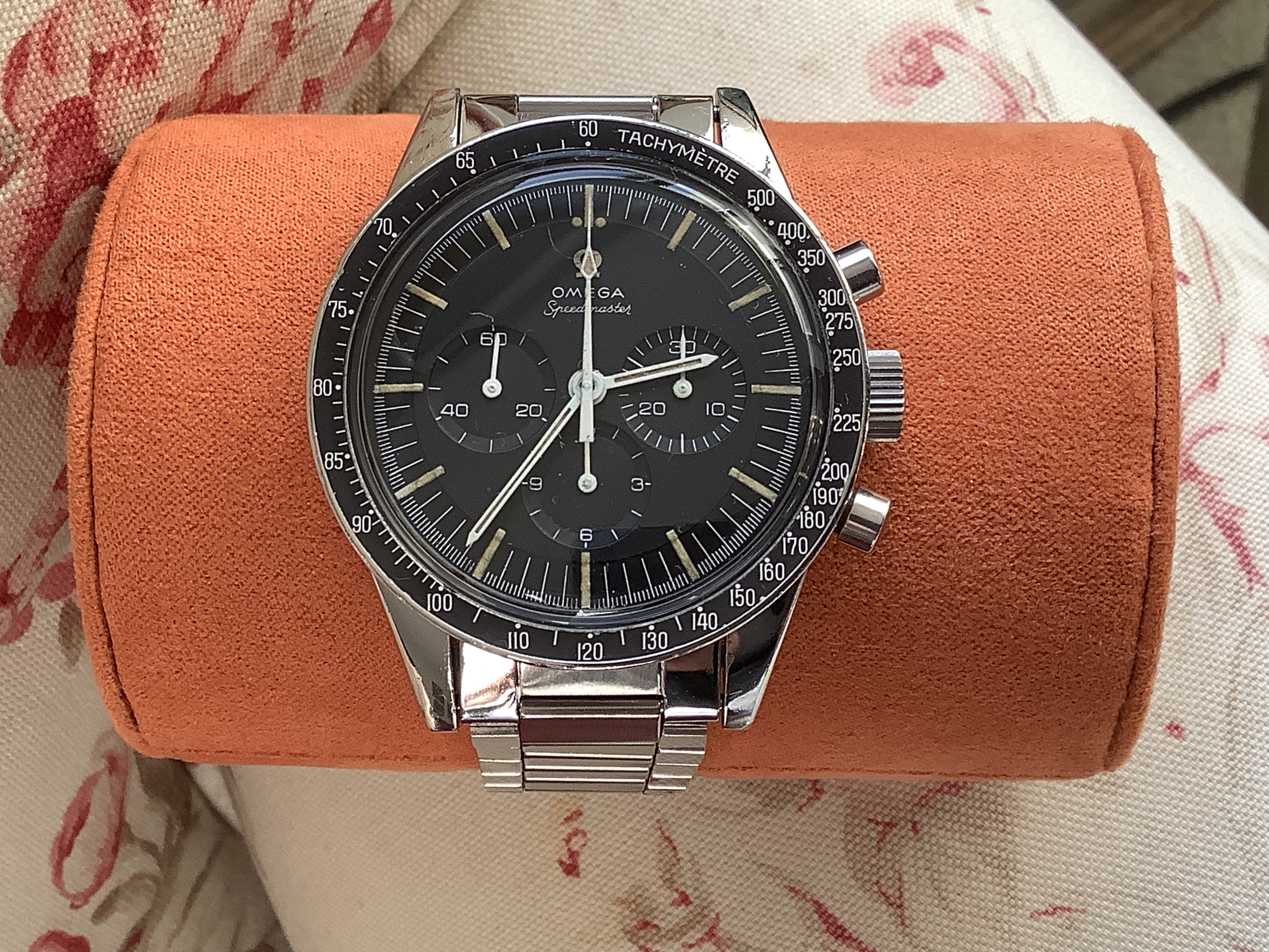

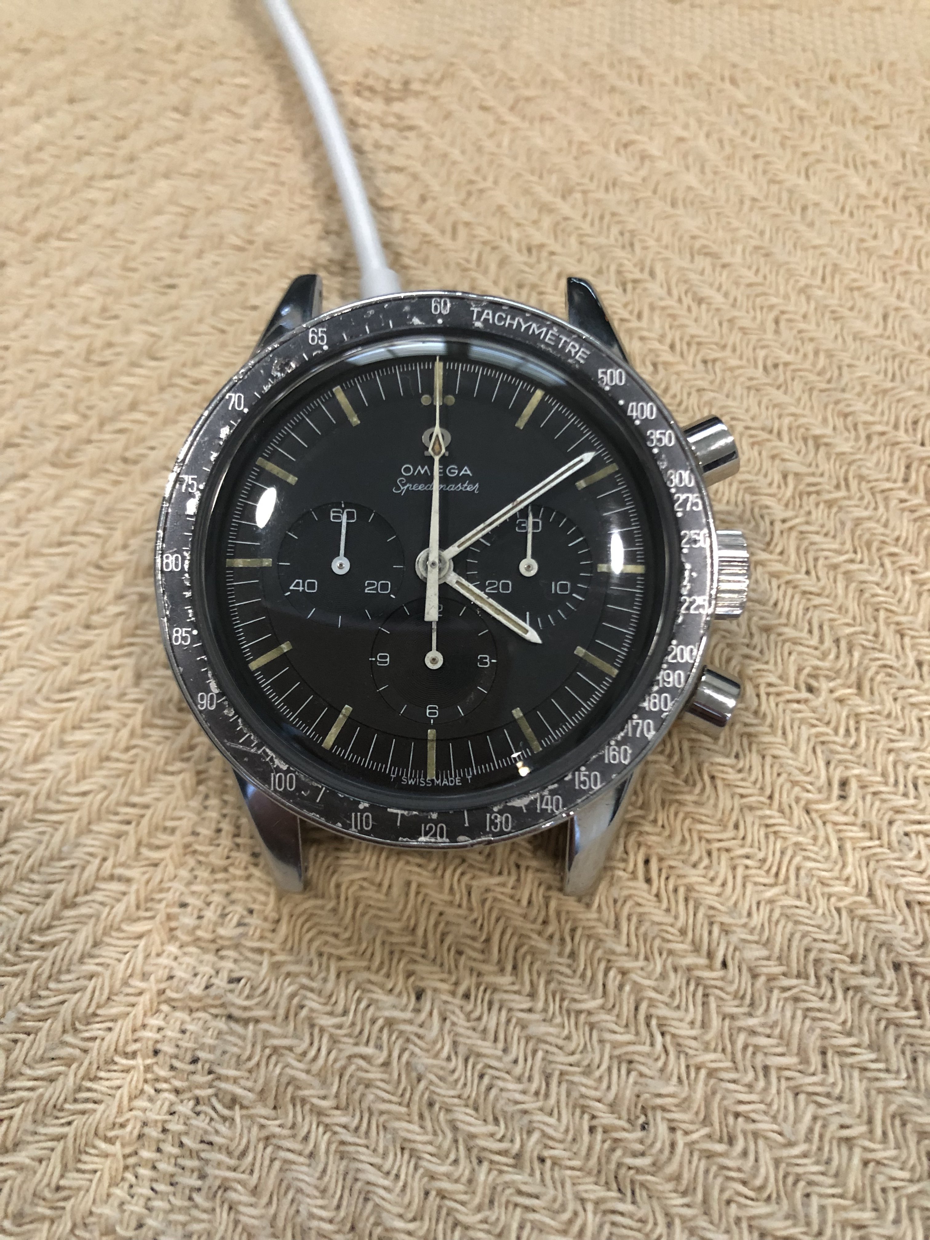

Great read. If this is true, it must have been a batch rather than a cut off point as my 105.003-65, serial 24,957xxx, produced Oct ‘67 doesn’t have the SP designation as has the ‘correct’ pushers, crown etc.
Obviously caveated by the fact Omega may not have taken serial number batches in sequential order.

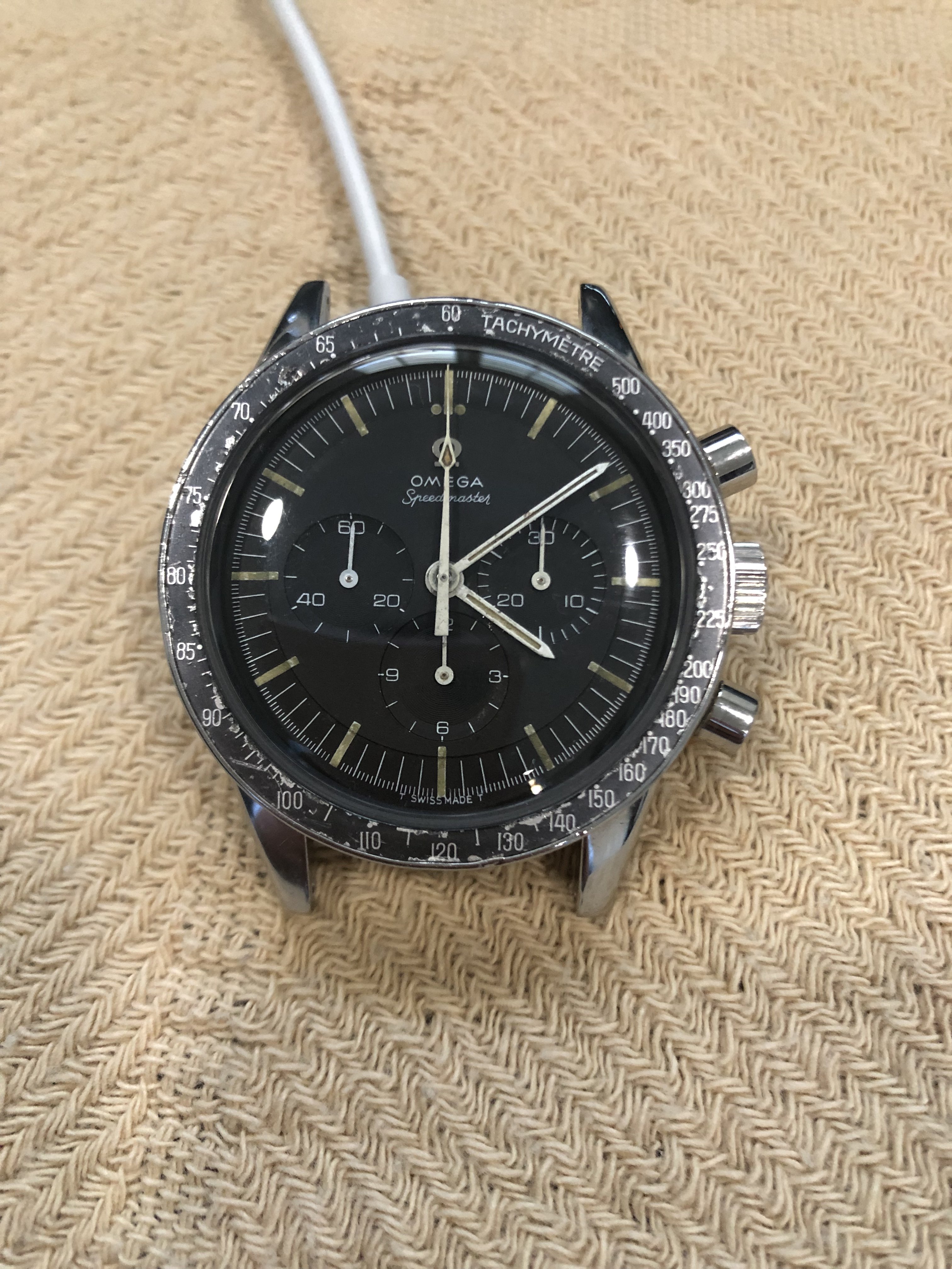

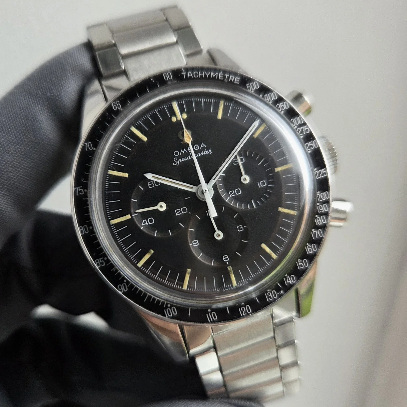

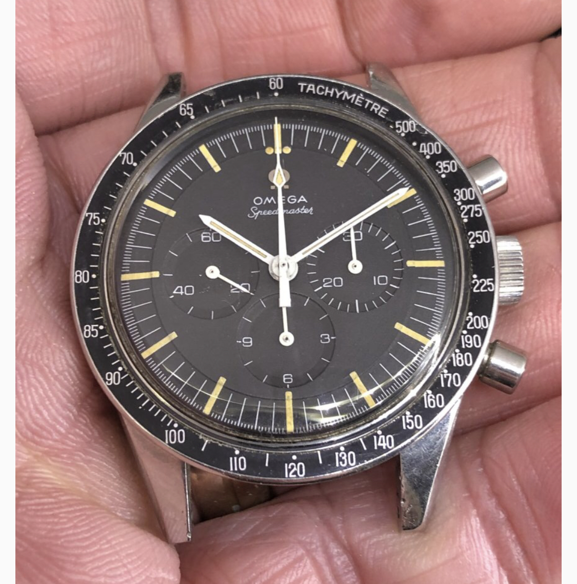

Haven’t looked at the inside back, but what do you think?
1,522
4,786
Could be, only one way to find out.
Cheers, Michael
7,401
23,886
Cheers, Michael

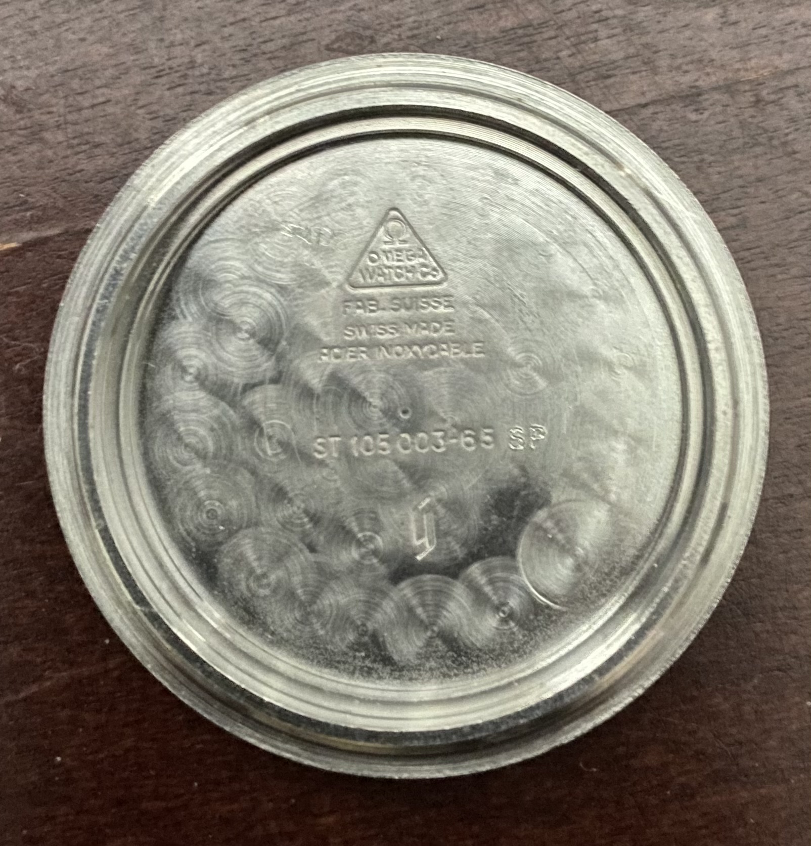

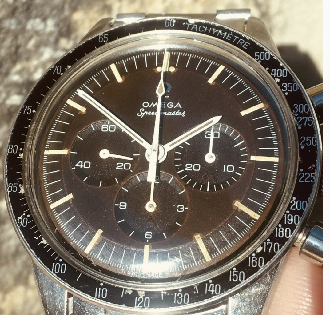

Serial number: 24952XXX.
Edit: just checked, does not have the SP marking on the inside.

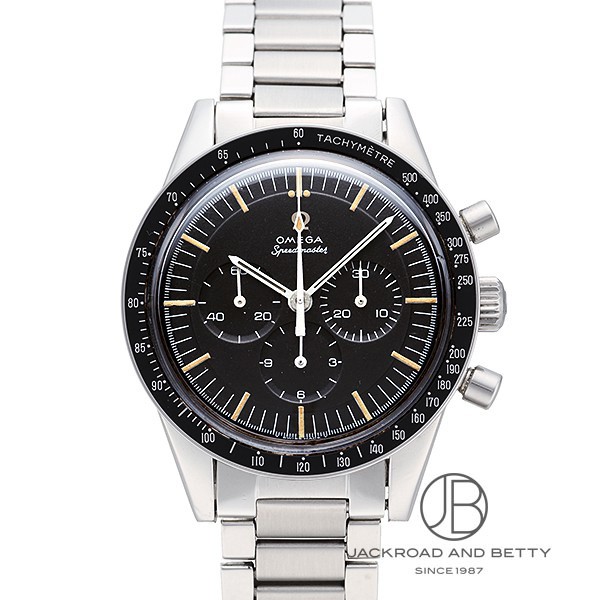

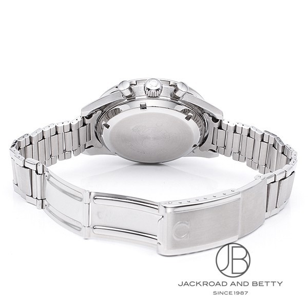

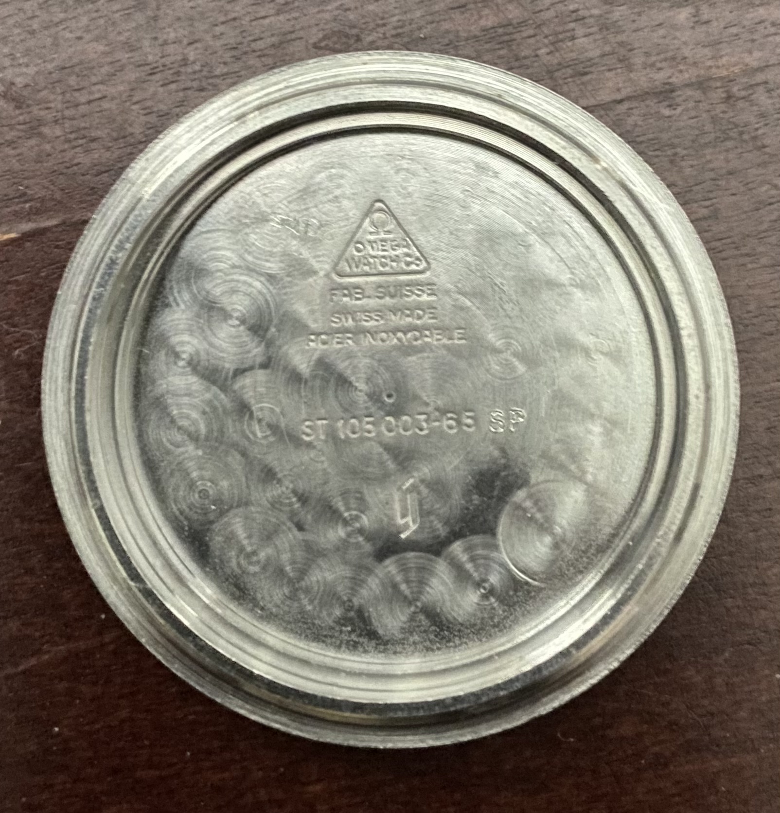

This thread reminded me of some questions I asked the dealer earlier when I was considering a purchase about the watch in the photo.
The answer was that the serial number was 25447xxx and the description on the inside of the back cover was 105.003-65SP.
I didn't buy the watch in the picture, so this is the only picture I have.

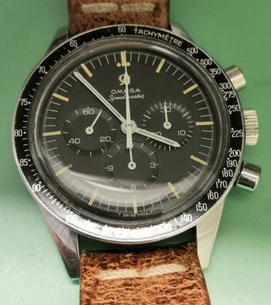

176
153

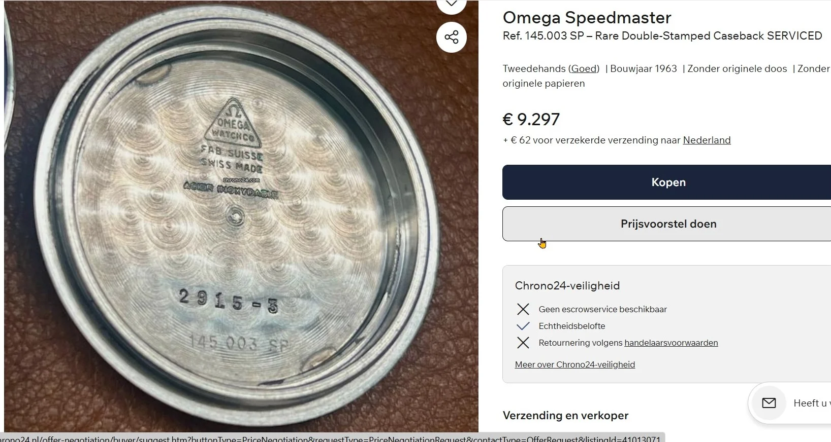

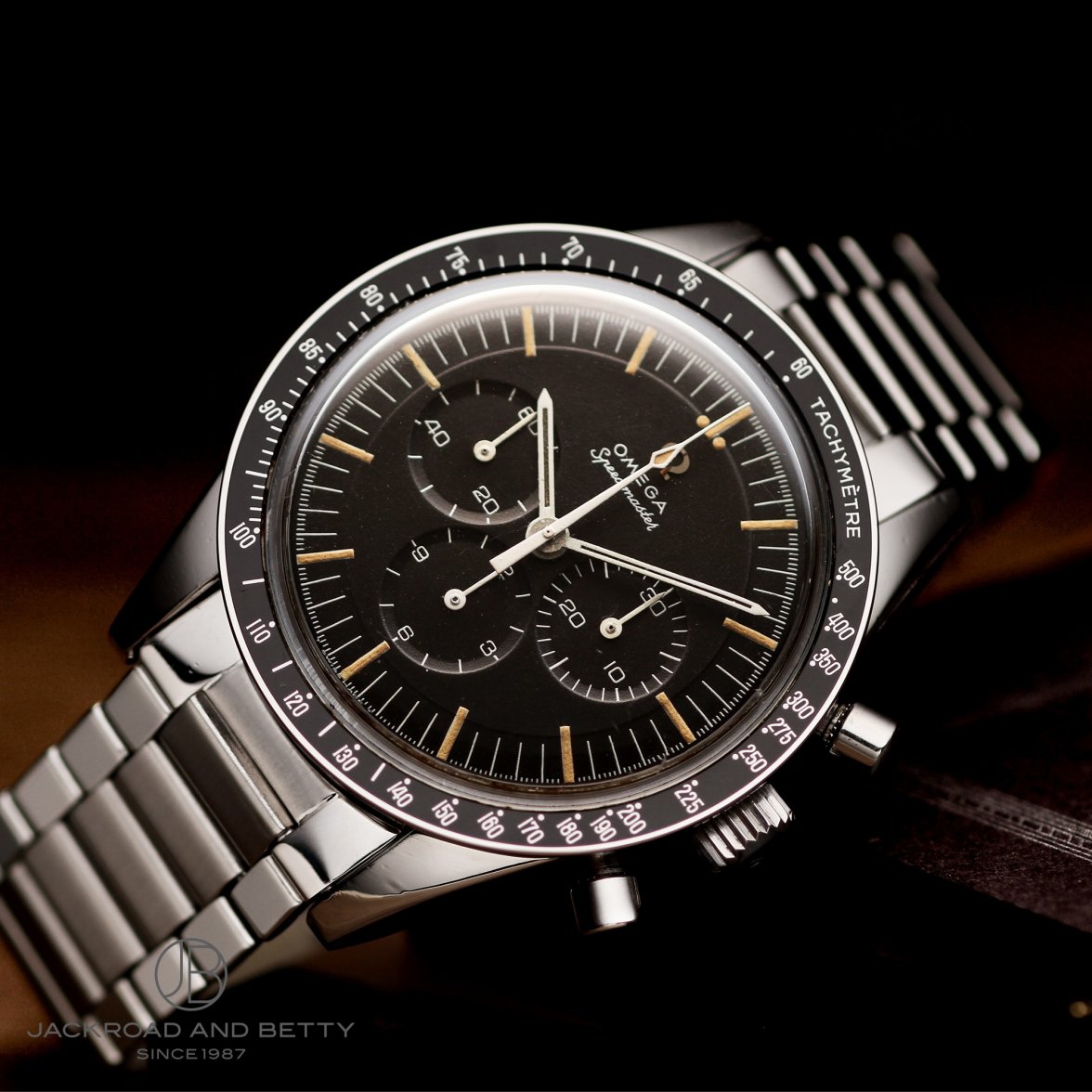

as an avid collector of 105.003 i have been offered what is described as 1 of only 3 in existence late 1968 105.003 SP. i am waiting for some better pictures but the case back looks like a standard 105.003 caseback and stamped SP.. Yet on the EOA there is no mention of this.
I know the pictures are bad but hopefully you can see the SP looks like it has been added afterwards.
Does anyone have a 145.003 SP with EOA and if so does it mention this SP , water protection upgrade

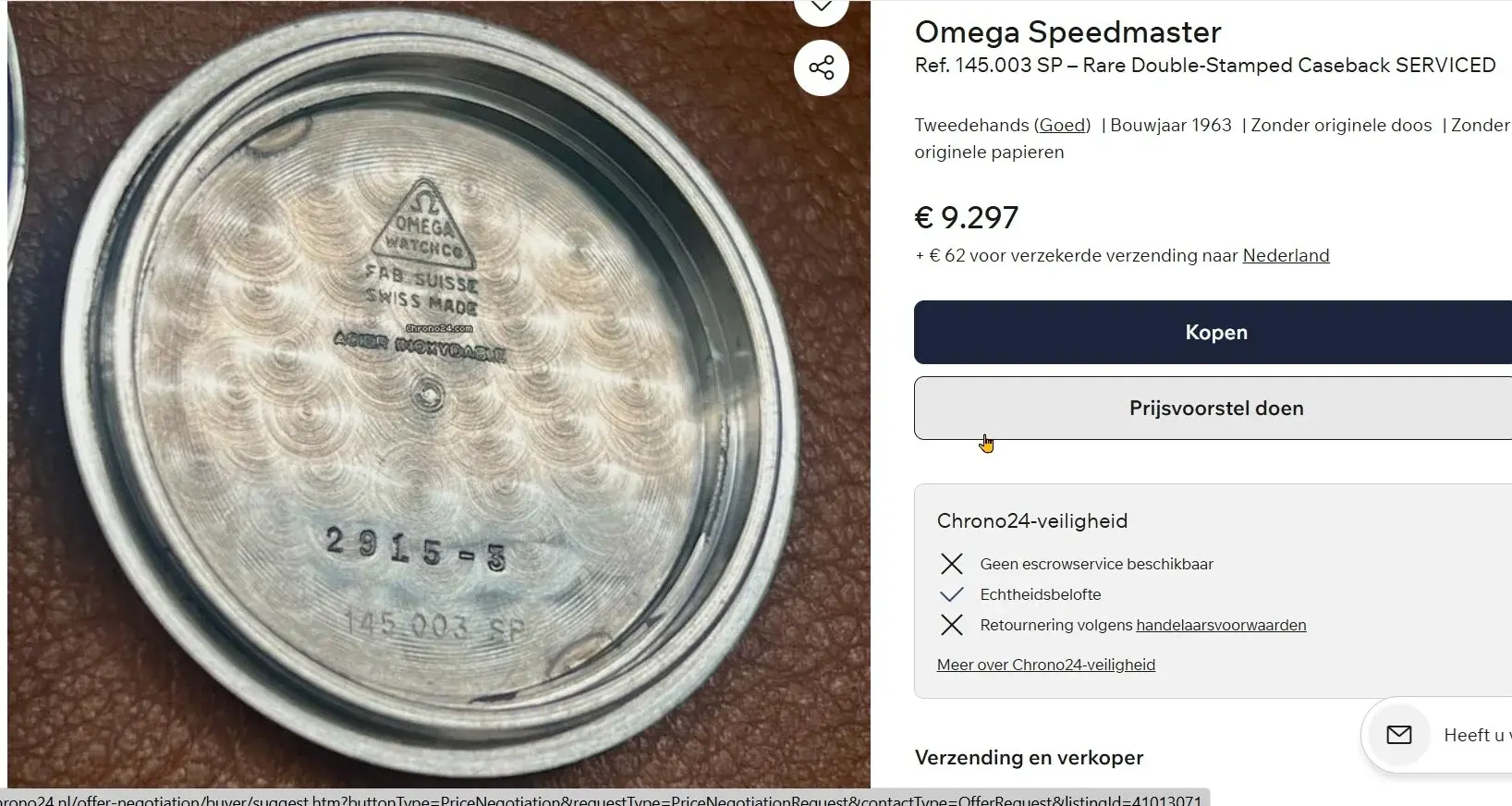

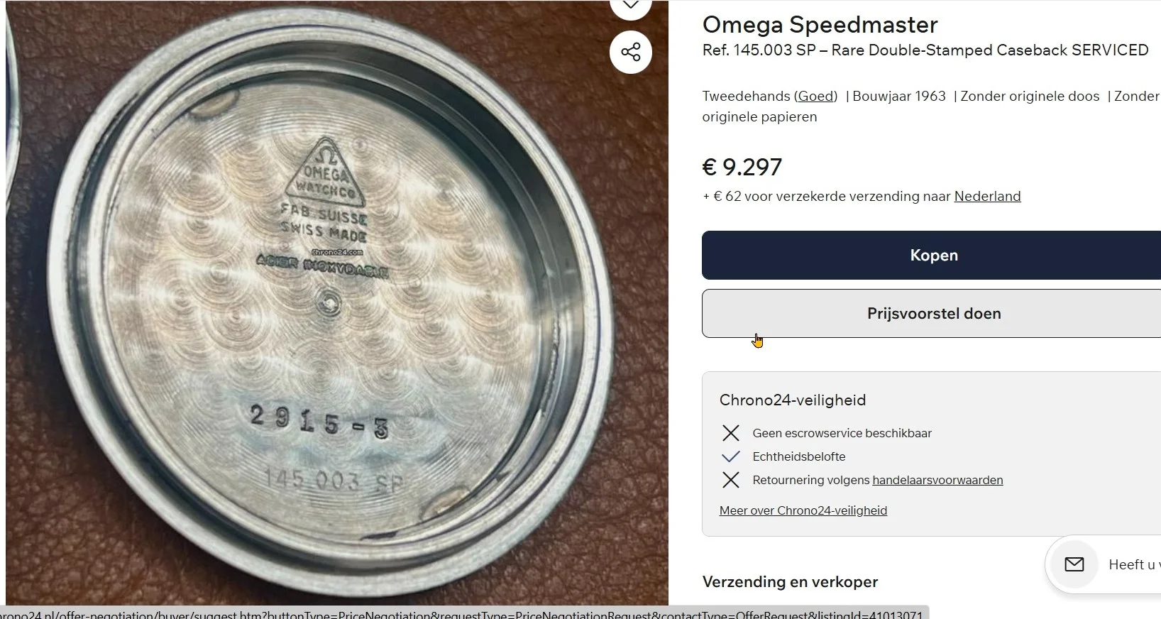

at your service, this 145.003 is listed on C24 right now ;
176
153
thank you for quick reply. if you look at the SP stamp on the chrono listing it appears original where as on the 105.003 caseback it looks like a different font on the stamp. does this listing have EOA ?

Description reads as AI and puffery, in my opinion.
I tend to agree. I picked this thread as the OP even mentioned the fact that the 105.003 had a stamp almost exactly the same but there was no more discussion about the SP on a 105.003. i have had dealings in the past with dealer on other 105.003 and they have always been willing to negotiate price but this time no.

@Ron_W Thank you for the link, i replied with same message but the moderators blocked it, i assume as your message has an outside link.
18,328
27,697
These all smell like service casebacks to me.... ESP the one posted today... color me skeptic, but there is a reason why they are not showing the differences that would appear on an sp...
